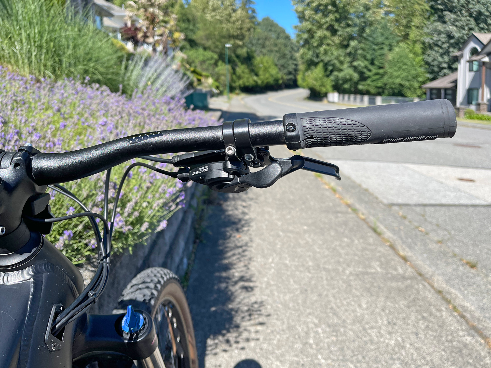

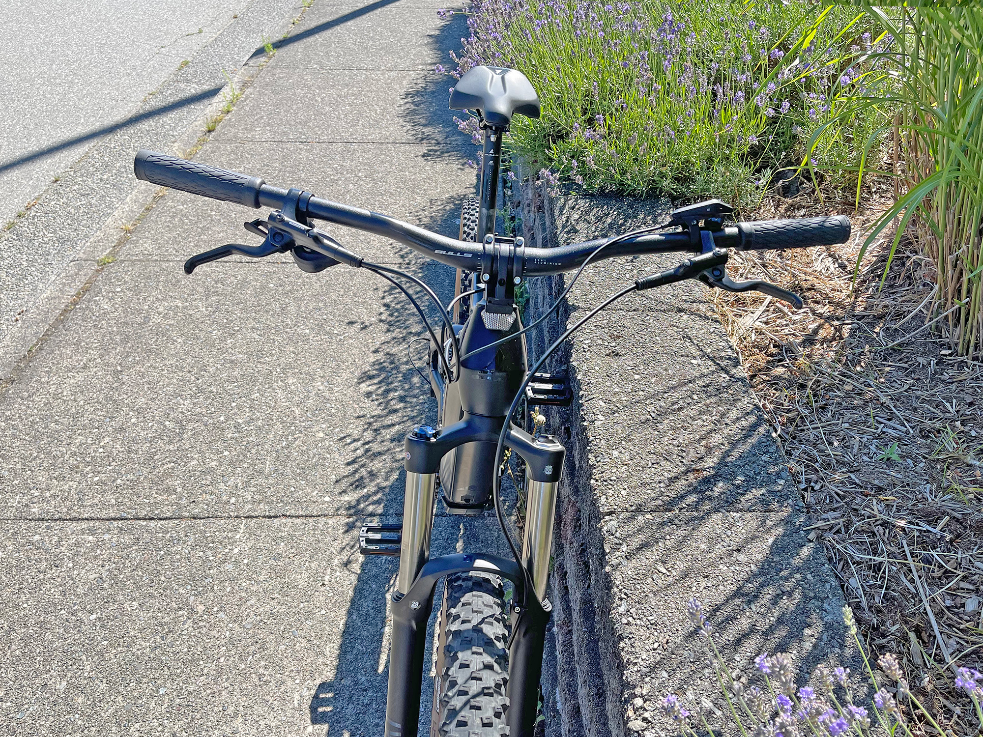

BULLS Branded MTB, Aluminum Alloy, Double Butted, Low-Rise, 760 mm Length, 25 mm Rise, 9° Back Sweep
Bulls Branded Velo, Flat Rubber, Inner Lock Ring

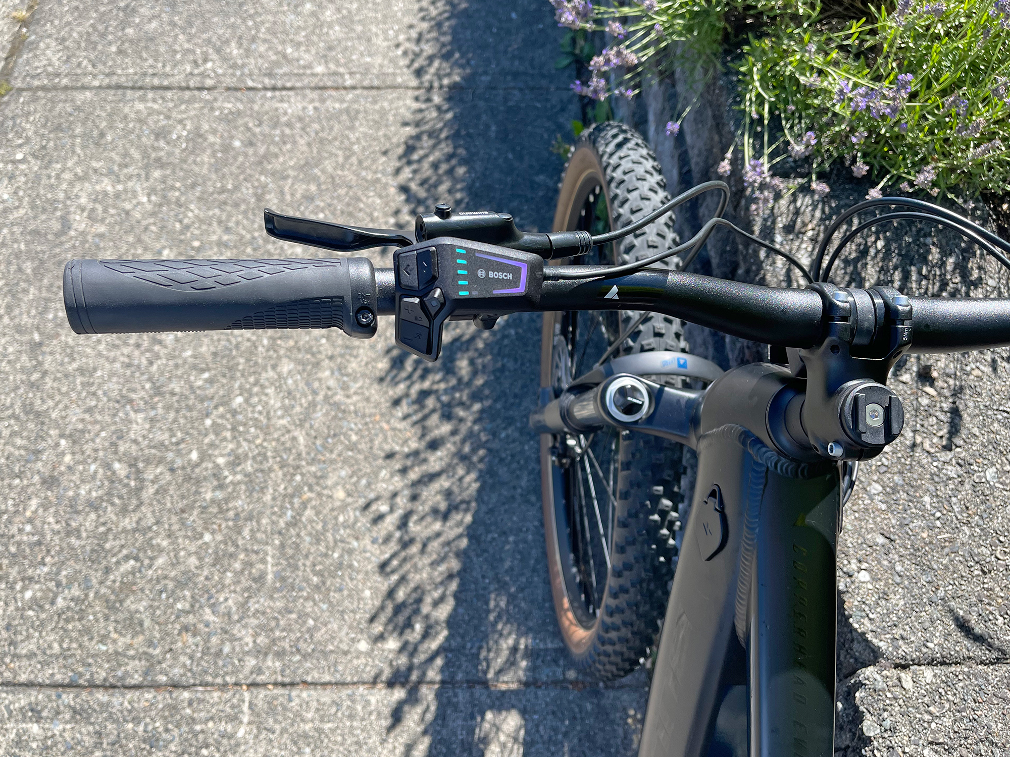

Bosch LED Remote (Buttons: Power, Left/Right, +, -, Select, Lights if Available: Hold + Button, Walk Mode: Hold - Button

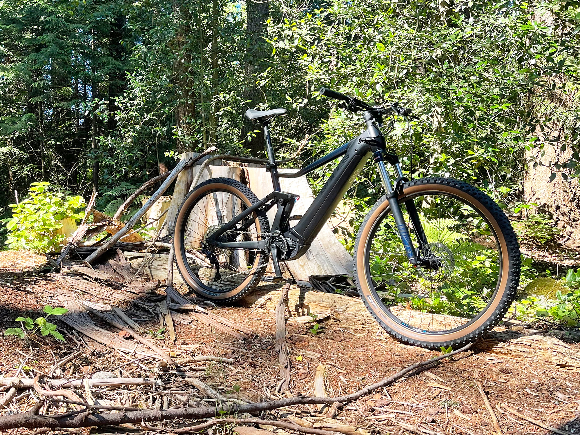

This review was provided for free using a demo bike. My goal is to be transparent and unbiased with you, this video and writeup are not meant to be an endorsement of BULLS products. I welcome your corrections, additions, and feedback in the comments below, and the BULLS electric bike forums.
Observations:

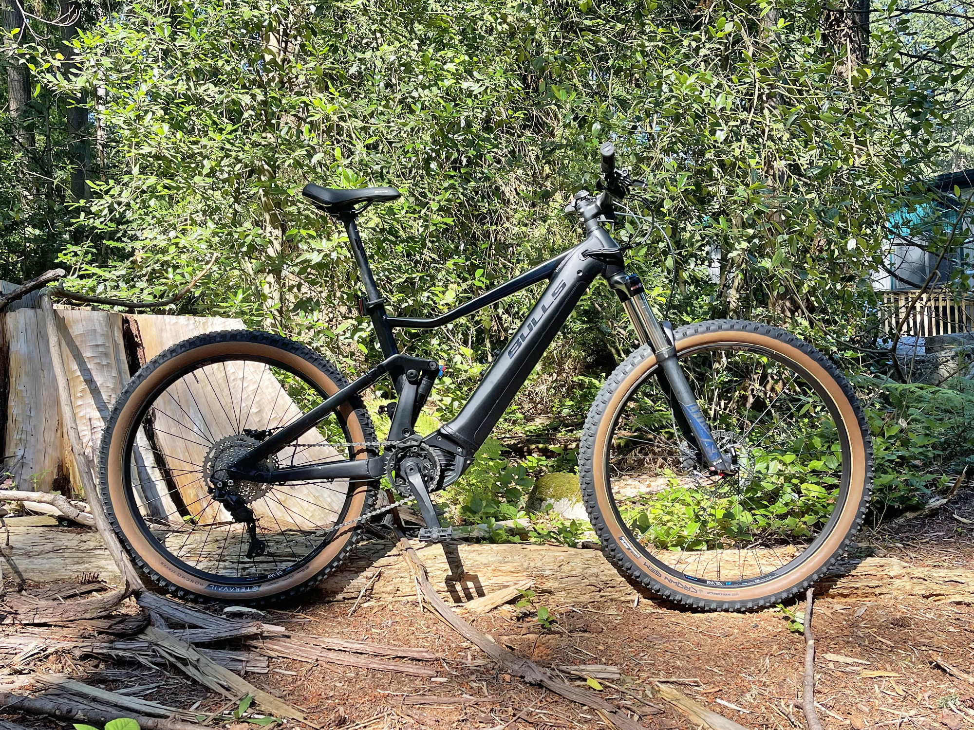

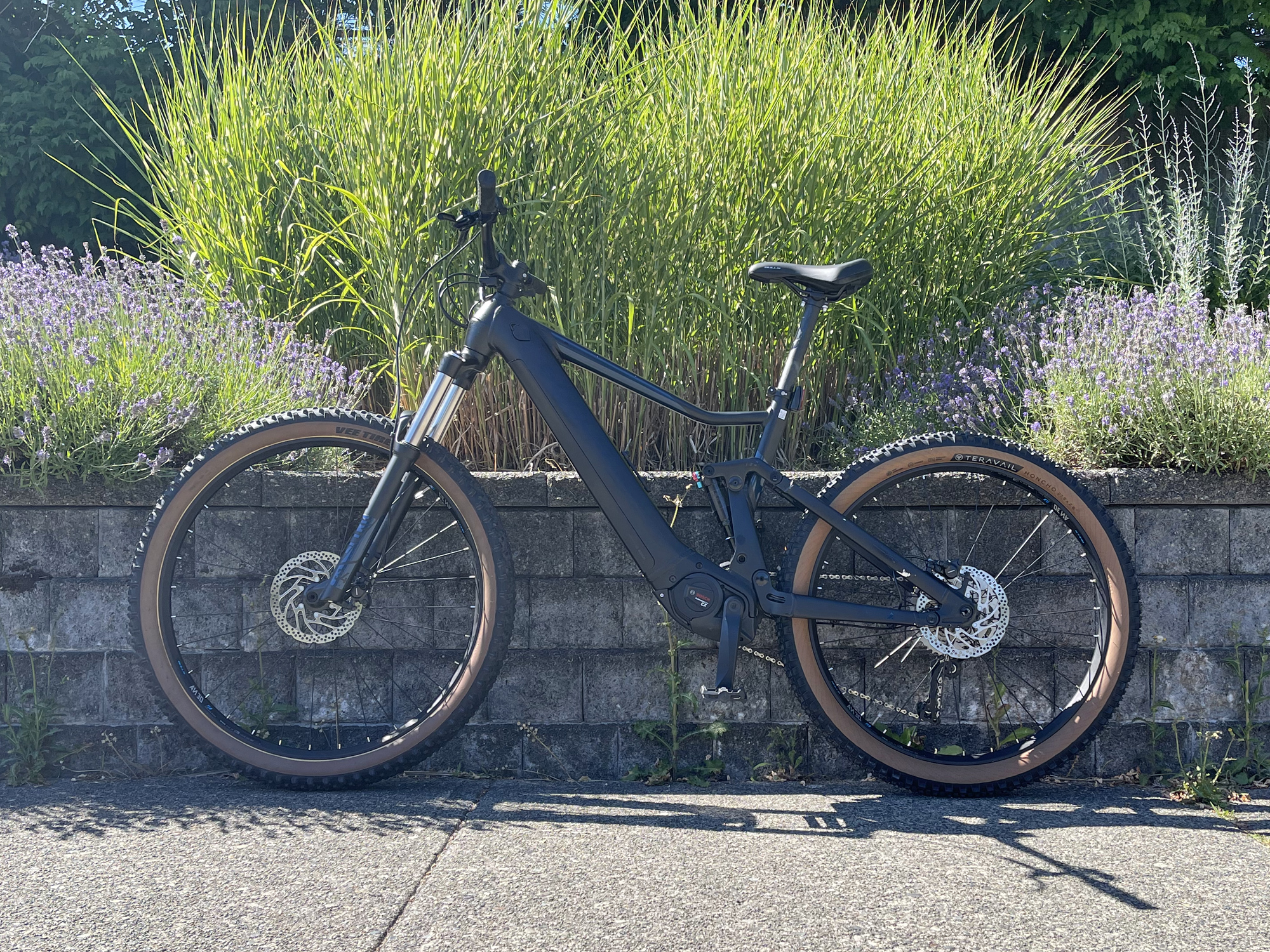

  • The bike is purpose built with good weight distribution, although it is fairly heavy due to the high capacity battery pack. It comes in four frame sizes, one color scheme, and is generally sold through dealers.

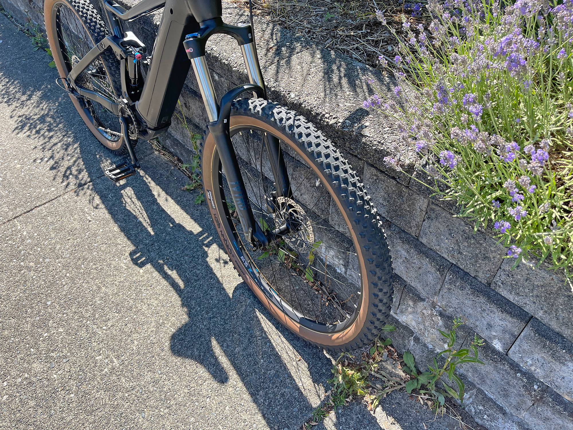

  • The wheels and tires are different sizes, the front is larger than the rear. This is called a mullet, named after the hair style, because the larger wheel in the front handles the “business” of drops and large obstacles while the rear offers a “party” being more playful and quicker. You get a lower attack angle up front, raised bottom bracket, and sturdier rear wheel. Steering is a bit slower and smoother than if both wheels were 27.5″ vs. the front being 29″ so you can take on obstacles vs. steering around them.
  • Boost hub spacing means the spoke bracing angle is sturdier and the frame is wider. Both wheels attach with sturdy thru-axles. The tires are 2.6″ wide which is the narrowest “plus” size, offering improved stability, float, and overall forgiveness… supporting the “go over and off vs. around” capabilities of the bike.

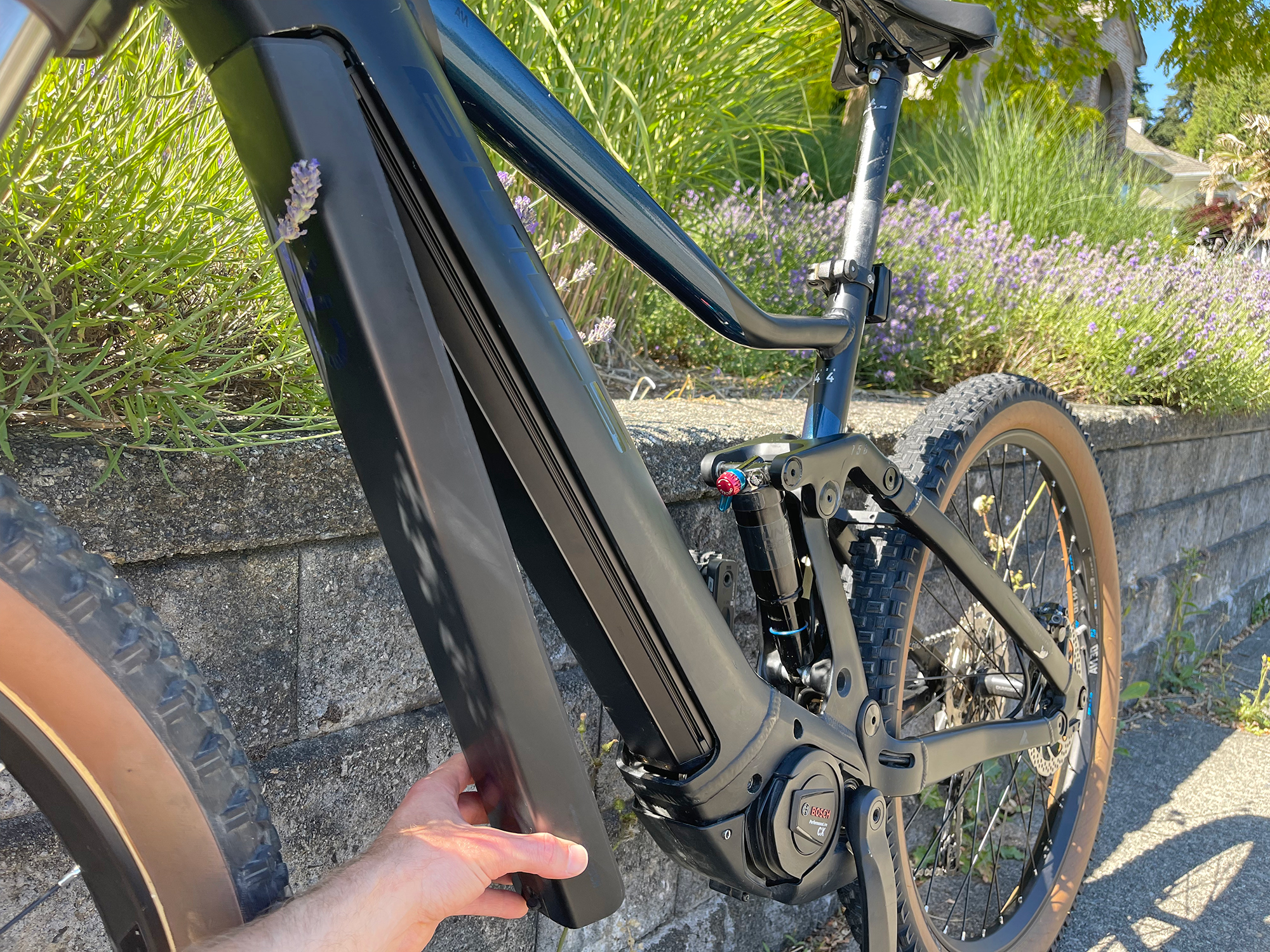

  • Purpose built frame with internally routed cables, sloped top tube for safer dismounts, drive system weight is kept low and center, the battery is completely hidden and well protected.
  • I love that they included a kickstand mount on the left rear chain stay, and it’s not a tab that hangs down. BULLS used industry standard two-hole threaded 18mm spaced interface. I also love the bottle cage mount on the downtube (it comes with magnetic MonkeyLink adapter), and where they positioned the battery lock and charging port (high up on the downtube, near the steer tube).

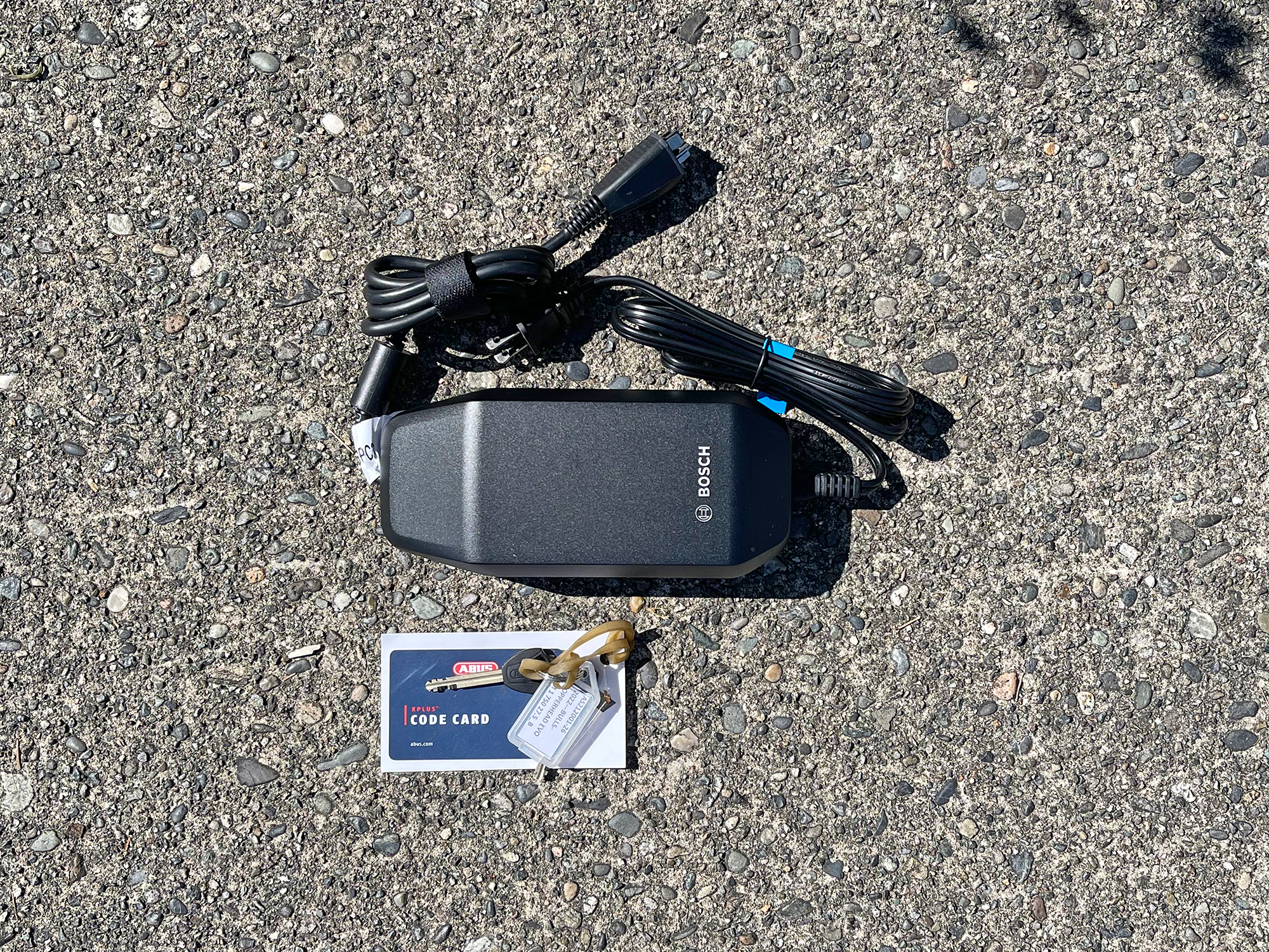

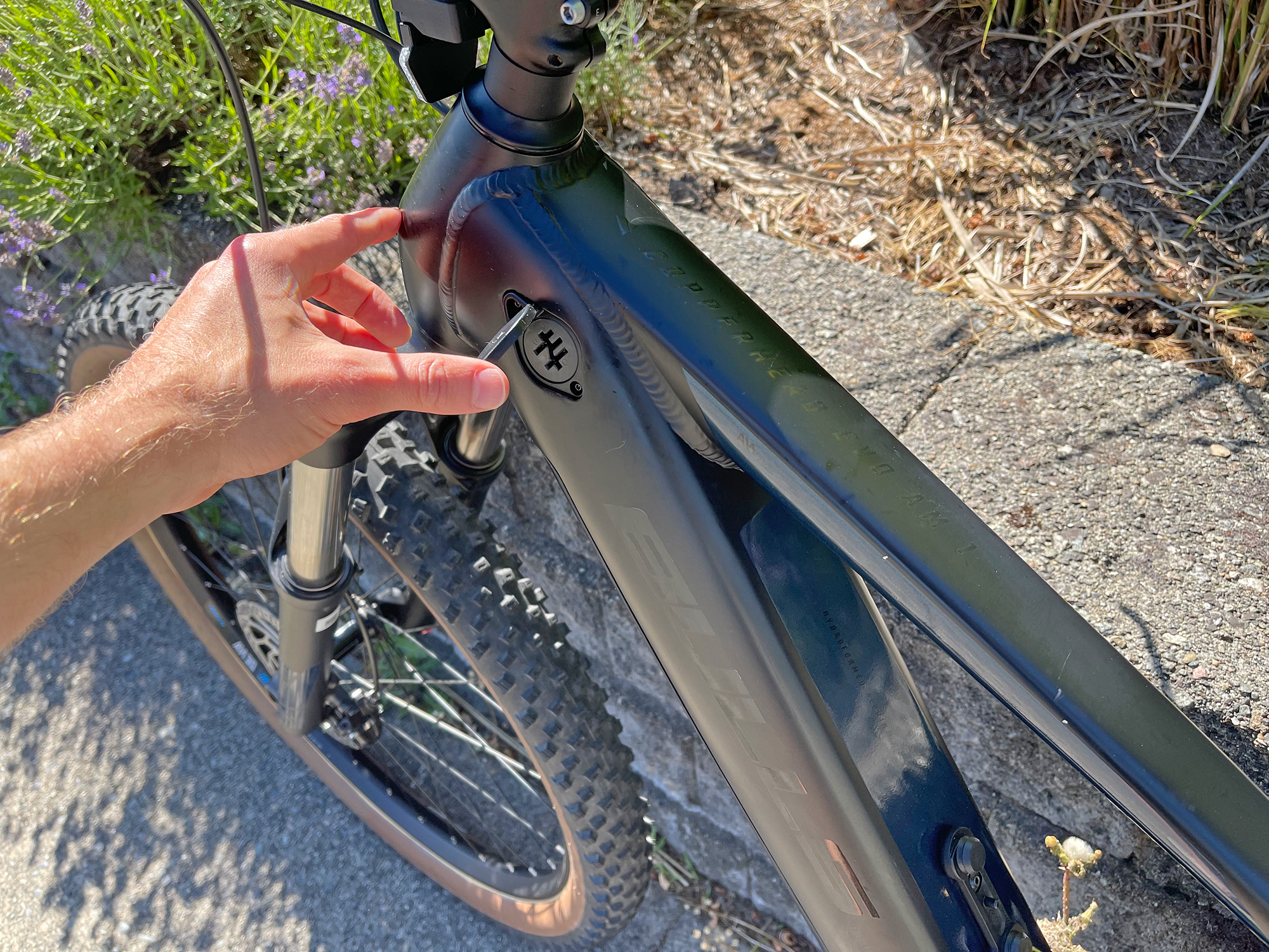

  • The battery pack locks into the frame using an ABUS locking core with XPLUS Code keys that can be matched to ABUS locks (like folding locks, u-locks, and frame locks), so you don’t need multiple keys! They seem to be high quality locks in general that would be more more difficult to defeat.

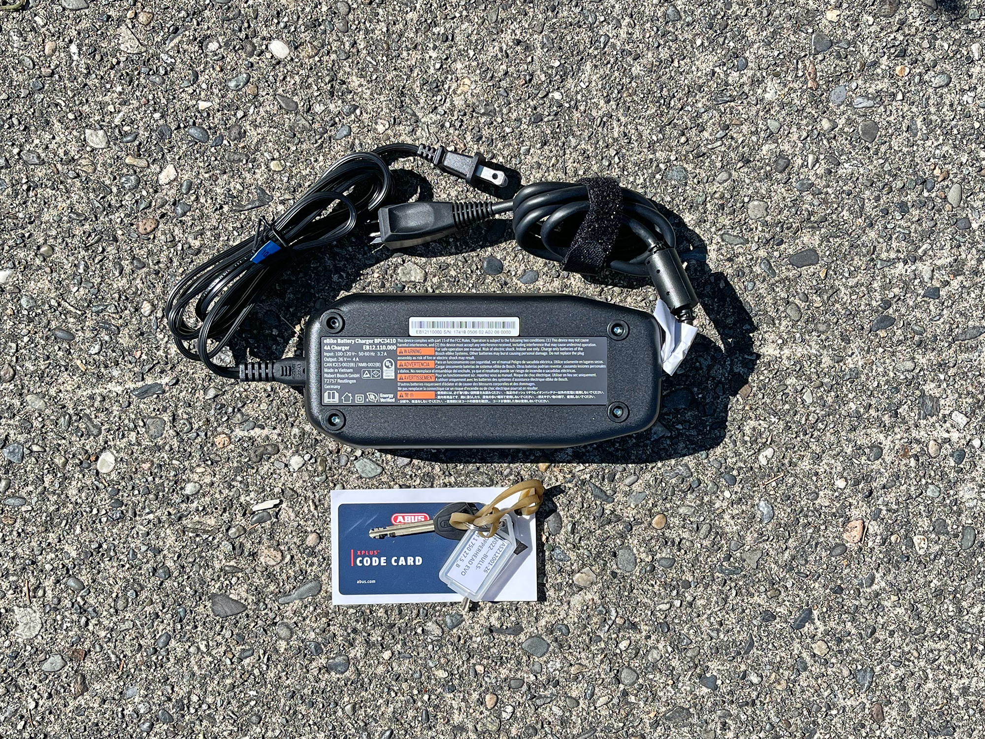

  • Outstanding battery charger that’s relatively light weight at 1.6lbs, compact with removable wall-side plug, and puts out 36 volt 4 amps vs. just 2 amps on many competing chargers. It has a sturdy plug design that works directly to the battery as well as the plug port on the bike. It’s also UL certified.

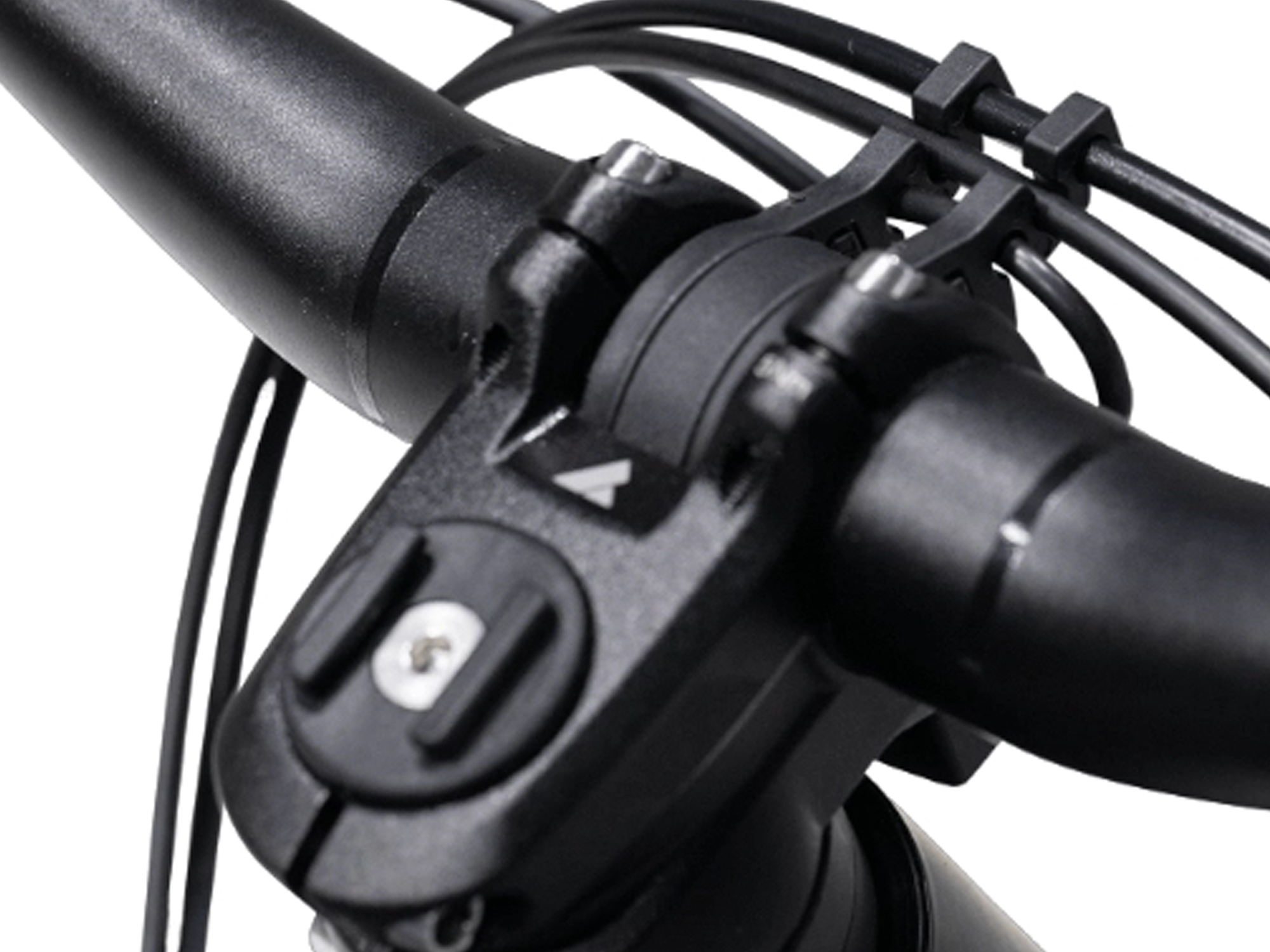

  • There are two magnetic light mounts with MonkeyLink interface, so you can add a headlight and a rear light or fender with light that will run off of the main rechargeable battery pack. The headlight is very nice with a flattened beam that won’t shine up into oncoming traffic and offers adjustable angle for aiming.
  • Clean aesthetic with satin black paint on the frame, fork lowers, rims, spokes, posts, and handlebar. Notice the brown sidewalls on both tires, despite being different sizes and tread patterns.

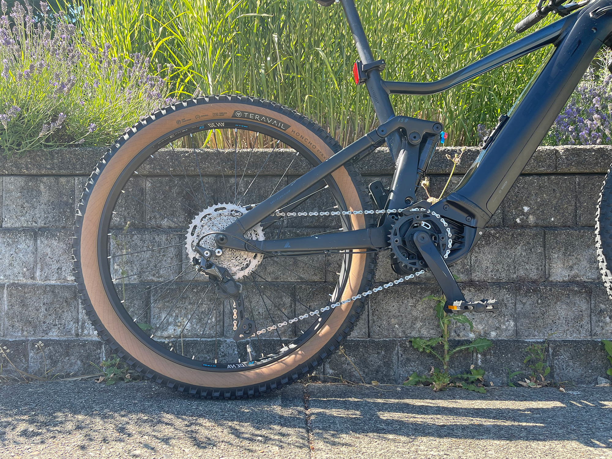

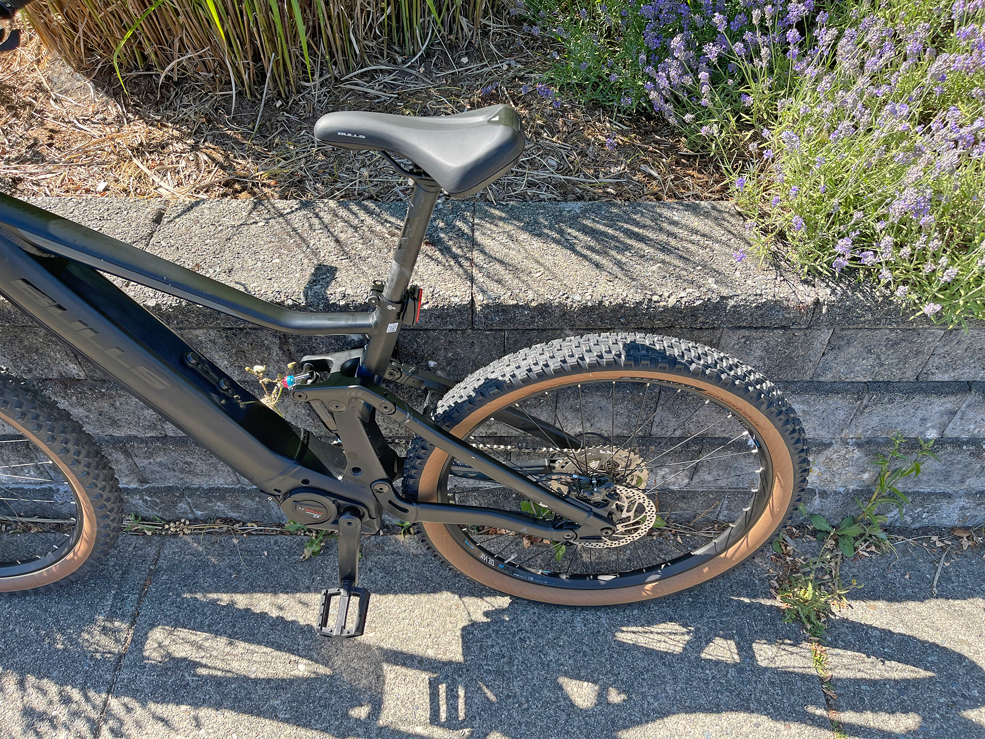

  • This is a rare setup, stock mullet with 29″ wheel in the front and 27.5″ wheel in the back. They configured the geometry, so you don’t have to convert a 27.5″ setup with a new fork. The configuration blends stability and confidence on bigger drops and hits with playfulness and precision.
  • Tire tread is different for each wheel, the front tire has more space between knobs to improve steering grab while the rear is tighter for improved traction during acceleration. The plus sized 2.6″ width improves stability, float, and comfort with a good range of PSI options. Rims and tires are tubeless ready to run at lower pressure and save some weight.

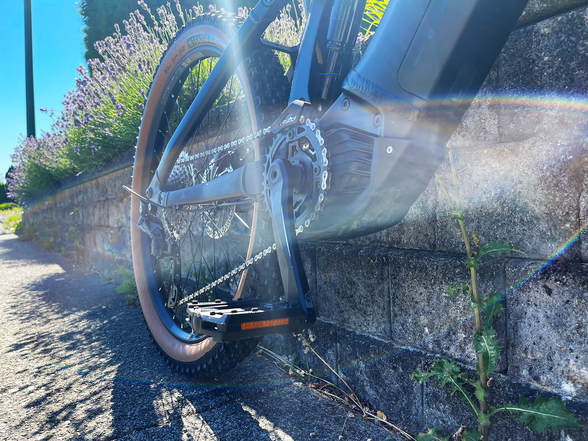

  • Another benefit of the mullet setup is higher bottom bracket clearance because of the taller front wheel, BULLS accentuates this by stocking shorter 165mm crank arms vs. 170mm to reduce pedal strikes.

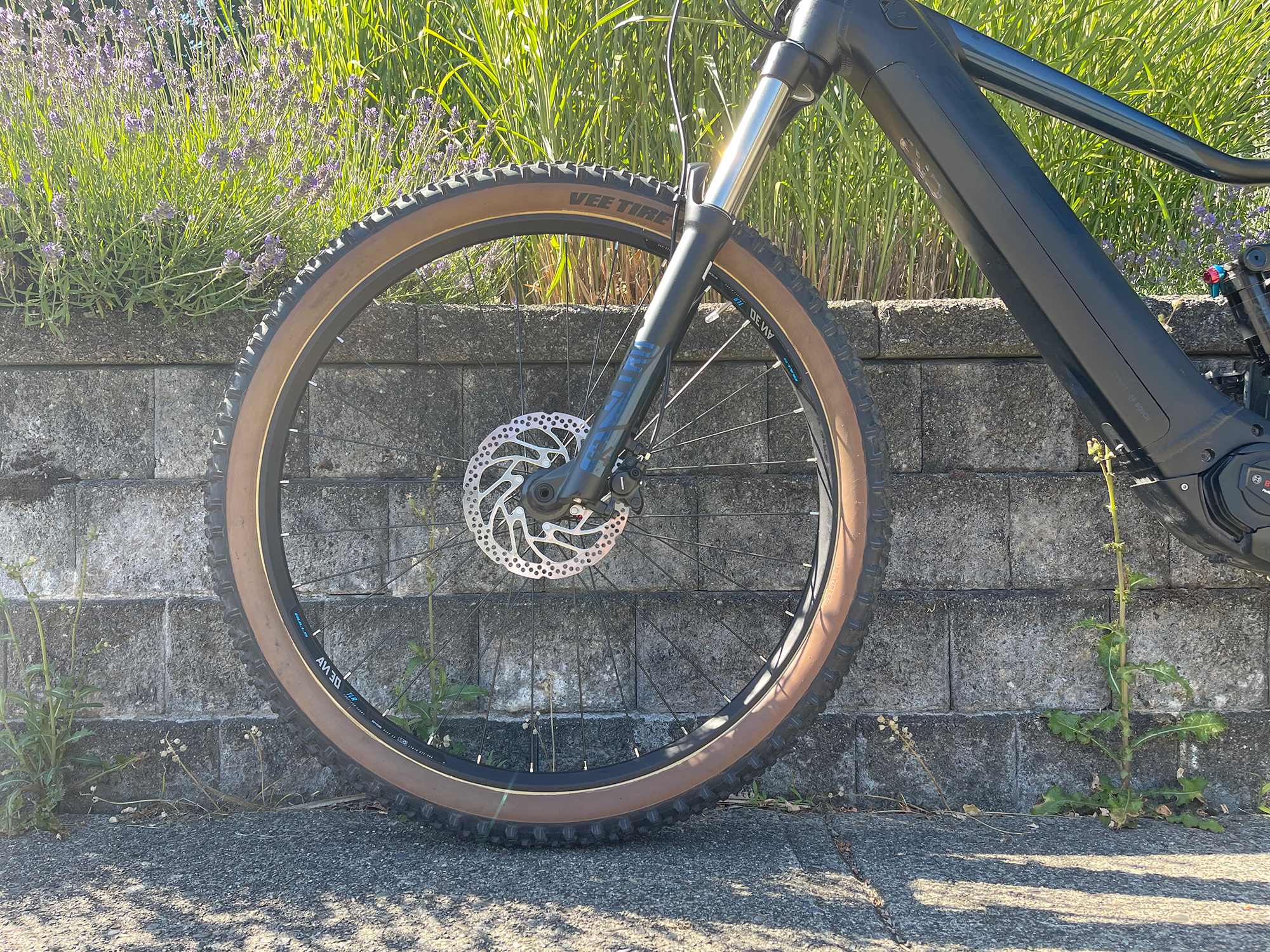

  • Large 203mm hydraulic disc brakes offer a good mechanical advantage for continuous descents and control over the larger 29″ front wheel. The wheels are heavier given the wider 2.6″ plus sized tires. Larger rotors also cool faster.

  • Solid drivetrain with 34 tooth sturdy steel chainring that has a narrow-wide tooth pattern for improved grab. Plastic chain guide ensures you won’t have drops, even on the roughest terrain. The 10-speed 11-46 tooth cassette provides enough range for steep climbs and comfortable pedaling at speed.

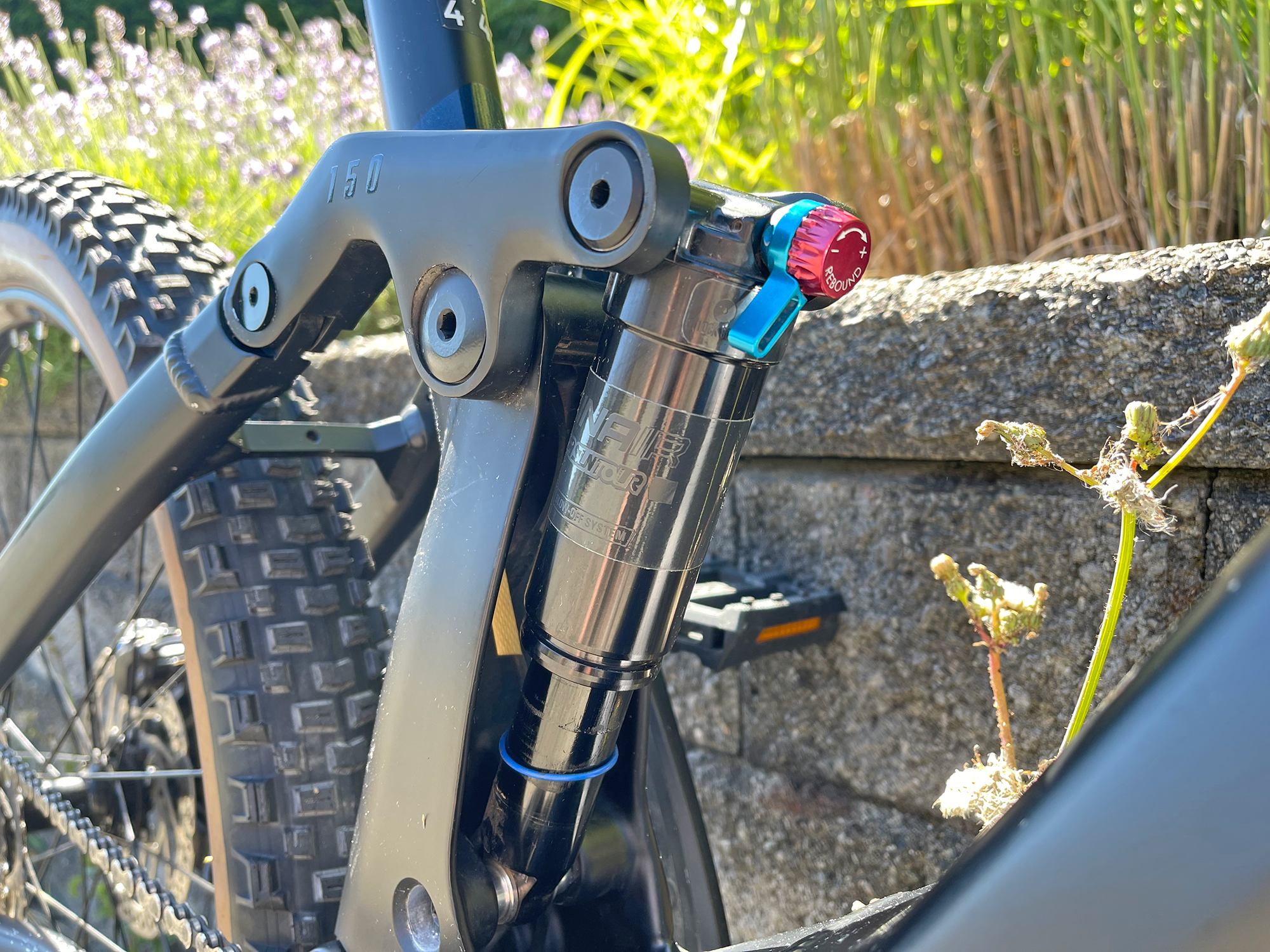

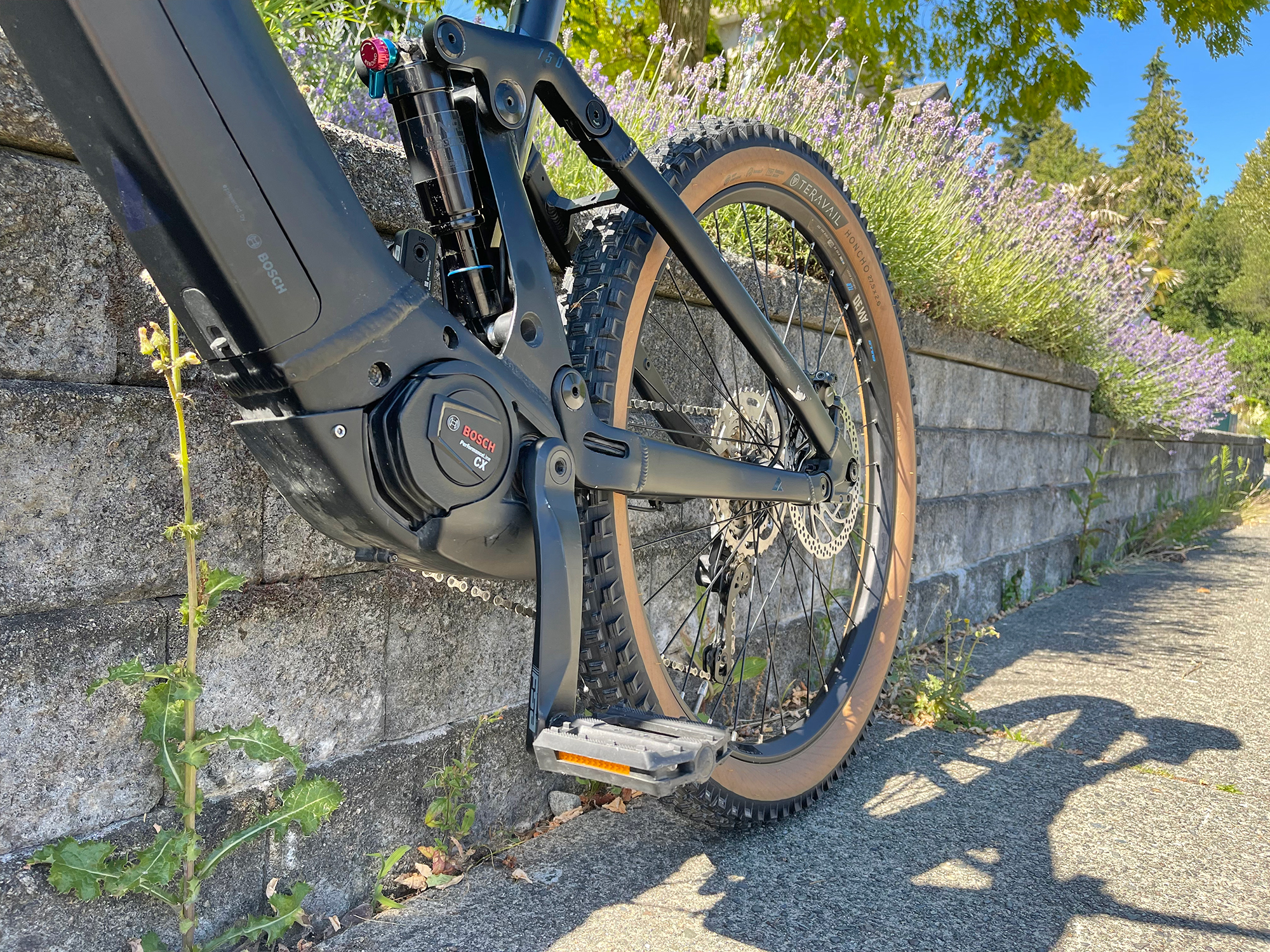

  • Long travel 150mm air suspension with decent SR Suntour shocks. Both offer compression lockout (the rear says 80% lockout) and rebound adjust. They seem less adjustable and smooth to me, but weren’t dialed in perfectly after other demo riders had used them. The tapered steer tube supports a wide range of upgrade options if you wish to go that route someday.
  • I was told that Bulls does not use the official split-pivot rear suspension design but it looks very close and provides the same sort of isolation and vertical travel vs. an arched movement which can change your chain tension and produce kickback… whatever it is, it worked well during my test rides.

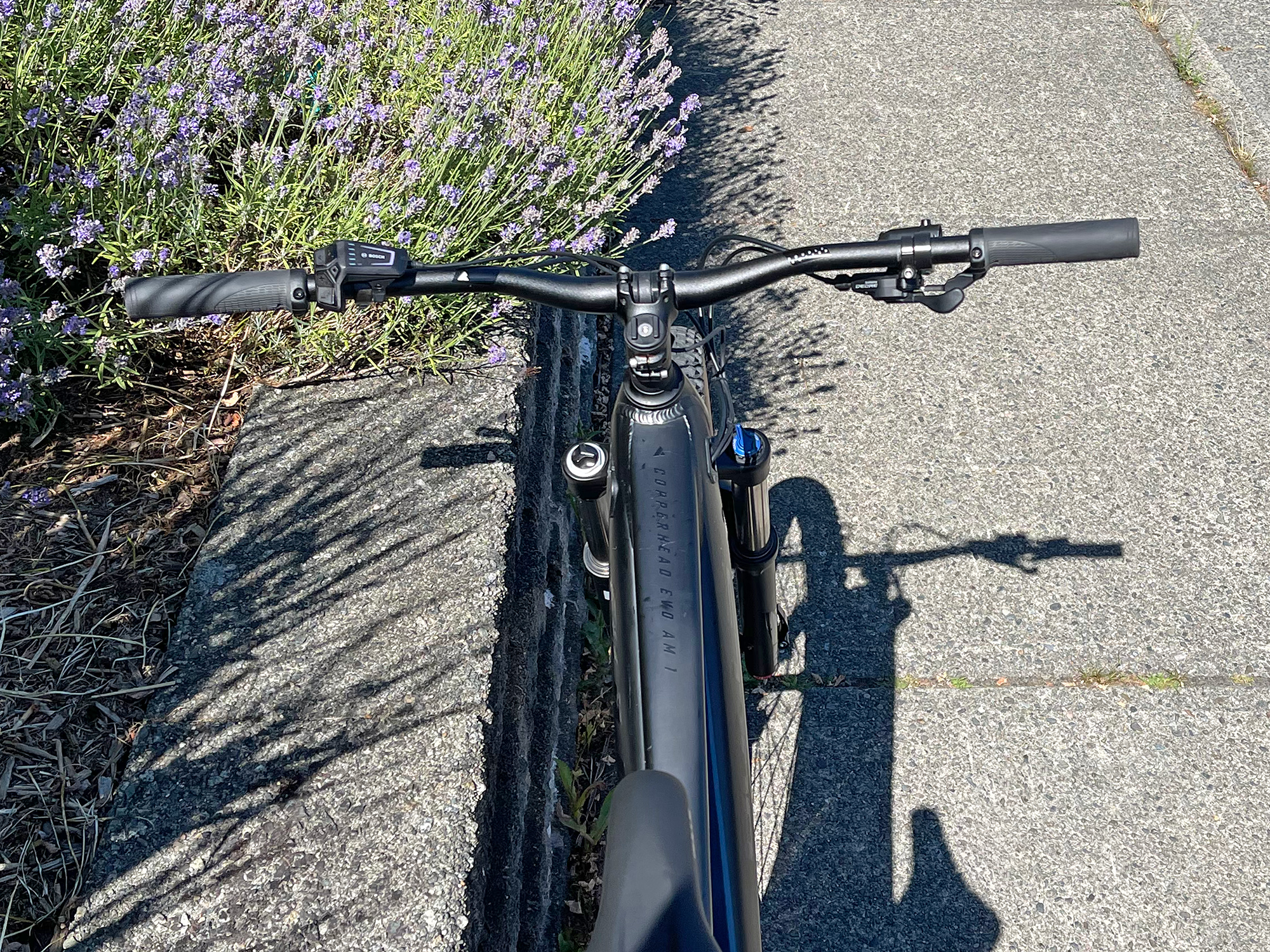

  • Bosch LED remote is easy to reach with your left thumb, the buttons are consistent and satisfying. The 5 LED lights actually communicate 10% charge level increments for more precise readings (blue is 20% chunk and white is 10% chunk). The four assist levels are matched to colors, so you don’t need to read anything, just memorize the colors Green = Eco, Blue = Tour+, Purple = eMTB, Red = Turbo.
  • You could easily wire in the Bosch Kiox 300 LCD display panel for more precise battery readouts, current speed, trip distance, heart rate, range estimate and more… if you are willing to buy and upgrade. The free Bosch Flow smartphone app offers many of the same readouts and lets your phone act as a display in Ride Mode.

  • The Bosch Performance Line CX motor is super smart, measuring rear wheel speed, pedal cadence, and pedal torque over 1,000 per second! It’s extremely responsive and quick, is quieter than I remember, doesn’t weigh a lot at just 6.4lbs because of the magnesium housing, and supports over 120 RPM pedal cadence. That means you don’t have to adjust your pedaling or ride style to the bike, it adapts to you… and even provided shift detection to reduce wear on the chain and sprockets.
  • BULLS has integrated the magnet for measuring rear wheel speed into the disc brake rotor mount, so your wheel can stay more balanced! Spokes won’t get loose, and the magnet itself won’t get spun out of place or dirty as easily… which results in fewer read errors.

  • The suspension shocks offer less refined compression adjustment, it’s more like open and 80% locked out. I felt that the fork was a little stiff vs. plush and smooth, even after removing some air pressure. It’s heavier than a fancier fork with aluminum alloy stanchions.
  • The battery cover seated well and provides good protection from dust and water, but it doesn’t lock to the frame. I feel that it could be easier to lose or have taken off, but at least it’s probably affordable and easy to replace because it’s just black plastic… and it’s not as heavy as a metal shield that some other ebikes use.
  • I wish that the USB-C port on the Bosch LED remote was active for charging smartphones and other devices, especially since the Bosch Flow app has a ride mode that shows realtime stats and mapping. The bike has such a high capacity battery, and I love that it can run lights using the MonkeyLink interfaces… just wish it could do the same for other accessories.
  • If you aren’t using a smartphone as a display, the readouts on the Bosch LED remote are a bit limited. You get a battery charge level percentage with 10% steps (blue blocks represent 20% and white blocks represent 10%). Four colors communicate assist level… but there’s no current speed, min or max speed, range, cadence etc. that you could get from the Bosch Kiox 300 (which is sold separately).

  • I didn’t see a slap guard on the right chain stay, and I did see a lot of chips from the chain bouncing around and making contact with the frame. Consider using some clear box tape, or purchasing an aftermarket slap guard made from neoprene or rubber to keep things looking nice. The derailleur does have a clutch lever that can tighten the spring that helps reduce bounce and drops, so make sure it’s activated.

  • This is a minor thing, but the chainring doesn’t cycle backwards when you backpedal, this changes how drivetrain service is done… you basically need a bike maintenance stand or a friend to lift the bike and pedal to clean and lubricate the chain. One positive note here, is that Bosch has setup the bottom bracket with some resistance so the cranks won’t spin as freely backwards, which could lead to more shin scrapes and shin bumps if your foot slips off when pedaling.
  • Be careful when lifting and transporting the PowerTube battery because it does not have an integrated handle like the PowerPack mid-frame and rear-rack models. I do appreciate how it clicks down one step when unlocking, before completely coming off the bike because you are less likely to drop it when removing.
