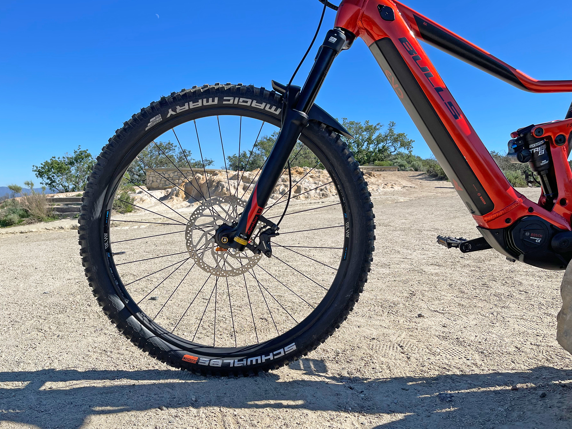

Ryde Disc 30, Double Wall, Aluminum Alloy, ETRTO 622x30c, 30 mm Outer Width, 32 Hole, Tubeless Ready | Hub: Shimano HB-MT400-B
Front: Schwalbe Magic Mary Evo Super Gravity, 29" x 2.6" (66-622) 17 to 38 PSI, 1.2 to 2.6 BAR ADDIX Soft, TL-Easy, EVO Super Gravity, Back: Schwalbe Big Betty Evo, 27.5" x 2.6" (66-584) 45 PSI, 3.0 BAR, ADDIX Soft, TL-Easy, EVO, Tubeless Ready

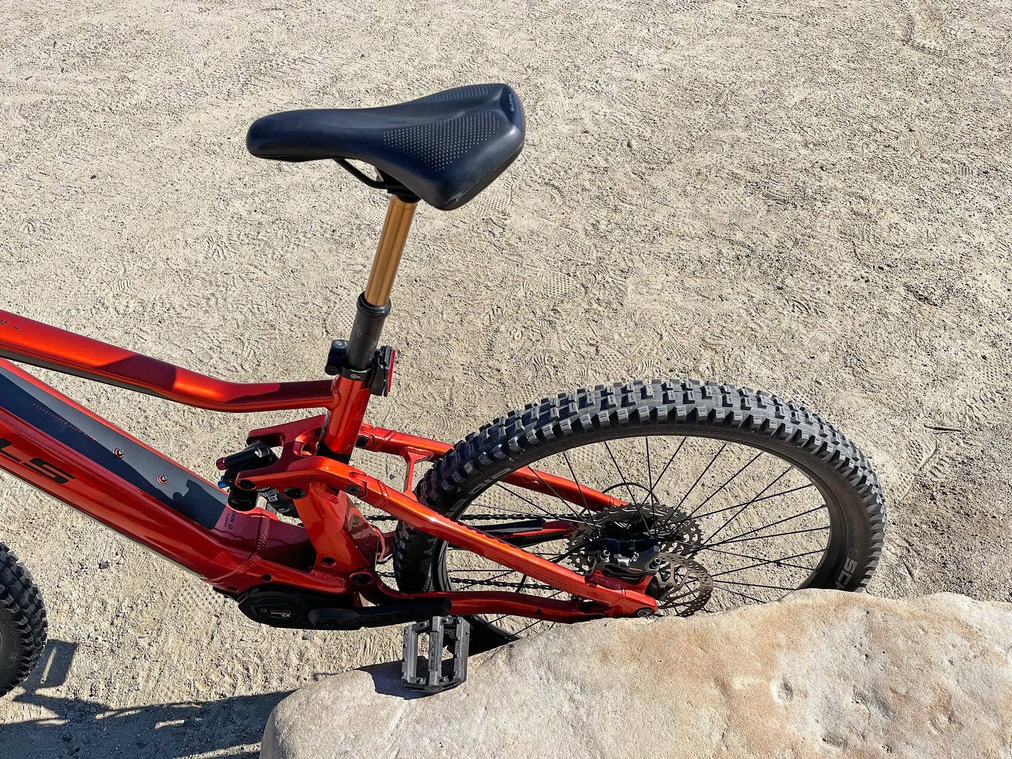

Limotech Alpha 1 Dropper (100 mm or 125 mm or 150 mm Travel)

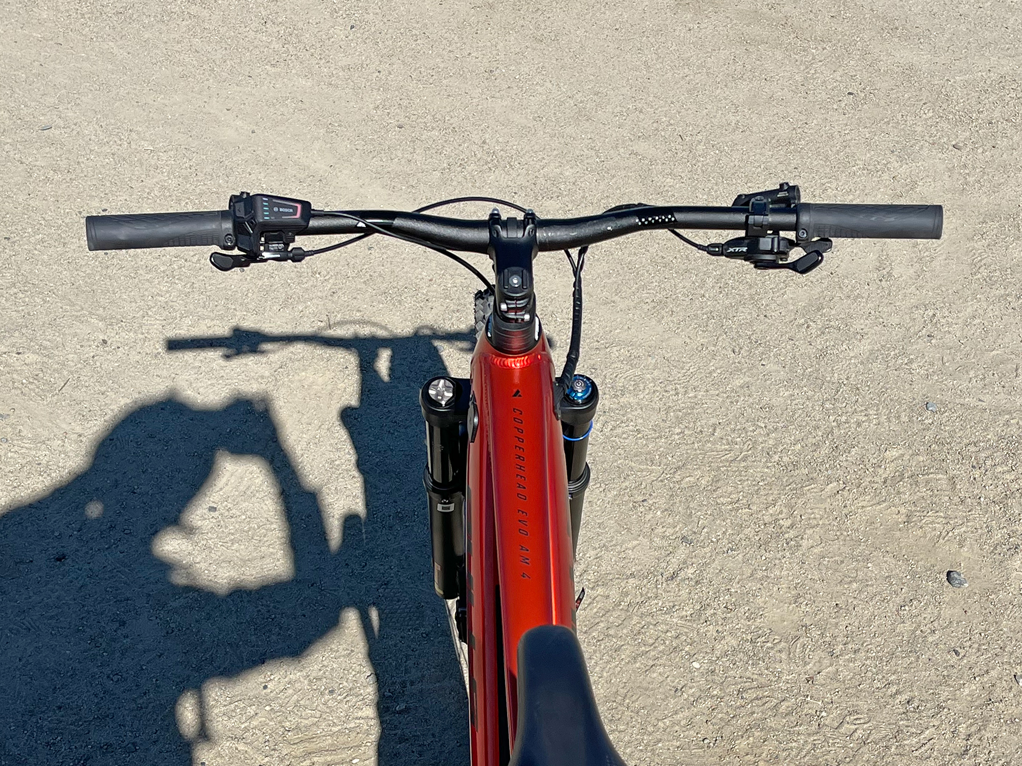

Bosch LED Remote, Buttons: Power, Left/Right, +, -, Select, Lights if Available: Hold + Button, Walk Mode: Hold - Button

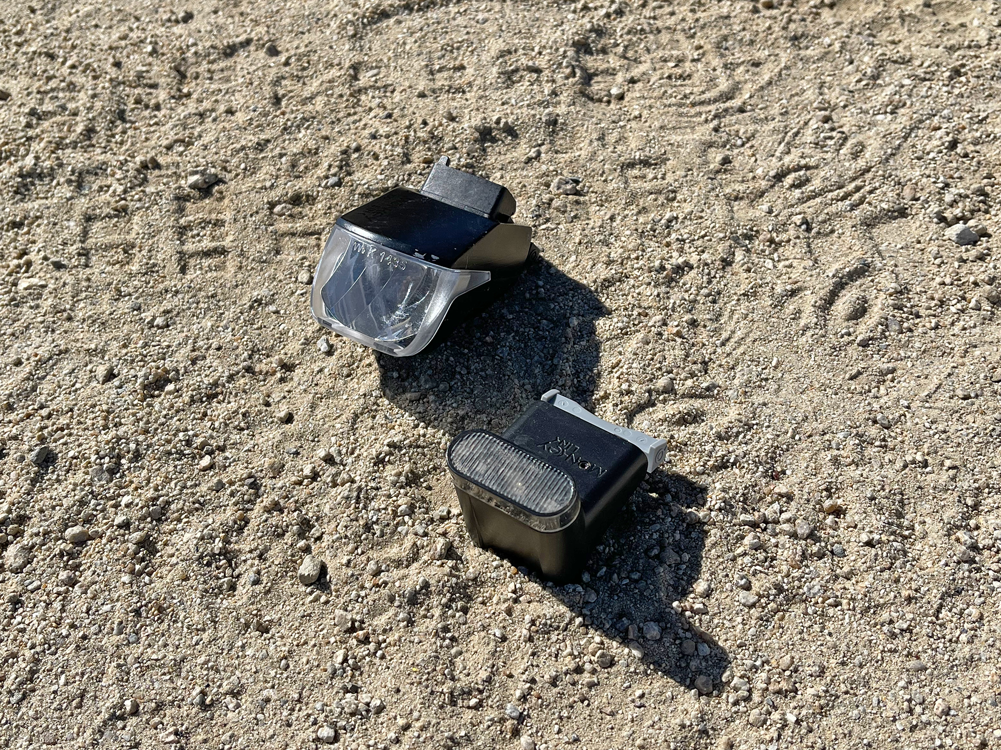

Bottle Cage Mount on Downtube, MonkeyLink Bracket on Stem and Seat Collar for Lights or Fender
Plastic Slap Guard, SP Connect Stem Cap Phone Mount, MonkeyLink Magnetic Reflectors, Plastic Mudguard on Fork Arch, Optional MonkeyLink Front and Rear Lights and Fender (Magnetic Connection, Lights Powered by Ebike Battery), Optional Bosch Kiox 300 Color LCD Display Panel

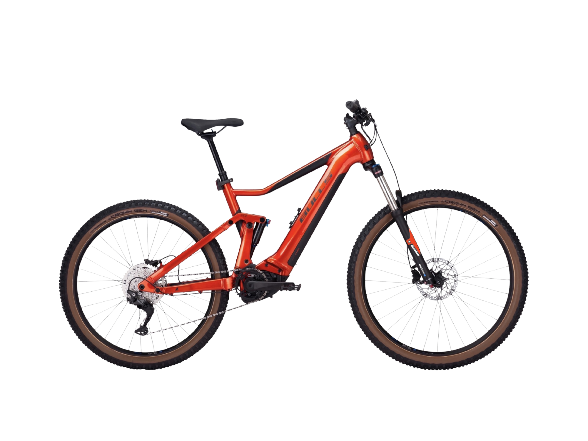

This review was provided for free using a demo bike. My goal is to be transparent and unbiased with you, this video and writeup are not meant to be an endorsement of BULLS products. I welcome your corrections, additions, and feedback in the comments below, and the BULLS electric bike forums.
Observations:

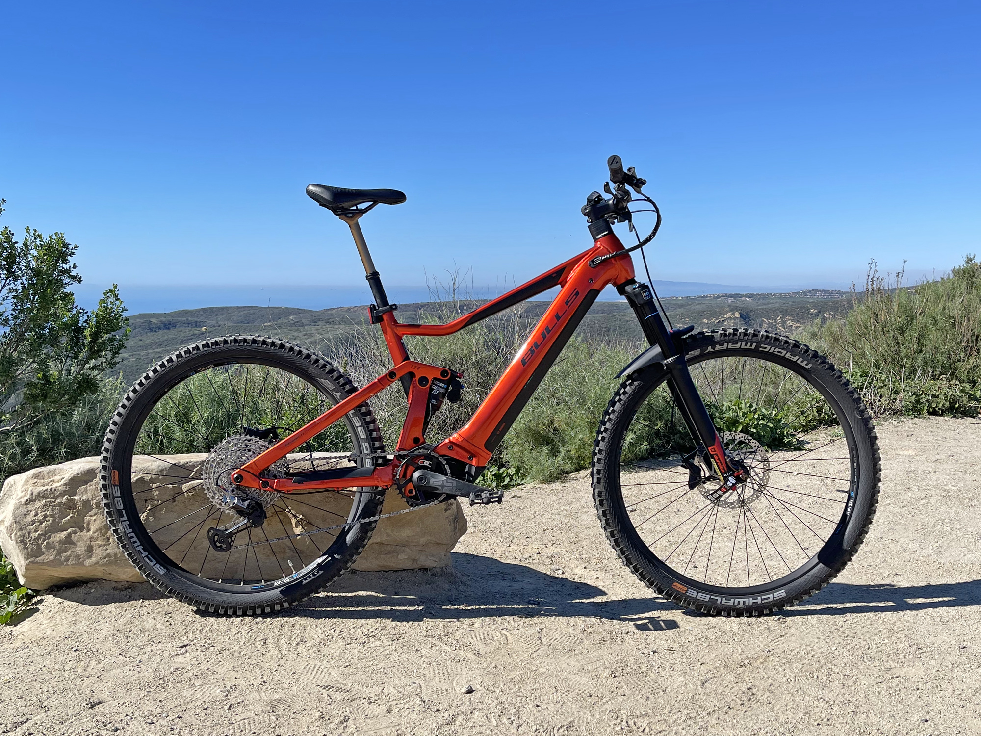

  • The bike is purpose built with good weight distribution, although it is fairly heavy due to the high capacity battery pack, long travel suspension, and plus sized tires. It comes in four frame sizes, one color scheme, and is generally sold through dealers.
  • The wheels and tires are different sizes, the front is larger than the rear. This is called a mullet, named after the hair style, because the larger wheel in the front handles the “business” of drops and large obstacles while the rear offers a “party” being more playful and quicker. You get a lower attack angle up front, raised bottom bracket, and sturdier rear wheel. Steering is a bit slower and smoother than if both wheels were 27.5″ vs. the front being 29″ so you can take on obstacles vs. steering around them.
  • Boost hub spacing means wider hubs that improve spoke bracing angle. Both wheels attach with sturdy thru-axles, 15mm in the front and 12mm in the rear. The tires are 2.6″ wide which is the narrowest “plus” size, offering improved stability, float, and overall forgiveness… supporting the “go over and off vs. around” capabilities of the bike.

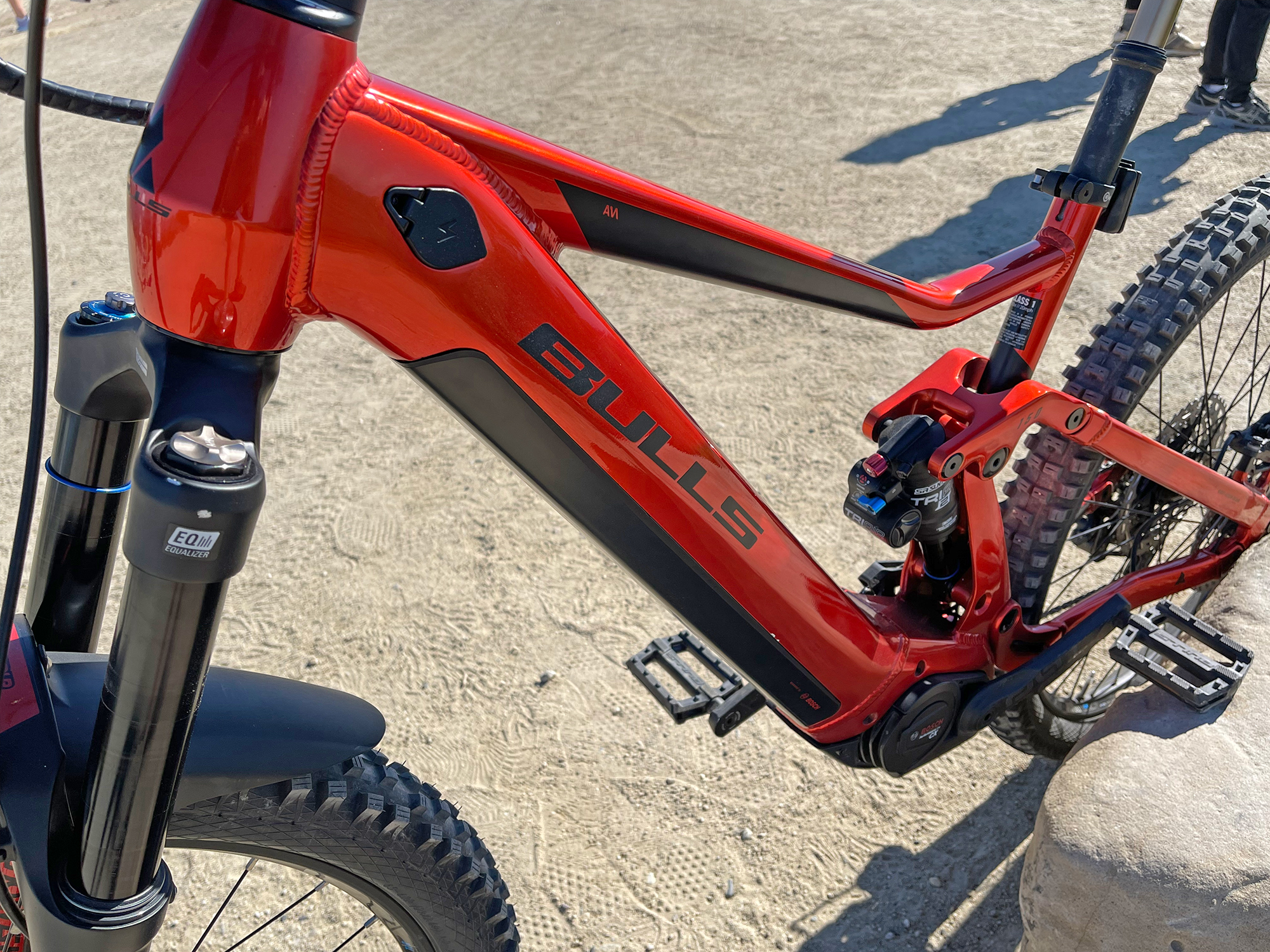

  • Purpose built frame with internally routed cables, sloped top tube for safer dismounts, drive system weight is kept low and center, the battery is completely hidden and well protected.

  • There are two magnetic light mounts with MonkeyLink interface, so you can add a headlight and a rear light or fender with light that will run off of the main rechargeable battery pack. The headlight is very nice with a flattened beam that won’t shine up into oncoming traffic and offers adjustable angle for aiming.
  • The battery pack locks into the frame using an ABUS locking core with XPLUS Code keys that can be matched to ABUS locks (like folding locks, u-locks, and frame locks), so you don’t need multiple keys! They seem to be high quality locks in general that would be more more difficult to defeat. The Bosch eBike Flow smartphone app also has a disable feature, where the bike won’t operate unless the smartphone enters the geofence around the bike.

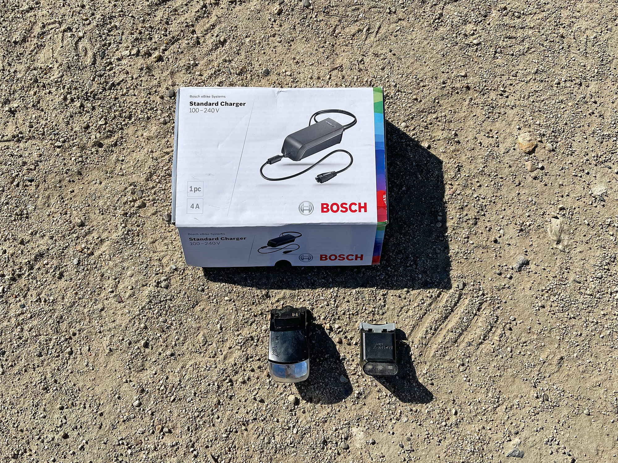

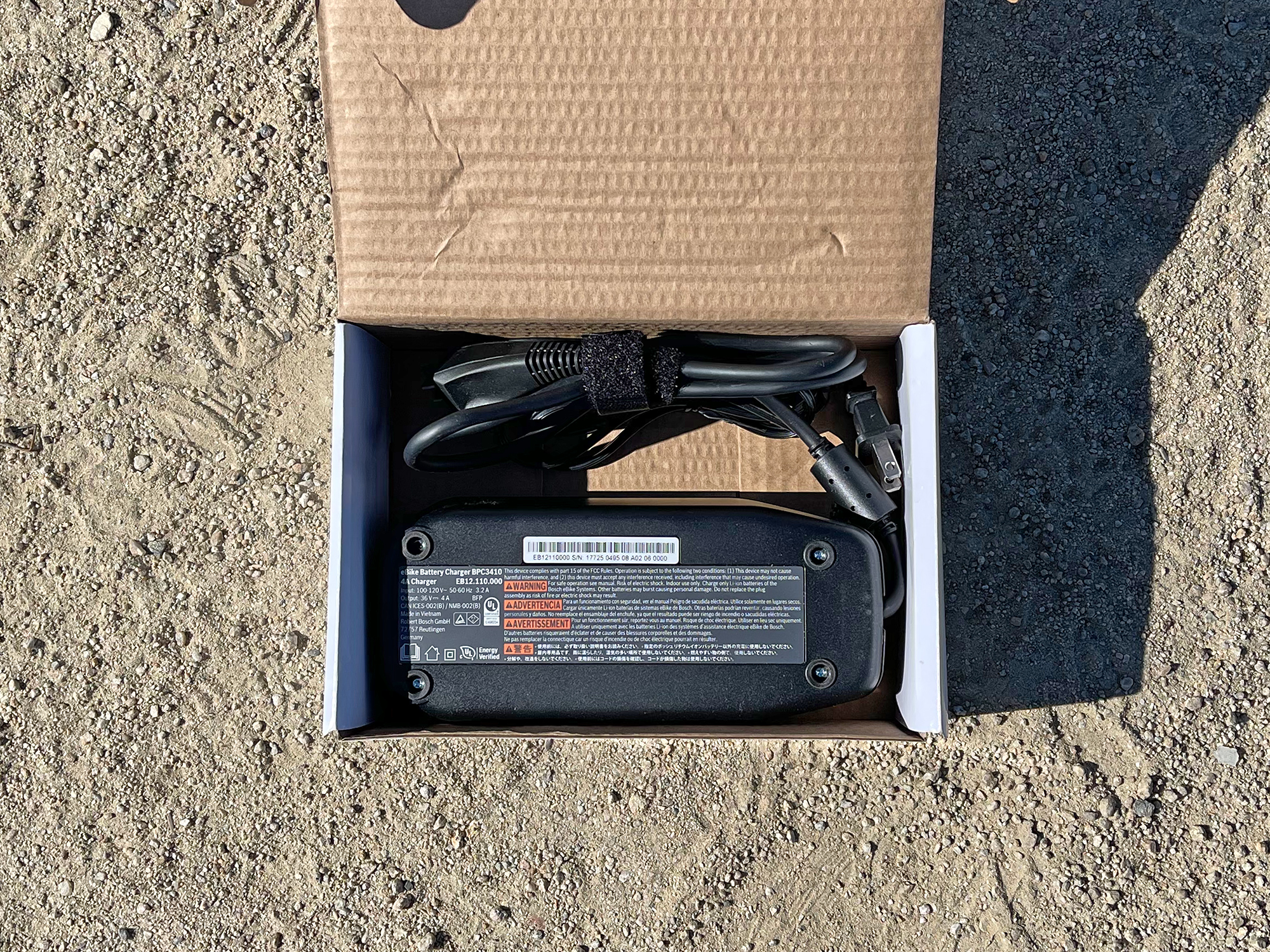

  • Outstanding battery charger that’s relatively light weight at 1.6lbs, compact with removable wall-side plug, and puts out 36 volt 4 amps verses just 2 amps on many competing chargers. It has a sturdy plug design that works with the battery as well as the plug port on the bike.

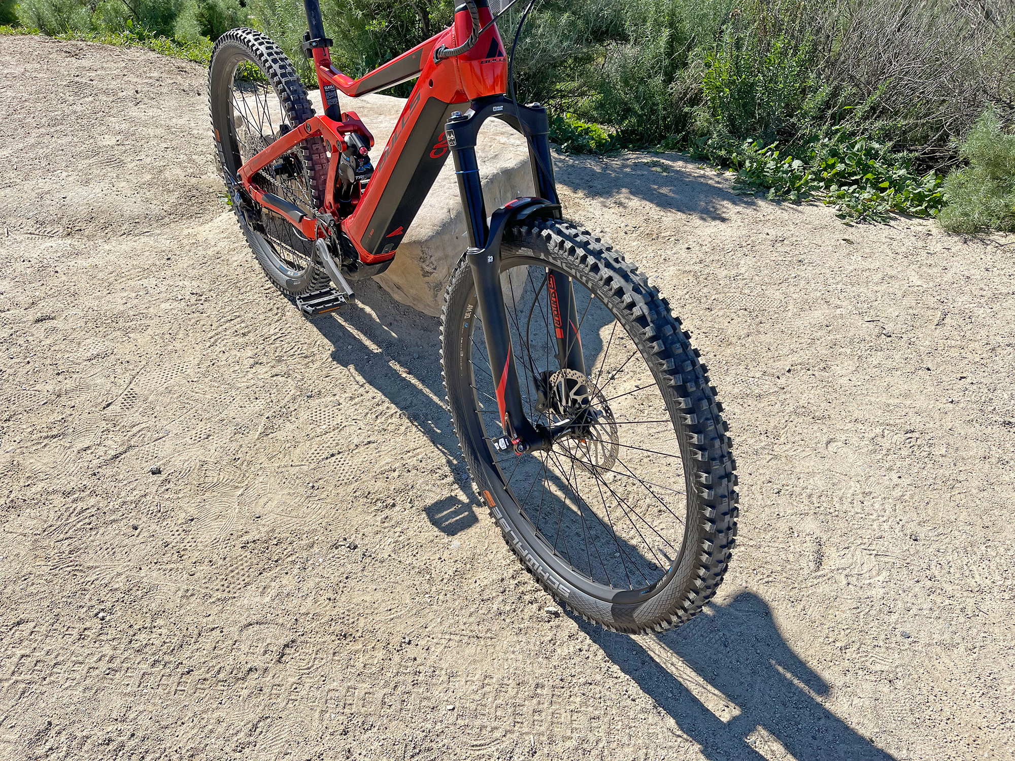

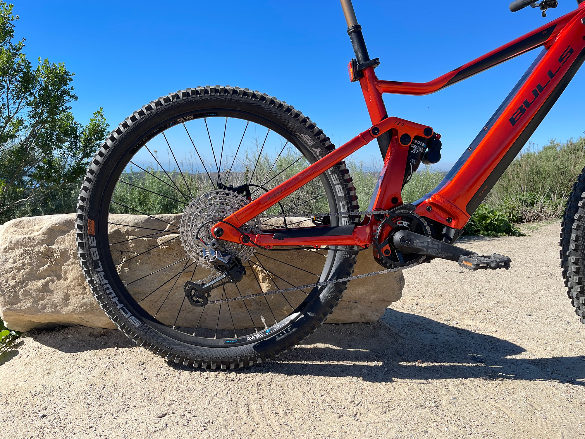

  • This is a rare setup, stock mullet with 29″ wheel in the front and 27.5″ wheel in the back. They configured the geometry, so you don’t have to convert a 27.5″ setup with a new fork. This configuration blends stability and confidence where the front wheel rolls over obstacles easily and the rear wheel is lighter, quicker, and more nimble.
  • Another benefit of the mullet setup is higher bottom bracket clearance because of the taller front wheel, BULLS accentuates this by stocking shorter 165mm crank arms vs. 170mm to reduce pedal strikes.
  • Tire tread is different for each wheel, the front tire has more space between knobs to improve steering grab while the rear is tighter for improved traction during acceleration. The plus sized 2.6″ width improves stability, float, and comfort with a good range of PSI options. Rims and tires are tubeless ready to run at lower pressure and save some weight. I believe the rubber material used for the tires is the softest that ADDIX makes.
  • Large 203mm hydraulic disc brakes offer a good mechanical advantage for continuous descents and control over the larger 29″ front wheel. The wheels are heavier given the wider 2.6″ plus sized tires. Larger rotors also cool faster, and the front caliper uses quad piston with a larger brake pad surface.

  • Limoteq dropper seat post offers different travel depending on frame size. The adjustments are infinite, meaning you can dial it in more precisely vs. the older stepped dropper designs.

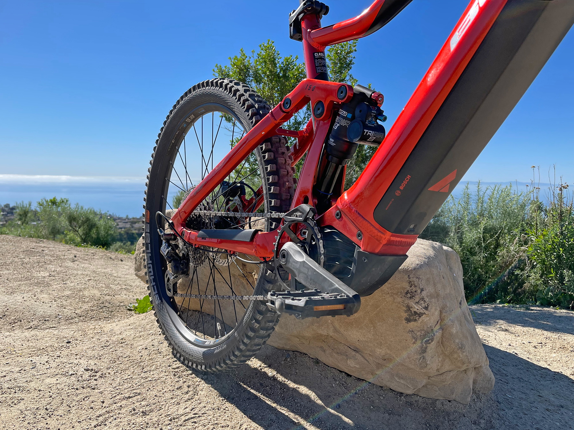

  • Solid drivetrain with 34 tooth sturdy steel chainring that has a narrow-wide tooth pattern for improved grab. Plastic chain guide ensures you won’t have drops, and it should clear some debris and mud as well. The 12-speed 10-51 tooth cassette provides excellent range for steep climbs and comfortable pedaling at speed during descents. I love the Shimano derailleurs with the locking clutch mechanism to reduce chain bounce, and appreciate the heavy duty rubber slap guard that will protect the fancy paint here.

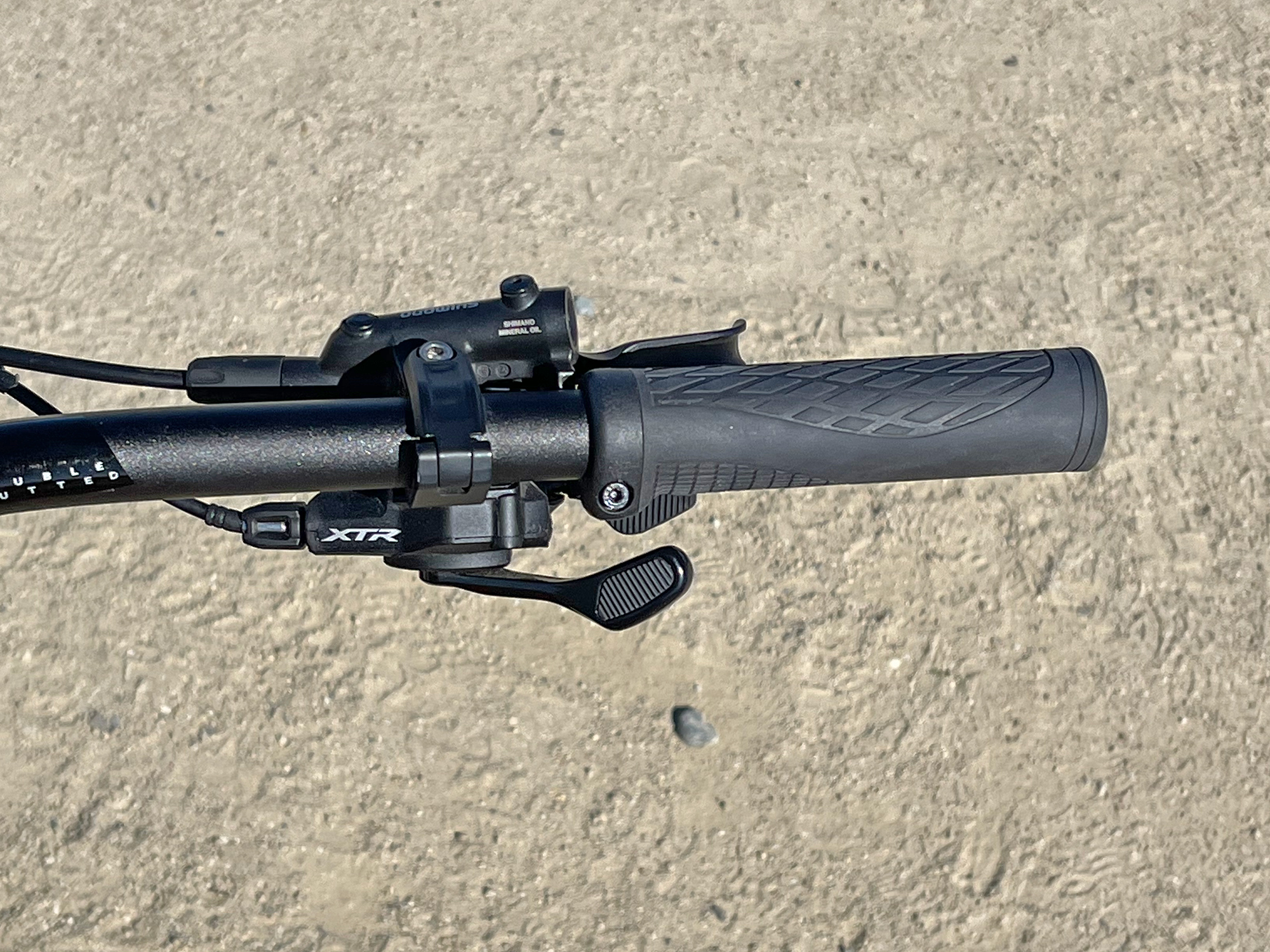

  • The Shimano XTR trigger shifter allows you to shift down four steps at once using the long lever. The short lever can be actuated by pushing or pulling. It’s an excellent interface that is sturdy and comfortable.

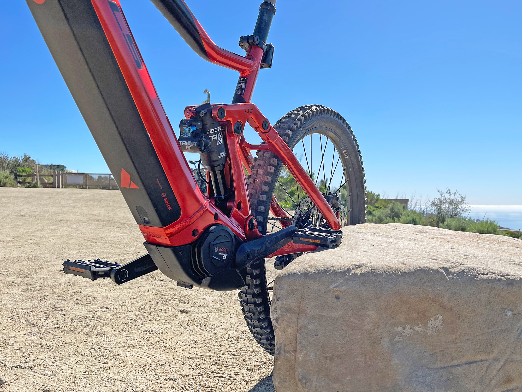

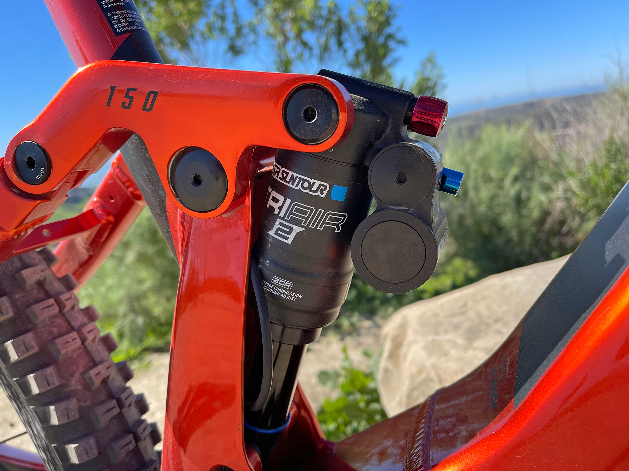

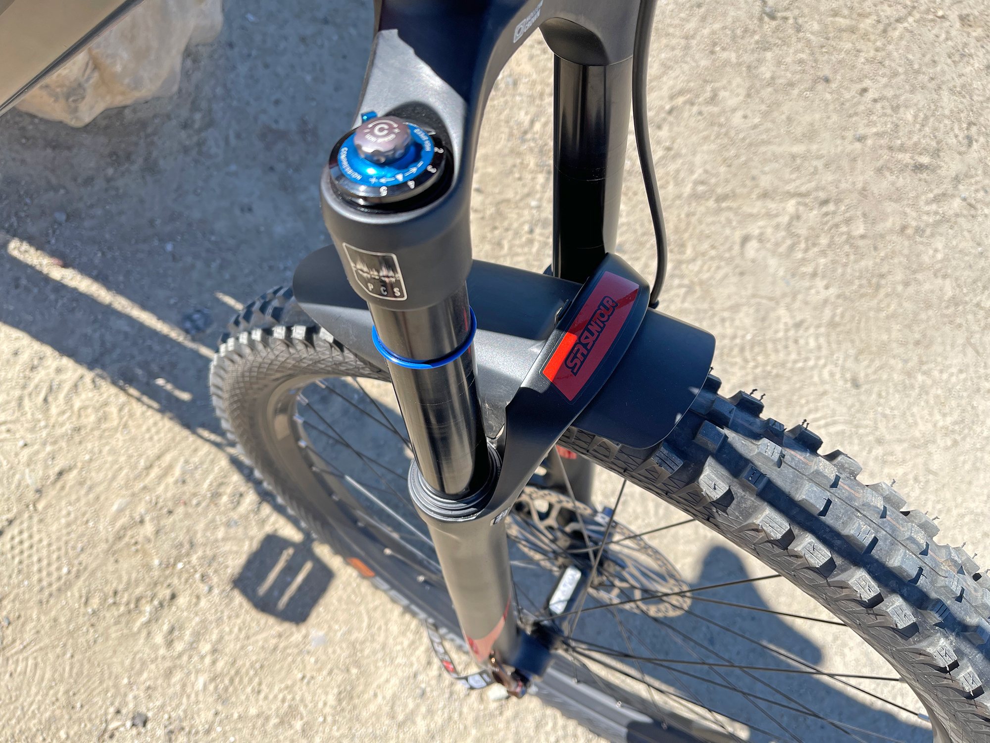

  • Long travel 150mm air suspension with top shelf SR Suntour shocks front and rear. Both offer rebound and compression adjust; the front has low and high speed compression dials! The tapered steer tube supports a wide range of upgrade options if you wish to change hardware at any point in the future.
  • I was told that Bulls does not use the official split-pivot rear suspension design, but it looks very close and provides the same sort of isolation and vertical travel vs. an arched movement which can change your chain tension and produce kickback… whatever it is, it worked well during my test rides.

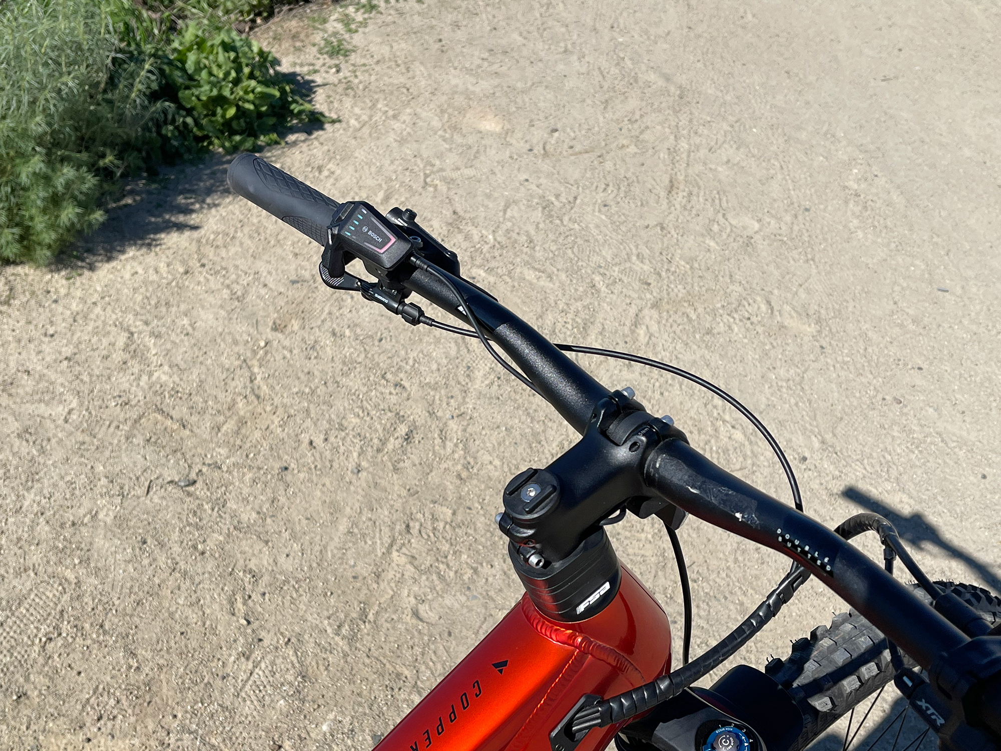

  • Bosch LED remote is easy to reach with your left thumb, the buttons are consistent and satisfying. The 5 LED lights actually communicate 10% charge level increments for more precise readings (blue is 20% chunk and white is 10% chunk). The four assist levels are matched to colors, so you don’t need to read anything, just memorize the colors Green = Eco, Blue = Tour+, Purple = eMTB, Red = Turbo. Eco and Turbo can be adjusted with the app, so their profiles match your ride style, you can even adjust the top speed of the bike from 20mph (32km/h) or below.

  • BULLS has integrated the magnet for measuring rear wheel speed into the disc brake rotor mount, so your wheel can stay more balanced! Spokes won’t get loose, and the magnet itself won’t get spun out of place or dirty as easily… which results in fewer read errors.

  • I wish that the USB-C port on the Bosch LED remote was active for charging smartphones and other devices, especially since the Bosch Flow app has a ride mode that shows realtime stats and mapping. The bike has such a high capacity battery, and I love that it can run lights using the MonkeyLink interfaces… just wish it could do the same for other accessories.
  • If you aren’t using a smartphone as a display, the readouts on the Bosch LED remote are a bit limited. You get a battery charge level percentage with 10% steps (blue blocks represent 20% and white blocks represent 10%). Four colors communicate assist level… but there’s no current speed, min or max speed, range, cadence etc. that you could get from the Bosch Kiox 300 or Kiox 500 (which are sold separately).
