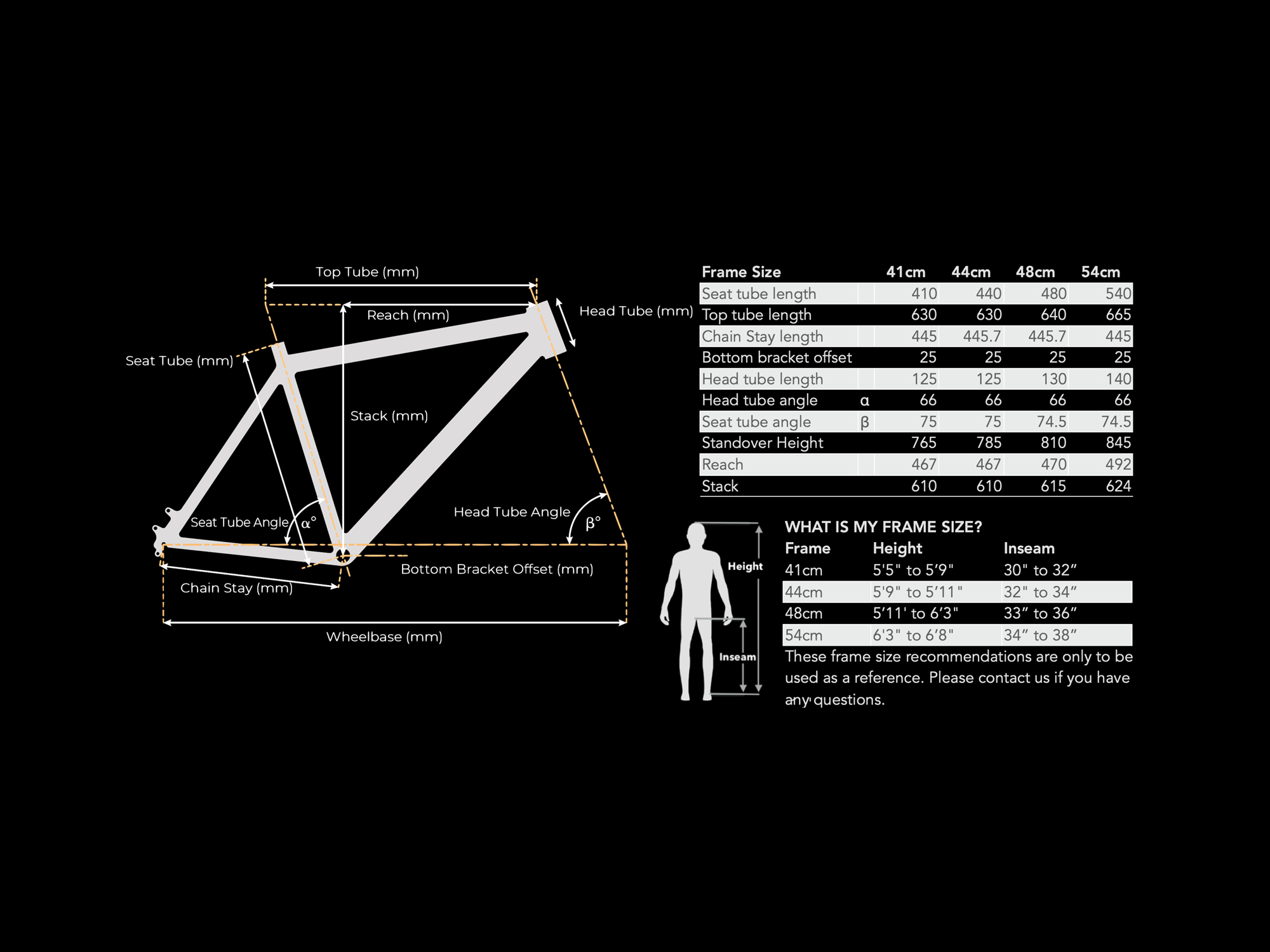

16.14 in (40.99 cm)17.32 in (43.99 cm)18.89 in (47.98 cm)21.25 in (53.97 cm)
Medium 44cm: 17.5" Seat Tube, 23.5" Top Tube, 18.5" Reach, 28.5" Stand Over Height, 34" Minimum Saddle Height, 30" Width, 48" Wheelbase, 77" Length

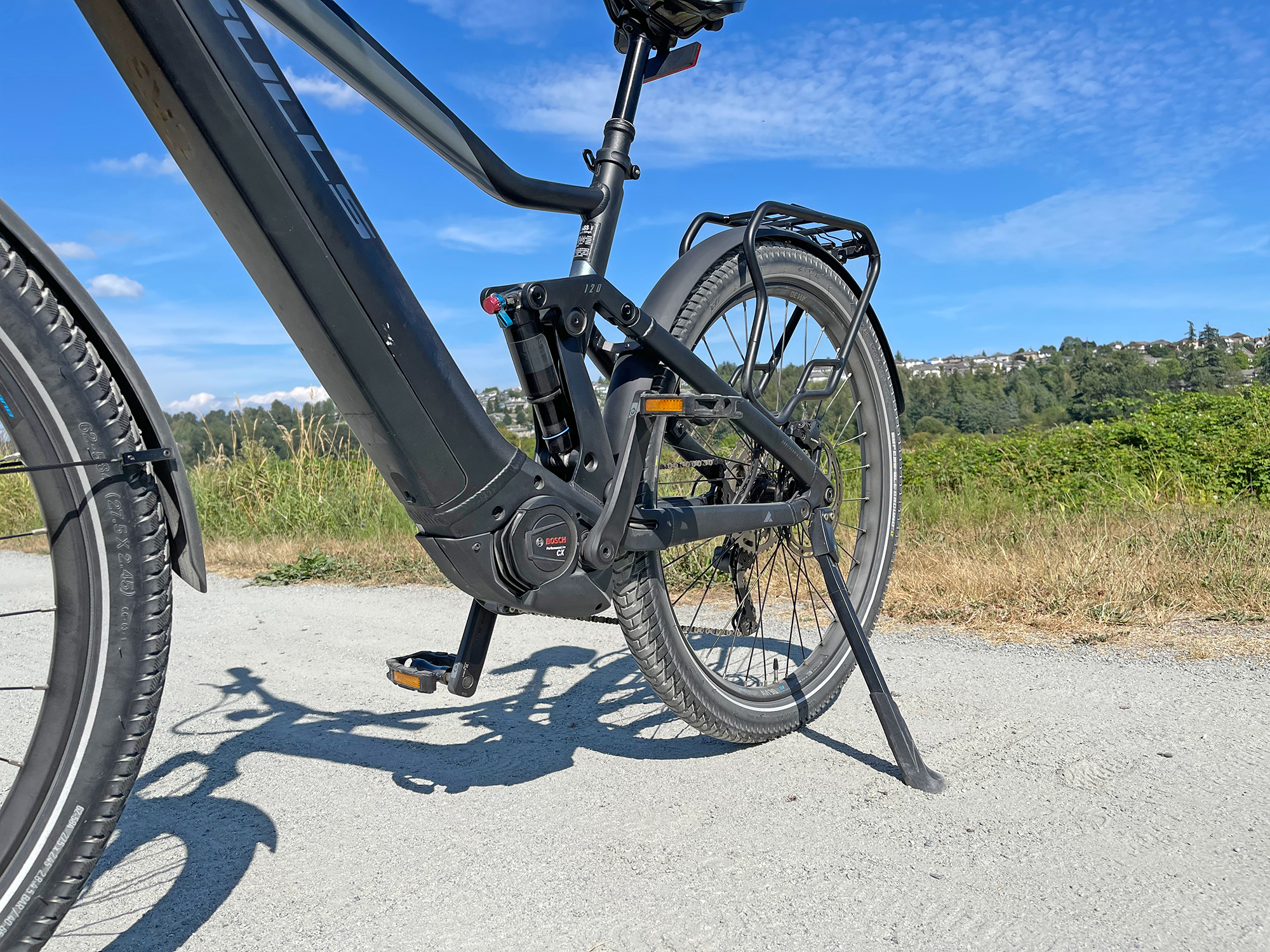

  • The bike is purpose built with good weight distribution. It’s rare to see a full suspension urban model complete with fenders, rear rack, and integrated lights. Like many other BULLS models, it comes in four frame sizes, one color scheme, and is generally sold through dealers.
  • Boost hub spacing means the spoke bracing angle is sturdier, and thru-axles improve stiffness and overall strength. The tires are 2.45″ wide which is wider than average, offering improved stability, traction, and float. While the tires did not appear to have puncture protection lining, they are e-bike rated to 50km/h high speeds, and the tread was thick and appeared to be durable.

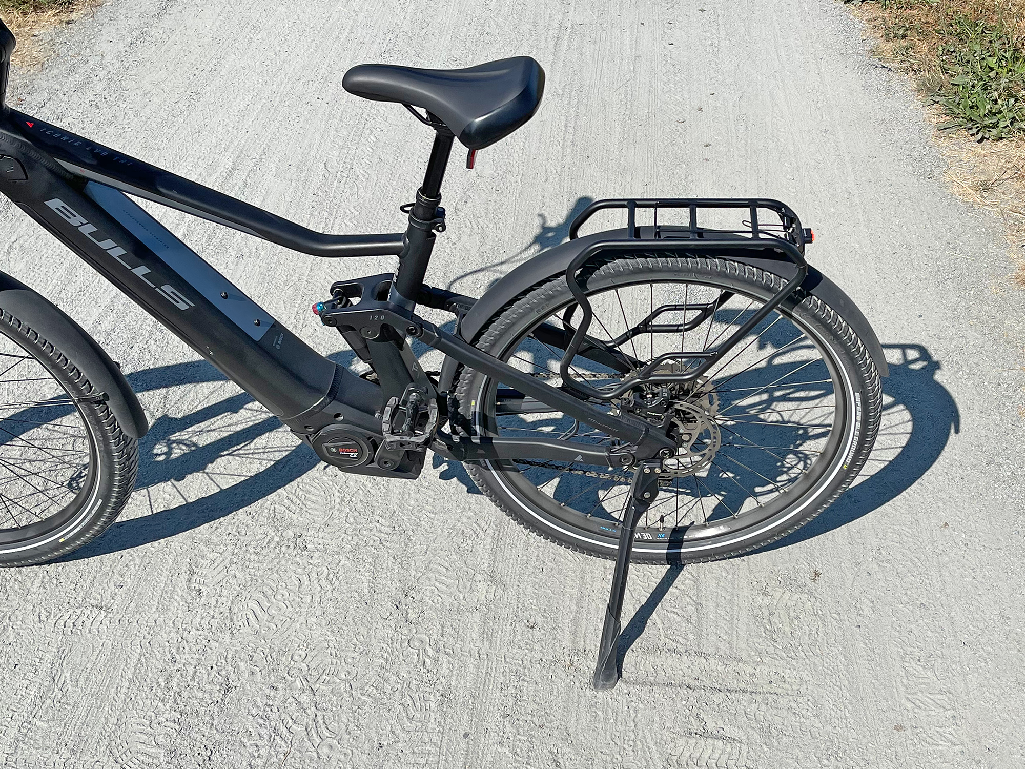

  • Feature complete electric bike including everything you’d need for adventure touring or daily commuting. The platform includes sturdy matching fenders, a custom rear rack, an adjustable kickstand, and premium integrated lights.

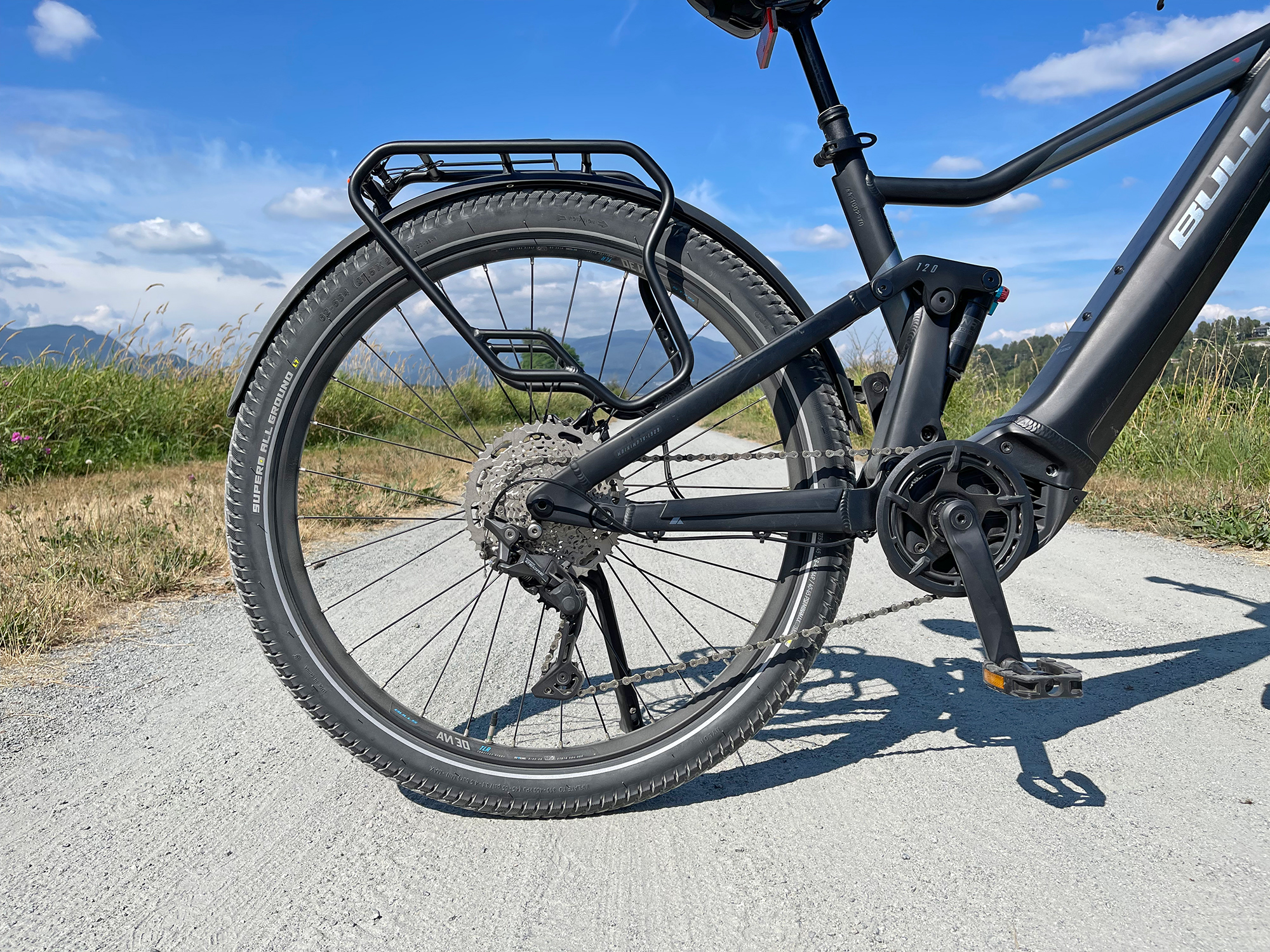

  • The fenders and rear rack are aluminum alloy, so they won’t rust like steel if scratched. They actually connect in three places for improved strength. I appreciate the spring latch, bungee loops, and positioning of the rack (it’s clear of the saddle so you can use trunk bags on top without making contact or impairing the dropper movement).

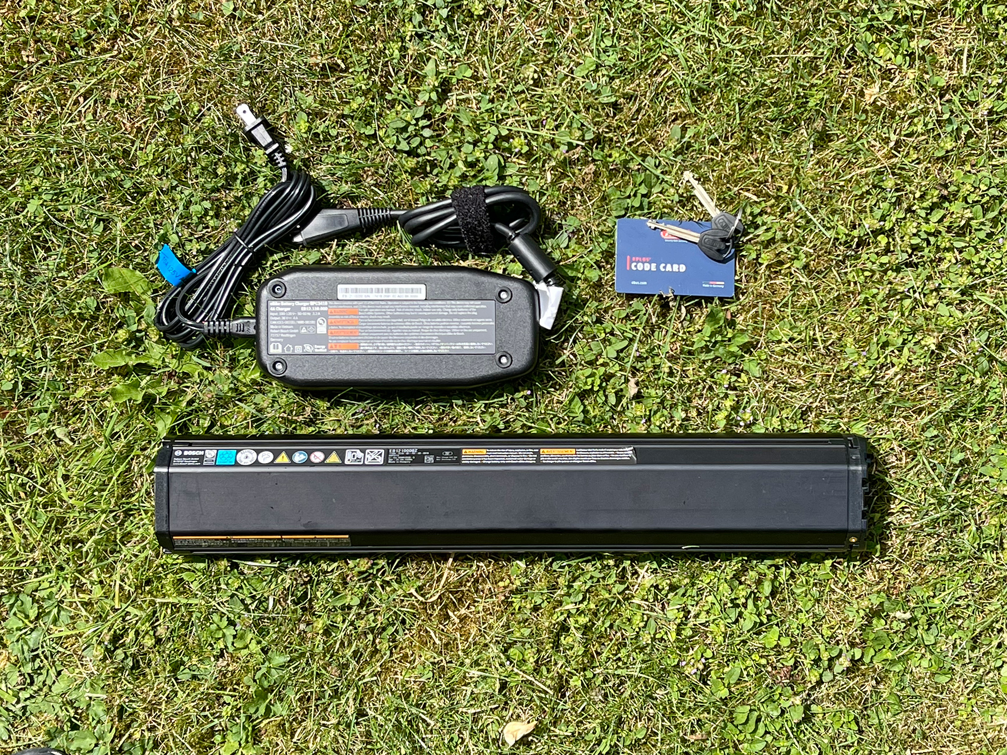

  • The battery pack locks into the frame using an ABUS locking core with XPLUS Code keys that can be matched to ABUS locks (like folding locks, u-locks, and frame locks), so you don’t need multiple keys! They seem to be high quality locks in general that would be more more difficult to defeat.
  • Outstanding battery charger that’s relatively light weight at 1.6lbs, compact with removable wall-side plug, and puts out 36 volt 4 amps vs. just 2 amps on many competing chargers. It has a sturdy plug design that connects directly to the battery as well as the plug port on the bike.
  • The battery offers extremely high charge capacity, 36 volts and 20.1 amp hours for roughly 750 watt hours of capacity. That means you can use higher assist levels without range anxiety, and just go farther in general.

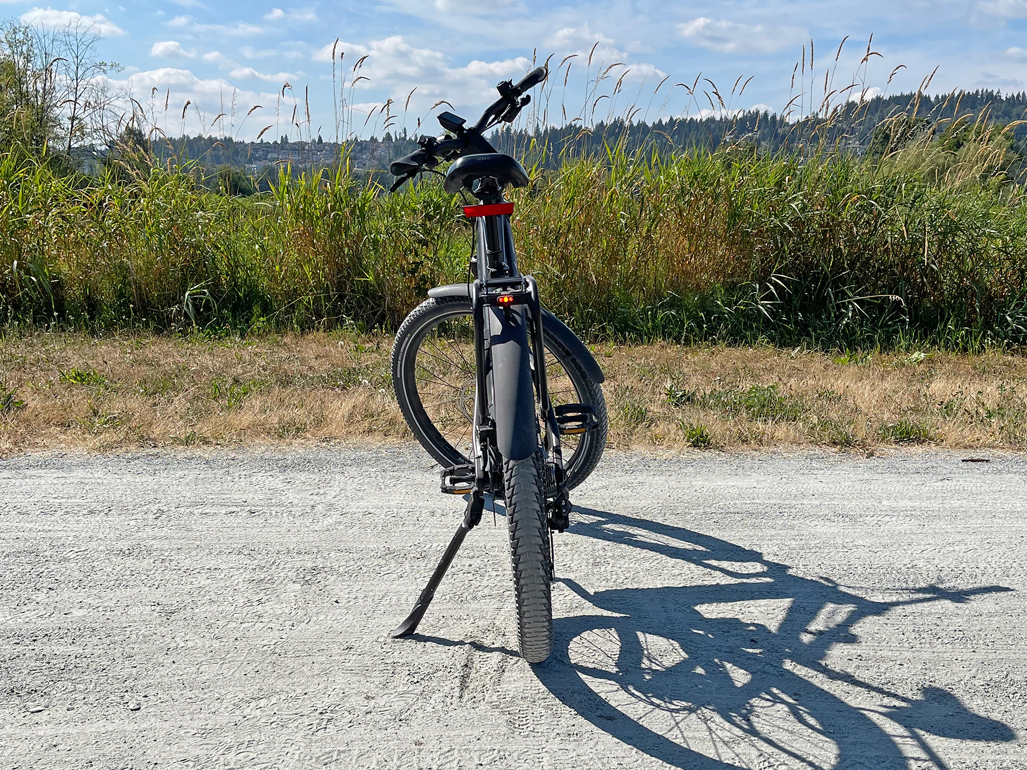

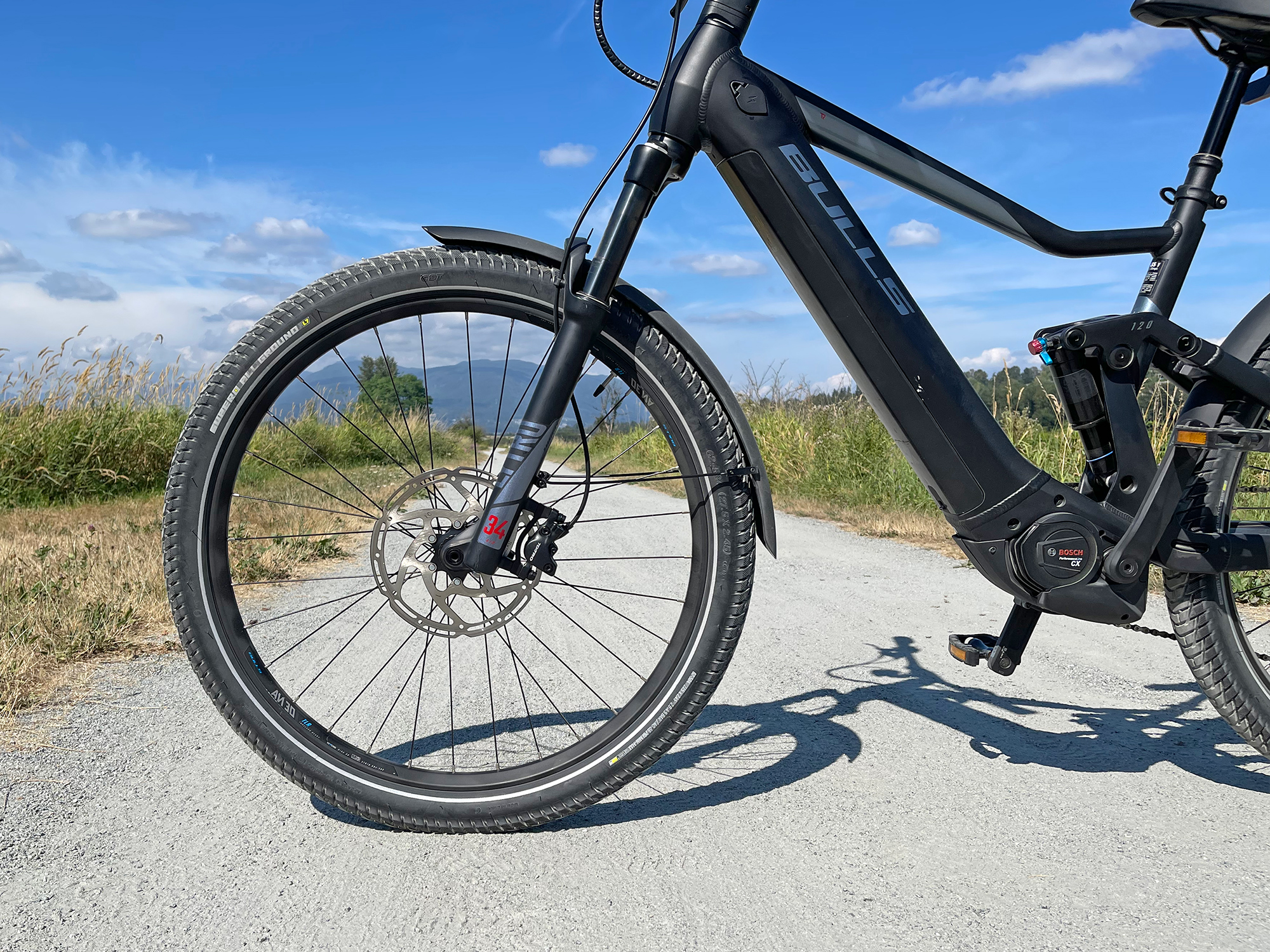

  • Excellent positioning for the headlight, it’s high up and points where you steer, and has side cutouts so you’re visible from more angles! The light beam that comes out the front is rated at 100 LUX and has a flat top so it won’t shine up into the eyes of oncoming traffic.
  • I also appreciate the reflective sidewalls on the tires here, especially since the frame and other hardware are all black, this keeps you visible from the side and really enhances your visual footprint.

  • Sturdy 120mm air suspension with lockout, rebound adjust, and thicker 34mm stanchions up front. The stanchions are steel vs. anodized aluminum alloy that would be lighter, but the action was smooth and satisfying during my ride tests (both front and rear).

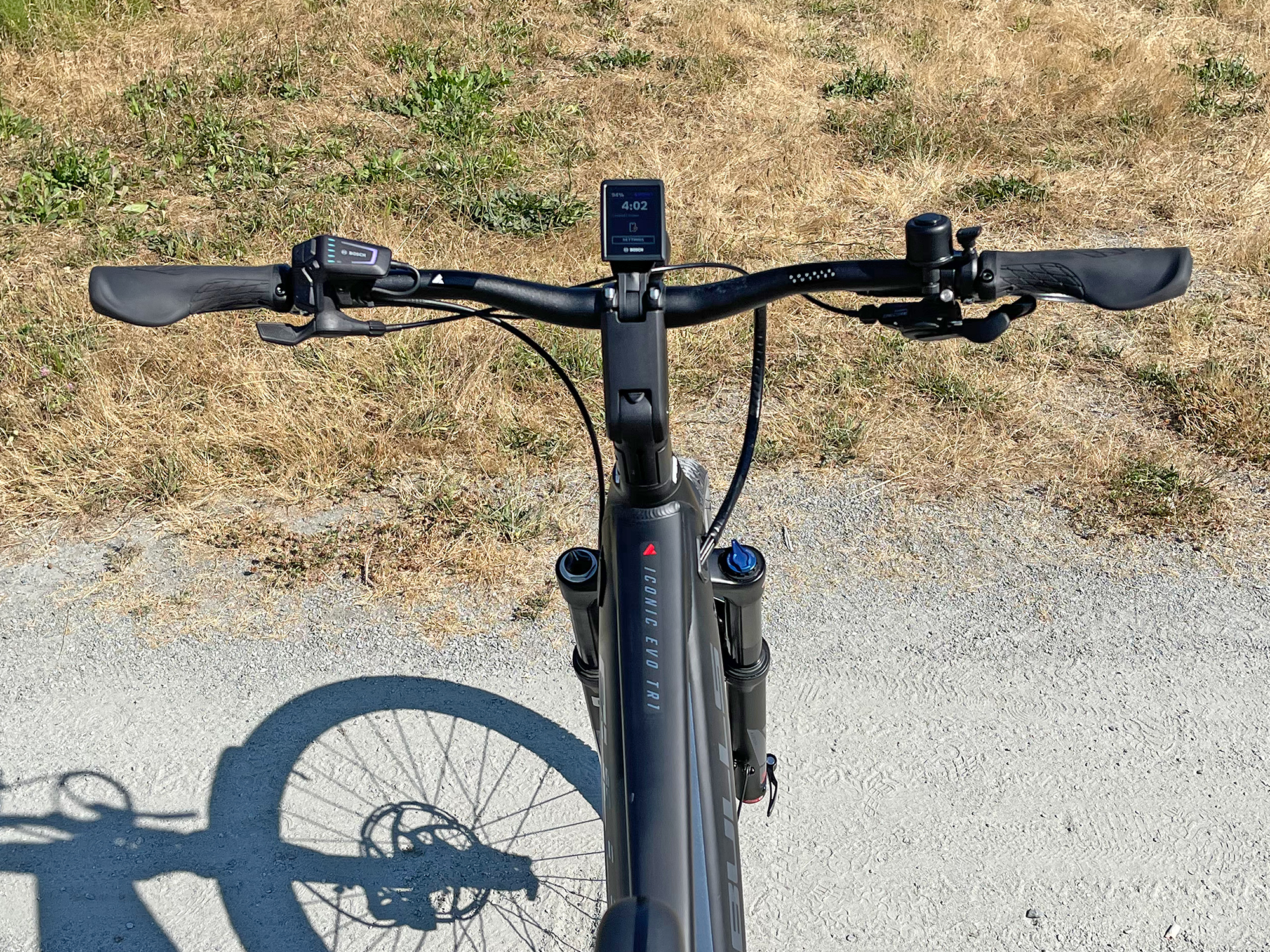

  • Bosch LED remote is easy to reach with your left thumb, the buttons are consistent and satisfying. The 5 LED lights actually communicate 10% charge level increments for more precise readings (blue is a 20% chunk and white is a 10% chunk). The four assist levels are matched to colors, so you don’t need to read anything, just memorize the colors Green = Eco, Blue = Tour+, Purple = eMTB, Red = Turbo.
  • The included Bosch Kiox 300 LCD display panel offers more precise battery readouts, current speed, trip distance, heart rate, range estimate and more. The free Bosch eBike Flow smartphone app offers many of the same readouts and lets your phone act as a display in Ride Mode.

  • The Bosch Performance Line CX motor is super smart, measuring rear wheel speed, pedal cadence, and pedal torque over 1,000 per second! It’s extremely responsive and quick, is quieter than I remember, doesn’t weigh a lot at just 6.4lbs because of the magnesium housing, and supports over 120 RPM pedal cadence. That means you don’t have to adjust your pedaling or ride style to the bike, it adapts to you… and even provides shift detection to reduce wear on the chain and sprockets.
  • BULLS has positioned the magnet for measuring rear wheel on the wheel hub near the disc brake rotor mount vs. a spoke. This means that your wheel can stay more balanced and you won’t end up with a loose spoke over time, it also improves reliability because this tucked-in position isn’t exposed to mud and debris as much.

  • The fenders are well done, but might restrict the size of tires you can use with the bike. Tires that are too wide or have large knobs might make contact with the fenders… and then you’d have to remove them and the rear rack (since the fender supports the rear rack).

  • The rear rack did not have a weight rating stamped on it, but I’m guessing it could be 20kg which is roughly 44lbs because of how it is attached to the stanchions and fender vs. directly to the seat stays. It might not be sturdy enough for child seats, and is unsprung. This means it will bounce around if you’re riding on rough terrain, and it increases the work and slows the actuation of the rear swing arm.

  • I wish that the USB-C port on the Bosch LED remote was active for charging smartphones and other devices, especially since the Bosch eBike Flow app has a ride mode that shows realtime stats and mapping. This is less of an issue than some other models because you already get the Kiox 300 with many readouts. The bike has such a high capacity battery, and I love that it can run the included lights… just wish it could do the same for other accessories.

  • When mounting the battery pack back onto the frame, you have to actively twist the key to unlock the latch or the pack won’t go in. It requires two hands and just isn’t as convenient as a ramped latch that I’ve see on other interfaces where you just push, especially because the battery is heavy at 9.4lbs. At least the bike has a kickstand so interacting with the battery is easier than on some of the mountain models without kickstands.
  • Be careful when lifting and transporting the PowerTube battery because it does not have an integrated handle like the PowerPack mid-frame and rear-rack models. I do appreciate how it clicks down one step when unlocking, before completely coming off the bike because you are less likely to drop it when removing.

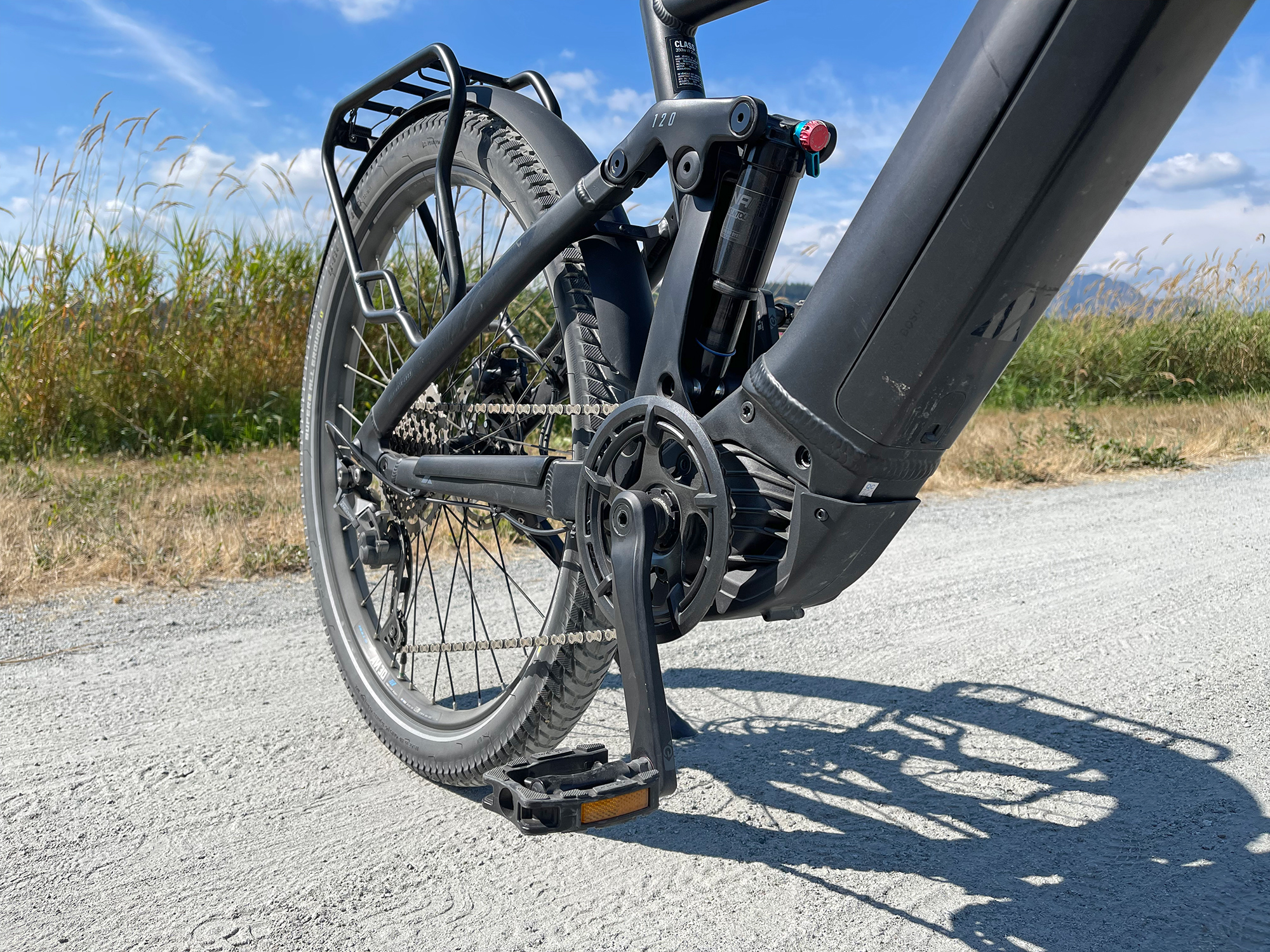

  • This is a minor thing, but the chainring doesn’t cycle backwards when you backpedal, this changes how drivetrain service is done… you basically need a bike maintenance stand or a friend to lift the bike and pedal to clean and lubricate the chain (and the bike is heavy at 65.87 pounds, so lifting in general can be a challenge… be careful with the dropper seat post). One positive note here, is that Bosch has setup the bottom bracket with some resistance so the cranks won’t spin as freely backwards, which could lead to more shin scrapes and shin bumps if your foot slips off when pedaling.
  • I noticed that small rocks and pebbles would occasionally get caught between the tire tread and flung off into the fenders while riding on gravel trails. I show this in the video, and it makes a ting rattling noise.
