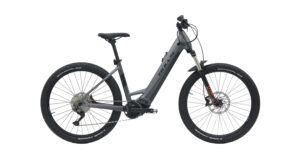

- The bike is purpose built with good weight distribution, although it is a bit heavier than most cross country models I’ve covered due to the large integrated battery, plus sized tires, and reinforced wave frame. It’s unique to see a step-thru mountain bike that’s so approachable but also sturdy and trail capable. It comes in four frame sizes, one color scheme, and is generally sold through dealers.

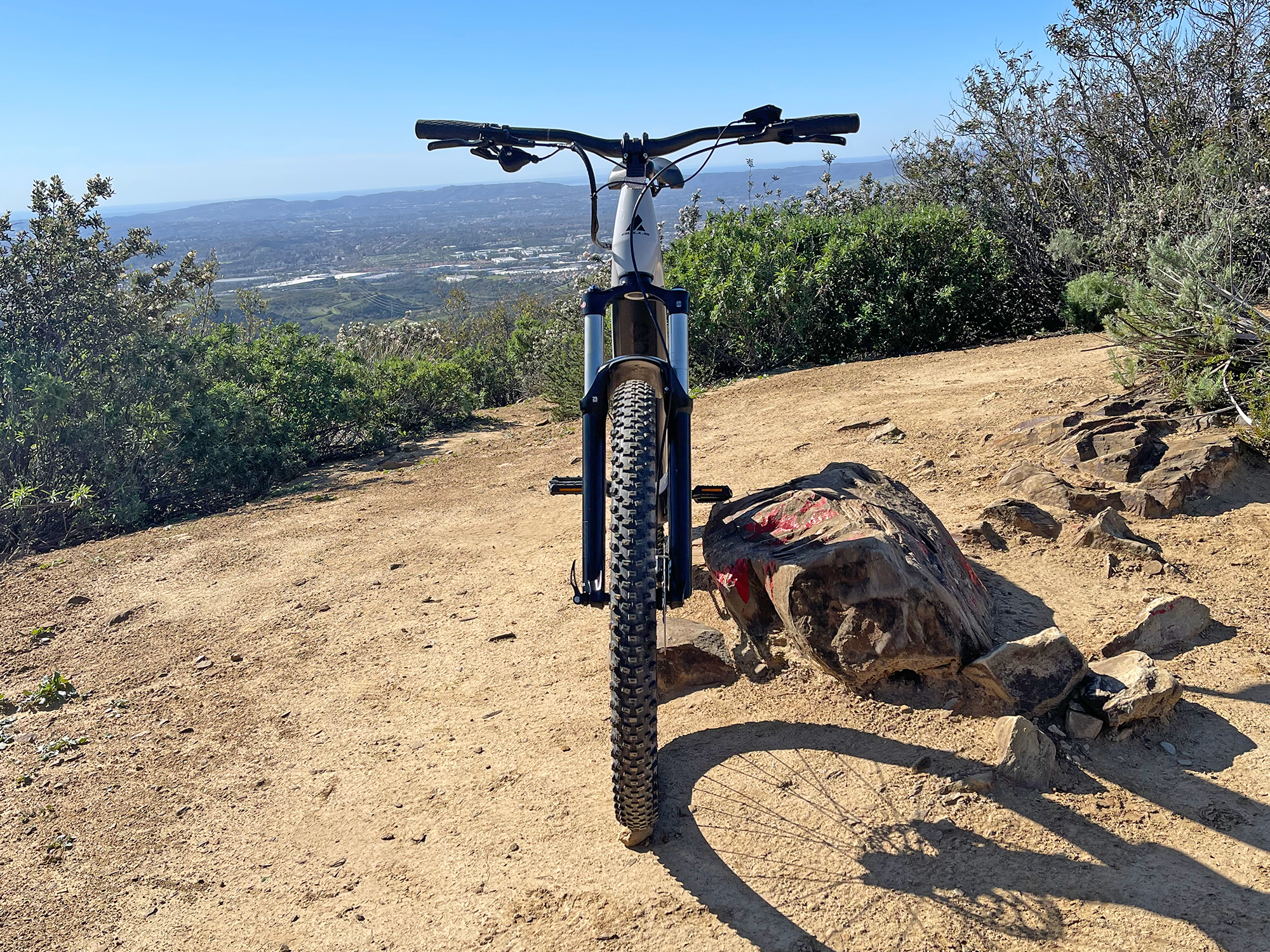

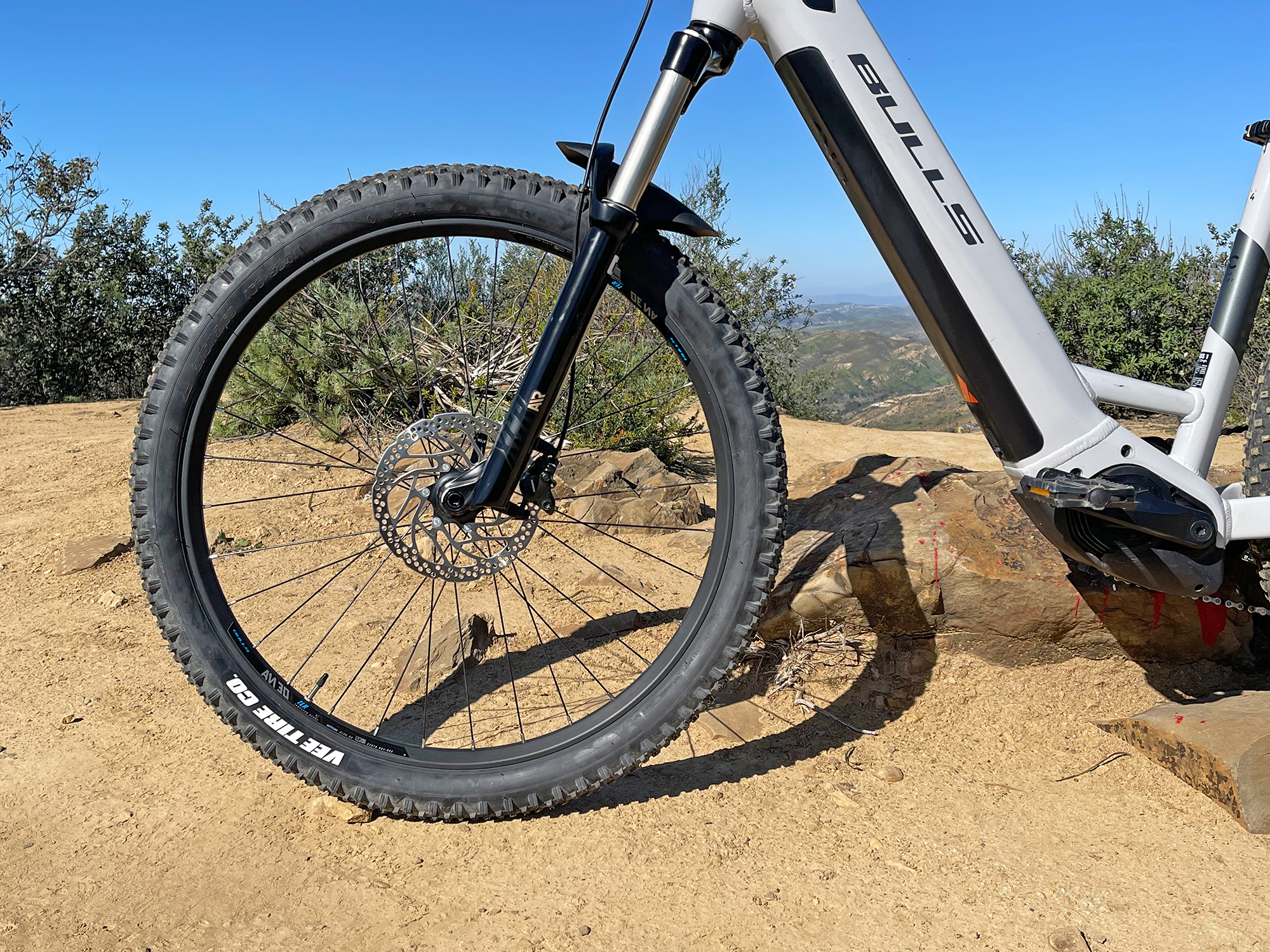

- Boost hub spacing for the front wheel means the spoke bracing angle is sturdier and the fork is wider. The tires are 2.6″ wide which is the narrowest Plus size, offering improved stability, float, and overall forgiveness.

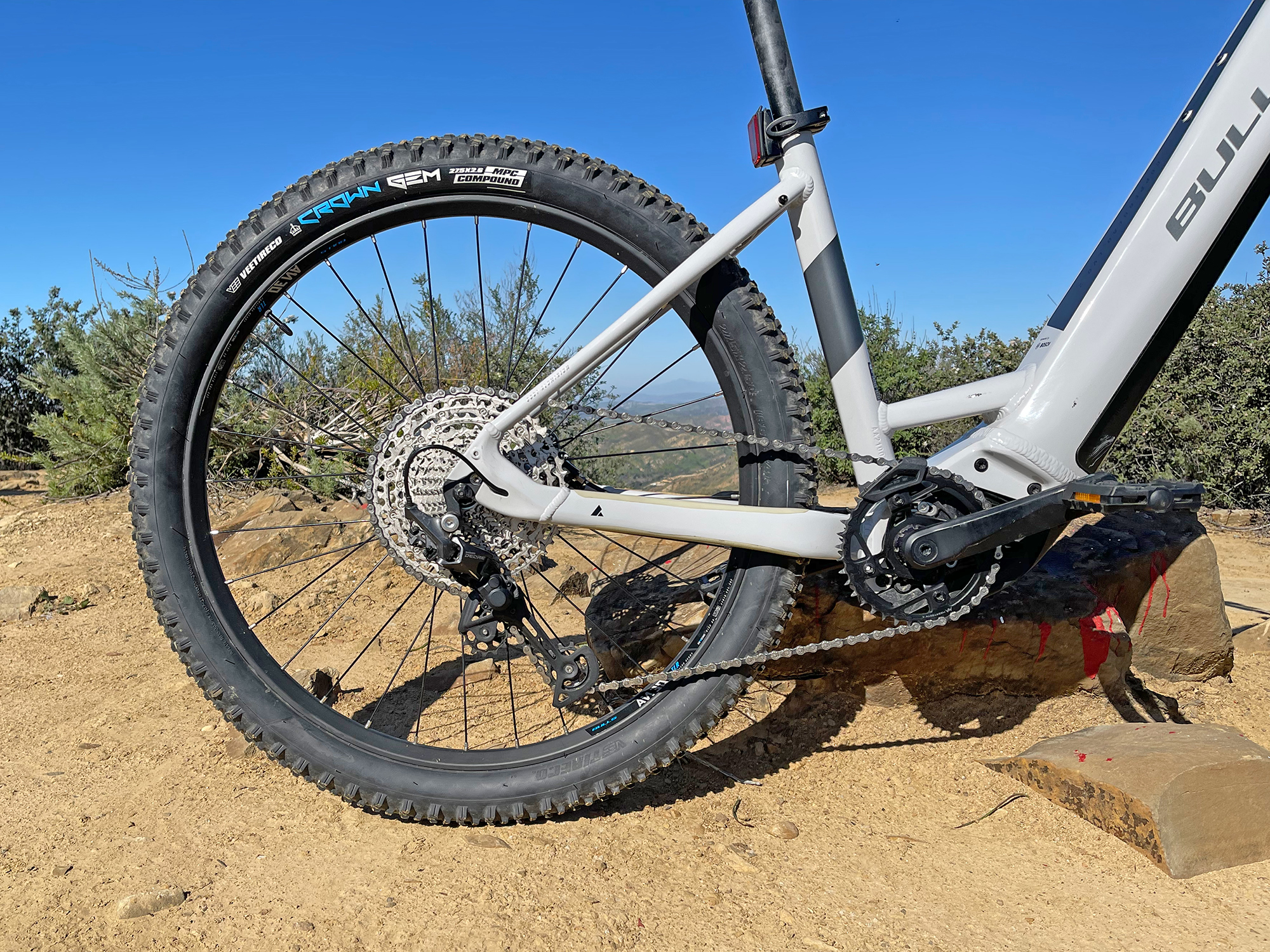

- The drivetrain on this model is excellent, an upgrade from the COPPERHEAD EVO HD and nicer than most cross country models I cover in this price range. It comes with an 11-speed, Shimano Deore derailleur with one way clutch, and extra wide 11-51 tooth cassette.

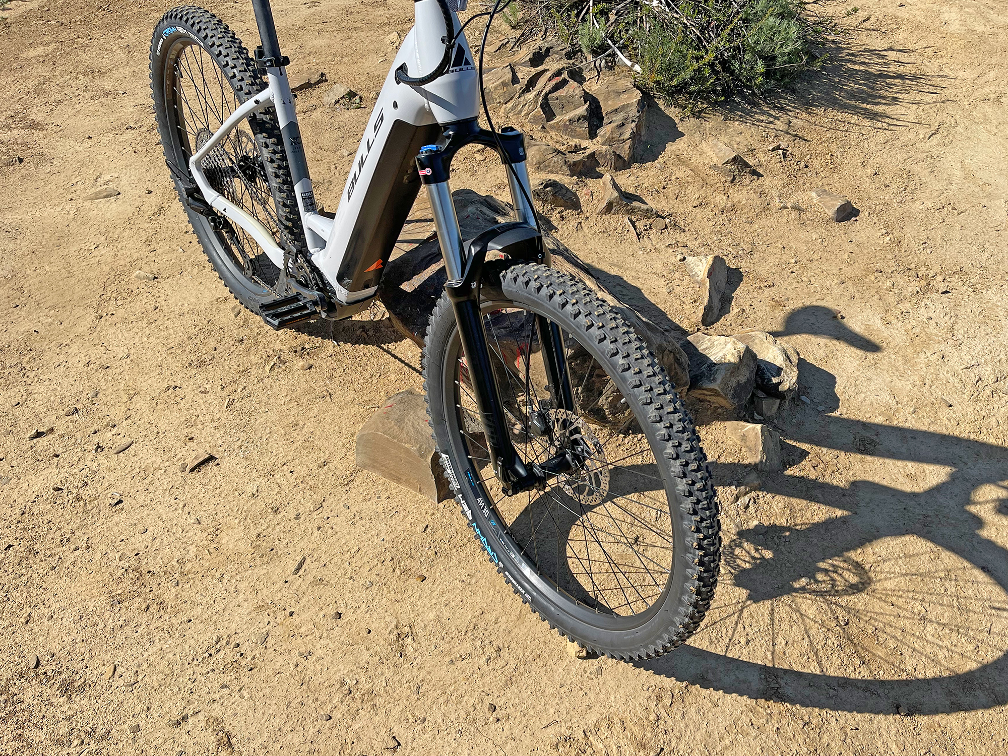

- The suspension fork is quite nice. It’s an air fork, which means you can adjust the air pressure for your body weigh and sag it to the optimal position. There’s a compression lockout lever and rebound adjustment clicker to improve performance on different types of off-road terrain.

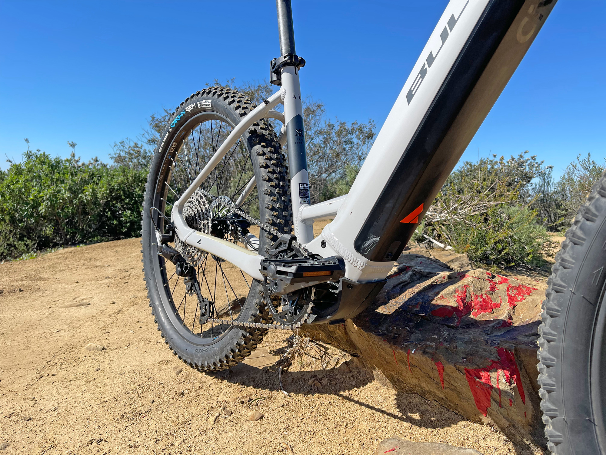

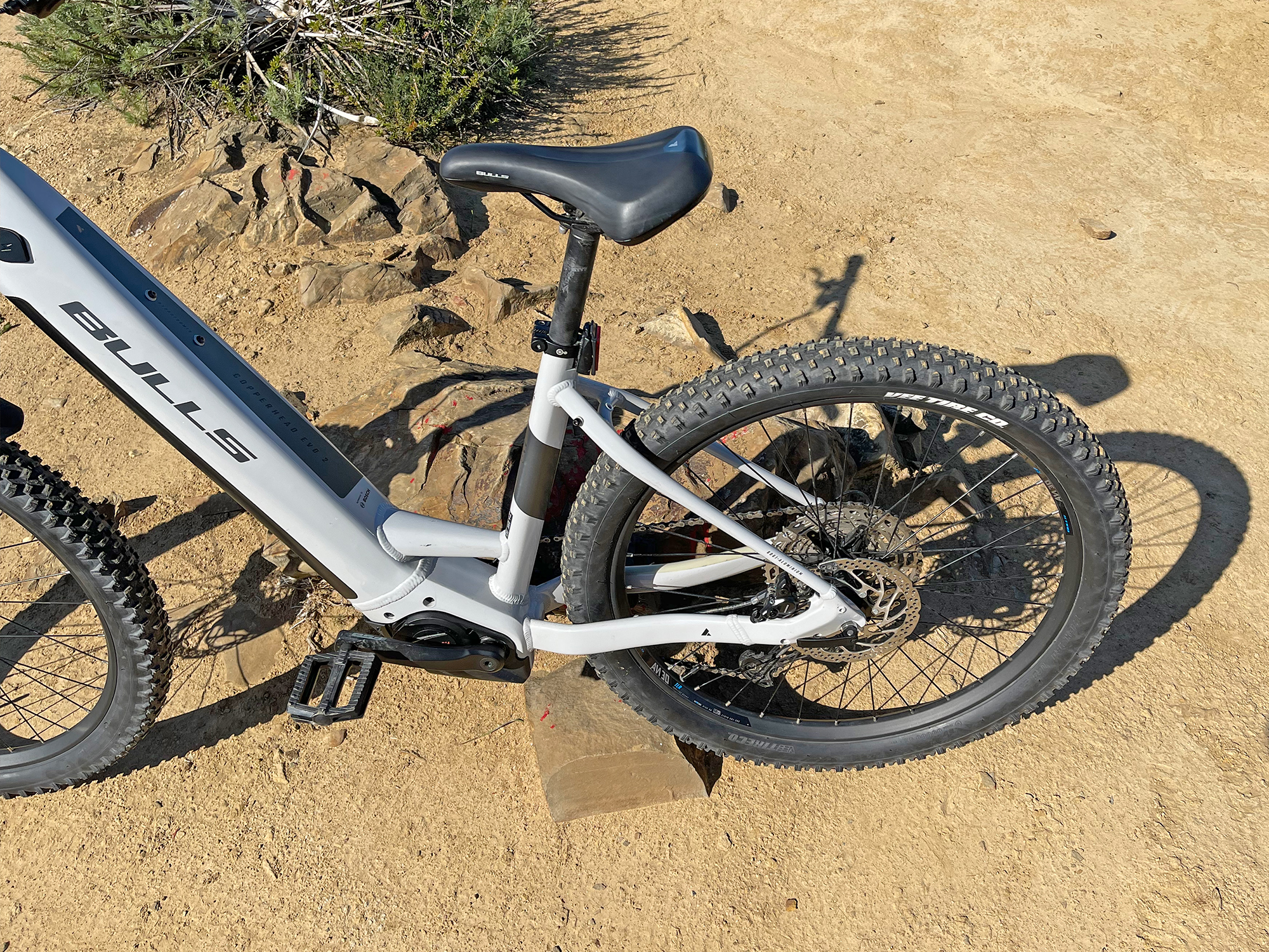

- This is a very minor thing, but I noticed a clear sticker slap guard on the top and bottom of the right chain stay. This will keep the paint from gettin chipped over time as the chain bounces around. The one way clutch lever on the derailleur also tightens the chain to reduce bounce, as demonstrated in the video review.

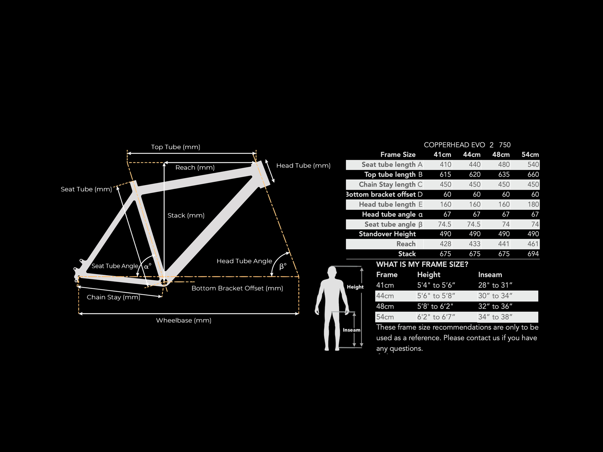

- This model is available in four frame sizes, which improves rider fit, handling, and overall comfort in my experience. This is especially relevant for a nicer more capable ebike that also happens to weigh more.
- Purpose built frame with internally routed cables, drive system weight is kept low and center, the battery is completely hidden and well protected. The bike handles well and is truly trail-capable in my opinion. That’s rare for a deep step-thru mountain bike, which has to deal with conditions that induce frame flex.

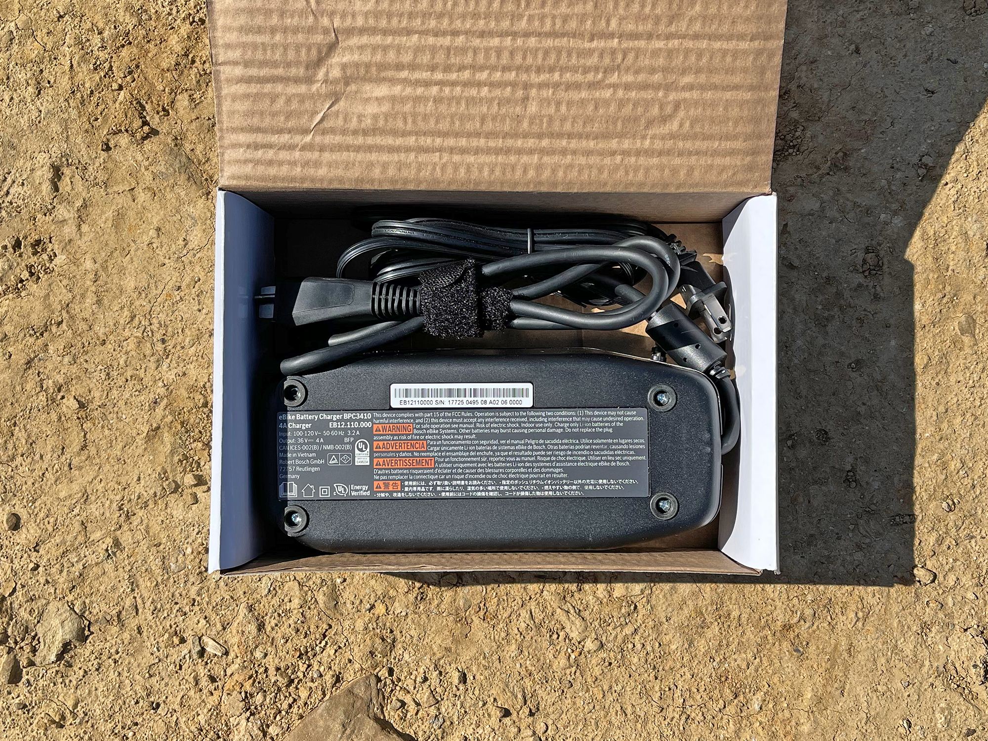

- Outstanding battery charger that’s relatively light weight at 1.6lbs, compact with removable wall-side plug, and puts out 36 volt 4 amps vs. just 2 amps on many competing chargers. It has a sturdy plug design that connects directly to the battery as well as the plug port on the bike. It’s also UL certified for safety. Note that it uses a different plug interface than the older non-Smart System chargers… though they look very similar.

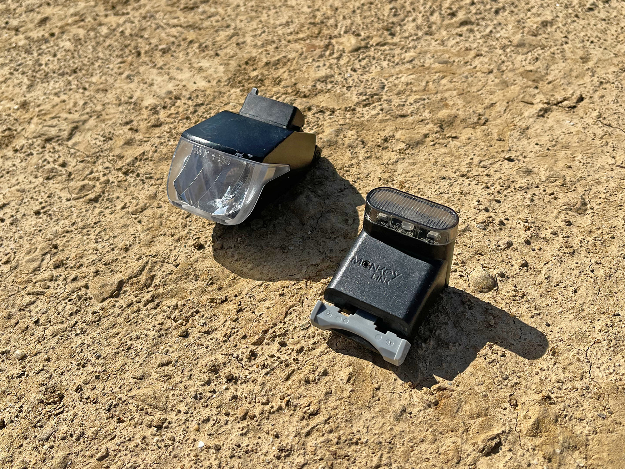

- There are two magnetic light mounts with the magnetic MonkeyLink interface, so you can add a headlight and a rear light or fender with light that will run off of the main rechargeable battery pack. The headlight is very nice with a flattened beam that won’t shine up into oncoming traffic and offers adjustable angle for aiming. It’s unique to find a capable electric mountain bike with the option for seamlessly integrated lights.

- Decent hydraulic disc brakes with 180mm rotors offer control for continuous descents and control over the larger plus sized tire. Note that you may see Shimano or Tektro hardware depending on supply chain. It is interesting that the COPPERHEAD EVO HD model had a larger 203mm front rotor, which offered better cooling and mechanical advantage than the EVO 2 here.

- Solid drivetrain with 38 tooth chainring that has narrow-wide teeth for improved grab, and a plastic guide to ensure that you won’t experience chain drops on rough terrain. The 11-speed 11-51 tooth cassette provides enough range for steep climbs and comfortable pedaling at speed. It’s light, durable, offers a clutch to keep the chain tight, and is one of my favorite drivetrains with excellent shifters (Shimano Deore).

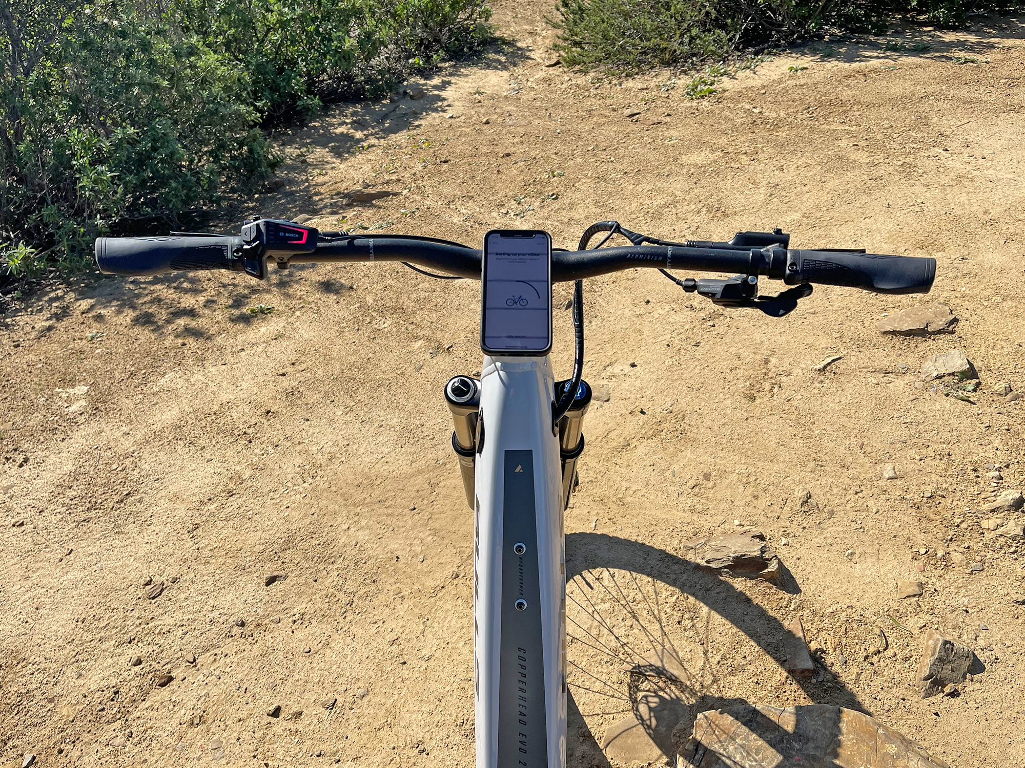

- Bosch LED remote is easy to reach with your left thumb, the buttons are consistent and satisfying. The 5 LED lights actually communicate 10% charge level increments for more precise readings (blue is a 20% chunk and white is a 10% chunk). The four assist levels are matched to colors, so you don’t need to read anything, just memorize the colors Green = Eco, Blue = Tour+, Purple = eMTB, Red = Turbo.

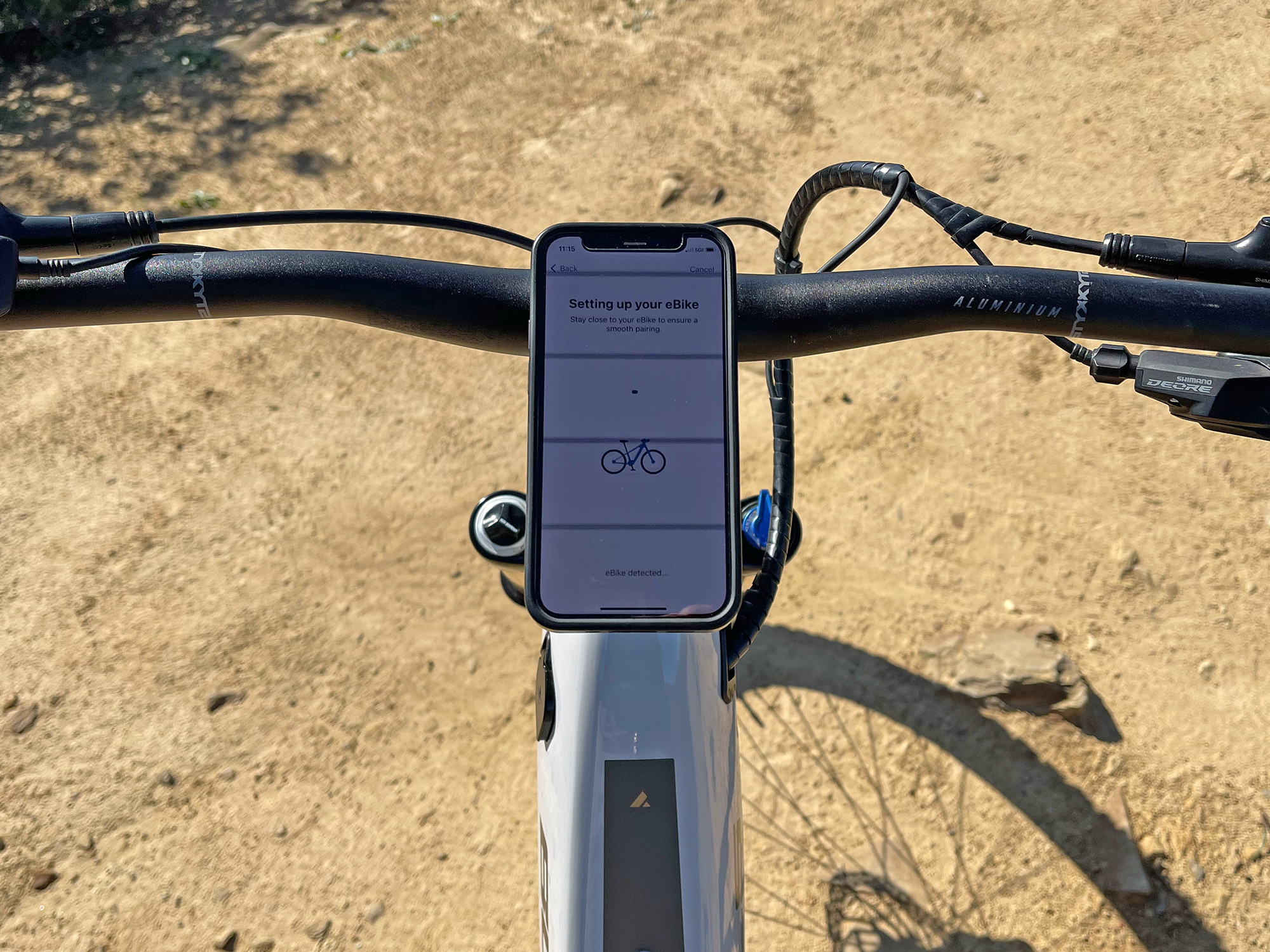

- You could easily wire in the Bosch Kiox 300 LCD display panel for more precise battery readouts, current speed, trip distance, heart rate, range estimate and more… if you are willing to buy and upgrade. The free Bosch eBike Flow smartphone app offers many of the same readouts and lets your phone act as a display in Ride Mode. It also lets you tune Turbo and Eco modes, track past rides, and lock/unlock the bike based on phone proximity.
- I love that the Bosch Flow ebike app also offers trip planning with GPS and gives you three options for direct, casual, or mountain routes. It dynamically updates your route depending on your ride preferences! You can update your own firmware without visiting a shop, and connect to other cycling apps like Strava, Komoot, Apple Health, and Apple Watch with heart rate monitor all with this free eBike Flow app.

- It’s a small detail, but I love the little plastic mudguards that come with the suspension fork. They will help keep mud and water out of your eyes as you ride faster across varied terrain. I’ve added similar fenders to my own mountain bike with zip ties, but these are a lot sturdier and look great.

- If you aren’t using a smartphone as a display, the readouts on the Bosch LED remote are a bit limited. You get a battery charge level percentage with 10% steps (blue blocks represent 20% and white blocks represent 10%). Four colors communicate assist level… but there’s no current speed, min or max speed, range, cadence etc. that you would get from the Bosch Kiox 300 (which is sold separately).

- This is a minor thing, but the chainring doesn’t cycle backwards when you backpedal, this changes how drivetrain service is done… you basically need a bicycle stand or a friend to lift the bike and pedal to clean and lubricate the chain. One positive note here however, is that Bosch has setup the bottom bracket with some resistance so the cranks won’t spin as freely backwards, which could lead to more shin scrapes and shin bumps if your foot slips off when pedaling.

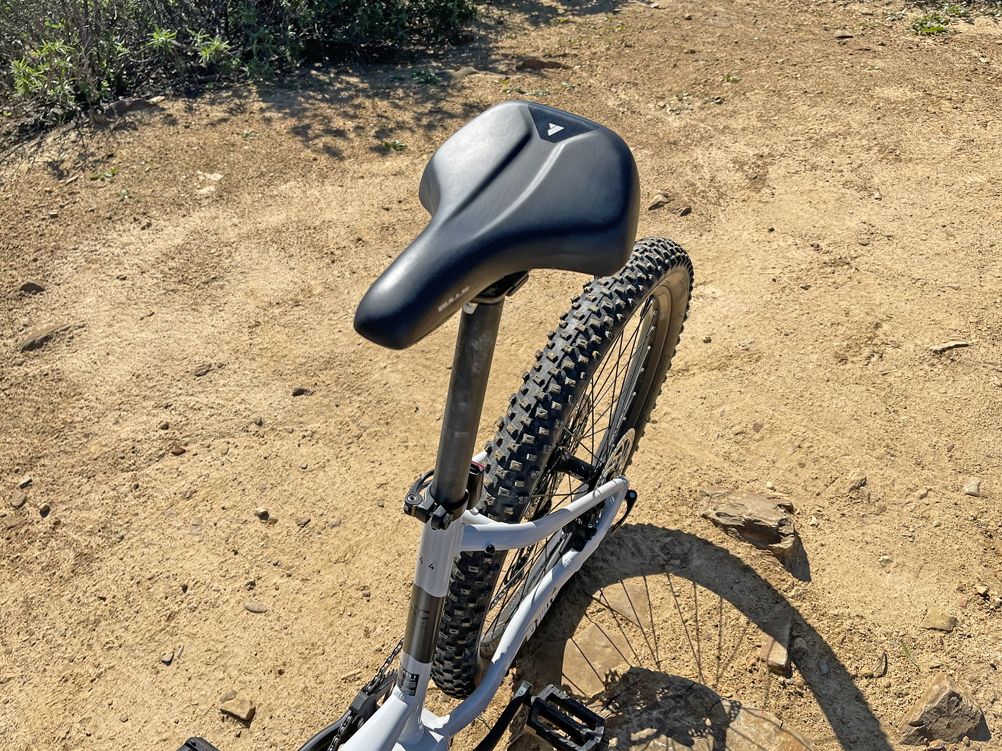

- I think this model would be a great candidate for a suspension seat post, or dropper post. This would improve comfort, or make it easier to mount and safer to navigate rough terrain. Some other BULLS models have a Limotech dropper post with 40mm of suspension built in! I would love to see that here, especially since it’s a hardtail and might appeal to petite riders or those with mobility challenges (going for the wave step-thru frame design).
