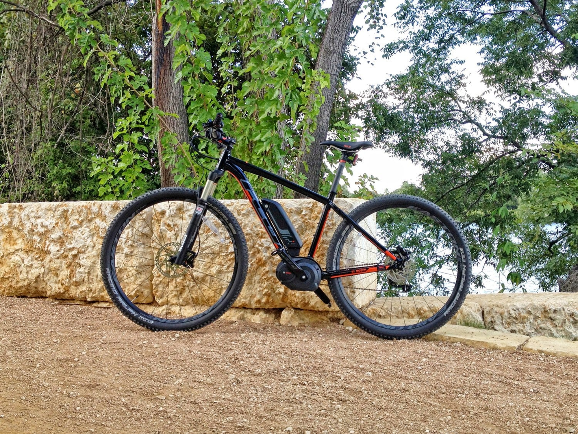

The Felt NINEe is the lightest weight, stiffest, highest quality electric 29er I’ve tested to date. It delivers everything you might expect from a premium Felt bicycle with the addition of an advanced motor pedal-assist system from Bosch. It performs wonderfully on trails, mountainous terrain and urban environments thanks to the large efficient wheels, remote suspension lockout and rear rack bosses. You could totally commute with this thing. My favorite aspect is just how “bike like” the NINEe is. All of the motor and battery weight is low and center, the front and rear wheels offer quick release and the battery is removable so transport, maintenance and even riding in non-electric mode is a breeze. Weighing in at ~38 pounds (varying by size) it’s not a burden to lift up stairs or hazardous trail points such as drops or rivers. In my view, it’s the ultimate hardtail on the market right now but it does cost a bit extra… as one might expect.

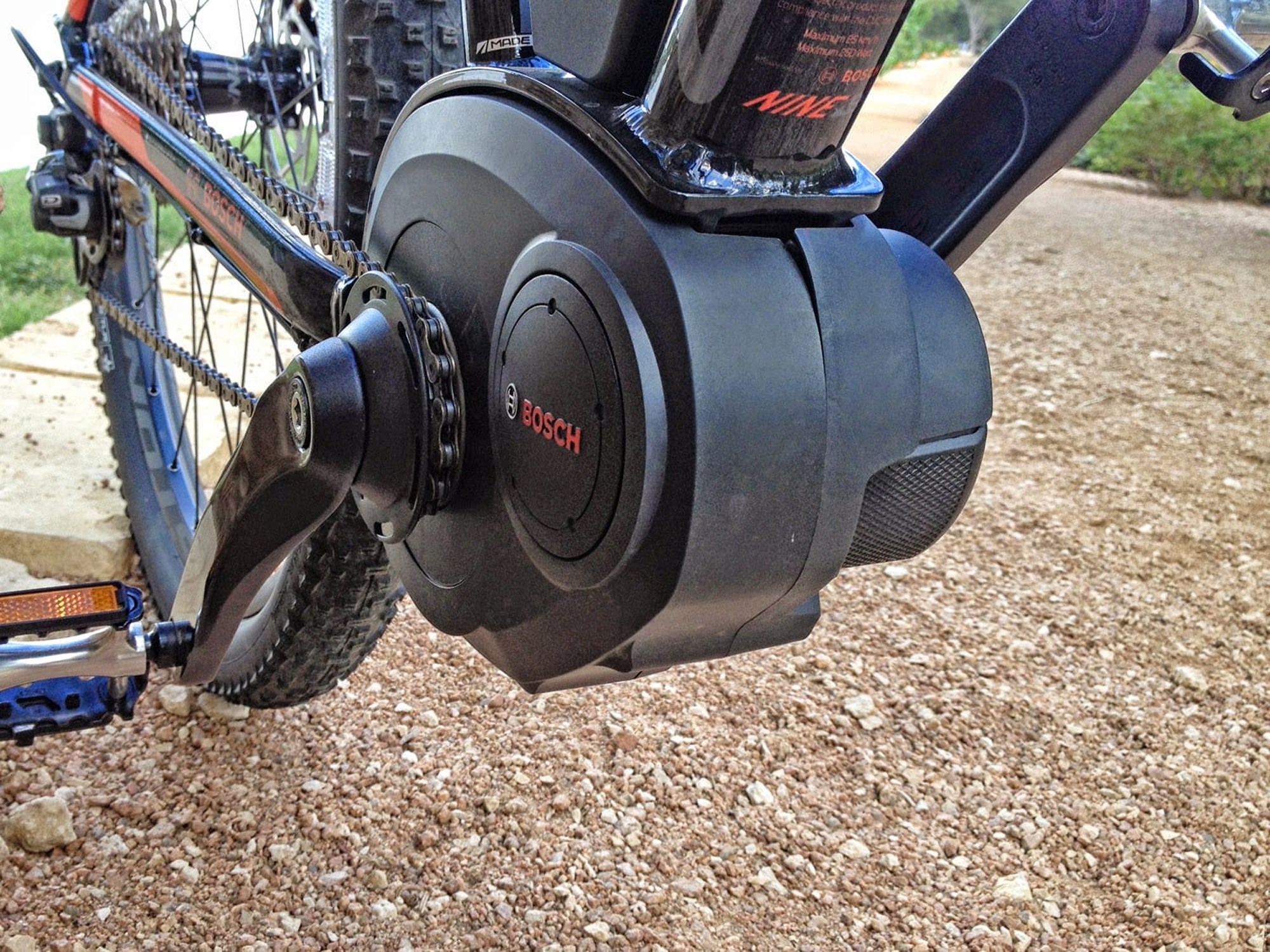

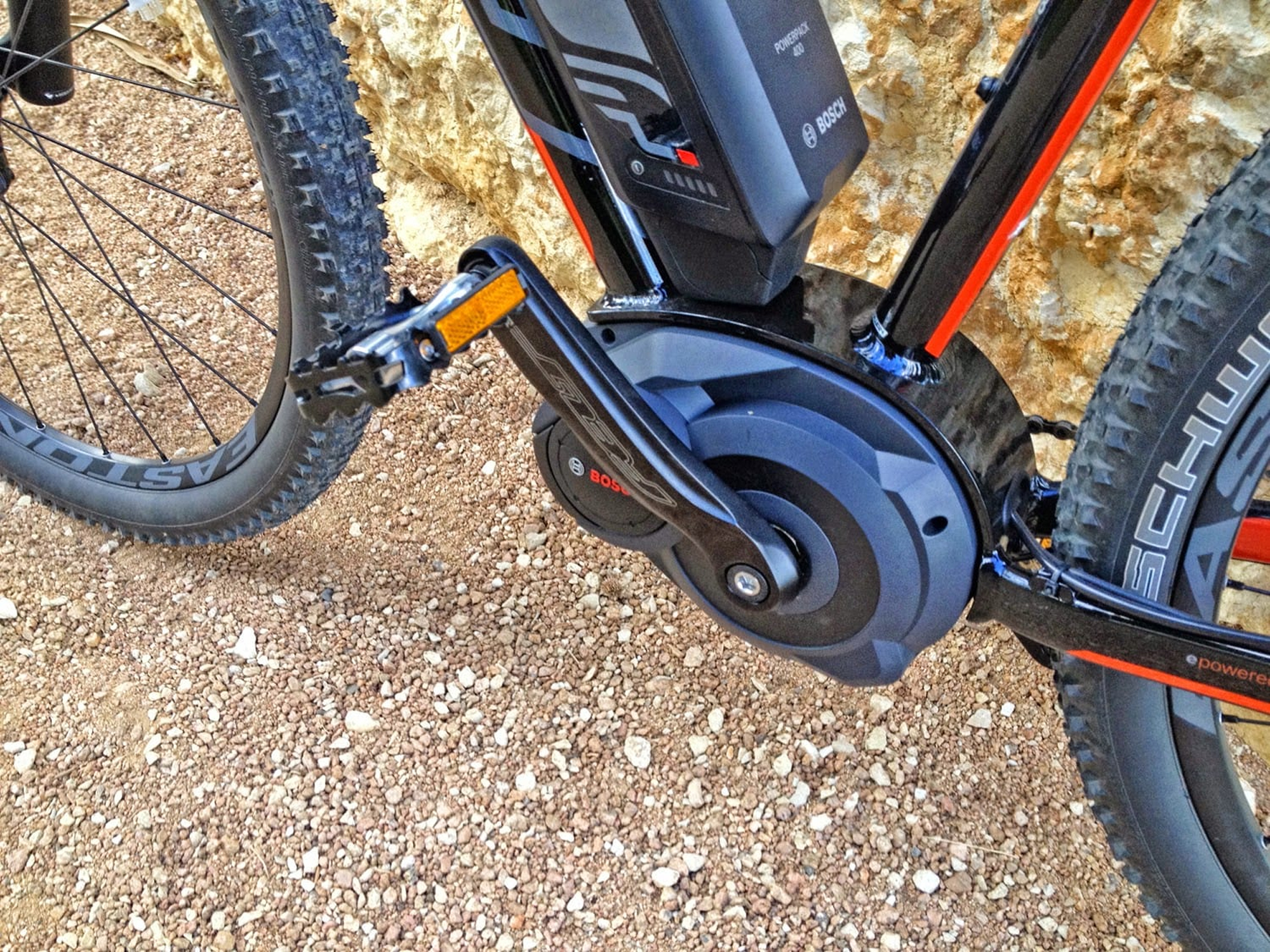

The motor assisting you is a 350 watt geared mid-drive design from Bosch. Weighing in at ~6 pounds and operating with a sort of electronic whir, this thing is very powerful and in Turbo Mode (the highest drive setting) will take you up the steepest hills you can find. In my experience, the rear wheel will begin to slip before the motor even gets close to giving up (as long as you’re pedaling along). The centerdrive mounting position of this thing keeps weight low and center but might expose the casing to more trauma on rocky or wooded trails. The plastic casing is designed to protect the system and the two year electronics warranty adds peace of mind. So it’s powerful and durable but most importantly… it’s responsive. With two sensors embedded in the motor and one at the rear wheel this bike is constantly measuring your pedal force, cadence and bike speed for instantaneous activation and deactivation. This is especially important for technical off-road riding and Bosch nails it.

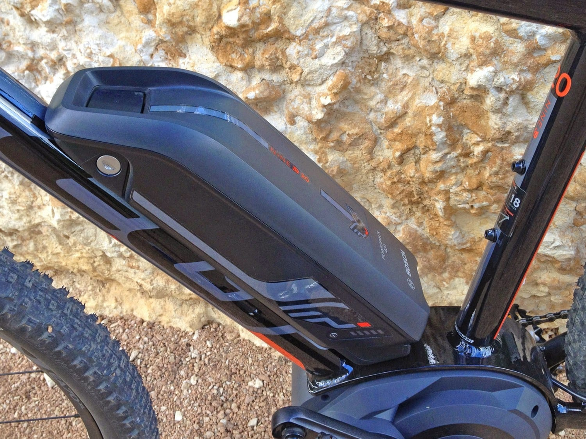

Powering the motor is a 400 watt hour Lithium-ion battery pack with premium Samsung cells. It mounts directly to the downtube and is so narrow that it won’t touch your legs when pedaling or get in the way. It provides just enough space that a bottle cage mount is present on the seat tube which isn’t the case for many ebikes with mid-batteries. The pack can be charged on or off the bike and includes a solid metal core lock (by ABUS) for security. And if you’re transporting the bike with a rear hang-style bike rack for your car, I love that the straight top tube and open triangle combined with the light weight frame mean you can still carry additional bikes without so much concern for overloading the rack. Considering how light this bike is to begin with, if you choose to remove the 8.8 pound battery you can enjoy riding in non-electric mode just as you would with a regular bike. Doing this, the bike would weigh ~30 pounds depending on frame size… that’s about 5 pounds heavier than comparable aluminum alloy hardtails.

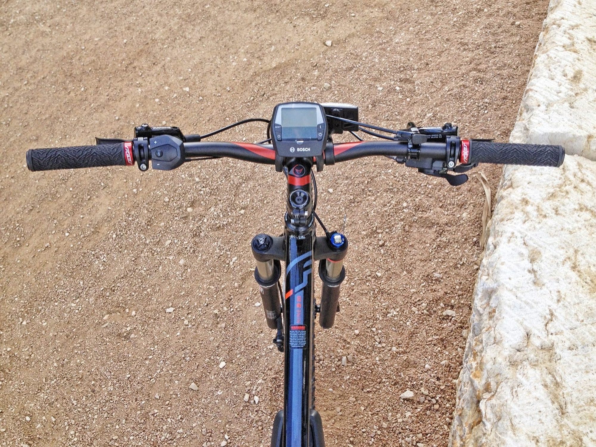

To activate this bike you simply connect a charged battery and then press the power button at the lower left corner of the LCD display unit. The large backlit console is mounted front and center for easy viewing and offers several readouts with a constant show of speed, battery and assist level. I love that the display is removable in case you’re locking up in a crowded space or leaving the bike outside in glaring sun. To cycle through menus there’s a button at the top right of the display marked with an i and this button is duplicated on the remote button pad at the left grip for easy access. It lets you see overall distance, trip distance, max speed, average speed, estimated range, and time. My favorite readout is range because it dynamically adjusts as you arrow between four levels of assist and factors in remaining battery capacity. This lets you plan rides and avoid getting far, far from the parking lot on a trail ride only to run out of juice half way home. You can expect to get great range however, up to 65 miles in the lowest level of assist, and that’s not an exaggeration. I’ve commuted with the Bosch system on other bikes with a round trip of 10 miles over several days and still had half a pack left. Cycling through assist levels is very easy using the button pad and you can literally click through without taking your hand off the grip and without even looking down. It’s a great design that lets you focus on riding the bike vs. interpreting menus and it’s native to all Bosch Gen2 systems. In my time riding off road I tend to stay in Eco mode and then click the system off if I’m passing pedestrians (to eliminate motor noise and avoid questions or concern from them) and then when I’m climbing steep stuff I’ll arrow up to Normal mode to climb without leaving the saddle. This tactic has worked with even the steepest terrain I’ve encountered.

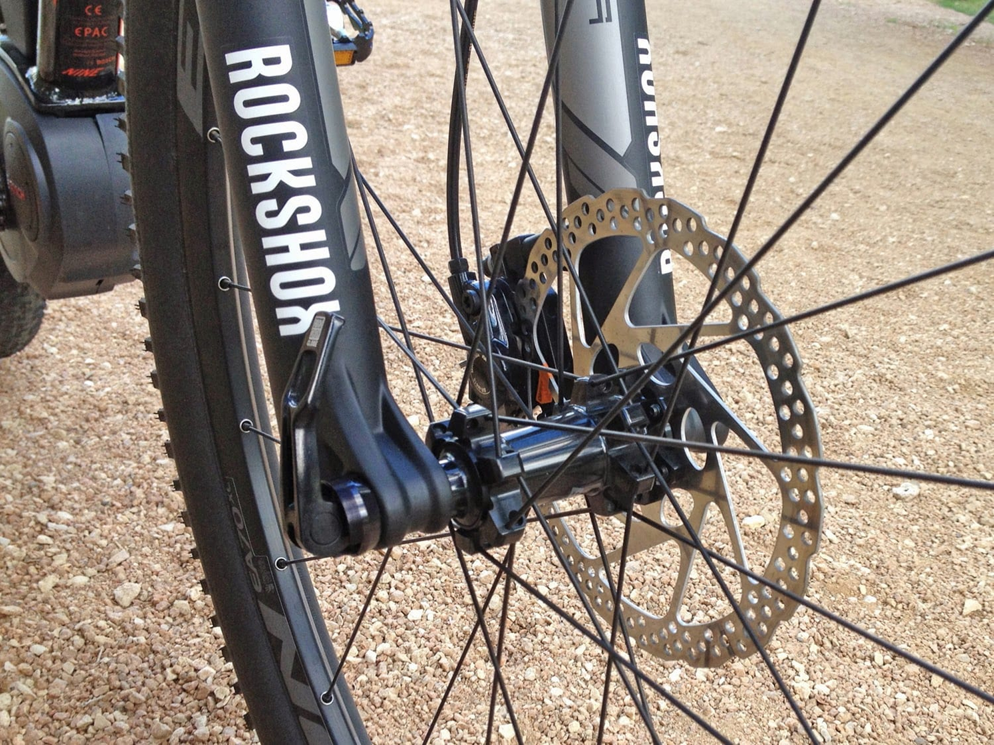

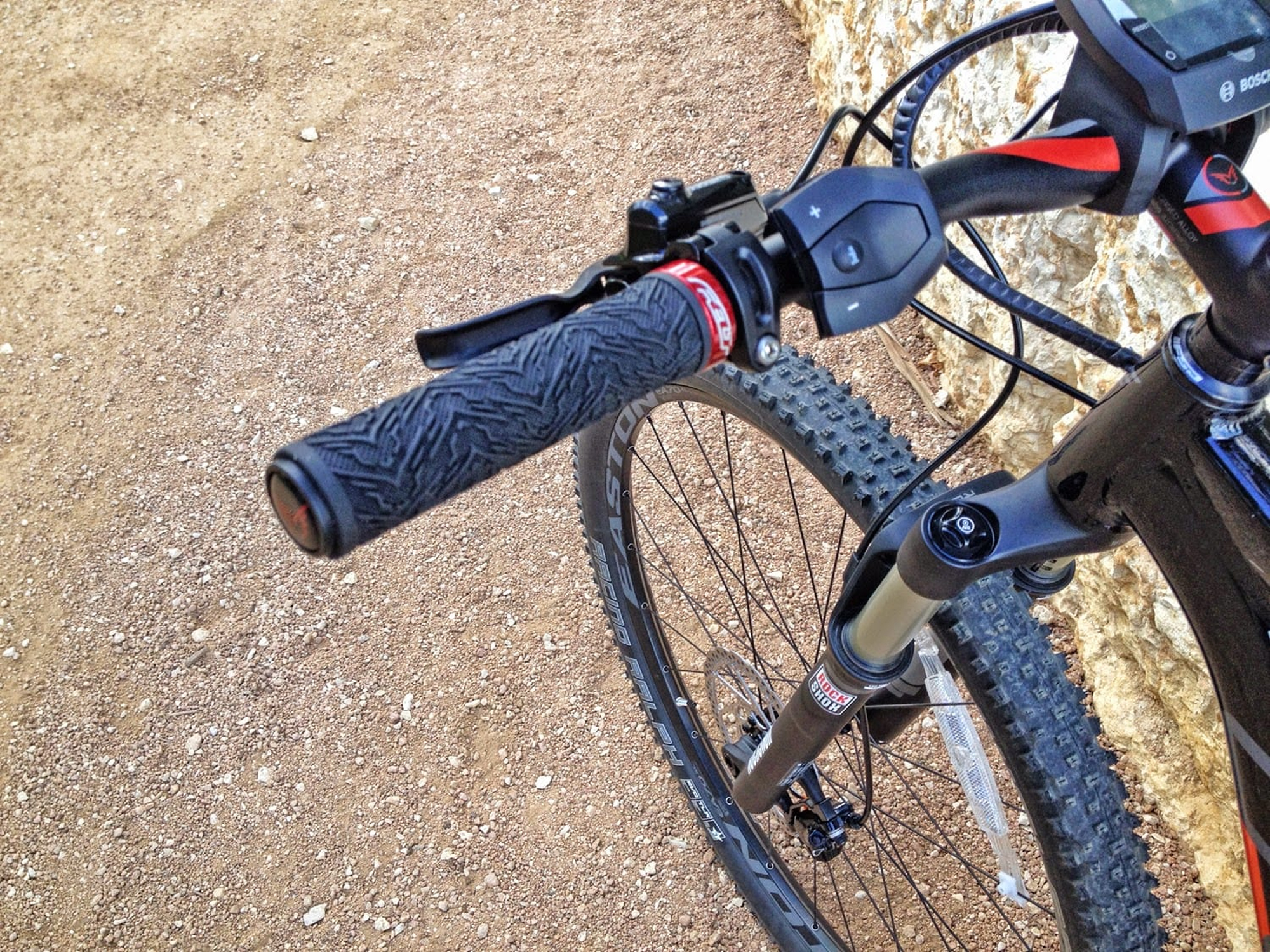

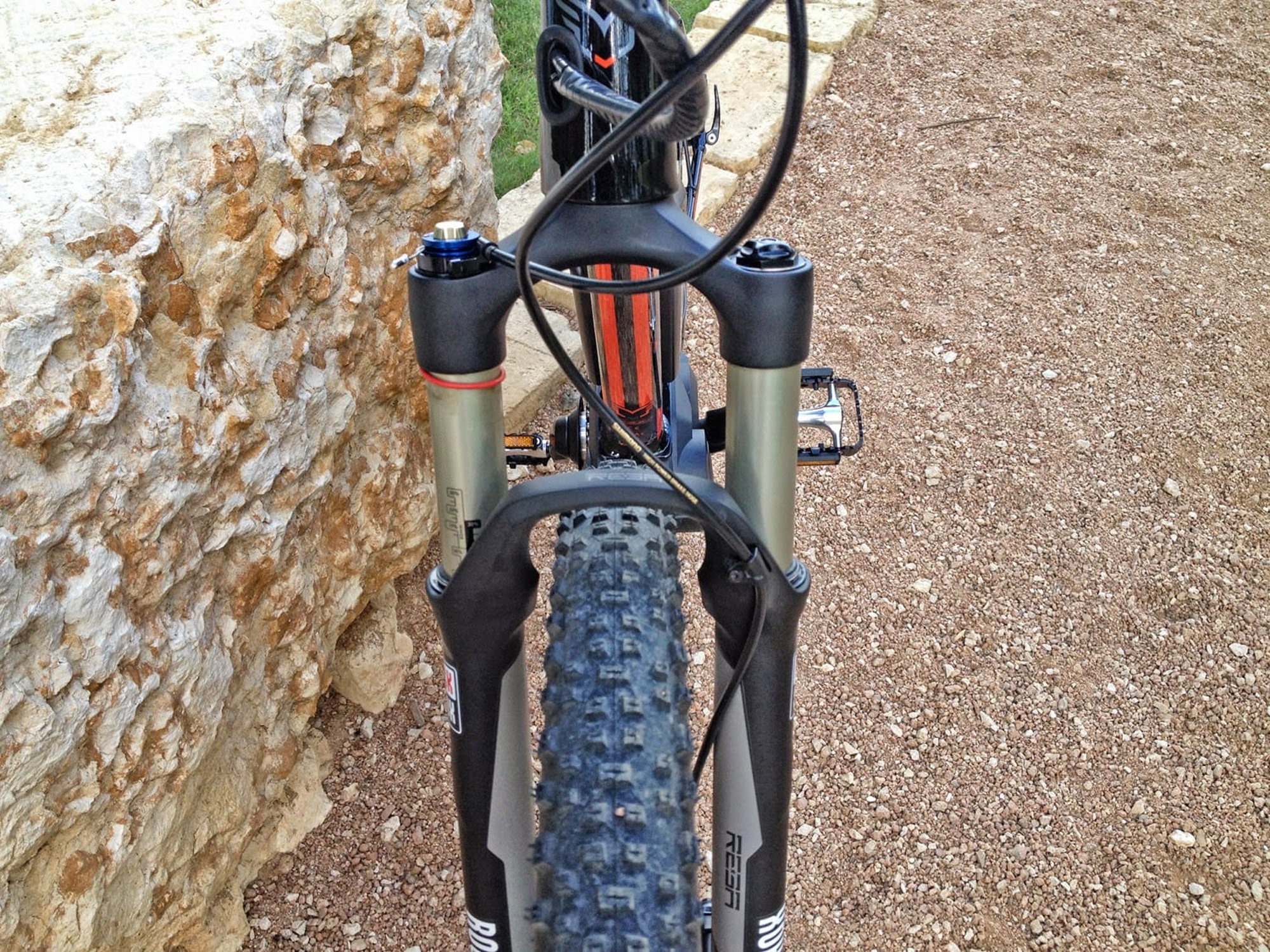

- Remote lockout for RochShox suspension fork complements the remote button pad for motor control, everything can be adjusted without taking your hands off the grips

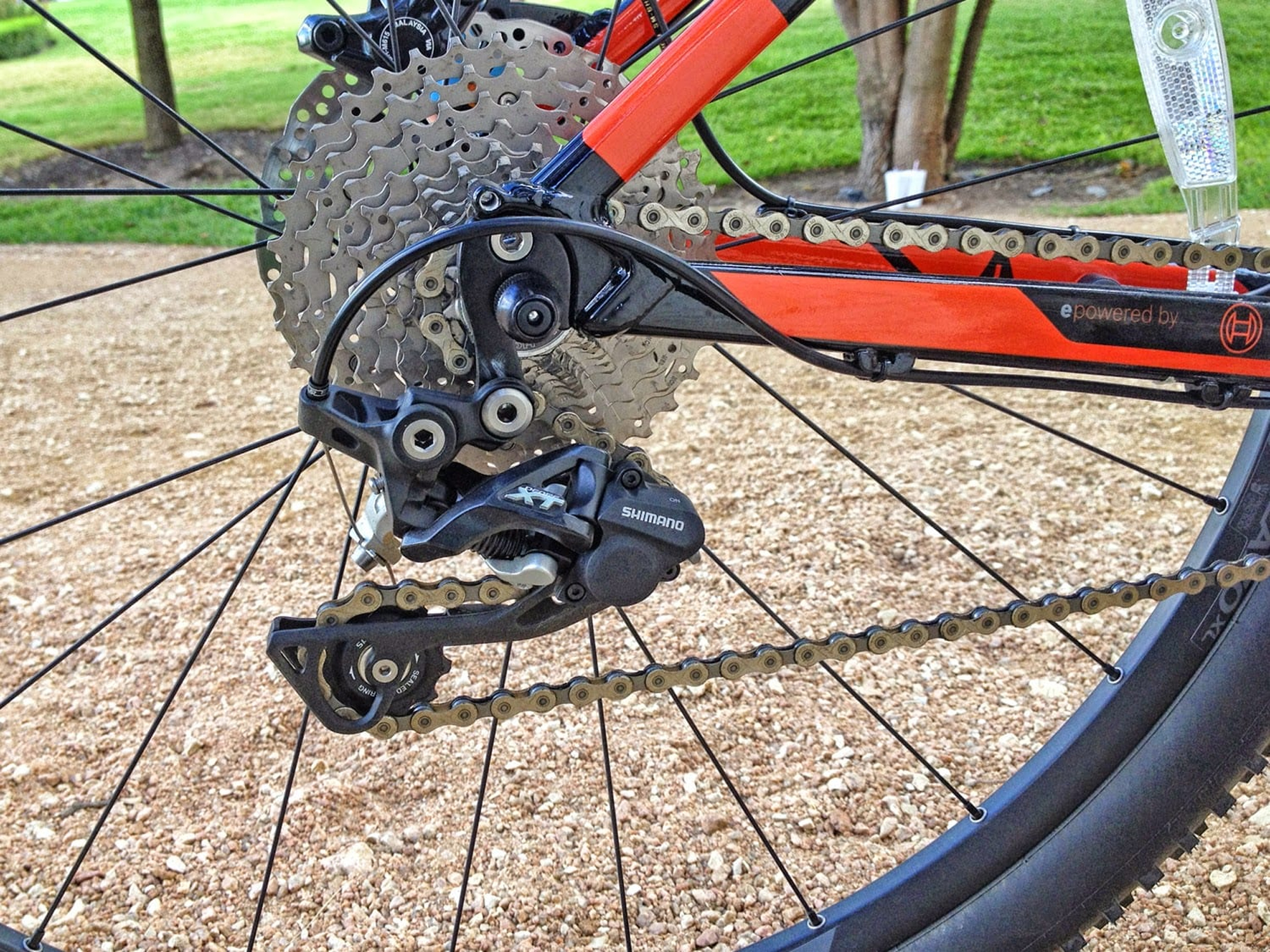

- High-end drivetrain, Shimano Deore XT with KMC X10 chain for toughness, important when paired with a mid-drive for off-road use

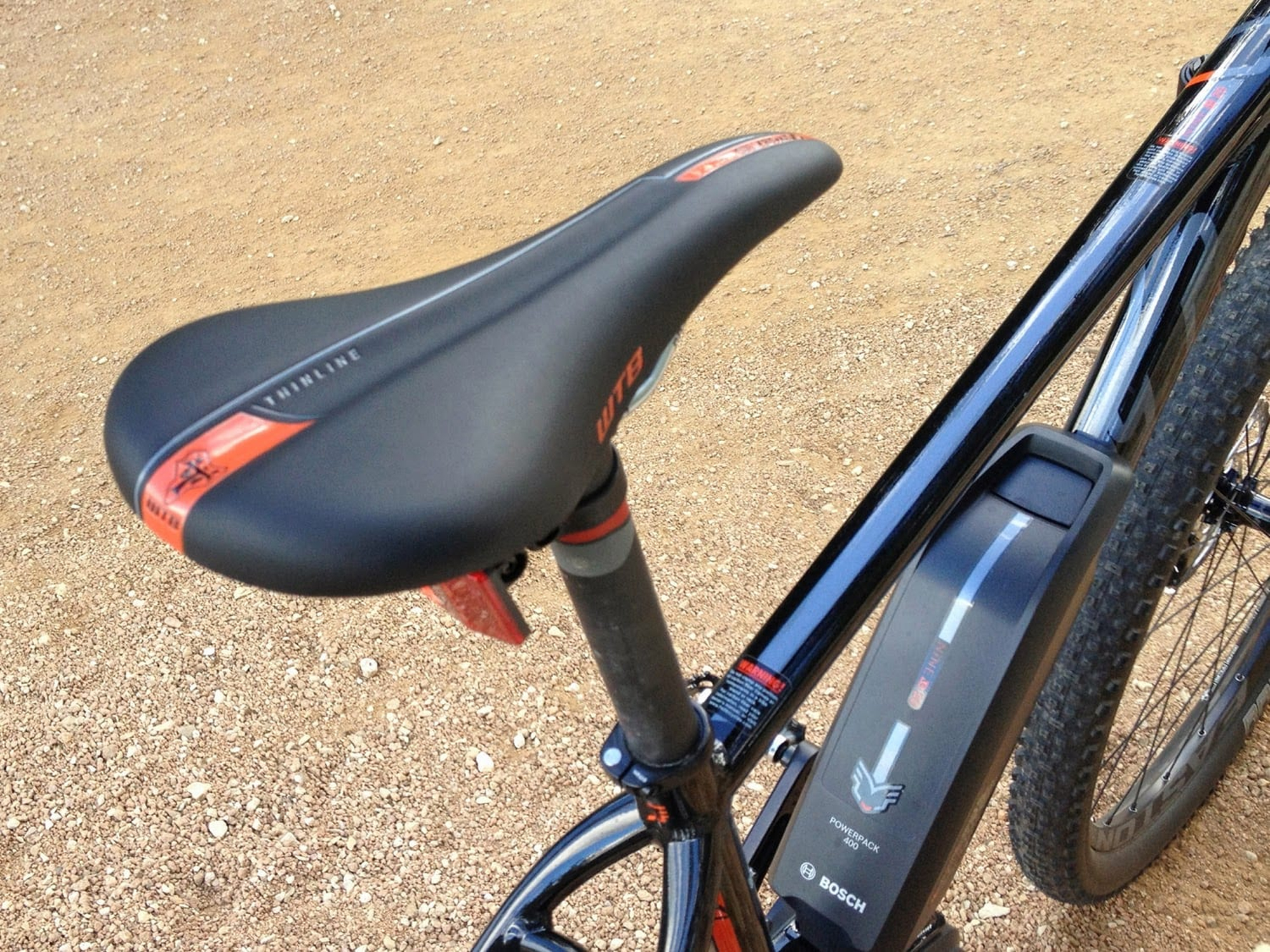

- Grips have lockers to avoid spinning, saddle is upgraded for comfort and reduced heat

- Gel saddle provides added comfort on longer rides and bumpy terrain, designed to stay extra cool in hot temperatures
- Battery pack is removable for convenient charging and to reduce the weight of the frame during transport, for security the battery has a built in locking core made by ABUS
- 10 speed rear cassette offers decent cadence range for climbing or reaching higher velocity on paved tarmac, motor cuts out at 20 mph
- Bosch display panel is removable for safe storage, backlit for night use and includes a breakout button pad that clicks when you press down so you don’t have to take your hand off the left grip or eyes off the road to navigate menus or change assist level

- Hydraulic disc brakes provide excellent stopping power while minimizing hand fatigue in off-road environments

I’ve had the Felt Nine E since they came out with it nearly, and I have really enjoyed this bike. My battery is now beginning to show some weakness and I was wondering if the newer Bosch 500 wh battery could be installed on this bike?
Court says
Hi Melany! My understanding is that YES, the PowerPack 400 and 500 use the same case and interface… they also operate at 36 volts, so they are interchangeable. You should be able to find one at any local Bosch ebike dealer or possibly get one mailed from a national shop if you don’t have a local dealer. Hope this helps and keeps your bike one the road! Keep in mind, storing your battery between 20%-80% and in a cool dry location vs. hot or cold will keep the Lithium-ion cells lasting longer :)
