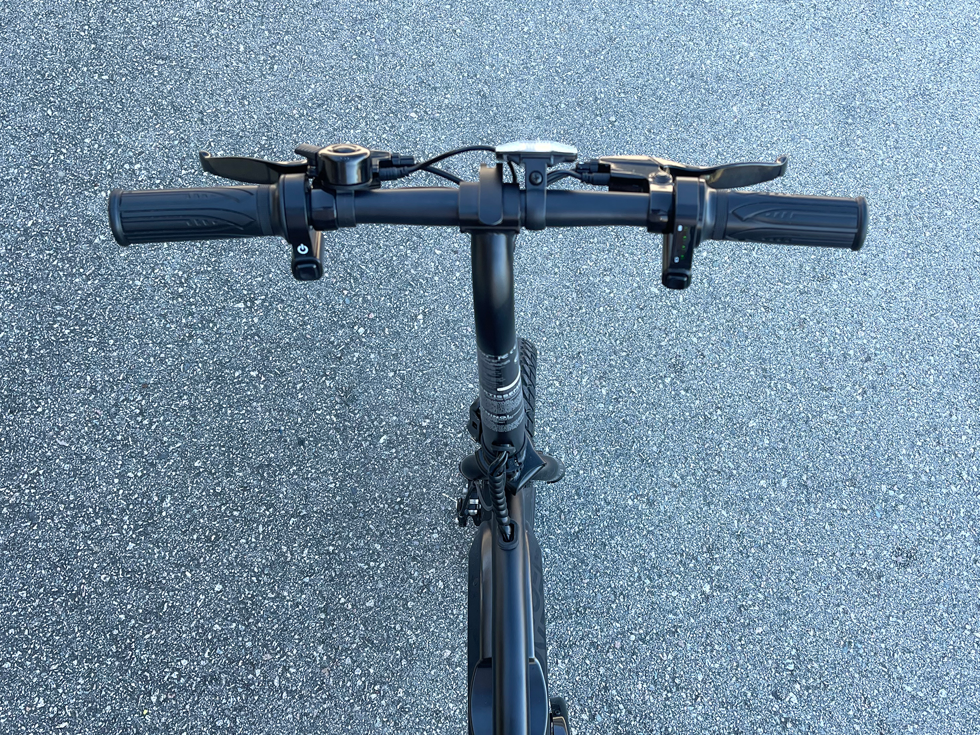

- The only portion of the bike that folds is the handlebar post. In order to make this ebike as compact as possible for storage or transport, you could also remove the saddle and seat post, and consider removing the pedals (which do not fold).

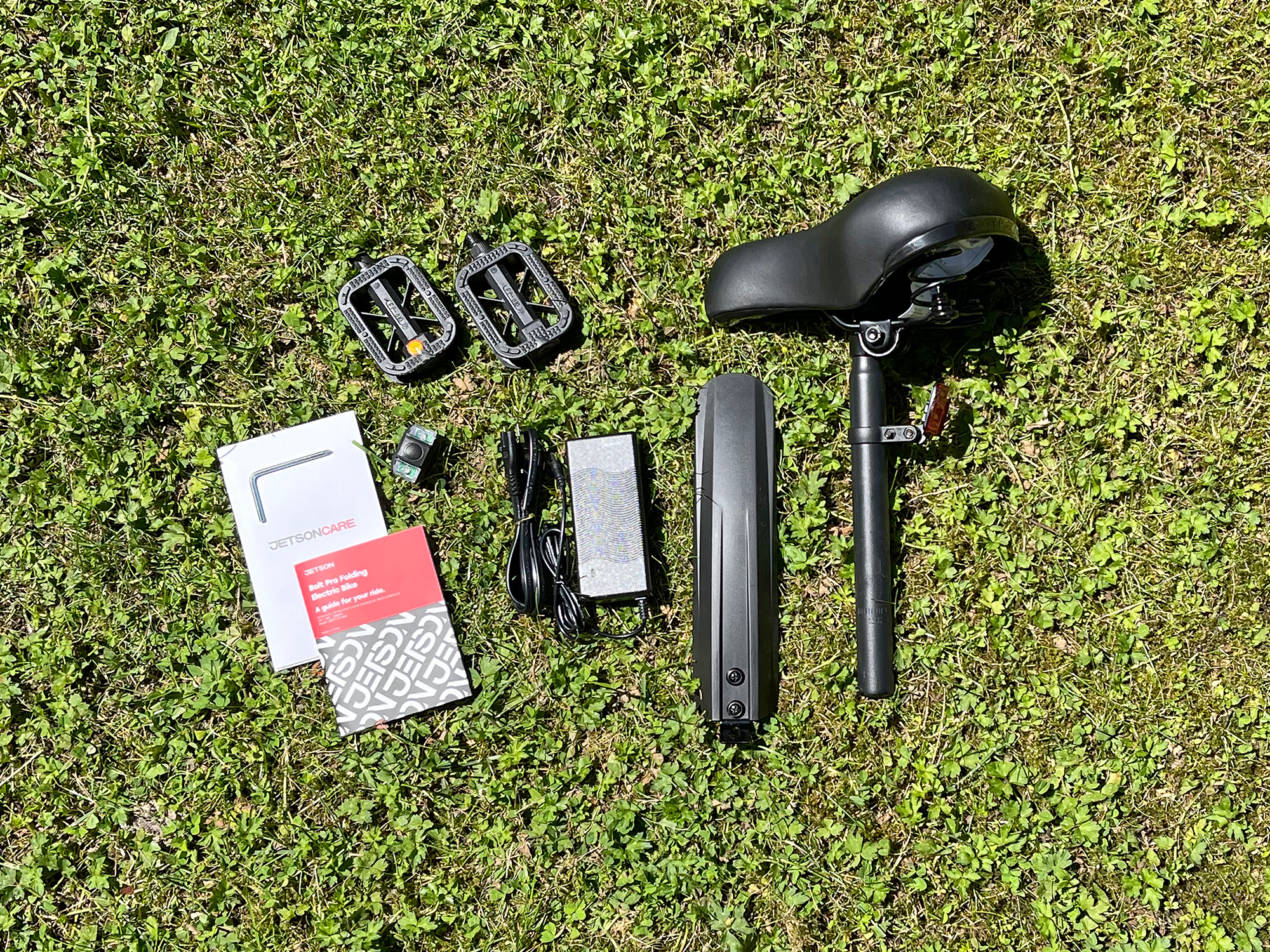

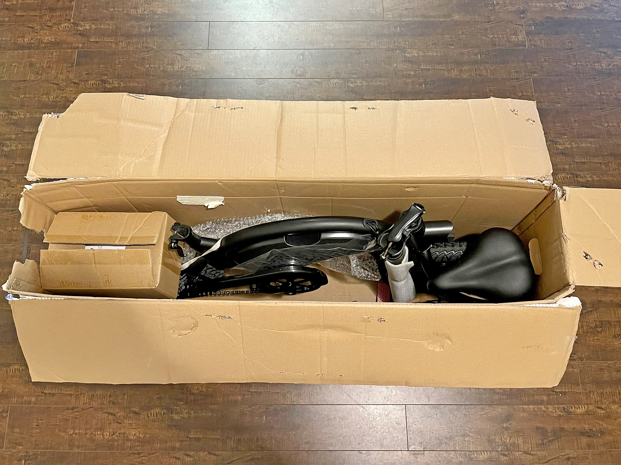

- Fairly easy to unbox and assemble! All I had to do was attach the seat post, pedals, and rear fender, then swivel the handlebar so the brake levers were easier to reach.

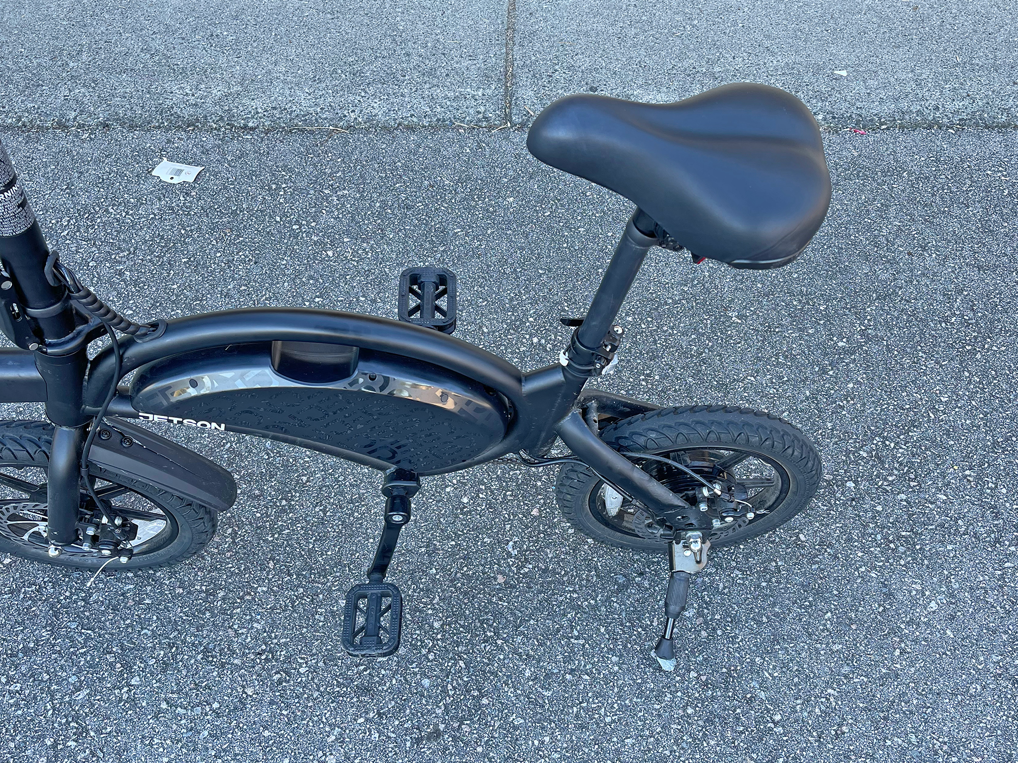

- The extra thick foam saddle has springs built into the bottom, so it really improves ride comfort. This is great, considering the smaller wheel and tire size, and lack of suspension.

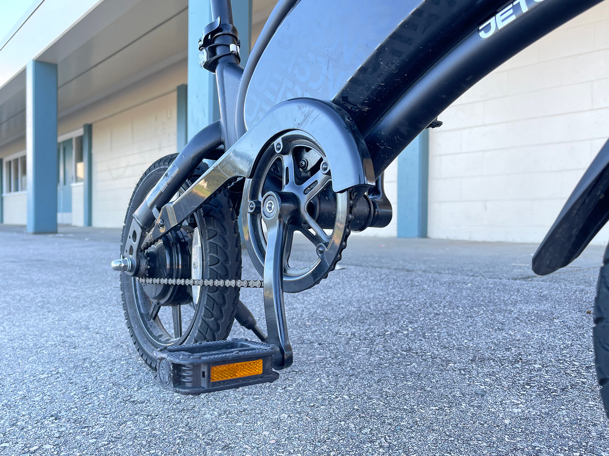

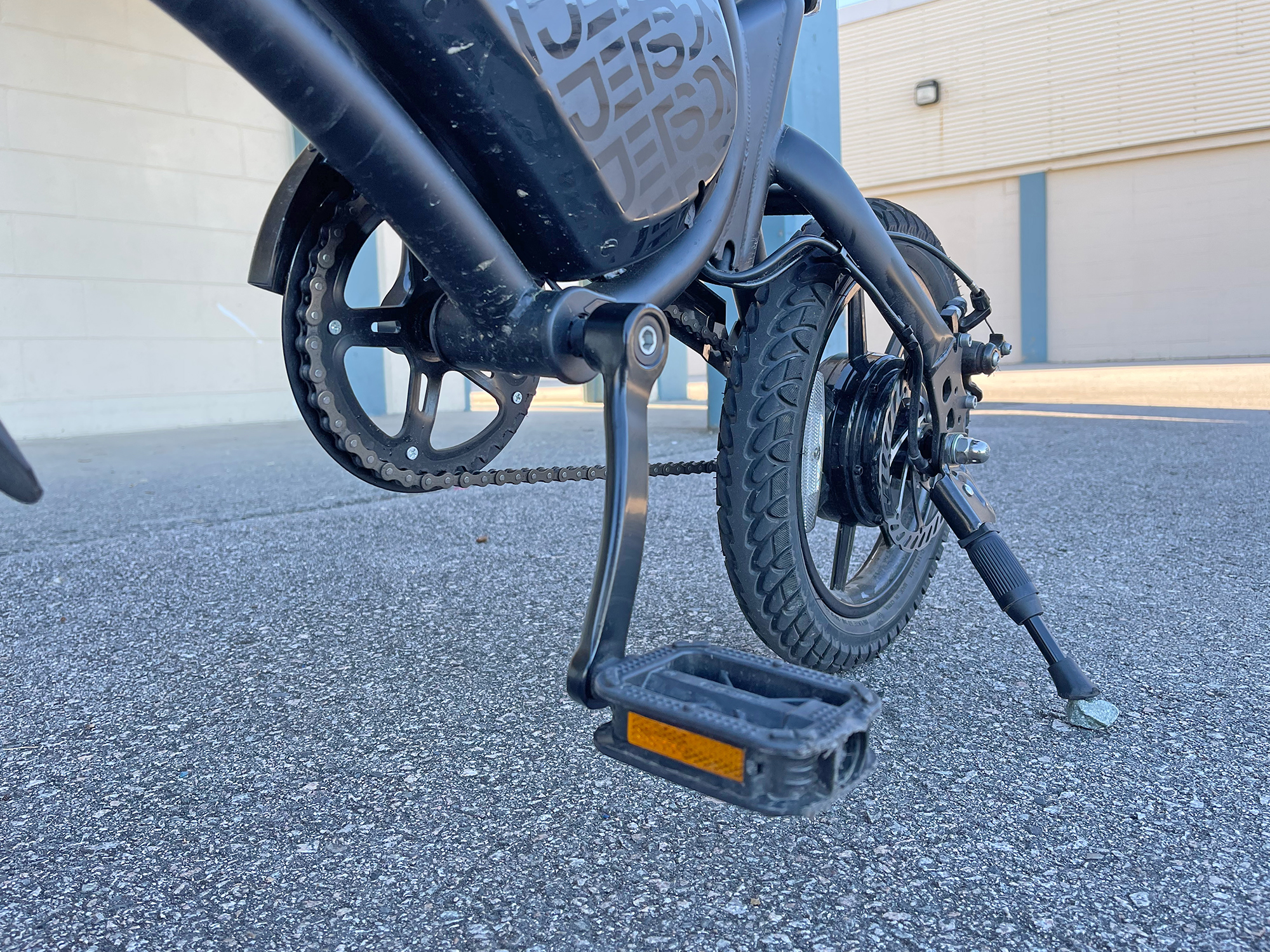

- Jetson added a plastic chainring guard and chain cover to help keep your pants or dress from touching and snagging on the chain! The single-speed chain is unlikely to fall off and operated smoothly for me.

- While the bike doesn’t fold in half, the handlebar does fold down to the side and the saddle and seat post can be removed to make it very compact. You could even unscrew the pedals or replace them with folding pedals like these.

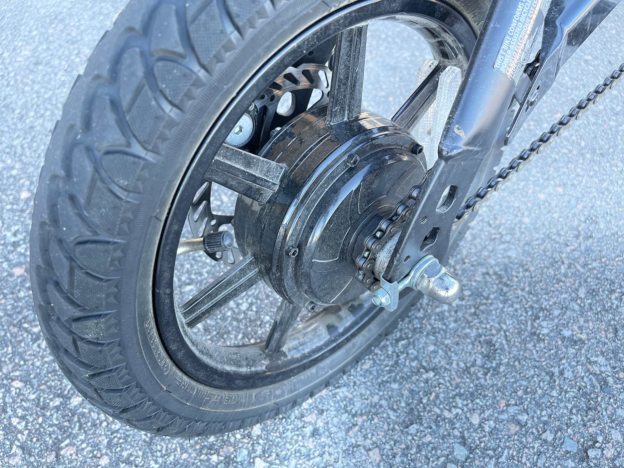

- I appreciate that they routed the motor power cable between the frame and rear disc brake rotor vs. inserting on the right side through the axle. It seems well protected and should be more durable here.

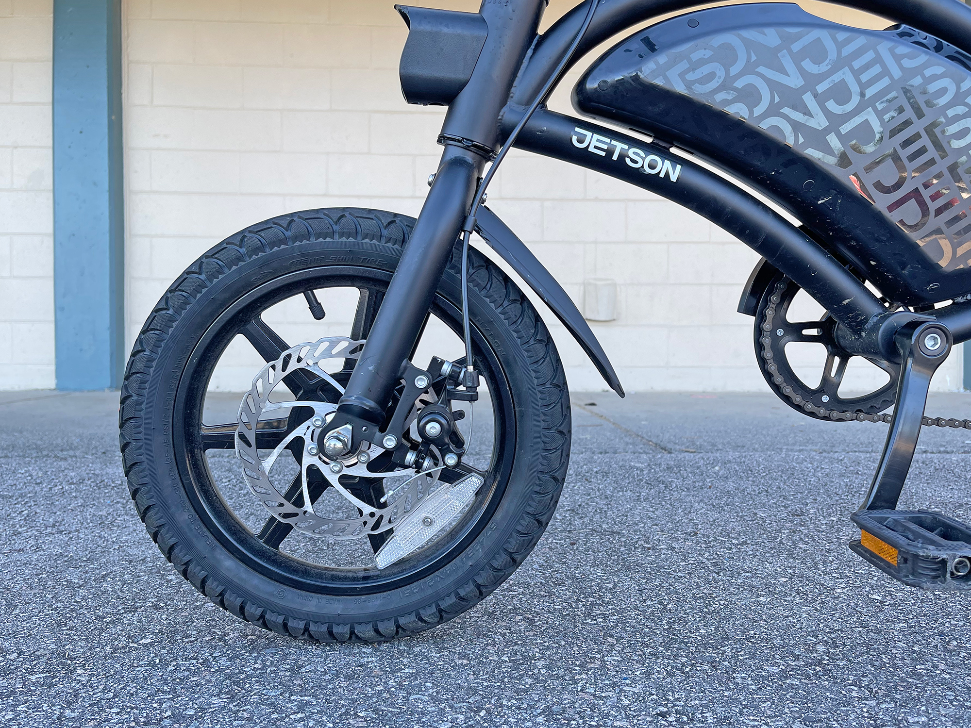

- The mechanical disc brakes worked well, and both brake levers have motor inhibitors for added safety! Mechanical brakes tend to be easier to adjust, and I appreciate the way that the housing for the wires both pointed down so water and dust wouldn’t enter as easily.

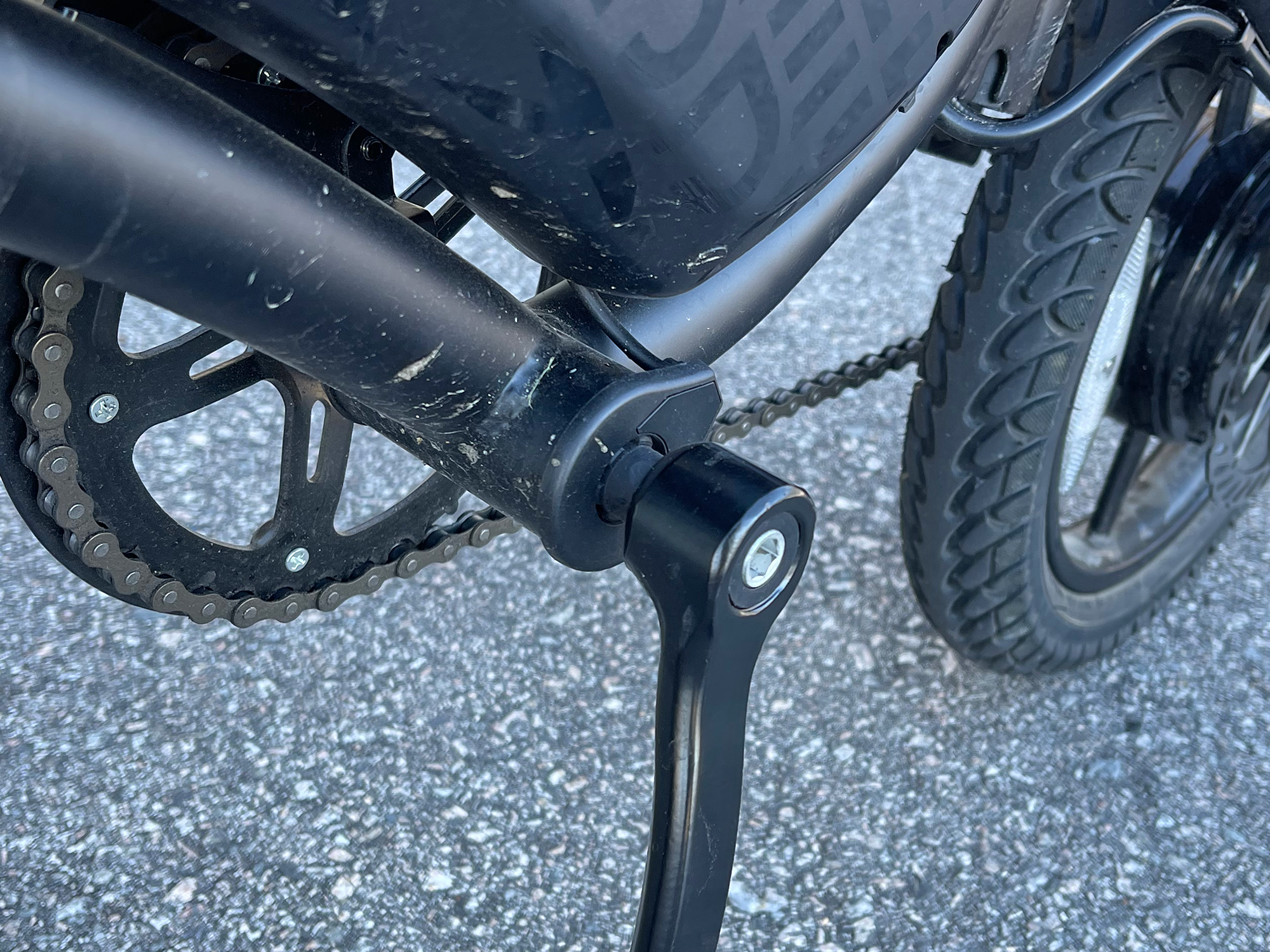

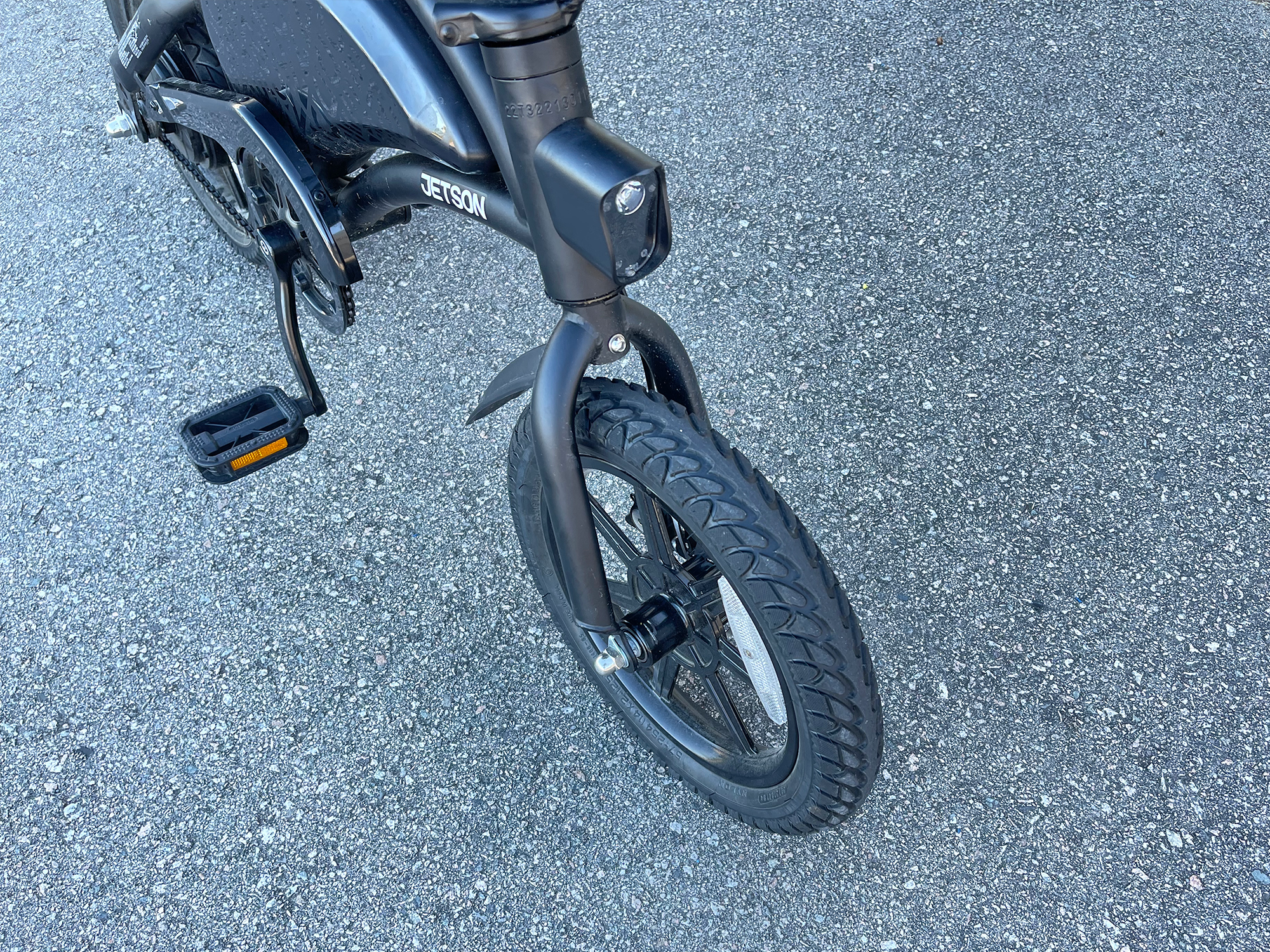

- The charging port for the battery is located near the bottom of the pack on the left side of the frame, directly in the path of the left crank arm. I found it difficult to reach and felt it was vulnerable to getting snagged if the cranks turn while plugged in.

- The unique 14″ wheel size isn’t as common as 26″ or 28″ which could make finding replacement inner tubes more difficult. I saw them for sale on Amazon. The tires do not have puncture protection, so avoid stickers.

- This is a minor complaint, but the saddle clamp is difficult to adjust because it uses two nuts (so you might need two tools) and it can spin easier than a forged clamp that is built into the seat post. This is cheap old-school hardware that I remember from my very basic bikes as a kid.
- The smaller wheel size decreases ride comfort, due to the higher attack angle and lower air volume. There’s no suspension fork, but the sprung saddle felt decent, and the lower top speed improves comfort a bit.

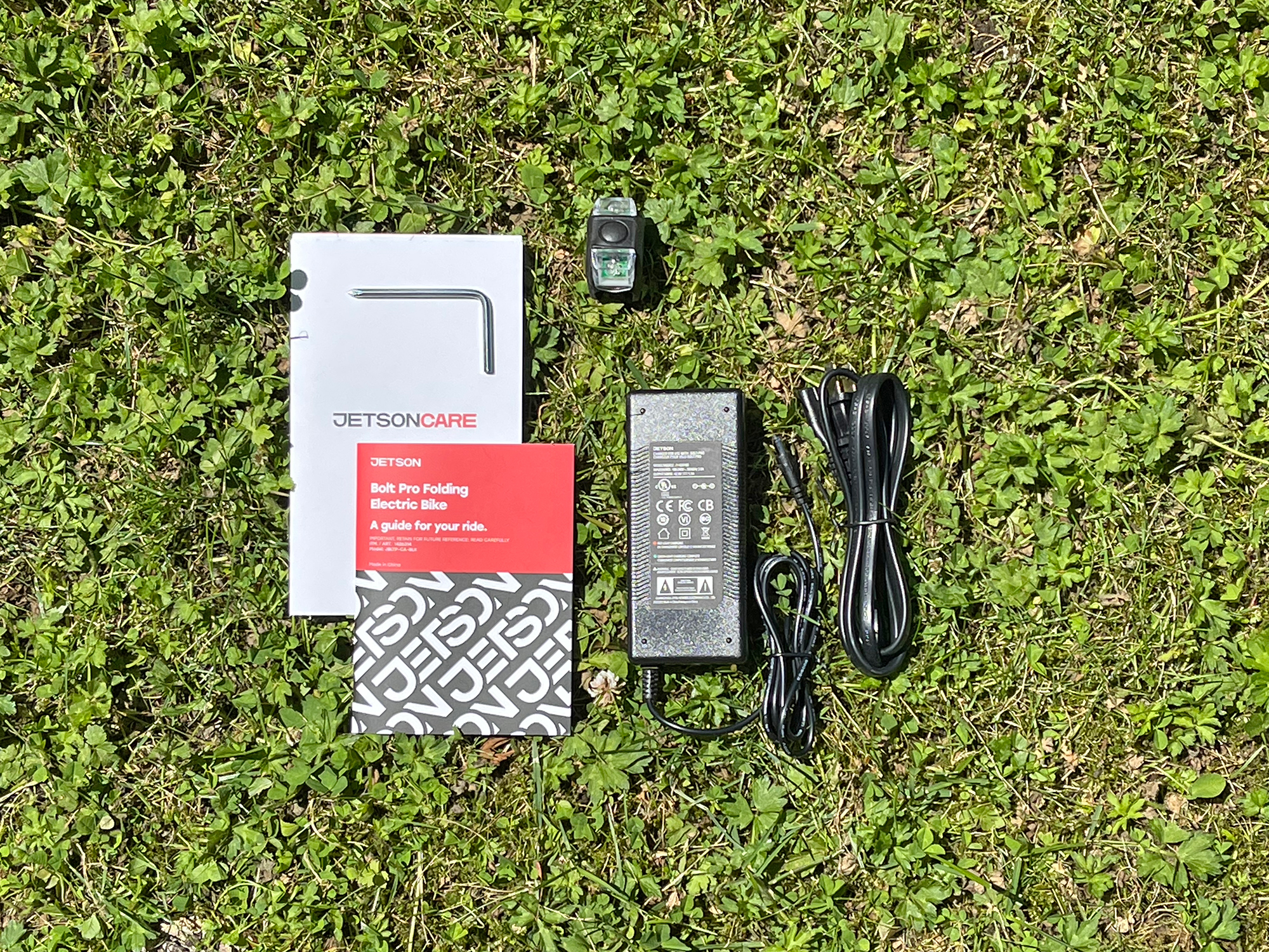

- The battery charger is very small and light at 0.6lbs but also slower than average at 1.5 amps. The pedals are cheap and basic, but actually better than I expected! They worked fine. There’s no bottle cage mount, but it does appear that you could try to mount a rear rack or buy the basket accessories that Jetson offers.
