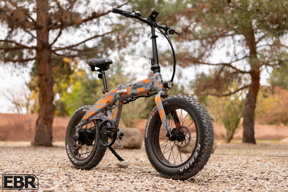

Let’s be honest, most folding e-bikes these days are absolute units. We’re talking 60, 70, even 80+ pounds of battery-powered bulk that you’re somehow supposed to “conveniently” fold up and toss in your trunk. Yeah, right.
So when Jupiter Bike sent over their Defiant for testing, I was genuinely surprised to see it clock in at just 58 pounds. Drop the battery out, and you’re looking at a manageable 52 lbs, which is light enough that you might actually use the folding feature without calling for backup. Although, we still probably recommend you do, you know, for the safety of your back…or your ego.
But here’s where it gets interesting: Jupiter Bike didn’t achieve this weight savings by neutering the motor. The Defiant rocks a beefy 750W rear hub (hitting 1130W at peak) paired with those chunky 20×4″ fat tires that look like they belong on a mini monster truck. It’s like they took a folder to the gym and it actually stuck with the program.
The big question: does a lighter folding e-bike with fat tires and decent power make sense, or is Jupiter Bike trying to have their cake and eat it too? Let’s dig in and find out.
My Experience Riding The Jupiter Bike Defiant E-Bike
Well, it’s a folder with a telescoping flat bar for the handlebars, so let’s just say this isn’t built for performance riders. But folks shopping for folders probably already know that. From a “does it fit” standpoint: sure, it fits just fine. At 5′ 11″ within their advertised range of 5′ 0″ to 6′ 2″, I had no issues getting comfortable.
To be honest, at first glance the Defiant looks small. Maybe that’s due to its lower height and slightly shorter wheelbase. But once you’re on it, the proportions make sense and feel as they should.

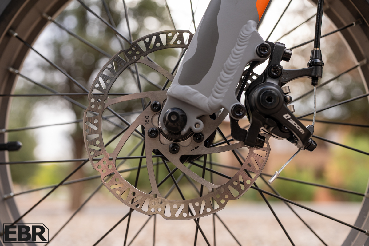

Coming down a larger hill, I was able to get the bike up to speeds cresting 30 mph. While that’s a torture test for any braking system, I found the mechanical disc brakes were up to the task of coming to a safe stop in a reasonable distance.

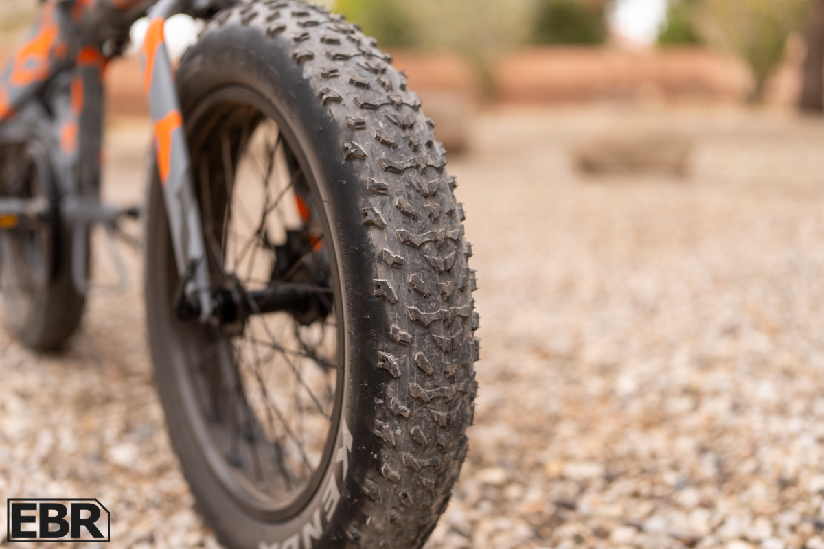

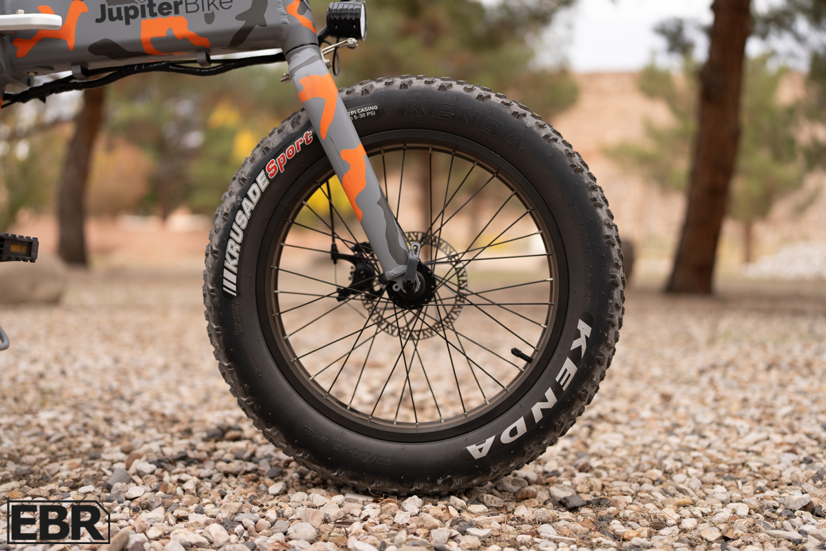

All in all, the bike is super fun to ride. With a little air let out of the 4-inch fat tires, you really don’t feel like you need suspension at all, even though I expected I’d miss it. Airing down is certainly underrated for rigid bike comfort. Now, if you start hitting drops and jumps, that’s likely a more uncomfortable experience, but I didn’t go crazy.

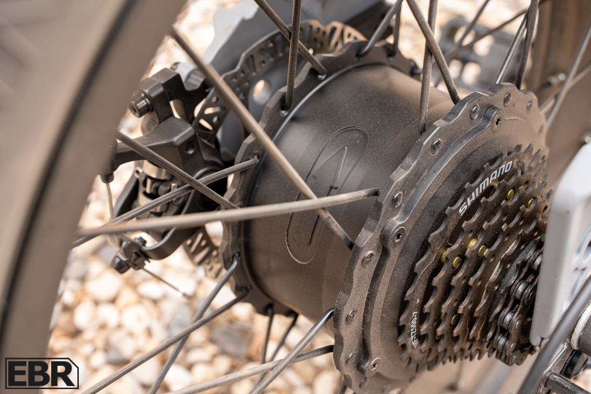

Jupiter Bike equipped the Defiant with a 750W rear hub motor that peaks at 1,130W. While they don’t publish torque specs, the Defiant has plenty of power. The cadence sensor kicks in as soon as your pedals turn and maintains consistent power based on your PAS level. It’s predictable and straightforward, even if it’s not as refined as a torque sensor.

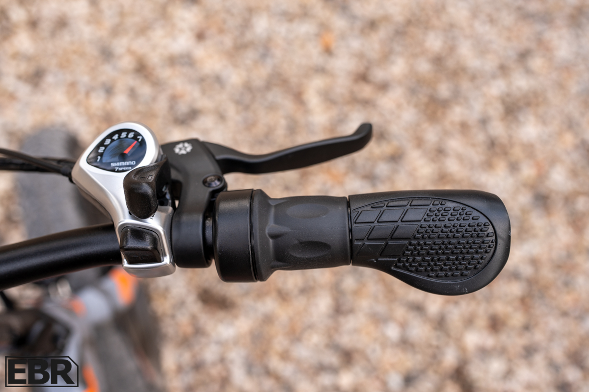

The Defiant keeps things straightforward with its component selection. You’re getting a 7-speed Shimano Tourney drivetrain with a 52T chainring and 14-28T cassette. It’s entry-level stuff, but it’s also pretty par for the course in this segment and price point of e-bikes. Shifting felt reliable during testing, and the gear range handled everything from flat pavement to moderate climbs without issue.
Braking is where things get a bit disappointing. Jupiter spec’d the bike with mechanical disc brakes featuring Zoom calipers and 160mm rotors front and rear. They work, but at this price point (nearing $2,000), I’d really expect to see hydraulic disc brakes. Hydraulics would offer better modulation, require less hand strength, and provide more confident stopping power, especially at speed with those fat tires.

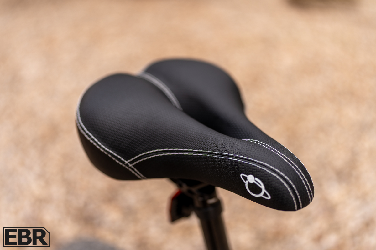

The dual-spring saddle deserves a shoutout. It’s genuinely comfortable and noticeably cushier than the saddles on most folding e-bikes I’ve tested. Combined with the 20×4″ fat tires, it does a solid job of smoothing out bumps.
Speaking of the bumps, there is no suspension on the Defiant. While this keeps weight down and makes cornering feel crisp and predictable, you’re relying entirely on the tires and saddle for cushioning. For riding on paved paths and packed dirt, it’s fine. Anything chunkier and you’ll start to feel it unless you air down quite a bit, which is a nice perk of having fat tires that are 4.0.

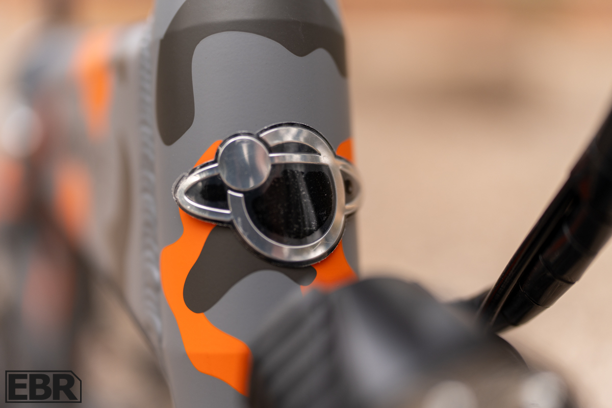

Folding the Jupiter Bike Defiant
The Defiant’s folding process is straightforward and easier than most folders, largely thanks to its lighter overall weight. The whole operation takes about 30 seconds: fold the pedals inward, collapse the telescoping stem, open the frame’s hinge latch, and fold it in half. The bike folds down to roughly 38.5″L x 21″W x 27″H, which is pretty compact for a fat tire folder.
One thing to note: if you want to remove the battery while the bike is folded, you’ll need the key that locks it into the frame. It’s a minor detail, but worth remembering if you’re planning to stash the battery separately for security or weight savings.
Like most folding e-bikes, the cables run near the hinge point. Keep an eye on them over time to make sure you’re not pinching or stressing the wiring when folding and unfolding. It’s an easy habit to develop, and it’ll save you headaches down the road.

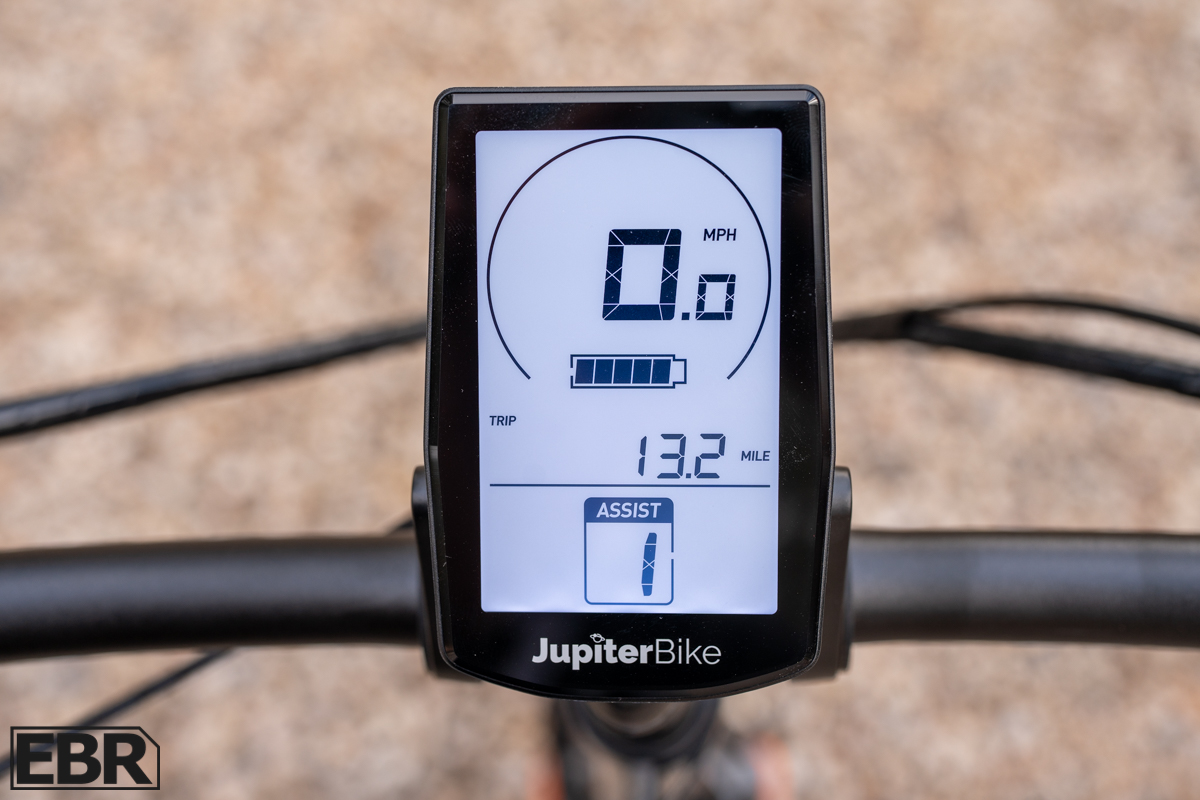

Screen / User Interface / App
The display is straightforward and keeps with the overall spec of the Jupiter Bike Defiant. It’s a decent size (about 3.5 inches) with a duo-tone LCD that shows all the basics: speed, PAS level, battery level, and odometer. Tapping the power button cycles through extra data metrics like average speed, top speed, trip meter, and time on the bike.
Want to dive into settings? Hold the plus and minus buttons on the PAS control for about 3 seconds to access the advanced menu. It’s easy to navigate and keeps things simple with just the essentials: switching between Class 2 or 3, adjusting screen brightness, and setting the auto-off timer.
There’s no app connectivity, which honestly makes sense for this bike. It’s a no-frills approach that keeps things reliable and uncomplicated.
