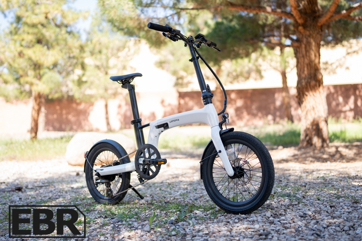

I was sent the gloss white for testing and it’s a clean look, especially with that raw carbon fiber accent strip running along the top tube. It’s subtle, not flashy, but it gives the bike a more premium appearance than you’d expect at this price point. The matte burnt orange is the one that caught my eye when I saw it in person though, that’s the colorway I’d probably pick if I were buying one. There’s also a Glacier Blue and a black rounding out the lineup, and that carbon accent carries across all four.
The bike does look compact as you walk up to it, which is kind of the point. Urtopia rates the fit for riders between 5’1″ and 6’1″, and at 5’11” I found that to be pretty accurate. I had room left in both the seatpost height and the handlebar adjustment, so I wasn’t maxing anything out. If you’re pushing toward 6’1″ you’ll probably be close to the limits, and anyone meaningfully taller than that should really try before they buy.

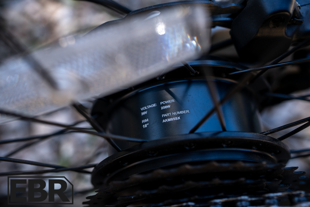

Motor performance is smooth and quiet, which is the consistent Urtopia thing at this point. The 250W motor peaking at 500W with 42Nm of torque doesn’t sound like a lot on paper, but on a bike this light it feels plenty capable without ever being jerky or unpredictable. Acceleration builds naturally, the zero-latency torque sensor keeps things feeling like you’re actually riding rather than just being pushed, and there’s zero motor whine. Every Urtopia I’ve ridden has had this same quiet, smooth character and the Fold 2 is no different.

The Carbon Fold 2 runs the same 250W nominal motor you’ll find in the ST, peaking at 500W with 42Nm of torque. It uses a torque sensor for pedal assist, so the bike is reading how hard you’re actually pushing rather than just clocking wheel rotation. It’s not an exotic setup, but Urtopia has been running this system long enough that it feels dialed, smooth power delivery, no weird surges, just a natural assist that gets out of your way.

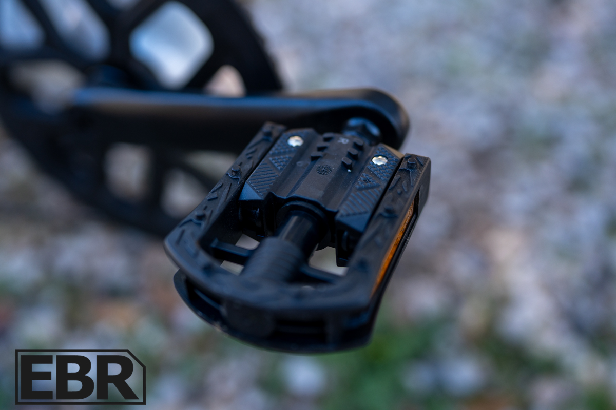

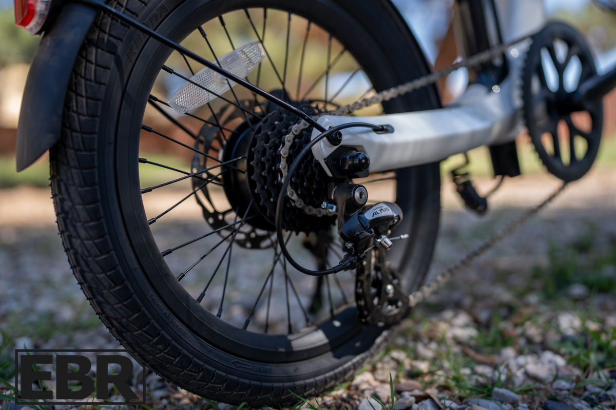

The Carbon Fold 2 runs a Shimano 8-speed drivetrain, which gives you a solid range of gears to work with across varied terrain. The pedals are plastic folding units, which is the right call on a folder, they tuck out of the way when you’re carrying or storing the bike, and it’s one of those small details that adds up when you’re actually living with the bike daily.

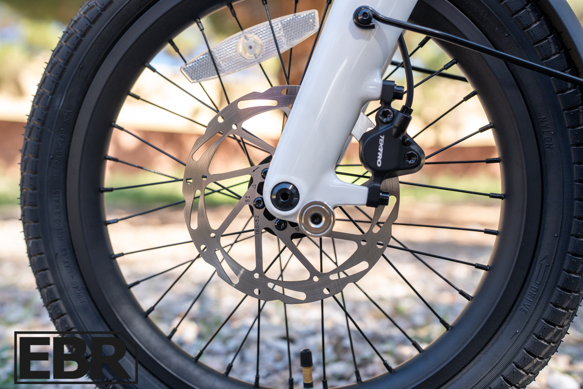

Stopping power comes from Tektro 2-piston hydraulic disc brakes with 160mm rotors front and rear. Hydraulics at this price point and weight class is the right choice, consistent, reliable stopping without adding meaningful weight to the package. The brake levers also have motor cutoff sensors built in, so the moment you grab a lever the motor cuts out. No fighting the assist through a stop, it just gets out of the way and lets the brakes do their job.

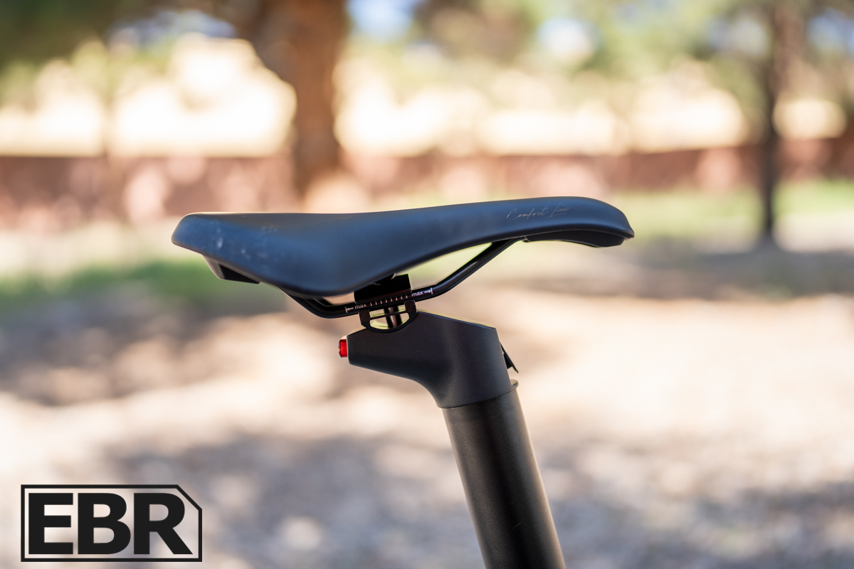

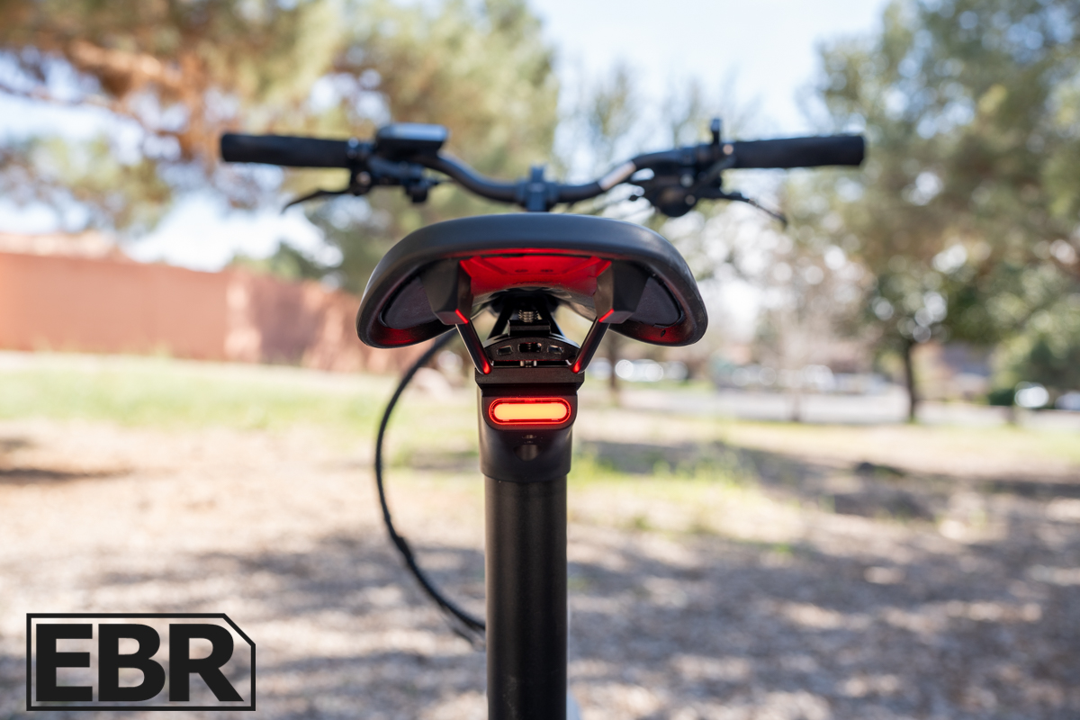

The rear light is integrated directly into the base of the seatpost battery, sitting just under the saddle, and it looks genuinely premium, no bolt-on afterthought tail light hanging off the back, just a clean flush-mounted unit that looks like it belongs there. Urtopia also tucked a hidden AirTag slot under the saddle, which is a small but smart addition for anyone parking this bike in public often.

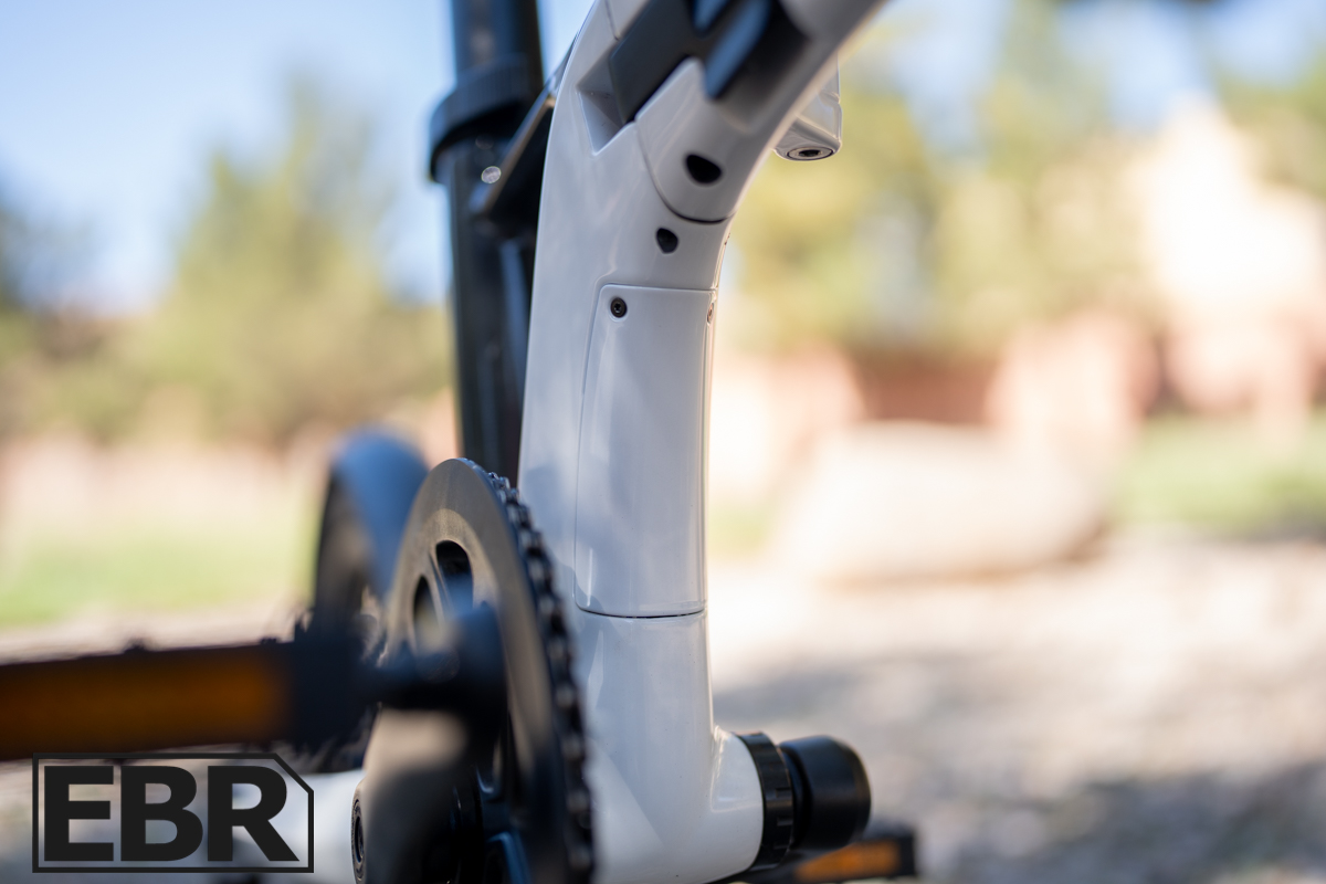

Internal cable routing keeps everything tidy, which is something Urtopia consistently gets right across their lineup. No cables flopping around, the bike looks clean, and the wiring is better protected from the elements long term.

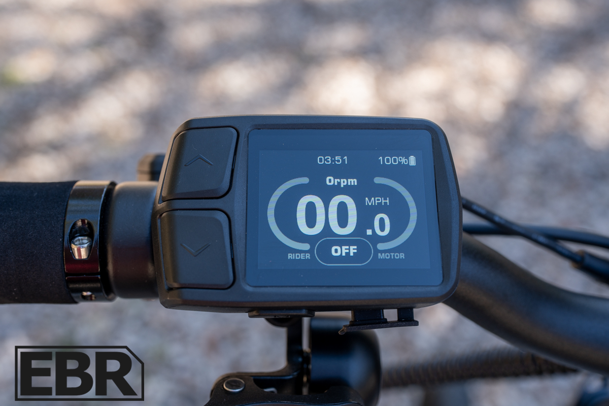

The Carbon Fold 2 uses a small full-color display mounted on the left side of the cockpit. It’s a clean, uncluttered setup with UP/DOWN buttons flanking the screen, a power button on top, and a menu button plus a covered USB-C charging port on the bottom. The USB-C port is a handy addition, enough juice to top off your phone if you need it mid-ride.
The home screen covers all the bases without overwhelming you. Speed, assist level, battery level, motor power, rider power output, and cadence are all visible at a glance, along with indicators for the headlight and throttle when they’re active. Holding the UP button toggles the lights, and holding DOWN kicks on walk mode, which is genuinely useful if you ever need to roll the bike any real distance on foot.
Tapping through the menu pulls up a second layer of data, odometer, trip distance, average and max speed, average and max motor power, and proportional rider power. More than most riders will ever dig into, but it’s there if you want it.
Since the Fold 2 doesn’t pair with a mobile app, all your customization lives inside the display’s advanced menu, accessed by holding the menu button. From there you can adjust screen brightness, walk speed, auto-sleep time, and set a startup password if theft is a concern. You can also tweak the speed limit and do some actual motor tuning to dial in a power profile that matches how you like to ride. The whole menu is in plain English, no cryptic codes or manual required, you can make changes on the fly without needing to pull up a YouTube tutorial.

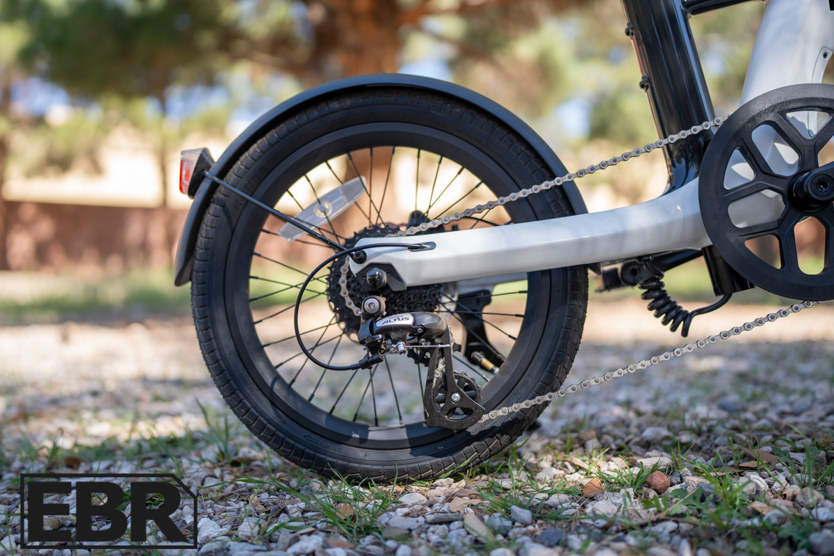

Is it flawless? No, but as I say often, nothing is. I’d prefer to see a protective strip along the chain stay to shield against any chain slaps when the rods get rough. And if you had your heart set on a bike with ‘perfect fit’ for long cycling trips, this probably isn’t the bike for you.

- No chainstay protection, and with a non-clutch rear derailleur the chain sits very close to the frame, seems primed for paint damage if you hit any kind of bumps.
