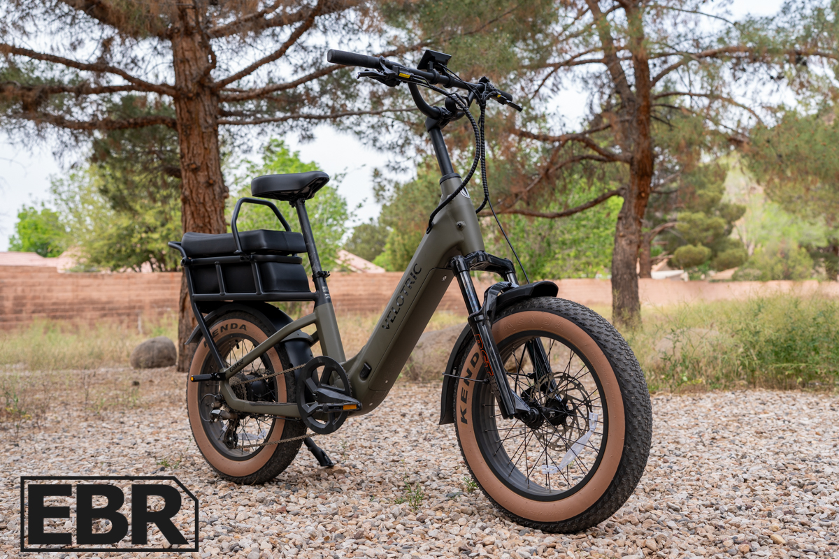

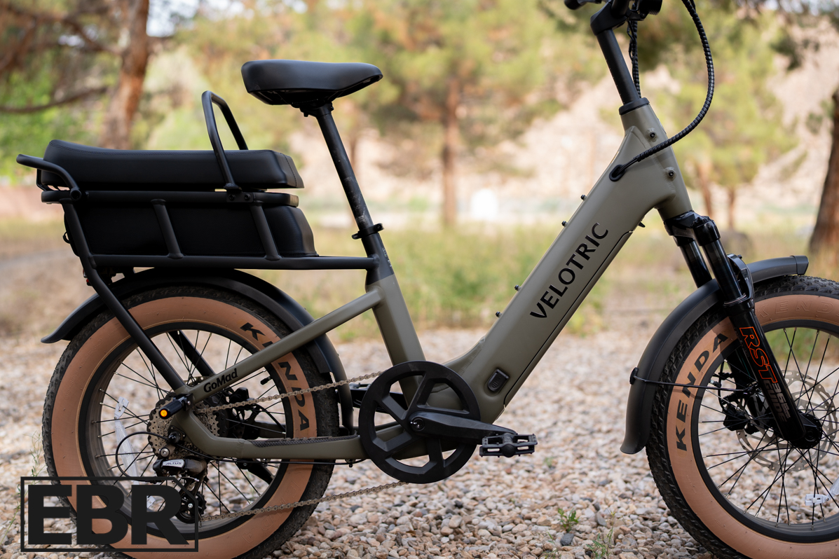

Curb appeal is sharp with the sage green I was sent for testing, really looks good with the tan sidewalls on the 4 inch fat tires and black accents on the cockpit and contact points. Getting on and off is easy thanks to the step-through frame with the lowest point being only 16 inches high.
The kickstand placement in the rear works well, though if you get the young passenger kit it comes with a center mounted dual leg kickstand for more stable stops and starts. That said, I think Velotric should just give the dual leg kickstand as a standard feature in general for a bike billed as a utility and cargo e-bike. It’s safe to assume people will use it that way.
The geo and fit are upright and relaxed, really comfortable. Thanks to the 140mm of vertical adjustability you can actually get proper hand reach placement for most folks, which was a good choice for a one-size-fits-most offering. At my 5’11 height I found myself raising the seat post and handlebars via that 140mm quill stem to dial in a fit I was happy with.

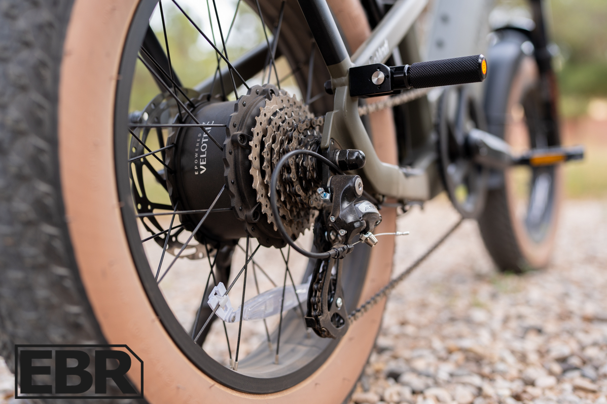

The GoMad uses a rear hub motor with 750W nominal, 1300W peaking and pushing 85Nm of torque. It’s a package that fits the utilitarian role of the Velotric GoMad. The bike comes with both a torque and cadence sensor, and like I mentioned earlier, these two have very distinct differences when it comes to the felt power in each sensor mode.

The battery is fully integrated into the downtube and has a color matched painted cover affixed to the battery. It’s 48V, 16.7Ah and a total of 801.6Wh of power that is UL 2271 certified and has a IPX7 Water Resistance rating, meaning even a monsoon won’t bother your battery, let alone a little rain.

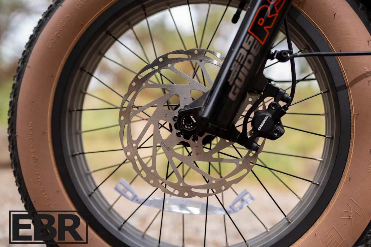

The front suspension is handled by an RST fork with 100mm of travel and beefy 36mm stanchions, which is a smart choice for a bike carrying this kind of payload. It keeps the handling responsive and limits any felt flex. The fork runs a thru-axle interface and comes with both preload adjustment and a lockout.
Braking is covered by Tektro hydraulic disc brakes with 2-piston calipers and motor cutoff sensors. The rotor setup runs a 203mm rotor up front and 180mm in the rear. That larger front rotor helps with heat dissipation and should extend pad life over time.

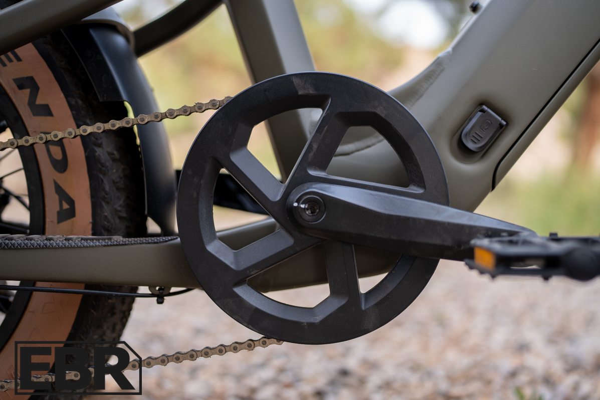

The drivetrain is an 8-speed setup built around a Shimano Altus rear derailleur, an 11-34 tooth cassette and a 52 tooth chainring. Cranks are 165mm aluminum alloy and come with a chain guard to keep grease off your pant leg.

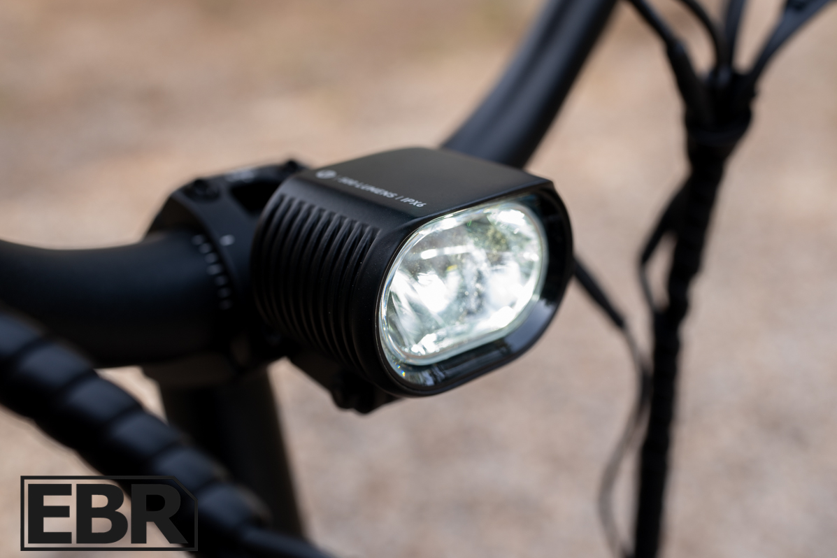

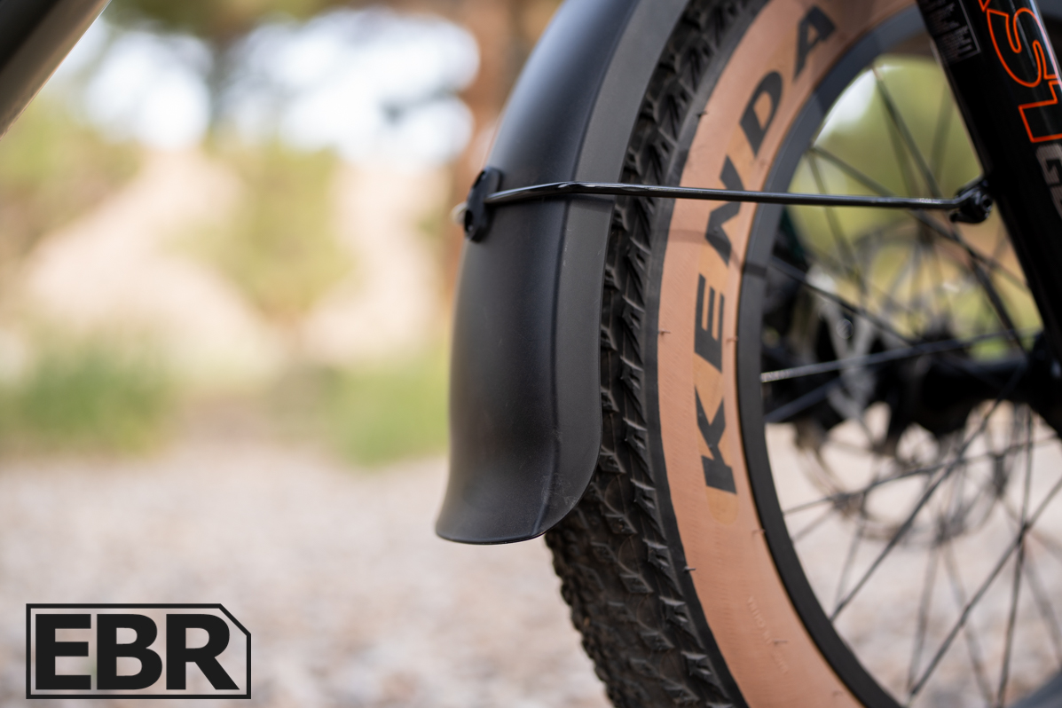

Rounding it out, the GoMad comes fully equipped for daily use. Front and rear fenders, a rear rack rated to 176 pounds, a 500 lumen front LED headlight with adjustable angle, and a rear light with a braking indicator and turn signals integrated in.

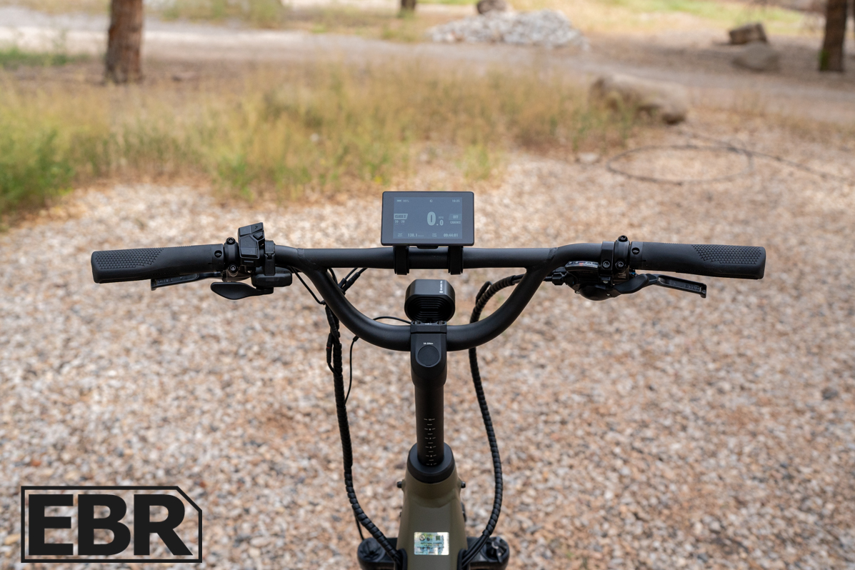

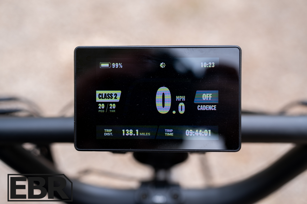

The GoMad’s display is a 3.5” full-color screen that’s actually legible in bright sun without washing out, angle-adjustable to cut glare, and it feeds you the important stuff like speed, battery level, assist mode and range estimate. There’s also a USB-C port on the bottom side of the display that lets you top up your phone while you ride.
Where the GoMad customization options really shine is in the Velotric app. You’ve got selectable Class 1, 2, and 3 modes, plus a custom mode where you can push the throttle out to 28 mph if you want to go beyond what the standard classes allow. You can also dial in individual PAS levels for both pedal assist and throttle, and adjust motor output percentages at each assist level to build a power curve that matches how you actually ride.
For folks who find all that tuning overwhelming there’s a Smart Riding Mode that asks some quick questions about your style and use case, then spits out a sensible baseline you can tweak from there.
Then there’s Experience Mode, which lets you set the overall attitude of the bike. I first saw this on my review of the Velotric Disclover 3 and thought it was a good move then too. You get three options: Smooth, Slow, and Turbo. Each one does exactly what it sounds like, adjusting the general feel of the ride without having to dig into specific torque or power settings. Think of it as a mood dial. You’re not fine-tuning, you’re just picking how you want the bike to feel today and getting on with it.
And because it’s a Velotric e-bike, you get SensorSwap. For the uninitiated, this lets you switch between torque and cadence sensors on the fly. Velotric were early to popularize this and the rest of the market has followed, which tells you everything you need to know about how useful it is. Both sensors have their place depending on how and where you’re riding, and having both means you’re not stuck adapting to whichever one the manufacturer decided to ship. To switch, just hold the M button on the display and it changes instantly. Simple, and genuinely useful when you’re moving between surfaces.
On the security side the GoMad has NFC keyless unlocking so you can tap your phone or a card to get going, and the app ties into Apple Find My and Android Find My networks. If you forget where you parked or the bike gets stolen you can track it through your phone. It’s a nice layer of protection, though obviously you’re still going to want a solid lock.
