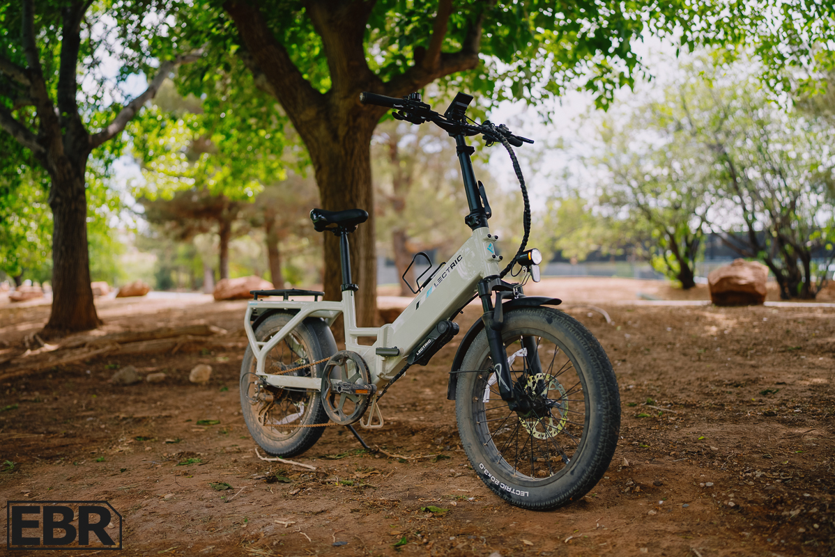

The Lectric XP4 catches your eye with a redesigned frame that’s a solid step up from past models. Softer lines, a sharper look, and a stiffer chassis make for a more responsive ride. Geometry tweaks tighten up handling, too. My review unit was the clean and crisp step-through (ST) in Stratus White, but Tempest Grey is another option. The 750W version tosses in Pine Green and Raindrop Blue for extra pop.
Hop on, and the XP4’s zero-degree stem shortens the reach, fixing the slightly stretched feel of the XP 3.0. It fits riders from 4′ 10″ to 6′ 3″ across step-through and high-step frames. At 5 ’11”, I found the upright position comfy for cruising, though it’s not meant for hammering down trails. The fit keeps rides chill and relaxed.

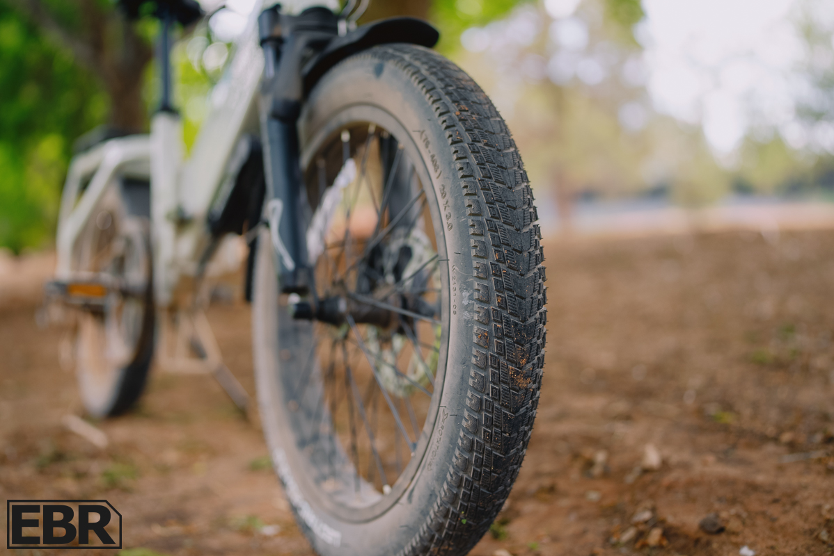

Comfort’s on point. Lectric’s custom saddle, with spring supports and thick foam, eats up vibrations, and the front suspension fork softens bumps. The 3-inch-wide tires, with a new tread pattern, roll quieter and a bit faster on pavement. On rougher stuff, though, the suspension feels underdamped, letting some jolts sneak through.

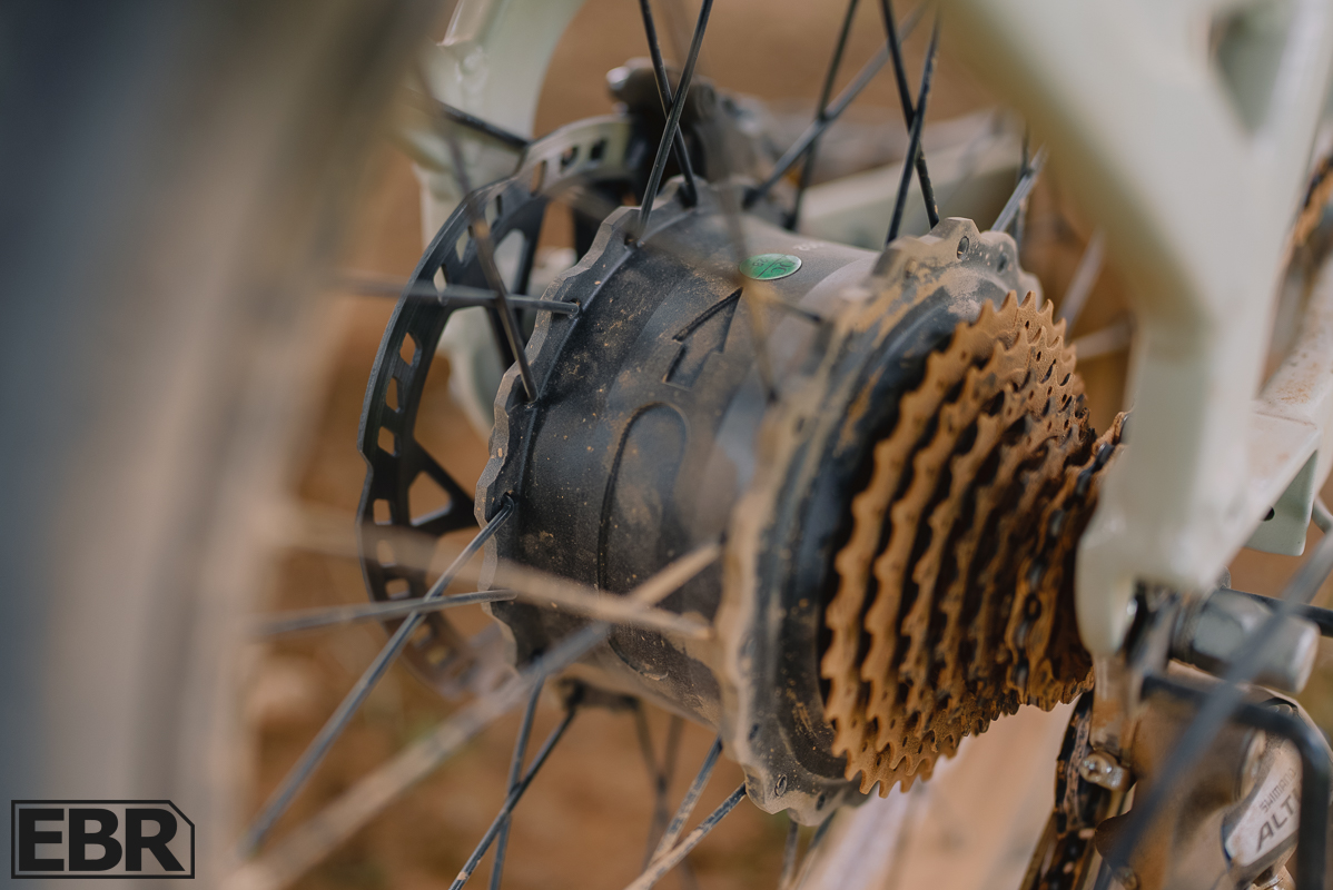

Shifting’s handled by an 8-speed Shimano Altus groupset, a nice bump from the XP 3.0’s 7-speed Tourney. The 58T chainring and 11-32T cassette give a wider range, useful for mixed terrain, though it’s not a game-changer. It’s a solid upgrade that adds flexibility.

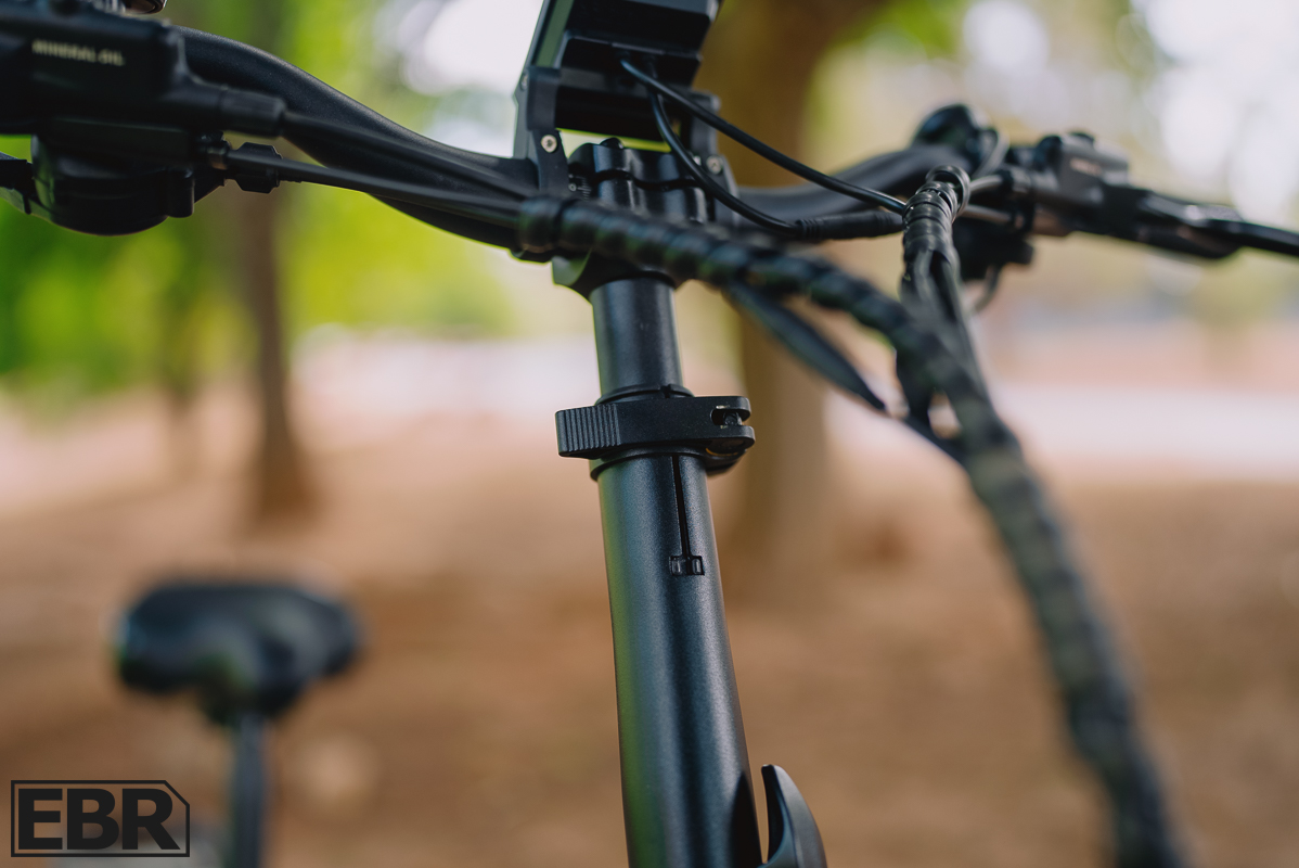

Folding the XP4 takes 15–20 seconds: lower the stem, pop the frame latch, and swing the halves together. It’s easy, but paint scuffs where the fender mount and axle bolt rub the frame and fork are a bummer. Protective film fixes it, but it’s a design miss. Unfolded, the XP4 ST 500W is 66 x 18.5 x 47 inches; folded, it’s 37 x 17 x 29 inches. It’s hefty, as expected for an e-bike weighing on my scale at 70.7 lbs.

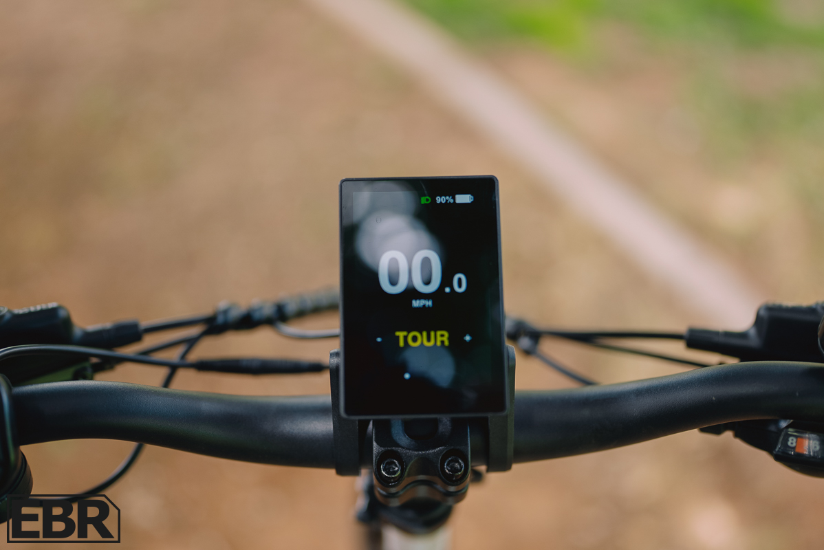

The 3.5” color display shows a numerical battery percentage and a visual bar meter, but it moves in 10% increments (100%, 90%, down to 0%). This lack of precision means you need to plan carefully below 30%—head toward your destination, not further out. I prefer a more granular readout but adapted quickly and learned to work with it. The battery is removable for easy charging, and my test bike came with the optional 5A charger, which juices it up in about 2.5 hours—blazing fast. For commuters, weekend cruisers, or urban riders, the 10.4Ah battery covers most needs.

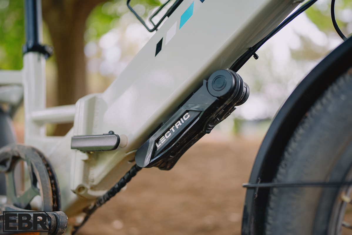

The 48V, 10.4Ah (499Wh) battery, UL 2271-certified, powers up to 50 miles (I hit 44 miles—see Range section). The $200 17.5Ah (840Wh) Long-Range battery claims 85 miles, ideal for big rides. My test bike’s optional 5A charger filled the 10.4Ah battery in 2.5 hours.
Best of all, Lectric axed the annoying key-in-ride requirement from past models—no more keys dangling mid-ride. The non-drive-side key slot and charging port streamline startups and charging.

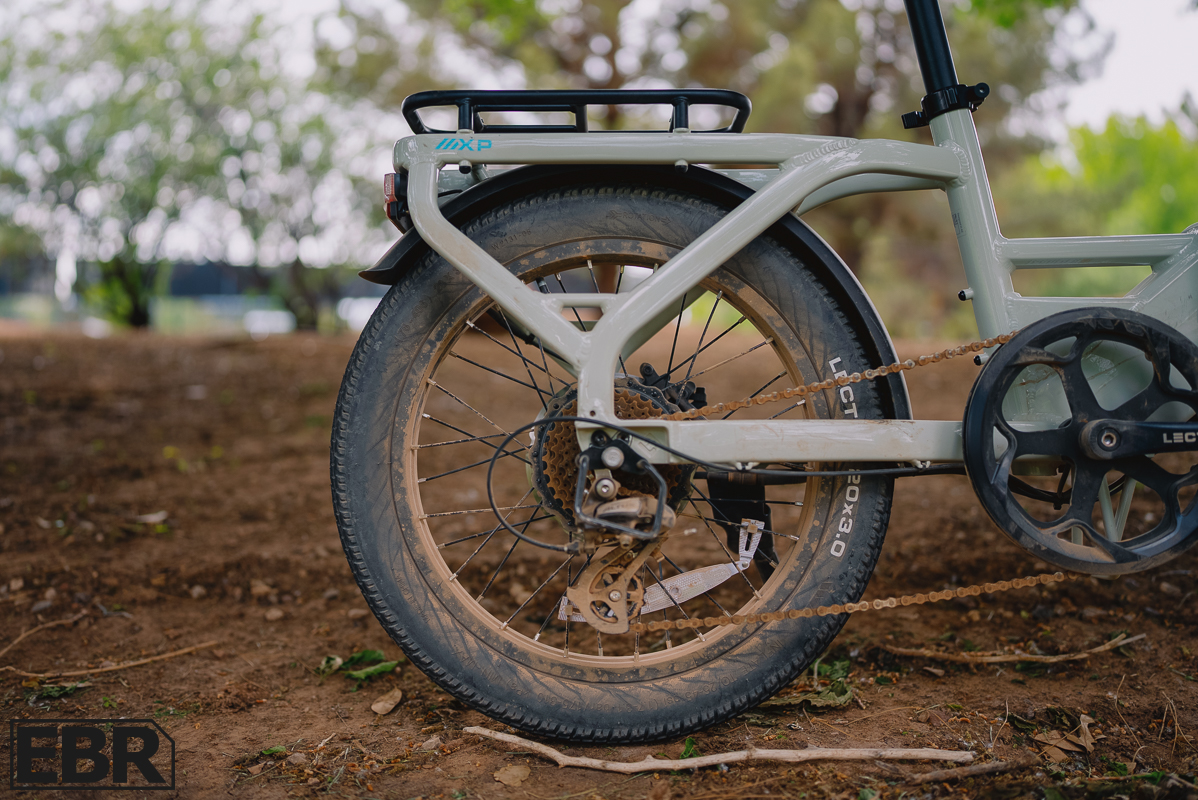

The heart of the XP4 is its fully redesigned folding frame, crafted from 6000 series aluminum for improved durability and even adding a few extra accessory mounting points. Beyond its sleeker, modern look with softer lines, the frame is stiffer than the XP 3.0’s, delivering a more responsive and planted ride.
Lectric also shortened the reach with a new zero-degree stem, fixing the slightly stretched-out feel of its predecessor. This tweak, paired with a flat bar featuring a slight rise and full-length ergonomic lock-on grips, creates a comfy, upright position, improved from the 3.0.

Up front, a coil-spring suspension fork with 50mm travel, 30mm stanchions, preload adjustment, and lockout smooths out bumps. It’s fine for urban paths and light trails but feels underdamped on rougher terrain, letting some jolts through. The 20″ aluminum wheels are paired with 20″ x 3″ mixed-terrain tires, sporting a new tread pattern that rolls quieter and faster on pavement while gripping decently off-road.
The drivetrain sees a solid upgrade with an 8-speed Shimano Altus groupset, a step up from the XP 3.0’s 7-speed Shimano Tourney. The Altus rear derailleur, paired with an 11-32T cassette and 56T chainring, offers a wider range for mixed terrain, shifted crisply via Altus trigger levers. It’s not revolutionary, but the extra gear and sharper shifting add flexibility for climbs and cruising.

The Lectric saddle, with spring supports and plush foam, soaks up vibrations for all-day comfort. New 6000 series aluminum quick-release pedals are a big win over the XP 3.0’s plastic folding pedals and the XPeak’s less reliable quick-release set. These install fast, stay secure, and feel solid underfoot—a dialed-in upgrade that just works.

The Lectric XP4’s display is a massive leap forward, ditching the clunky black-and-white, calculator-style screen of past models for a modern, user-friendly setup. Say goodbye to deciphering cryptic codes with a second manual—the new 3.5” full-color TFT display is detachable for security, crystal-clear, and intuitive. It even includes a USB-C charging port to keep your phone or devices juiced on the go.
Every menu and screen uses plain language, making navigation a breeze, even in the advanced settings. Tap the power button to cycle through two new data screens: one for ride metrics (speed, distance, time) and another for power metrics (dynamic voltage, amps, input/output watts, pedal cadence). These give you a deep dive into the bike’s performance, helping you understand its range and personality—perfect for data nerds or anyone optimizing their ride.
The Bike Classification menu is equally straightforward, offering Class 1, 2, and 3 options to toggle between 20 mph throttle/assist or 28 mph pedal assist where laws allow. The “California Class 3” setting is a clever addition, a workaround for California’s new eBike laws. It enables 28 mph pedal assist but turns off the throttle entirely (even at 20 mph) to stay compliant. It’s a thoughtful nod to regional riders.
Lectric still skips a companion app, likely to keep the XP4’s price at a jaw-dropping $999 by avoiding the costs of an IT team. While the display’s simple, effective UI is a home run, I’d love to see connectivity in an XP5. An app could enable over-the-air updates to refine the battery meter’s 10% increments (noted in the Range section) or tweak motor and controller settings. For now, though, this display’s clarity, data, and ease of use make it a standout at this price point.

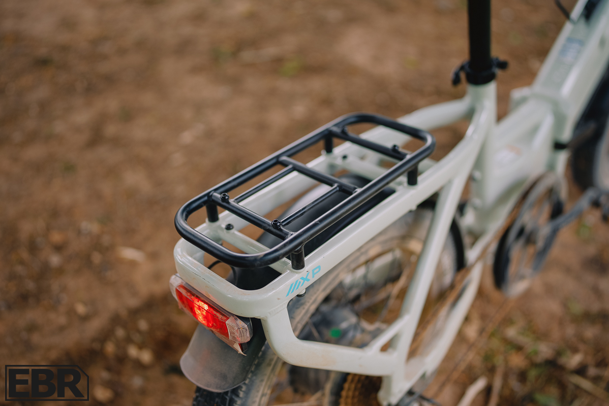

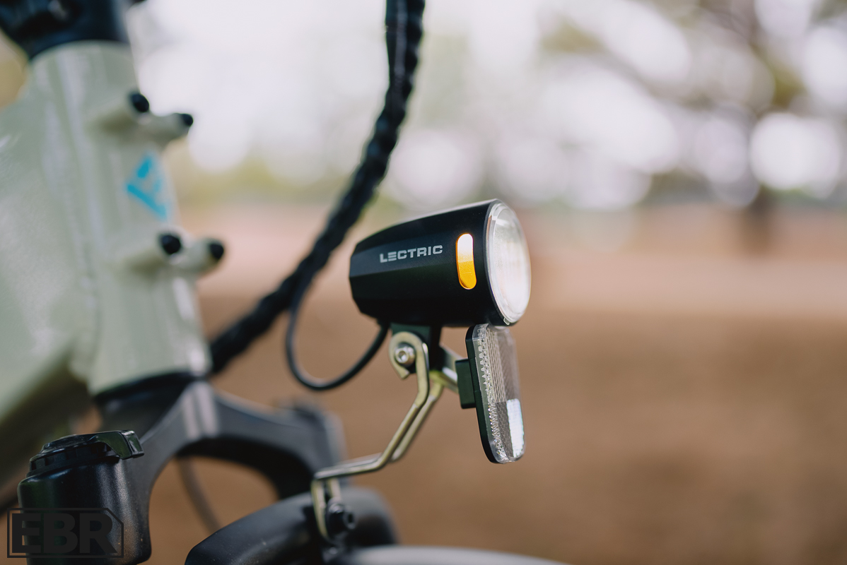

Every XP4 includes practical accessories like a 90-lumen LED headlight with adjustable angle, rear tail light with brake light and corner-flashing turn signals, and a LevelUp rear rack rated for 150 lbs, compatible with Lectric’s Buddy or Yepp seats. You also get full-length black polypropylene fenders—my preference over metal since they don’t rust, rattle, or bend.
