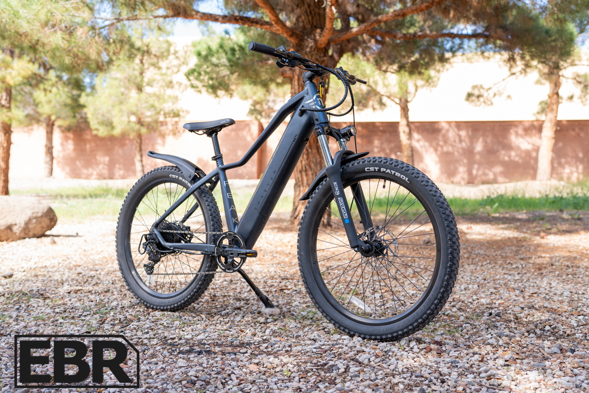

The Magnum Peak 2.0 has a bold stance that can’t be ignored. Between the chunky 2.8” off-road tires, the 140mm front suspension fork, and the beefy 720Wh battery tucked neatly into the downtube, it looks ready for business. The sleek Velofox DM13 color display is integrated right into the top tube, complementing the no-nonsense graphite colorway and black accents. If that’s too grim for your taste, they offer a few other colors, but personally, this one fits my style perfectly.
Hopping on the Peak, you’ll notice the mid-step frame has a slanted downward tube to help you get a leg over. The riding position is exactly what you’d expect from a bike with off-road chops: a slight forward lean that balances your weight between the saddle and the ergonomic lock-on grips.
After dialing in my tire pressure and adjusting the fork’s preload and compression, I spent several weeks testing it in every scenario imaginable, from the daily commute to off-road escapades on Southern Utah’s beautiful (but unforgiving) gravel roads and green-line MTB singletracks. If you’re ever in Southern Utah and want a mild but insanely fun green line that’ll make any rider smile, check out the Bearclaw Poppy Navajo Trailhead.
While the Peak 2.0 isn’t a dedicated “eMTB,” it holds its own on beginner singletrack. You’ll feel that weight in the rear hub motor, sure, that’s expected, but the frame geometry, CST Patrol tires, and 140mm of forgiveness from the SR Suntour fork team up for some serious fun on tamer trails. The motor power is something you notice early on.

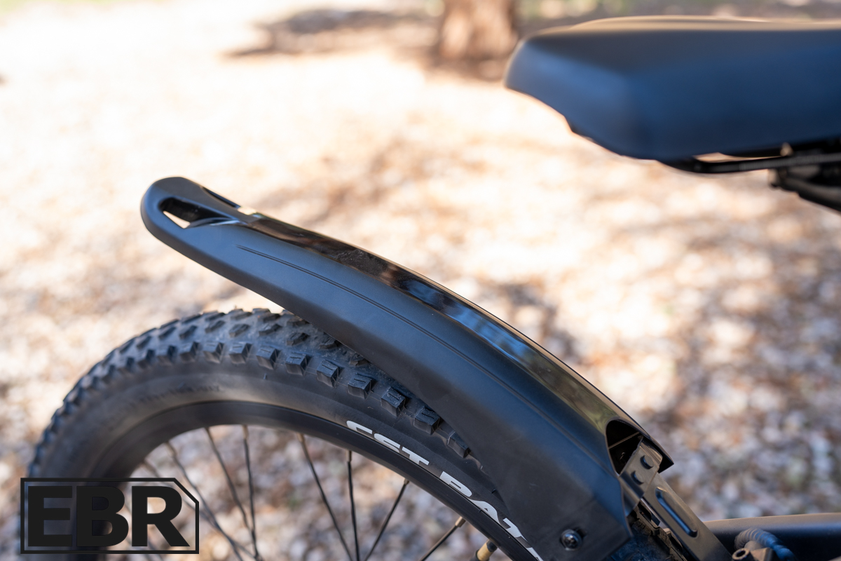

The integrated top-tube LCD keeps the handlebars clutter-free and looks premium. You can quickly jump into settings to switch from Class 2 to Class 3 (unlocking 28 MPH speeds). It comes “SUV-ready” with front and back “lite” fenders (off-road focused), a 100-lumen adjustable headlight, and plenty of mounting points for a rear rack or bottle cages. Overall, the Magnum Peak 2.0 hits that “sweet spot” in the affordable e-bike segment. It lets owners be mild or go wild, and that’s exactly what a good SUV e-bike should do.

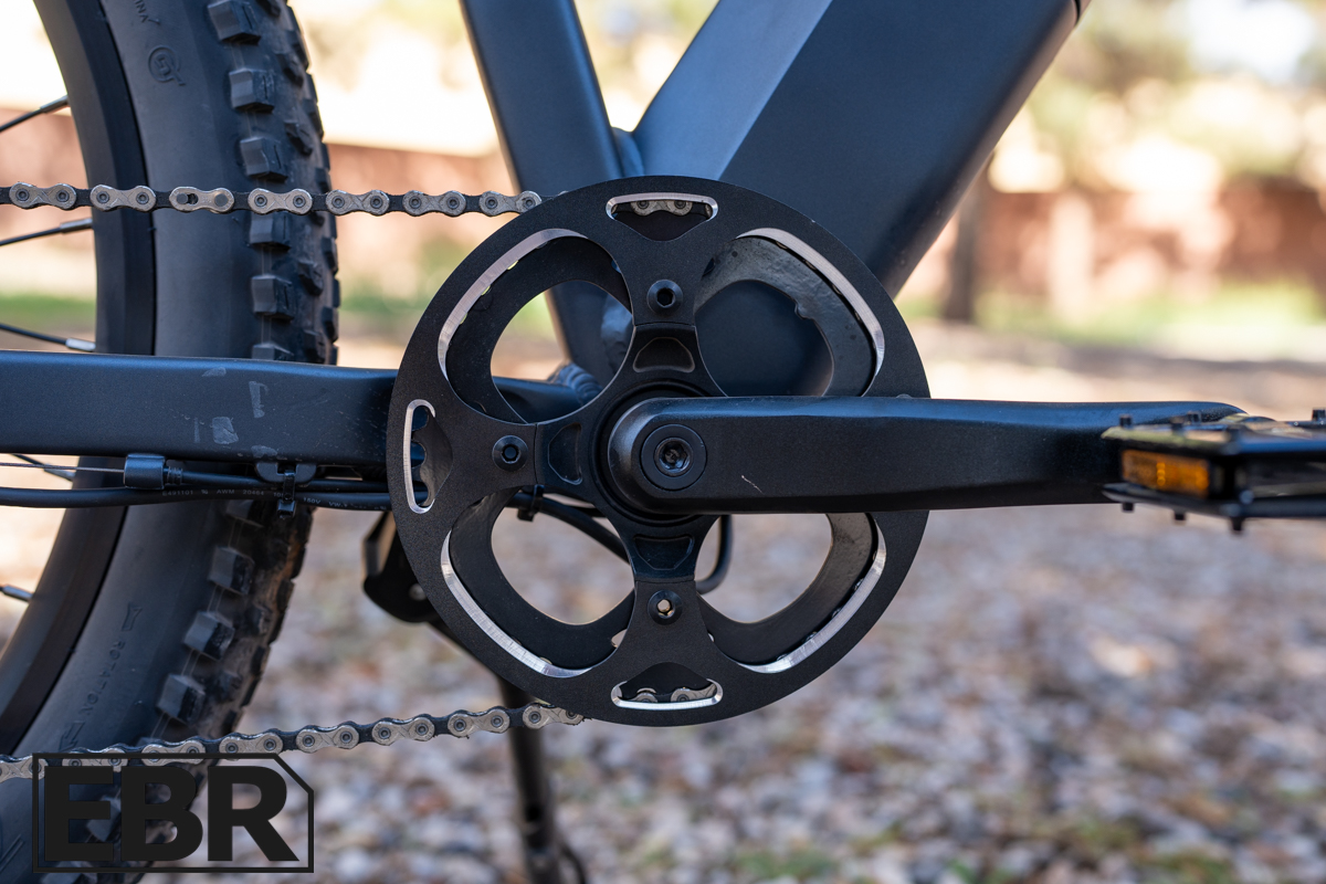

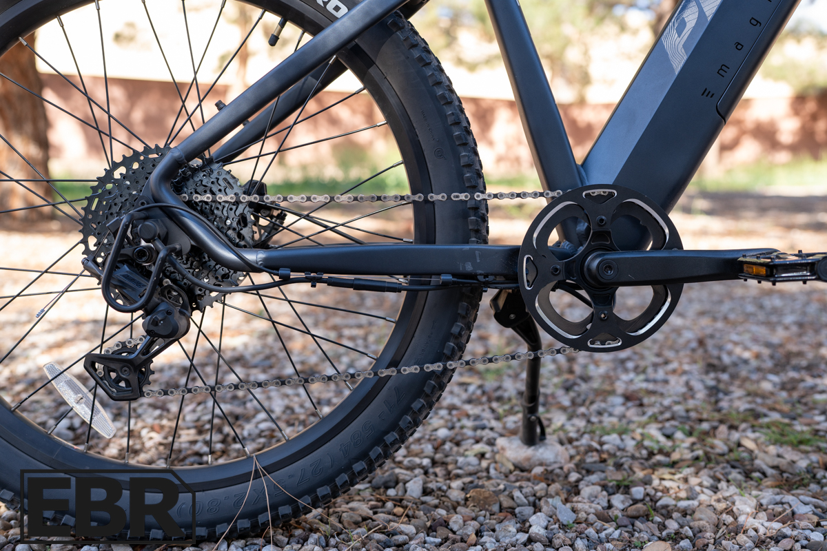

The components on the Magnum Peak 2.0 are a nice mix of value and performance. Up first is the heart of the components, the drivetrain. The MicroShift Advent 1×10 is a solid pick. It’s not a flimsy, “bottom of the parts barrel” derailleur. Because it’s clutched, you get better spring tension, crisper shifts, and a massive reduction in chain slap, meaning that pretty graphite paint on your chainstays stays intact.

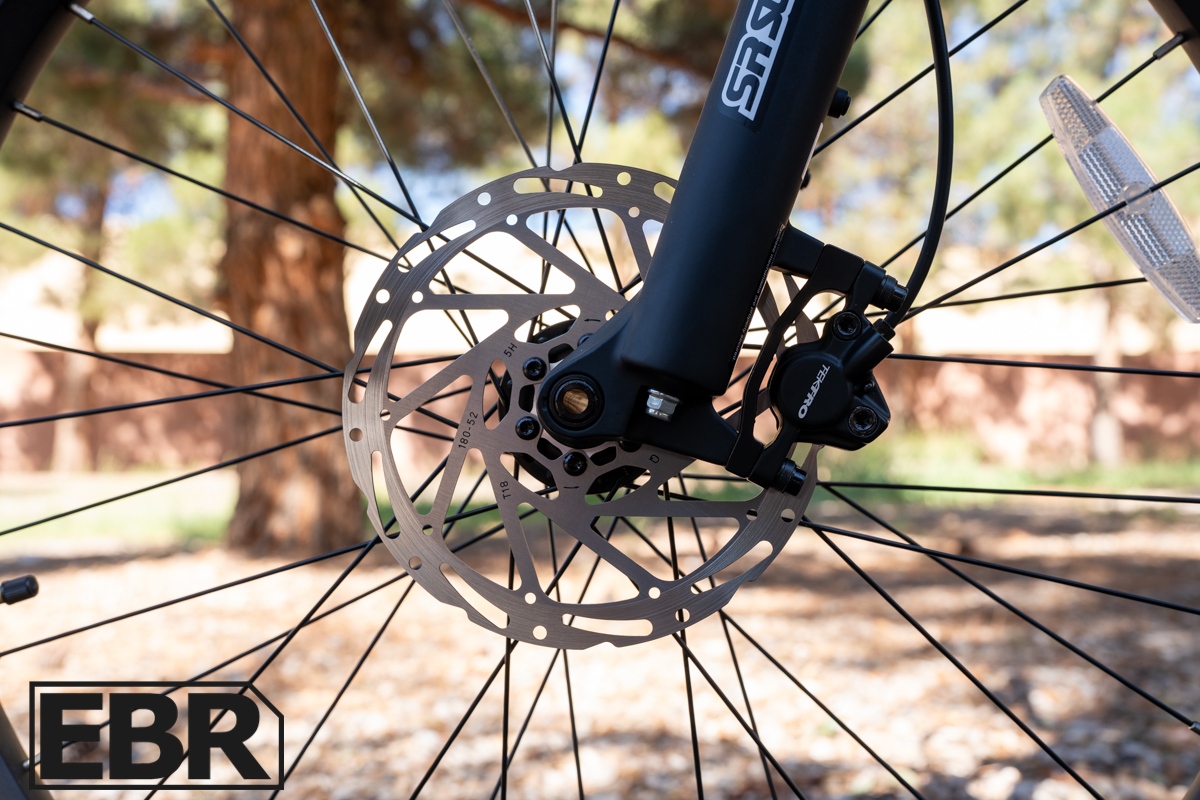

Braking is covered by the trusty Tektro HD3520 hydraulic disc brakes. These are seen pretty often in e-bikes and for good reason: they have excellent stopping power, they aren’t overpriced, local bike shops know them, and they are equipped with a safety feature referred to as “e-cutoff” sensors. This is a signal sent from the brake lever to the motor as soon as you start to brake to cut any pedal assist or throttle so you can focus on a safe stop, not fighting your motor along the way.

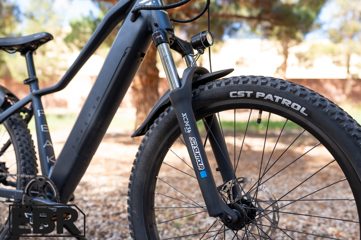

The wheels are 27.5-inch alloy wheels wrapped in CST Patrol 2.8-inch wide mountain bike tires. These use standard tubes with Schrader valves, and the setup is not tubeless compatible. Up front, there’s an SR Suntour suspension fork, the XCM 34 with BOOST hub spacing, 34mm stanchions, a thru-axle, and a generous trail-ready 140mm of coil spring travel to smooth out the route, whether that’s city curbs or backroad bumps.

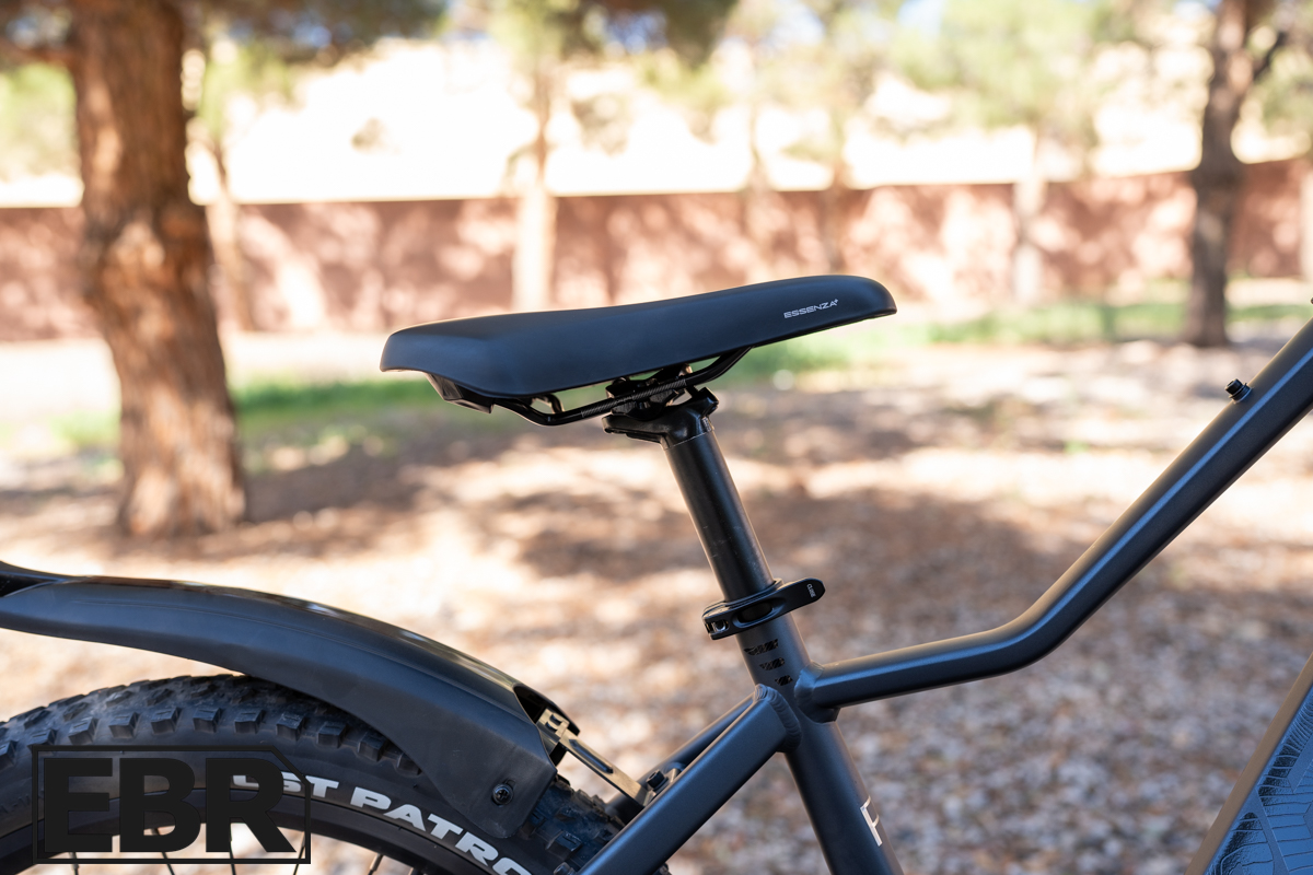

Contact points are all straightforward and properly picked. The saddle is a Selle Royal Essenza + GEL; it has micro-adjust rails to move the saddle back and forth to dial in a better fit. The seatpost is a 30.9mm alloy post with roughly 6 inches of adjustability via the quick-release lever. The pedals are alloy flats with a standard 9/16-inch spindle, and the grips are lock-on ergonomic platform rubber grips.

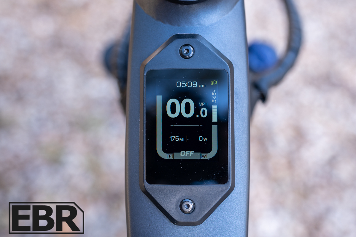

The display on the Magnum Peak 2.0 is the Velofox DM13 LCD color display with about a 2-inch screen size. Mounted into the top tube of the frame, it gives the Peak a more premium look and keeps things cleaner overall up front.
The data on the screen is straightforward, yet plentiful, where you have time, speed, voltage, a battery indicator, wattage in numbers, wattage in a dynamic bar graph, power in a dynamic bar graph, an odometer, and the pedal assist level in use. Scrolling to the next data screen by tapping the centered ‘M’ button on the control pad, you can see other useful metrics like your average speed, max speed, trip meter, and odometer.
If you head into the settings menu of the display, you can change the class of the bike from Class 2 to Class 3. In Class 3, you get the pedal assistance up to 28 mph and the throttle caps at 20 mph, whereas in Class 2 mode, they both cap at 20 mph. Just remember you must long-press the ‘M’ within 2-3 seconds of powering on the bike; otherwise, you might go crazy thinking it’s not working… ask me how I know.
While there is no app for Magnum e-bikes, I found the Velofox display to be easy to read in all light conditions, neatly integrated into the frame, and it offered all the settings and adjustments I would want on any given day of a trip out on the Peak 2.0.

When it comes to included accessories, the Magnum Peak 2.0 comes with enough to get you rolling and a few more to sweeten the deal. You get light fenders for both front and back tires, which have a smaller footprint over the wheel and lean more toward mudguards for off-road use, a kickstand, a 2A charger, and an adjustable-angle LED headlight with a 100-lumen rating.
