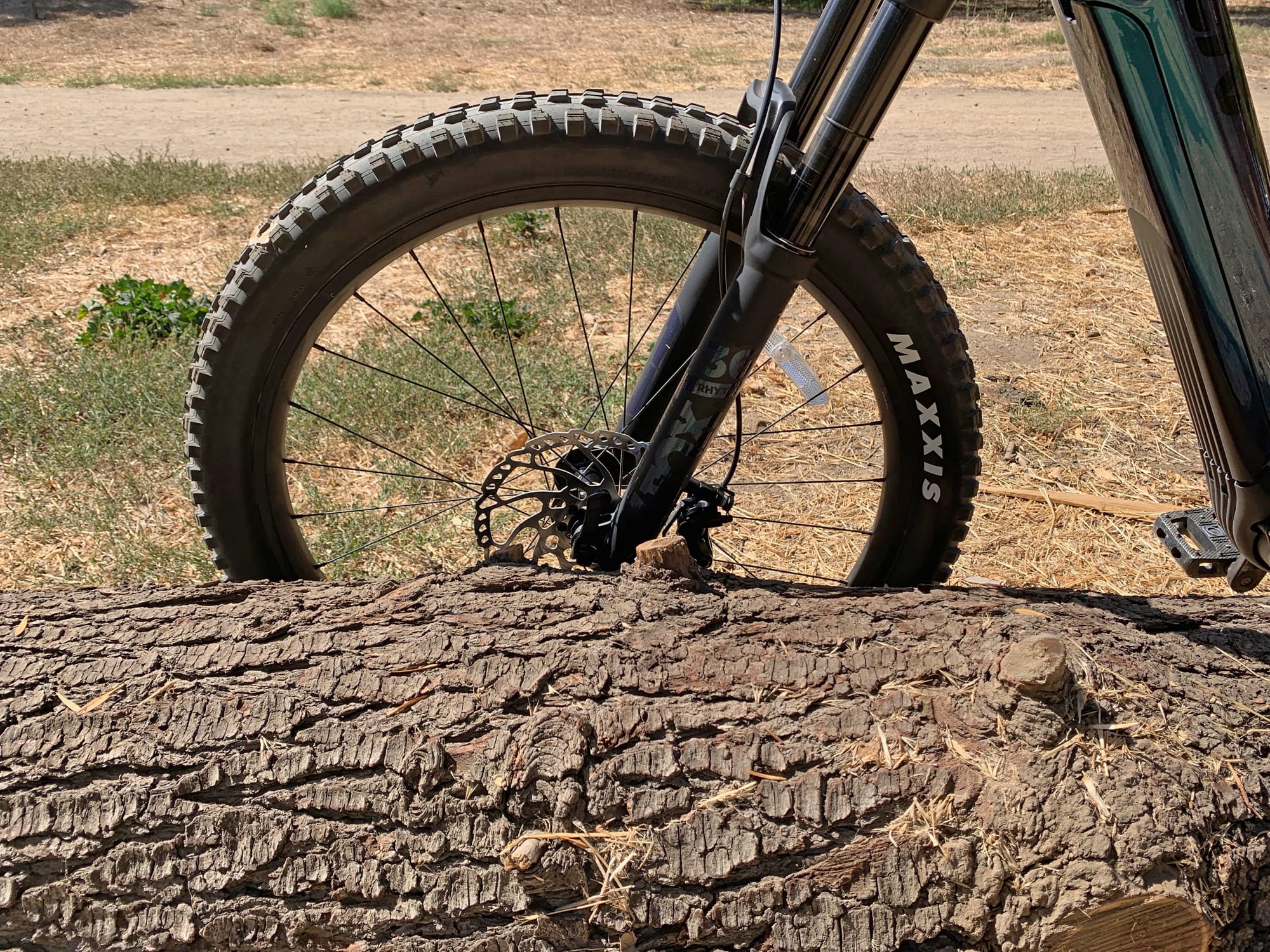

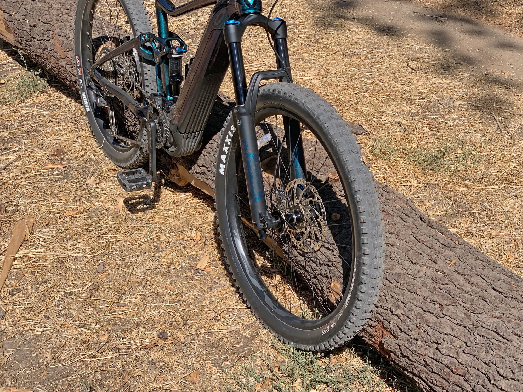

Fox 36 Float Performance 27.5+ Air Suspension, 150 mm Travel, Compression Adjust with Lockout, Rebound Adjust, 34 mm Black Anodized Stanchions, Boost 110 mm Hub Spacing, 15 mm Thru-Axle with Quick Release
Giant AM 27.5, 584x35 mm, Aluminum Alloy, Double Wall, 28 Hole Front, 32 Hole Rear, Reinforcement Eyelets | Spokes: Sapim E-Lite Race Stainless Steel, 15 Gauge, Black with Nipples
Front: Maxxis Minion DHF, 27.5" x 2.6" (66-584), Rear: Maxxis Rekon, 27.5" x 2.6" (66-584), 20 to 40 PSI, 1.4 to 2.8 BAR, Foldable, Tubeless, EXO, Dual Compound

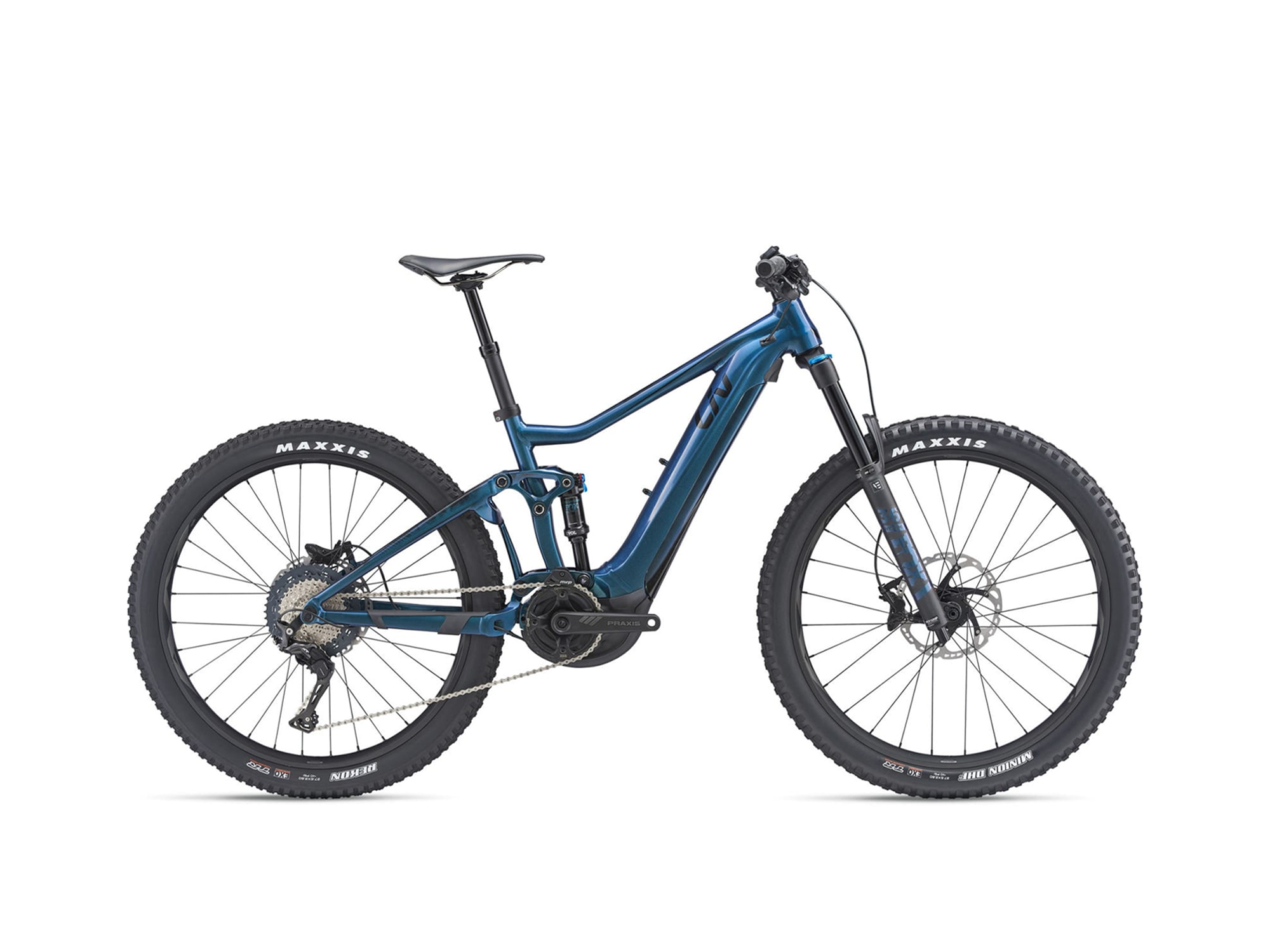

Liv Cycling builds mountain bikes for women and they really go the extra mile when doing so. Many mountain bike manufacturers have women’s versions of their popular models, but as Mike from Fullerton Cycles explained to me, Liv bikes are not just a men’s bike with a pretty color slapped on it! They are engineered from the ground-up with women in mind, with unique components such as the Liv Contact saddle, and unique geometry such as shorter reach and handlebar width. Liv Cycling is a sister company to Giant which means their bikes can take advantage of Giant’s many proprietary components. They also share the same great warranty which offers comprehensive coverage for two years and lifetime coverage for the frame! With a large network of dealers, you’re also sure to get help with proper fitting and regular maintenance to keep things running smooth and lasting longer. The visual design of this bike stood out to me immediately, it is simply a gorgeous bike. The chameleon color scheme, clean internally routed cabling, and flawless downtube integration of the battery all contribute to a cohesive and beautiful appearance. This clean integration coupled with the reduced footprint of the SyncDrive motor and lack of an LCD screen (more on these later) make the Intrigue stealthy for an electric mountain bike, and I suspect that many riders would not even realize it was electric without close inspection. This bike does come in four different frame sizes, with the medium which we used for this review weighing in at 53.2 pounds. Currently there is only one color option which is blue/black, so hopefully, you like that color if you are considering it for yourself. Of course, this bike doesn’t just look pretty, it is fully loaded with quality components and ready to tackle any trail! Fox 36 suspension provides 150mm of travel in the front, while Giant’s proprietary Maestro floating-point suspension offers 140mm of travel in the rear. The Maxxis tires are on the lower side of plus-sizing at 27.5″ by 2.6″ (making them nimble and light while still providing traction and increased float over traditional sizes) as well as being tubeless-ready and Ebike optimized, and the Intrigue E +1 Pro actually features two different tires with the Minion DHF on the front for better steering traction, and the Rekon on the rear for optimal motor and climbing performance. In fact, nearly everything about these wheels is Ebike optimized, including the aluminum alloy rims, stainless steel spokes, and eTracker hubs with Boost spacing and sealed cartridge bearings. The boost spacing provides a sturdier bracing angle for the spokes and Giant went with 32 spokes rear and 28 in the front… which saves weight compared to most other manufacturers who don’t make their own rims. Giant goes for quality, and you can see this when you look at any of their components, which are stamped with pressure ratings for all of the bolts, so you don’t over-tighten or crush anything ;)

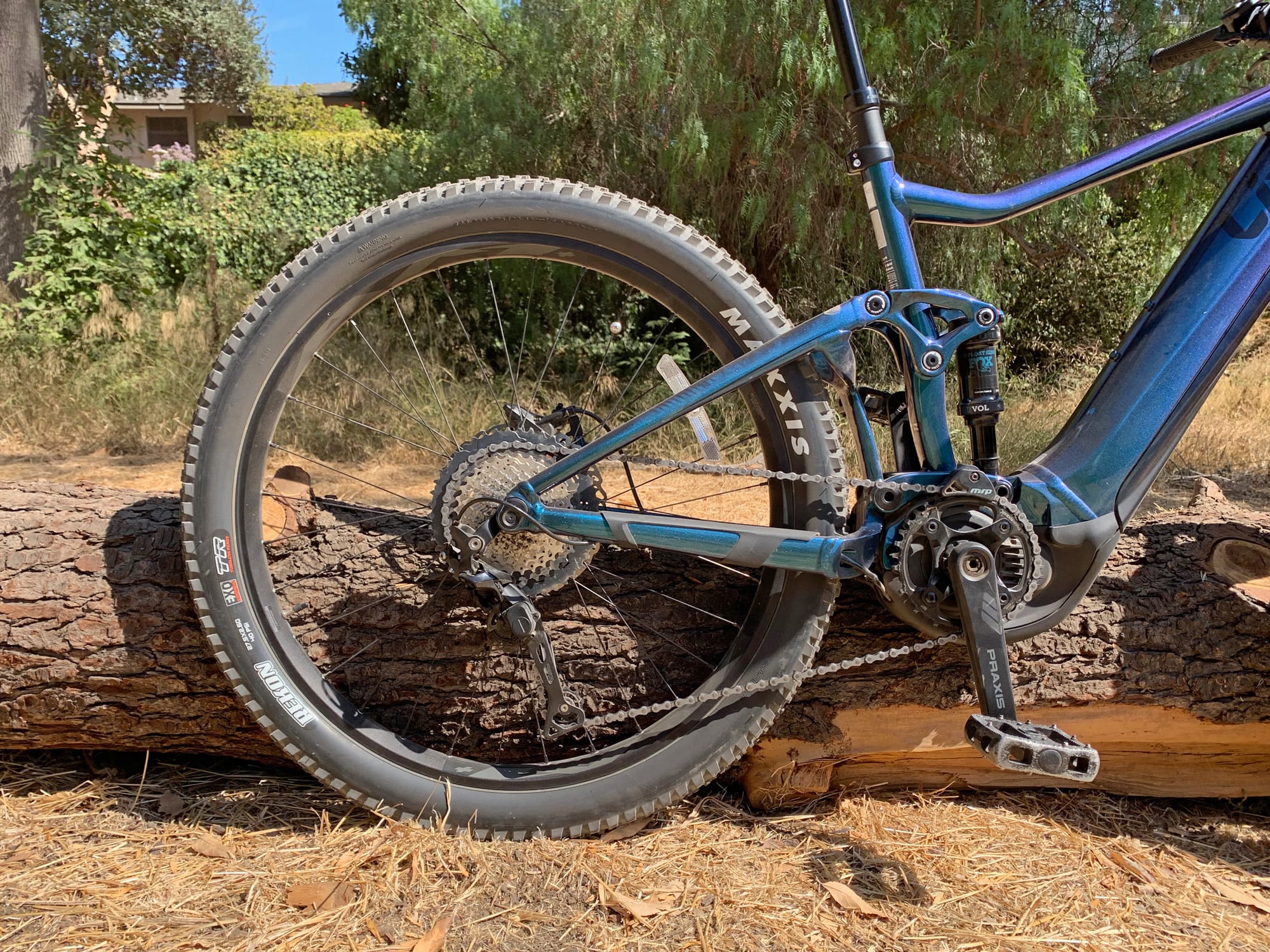

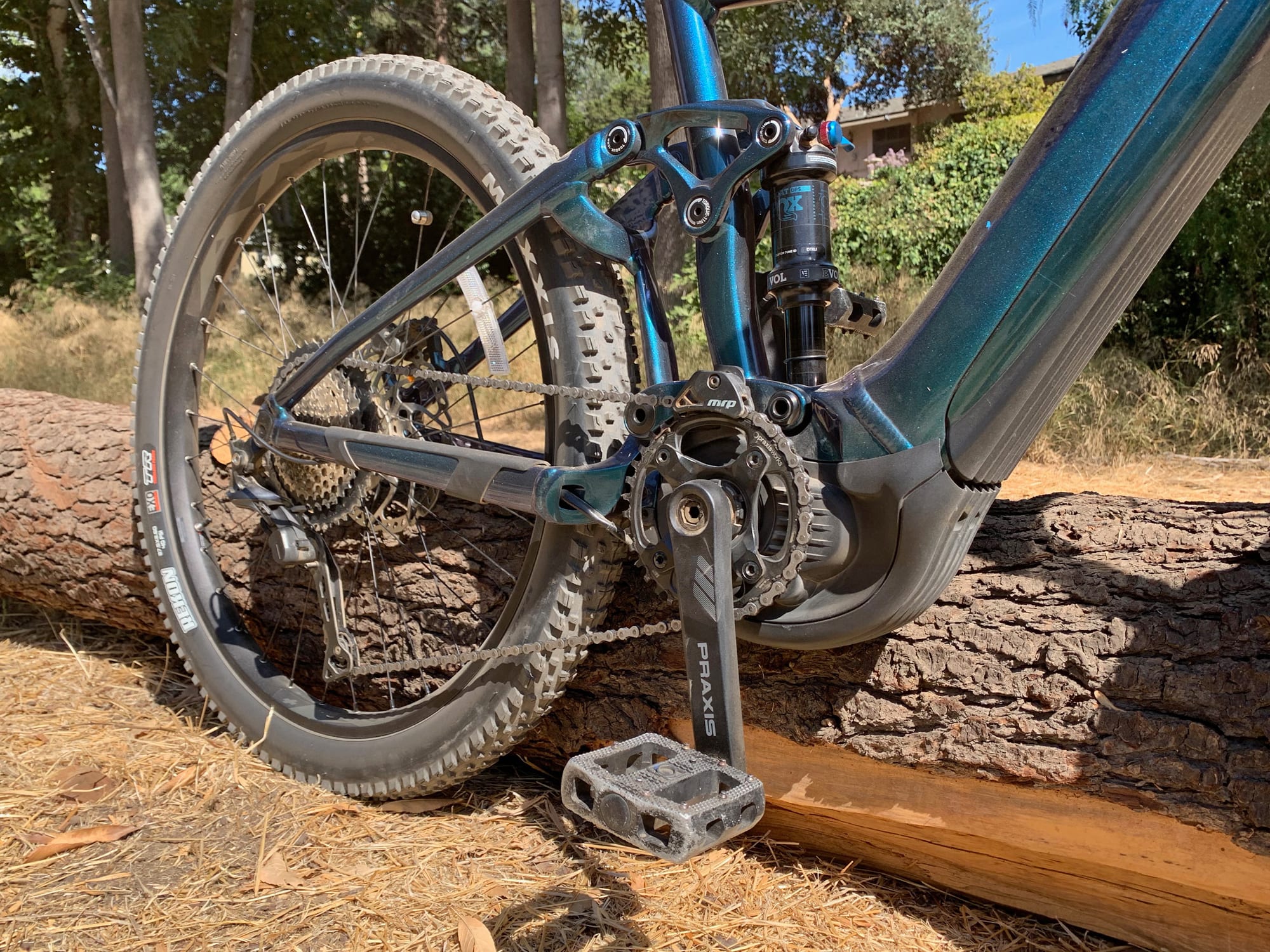

The motor is a Giant SyncDrive Pro, a mid-drive offering 250 watts of nominal power and peaking at around 500 watts. This is a Giant proprietary motor and it is based on the PW-X from Yamaha with further modifications by Giant to increase performance and reduce weight. The end result is a smooth, responsive, and fairly quiet experience with plenty of power available for climbing. I could definitely hear the motor when using the highest level of assist and hitting around 120RPM, but when pedaling at a more normal cadence and using a medium assist level this motor really is quiet! One drawback worth mentioning here is that the battery charging port is near the top of the motor and directly in the path of the left crank arm, so use caution when charging to make sure that the bike is stable and doesn’t get bumped. This motor has a standard chainring interface with no reduction gearing so you could swap out the 38-tooth steel chainring for something else if you wanted to, but I think the stock setup is more than adequate thanks to the large range of 11 to 46 tooth sprockets on the rear cassette. The stock chainring does have narrow-wide teeth and the chain is engineered by Giant specifically to handle the higher stress levels associated with Ebike use, as well as a solid chain guide to keep it from bouncing off. This is an 11-speed setup and shifting is handled by Shimano with a Deore XT derailleur and SLX shifters. Be aware that these shifters do allow you to dump up to three gears down at once and this motor does not have any software shift detection, so make sure you ease off the pedals when shifting so that you don’t mash gears and damage your chain. This is a more advanced setup compared to other drivetrains that have shift detection and/or single-click shifters, and while I prefer this, setup it really comes down to your personal preferences, skill level, and riding style.

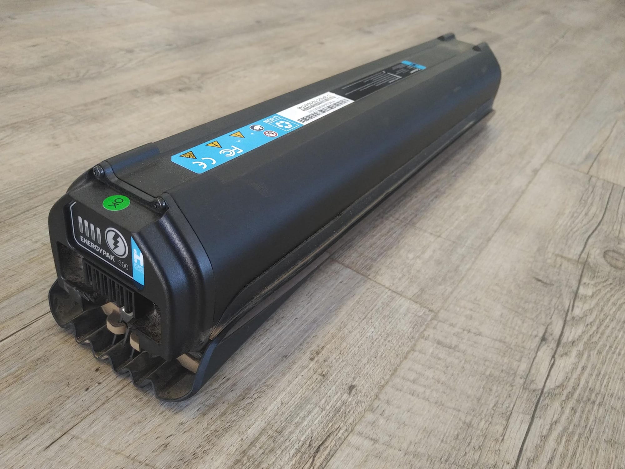

The battery is another example of proprietary technology and is called the Giant EnergyPak 500. As the name suggests this battery has about 500 watt-hours of capacity at 36 volts and 13.86 amp-hours. I really loved the clean integration of this battery, it fits beautifully into the downtube and matches the color scheme of the bike perfectly. It also has a two-step removal process that requires you to use the key to unlock the battery first, followed by pressing a release trigger near the top to free the pack for removal, which is nice as it helps to keep the battery secure and prevent it from falling out as soon as you turn the key. These battery packs are kind of heavy at 9.4lbs compared to a Bosch PowerPack 500 at just 6.3lbs, but that has to do with additional covering, including a beveled plastic skid plate below to keep it protected from rocks and dirt that might get kicked up. The cells inside the pack have increased spacing for heat management and are individually controlled, which helps to extend their lifetime as well as allowing you to continue using the battery if one of the cells should fail. The battery also has a button and five-step LED readout to check the charge level when the battery is removed, but I was disappointed that it doesn’t have any USB charging ports, which can be handy for powering personal electronics when the battery is removed from the bike, although this is more of a convenience feature and might not see much use on a mountain bike. Perhaps a micro-USB port up near the display panel would have been nice, for those who like to use the Strava app or other GPS / smartphone apps on the go. The battery charger is a real powerhouse offering 6 amps vs. just 2 or 4 amps on the vast majority of competing bikes, and can charge the battery from 0 to 60% in just 90 minutes, but of course, that power comes with a trade-off as this charger is bulky and weighs in at 3.1 pounds vs. 1.5lbs or 2lbs respectively… not something you can easily toss in your bag and carry with you. The charger comes with a dongle that is required if you want to charge the battery while it is removed the bike, which is a bit of a bummer – just make sure you don’t lose that dongle! It’s one more thing to keep track of and it adds to the space requirement mentioned earlier. To be honest, 500 watts is pretty standard sized for a battery pack these days, with BULLS and some others offering around 650 watt hours… so the weight of the pack and the charger and extra space requirements do set this bike back a bit in my mind. Being a full-suspension mountain bike, the Intrigue does not come with any integrated lights that could be damaged in the event of a crash or collision, so be sure to pick up some of your own if you plan to do any night riding. There are also no kickstand mounting points, but the downtube does have bottle cage bosses and the rear suspension design leaves enough room here for a side-entry cage. To really care for this and other Lithium-ion battery packs, store in a cool dry location, maintain a charge of 20% to 80% at all times to avoid stressing the chemistry, and don’t drop it ;)

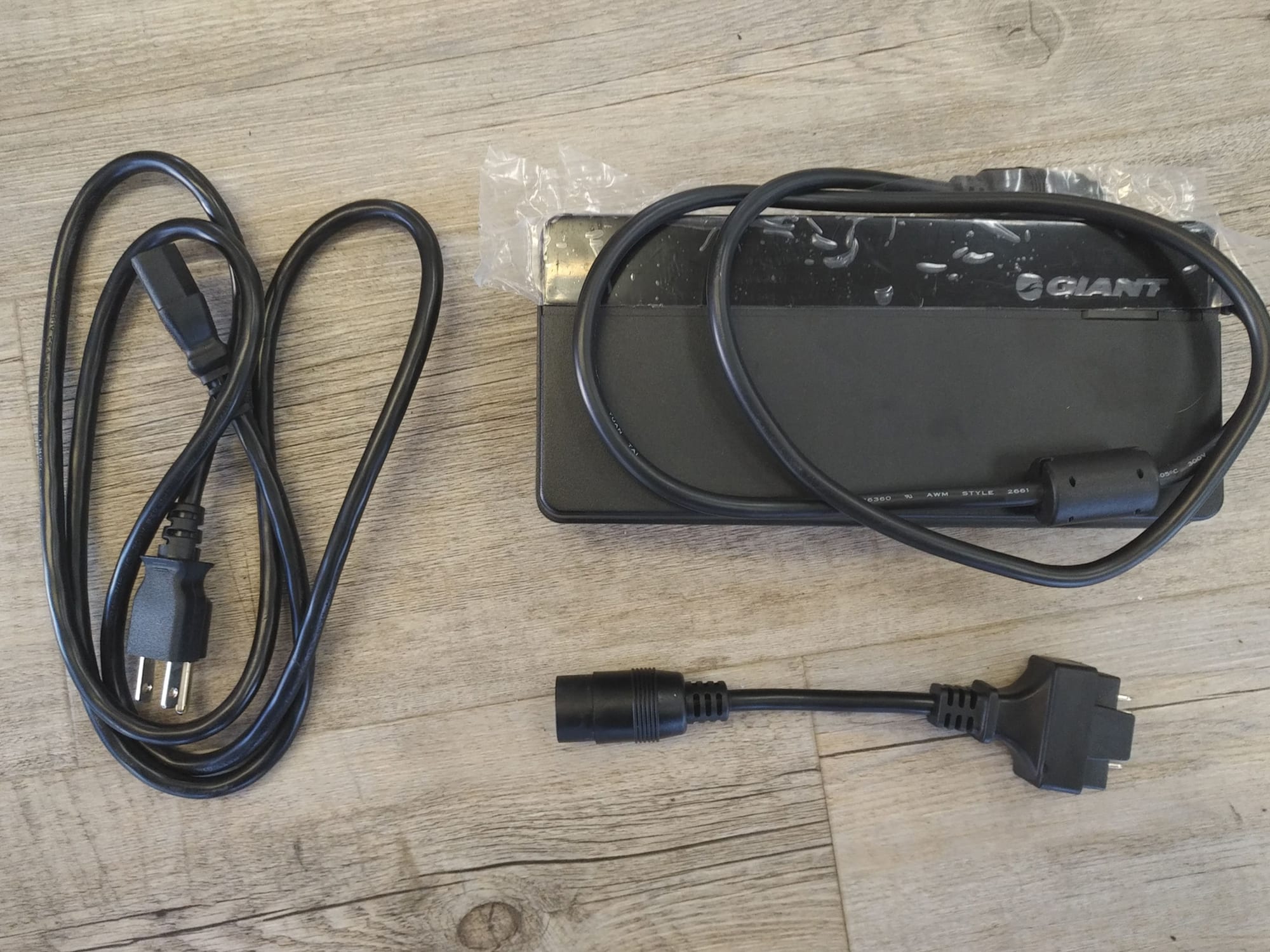

  • The charger weighs in at 3.1 pounds and is a bit heavy to easily transport in a backpack or bag, but it does charge the battery very quickly with 6 amps
  • The battery is average capacity for this generation of ebikes but weighs more than the competition (in part because of the protective covering)
  • Charging the battery off the bike requires a separate adapter which is included, just make sure not to lose it
