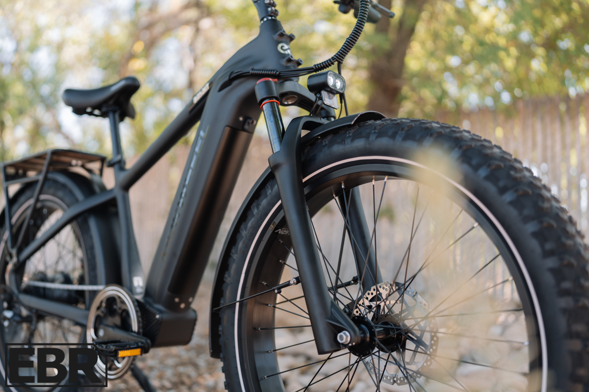

My Experience Riding The Mokwheel Basalt 2.0 E-Bike
I got my hands on the Basalt 2.0 in that slick Phantom Black matte finish, and honestly, I’m always a sucker for matte black anything. Combined with the black fork stanchions and matching contact points, this thing looks properly stealthy and put-together. No complaints on the aesthetics front.
The step-over frame felt a bit oversized under me, but that actually makes sense when you look at the numbers. This version is spec’d for riders 5′ 7″ to 6′ 9″, and at 5′ 11″, I’m sitting closer to the lower end of that range. Still totally manageable though, and here’s the bright side: we don’t often see bikes that genuinely accommodate riders pushing 6′ 9″, so it’s refreshing to find something that actually delivers for taller folks instead of just claiming it does.
Comfort-wise, this thing nails it. That upright geometry pairs nicely with the 110mm suspension fork and those chunky 26×4″ fat tires. I kept mine around 15 psi for maximum cushion, and whether I was on pavement or dirt, the ride stayed smooth and controlled. The padded grips and decent saddle keep things comfortable for longer hauls without any pressure points or numbness creeping in.
The Tektro two-piston hydraulic brakes with 180mm rotors handle stopping duties just fine for most situations. On an 80-lb bike, I wouldn’t mind seeing four-piston calipers for extra bite (something I mentioned in the Basalt 2.0 Step-Through version as well, but again, that’s more wishlist territory than an actual complaint. They get the job done reliably.

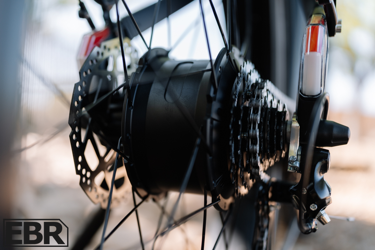

Now, the motor is where this bike really shines. That 750W rear hub motor (hitting 1100W peak) with 90 Nm of torque has serious grunt when you need it. Hills don’t faze it, and I never felt like I was asking for power that wasn’t there. What I really dig are the control options buried in the display settings. You can dial in speed limits for both pedal assist and throttle independently, plus there’s this “motor sensitivity” adjustment from 1 to 5 that I haven’t seen elsewhere. Crank it to 5 and you’ll get some rear wheel spin if you punch the throttle too aggressively. Set it to 1 and it’s tame as can be. That level of customization is pretty slick.
I also bumped the speed limit in the display to 34 mph just to see what this thing could really do (knowing full well it wasn’t hitting that number, but I like pushing the envelope to find true top speeds). On flat ground with pedal assist and throttle working together, I managed to hit 31.6 mph. Not bad for a fat tire rig, and you can run the throttle restricted or wide open depending on your preference.
The updated torque sensor deserves a shout-out too. Mokwheel’s earlier versions could feel a bit jerky or unpredictable, but this one tracks your pedaling effort accurately and delivers smooth, responsive assistance. It’s a solid improvement that makes the bike feel more refined overall.

Under the hood, the Basalt 2.0 packs the kind of power system that backs up its all-terrain swagger. We’re talking about a rear hub motor rated at 750W that can surge to 1100W when you need it most, cranking out 90 Nm of torque in the process. For an 80-lb machine rolling on fat 26×4″ rubber, that’s the kind of muscle you want when facing steep climbs or pushing through loose terrain.

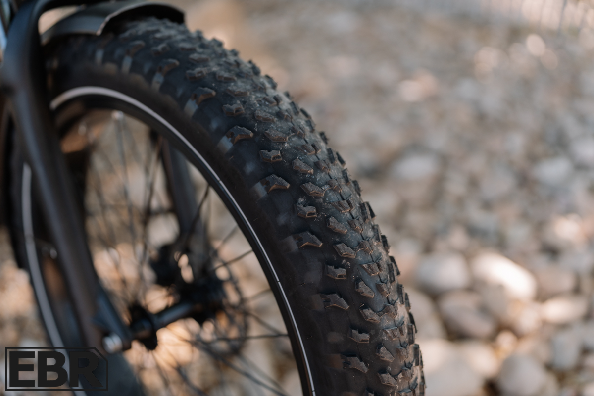

Those signature 26″x4.0″ puncture-resistant tires remain the standout feature here, mounted on sturdy 6061 aluminum wheels. This rubber is designed to grip and roll over just about anything, sand, snow, loose gravel, you name it. The whole wheel package prioritizes durability and traction over weight savings, which makes perfect sense for this bike’s adventure-focused mission.

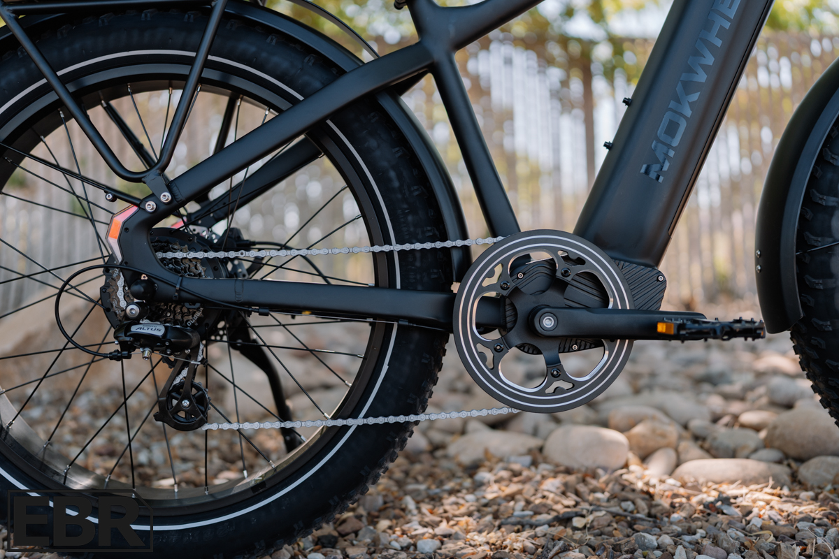

Where the step-over version gets a leg up is in the drivetrain department. Instead of the 7-speed Shimano Tourney setup, you’re getting an 8-speed Shimano Altus configuration that gives you a bit more range to work with. The cassette spans 14-28T, paired with that same beefy 52T aluminum alloy chainring and operated via Shimano trigger shifters. That extra gear and slightly wider range is welcome when you’re tackling varied terrain, though you’ll still be leaning on that motor for the steeper stuff. It’s not a mountain biker’s dream drivetrain, but as a backup to the electric system, it’s more than adequate.

My main gripe? The drive-side chainstay lacks any protective film or rubber guard, so chain slap will eventually scuff up that painted aluminum. Sure, I can grab some protection film off Amazon for a few bucks, but Mokwheel could easily handle this before the bike ships.

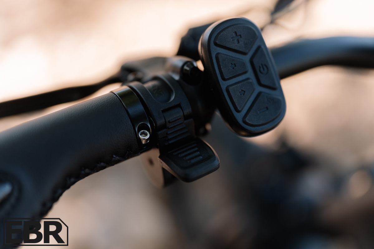

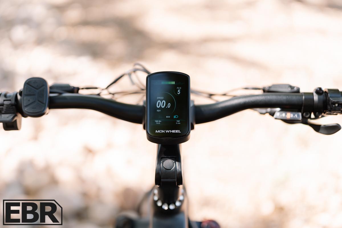

The Basalt 2.0 comes equipped with a standout display that punches above its weight class for a fat-tire e-bike. This full-color, high-contrast screen stays readable even when you’re squinting through bright sunlight on exposed trails or city streets. The interface feels modern and intuitive rather than some dated LCD throwback you’d expect at this price point.
Everything you need sits right on the main screen: current speed, battery status, assist level, and trip data. Dive into the settings menus and you’ll find the real flexibility, toggle between Class 2 and Class 3 modes (switching from 20 mph throttle to 28 mph pedal assist), dial in custom speed limits, or adjust that motor sensitivity setting I covered earlier. Level 1 keeps things mellow, while level 5 will light up the rear tire if you’re not careful with the throttle.
The killer feature is that detachable faceplate design. Snap it off with a quick twist, and suddenly the bike becomes a paperweight, no motor response, dead throttle, nothing. It’s brilliant anti-theft thinking that more manufacturers should copy. Park it somewhere sketchy, pocket the display, and you’ve eliminated the obvious “steal me” signal while making the bike useless to ride away. Determined thieves could still load it in a truck, but you’ve just raised the bar significantly. With replacement displays reasonably priced, pairing one with that $199 backup battery gives you a complete spare setup.
There’s no companion app, and frankly, that’s refreshing. Everything you need to configure lives right in the display itself, no Bluetooth headaches, no buggy software updates, no dependence on your phone’s battery life. For a bike designed around trail adventures and off-grid capability, this self-contained approach makes total sense. You’re not here to upload Strava segments or obsess over ride analytics; you just want the thing to work when you twist the throttle.
This display strategy aligns perfectly with the Basalt 2.0’s philosophy: practical, reliable, and refreshingly uncomplicated. Sometimes the best tech is the kind that just works without asking for your attention.

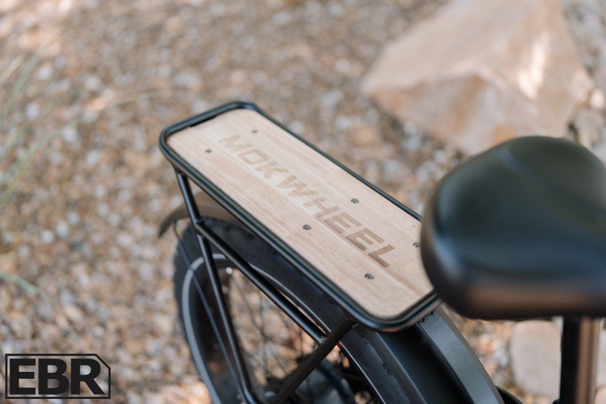

Right out of the gate, you’re getting fenders and a rear rack, which makes sense for a bike positioning itself as a practical adventure tool. Those fenders will keep the spray off when conditions get messy, and that rack opens up cargo possibilities whether you’re hauling trail supplies or grocery runs. Not having to buy these basics separately is a nice touch at this price point.

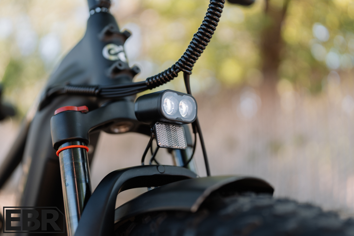

But here’s the thing, it doesn’t sacrifice everyday practicality to achieve that off-grid magic. Those included fenders and rear rack, the lighting system with actual turn signals and brake indicators, the detachable display security feature, these details show Mokwheel thought about real-world use beyond the marketing bullet points. This bike can absolutely pull double duty as a daily commuter that transforms into an adventure rig on weekends.

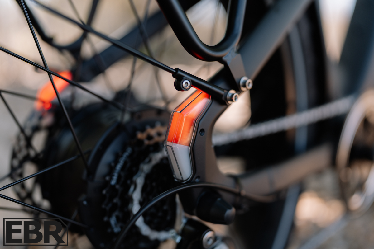

- Integrated turn signals and brake lights provide legitimate safety benefits that make this surprisingly street-friendly for such a rugged machine.
