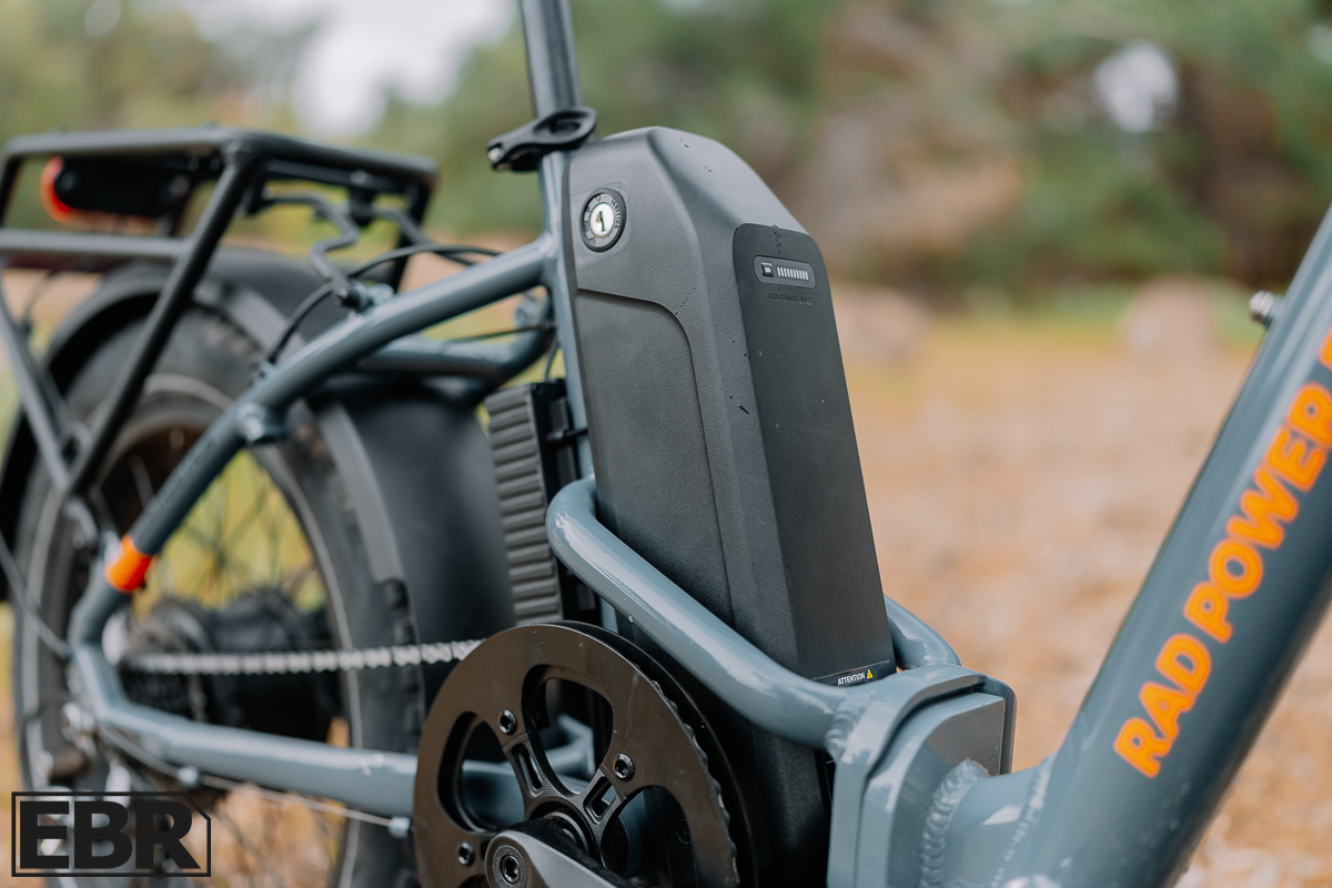

The biggest single upgrade may be the addition of Rad Power Bikes’ Safe Shield battery. Not only is this battery certified to UL’s 2271 standard for batteries, but the battery is “potted.” By this we mean that all of the cells are encased in a heat-absorbing polymer. We will go into greater detail about this later in our review. The Rad Power Bikes Safe Shield battery may be the safest battery found in an e-bike.

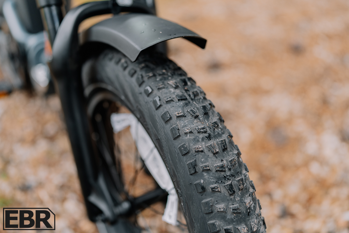

Rad Power Bikes presents the RadExpand 5 Plus as an e-bike capable of offroad riding, thanks to its 4-in.-wide, knobby tires. Certainly, the tires can handle unpaved roads and multi-use trails, but this is no eMTB. With just 50mm of suspension travel in the fork, this is an e-bike that will perform well in light offroad use, but isn’t meant for technical singletrack trails.

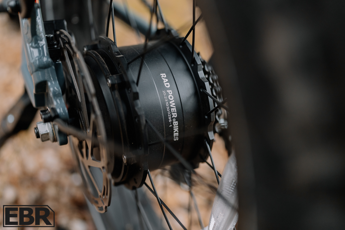

The Rad Power Bikes RadExpand 5 Plus is equipped with a 750W brushless, geared hub motor. It produces a maximum torque of 64Nm, which solid, if not mind-blowing. Most Rad Power Bikes models pair this motor with a cadence sensor, but Rad Power Bikes has begun upgrading their new models with the Safe Shield battery as well as some other components, such as a torque sensor.
The presence of a torque sensor is why the RadExpand 5 Plus achieved such great range numbers. Torque sensors apply power in a fashion that’s very different than a cadence sensor. Torque sensors take the amount of power the rider is producing and multiply it by a factor determined by the PAS level the rider has selected. This is what some e-bike makers mean by giving the rider 200 or 300 percent assistance. They give two or three times the power output generated by the rider. To generate more power, the rider must pedal harder. The bottom line is that a rider pedaling an e-bike with a torque sensor is contributing more of the power being output than if they were on an e-bike with a cadence sensor.
A cadence sensor puts out power at a steady rate depending on the PAS selected. All that the cadence sensor is measuring is whether the pedals are turning, or not. E-bikes with torque sensors may require more work from the rider, but they offer a fundamentally more dynamic and exciting ride experience.
The biggest single upgrade is the addition of Rad Power Bikes’ Safe Shield battery. Not only is this battery certified to UL’s 2271 standard for batteries, but the battery is “potted.” By this we mean that all of the cells are encased in a heat-absorbing polymer.
Lithium-ion batteries generate heat as they produce electricity. Under most circumstances, that’s not a problem, but sometimes, the battery begins to generate an excessive amount of heat. If there is an issue with one of the cells, such as being defective or damaged in a crash, that cell can go into thermal runaway, heating up until it causes a fire. With the thermal polymer that encases the cells, the material draws heat away, preventing the heat buildup that can lead to runaway, so not only does the battery meet the UL standard, it adds an extra layer of security.

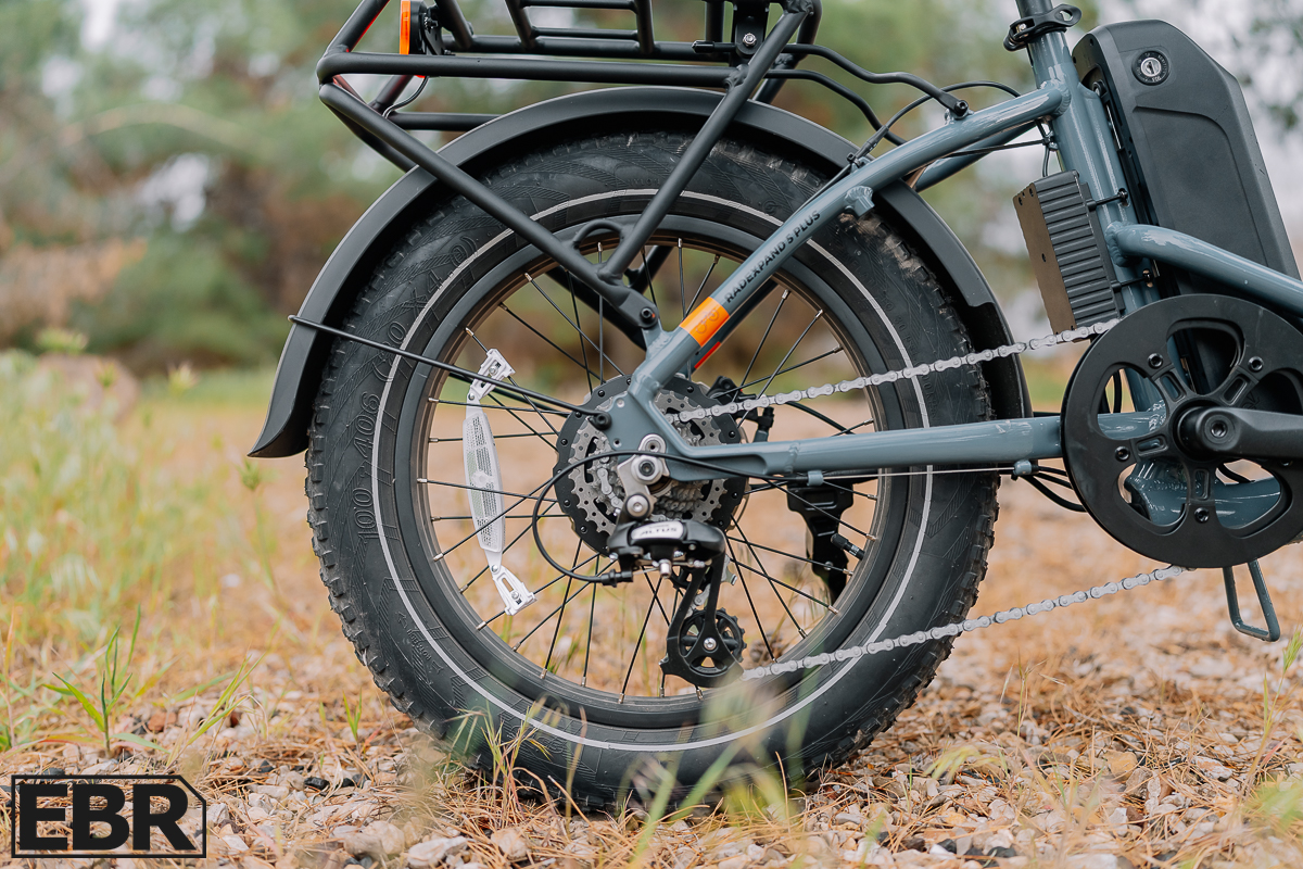

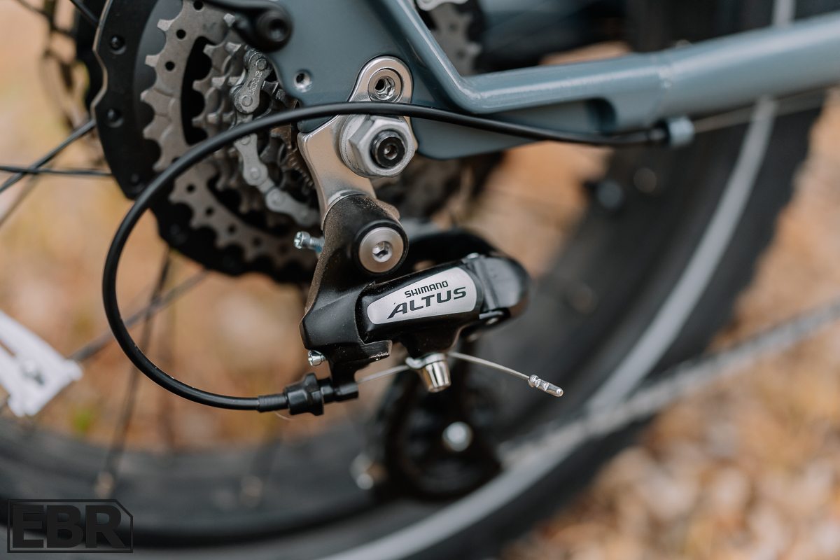

One of our biggest reservations about the RadExpand 5 Plus is its choice of drivetrain. The 7-speed Shimano Altus drivetrain is rarely found on e-bikes that cost more than $2000, so it seems out of place here. An 8-speed drivetrain would shift better and offer a wider range of gears, which is handy for anyone living in a hilly place like Rad Power Bikes’ home base of Seattle.
This point is only driven home by the fact that another of the upgrades that the RadExpand 5 Plus received relative to the RadExpand 5 was a change from mechanical disc brakes to hydraulic disc brakes. Such a change makes a big impact on braking performance.

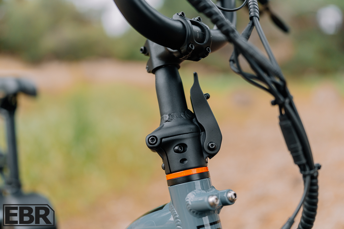

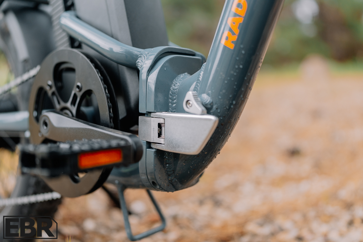

People always have questions about the latching mechanism for a frame and the Rad Power Bikes RadExpand 5 Plus latch is the one they have used for a while. It’s easy to operate and foolproof; if it isn’t fully latched, the e-bike isn’t rideable; it just folds up. The handlebar mast is similarly easy to operate.
None of this speaks to how rigid the frame is when locked into position. For most e-bikes, the handling suffers some when you reach top speed. They can be a bit squirrelly, nervous, but that really isn’t the case with the Rad Power Bikes RadExpand 5 Plus. When we say we don’t know why this isn’t a Class 3 e-bike with a top-assist-speed of 28 mph, that is more praise than criticism. We wouldn’t want most folding e-bikes to go 28 mph.

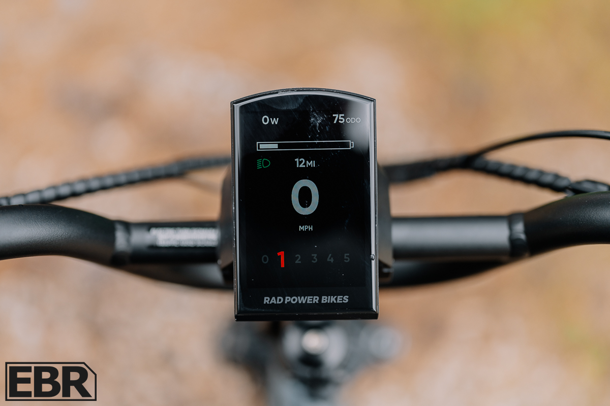

Rad Power Bikes has introduced a new display and it lends a significant improvement over the previous one. First, this one mounts at the center of the handlebar, where it is far easier to look at while riding. Displays mounted near the grip require a rider to turn their head, which can cause many of us to deviate our line a bit, and for some of us to outright veer offcourse. Positioning the display so all you have to do is look down makes things easier and safer.
The fact that the display is both larger now and in color also aids quick reading, meaning you take your eyes off the road less. While it offers usual functions such as current speed and odometer, it shows exactly how much power the motor is producing moment by moment, which is handy given the way a motor’s output changes when it is paired with a torque sensor. It also shows remaining estimated range (it is always an ongoing calculation and one hasty acceleration can throw it off), as well as brake light and turn signals.

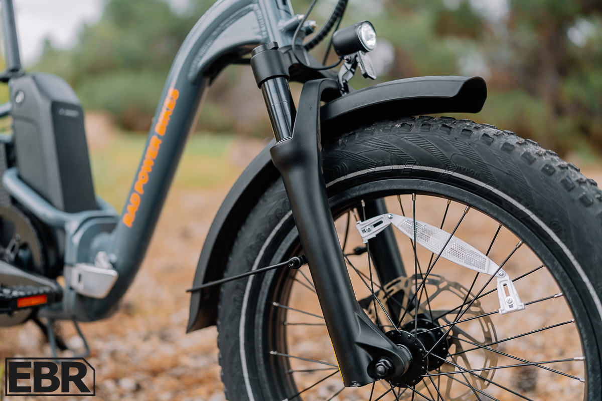

- 50mm travel Exsho suspension fork will give riders a more comfortable ride.
