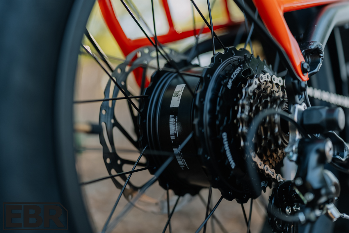

The Rev Roo XL comes with a 750W rear hub motor, which seems like a standard for cargo bikes these days. With peaking power up to 1,150W’s and 85Nm of torque, the Roo Rev XL has the muscle needed to haul your cargo.
What’s actually more important here is the torque sensor. The torque sensor on the Roo XL actually measures how much force you’re putting into the pedals and adjusts the motor assistance accordingly. This makes a huge difference when you’re loaded down – the bike gives you more help when you need it most, like starting from a stop with two kids on the back.

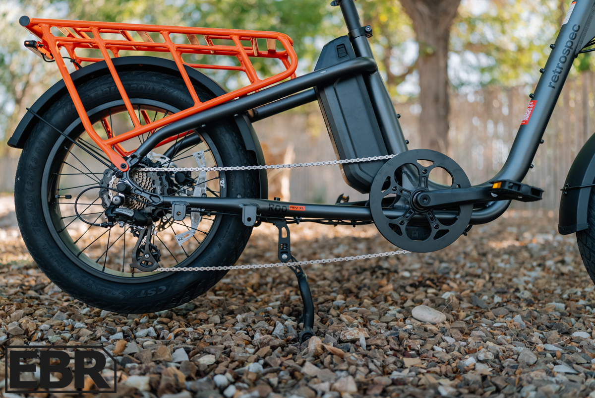

In terms of the battery, Retrospec uses LG 21700 lithium-ion cells with 48 volts, 14.6 amp-hours and a total of 700 watt-hours. The battery is cleanly installed against the seat post so you can easily secure it by key or quickly remove it for off-the-bike charging.

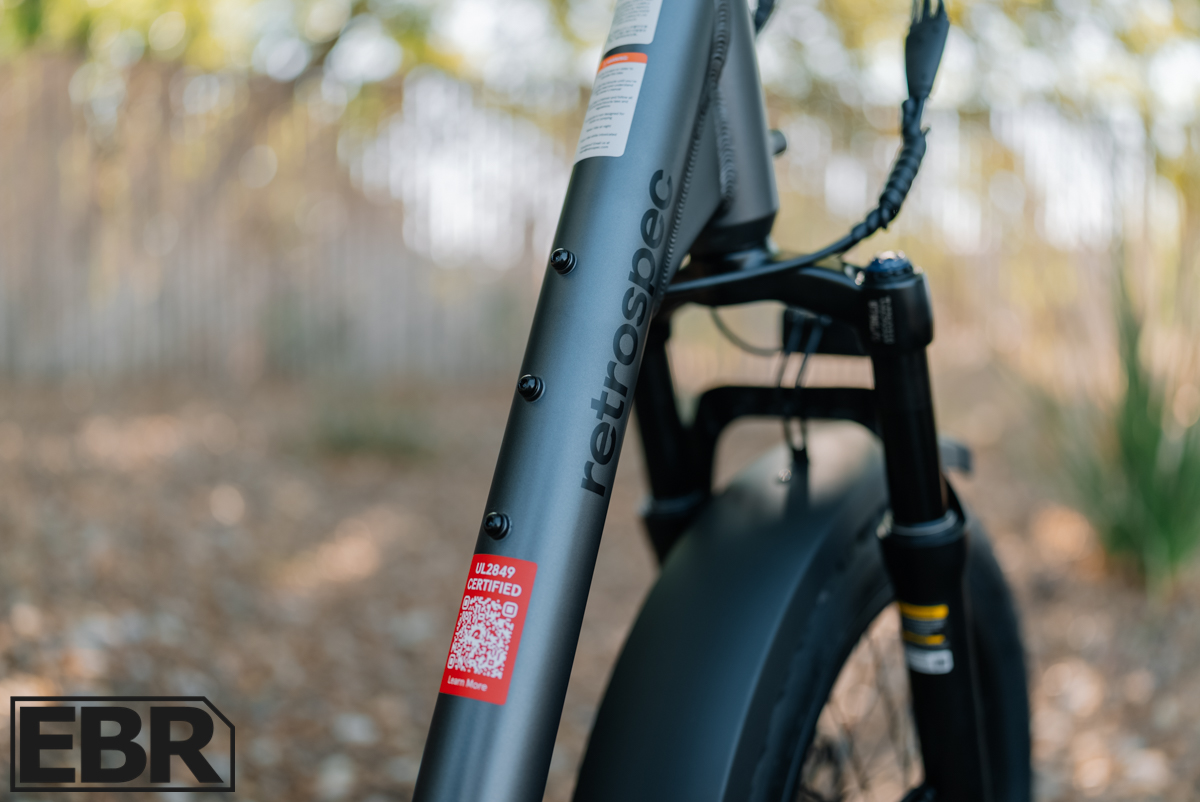

The whole system is UL2271 and UL2849 certified, which means it passed safety testing for both the battery and the complete ebike electrical system. That’s actually important for cargo bikes since you’re potentially carrying kids and dealing with higher loads that could stress the electrical components.

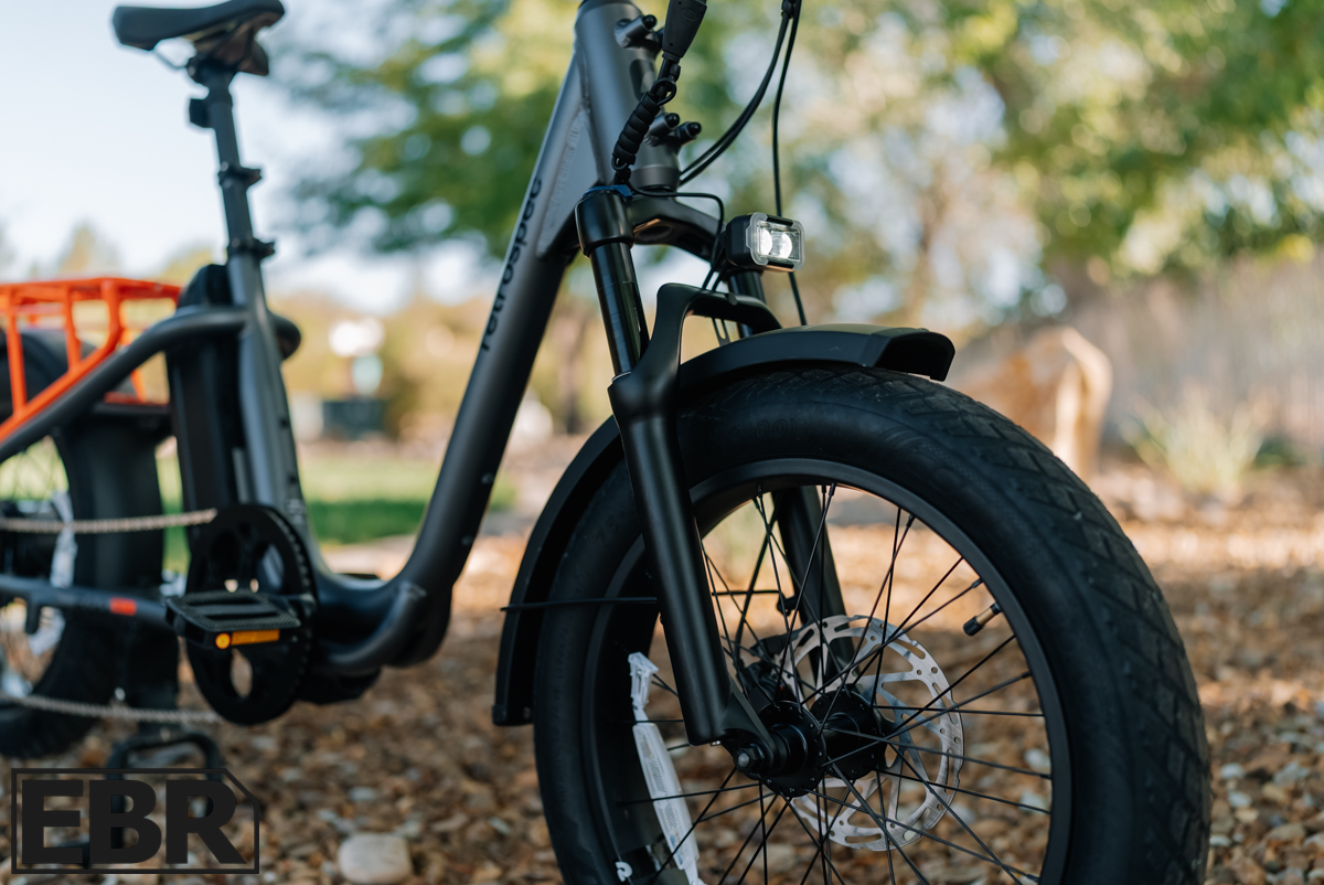

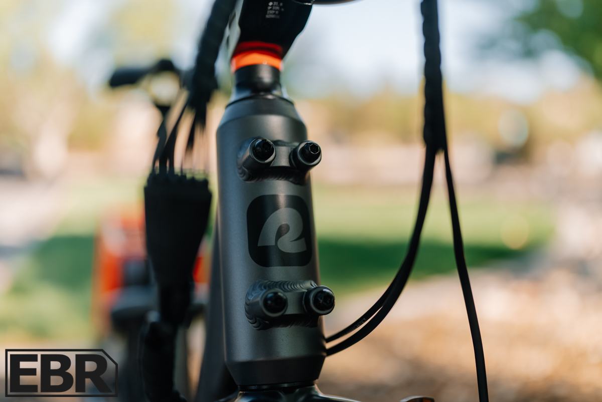

The Rev Roo XL uses a hydroformed aluminum frame, which is a nice touch for a cargo bike in this price range. Hydroforming creates smoother frame lines and requires fewer welds compared to traditional tube construction, which not only looks cleaner but also creates stronger joints. Plus, this style of open frame makes maintenance or service easier as all the wires, cables and components are nice and accessible without needing to perform bike ‘surgery’ to take a look.
The cockpit is pretty well thought out for a cargo bike. You’ve got BMX-style alloy rise bars with a cross bar for extra stiffness, which gives you good leverage when steering with a full load. The Tektro brake levers include e-cutoff sensors that kill the motor when you brake, the 7-speed Shimano shifter, a throttle, bell, and the center-mounted color TFT display. Everything’s topped off with lock-on comfort grips that won’t slip around when your hands get sweaty.

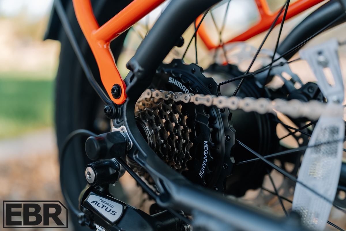

Shimano 7-speed Tourney setup with over-the-bar shifters. The drivetrain uses a 14-34T cassette paired with a 52T steel chainring and double chainguard, which gives you a decent range for starting from stops and climbing hills (with pedal assist).
The 20″ double-wall aluminum rims with 36 holes and 13-gauge spokes with brass nipples are built for cargo duty. The 20×3″ CST Big Boat tires with puncture protection and 60 TPI construction are fat, stable, and should handle the weight well. The 20″ wheel size is actually smart for cargo bikes – lower center of gravity and easier loading/unloading compared to larger wheels.

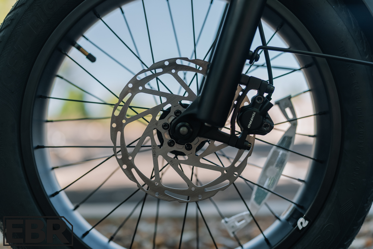

Tektro hydraulic disc brakes with properly sized rotors – 180mm up front and 203mm in the rear where you need the extra stopping power under a heavier load. Both use semi-metallic pads and ebike-specific rotors. This is exactly what you want on a 400-pound capacity bike, and the hydraulics provide consistent stopping power even when loaded down.
The ZOOM fork provides 80mm of travel with preload adjustment and lock-out. It’s not going to win any awards, but it does the job of smoothing out bumps when you’ve got passengers or cargo on the back. The lock-out is useful for more efficient pedaling on smooth surfaces.
The DDK 500GT saddle sits on an aluminum telescoping seatpost with a 380-552mm range and quick-release clamp, giving you good adjustability for different riders. The bike weighs 71 pounds with battery and comes with an aluminum twin-leg center kickstand for stability when loaded to keep the rig stable when parked.
