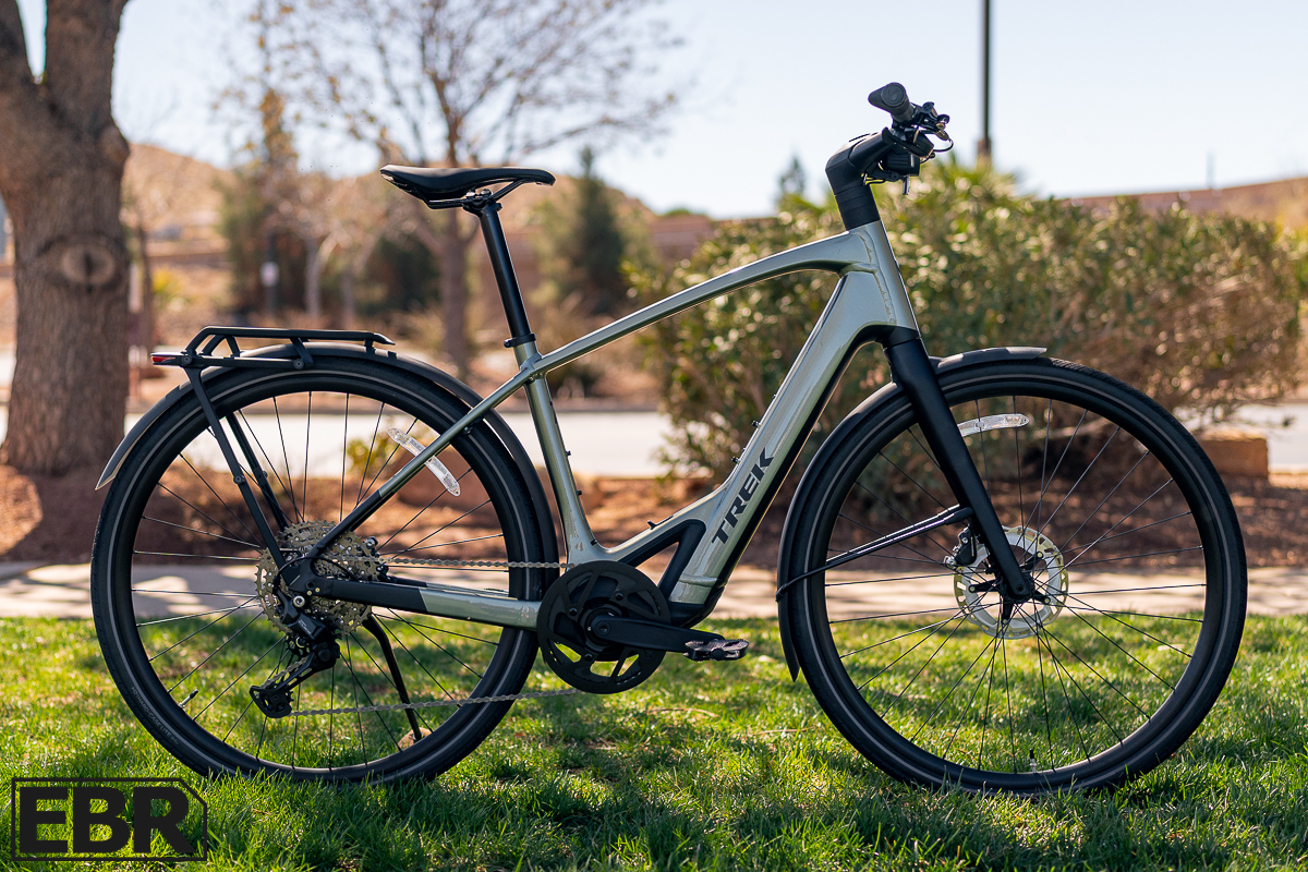

Court, first of all thank you so much for your website. I visit it on a daily basis. While I typically find little to disagree with in your reviews, I differ more than agree with your review of this R & M bike.
As an owner of the Trek Supercommuter + 8s, the R & M bike is anything but beautiful. For $11K you have a bike with batteries that are not integrated into the frame, and a mix of components that seem to be cobbled together. While the various components of the drivetrain and the brakes etc. are top notch, I struggle to understand why it is not capable of 28 mph. Why build a commuter bike with the range of two batteries (50 M min) and limit it to 20 mph. To commute the potential 50 miles round trip would take almost 3 hours. Really not useful. With my Supercommuter I can ride a steady 25 mph, and with the time taken at intersections, make my 20 mile commute in under an hour each way.
Again, thank you for the all your work to bring these wonderful bikes to your readers.
Dave
Court Rye says
Great points Dave! I think they focused on the CX motor because it integrates with the electronic shifting and Shimano does not support Class 3 at this time. In any case, I do really like the Supercommuter too and am glad that you’re enjoying it!
