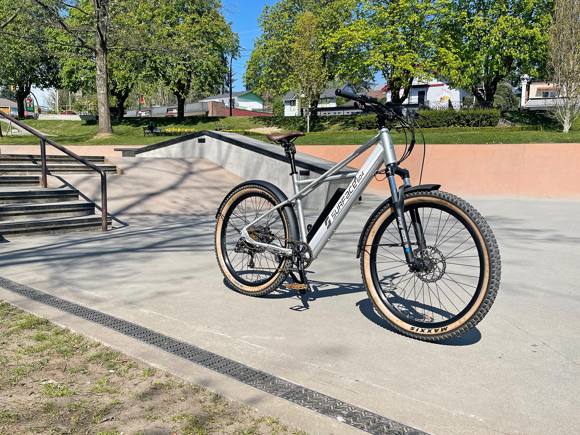

- Surface 604 dates all the way back to 2013. I was lucky enough to review their first product, the Element electric fat bike, in 2014. S604 products are designed to be affordable, but capable on a wide variety of terrain. Their designers frequently choose components that are a step up in terms of durability and quality because they come from the mountain bike background in Vancouver Canada, where it rains a lot. Their name denotes the 604 phone area code for the Vancouver region, which is home to ocean, city, and mountain conditions. The brand is sold in the US and Canada.
- The Quad is names after quadangle BMX bikes that were popular in the 1980’s. You can tell that the designer (Jason, who is awesome) had a lot of fun with this model! The brushed aluminum alloy with silver and gold accents is so sweet. This ebike is like an SUV in my opinion, it’s capable but still comfortable with a more upright geometry. The bike is almost exactly the same as the 2021 S604 Shred model, just built around a different frame with different tires.

- Very unique style and look, in my opinion it is done perfectly! The bike only comes in one color scheme, but the brushed aluminum alloy, silver and gold accents, and all-black components just look amazing. The gold chain is almost like a gold necklace and the muted branding is on point. If you don’t love this look, consider the Surface 604 Shred which is basically the same bike.

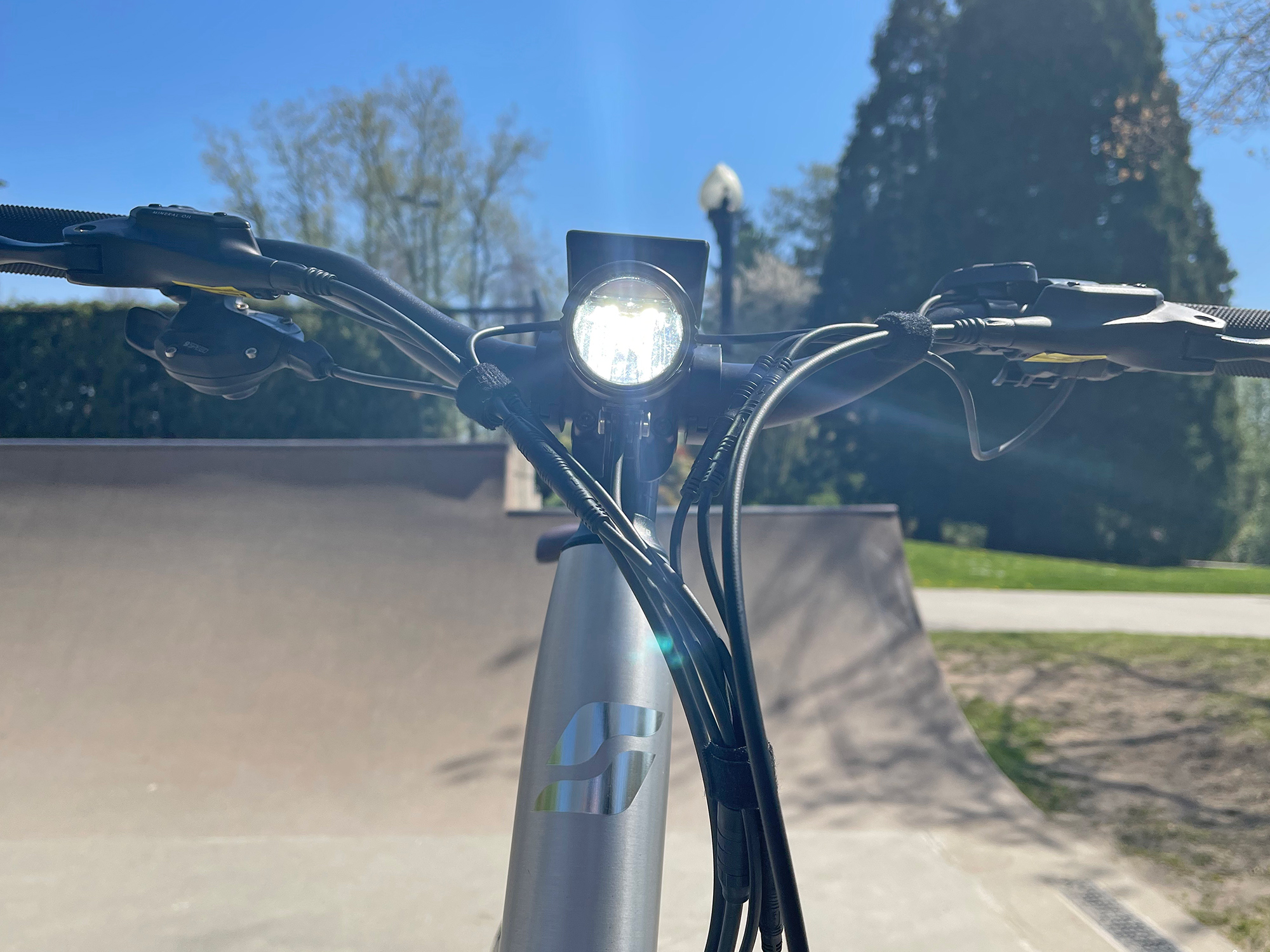

- The headlight they chose is quite bright, and has side windows to improve your visual footprint. Normally, headlights are mounted lower down on the suspension arch which isn’t as safe and may vibrate more because that position is not suspended. S604 made a custom light bracket that mounts to the stem and it works great… points where you steer and the beam won’t get cut off by the fender or front tire.

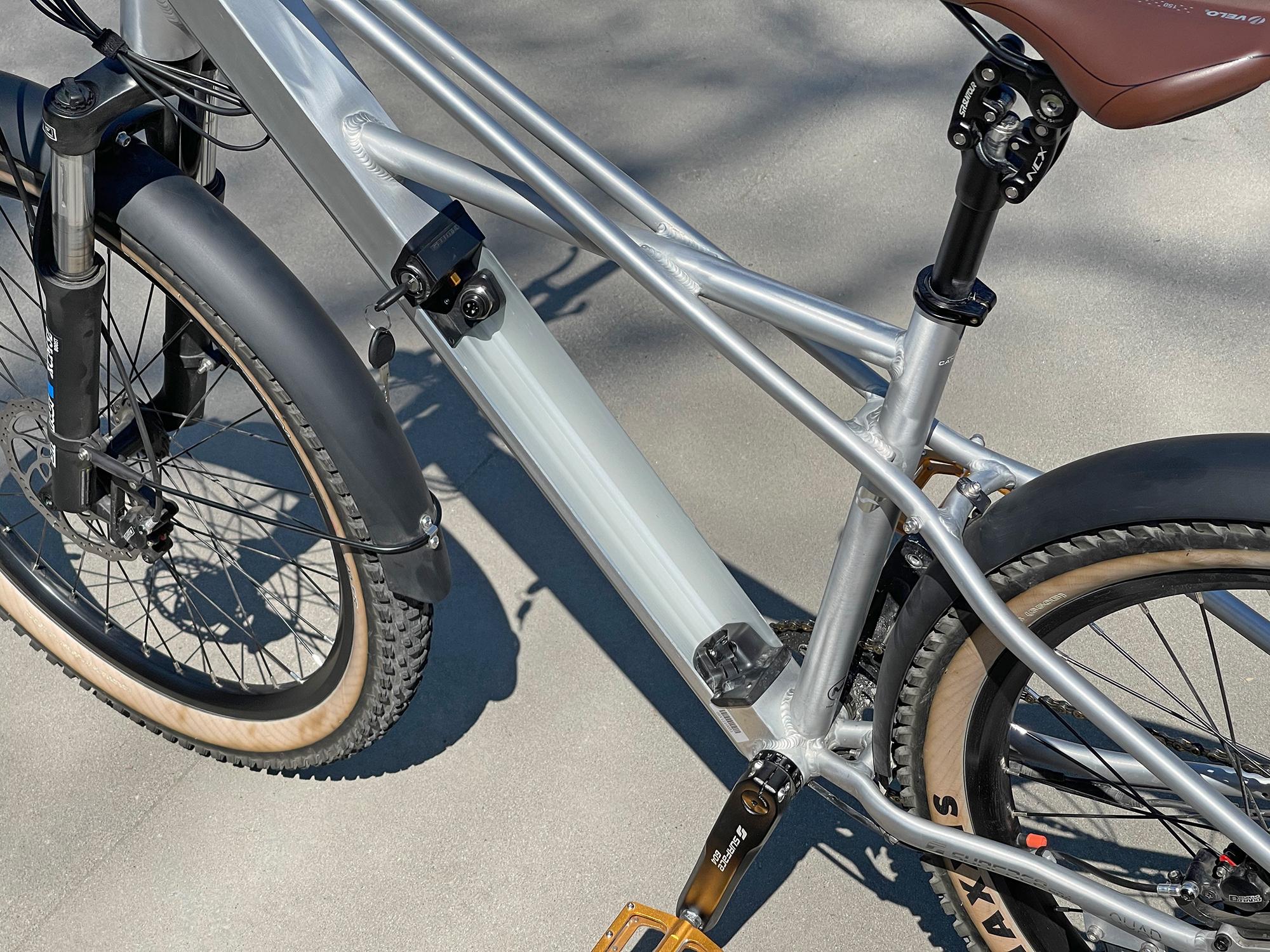

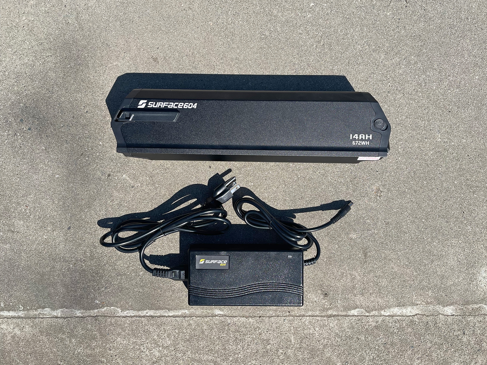

- There are two battery options with this ebike, and the default 672 is above average! For a bit more money, you can upgrade to 960 watt hours to extend range (great if you plan to use the throttle frequently). I love that both battery packs have a built-in USB port for charging accessories, even if the battery is not on the bike. There is a second USB Type A port built into the base of the display, so you don’t have to run wires all over the bike if you add more lights or want to charge your phone… this is all great considering the extra energy the bike batteries both have.
- My understanding is that many of the Surface 604 bikes now use the same Reention Dorado battery interface, so the battery pack can be shared! This is a more open battery standard, which means you can have the batteries repacked or purchase them from generic suppliers someday if S604 changes their design or goes out of business.

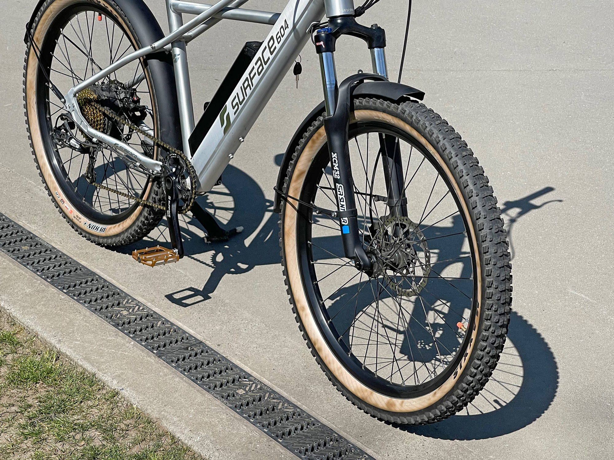

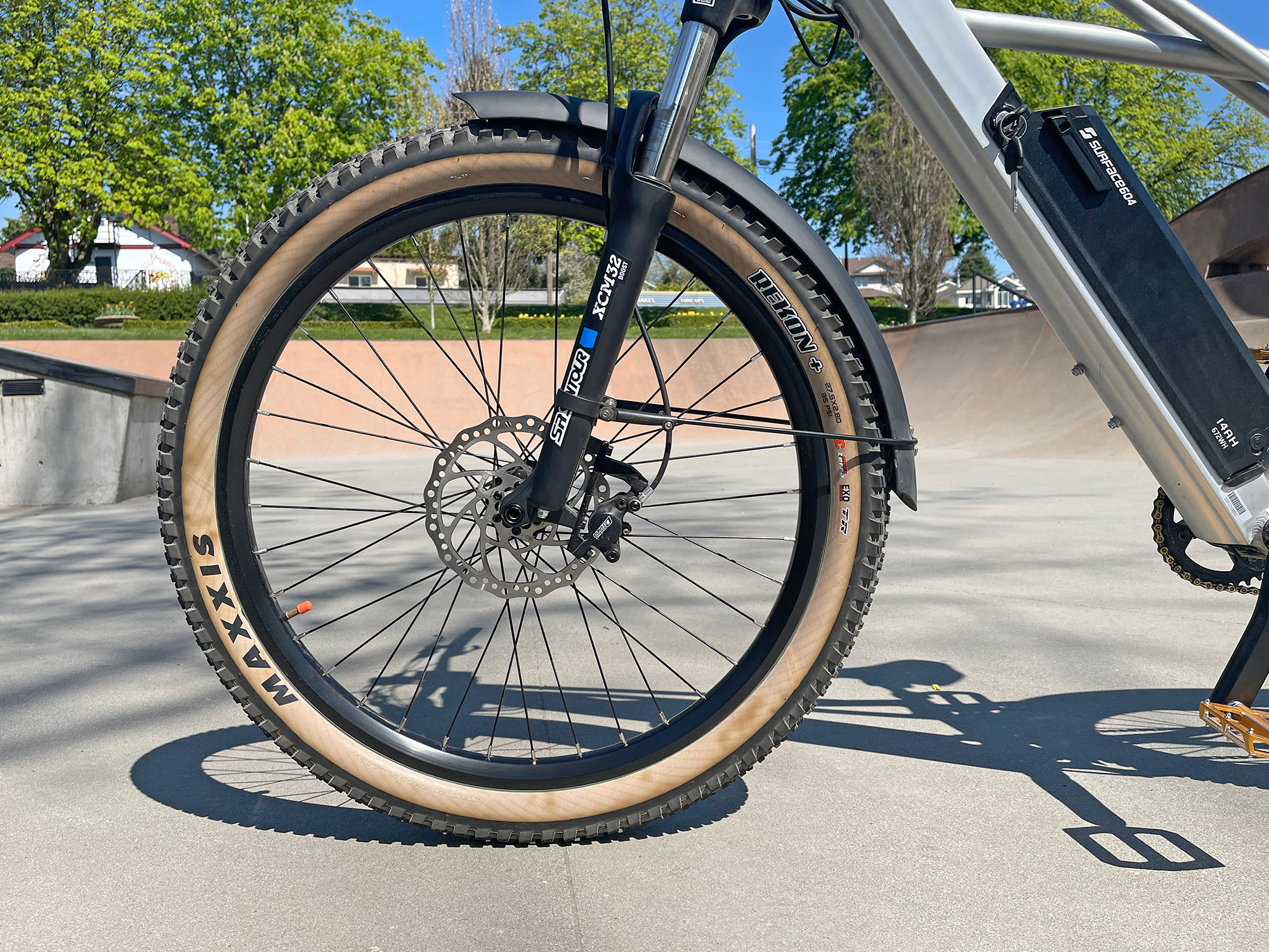

- Pretty good suspension fork here, I love that it offers lockout and preload adjust to “pre load” the spring for heaver riders. The sturdy 15mm thru-axle is a big upgrade from 9mm axles that use quick release, and the wider 110mm Boost hub spacing improves spoke bracing angle and strength. The front wheel has 13mm spokes and the rear appears to be 12mm which is even thicker. The wheels are super sturdy and use 36 spokes, so they should be capable of handling heavier riders and heavier trails.

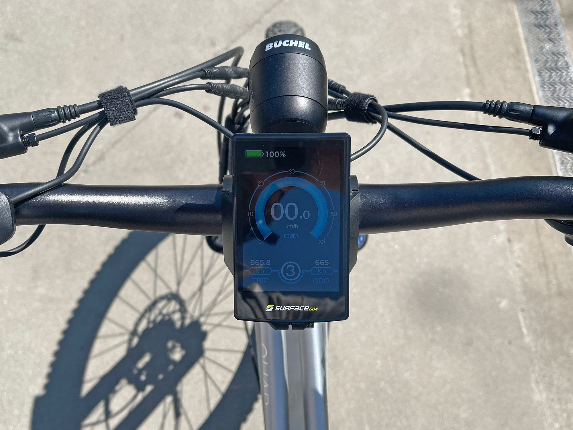

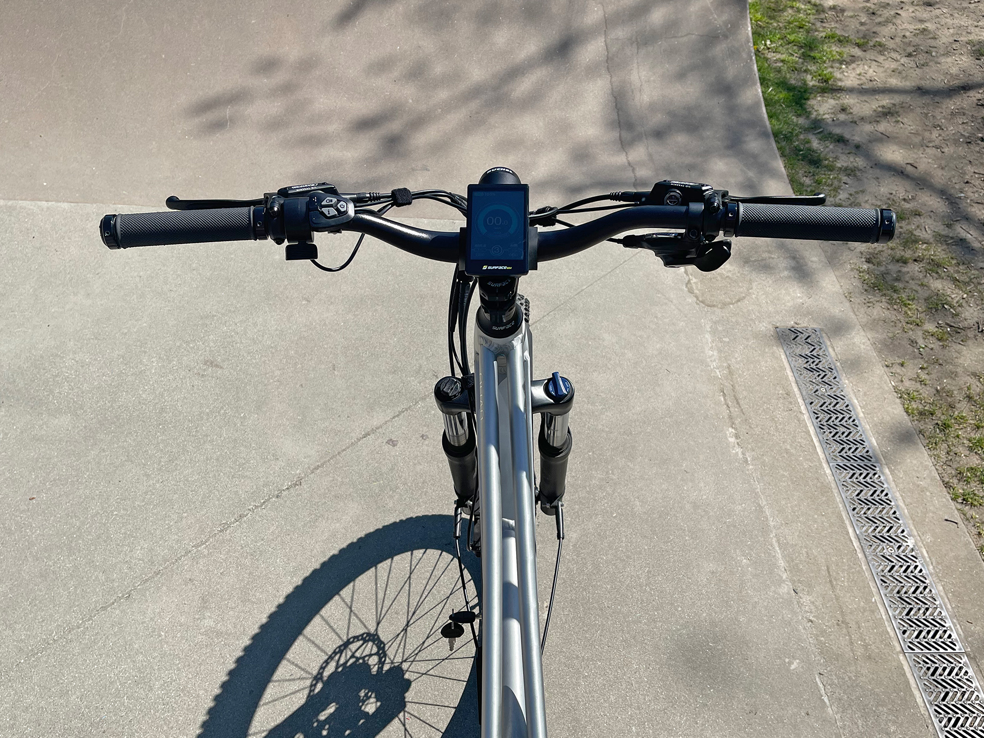

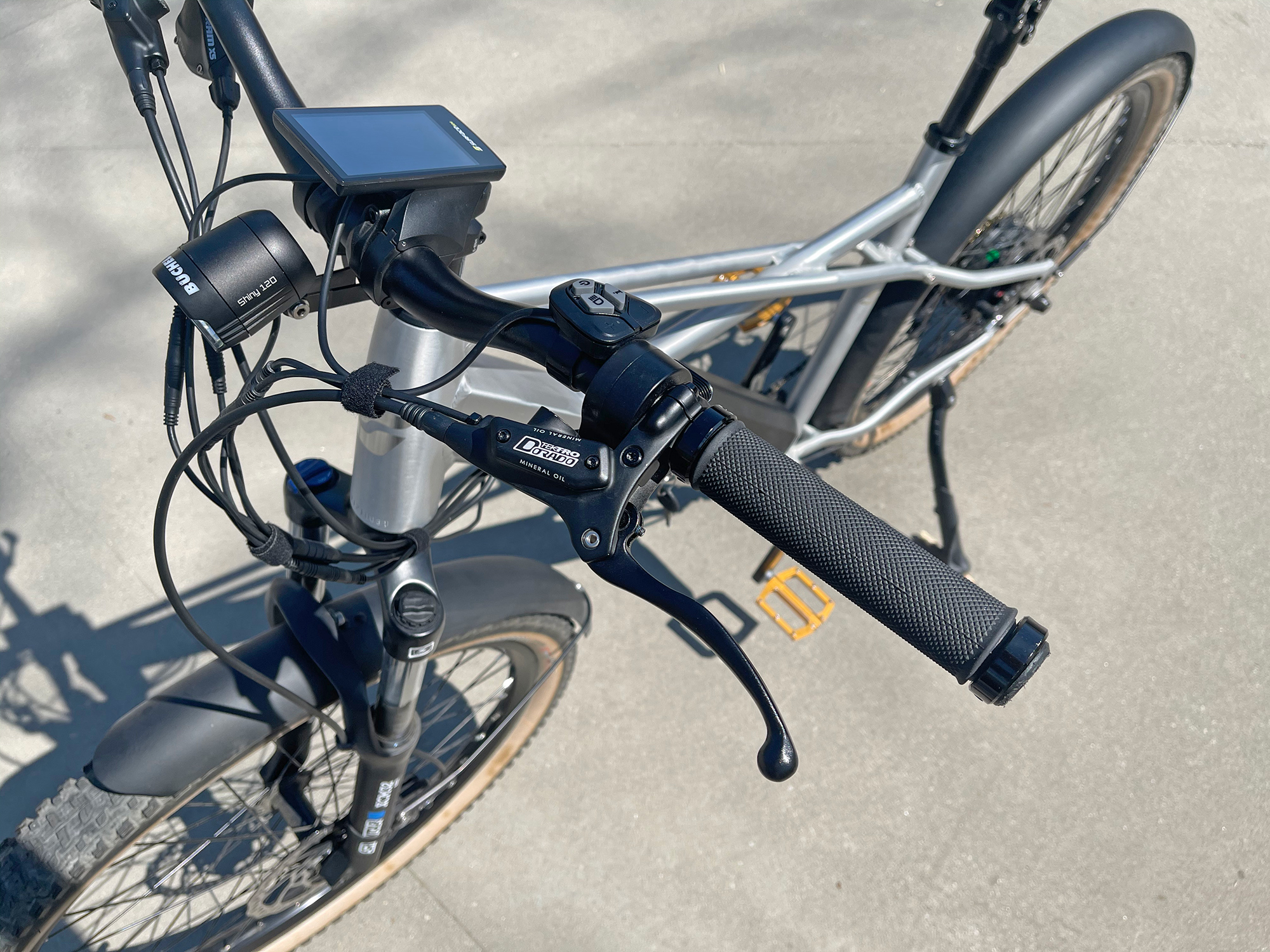

- The LCD display is large and fairly easy to read, it offers adjustable angle to reduce glare and has the USB port in the bottom. I appreciate that the button pad for it has a dedicated lights on/off button and info button. You can get into the settings fairly easily by holding + and – simultaneously and S604 has codes that let you unlock higher speeds if you wish. Both the button pad and trigger throttle are fairly easy to reach and intuitive to operate.

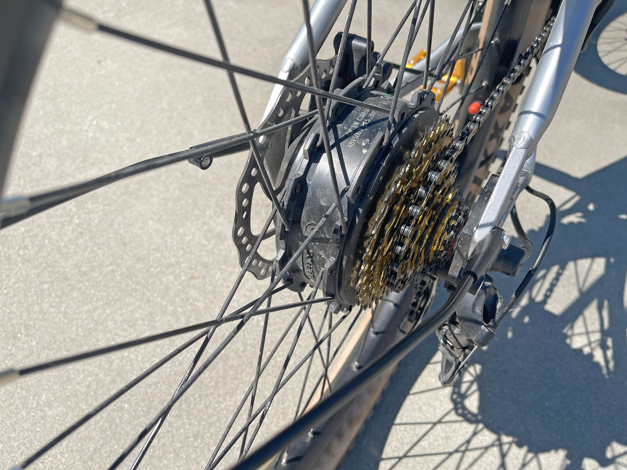

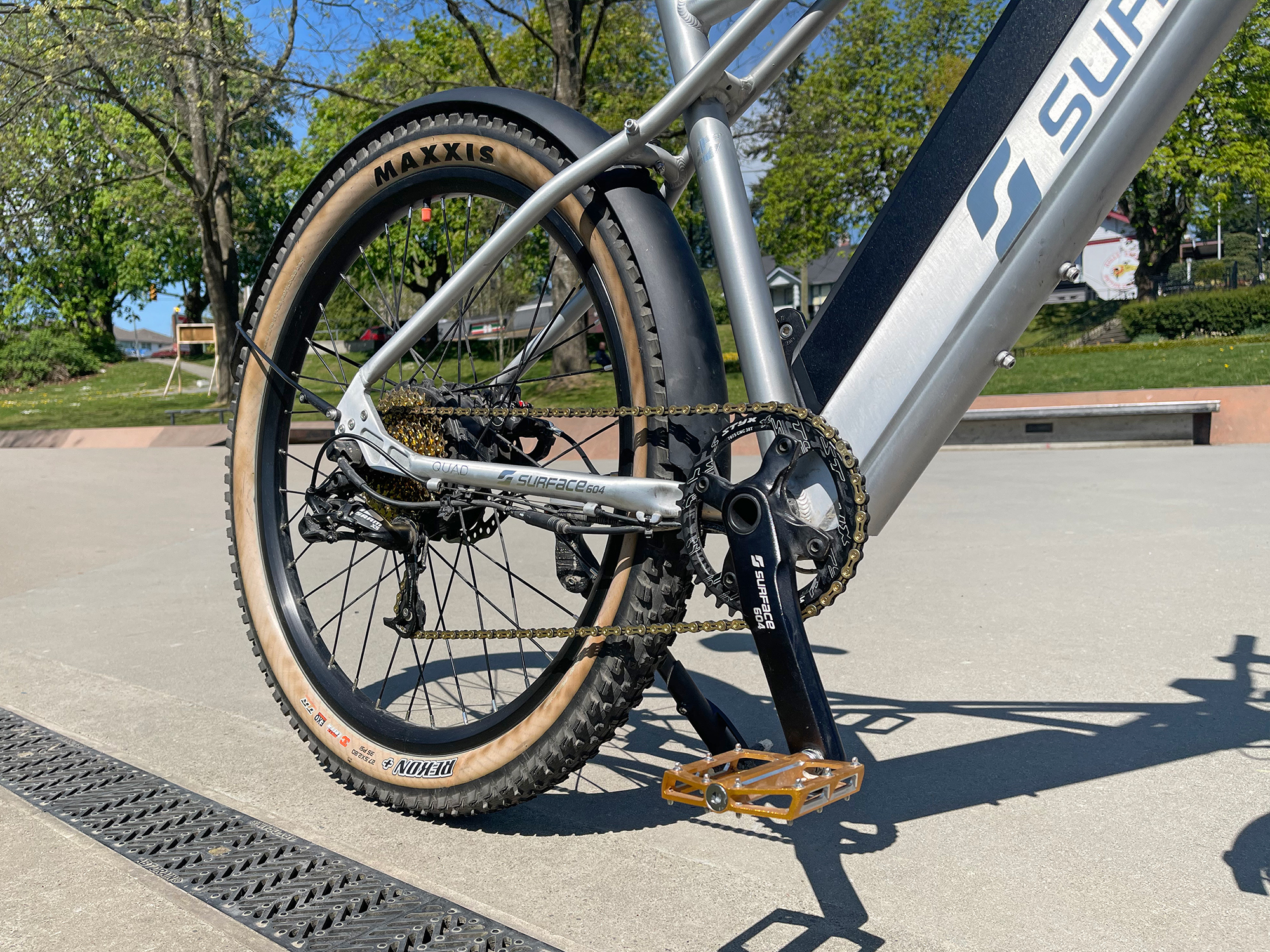

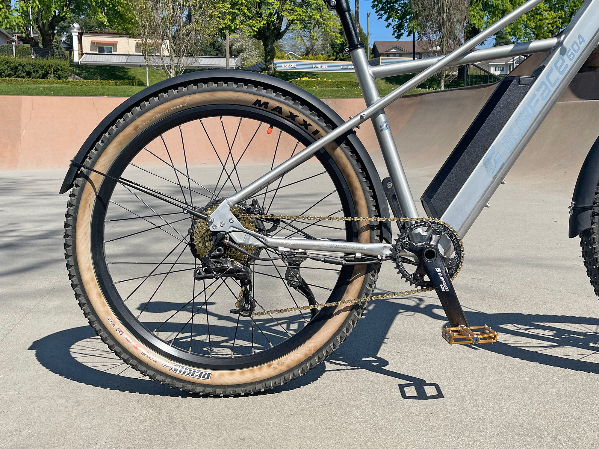

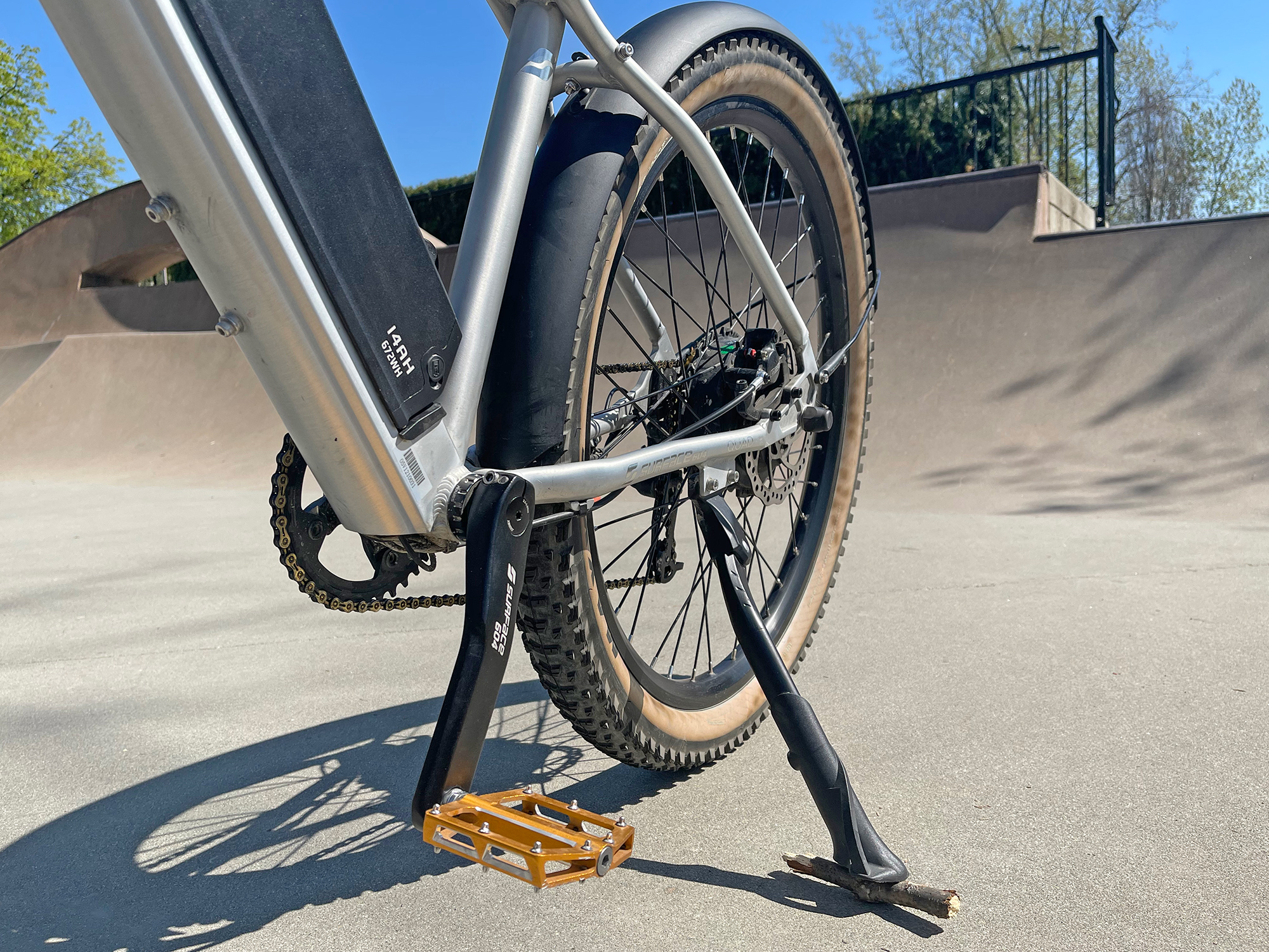

- Speaking of off-road, not only are the chain and cassette upgraded (with a wide 11 to 36 tooth cassette painted gold) but the chainring uses a narrow-wide tooth pattern that grabs the chain more securely so you don’t drop it when riding on bumpy sections of trail. It’s a clean lightweight way to improve the drivetrain vs. a full guide.

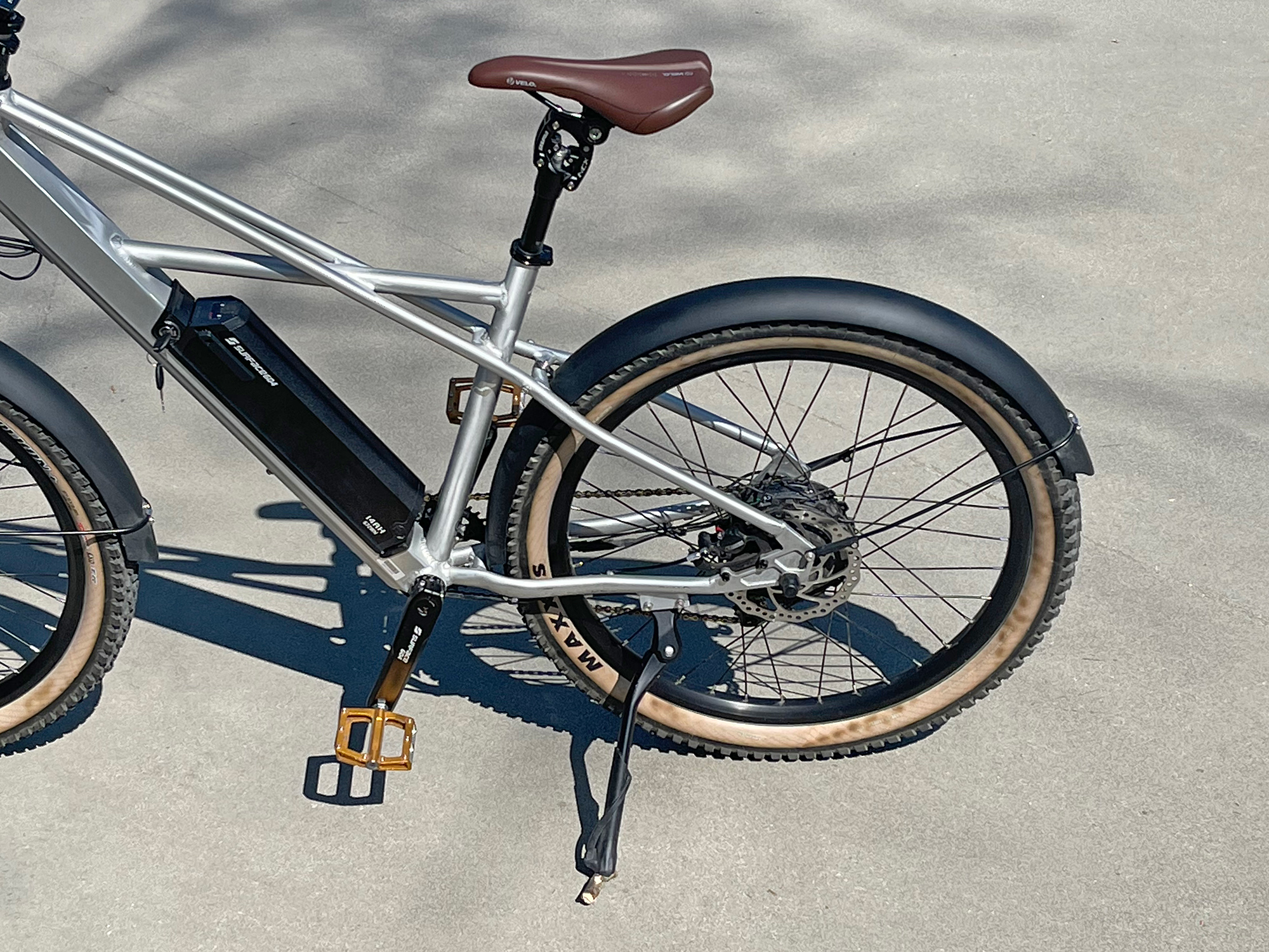

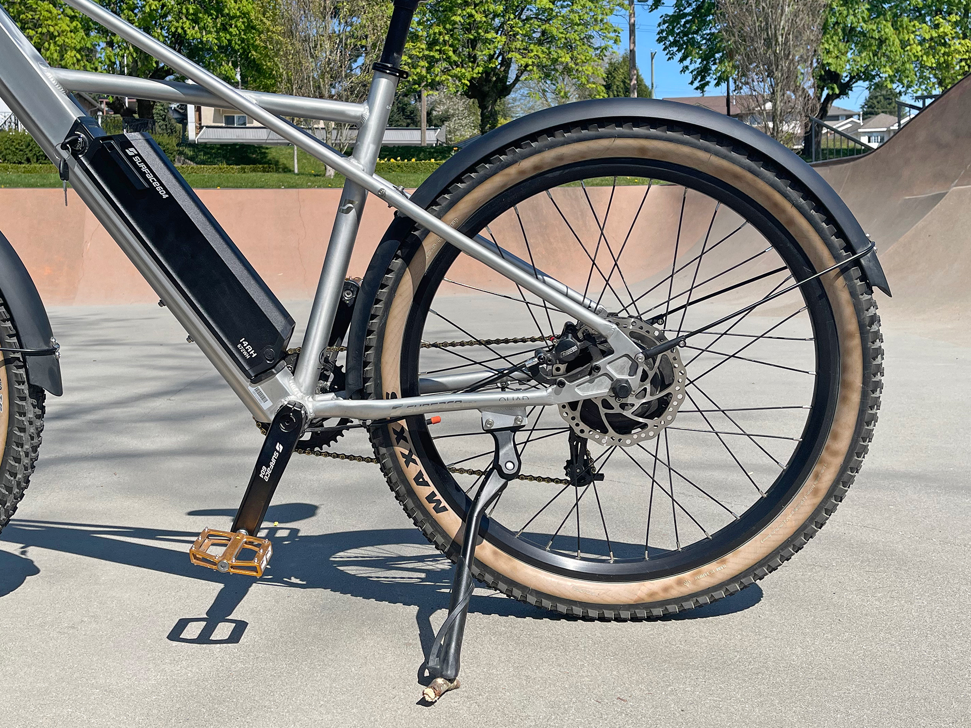

- I appreciate the kickstand choice here, because it offers adjustable length. It’s mounted using a standard 40mm bolt spacing, which makes it easy to replace. They positioned it far enough back that it won’t cause pedal lock when backing the bike up, and it should support a loaded rear rack well.
- The large 27.5″ x 2.8″ plus sized tires offer a larger contact patch that improves grip, float, and stability. It’s a popular size for ebikes because the additional weight and drag are more than offset by the motor. These tires come tubeless ready if you wish to set the rims up, they are puncture resistant, and have the stylish brown sidewall. The larger overall diameter is close to 29″ which offers a lower attack angle for easier rides over rough terrain.

- This is a minor thing, but the brake levers both offer adjustable reach for improved fit, and I suspect that they activate the rear light if you get that as an option with the rack (at least this is the case for their city models like the Surface 604 Rook and Colt).
- Lots of changes from previous generations for easier maintenance and repairs, for example, the controller has been changed to use standard XT60 connectors and is much easier to reach for diagnostics and repairs when necessary. Notice the quick disconnect for the motor, headlight, display, brake motor inhibitors, and trigger throttle. The controller has also been upgraded to produce 20 amps of power output for that zippy powerful ride feel. Many cheaper ebikes use 18 amp controllers.

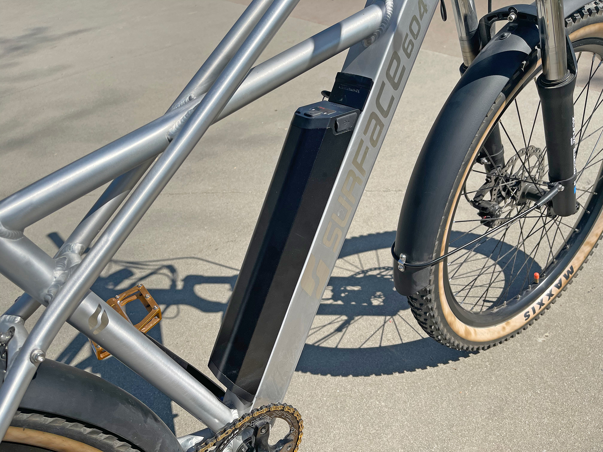

- The battery locking cylinder and charge port are both on the non-drivetrain side of the bike, which is more vulnerable since it leans that way when on kickstand. The charge port is low, and exposes the charging cable to the left crank arm. You have to bend down to plug it in, and the bike leans towards you. I’d prefer both of these to be high on the right side of the bike for easy access and reduced snag potential.

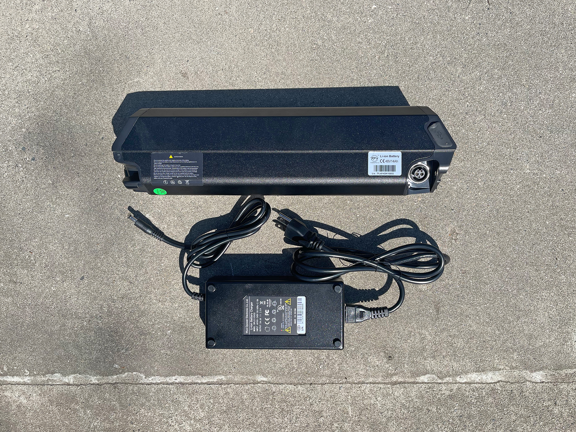

- The charger for this ebike is pretty basic, though I do appreciate the branding they did. It’s fairly compact, has a removable wall-side cord to reduce length, and it only weighs ~1.4lbs, but it only puts out 2 amps. This makes it slower than some of the 3 and 4 amp chargers I’ve seen from other companies, which is especially relevant if you get the upgraded 20 amp hour battery (960 watt hour) because it could take 7+ hours for a full charge. I’ve also heard that the barrel style charger plugs can ark easier or crack the plug socket if bumped.

- The display panel is not removable, and may take damage when parked at bike racks. it’s all meant to be fairly water resistant though, which is great if you ride this as a commuter. The throttle is on the left side vs. right, which I feel is more intuitive to people who grew up riding mopeds, motorcycles, jet skis etc. but that’s because the trigger shifters for the gears are on the right and they didn’t want to compromise the sturdy grips with a twist throttle (sometimes less safe when actually riding off-road on bumpy terrain than a trigger).
- As great as the torque sensor is for starting and responding naturally, it didn’t seem to cutoff as quickly as a multi-sensor and may even activate unexpectedly when going off drops or large bumps due to chain tension changes. You can see me talk about this and demonstrate in the video review above. To overcome this issue, just pull either brake lever slightly whenever you wish to cut power to the motor.

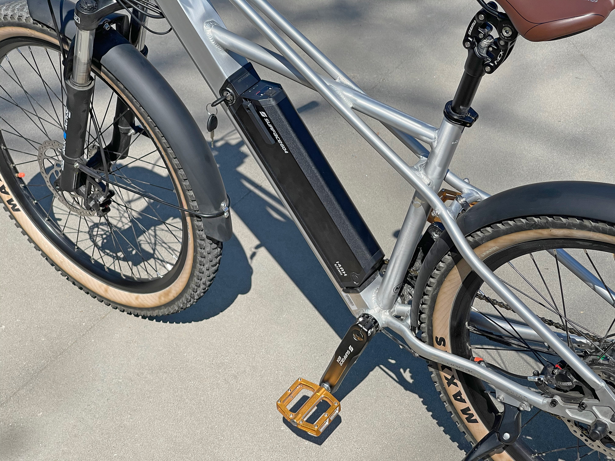

- If you opt for the upgraded 48 volt 20 amp hour 960 watt hour battery pack, you will notice that it spills out to the left side a bit and is not perfectly centered on the frame. This bugs me a bit aesthetically and may slightly impact the balance of the frame.
- While the quadangle frame looks cool and is sturdy and stiff, it does not leave enough room for a bottle cage mount on the seat tube and may be difficult to hang on some car and bus racks, or to shoulder and carry.

- The control pad is mounted behind the trigger throttle on the left, and I found that it took a bit more flexibility and effort to reach in this configuration, you could always change the order, but then the throttle would be tricky to reach, you could also try to put the throttle on the right portion of the handlebar but then it will interfere with the trigger shifters, maybe a future throttle mount will be narrower so the buttons can move closer…
