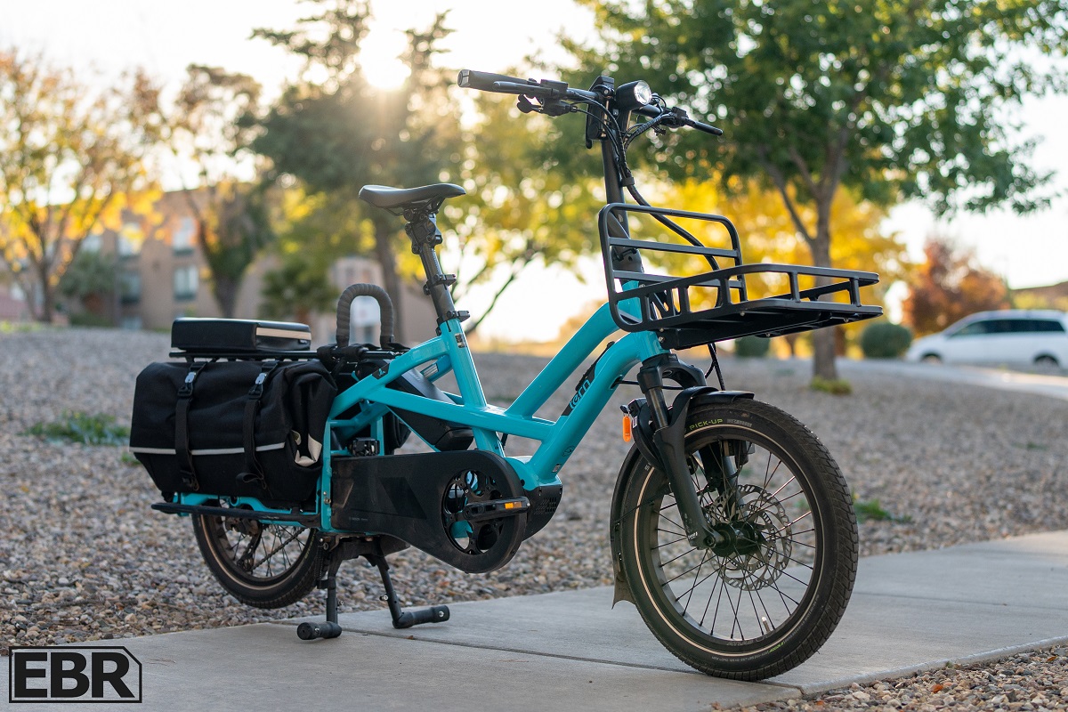

When Tern unveiled the original GSD at Eurobike in 2017, they essentially created the compact longtail cargo e-bike category. The pitch was simple: deliver serious hauling capacity (440 lbs) in a package no longer than a standard bike. It worked. The GSD became the benchmark that spawned dozens of competitors.
Fast forward through Gen 2’s refinements in 2020 (beefier frame, Bosch Cargo Line motor, suspension fork) and we arrive at Gen 3 in early 2025. This isn’t a ground-up redesign. Tern took seven years of real-world feedback and focused on three areas: increased capacity (now 463 lbs), Bosch’s Smart System integration, and proper ABS braking borrowed from motorcycles.
The S10 sits in the middle of the four-model Gen 3 lineup. Below it are the P00 and P10 base models without Smart System or ABS. Above it is the R14 with its Rohloff electronic hub and Gates belt drive. The S10 gets you the cutting-edge tech (GPS tracking, electronic lock, app connectivity, ABS) while keeping the Shimano Deore chain drive for easier servicing.
We spent a week with the S10 in southern Utah. Here’s what we found.

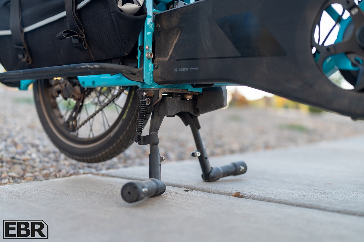

Speaking of little things, the dual-legged Atlas Lockstand is brilliant in execution, and I’d like to see it applied more often. Most cargo bike kickstands work fine when stationary, but mounting a loaded bike and getting moving from a dead stop can be sketchy. Tern solved this with a remote stand lever on the handlebars. The kickstand stays locked in the down position until you’re ready to go. Hit that lever, shift your weight forward, and the stand releases cleanly as you pedal away. No wobbling, no fighting with the stand while trying to balance kids and cargo.
They also addressed a common kickstand complaint by building a weatherproof container around the hinge mechanism. Previous versions would get gunked up with road grit, gravel, and mud, causing reliability issues. This sealed cover keeps the grime out while maintaining smooth operation. It’s another one of those details that shows Tern actually listens to people who ride these bikes daily.
Out on the road, the GSD S10 just feels dialed in. The hydroformed frame is stiff and handles predictably even when loaded, and those Schwalbe Pickup tires are smooth and quiet. The Bosch system is smooth and quiet, and I found myself gravitating to the Auto mode most often. You’ve got Eco, Tour, Auto, and Cargo modes available, but Auto just reads your effort and delivers the power you need without thinking about it. Flat roads, hills, heavy load, light load, it adapts. I reserved Cargo mode for when I was genuinely maxed out on weight and needed that extra punch.

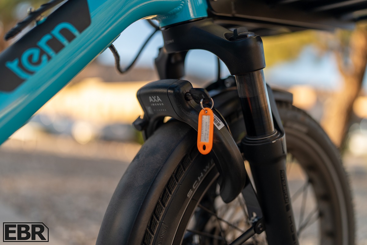

I also never felt anxious parking it outside the grocery store or gas station, which says something about an $8,000 bike. The electronically activated ABUS wheel lock, audible alarm, and flashing lights kick in if someone tries to move it. And if they somehow manage to steal it anyway, the Flow+ app lets you disable the battery remotely, meaning they’re stuck pedaling 80 pounds of dead weight while the alarm blares and lights flash. Good luck making a clean getaway.

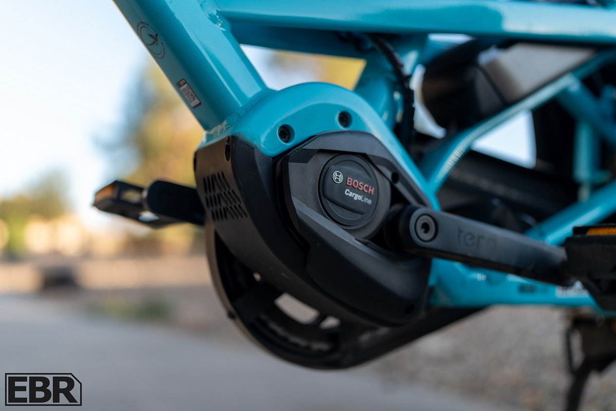

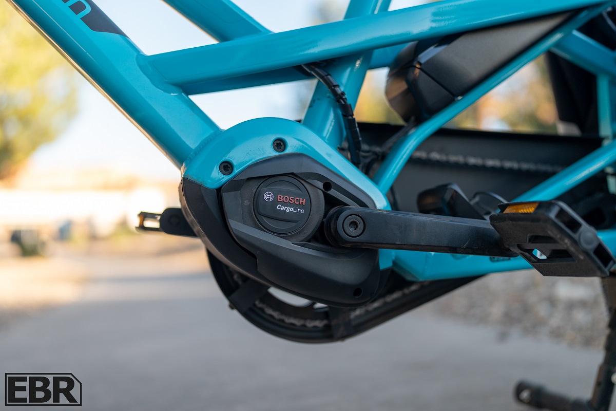

The power setup on the new Tern GSD S10 is brought to you by Bosch, and it’s important to understand you’re not just getting “a motor”—you’re buying into a complete Bosch ecosystem of premium e-bike tech that all works together.
At the heart of it sits the Bosch Cargo Line mid-drive motor, purpose-built for heavy loads. It peaks at 600 watts, delivers up to 400% pedal assistance, and pushes 85Nm of torque: exactly what you need when hauling kids up hills or starting from a dead stop with a fully loaded rear rack. This isn’t a commuter motor pressed into cargo duty; it’s specifically engineered for bikes that regularly carry serious weight.
But here’s where it gets interesting: that motor is just the starting point. The Bosch ecosystem includes the eBike Flow app for motor tuning (letting you set custom power values at each assist level to match your riding style), the Bosch Anti-Lock Brake system that prevents wheel lockup during emergency stops (which I initially thought was managed by the excellent Magura brakes until I learned it’s actually its own Bosch module), and Flow+ connectivity features for theft protection and GPS tracking. We’ll dive deeper into the app and security stuff in the Display section below, but just know this is a deeply integrated system, not a collection of parts bolted together.

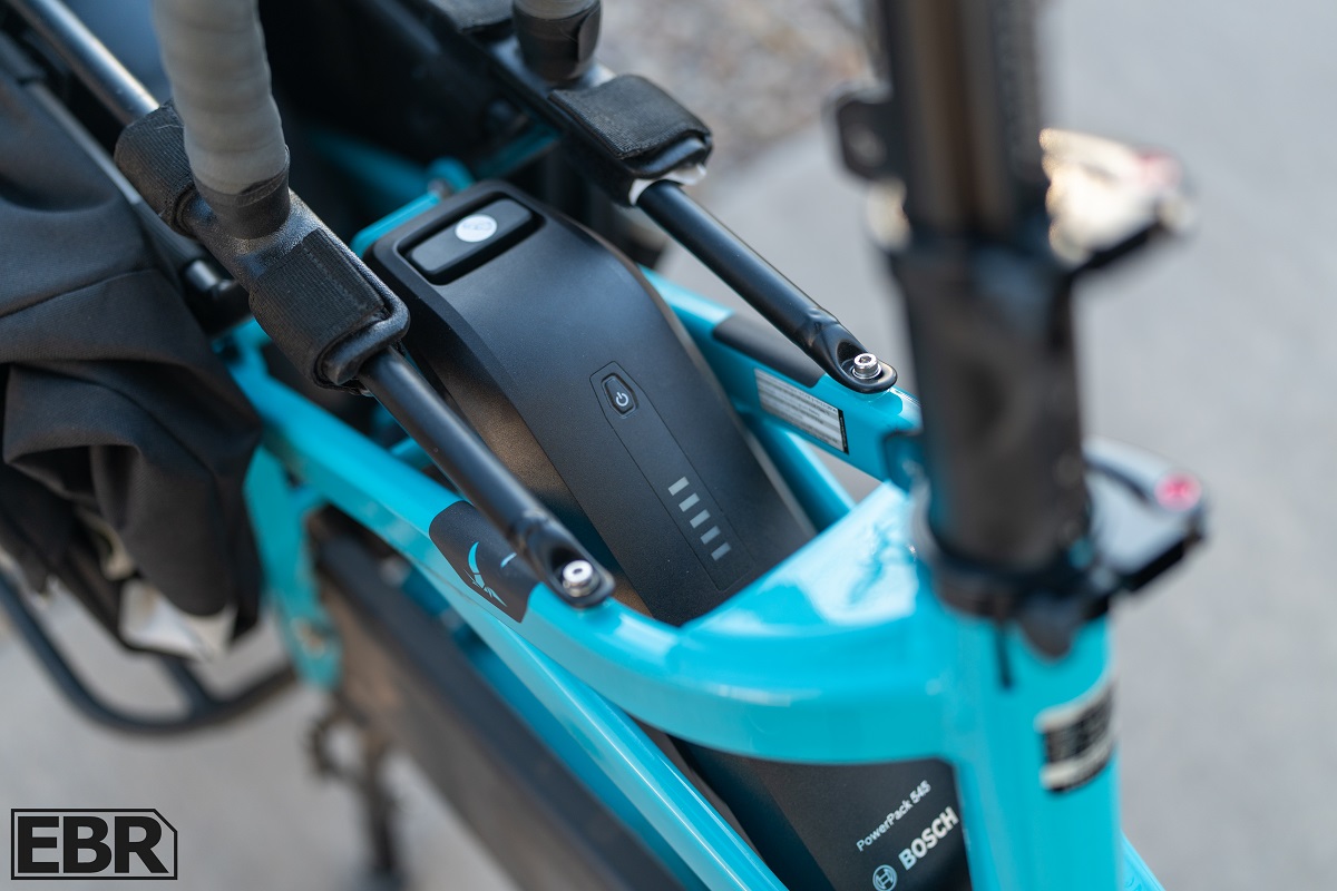

Powering everything is the Bosch PowerTube 545, which as you’d guess from the name, carries 545Wh of capacity and weighs just 6.5 lbs. There’s a handy LED light bar on the exterior displaying charge level, so you can check battery status at a glance without installing it and powering up the whole bike.
The battery mounts cleanly below and behind the seatpost, almost tucked between the post and rear rack, keeping the weight centered and out of sight. And here’s the beauty: if you opt for the dual battery setup, there’s a second dock that lets you effectively double your range. Both batteries mount neatly side-by-side without cluttering up the bike’s clean lines.

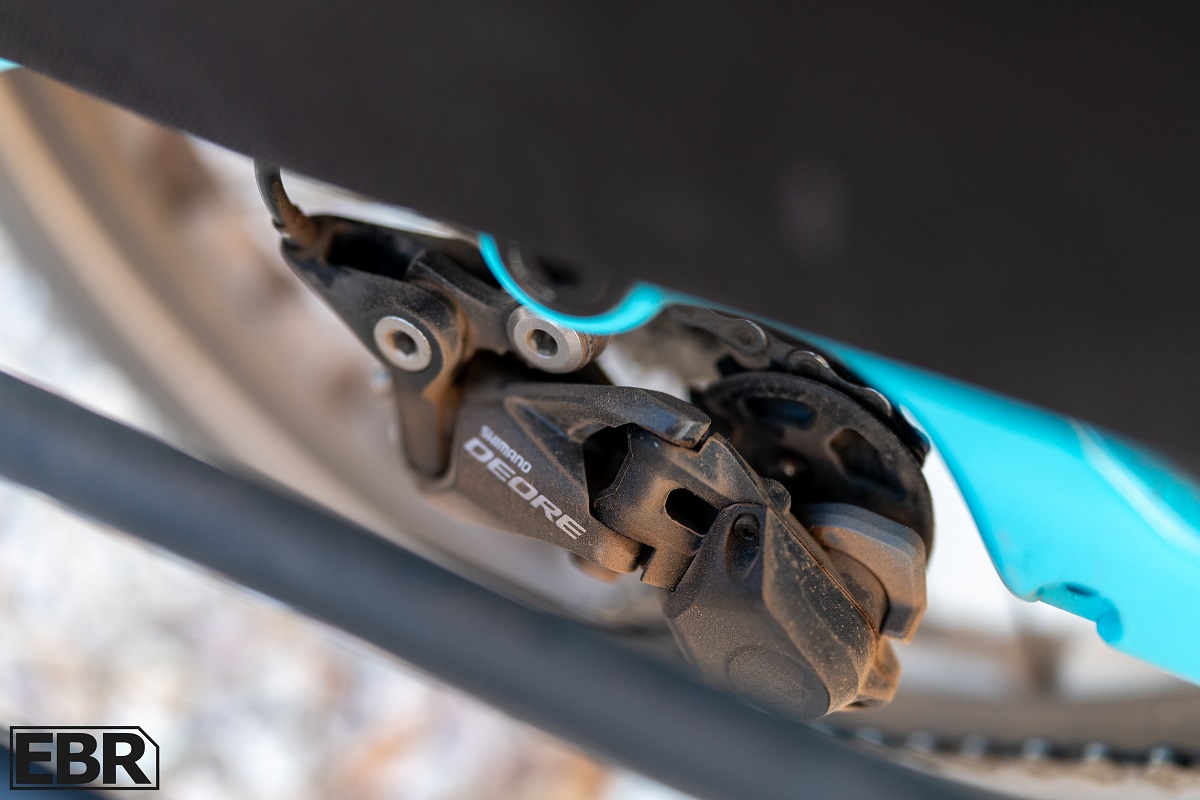

The Tern GSD S10 runs a Shimano Deore 10-speed drivetrain with an 11 to 51t cassette, giving you a genuinely wide gear range for everything from crawling up steep hills with a loaded bike to maintaining a comfortable cadence on flat ground. It’s a mid-tier mountain bike groupset that’s proven reliable and easy to service at any bike shop, which matters when you’re putting serious miles on a cargo hauler. The chain drive does require regular maintenance (cleaning and lubing), unlike the Gates belt setup on the pricier R14 model, but it’s also significantly cheaper to replace if you trash it.

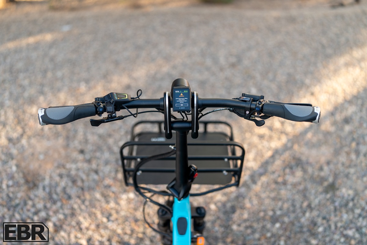

Up in the cockpit, Tern’s obsession with adjustability really shines. The Andros adjustable stem is a first for me and frankly, I hope we see it more often in other brands. It offers 110 degrees of rotation, letting you dial in handlebar height and angle without any tools in just seconds. This isn’t a minor tweak, it’s the difference between a comfortable riding position and constantly adjusting your back and shoulders. Combined with the adjustable grips and that wide fit range (4’11” to 6’7″), it means the whole family can genuinely share this bike without compromise.
The handlebars themselves fold and lock into place with a simple mechanism, and there’s a rubber retention strap on the downtube that secures everything when folded for storage or transport. It’s one of those small touches that shows someone actually uses this bike daily.

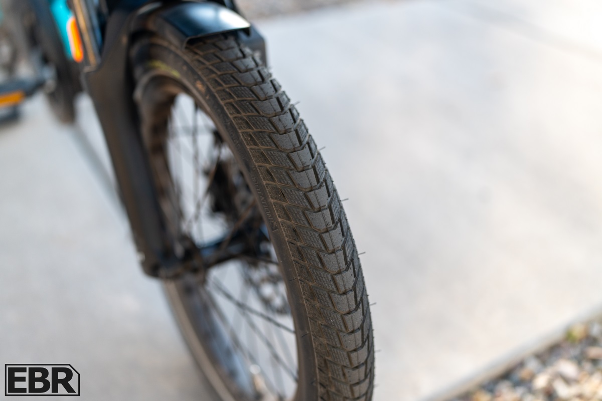

Rolling on 20-inch wheels with Schwalbe Pickup tires (2.35 inches wide), the GSD strikes a nice balance between stability, cushioning, and rolling resistance. The smaller wheel size lowers the center of gravity for better handling with heavy loads, while the fat rubber soaks up bumps and provides confident grip in all conditions I tested.

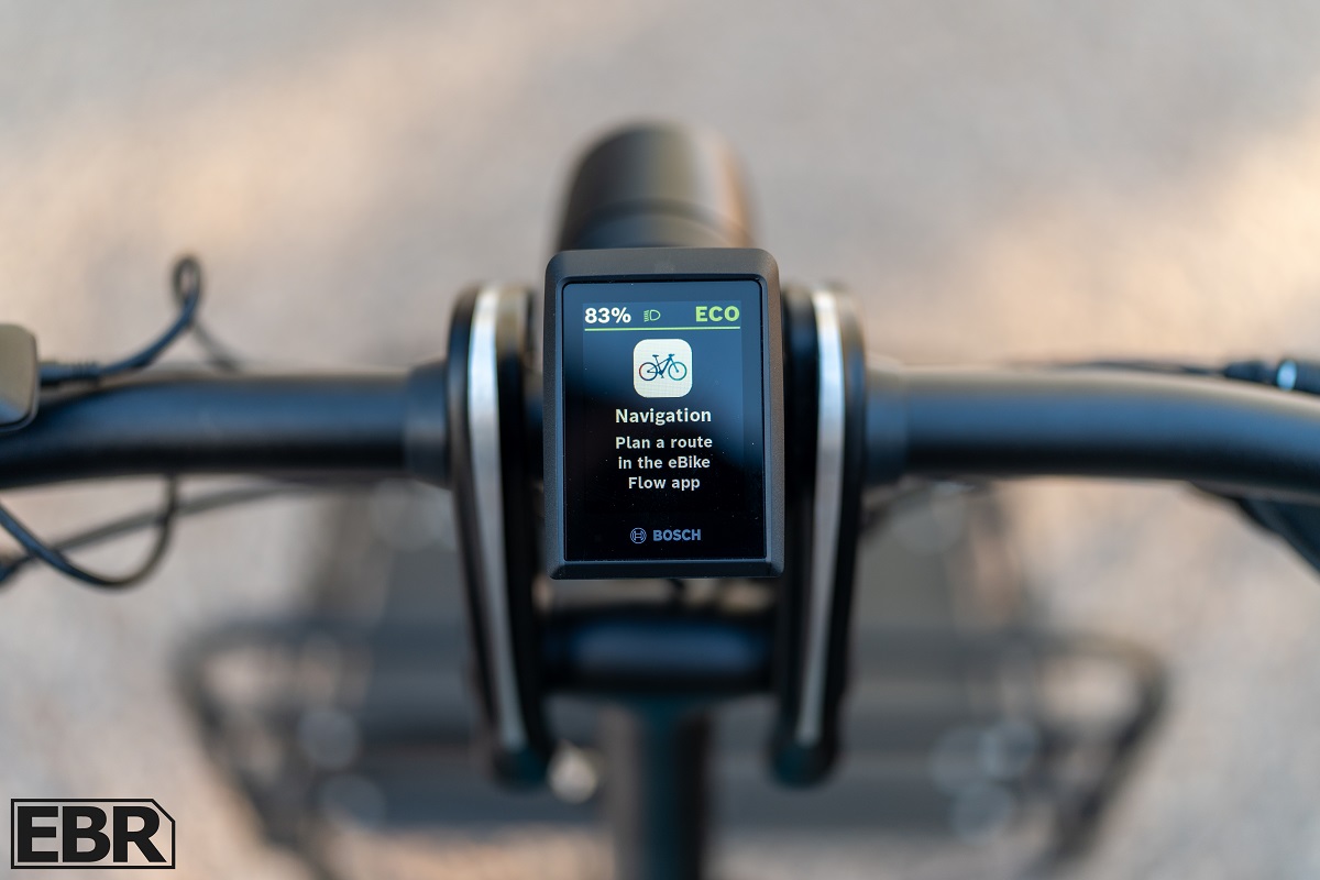

The GSD S10 comes equipped with the Bosch Kiox 300 display, a full-color screen mounted on the handlebars showing all the essentials: current speed, battery level, range estimate, assist mode (Eco, Tour, Auto, or Cargo), trip distance, and time. The screen is bright enough to read in direct sunlight and the menus are simple to navigate with buttons on the left grip.
One clever security feature: the Kiox 300 is removable. Pop it off when you park and the motor automatically disables, turning your bike into an 80-pound paperweight that thieves won’t bother with. But, if they do try something, the GSD has a suite of defense tools that make this hauler very tough to steal, but more on that in just a second.
