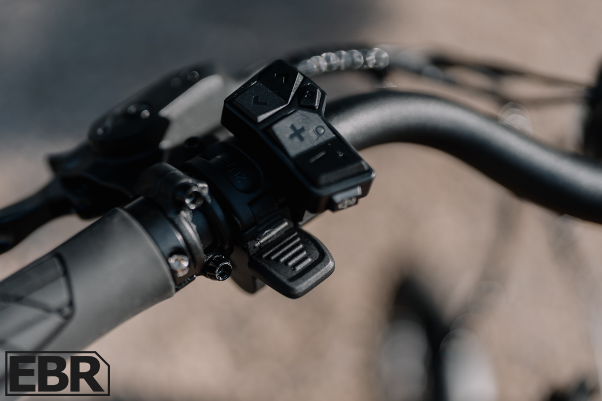

The speed control options are equally thoughtful. Worried about handling a powerful trike? Start in beginner mode with its 8 mph cap while you get comfortable with three-wheel dynamics. When you’re ready, standard mode lets you set custom speed limits at any mph increment from 8 to 20. You can work your way up one mph at a time or jump straight to full blast. It’s your call.

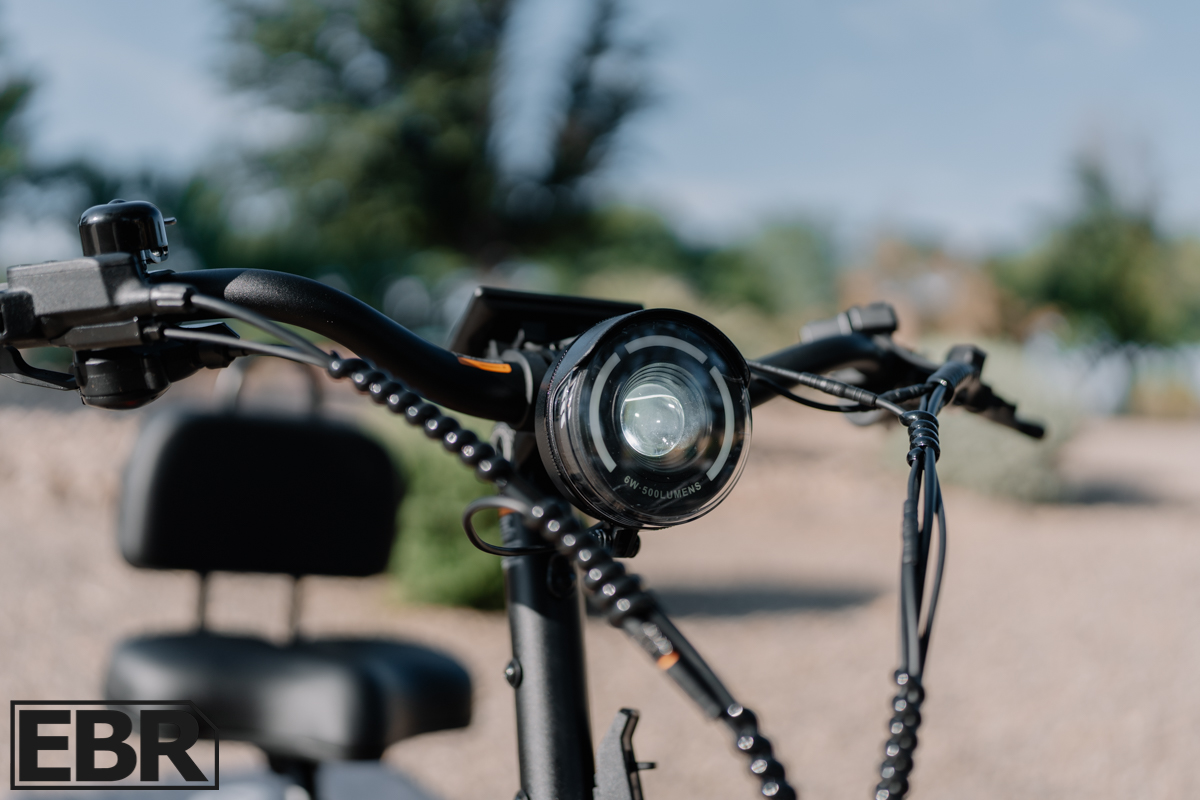

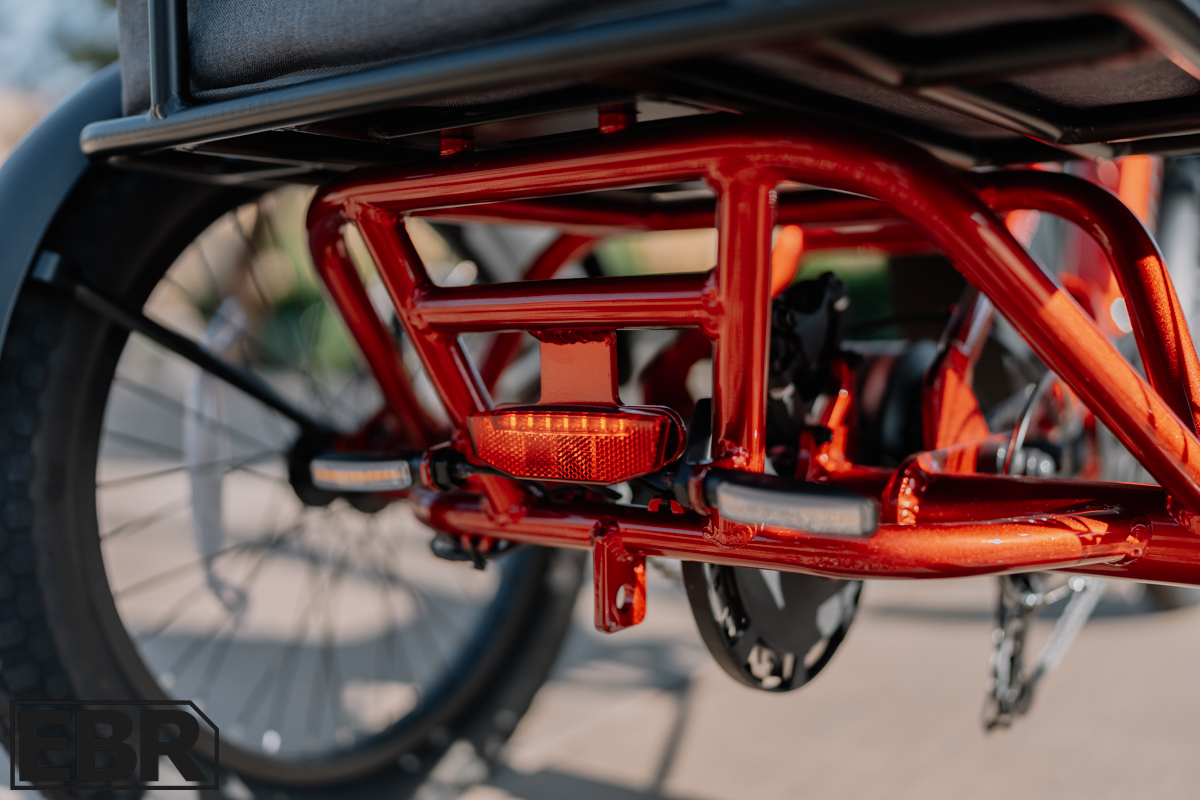

Topping it all off is complete lighting coverage: full fenders for all three wheels, front-to-back lighting with brake highlights and turn signals, plus a 400-lumen headlight that ensures you’ll be seen. It feels like what Velotric has become known for: offering more options than most brands while pushing the limits with power, all built into a three-wheeler that can handle fitness rides, grandkid adventures, or grocery runs with equal capability.

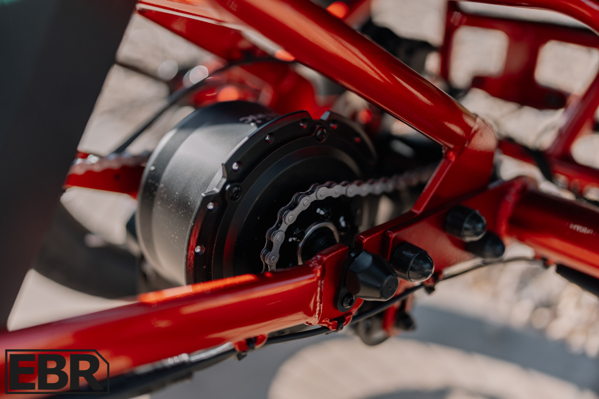

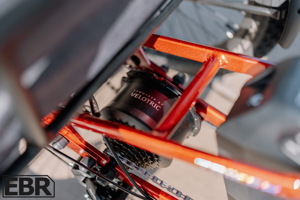

The Triker packs a 750W rear hub motor mounted just in front of the rear axle that can peak at 1,300W and delivers a respectable 90Nm of torque. For a bike that weighs nearly 100 pounds and can haul a 500-pound payload, those are solid numbers that should get the job done without leaving you wanting more power on hills or when loaded down with cargo.
Velotric gives you two riding modes to work with. Beginner mode keeps things capped at a gentle 8 mph, which is perfect for new riders or younger family members who are still figuring out how to wrangle a big trike around corners and through tight spaces. Standard mode is where things get interesting: you can customize the speed limit anywhere from 8 to 20 mph, giving you full access to the Triker’s capabilities since 20 mph is the legal max for Class 2 bikes.
But here’s my favorite feature: the switchable motor sensor system. You can swap between torque and cadence sensing on the fly through either the display or the app in just a few seconds. I love this because it solves one of the most common questions new riders ask me: “Which sensor type is better?” The honest answer is that it depends on your riding style, the terrain, and personal preference. Some folks love the natural feel of torque sensing that responds to how hard you pedal, while others prefer the consistent boost of cadence sensing that kicks in as soon as you start pedaling. With the Triker, you don’t have to pick a side and live with it forever.

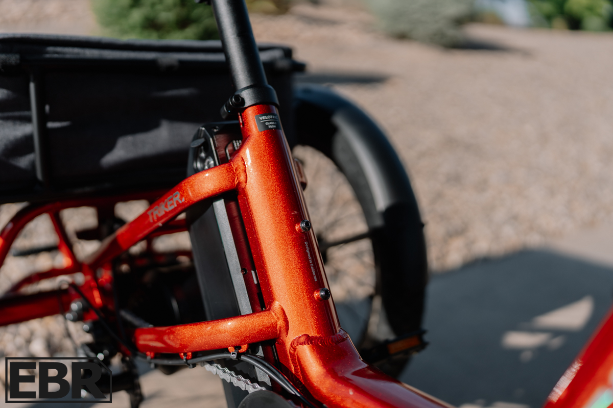

The battery setup is a removable (by the integrated lock and provided key 48V, 16.6 amp-hour unit delivers 804Wh of capacity and sits mounted under the saddle along the seatpost. This central, low placement keeps the center of gravity where it should be instead of making the bike feel top-heavy or unbalanced. The battery pack carries both UL 2271 certification for the overall pack and UL 2850 certification for the individual cells, so you know it’s been properly tested for safety.

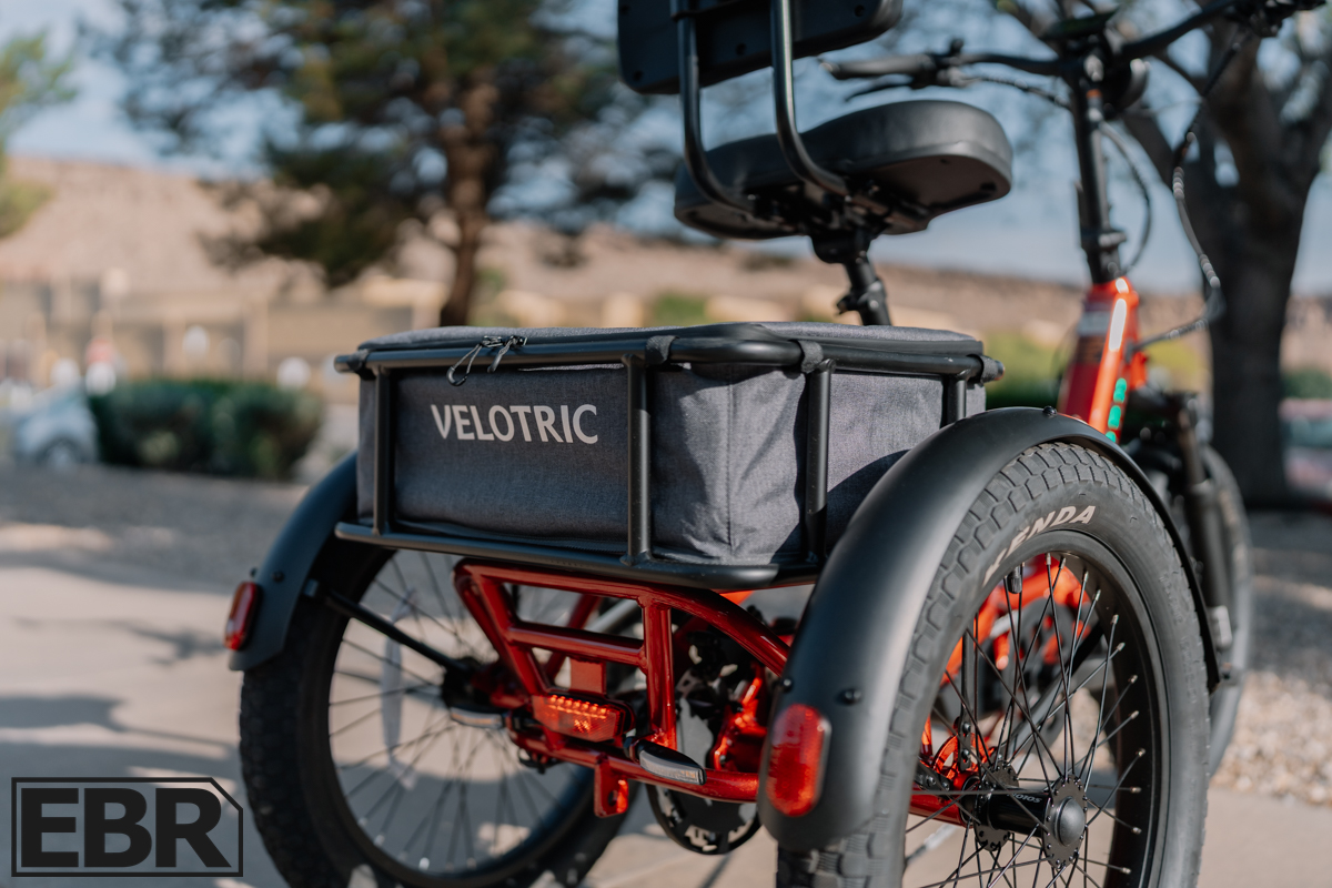

Let’s start with the frame. Velotric built this thing from aluminum alloy in a folding design that can handle a hefty 500-pound payload, with 120 pounds of that capacity dedicated to the rear cargo basket. That’s enough room for grandkids, groceries, or your favorite four-legged riding buddy. Now, about that folding feature: let’s be real with each other. This isn’t some quick-fold, toss-it-in-your-trunk situation. At nearly 100 pounds, you’re going to want a second person to help you (save your back), and while it does fold down for storage, the space savings aren’t dramatic. It’s more about getting it through doorways than making it compact.

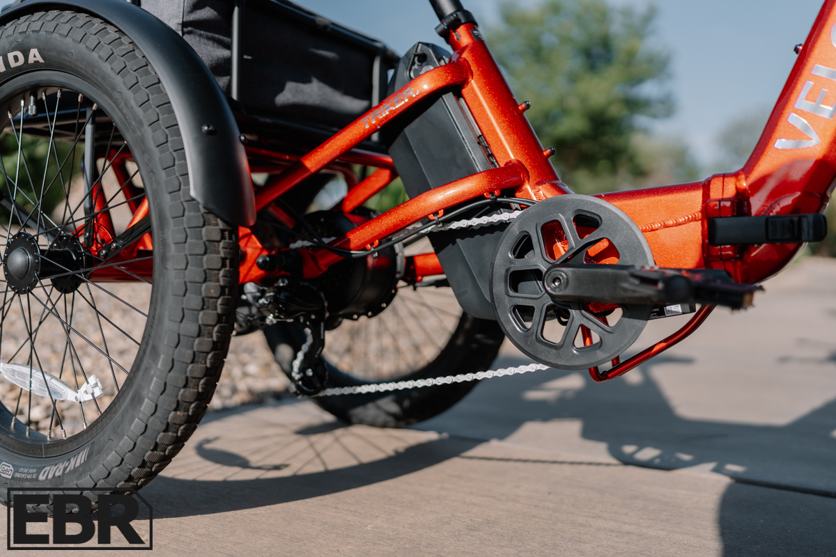

The drivetrain keeps things simple with a solid Shimano 7-speed setup. The 40-tooth chainring pairs with an 11-28 tooth cassette, giving you a decent range for flat cruising and moderate hills. Everything is controlled by an under-bar Shimano trigger shifter with a handy window that shows which gear you’re in at a glance.

Rolling on 20×3-inch alloy wheels wrapped in Kenda K-Rad puncture-resistant tires, the Triker strikes a nice balance between stability and efficiency. The tread pattern is mild commuter-oriented with some slightly raised knobs for extra traction when you need it.

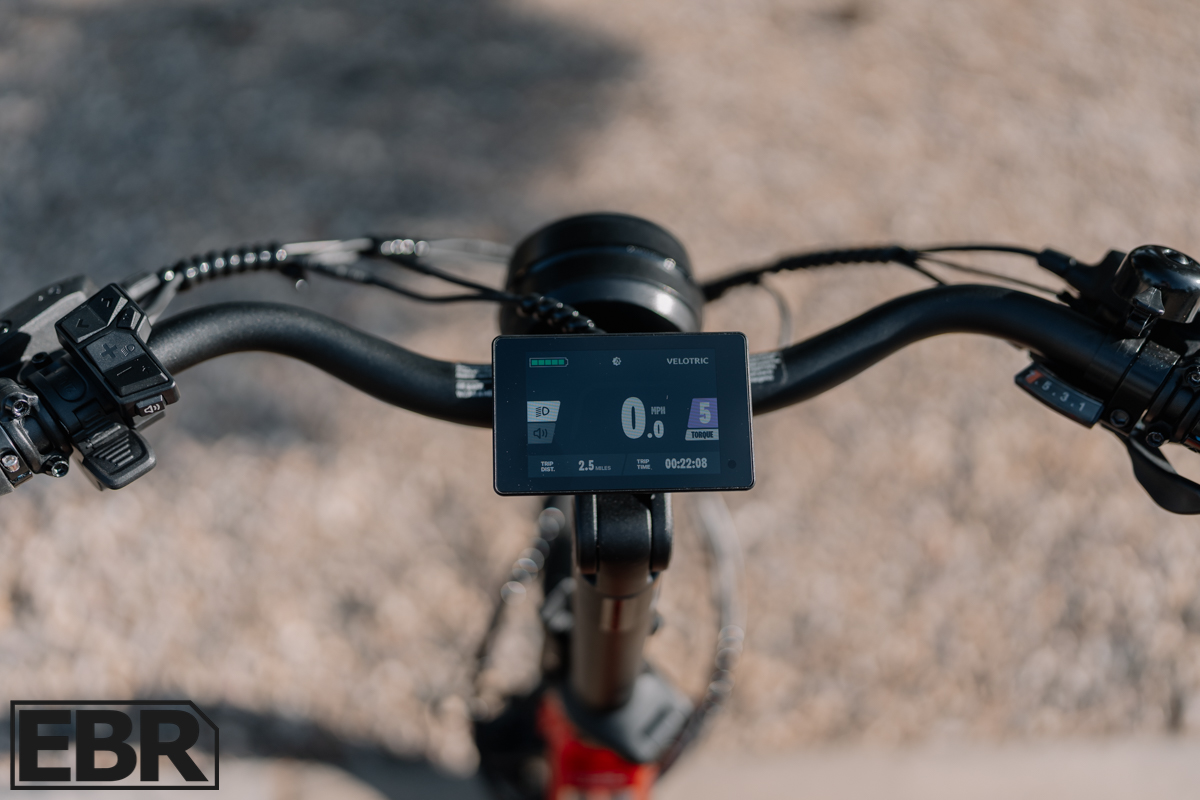

Screen / User Interface / App
The Triker comes equipped with a full-color 3.5-inch display that’s actually readable in real-world conditions. I’m talking plenty bright with auto-brightness features that adapt to different lighting, and the viewing angles are solid enough that you can see what’s going on whether you’re sitting upright or leaning into a turn.
The display shows all the essentials: battery level, PAS level, current speed, which motor sensor is active, odometer, trip meter, ride time, and even a CO2 emissions saved estimation if you’re into tracking that. There’s also a Bluetooth/app connectivity icon and headlight status, so you know at a glance what’s going on with your bike.
The advanced menus are where things get interesting. This is where you can swap between cadence and torque sensors, adjust speed limits, handle app pairing, and tweak other settings without needing to pull out your phone. It’s intuitive enough that you won’t need the manual, but deep enough to let you customize the ride experience to your liking.
