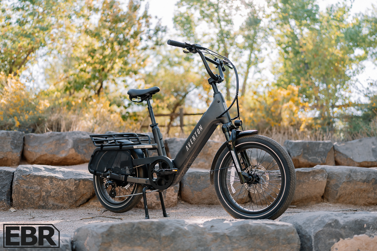

I know that looks don’t technically affect the ride quality of an e-bike, but the looks do affect the perception of how the bike rides. It’s similar to how your car seems to ride better after you take it through the car wash. Looks matter, and we think that Aventon knocked it out of the park with how sleek the Abound SR looks.
In fact, at first glance, I thought that Aventon had decided to make the Abound SR with a full carbon frame. And while that would be cool, it would also be a bit overkill and raise the price by at least $1,000.
Instead, Aventon used a gravity casting technique for the frame that both reduced the welds needed while also increasing the structural integrity and rigidity of the frame.
And that’s where looks literally improve the ride quality on the Abound SR.
We get so many step-thru bikes with flexi frames that don’t have the same confidence-inspiring handling that a stiff frame provides. The Aventon Abound SR is one of the most stiff frames we’ve tested in the utility / short-tail cargo bike category and you feel that while riding the bike, even with cargo.
The fact that Aventon achieves that stiffness while still having a full step-thru frame, a removable battery, front suspension fork, and even a suspension seat post is impressive. On the trails, that translated to a very controlled, sporty feel to the bike while still being very comfortable even over the bumps in the road/path.

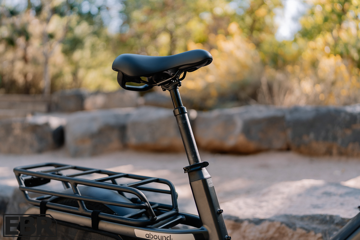

The only place we have found where Aventon could improve the ride quality is with the seat post length. The stock seat post is a bit short for riders over 6’1 who want full leg extension. I’ve reached out to Aventon to see if they will offer a longer seat post, and for now it looks like taller riders will need to purchase a 3rd-party seat post if they want something longer. That’s not a dealbreaker for me, but is somewhat disappointing.

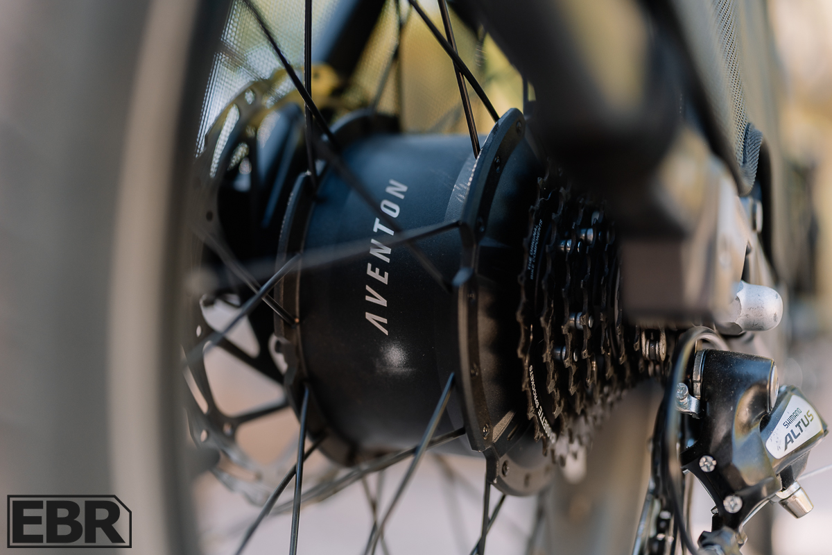

As mentioned above, the Aventon Abound SR comes with a 750W, 36V motor that produces 80Nm of torque.
As I mentioned above, we’ve spent a lot of time adjusting and tuning the motor. At first, we were a bit nervous seeing “just” a 36V system. So much so that we reached out to Aventon to ask why they chose that over a more traditional 48 volt system. There answer is below:
“We have been experimenting with the 36V system starting with our performance eMTB-Ramblas. We’ve upgraded the controller on our 36V system to match the peak power of the 48V system, while also incorporating a higher capacity battery for enhanced performance. To stage our efforts for corporate sustainability and looking towards global expansion, we strive to use less raw materials while delivering the same great experience for our customers.”
I’m happy to see brands trying to use less raw materials, and even happier when they are still able to produce good results while using less. Our first run on the Abound SR wasn’t so great. It was somewhat sluggish up hills, and our heavier testers had challenges getting up to 25 mph.
Of course, our model was sent to us pre-launch. Since Aventon can fully update how the controller and motor function OTA (over-the-air), we were able to work with the team to completely change the feel and output of the motor.
Now, the motor feels great, climbs hills well, and is more than powerful enough to make you not have to worry about the technical differences between 36 and 48 volts.

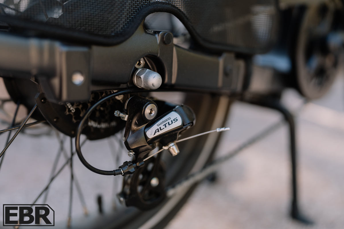

8 speed Shimano Altus drivetrain
While still what we consider entry-level, we are happy that they went with Altus vs Tourney components. With Altus, you get better shifting performance, less chain slaps, and rapid thumb shifters.

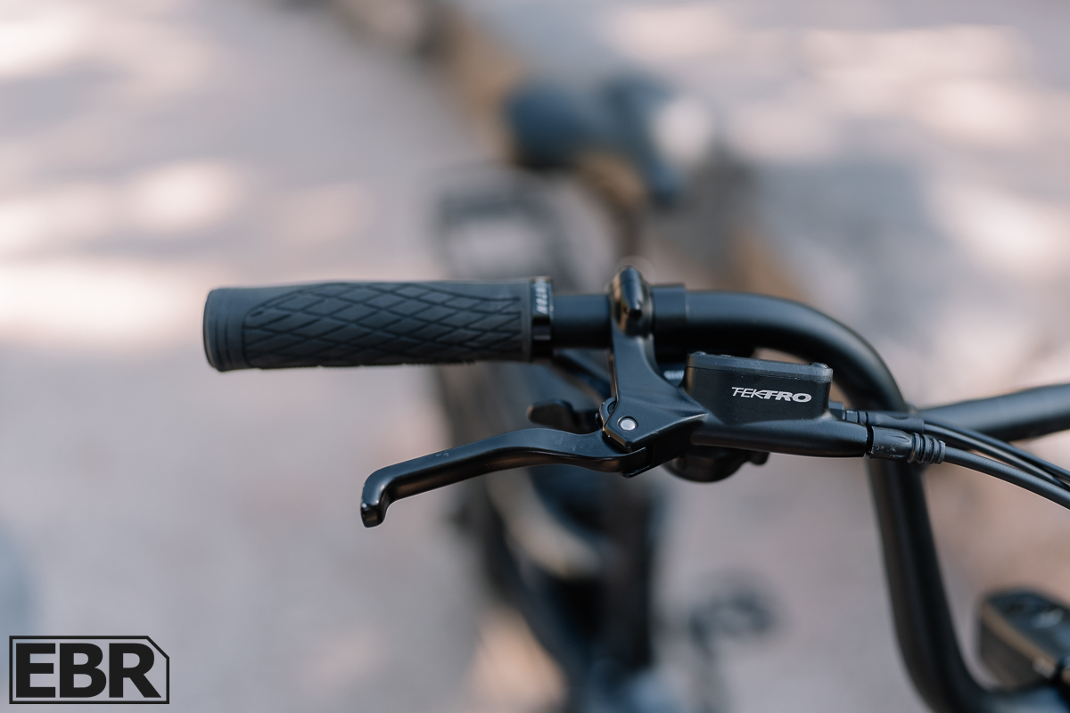

Tektro 2 piston hydraulic disc brakes with 180mm x 1.8mm rotors (HD-E3520)
We’ve always had good experience and luck with Tektro brakes, and these are no exceptions. We do wish that Aventon had gone with a 4 piston brake caliper and 2.3mm rotors, as that extra stopping power would come in handy when carrying extra-heavy loads.

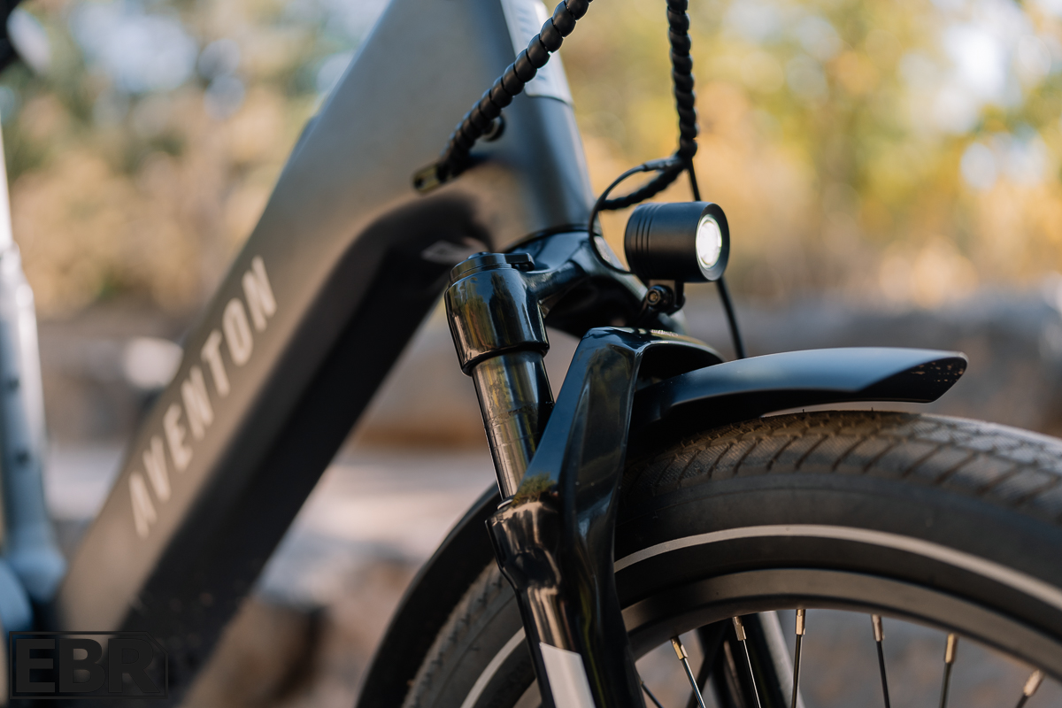

50mm travel front suspension fork with lockout and preload adjustment
While 40mm doesn’t sound like a lot, we actually prefer shorter travel forks on cargo bikes. In fact, we typically don’t love suspension forks on cargo bikes, as it can be very hard to get the suspension correct given the wide range of weights being carried. A rider can ride the bike by themselves at 180 lbs, and then quickly have a child who weighs 90 lbs jump on the bike and end up over compressing the fork.
By specking the bike with a more stiff, shorter travel front suspension fork, Aventon solves that problem and gives you a good, stiff ride while still taking the edge off the bumps in the road.

- 50mm suspension seat post

On a bike where you will pedal more than you will throttle, we prefer a thumb-style throttle over a twist throttle.

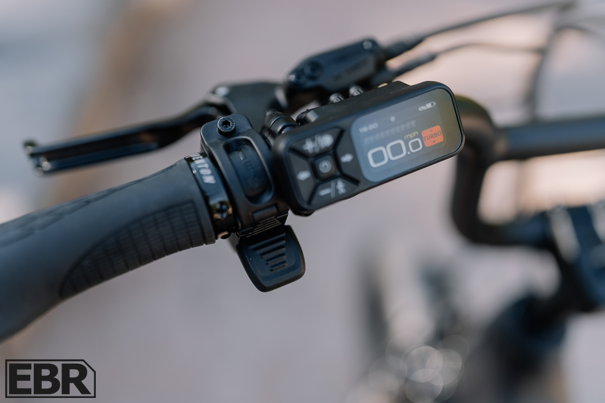

As you can see in the photo above, the display for the Aventon Abound SR is pretty basic. It’s also very functional and intuitive to use because they based the button design on the original iPOD.
I think Aventon did a great job with the display. It’s simplistic, easy to use, easy to read, and displays everything I need to see while riding: MPH, Battery levels (using % not just something basic like 5 bars), and it even gives you the current time of day.
The controller is also compact and easy to use. In one small unit, you have the power button, turn signals, PAS up and down button, lights button, and walk assist button – all with just 5 buttons.

- Seat post could be longer. If you’re 6 ‘2 or taller, you will likely prefer a longer seat post. The nice thing is that you have room in the seat post tube for a longer post
