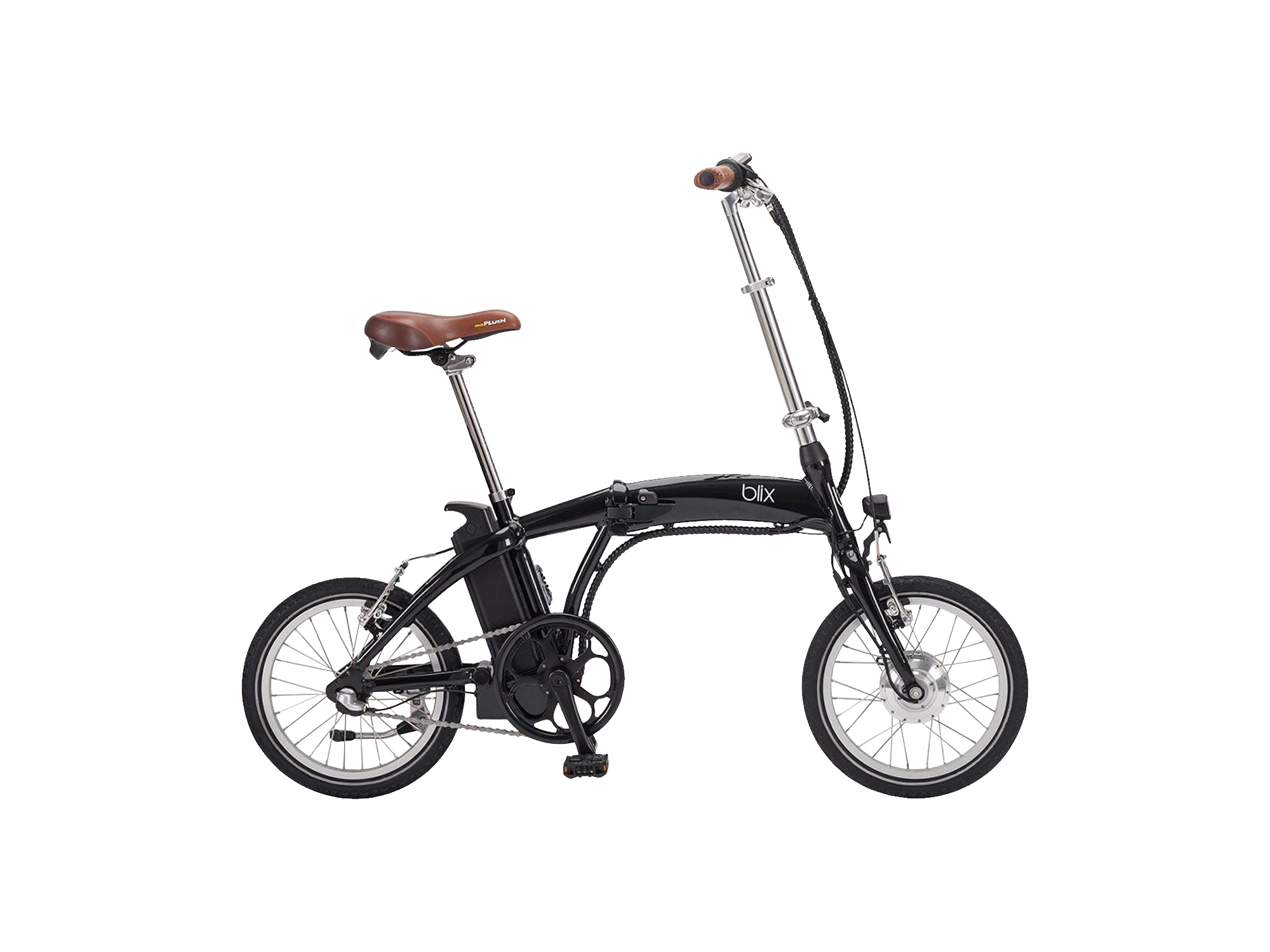

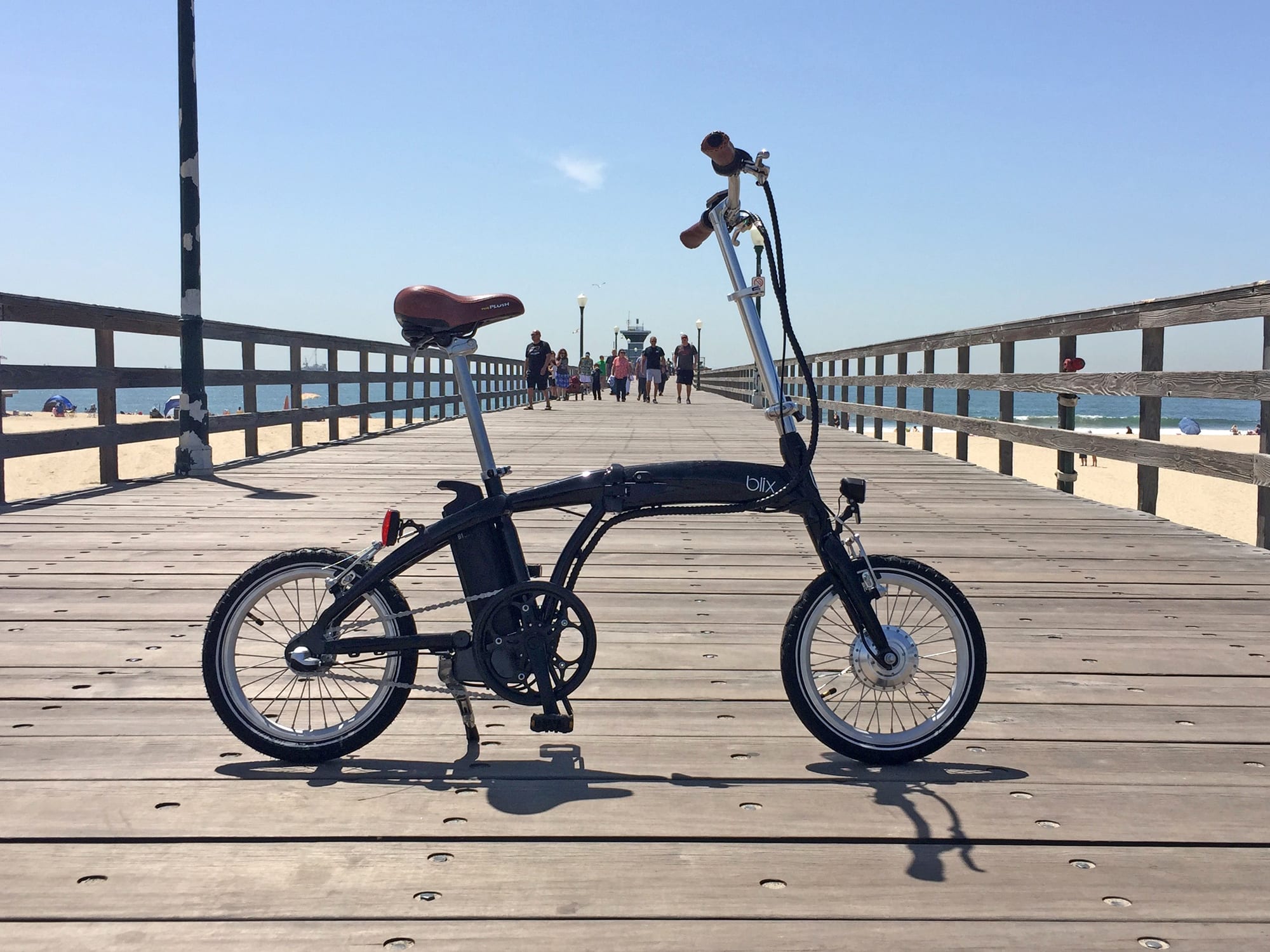

The Blix Vika Travel is one of the lightest, most compact, and yet feature rich, folding electric bicycles that I have reviewed. It offers a surprisingly natural ride experience, despite the smaller 16-inch wheels and shorter 140 mm crank arms. There’s only one chainring and one rear sprocket, so the chain stays tight and shouldn’t drop easily. Blix has gone above and beyond to include a double-sided plastic chain guide to further limit chain drops when riding or transporting in the folded position, and the guide doubles as a pant and skirt protector, keeping you clean as you pedal. So, you get the simplicity and durability of a single-speed drivetrain but actually benefit from three gears! A Shimano Nexus Inter3 internally geared hub allows you to comfortably climb or reach and maintain the 20 mph top assisted speed. Shifting is done with an intuitive half-grip twist mechanism on the right. Stitched ergonomic grips match the padded faux leather saddle. Silver brake levers with an integrated bell and rubberized edges match the silver handlebar, stem, seat post, spokes and hub motor. This e-bike only comes in one frame size, but the seat post is extra long and the stem telescopes up and down to fit riders as tall as the founder, Pontus Malmberg, who is 6’2″ (~188 cm). The Blix travel can support up to 250 lbs of rider+cargo weight, and while it doesn’t come with rear rack mounting options or a bottle cage mounting point, you can pay $50 for some plastic SKS fenders directly from Blix and get an aftermarket saddle bottle cage adapter like this to bring fluids. You may notice that the seat clamp is larger than normal, and this is because it swivels forward, providing easy access to the battery pack. Weighing in at roughly 40 lbs (18.1 kg), the Vika Travel becomes even easier to transport if you remove the 4.7 lb battery pack or fold and then trolly it around on the wheels as shown in the video review above at timestamp 14:10.

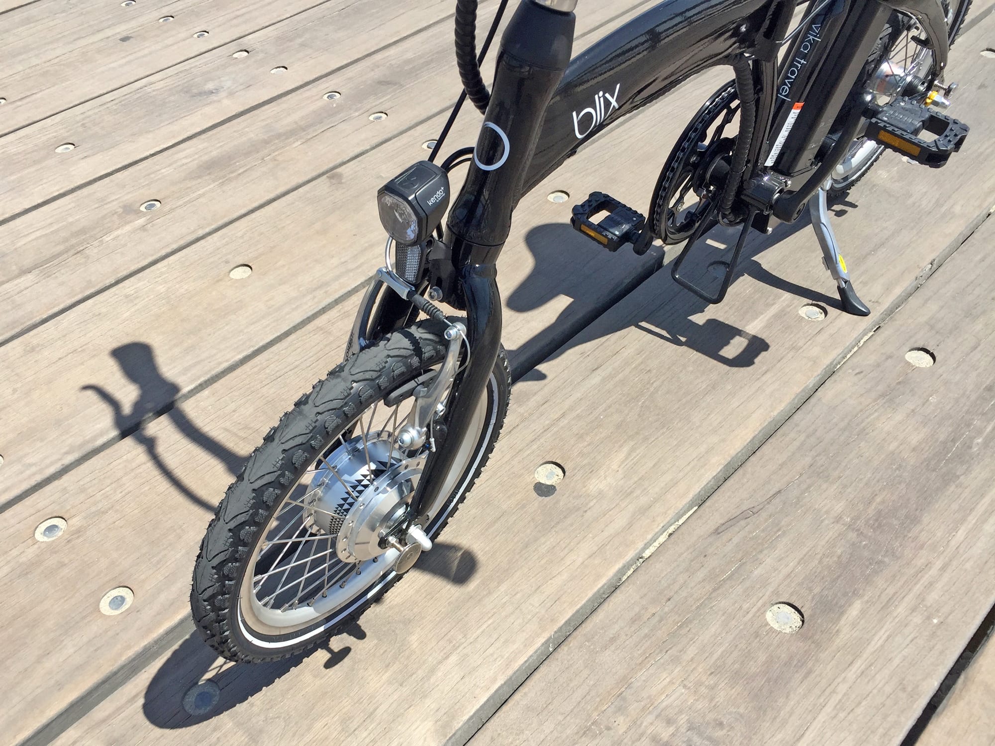

Driving this e-bike is an efficient 250-watt nominally rated planetary geared hub motor, spoked into the front wheel. Blix has refined all drive system hardware here, branding it as SpinTech. The motor felt smooth and quiet compared to similar offerings, and accelerated more gently because of its custom motor controller programming. I could hear a bit of whirring when operating at the highest level of assist, but it wasn’t too bad, and the front wheel didn’t spin out as frequently as it has on other front-wheel-drive products that seem to go from zero to 100% more instantly. Because this hub motor is compact and lightweight, it doesn’t interfere with steering as much, and it balances out the internally geared hub at the rear. With the centrally mounted battery pack, the bike is very steady and even front to rear… Geared hub motors usually offer the advantages of instant power, efficient freewheeling (so they won’t slow you down when coasting), they don’t interfere with the pedaling drivetrain, and they can be used more easily with throttles. The Vika Travel utilizes a high resolution 12-magnet cadence sensor that is responsive in pedal assist along with a variable speed trigger throttle near the left grip. It gives you many ways to ride and eliminates the need for pedaling at all if you get tired or need to focus on balancing. The throttle is live as soon as the display panel is turned on and overrides zero, 1, 2, 3, and 4 assist, so be careful mounting, dismounting, and folding the bike if you don’t turn it off first. If you utilize the throttle and the highest levels of assist frequently, it will cut down on your maximum potential range, and the battery capacity is a bit lower than average in order to cut down on weight and size. I enjoyed the bike most in assist levels 2 and 3.

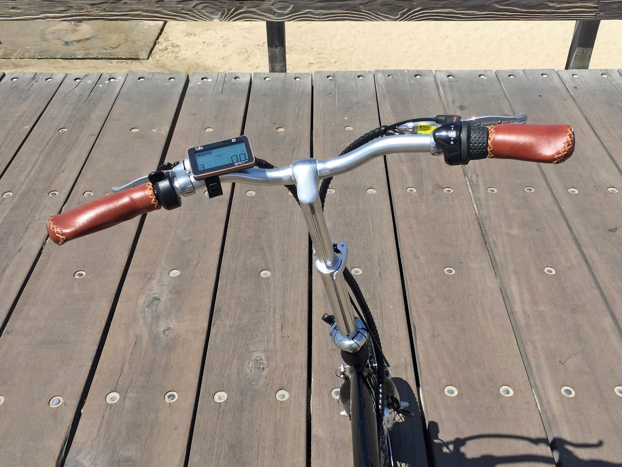

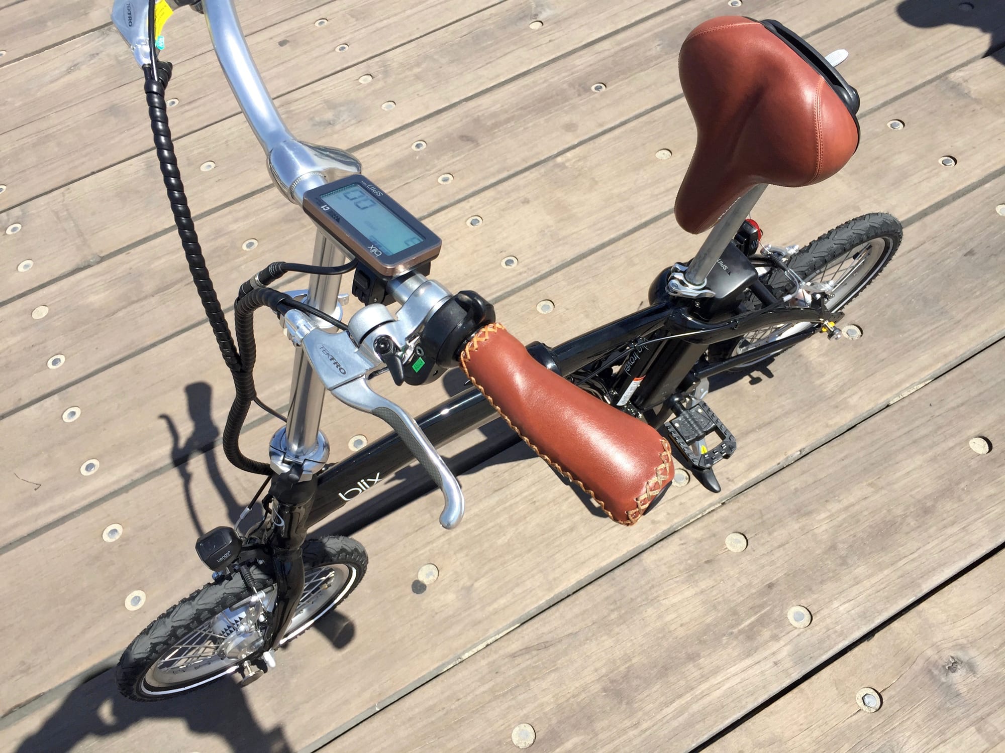

Powering on the bike requires that first step of activating the battery and then a second power button press on top of the display panel. The LCD is beautiful, large enough to be seen and read clearly while riding, but not overly crowded with buttons and wires. The cockpit is actually very clean considering that both brakes have motor inhibitors, there’s a grip shifter, and the display and throttle! That’s a lot of wires, but they are all wrapped up with plastic spiral tubing. The connector points use metal threaded locks with rubber washers to keep water out and should be more durable as you fold and unfold the bike repeatedly. The display itself isn’t removable and could get scratched at the bike rack or while folding and transporting, but you could simply put a sock or glasses microbag over it as a solution. The display doesn’t swivel easily and could produce some glare if the sun is positioned behind and above you, but I found that it was fairly easy to read and use. The power button doubles as a mode button, allowing you to cycle through trip stats like current speed, average speed, max speed, and distance. The up and down buttons allow you to adjust assist levels, and the menu goes from 4 back to 0 so you can basically save clicks by going “around” instead of all the way back down or up. Hold the up arrow to activate the LCD backlighting and integrated headlight. Hold up and down to enter into the settings menu and change units. It’s all fairly standard and intuitive, but the buttons aren’t quite as reachable as they would be without the trigger throttle also mounted on the left side of the handlebar. You do have to reach over a bit, and I’d probably use more of a “set it and forget it” approach with assist level 2 for efficiency and occasional throttle override for help starting and climbing. There are always trade-offs when it comes to organization and simplicity vs. features but I love where Blix ended up. And again, the inclusion of a little flick bell in the left brake lever is a big win… it’s useful but doesn’t add clutter or push the throttle and display further out.

- One of the smallest and most compact folding electric bikes I’ve seen, yet it still provides a full upright geometry and decent pedaling experience
- Fairly lightweight at ~40 lbs, most other folding electric bikes are at least 45 lbs and many are above 50 lbs, the Blix Vika Travel is easier to lift

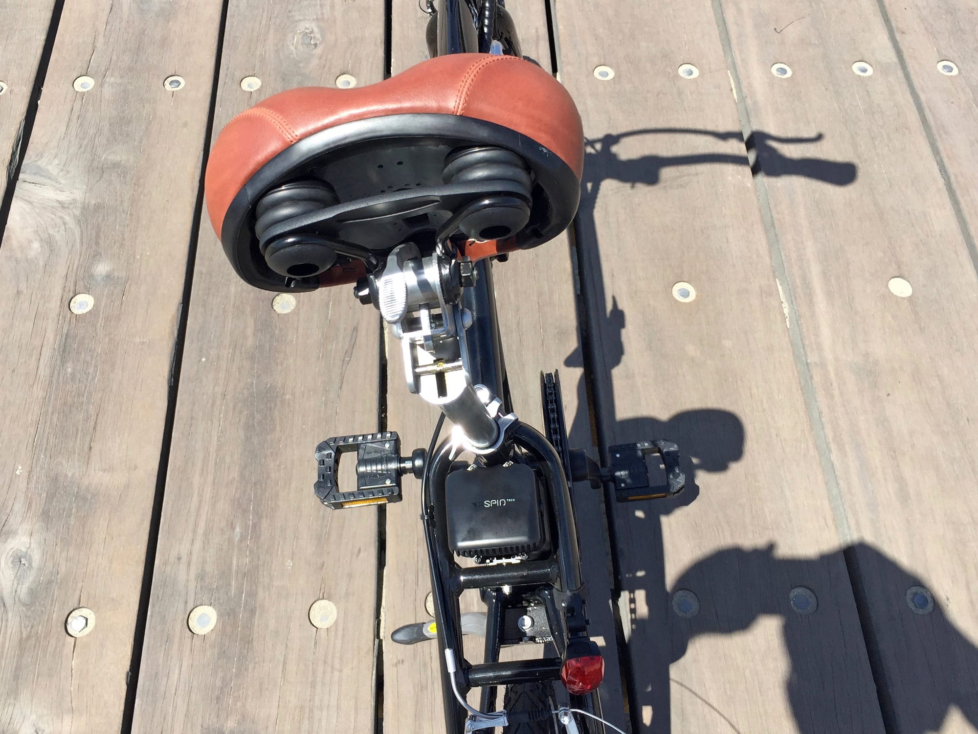

- The battery pack can be easily removed from the frame to further reduce weight (by ~4.5 lbs) or charge and store separately, I love how the saddle mount pivots forward so you don’t have to remove the seat post each time you want to take the battery off

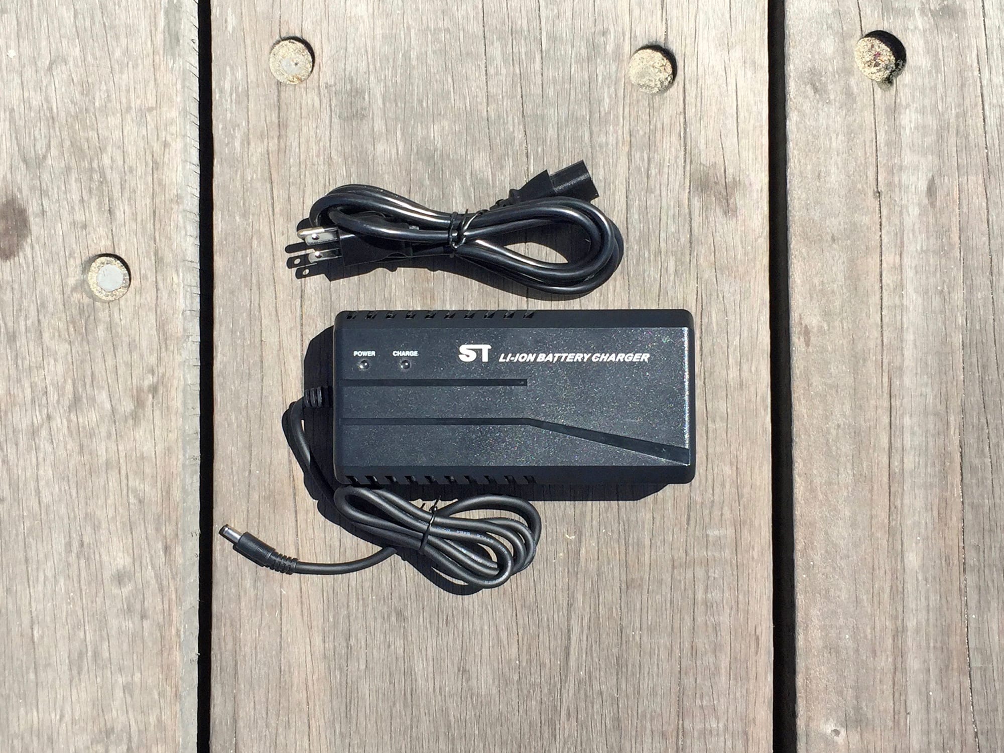

- Even though the battery capacity isn’t super large at 316.8 watt hours, you still get a fast charger that puts out 3 amps vs. the standard 2 amps on many other products, this means you can top off and keep riding more quickly, I love how compact and lightweight the charger is at just 1.3 lbs

- Even though the watt rating for the front hub motor sounds low at 250 watts, it actually feels pretty capable because of the smaller wheel diameter, it gets a mechanical advantage

- Sometimes I notice that front wheel powered ebikes can spin out a bit, but the Blix motors and controller system accelerates more smoothly and hasn’t had that issue as much, the 12-magnet cadence sensor is very responsive and it’s nice to also have throttle on demand (which overrides assist) with variable speed depending on how far you push it
- Great color coordination with the black battery and wires blending into the black frame, excellent wire management with plastic spiral wrap, the wires didn’t seem to be at risk of bending or pinching at the main folding joint, even with brake cables, motor inhibitors, grip shifter, a trigger throttle, and LCD display the cockpit feels clean, Blix has used threaded electrical connectors that are sturdier and more water resistant than plastic press fit on many comparable products

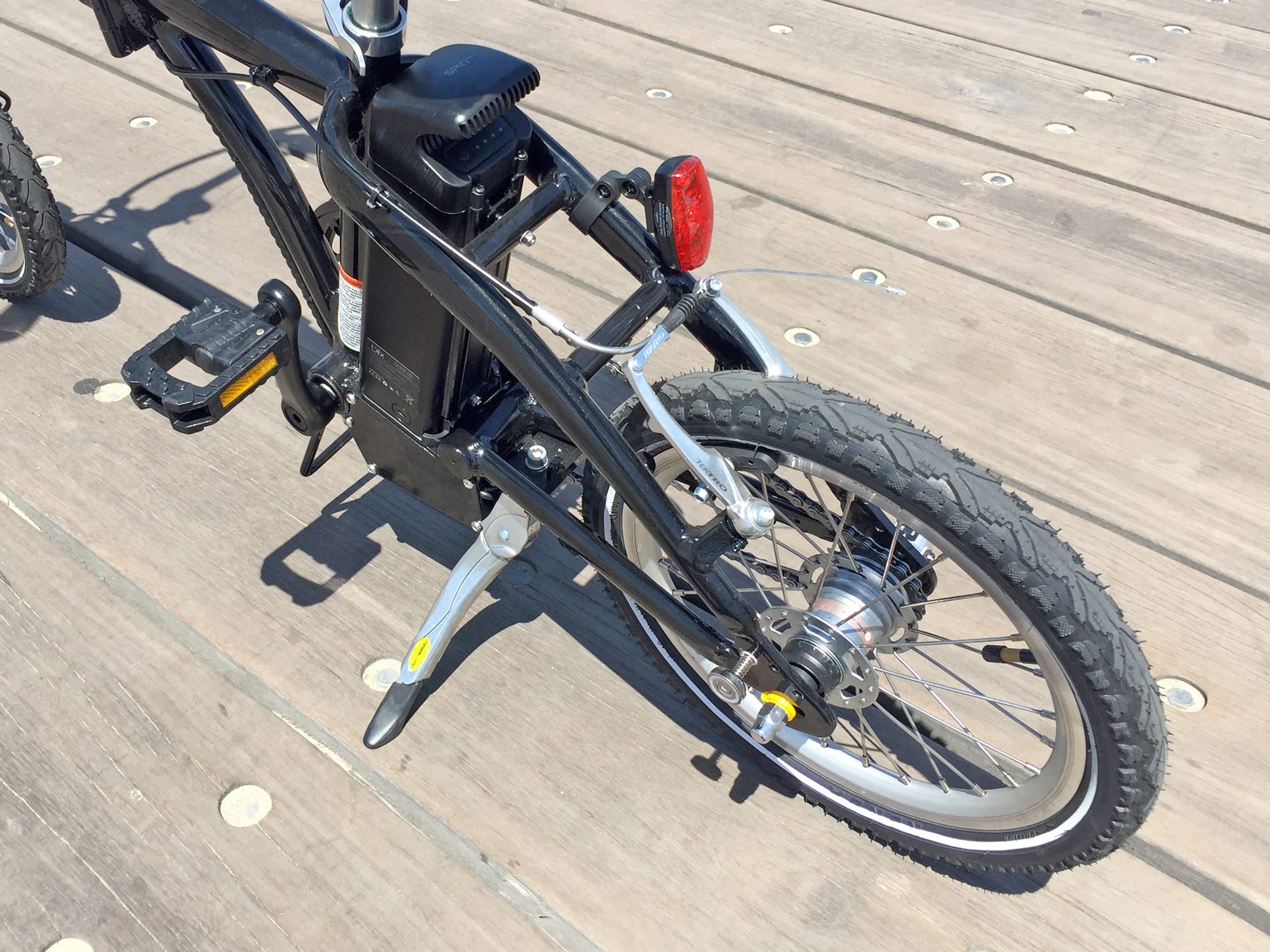

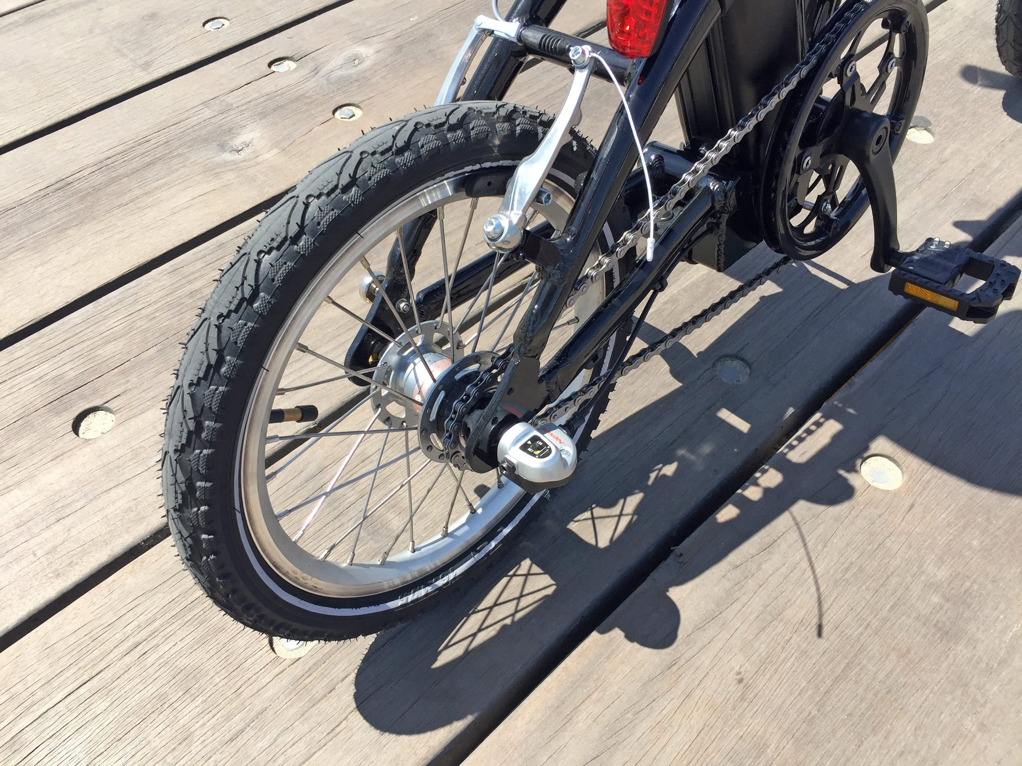

- The three-speed internally geared hub is going to be cleaner and more durable than an external derailleur, it allows for a single rear sprocket and fixed-length chain that won’t drop while riding on bumpy terrain or folding the bike

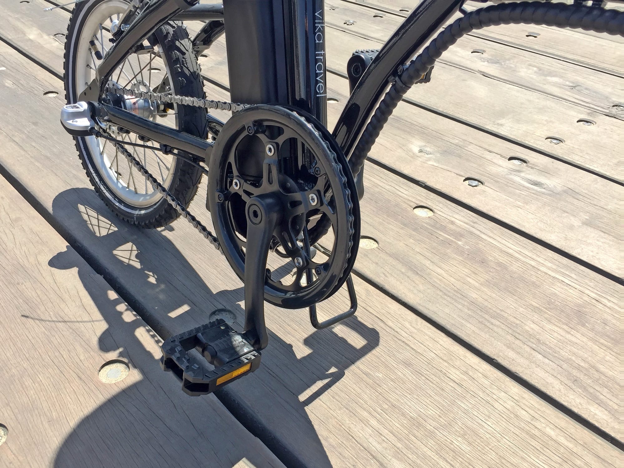

- Blix has used a double-side plastic chain guide on the chainring which further reduces the possibility for drops and keeps your pants or skirt from getting dirty and snagged, I appreciate the metal guard that protects the bottom bracket area (and chain ring) when folding or going over high obstacles

- Battery weight is kept low and centered on the frame, it seems well protected by the frame tubing if the bike were to top or get banged around during transport, the front hub motor balances out well with the rear internally geared hub
- I like how the assist levels loop around from 4 to 0 so you don’t have to click down, down, down, down, it’s a simple and quick way to navigate and allows you to focus more on riding and hand position

- The smaller 16-inch wheels bring the frame closer to the ground and require shorter 140 mm crank arms to reduce pedal strikes (vs. 170 mm crank arms on most full sized bicycles), the shorter arms speed up the pedal cadence a bit and don’t provide as much energy per stroke
- The tires are a bit narrower here and because of the smaller 16-inch wheel size, they don’t provide as much air volume which means that they cannot absorb bumps as effectively, the lower attack angle means that you feel cracks and potholes more and you want to keep an eye on the tire pressure more closely so that you don’t get a pinch flat (and consider buying extra tubes from Blix at time of purchase since this is a unique and uncommon size)

- Booting up the e-bike systems is a two-step process, you have to press a power button on the battery (under the handle) and then on the display as well (near the top edge) vs. just having a single step
