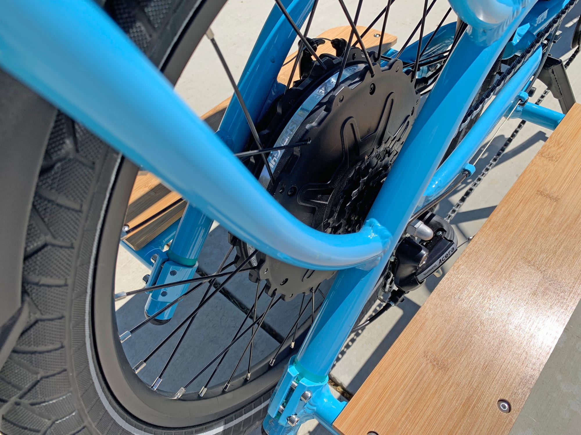

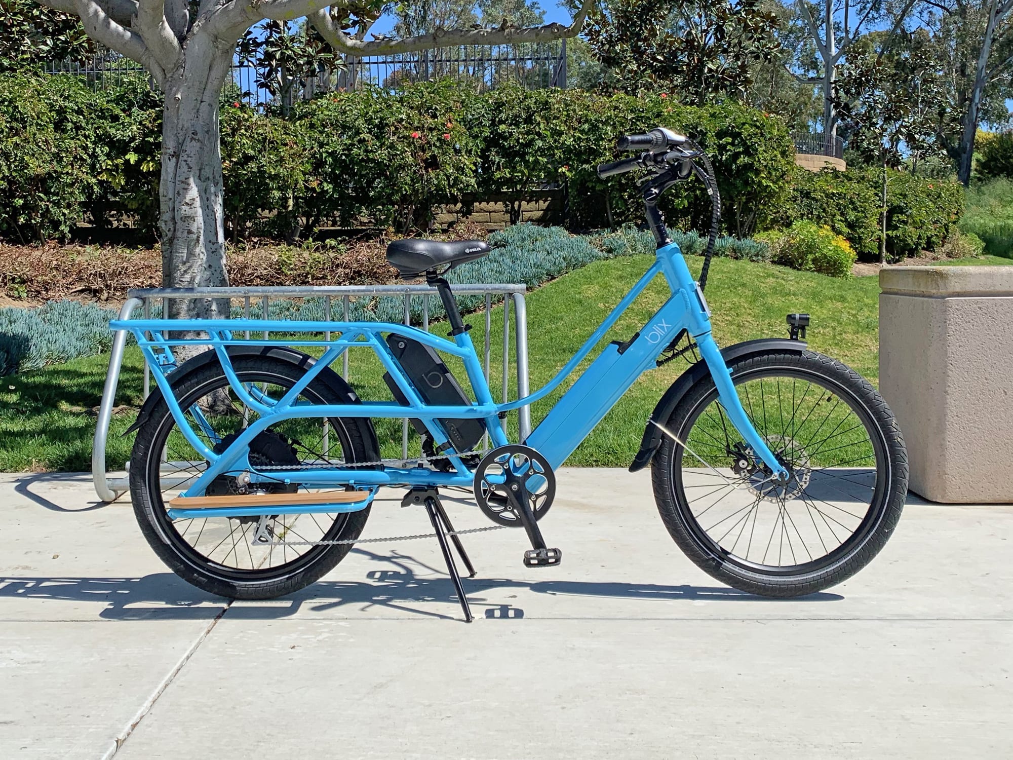

Driving this ebike is a a Shengyi gearless hub motor that weighs about 10lbs and is spoked into a sturdy 24-inch double-wall rim with extra-thick 12 gauge spokes. I’ve seen this motor brand before, on competing products from Rad Power Bikes, and heard that it’s very reliable from customers who have purchased and used it regularly for multiple years ongoing. Gearless motors need to be larger, and are usually heavier than geared, because they produce power through electromagnetic staters and rare earth magnets pushing against each other. This, compared with a planetary geared motor that uses a faster-spinning motor that is geared down for torque. With a gearless motor, the further out those magnets are from the center, the more torque power is generated. The advantage to this type of motor is that you don’t have plastic gears rubbing against each other to produce power, making it quiet and more durable over the long run. The magnets and staters don’t actually touch, so propulsion is smooth and quiet. However, when the motor is finished pushing, it also drags a bit because there is no freewheel mechanism. Some ebike companies that use gearless direct drive motors has designed their controller systems to recapture some of this magnetic drag as electricity for regeneration. That is not the case with Blix, and I don’t see this as a major drawback because it simplifies the controller and keeps it cooler. My understanding is that the electricity recaptured through regen on ebikes is only a small percentage, and the optional second battery option with the Packa is going to be much, much, more effective for extending range. Offering between 500 and 750 watts of power output and up to 40 newton meters of torque, the motor is powerful and effective in most situations. One challenging scenario however, is starting from standstill while climbing. Gearless motors just don’t generate as much torque at standstill… so try to get some momentum going in, if you can. In short, this motor is quiet, tough, and very capable of transporting heavy loads, especially with the 11 to 32 tooth cassette. You might have to pedal along when ascending steep hills, but it should do fine on small and medium hills without too much input, as long as you’ve got a little momentum going in.

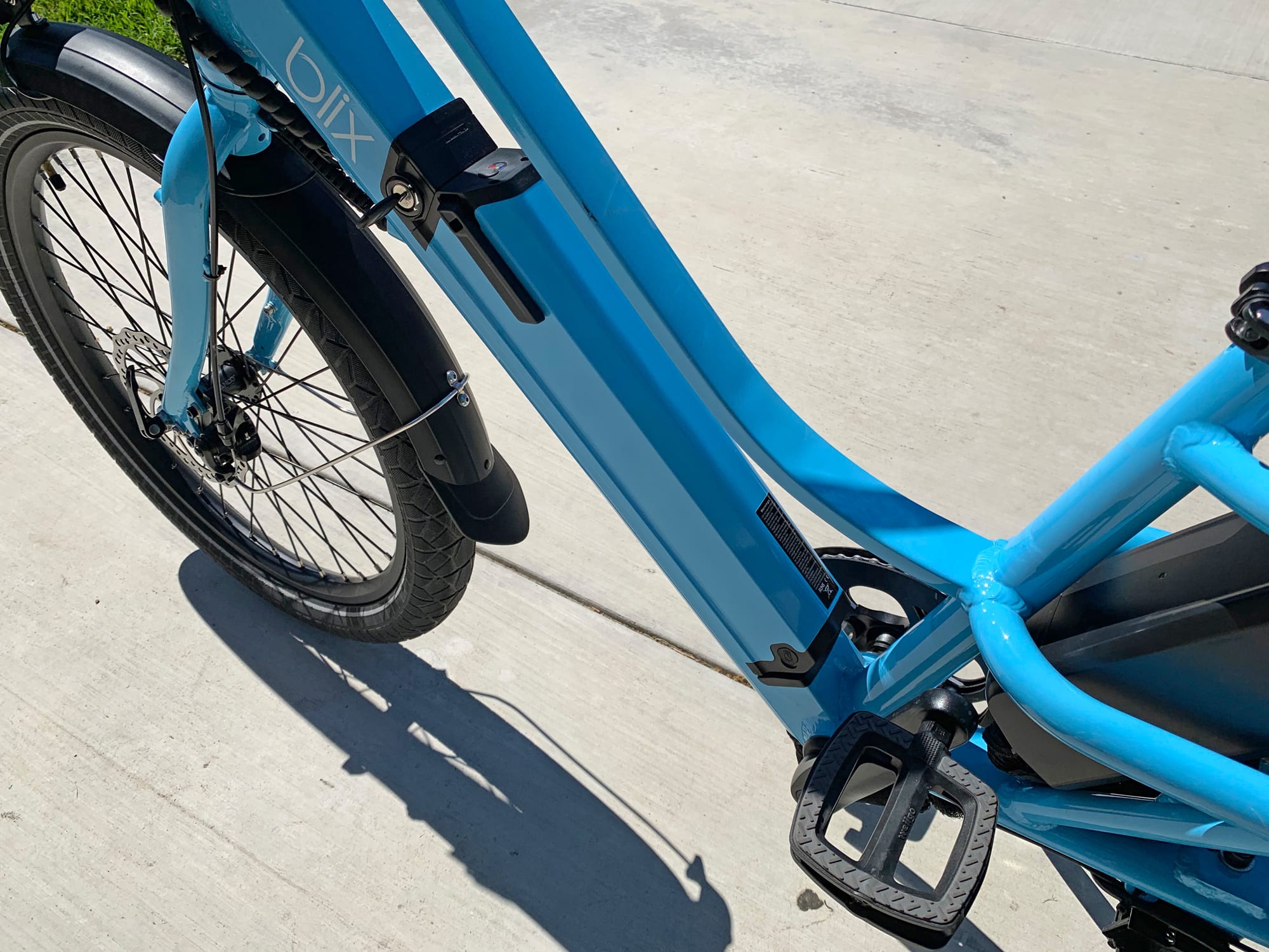

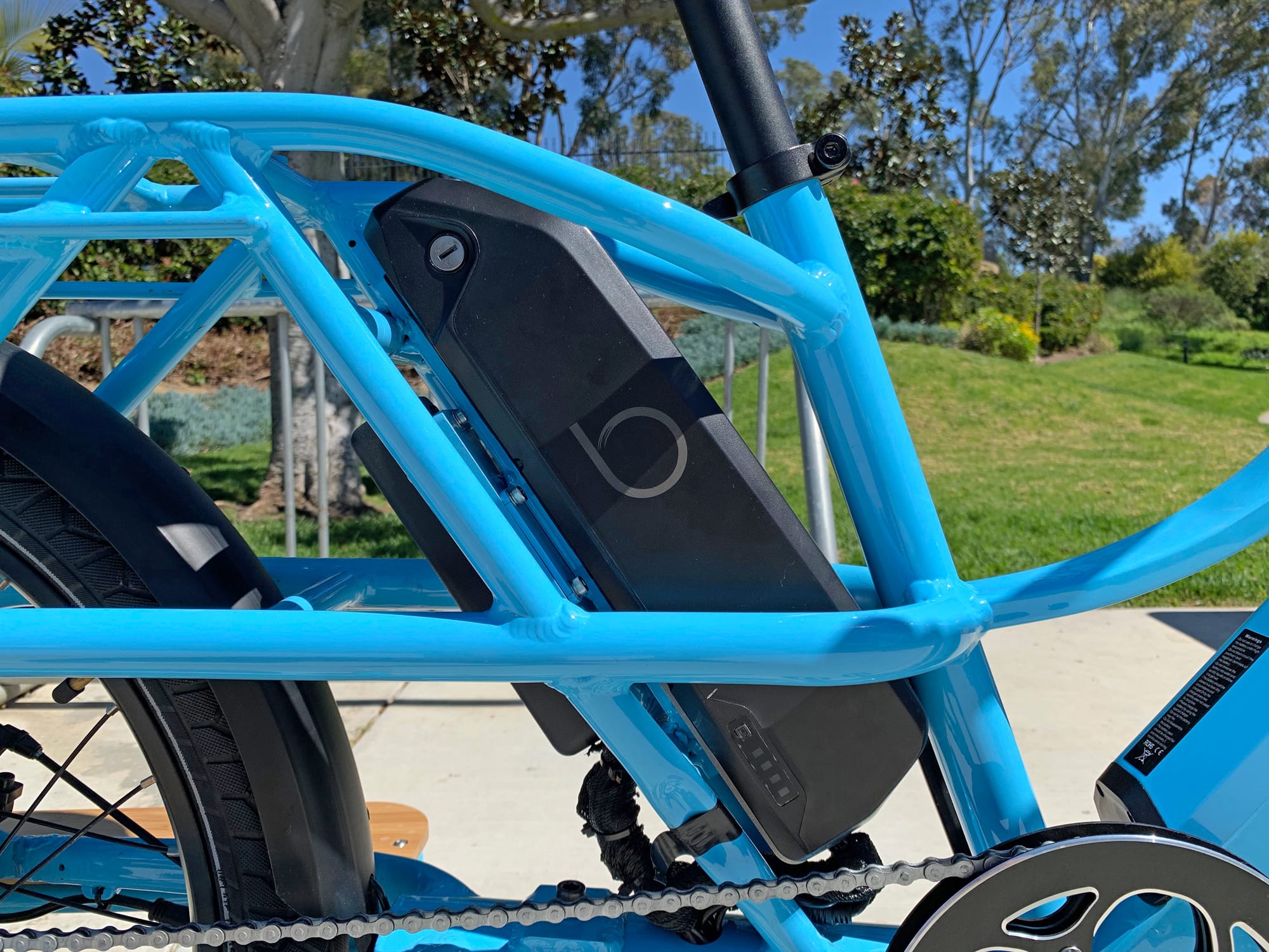

Powering the bike, it’s backlit LCD display, and two integrated LED Lights is a 48 volt 10.5 amp hour Lithium-ion battery pack. The case is a fairly standard design that I’ve seen on other ebikes, but never color-matched like this. It seats in from the left side of the frame and comes in at an angle. This allowed Blix to lower the top tube, providing a lower stand-over height and easier mounting/stabilizing of the bike. The capacity of this pack is pretty standard at roughly 500 watt hours, and should be enough for 20+ mile rides, even if you’re relying heavily on the throttle or using a higher level of assist. For those who want to go further, or plan on carrying lots of cargo over varied terrain, Blix offers a secondary pack rated at 48 volt 14 amp hours! When combined, this ebike has over 1 kilowatt-hour of juice, to offer. Only the default downtube battery has a built-in USB charging port, but they both use the same three amp charger. One of the compromises the company made to lower the cost of this second battery and the controller that draws from both, is that each pack must be physically plugged in separately. Some of the really fancy new systems from Bosch and Shimano are able to charge two packs at once, requiring less attention and handling by the rider. Also, both packs on the Blix Packa must be unlocked separately, using unique keys. If you opt for their optional front wheel frame lock, there will be a third key in use… So, there’s extra time and clutter with the Packa, but at $1,599, it’s priced at half of most other high-end multi-battery products on the market right now. One very cool feature about the dual-battery setup is that the packs drain fairly evenly when riding. The onboard control system is smart enough to switch back and fort when the difference is greater than 5%. This reduces the cycle count of any given pack and reduces the chance that you’ll hit zero (which can strain the cells). To extend the usable life of most Lithium-ion batteries, it’s best to store them in a cool, dry location. Extreme heat can damage them, and cold will limit their range. I’ve also heard that if you know you won’t be riding with a pack for a month or more, it’s great to keep it about half full or full but avoid letting it drain down all the way. All things considered, I feel that the positioning of both batteries is fairly good, low and center on the bike, protected by the frame tubing from scratches and bumps at racks or tips.

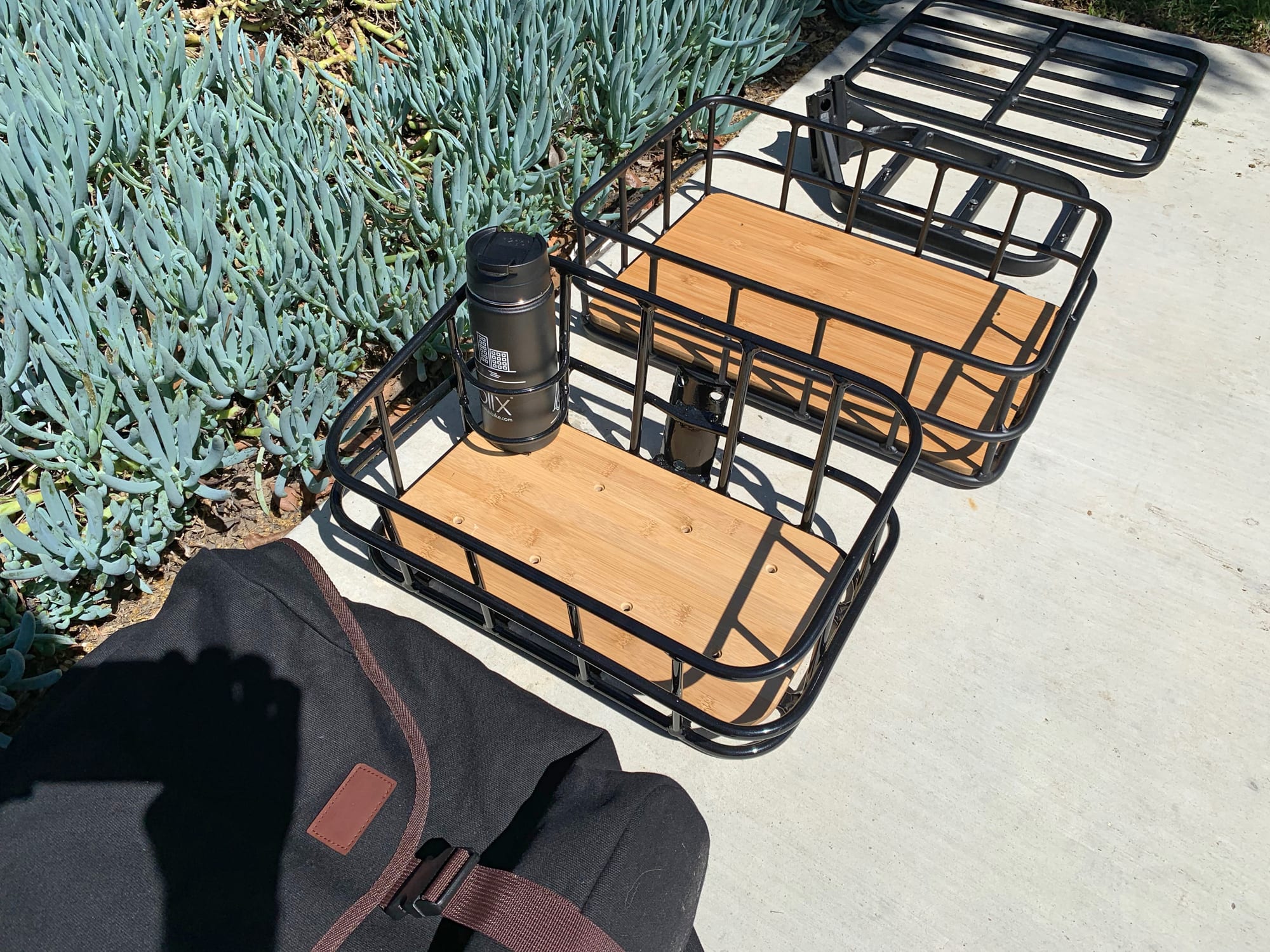

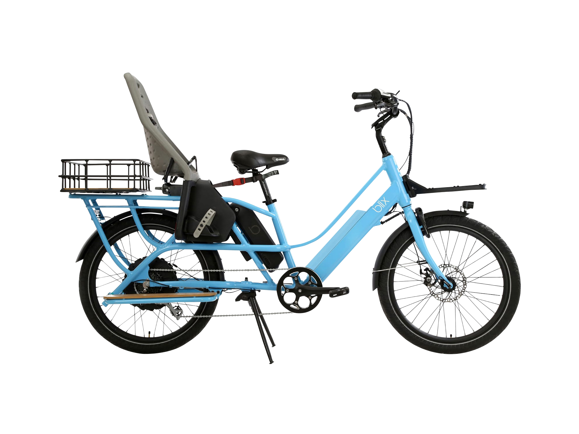

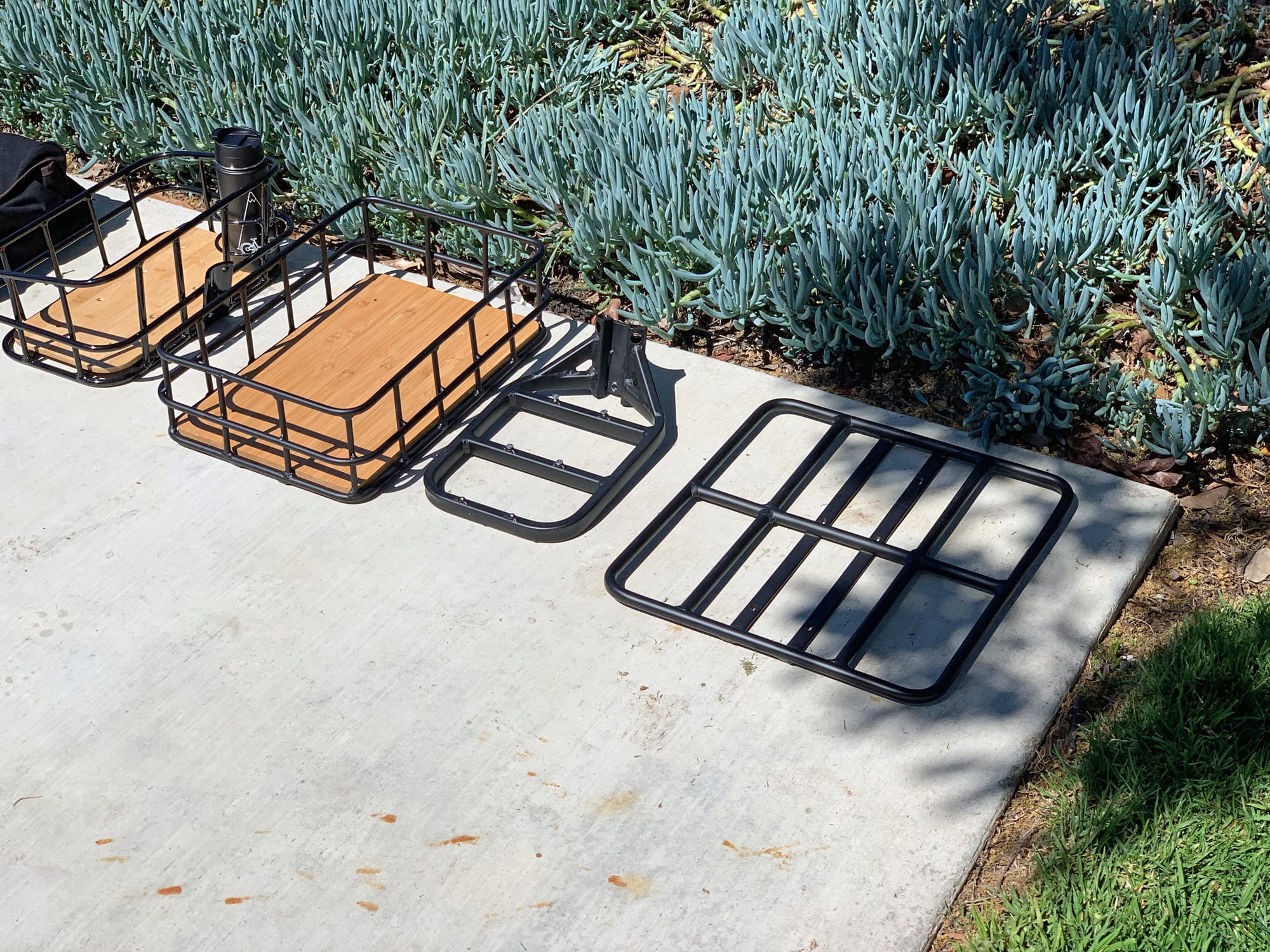

- Lots of great accessories for hauling cargo or additional passengers (infants, kids, and adults), Blix designed many of the bags to work in conjunction with the bolt-on cargo racks so you can maximize utility

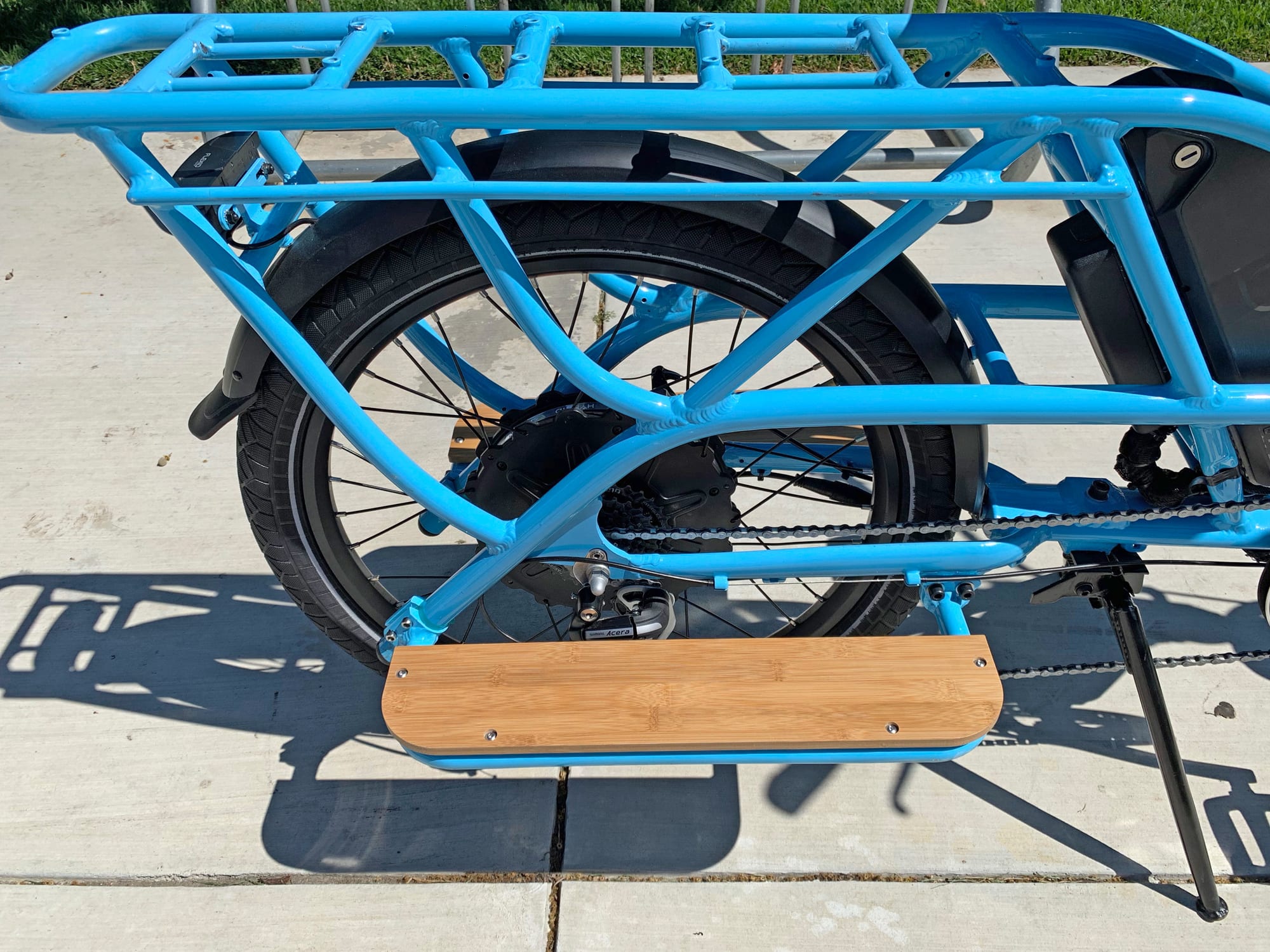

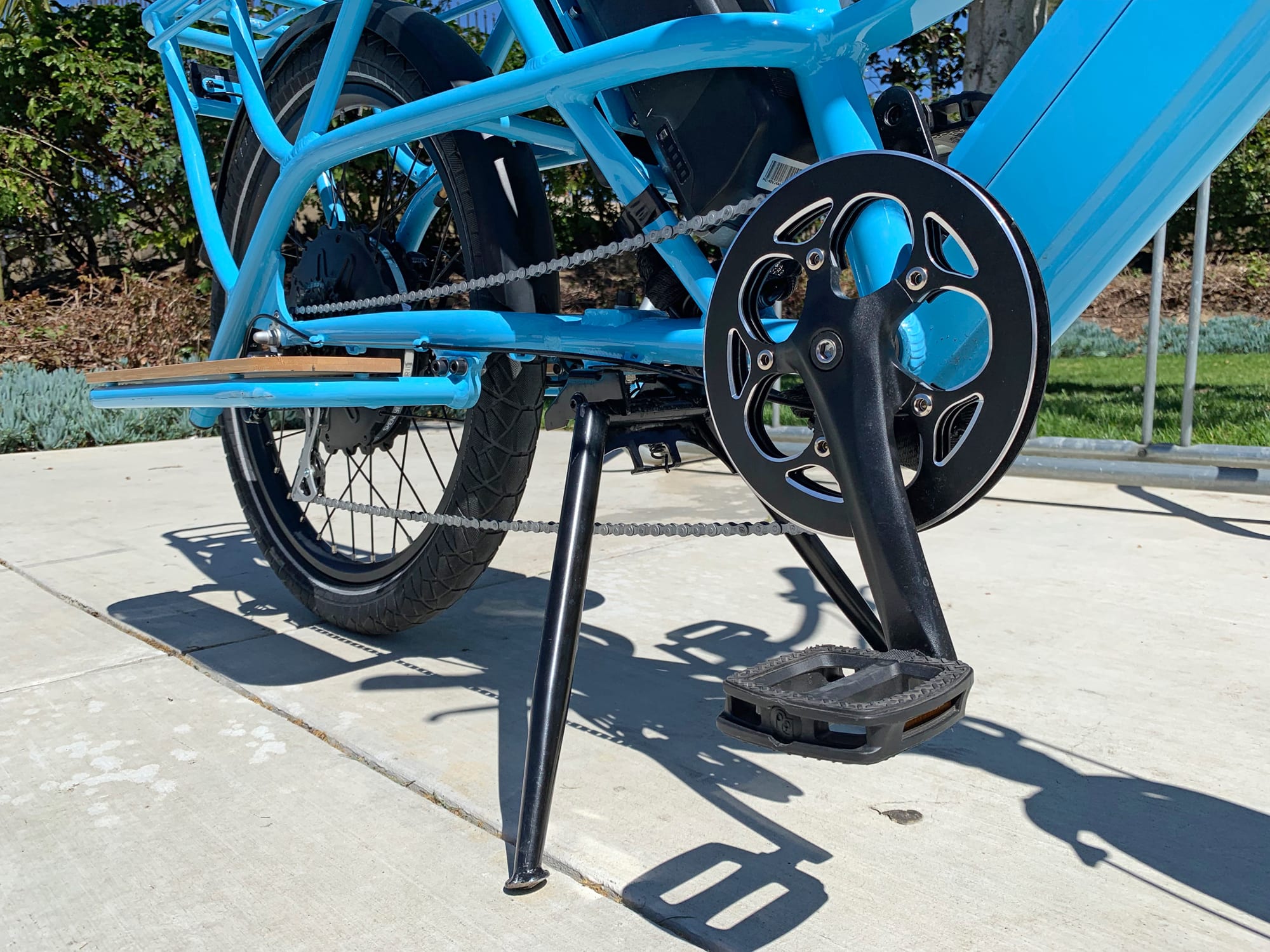

- Mounting and loading the bike is very easy thanks to the giant double-leg kickstand and stabilizing “deflopilator” spring at the front fork
- The drivetrain good for around town riding with a wider 11 to 32 tooth cassette (vs. 12-28) and an alloy chainring guide (to reduce chain drops), the chain is also rust-resistant
- Safety is important, especially if you’ve got passengers along for the ride! so I really appreciate the reflective tires, integrated lights, extra-bright 27-LED rear light with brake bright activation, and the white frame option (which will stand out more in low lighting situations)

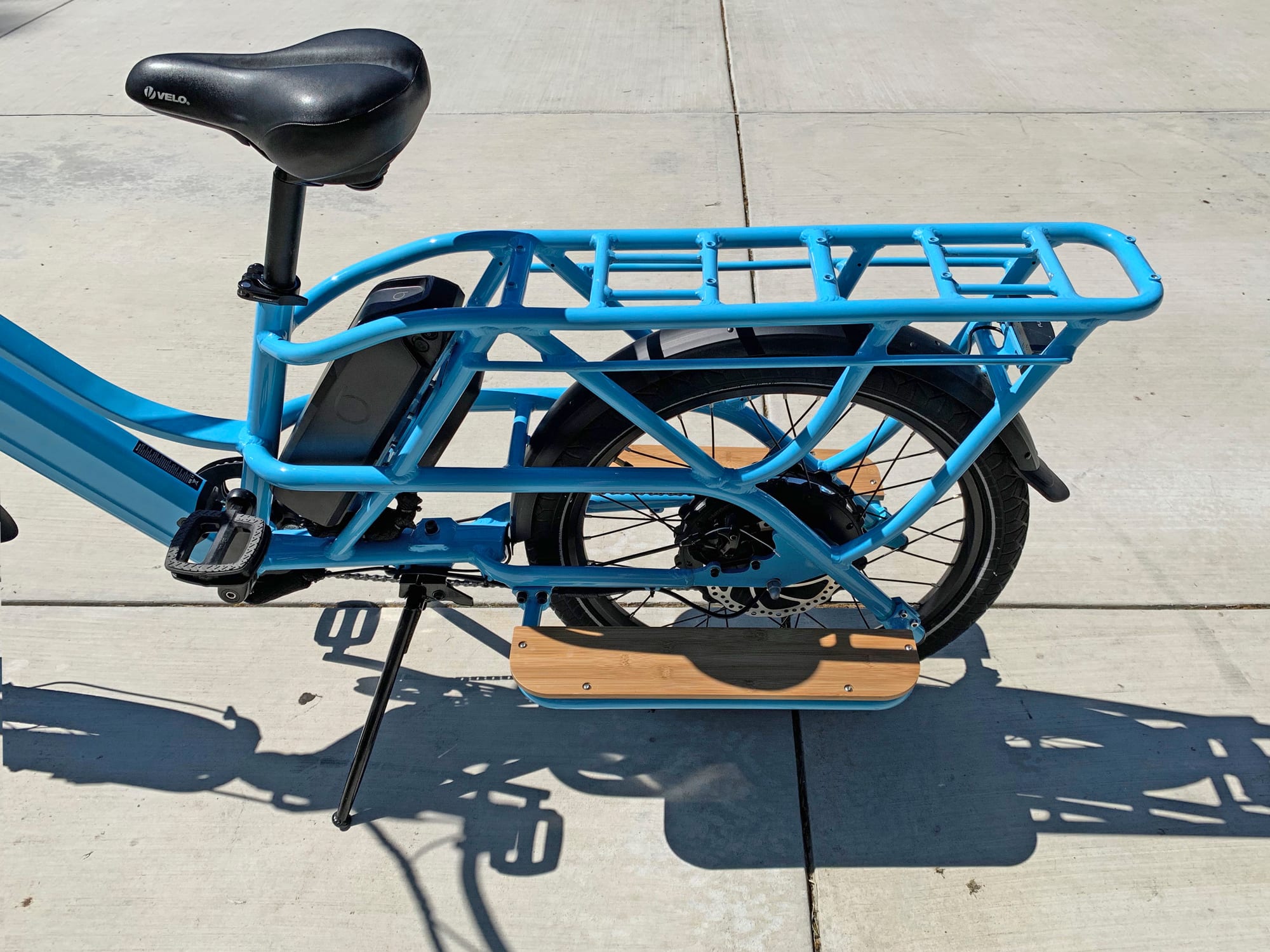

- It’s neat that Blix includes running board with bamboo decks, these offer support for pannier bags or a place for a passenger to put their feet… some companies charge extra for this feature or don’t include a wood insert

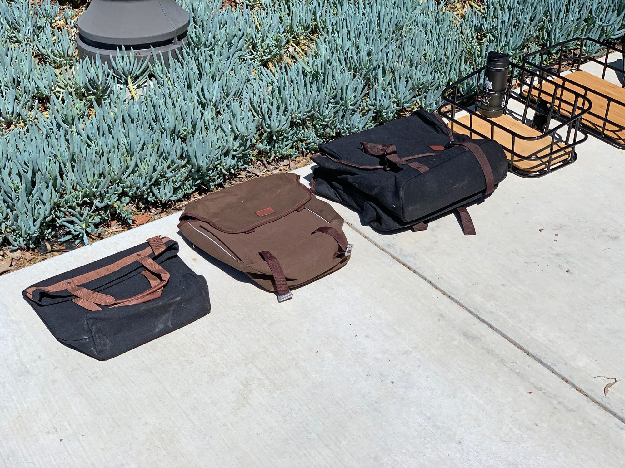

- I love that the rear rack includes a standard gauge tube for clipping-on aftermarket pannier bags, Blix has a great range of bag options that are guaranteed to work and look pretty good, but the industry standard tubing is a nice “open source” touch that adds utility and value if you already own gear

- Lots of little details are dialed in with this frame including internally routed cables, threaded water-sealed electrical cabling, sturdy 31.6mm seat post diameter, front wheel frame lock mounting option, and fender-mounted headlight… I was told that the final design will have a metal insert to increase fender strength and reduce headlight bounce

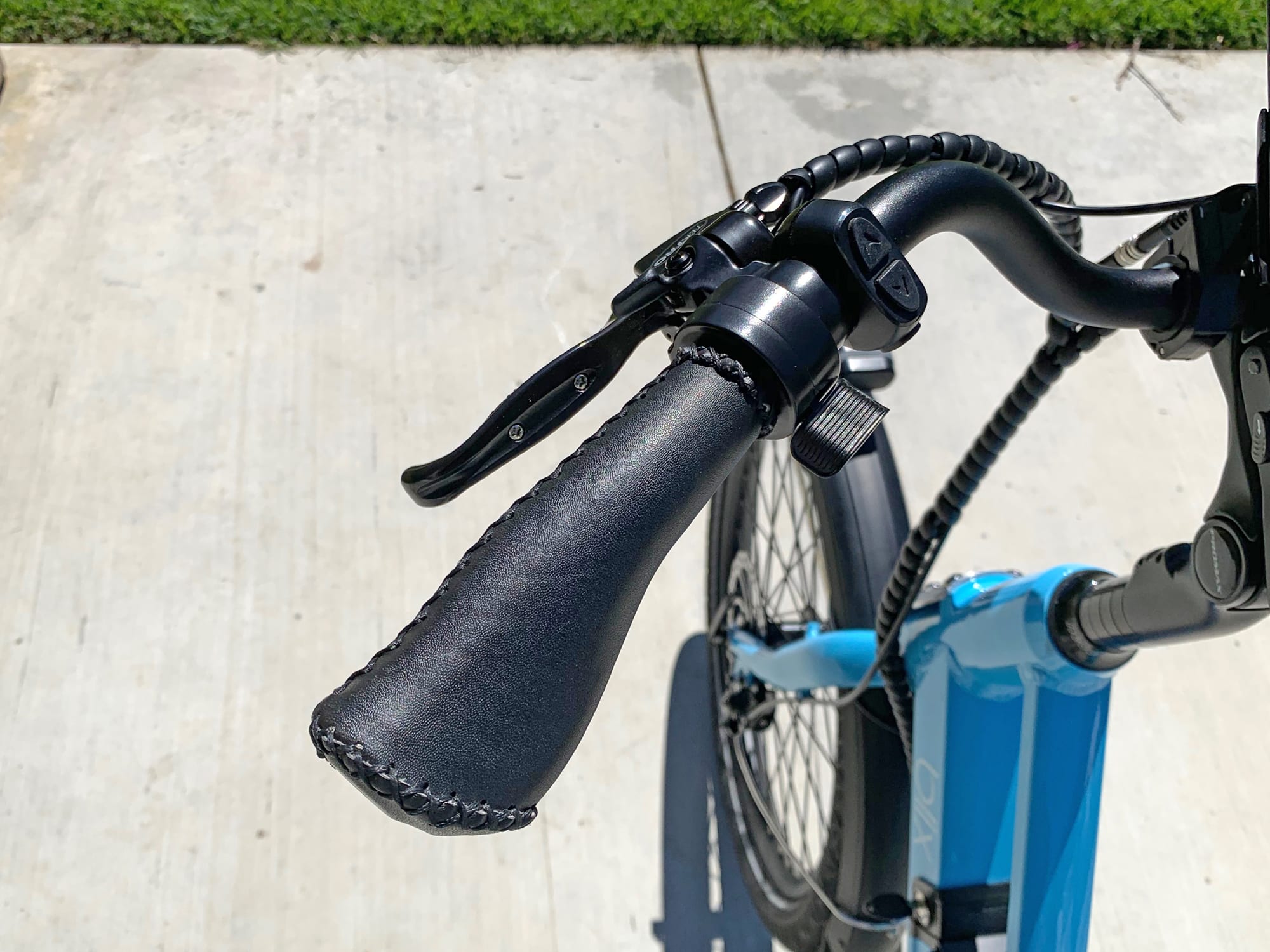

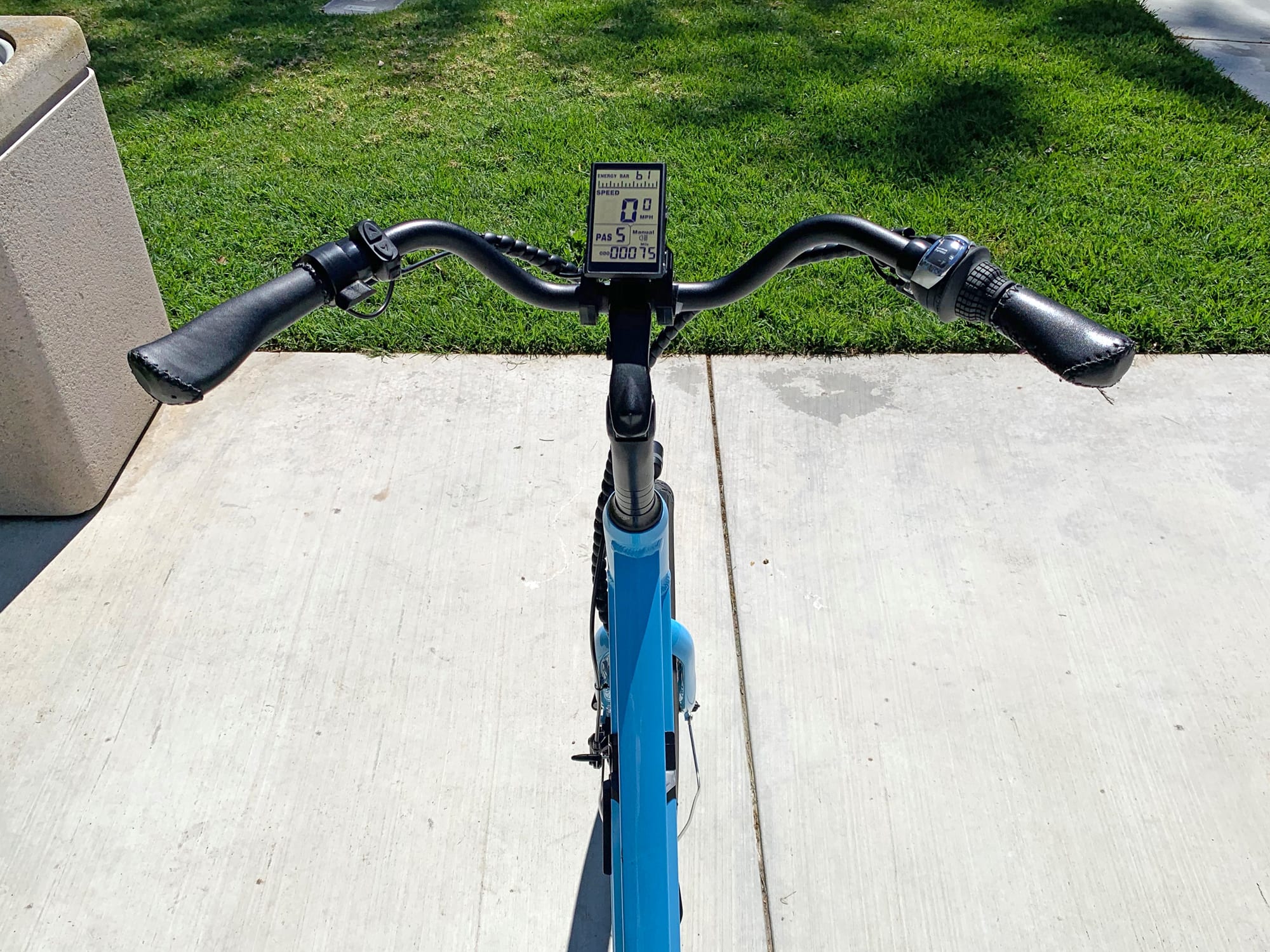

- The LCD display panel is fairly large, I appreciate the half-grip twist shifter because it’s intuitive to use (it has a little clear window showing the chosen gear), the stem can be adjusted without tools so it’s easy to switch riders, and Blix opted for a high power 48 volt electrical system vs. 36 volt and has a powerful external 22 amp motor controller that reduces the cost of replacement batteries and also reduces battery/controller heat

- Both brake levers have motor inhibitors built in, so they instantly cut power to the drive system whenever you need to stop, it’s especially important with a cadence sensing ebike vs. torque sensing, and the sensor also activates the tail light so you’ll be more visible when slowing down

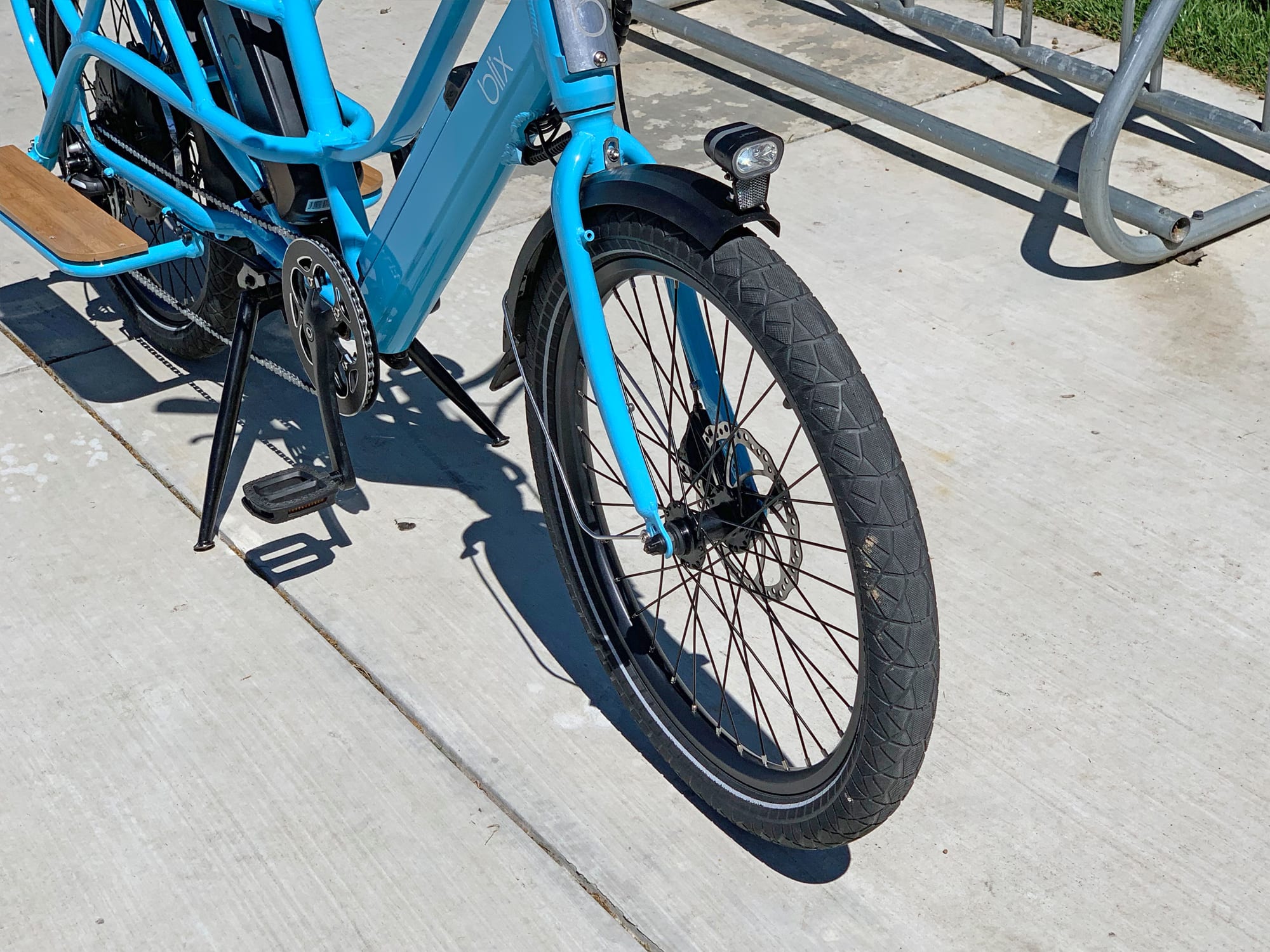

- I like how the tail light has angled sides so you’ll stand out from more directions, the headlight does not have this… it just shines out the front, but it does point where you steer and won’t be blocked by the optional front rack or basket accessories
- Gearless hub motors are known for being super reliable and quiet, I didn’t really hear it much during the ride test and have actually experienced the Shengyi motor on competing products from Rad Power Bikes with good success over year of use

- By choosing a trigger throttle vs. a twist throttle, Blix made the bike less prone to accidental activation, it’s still a good idea to turn it off before mounting and dismounting since it’s automatically active in assist level 1 (which is the default powerup mode)
- It’s nice to have a trigger throttle to help getting started from stop signs, especially with a cadence sensor vs. multi-sensor or torque sensor… I’m saying this as someone with sensitive knees, once you get the bike started, all you have to do is move the cranks for pedal assist to kick in, you don’t have to pedal hard since it only senses motion

- Most electric cargo bikes weigh more because the frames require additional material for strength, the Blix Packa uses a heavier Gearless hub motor and with the optional second battery pack it does start to weigh a lot, I did experience some frame flex and speed wobble when the rear rack had bags and a child seat added (as is the case with most mid-step cargo ebikes)

- Gearless direct drive hub motors tend to weigh more, produce less torque from standstill, and cause some magnetic drag when coasting, Blix is not recapturing energy with any sort of regenerative braking on this setup

- The charging port for the main battery is directly in the path of the left crank arm, so be careful not to bump the pedals while it’s plugged in or the plug and socket could get damaged
