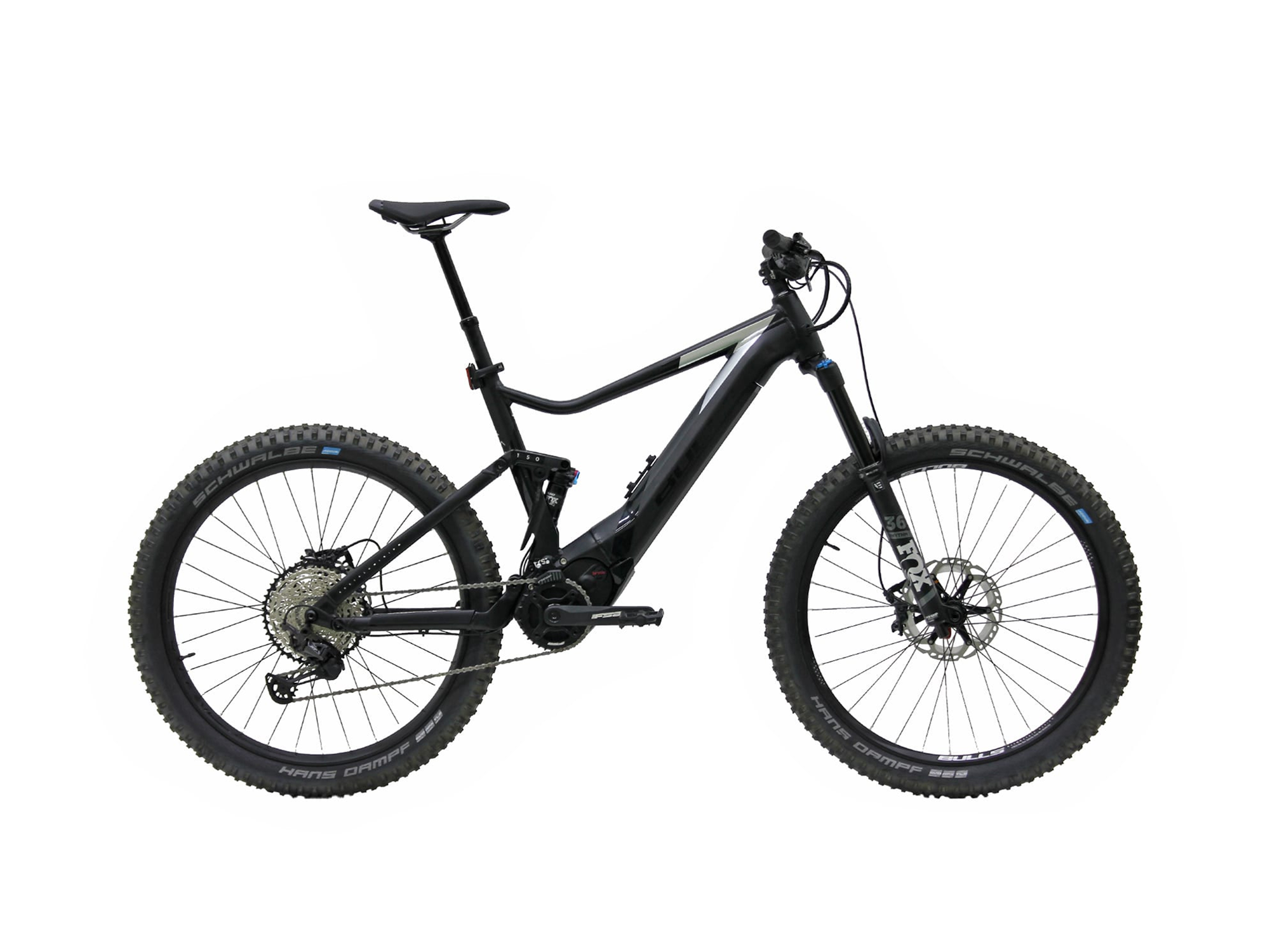

- Compared to the 2018/2019 version of this bike, BULLS has updated the drivetrain to a 12-speed withy 10-51 tooth cassette, this give riders an even wider range of gearing options for climbing or reaching high speeds during descents
- Compared to the 2018/2019 version of this bike, they brakes have been updated and the seatpost has also been upgraded (it now offers a bit of shock absorption as well as being a dropper post

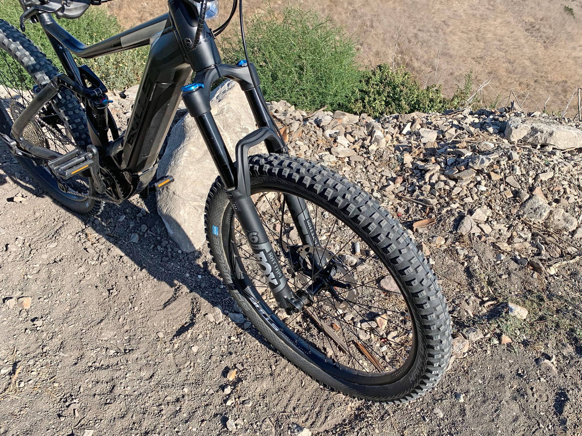

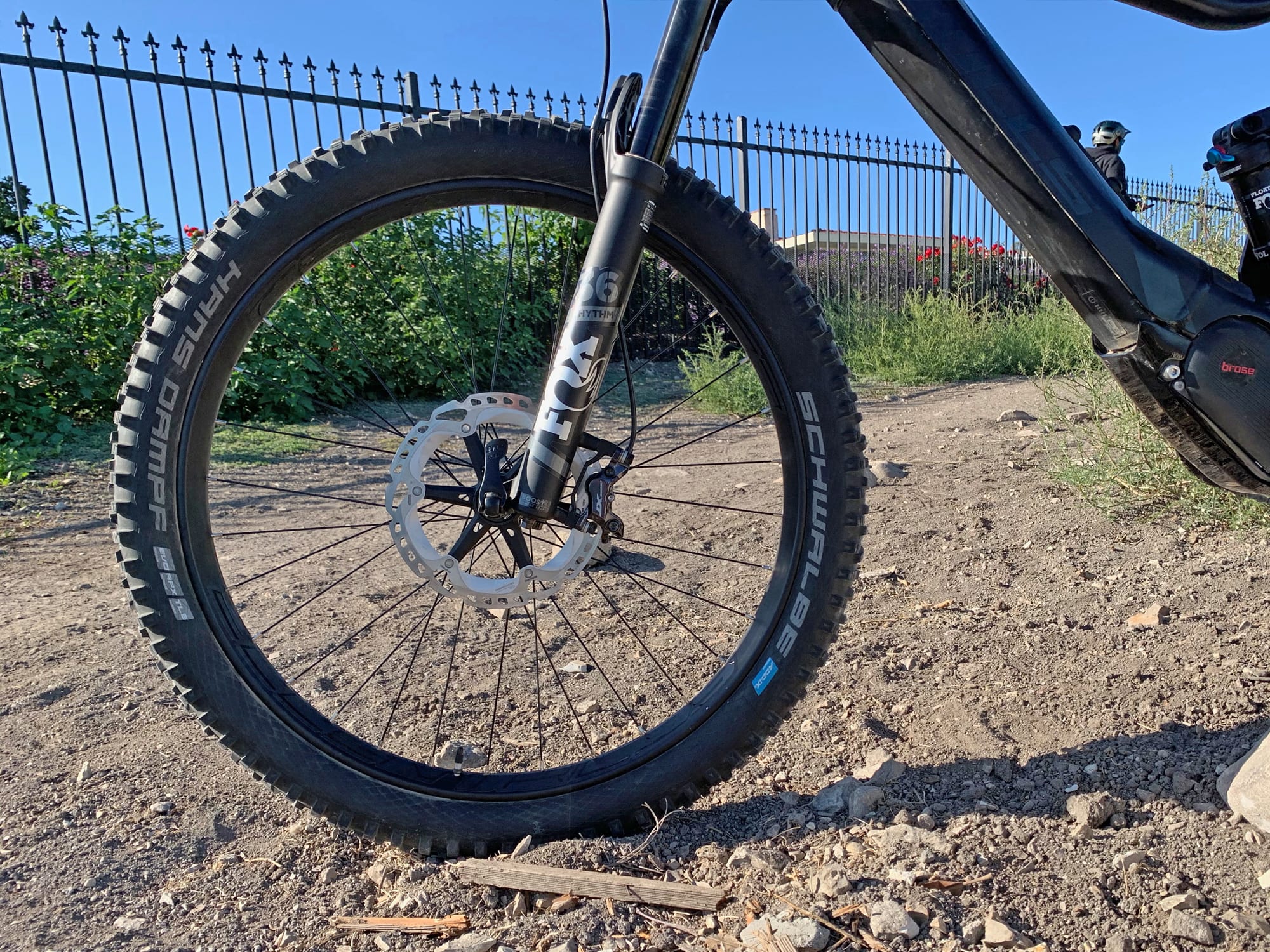

- Plus sized tires have become very popular on electric mountain bikes (and even some city bikes) because they provide some additional comfort with the increased air volume, stability because of the increased width, and the drag and weight is compensated for by the motor assist, Schwalbe is a top name in tires and the Hans Danpf performs great in all mountain ride settings… the rims and tires come tubeless ready so you can convert and save weight and run them at lower pressure
- To support the wider plus sized tires, the hub spacing on this bike has been extended to Boost, so that’s 110mm up front and 148mm in the rear, this gives the spokes a sturdier bracing angle and the thick 15mm front and 12mm rear thru-axles provide increased stiffness and strength, both offer quick release for easier trail maintenance and transport

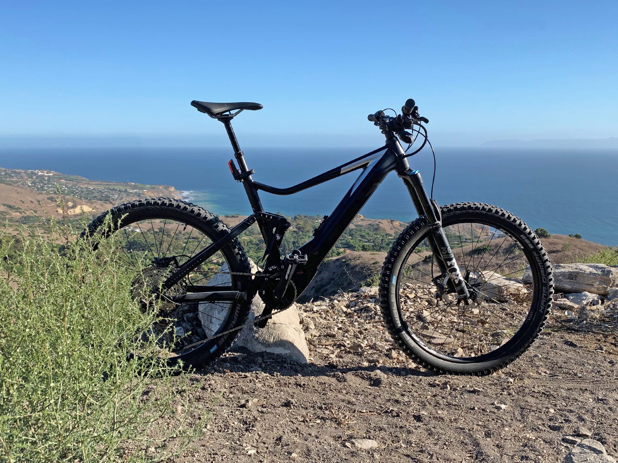

- This ebike is completely blacked out and looks great, I love the black anodized stanchions on the shocks, black spokes, rims, crank arms… even the dropper seat post is black

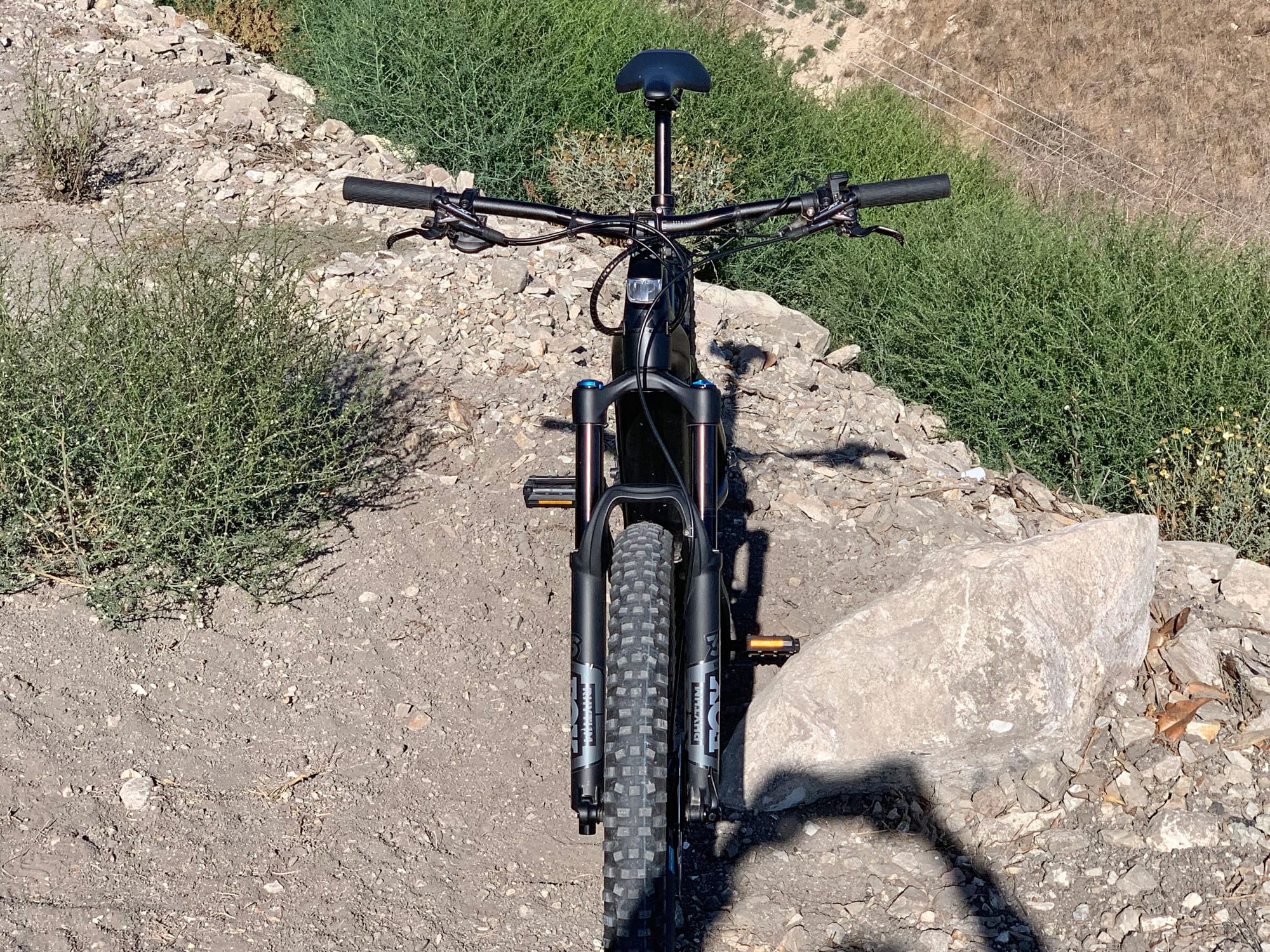

- For 2020, BULLS upgraded the brakes to use Shimano ICE Tech rotors and heat-sink calipers. They are light, stay very cool, and the sizing remains powerful with an extra large 203mm rotors and quad-piston calipers! I also like the the brake levers have tool-free adjustable reach so you can fine-tune based on brake pad wear or gloved and ungloved hands
- Excellent weight distribution, the motor and battery are positioned centrally and very low on the frame, the battery is not mounted on top of the downtube but inserts from below and has a nice rubber guard built onto it, this positioning improves balance and ride performance

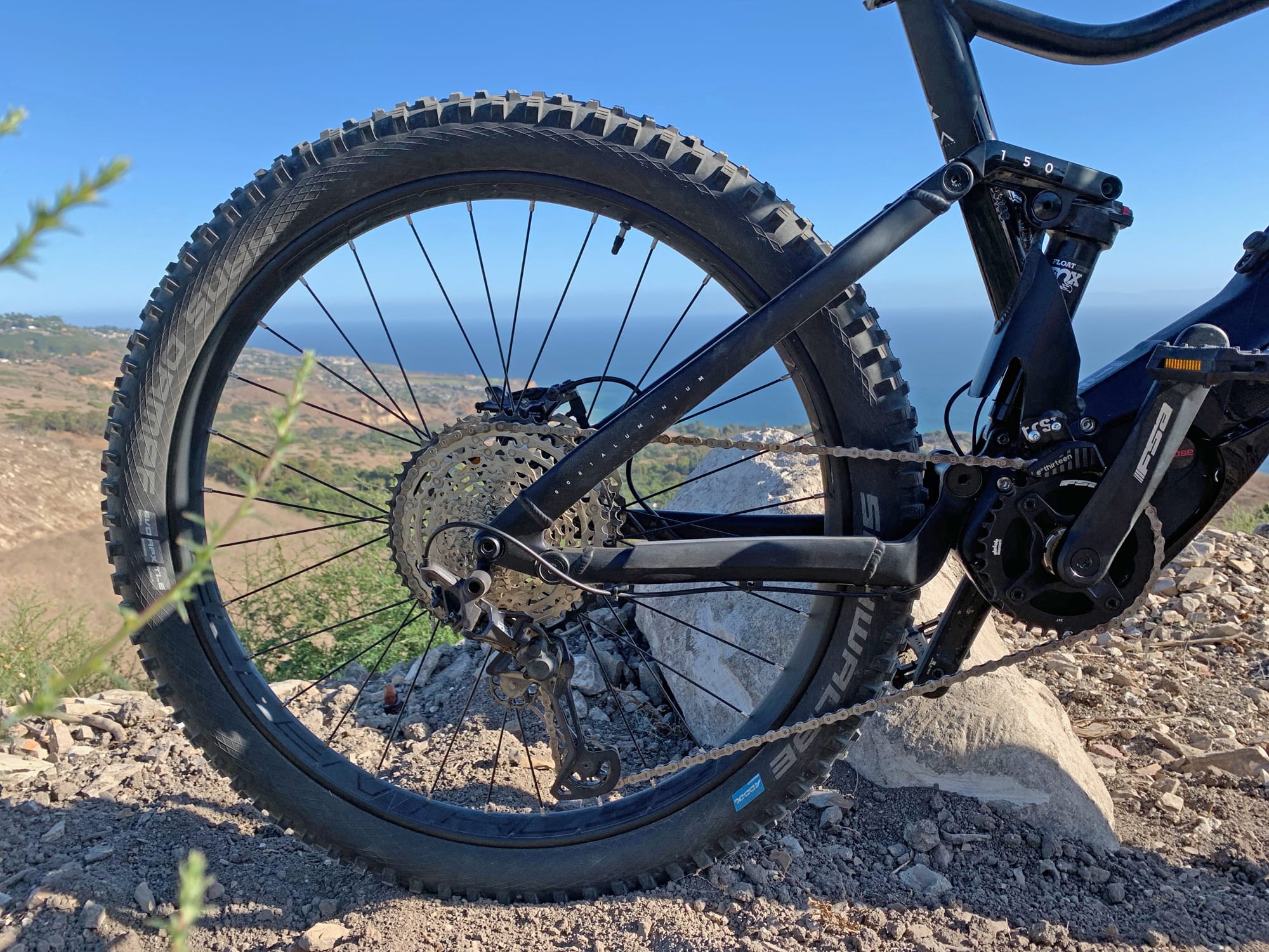

- I like how BULLS has designed their wheel speed sensor to be integrated into the rear brake rotor, the reader is tucked away and the whole system is less likely to fail due to mud, environmental impacts, or loose spokes… it’s great

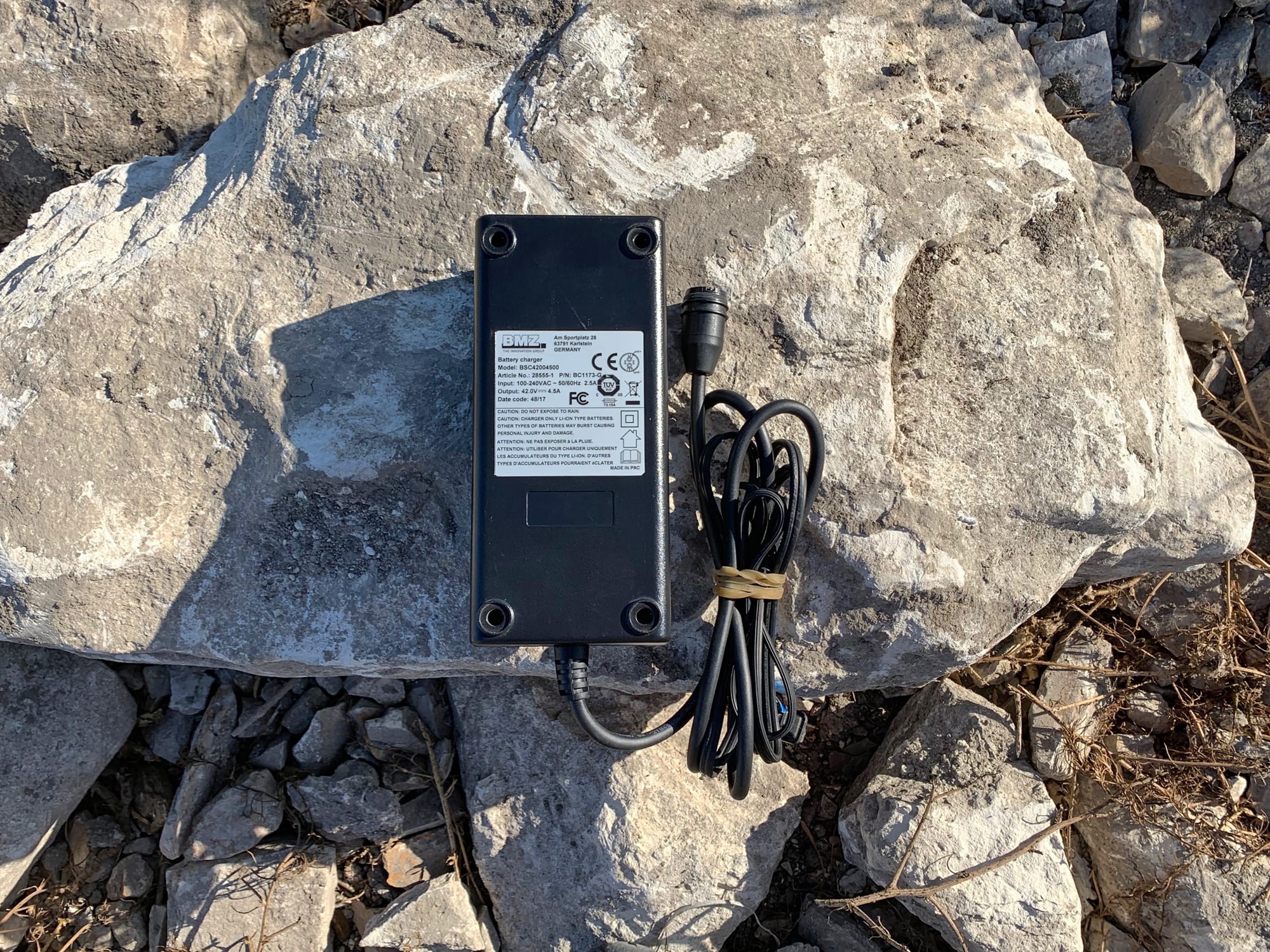

- I really like how BULLS is using a fast charger from BMZ, it makes filling the large 750 watt pack faster and more convenient, I also like how it uses a magnetic plug interface so the connector is less fragile and also won’t pull the bike over if tripped on

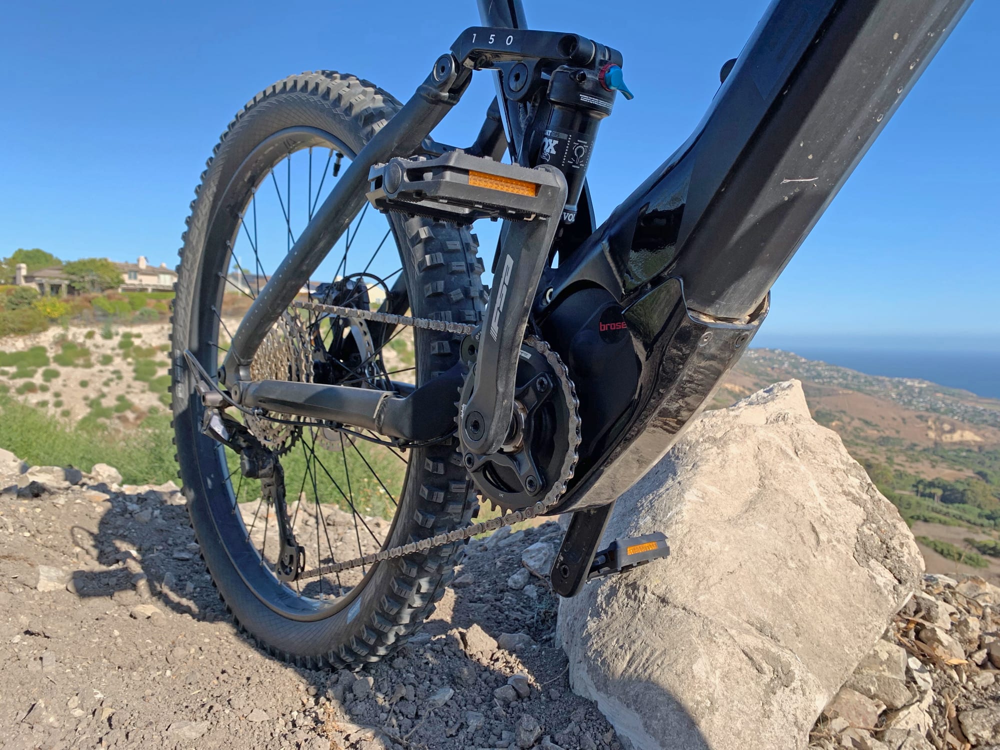

- Nice oversized slap guard on the right chain stay and great derailleur with the one-way clutch system to reduce chain bounce, I like the wide spread of the gears and also that the chainring uses narrow-wide tooth layout to reduce drops on bumpy terrain, the ethirteen chain guide is another little upgrade that prevents chain drops and might deter clothing from snagging on the chainring teeth if you’re wearing pants
- This is a little thing, but I appreciate how the trigger shifters here have a two-way high lever and four-shift low… so you can really dump gears when you’re approaching a steep hill

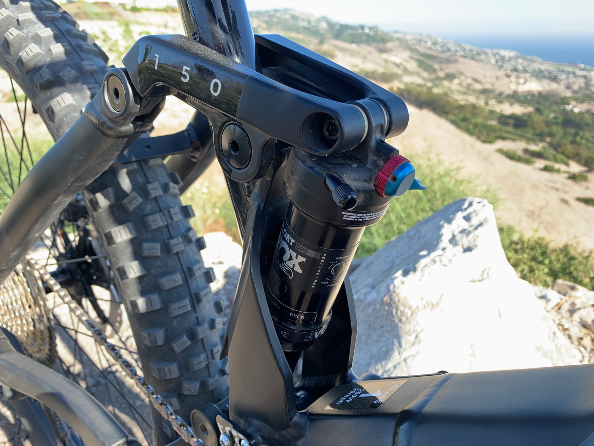

- Both shock absorbers are air and can be sagged to your body weight, adjusted for compression, and rebound adjusted to work with the environment, they are top of the line and weigh less than spring suspension while still being durable due to thicker stanchions (the fork uses 36mm stanchions)

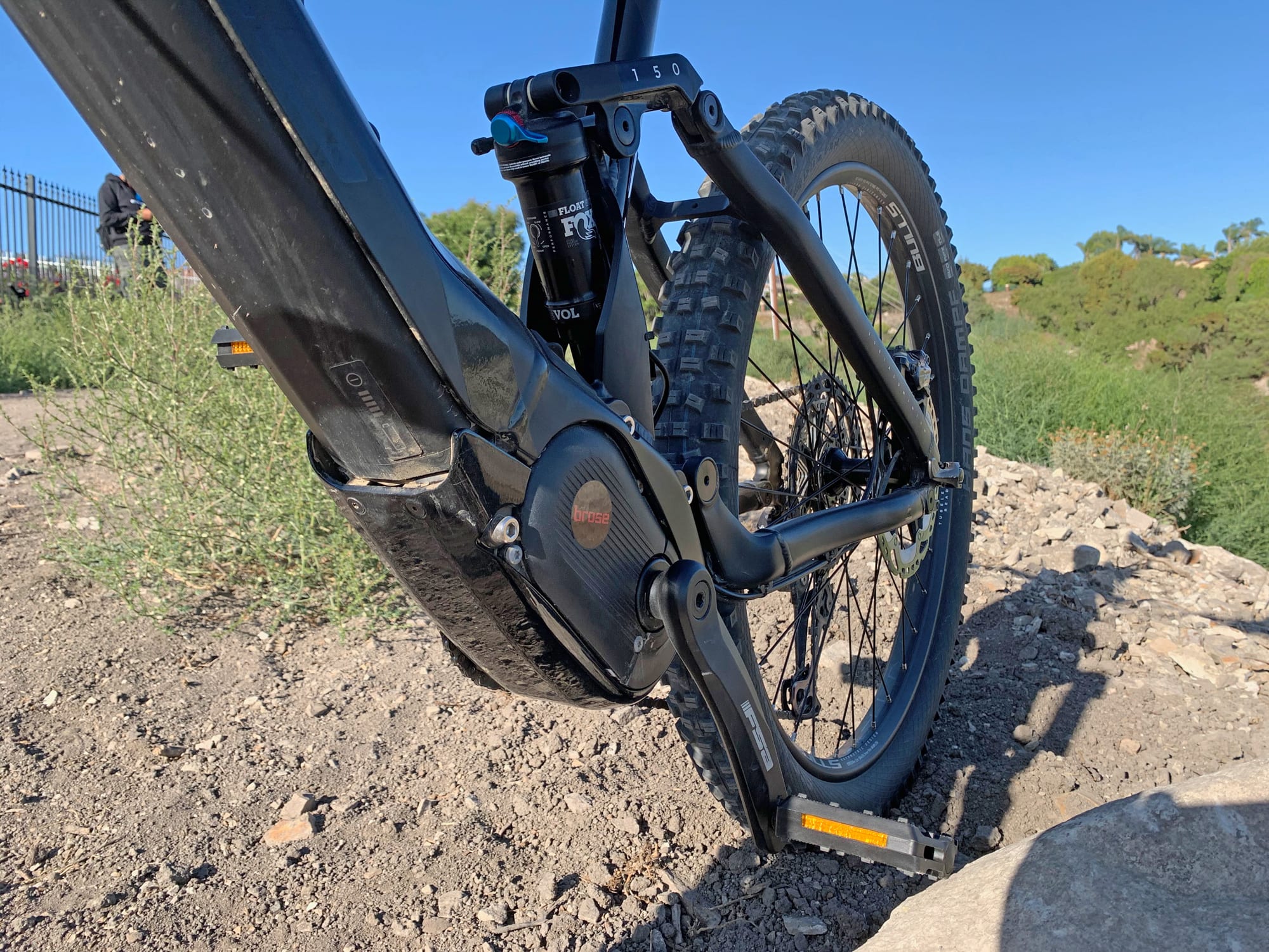

- The motor feels very well protected here because it has an alloy skid-plat built onto the bottom vs. just plastic with some of the other ebikes, however, this bike does weigh a bit more (~56lbs) due to this, the rear shock stanchion fender, the plus sized tires, and the high capacity battery pack

- As great as the battery charger is, being fast and using a magnetic Rosenberger interface, it does weigh more at 1.9lbs and is physically larger than many competing products, so it’s less fun to bring along

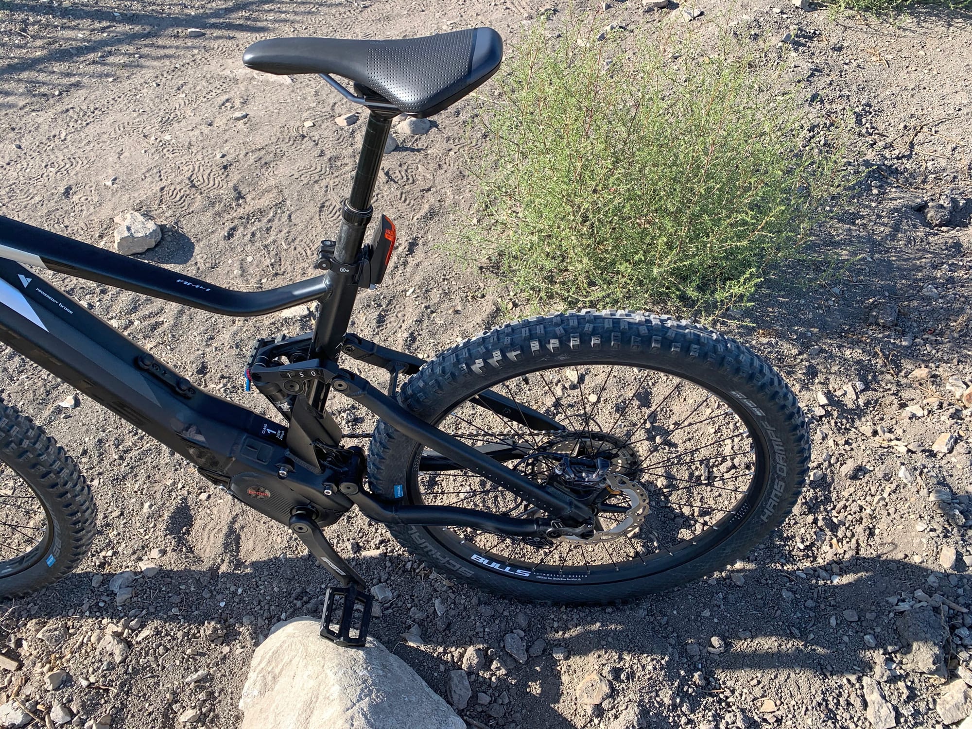

- If you do get that rear light, you might want to be careful about dropping the seat post, because it could come down and strike the top of it, something to be mindful of since the light sticks up above the seat clamp and the dropper post allows the saddle to get very low near the clamp

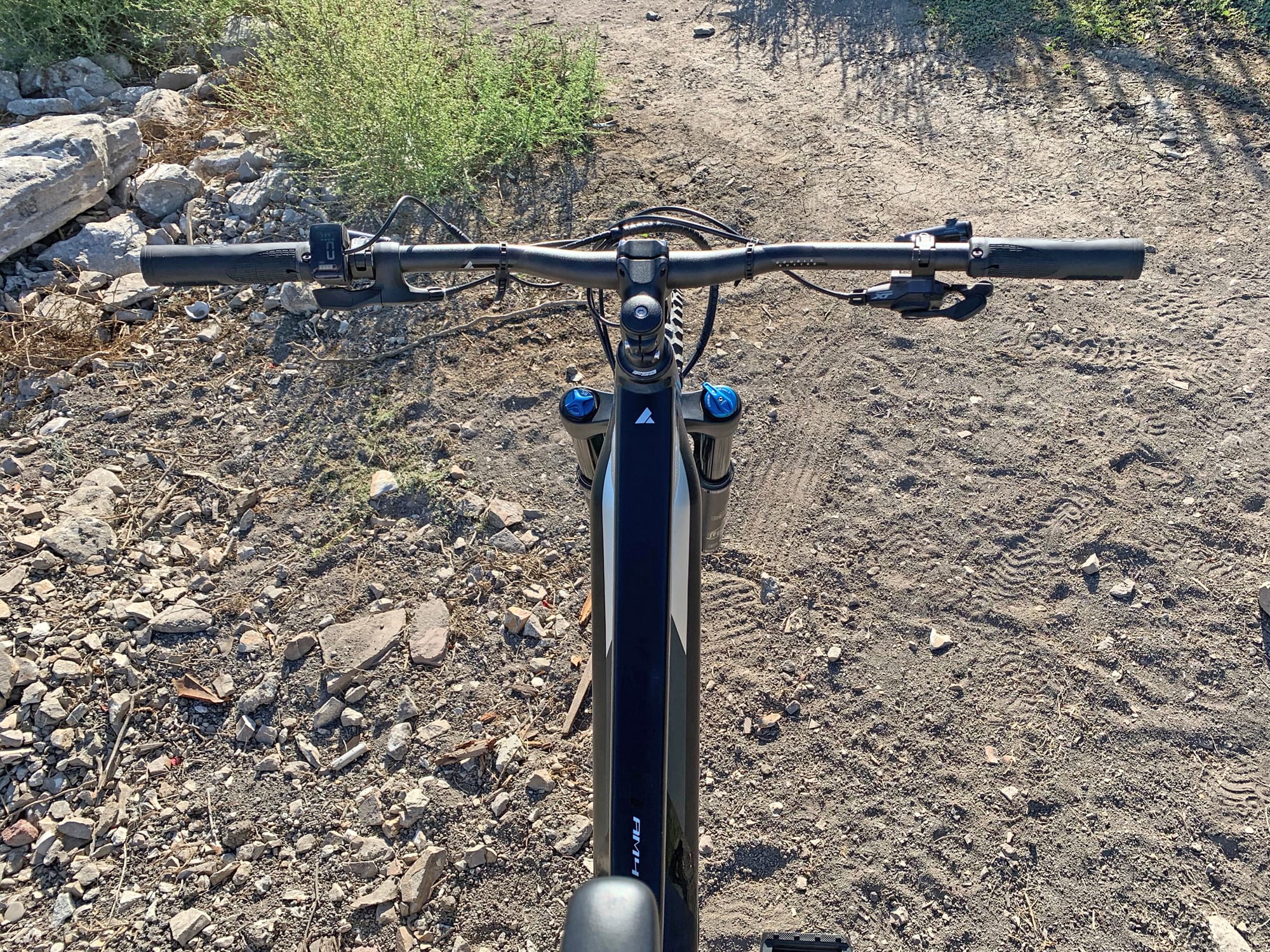

- The display cannot be easily removed, nor can you swivel it once it’s tightened down, I like that it is small and out of the way, but some may prefer a larger screen
- I noticed the charging port is positioned next to the crank arm so that could get in the way of the pedals, luckily though, the cord is magnetic, so if it gets pulled, it should remain mostly undamaged
