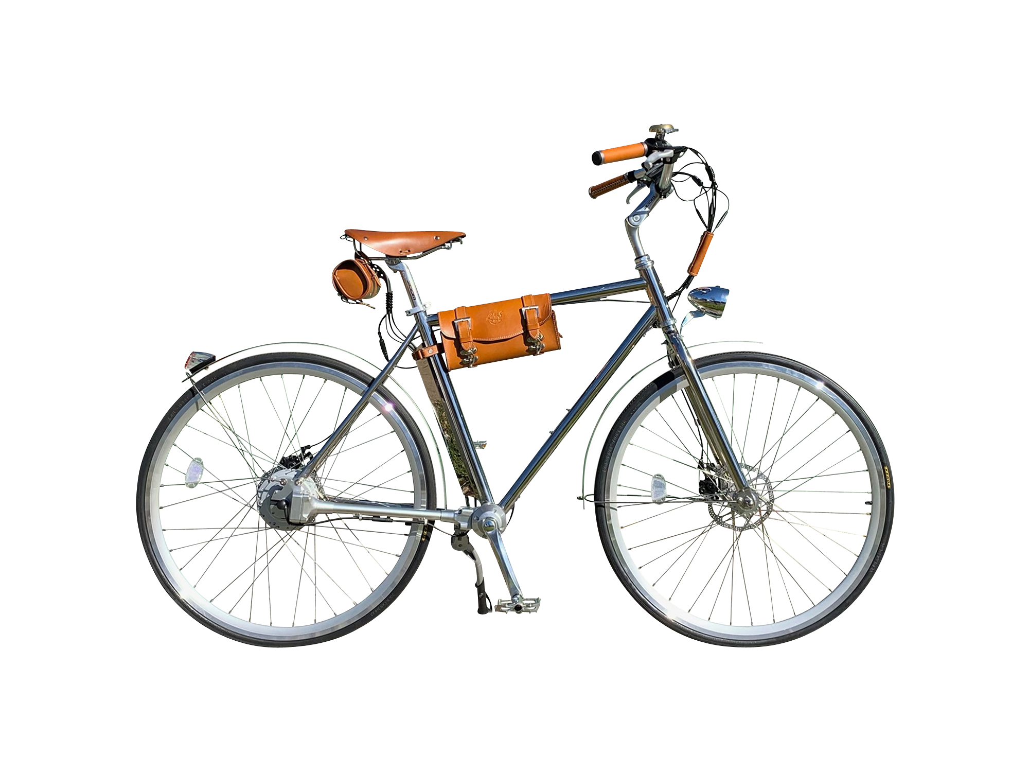

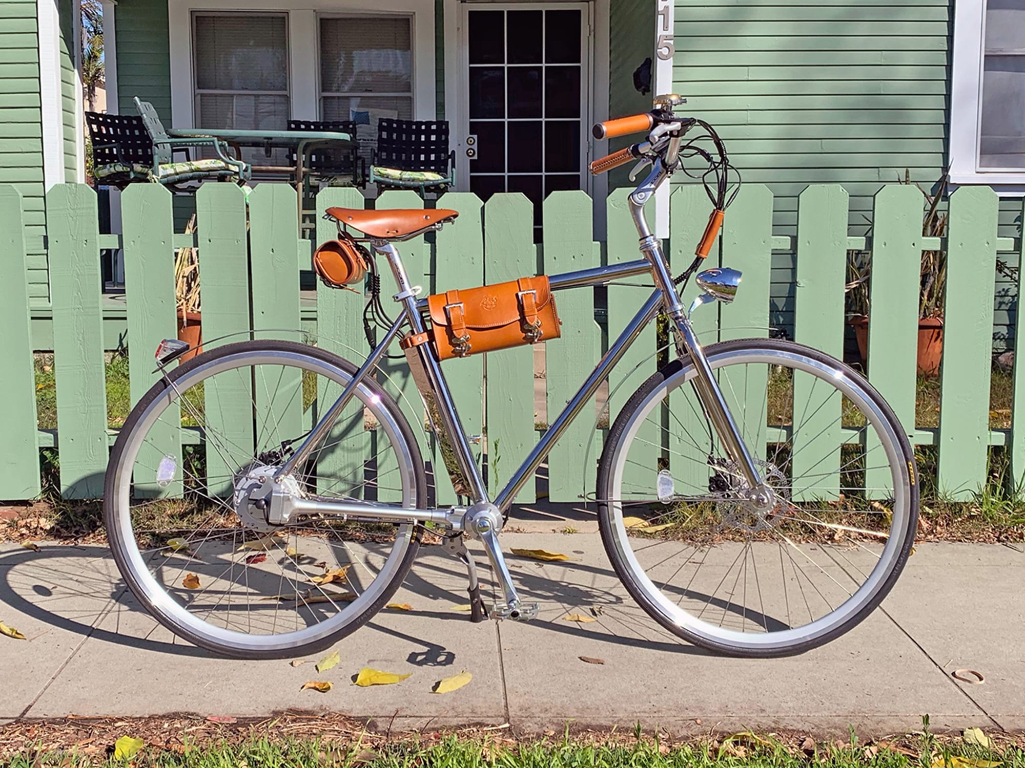

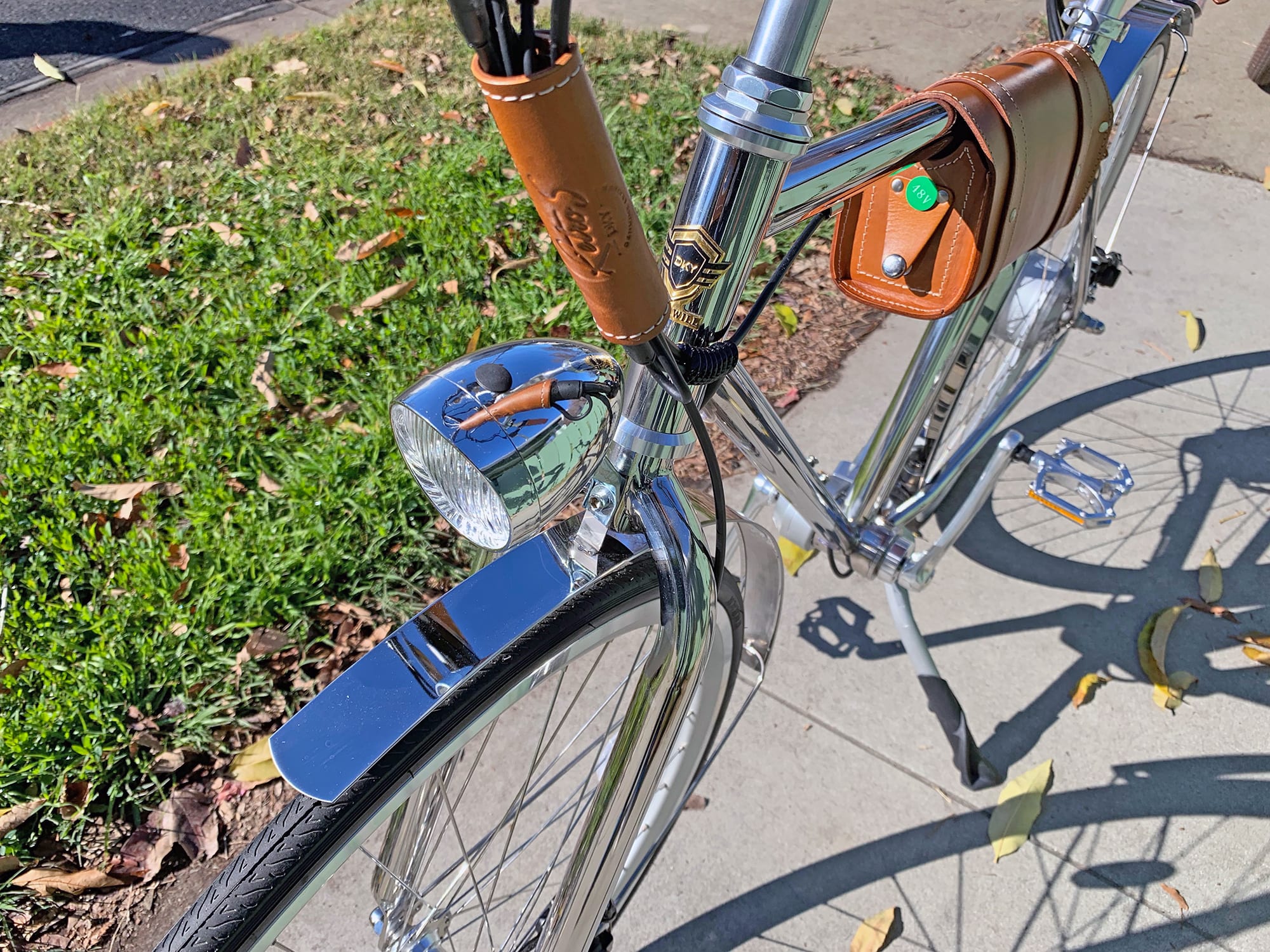

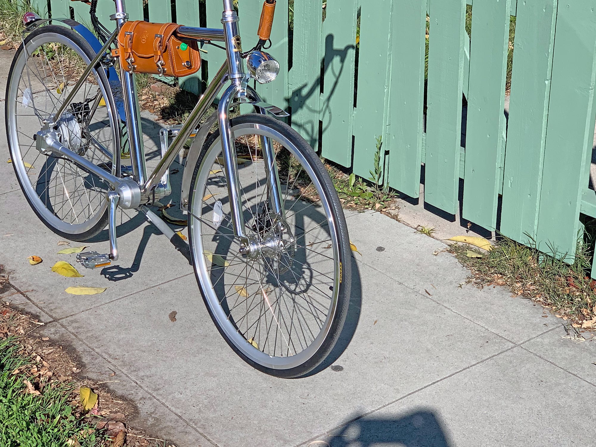

California Bicycle Factory is a new company to me, but they have actually been around since 2010 and this year they are offering their take on a simple yet clean and minimalist shaft drive ebike; the Retro S. This bike hides the electric aesthetics well and looks a lot like a traditional bike. On top of that, it has this cool chrome look with what I am told is a polished stainless steel, although I thought it was more of an aluminum alloy. It also has these polished flat stainless steel fenders but I am not sure if they will get amazing coverage because of the design. It definitely looks like they went for more form over function, but that’s not necessarily a bad thing, there is a lot of clever engineering to get things the way they are, and in this case, some of the simplicity means less maintenance or fuss. If you are looking for a battery or motor controller, you may miss them. The Retro S is equipped with two vintage looking leather saddle bags (I am told the leather comes from Italy and India) and inside each of these branded bags is the controller and the battery itself. The aesthetic of these bags is clean, and they match the stitched leather locking grips and even the leather wire wrap in the front. Although there are a few exposed wires, many of them are tucked away in the clean chrome looking frame. Another nice leather accent is the saddle that is hard and uncomfortable at first but will wear over time conforming to your body becoming soft and comfortable, like a Brooks saddle. One last note on the aesthetics is the matching Wellgo aluminum alloy pedals, which looks great here, but they are a little narrower, so do be mindful of that. The frame offers a relaxed riding position, thanks to the Quill zoom stem that goes up and adjusts, swept back bars, and the lower attack angle which overcomes the bumps comfortably. For tires they have a Kenda 28-622 700c x 28c narrow setup, similar to a road bike with a high 90psi pressure. Wheels here are 14 gauge spoke and 36 hole with machined double walled sidewalls. I am seeing some torque arm inserts, but no bigger torque arm, which I guess is okay since the electrical system on this bike is a bit on the entry level side. Some other features here are the headlight and rear light. Neither is battery integrated, but the front light has 3 LEDs and can be set for solid lighting or to blink while the rear light is actually a solar powered single LED which is positioned quite nicely out of the way. The Retro S does only come in one size and frame, this high-step 20” frame which is on the larger size, but the bike is fairly lightweight at 50lbs overall. Looking around the bike, I notice the 28.6mm seat post that you could swap out with a shim to get a suspension seat post, and there are tabs on the back of the saddle if you really wanted to add another bag or something. Other features include bottle cage bosses, motor inhibitors on the brakes, adjustable length kickstand (although it is positioned near the 165mm crank arm, so you can get pedal lock when reversing), and I love this big retro inspired integrated bell! As I said earlier, it is a shaft drive which means no chain and it only has one single speed for simplicity, which we will get into shortly, but for $2,499, they really pull of the cleanliness better than most and it just really looks classy.

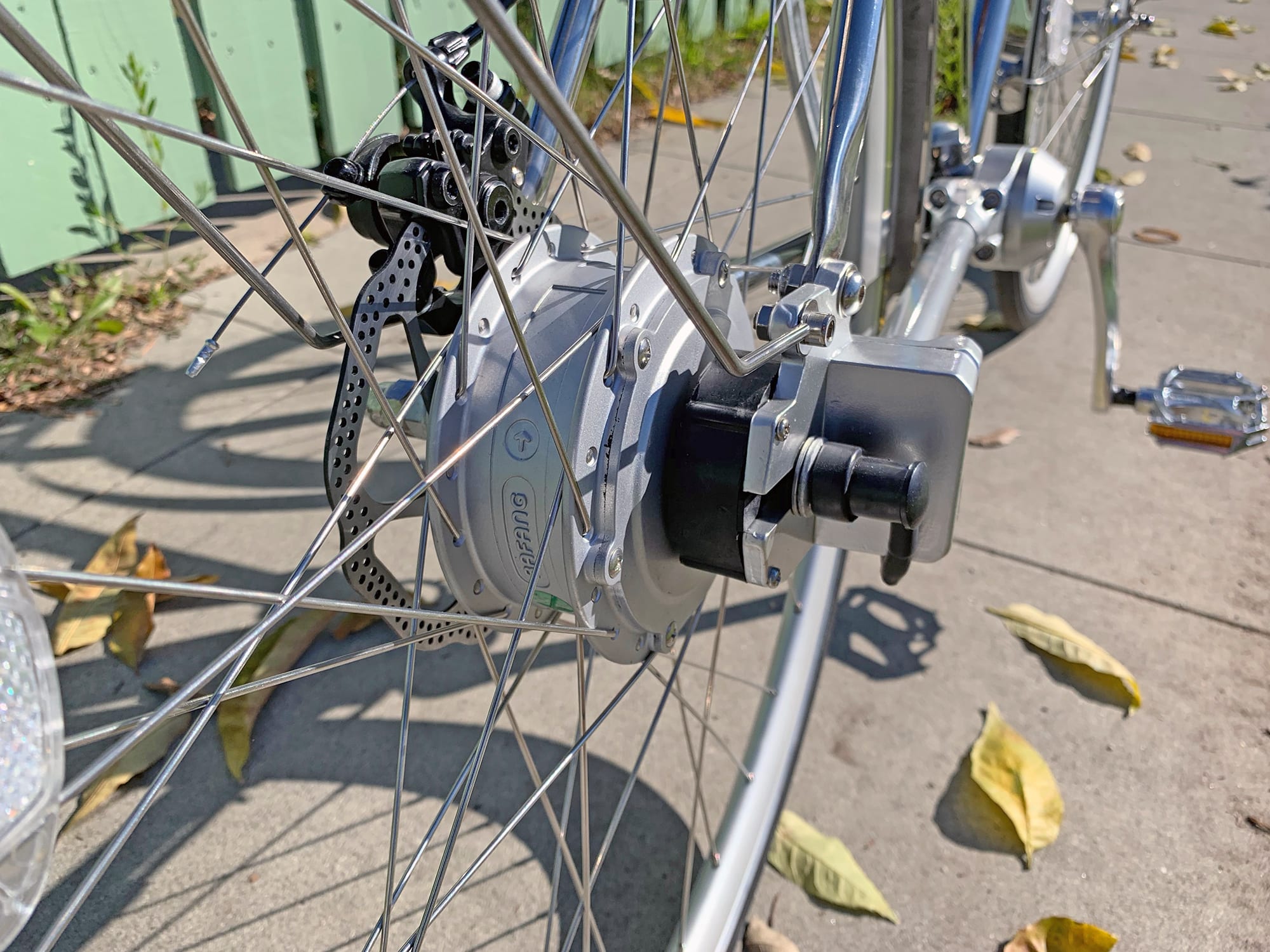

Driving the Retro S is a 250 watt nominally rated planetary geared Bafang hub-drive motor. This motor is kind of the entry level motor for Bafang and offers 50nm of torque. This bike is ready to go for Europe since 250 watt is the legal limit, but here in the states you may be used to something a little more powerful like a 750 watt. In use, the motor is quiet and is smooth in the lower levels of assist making it very fun to ride…. It feels like the motor never cuts out and keeps going and going. Keeping with the clean theme, I actually looked for a cadence sensing unit, and I know it is there somewhere, but I couldn’t find it. The motor cable is bent a bit coming out of the hub to get around the shaft drive, but it is out of the way and secured by that shaft in the event of a crash. I did notice a bit of delay on the cadence sensor with stopping and starting. Since this bike also has a throttle and some settings allowing you to push the limits, I decided to crank up the settings and see what happens. After adjusting the settings, I got 25mph on both throttle and pedal assist! With these road bike style tires, it almost changes this to a speed pedelec! Braking was a bit harder however, and you could tell this bike may not be made for such riding continually. Stopping the Retro S is a set of 160mm mechanical disc brakes. At that high speed, the braking was harder since there was no mechanical advantage due to the smaller size of the brake disc and the larger size of the wheel. Plus, mechanical disc brakes require a bit more of a hand pull and can have a slight bit of lag sending the braking down the rear cable. The single speed shaft drive is unique and interesting to me. The nice thing is there is you don’t have to worry about chain guides or if you are wearing pants… you also don’t have to deal with chain noise which is nice. But of course, you are limited to just that one gear, however I suppose having the modes of pedal assist can kind of make up for that, offering you different levels of assist is similar to what the traditional gears were added for back in the day. I am told a bonus to shaft drive is that it requires less maintenance and even avid riders don’t need to have it serviced until years down the road.

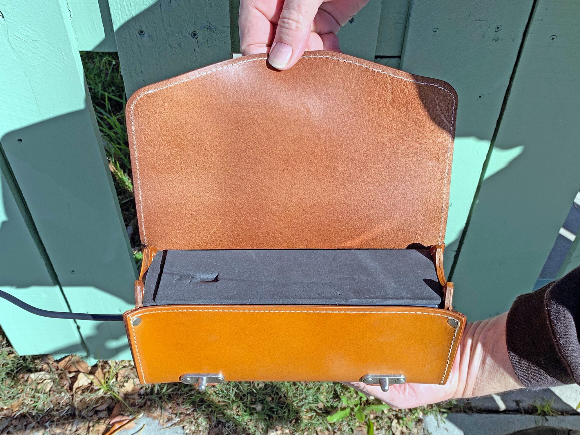

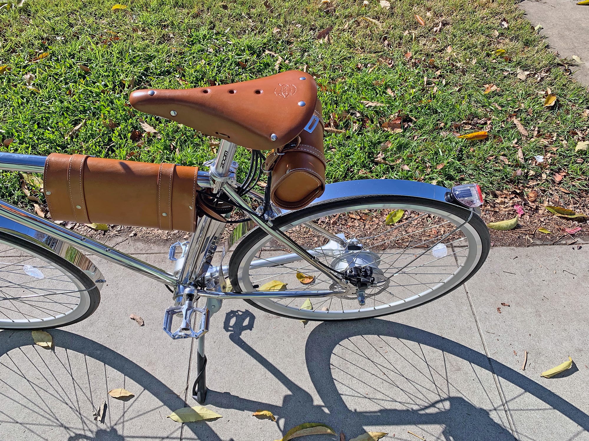

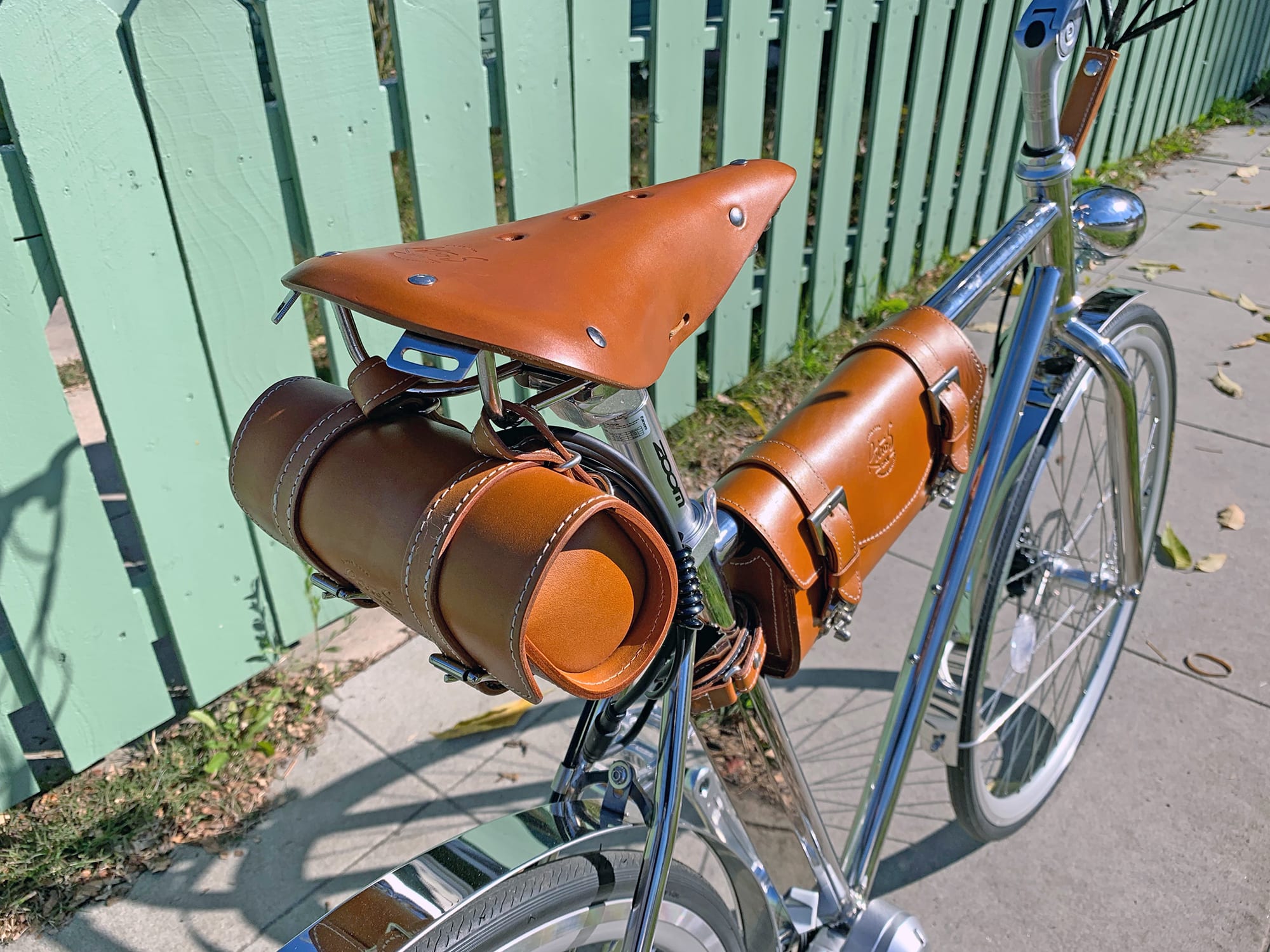

Powering the bike is a 48v 8ah battery with a total of 384 watt hours. Not the largest battery out there, but in keeping with simplicity I guess it fits okay. The battery is 6lbs and is enclosed in the saddle bag hanging from the top tube. I removed the bag and opened it, but upon inspection found that the battery itself doesn’t look like it can really come out of the bag. There are some nice foam inserts to keep the internals from rattling which is nice, and the physical size is small. They have an insert in the front of the bag to charge the pack and it looks like it may just be best to charge it on the bike. I do worry about these bags being out in the open to thieves and the elements. While they are removable, they would have to be disconnected and reconnected from the wiring each time, making for a complex routine if you are a daily commuter. Also included here is the 1.3lb charger which runs at 2amps. I did notice that there was no LEDs on the battery to read charge level, so you will have to turn on the bike to look at the display to know where the charge level is at. To really care for this and other lithium-ion packs, I have heard that storing in a cool dry location vs. extreme heat or cold will extend the life and try to keep it about 50% full when not using for long periods so you won’t stress the cells. Try not to let it run down to zero, because that’s really hard on the cell chemistry.

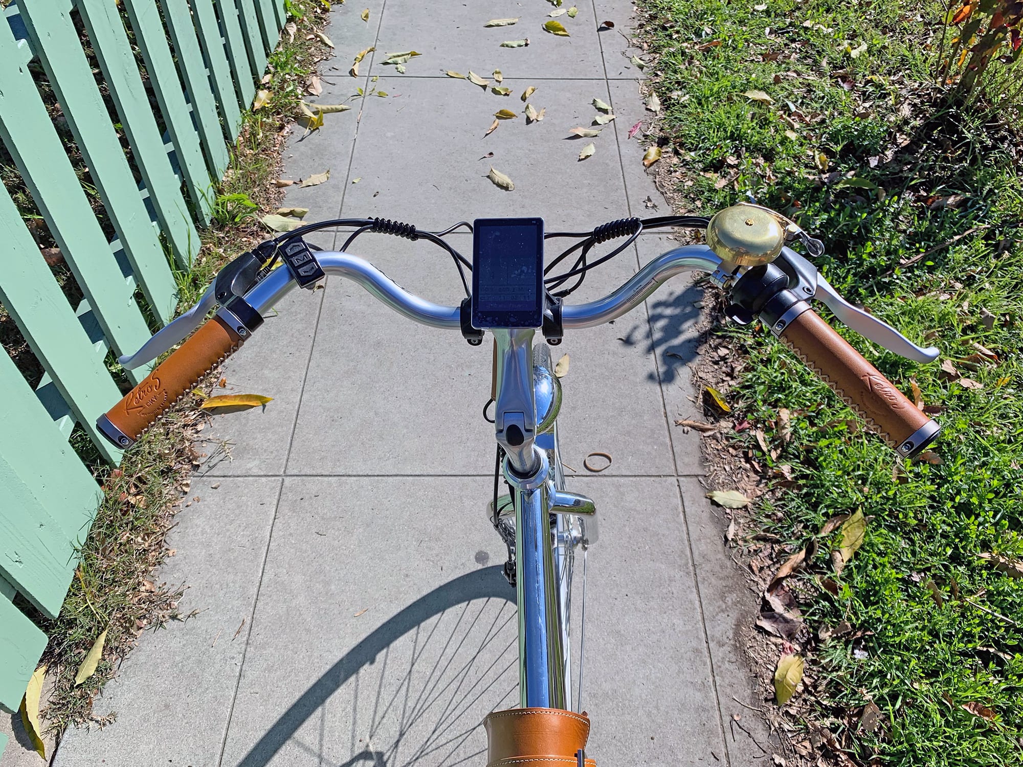

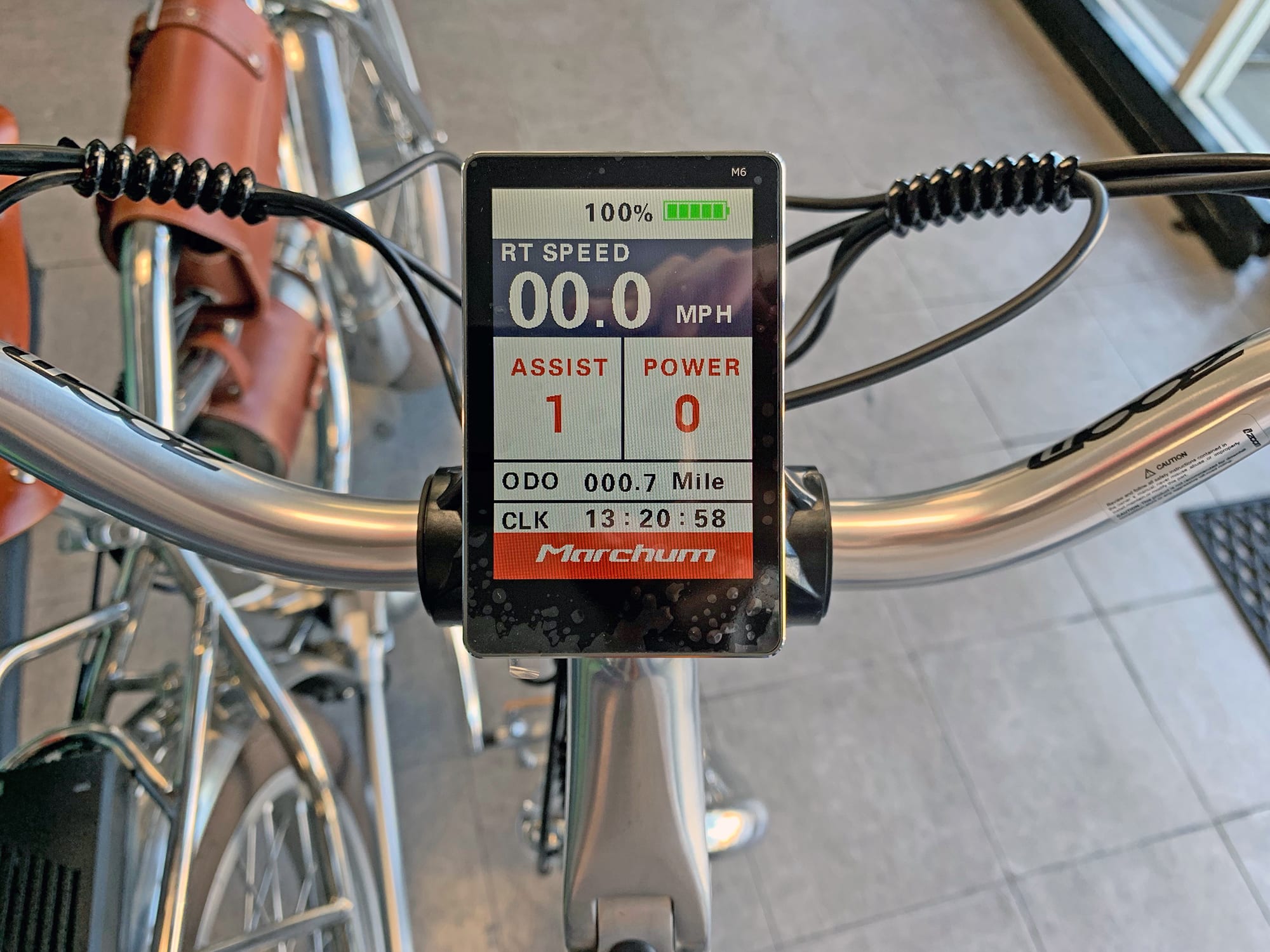

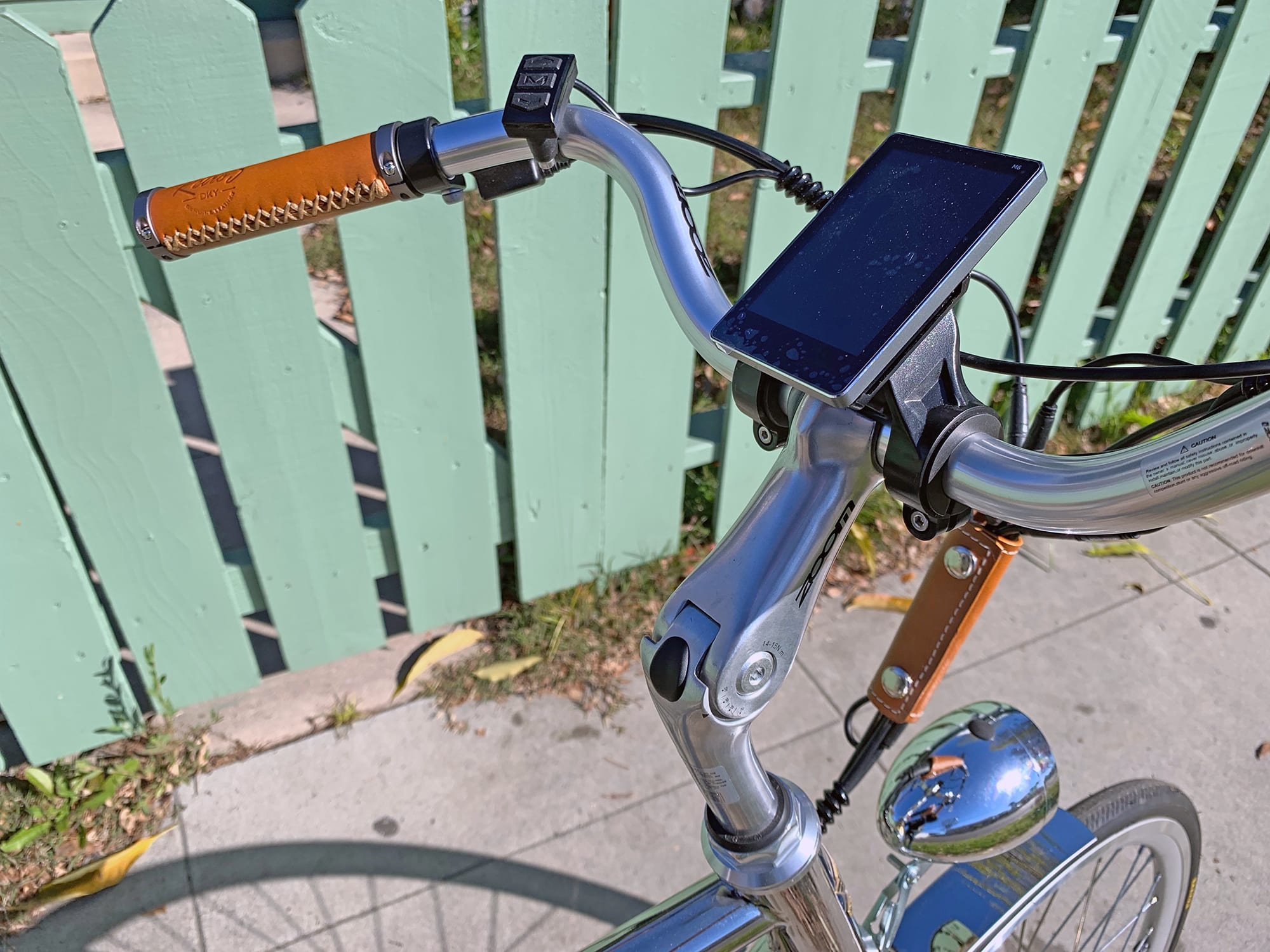

To turn on the bike and display, hold the M button on the controls on the left, there you will also find an up and down arrow. This a display from a company called Marcham and while it is not the brightest display, it does have a lot of settings to browse through. RT labeled big in the middle is actually your speedometer. The bike starts in assist level 1 and has pedal assist modes ranging from 0 (off) to 5. The throttle is always a live throttle, even at 0, so do be mindful of that. It is great to have a trigger shifter as it doesn’t get bumped as easily as a live twist throttle does when you grab the handlebar. I love that on the display there is a battery percentage for accuracy as well as an infographic in 5 ticks. Also, on the display, it shows current power output in watts, an odometer, and a clock. If you hold the up button, it will invert the colors, which is great for night time riding. Going back to those settings I mentioned, if you hold up and down together, it will grant you access to a couple of deeper menus that let you change a lot of settings. Just a handful of the settings I am seeing here is brightness, auto off, battery, clock, temperature, wheel size, start password (you can actually lock the electric system with a password), speed limits, power limit, etc. This is really a massive set of controls and it was here that I configured the bike to hit that 25mph top speed. As neat as this display is I have to iterate that it is not the brightest, also it does not have any USB charging, so sort of a missed opportunity there.

- The leather bags hold the battery and the motor controller as well as hide them, this coupled with some internal wire routing and a small hub-drive motor gives it a minimalist look that also hides the fact it is electric

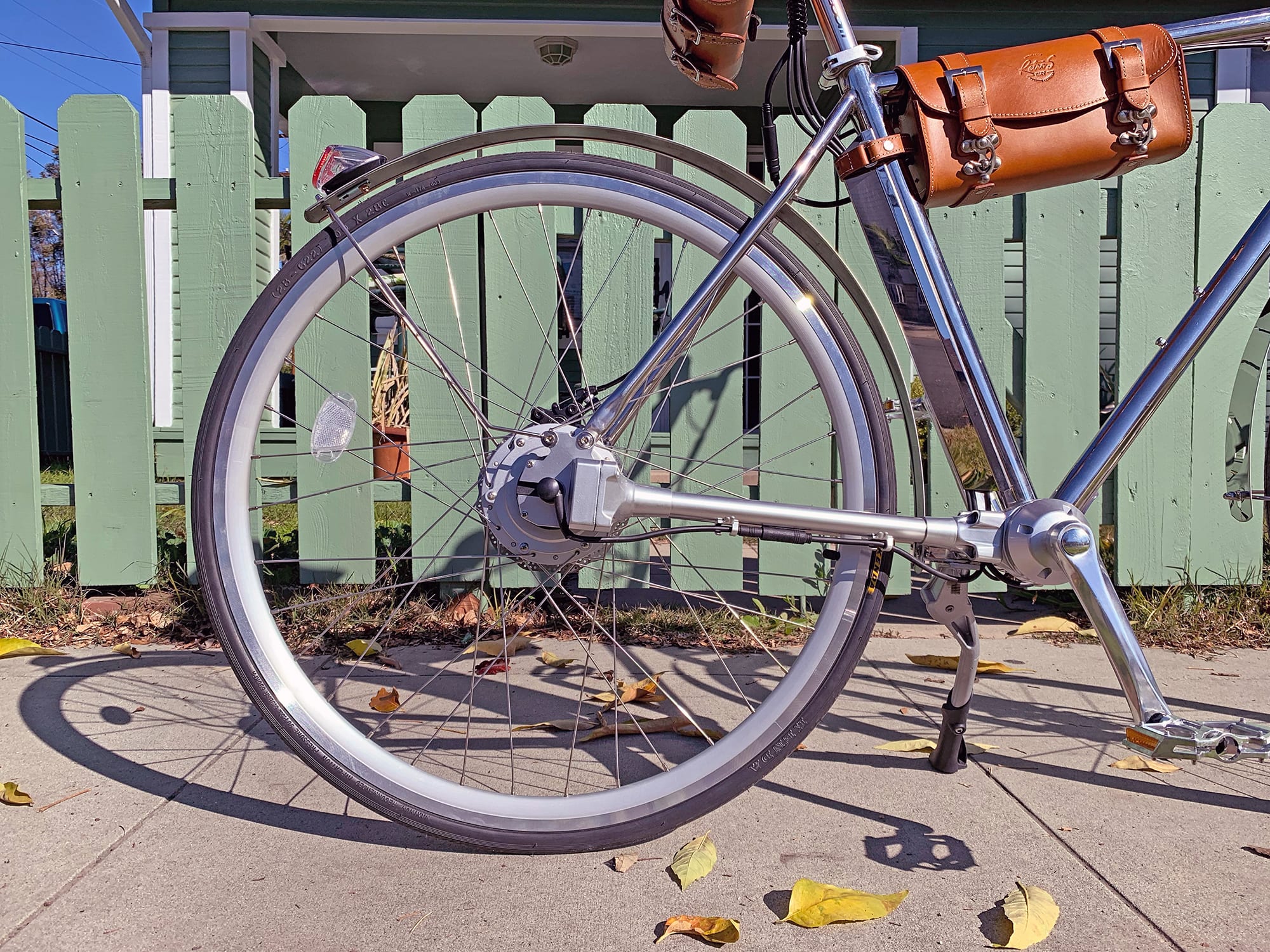

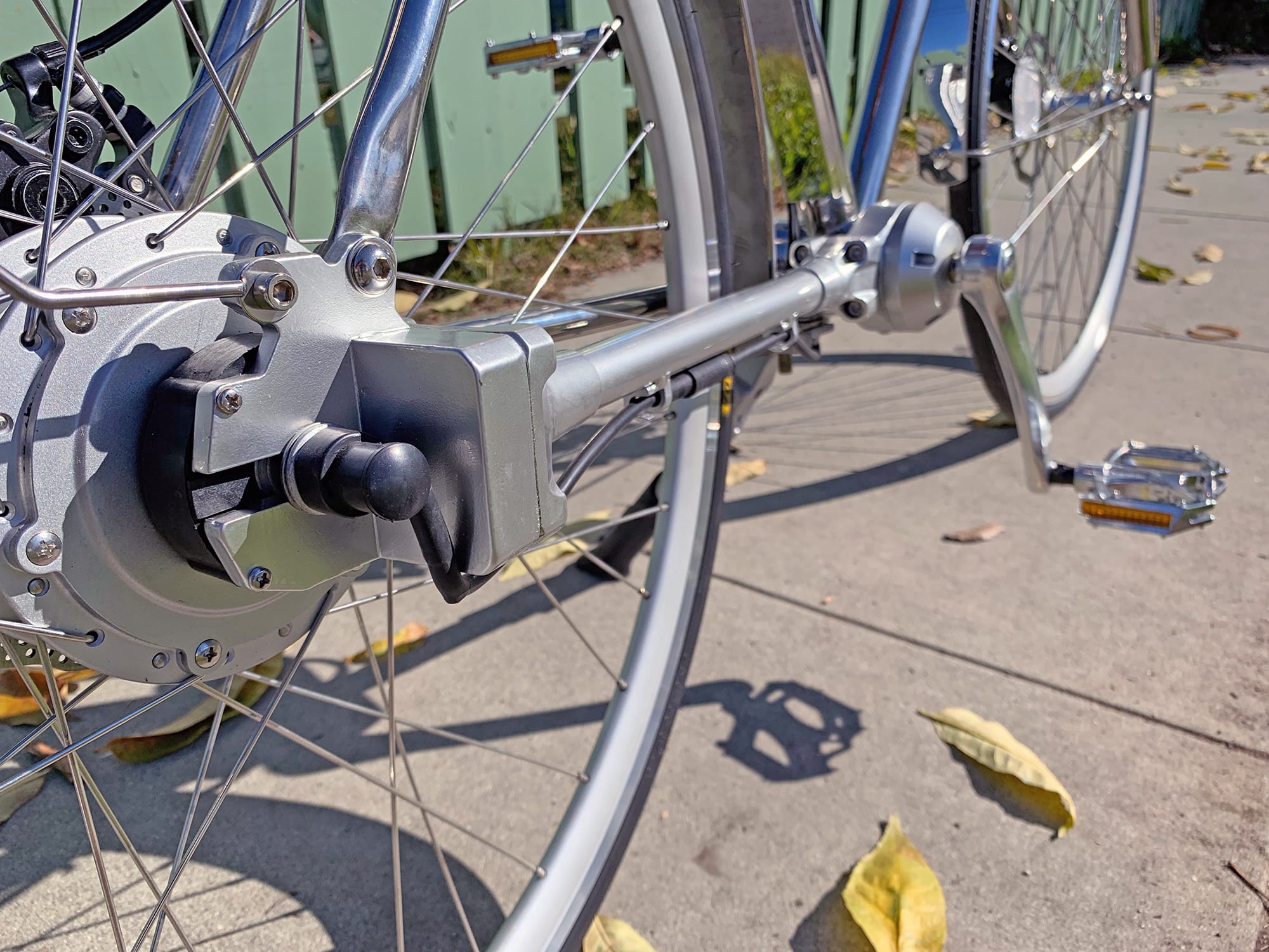

- This is a shaft driven electric bike which means no mechanical speed changes, just the one gear, this keeps things simple as well as making for very low mechanical maintenance

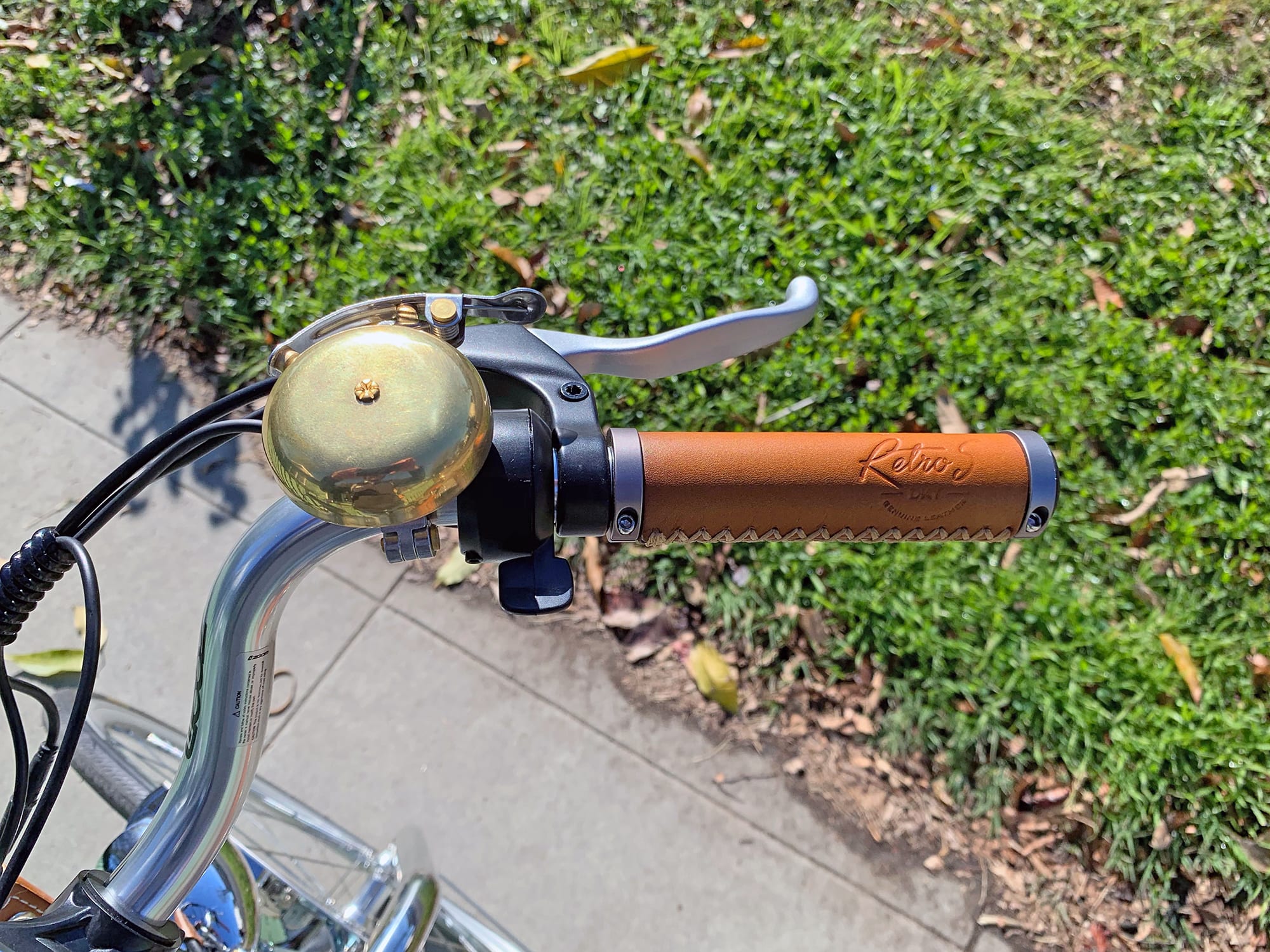

- The leather accents continue with the wire wrap and the stitched locking grips, everything looks great and is branded, I am told the leather comes from India and Italy
- Adding to the cleanliness is the routed cables, the stainless steel pedals, and the fact that a shaft drive has no chain bouncing around which is great if you’re wearing pants and want to ride, or don’t like the chain noise
- Riding position is relaxed with the swept back bars, adjustable stem, and a saddle that wears over time to conform to your body

- I really love the little extras here like the bottle cage bosses, adjustable length kickstand (although it is mounted near the crank arm), and this awesome large integrated bell
- The display has a battery percentage level which is my favorite way of reading the battery, far more accurate than ticks and notches
- The display allows you to deep dive and configure the electrical system, this was really fun as I was able to get the bike to do 25mph on both throttle and pedal assist

- The fenders look cool, but I do wonder how much actual protection they give you, also I did notice some fender rattling due to the design

- The bags contain the battery and controller which would be something you would want to keep from thieves or the elements when you park it, but this is easier said than done as you must continually unplug or plug back in wires pertaining to the electrical system
- There is no way to remove the battery from the saddle bag as they are integrated as far as I can tell, it could be because of this that there is no LED charging read outs on the battery

Interesting drivetrain. There are a couple other manufacturers of shaft drive ebikes: in the Netherlands the ByAr Volta, and in Portugal the Beixo Electra and E-Slim models. The single speed gearing on this model would limit the usefulness of this bike in hilly areas, it’s a pity they didn’t use an IGH which a shaft drive lends itself to as on the ByAr and Beixo models and pedal bikes using a shaft drive like the Dutch Brikbikes.
Court says
Hi Dewey! Thanks for calling out those other models. I agree that even a basic three-speed internally geared hub would add a lot of utility to this electric bicycle. Perhaps it’s something they will consider as an option for future revisions :)

The shaft drive is the most intriguing feature on the bike. Often wondered how soon chains would be a thing of the past, with ebikes allowing for more options, but there is the question of how it will hold up, as these have been attempted previously.
