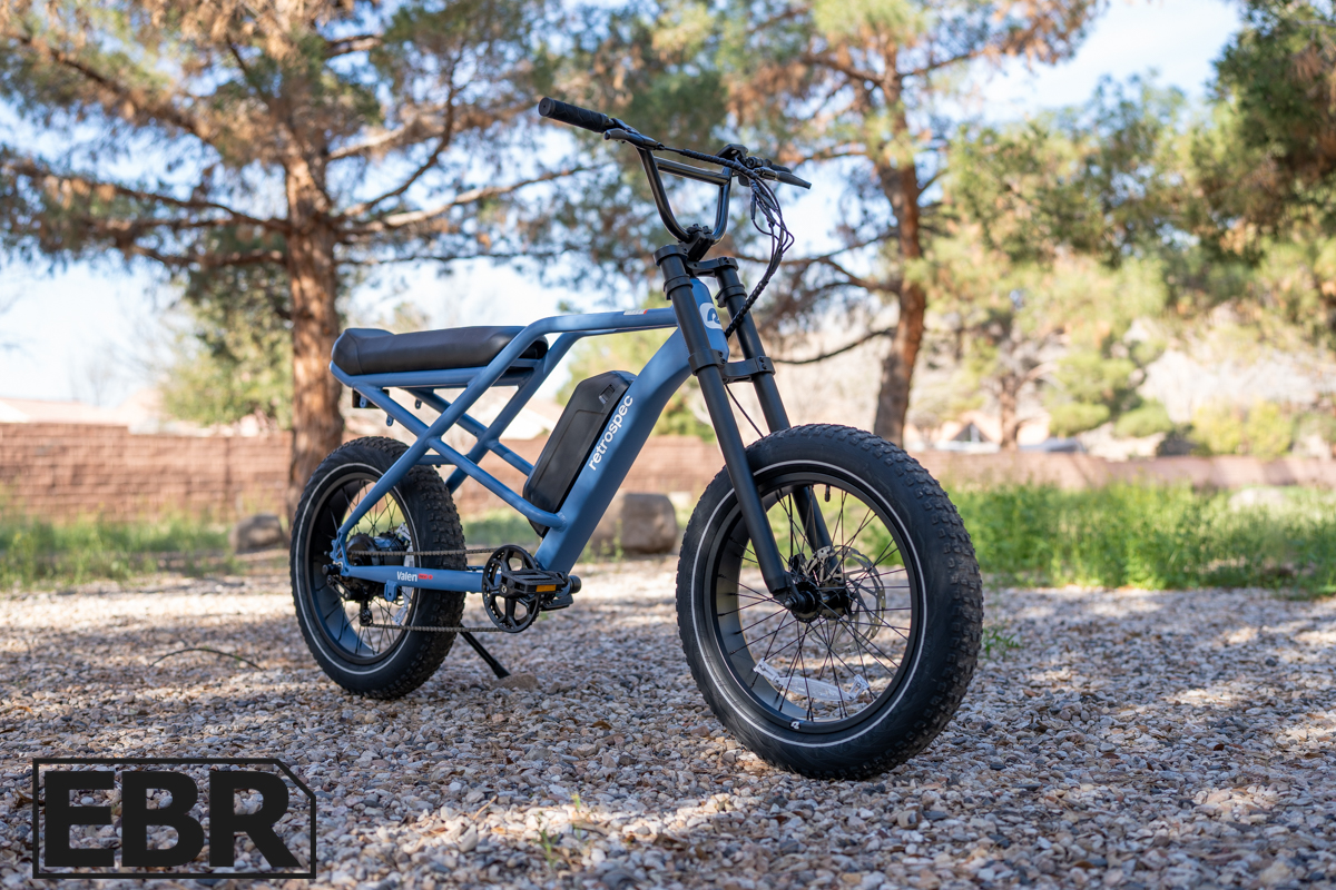

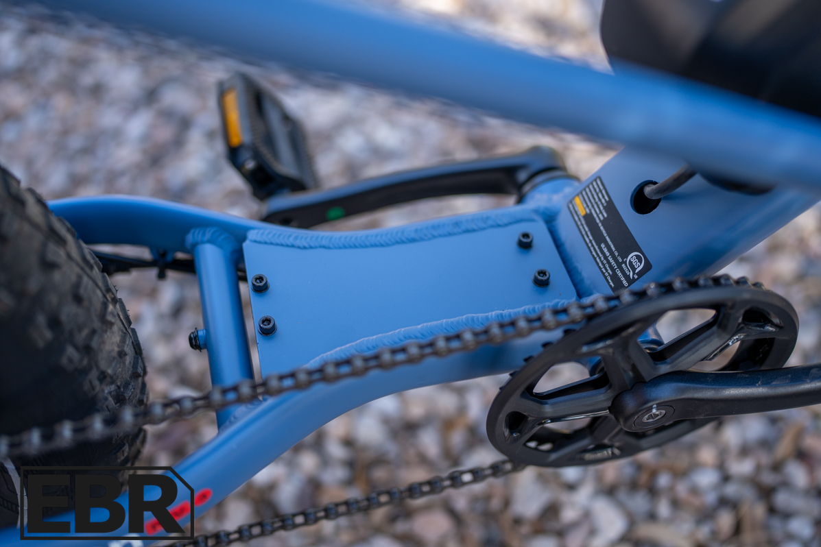

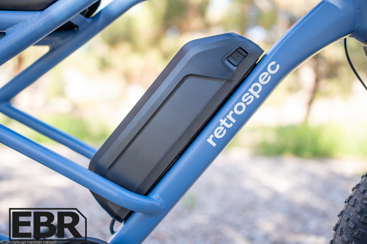

Right out of the gate, the Valen Rev 3 looks the part. The moto frame is clean, the fixed-position saddle fits the aesthetic, and one thing I genuinely appreciated was the open frame design. No digging around inside frame tubing trying to access wiring or components, everything is right there, easy to get to, which is a small but real win for anyone who actually wants to maintain what they ride.
Fit is a little loosely defined here. Retrospec doesn’t publish a traditional height range, just a nod to the 32.5″ standover height. On a moped-style bike that’s mostly going to be throttled around town, that’s honestly fine. The elongated saddle gives you room to slide forward or back until it feels right for your body, and if you need to dial in the reach, a quick loosening of the stem bolts lets you reposition the bars without any drama. It’s not a precision fit system, but it works.

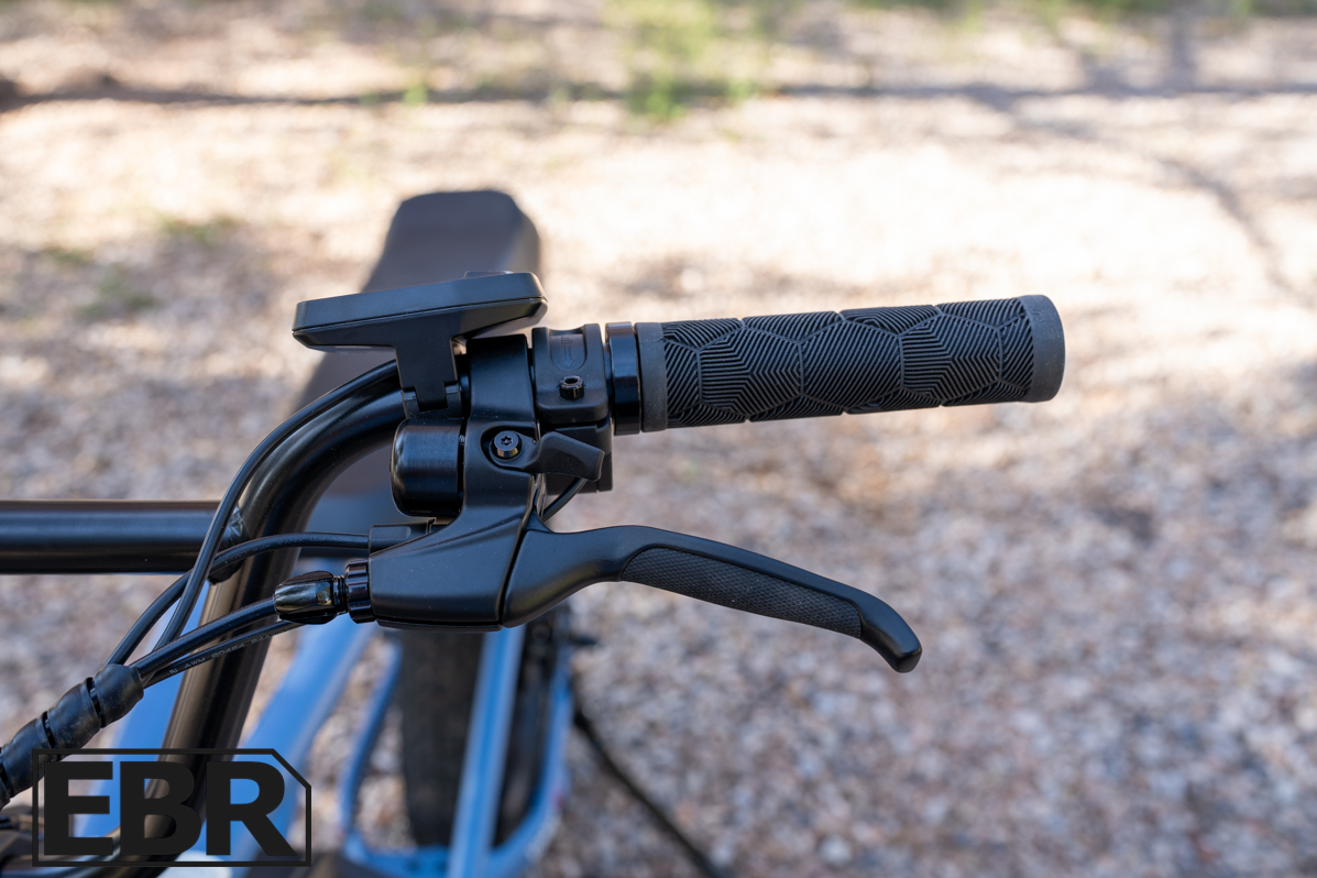

Braking is handled by Tektro mechanical discs, and despite being cable-actuated, they pull their weight. Stopping power is controlled and confident, and in our brake testing they actually came out well ahead of the class average. The single-speed drivetrain keeps things simple too, no derailleur to adjust, no shifting to think about, and if you ever want to spin your legs and supplement the motor, you’ve still got enough gearing to make that worthwhile.

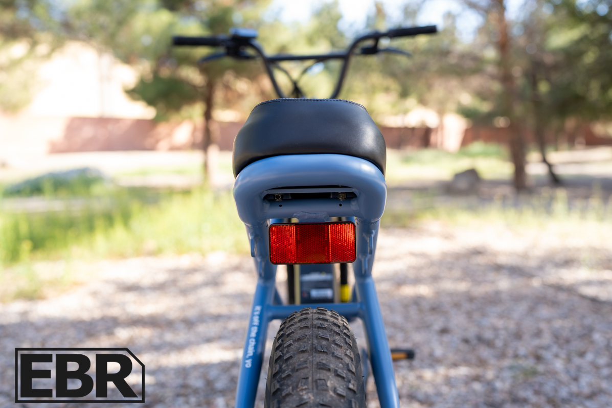

The one area where the Valen Rev 3 genuinely comes up short is lighting, or the lack of it. Reflectors only, front and rear. Once the sun goes down, your options run out fast. I ended up grabbing a cheap clip-on set from Amazon, maybe $20, that solved the problem well enough, but at $1,499 I’d like to see that sorted from the factory next time around. It’s a small thing that would make a real difference.

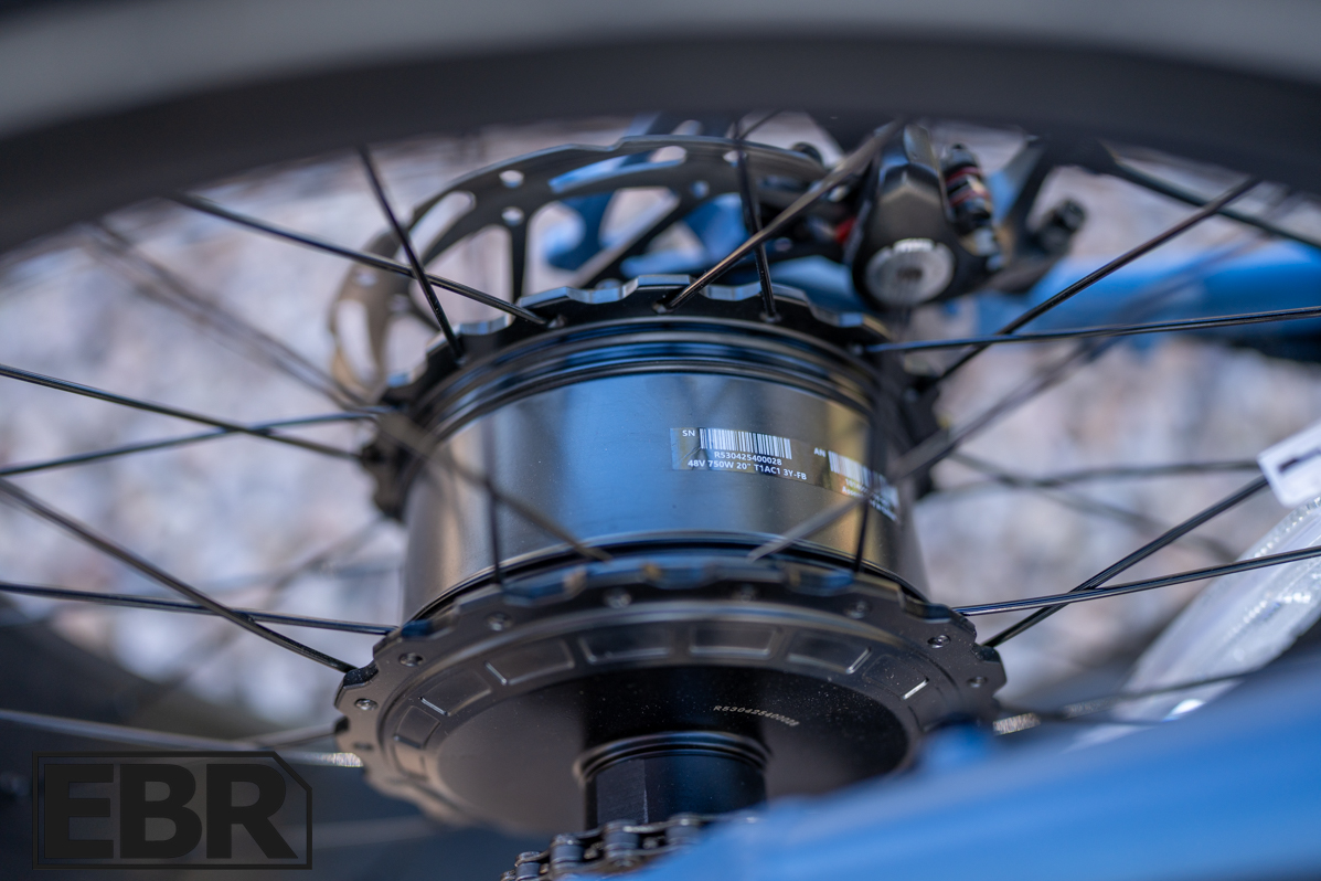

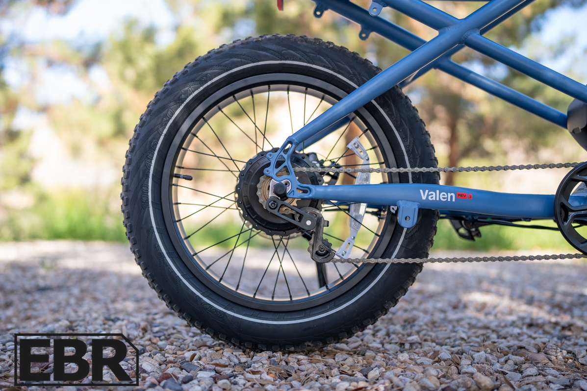

The Valen Rev 3 runs on an Ananda rear hub motor rated at 750W nominal and peaking at 1,150W when it needs to dig in. That peak output shows up right where you want it, off the line and on climbs, and the 85Nm of torque gives the bike a punchy, confident feel that suits the moto-style personality well.
Five levels of pedal assist plus a thumb throttle give you enough range of control to dial in your ride, and the cadence sensor keeps power delivery immediate and responsive. It’s not the nuanced, feathered feel of a torque sensor system, but on a bike like this, that immediacy is actually part of the fun.
The updated Ananda system is a clear step up from the previous generation, and you feel it. Whether you’re hammering the throttle on a flat or holding speed up a hill, the motor stays confident and composed. It’s a well-matched system for this style of riding.
On the battery side, the Valen Rev 3 carries a 48V, 10.4Ah and 500Wh’s using LG 21700 cells, is UL 2271 certified, and ships with a standard 2A charger. One of the practical wins here is the open frame design, the battery is genuinely easy to access and remove, no wrestling with frame tubing or hidden latches. It can be charged on or off the bike, which adds a little flexibility if you don’t always want to roll the whole bike to an outlet.

The drivetrain is about as simple as it gets, and that’s a feature, not a compromise. A 38T chainring paired with an 18T freewheel keeps the single-speed setup clean and low-maintenance, no rear derailleur to adjust, no shifting to think about, no cable stretch to chase down. If you want to pedal, the option is there and it works. If you’d rather just throttle around town, nothing gets in the way of that either.
Braking is handled by Tektro mechanical disc brakes with dual-piston calipers and 180mm rotors front and rear. Cable-actuated brakes can be a mixed bag, but these perform surprisingly well, controlled, confident, and more capable than you might expect given the spec sheet.

The BMX-style aluminum alloy handlebars are 28″ wide and can be repositioned by loosening the stem bolts, which makes dialing in your reach straightforward. Lock-on rubber grips feel solid in the hand and will stay exactly where you put them over time.

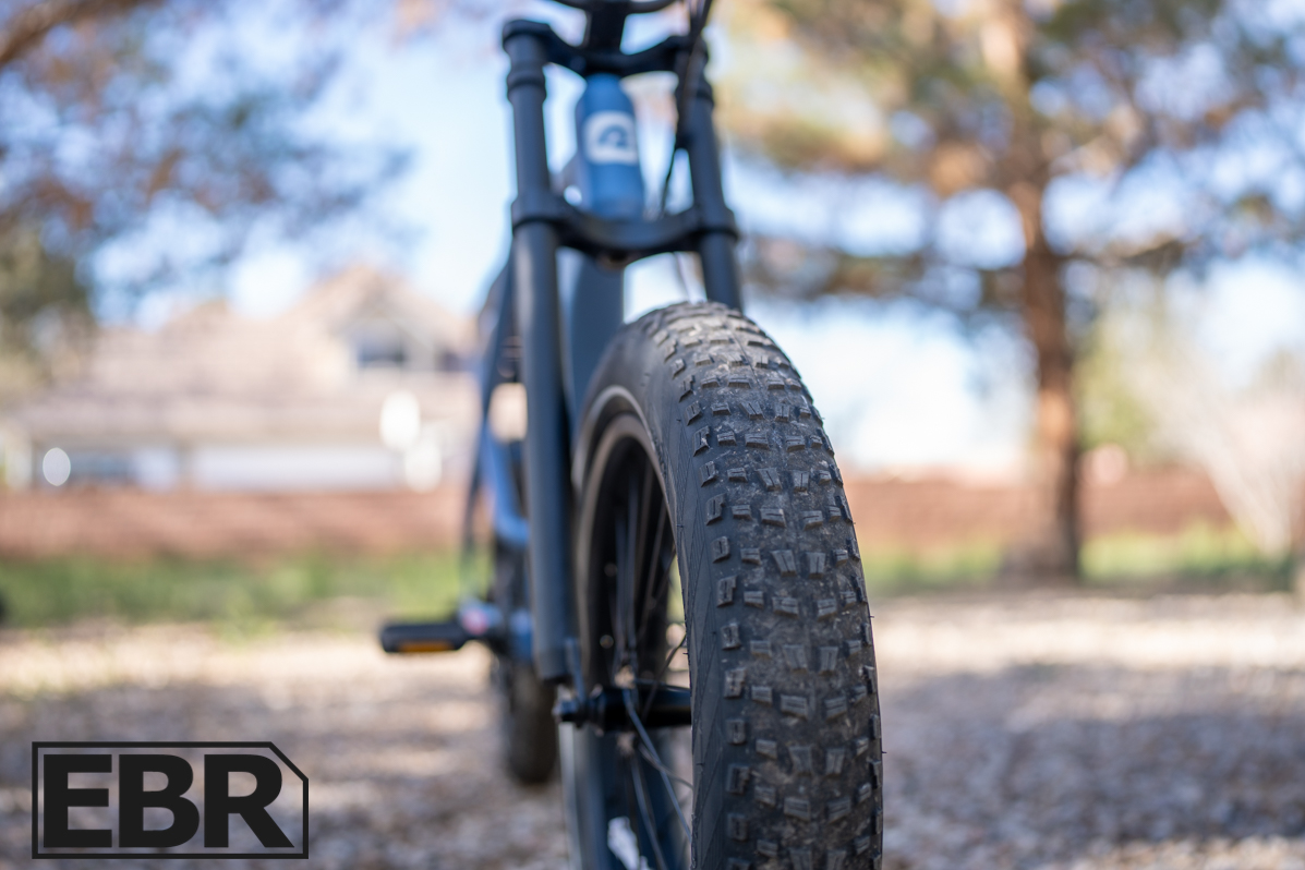

The 20×4″ fat tires run a mild all-terrain tread pattern with puncture protection built in and reflective sidewalls that catch headlights from the side in low-light conditions. With a recommended PSI range of 5–30, you’ve got real room to air down on looser surfaces and let those 4″ tires absorb bumps that a narrower tire would just kick straight into your hands. It’s a simple trick that adds a surprising amount of versatility to what is otherwise a pretty pavement-focused bike.

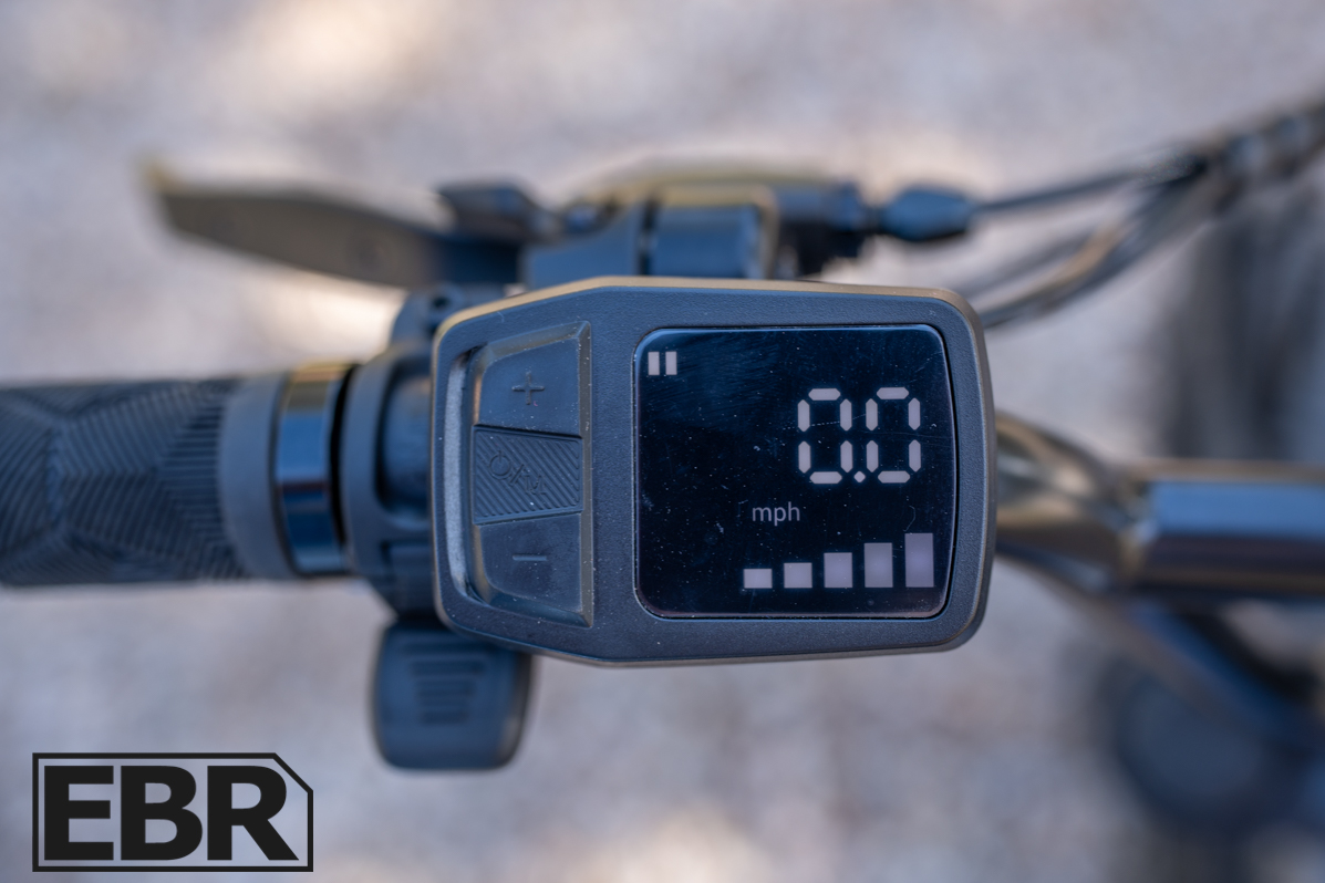

The display on the Valen Rev 3 sticks with the same keep-it-simple philosophy as the rest of the bike, and it works. A 2″ black and white LCD screen sits on the left side of the cockpit where it’s easy to see in any lighting condition, with enough contrast to read at a glance without squinting.
Three buttons handle everything: up, down, and power. That’s it. You get the information you actually need, current speed, odometer, trip meter, battery level, pedal assist level, and even ambient temperature, without any clutter around it.
There’s no app and no Bluetooth, which honestly fits. For a bike built around hopping on and riding, a clean simple display that just works is the right call.
