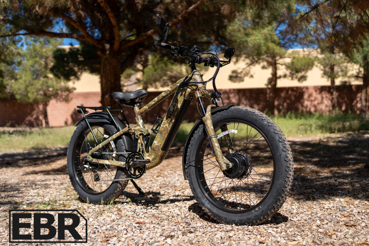

The look of the GoldenR is on par with most fat bikes these days, a flat bar up front, 4 inch fat tires, thick tubing for the frame and integrated battery. Color-wise, the model we were sent for testing is the camouflage, which will likely appeal to hunters and outdoorsy types. But, for those who don’t like camo, they have gray, blue and gray, orange and a red/black option, so there should be something for everyone.
The riding position is slightly more aggressive than expected and that means you are bending forward at the hips and leaning into the flat handlebar up front. Keep that in mind if you think you need an upright and relaxed riding bike. While the Golder R isn’t aggressively slammed forward, it is a touch more sporty than expected, especially paired to that overall look of the dual hub motors.

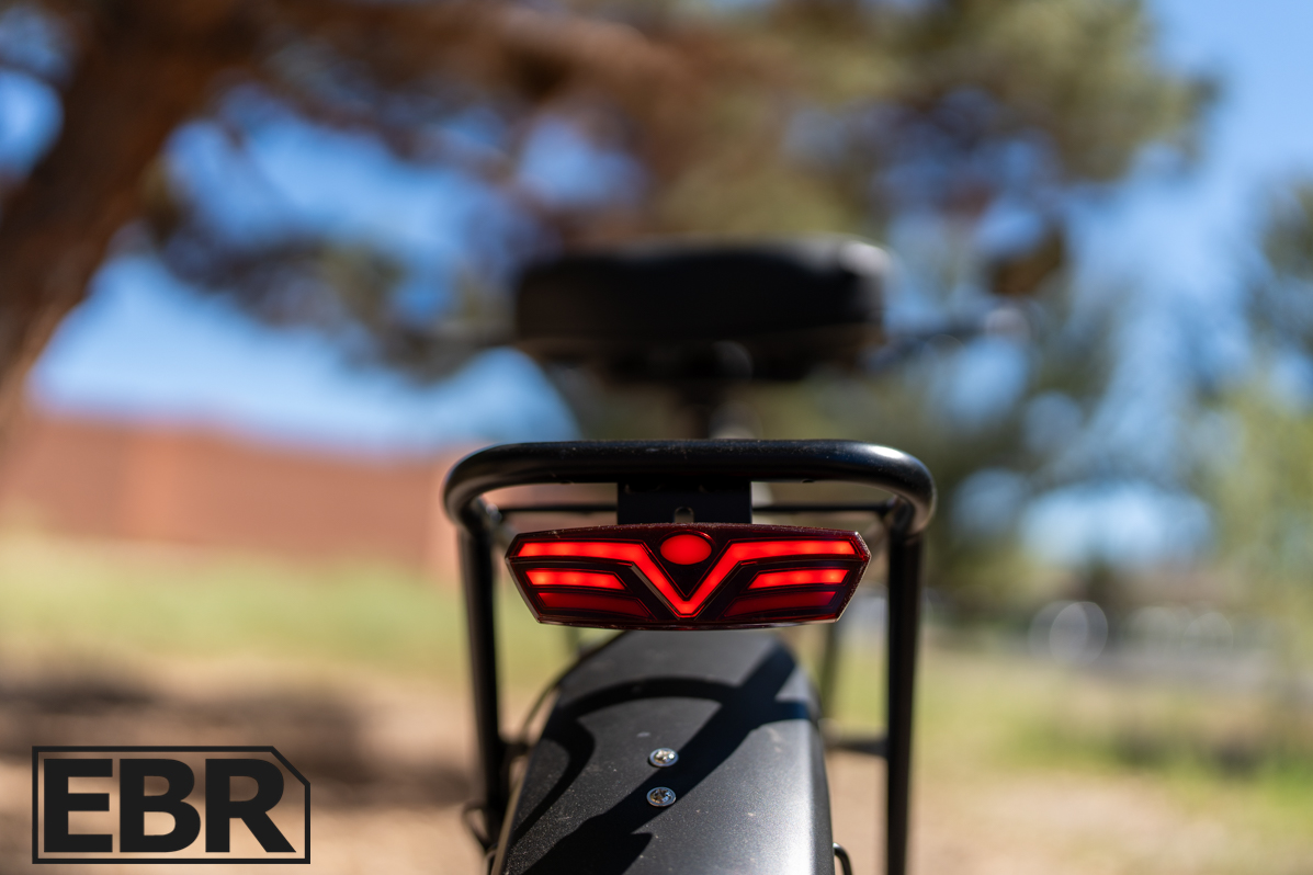

I like having all the commuter perks like the rear rack and front to back led lighting with turn signals, but, one gripe I found very quickly was the mounting hardware positions of the rear fender. The mounting keeps the rear fender in place, but the lack of a mounting point at the highest point of the rounded fender means it just slaps over and over even on city streets with even small bumps, very annoying and it lead me to start looking for ways to silence it and I found myself not wanting to drill a hole in the rear rack for a small nut and bolt, so removing it made the most sense….just not on rainy or muddy rides.

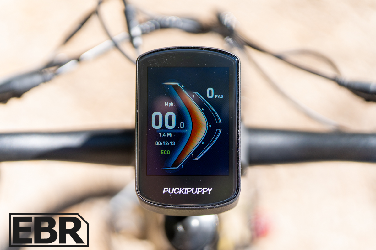

The detachable face display unit is 2.8” and looks great in all sunlight positions I had it in. I like the ability to remove the faceplate and toss it in my work bag or pocket should I run inside a coffee shop or gas station and not want to give a would-be thief a powered ride. At least with the faceplate removed they are left with only being able to pedal the GOldenR Pro with no assistance and that’s no easy task.

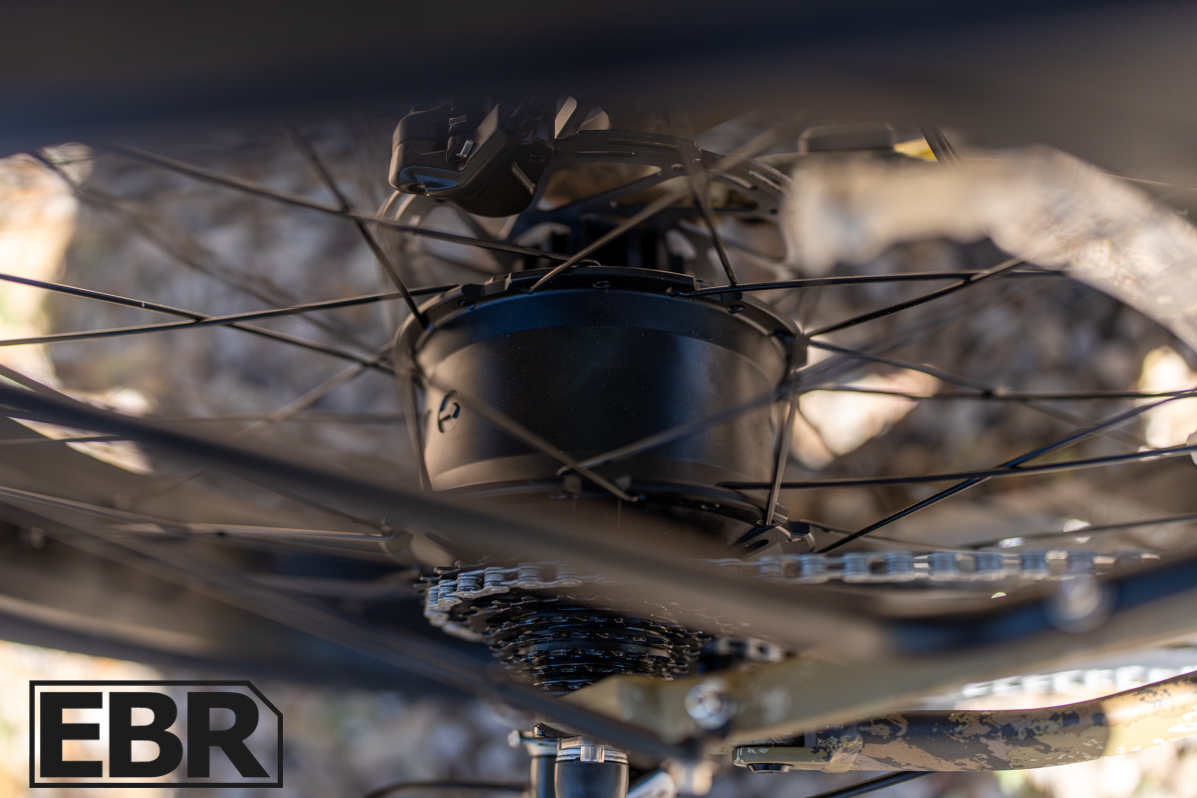

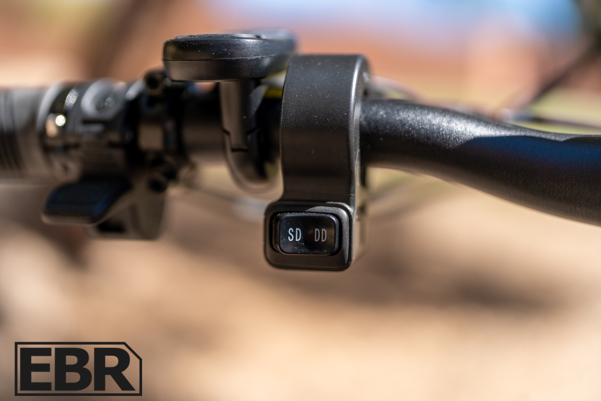

Flip the switch to single motor mode and you’re running on the 750W rear hub alone, which is still plenty capable on flatter ground and a smart way to stretch your range on less demanding rides. Dual motor is where the fun lives though, and the way the two work together for traction across loose or uneven surfaces is genuinely one of the stronger arguments for the dual-hub setup over a single powerful motor.

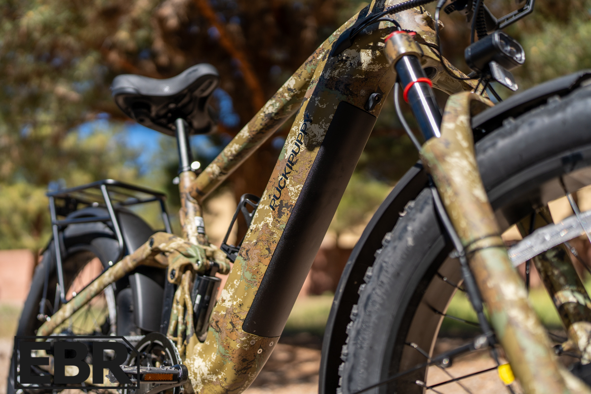

Fueling all of that is a 48V, 20Ah battery, 960Wh in total, that carries a UL 2271 certification by SGS, which matters more than most people realize when you’re talking about a battery this size living under you on a trail. It’s a substantial pack, and as we covered in the range section, it holds up well against the dual-motor draw better than you might expect going in.
A couple of details worth highlighting here. First, the battery ships with a keyed lock, so whether it’s on the bike or off for storage or charging, it’s not going anywhere without you. Small thing, appreciated thing.

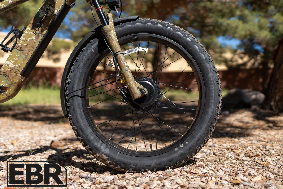

Up front is an unbranded 130mm coil fork with preload adjustment and a lockout feature, sitting on 32mm stanchions with a bolted axle. It does its job well enough, soaking up light to medium chatter without complaint. That said, at 95 lbs of bike with a 400 lb payload rating, I’d feel more confident with 34–36mm stanchions. The 32mm tubes are on the thinner side for an off-road rig of this weight and intended use, and while they held up fine in our testing, it’s an area where a heavier rider pushing the bike harder off-road might start to feel the limitation.

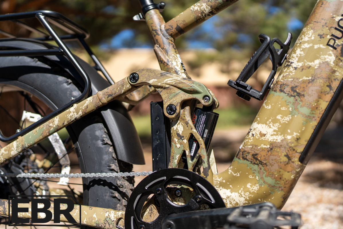

Out back, the rear shock carries PuckiPuppy’s own branding and a plastic housing that doesn’t exactly inspire confidence on first look. But here’s the thing, it actually performs. We’ve tested bikes with unbranded rear shocks that were effectively decorative, doing little more than compressing once and calling it a day. This one genuinely absorbs bumps, feels reasonably plush despite the lack of adjustability, and paired with the fat tires and cushioned saddle, keeps the ride comfortable across rougher ground. It’s not a high-end unit by any stretch, but it punches above its appearance and that counts for something.

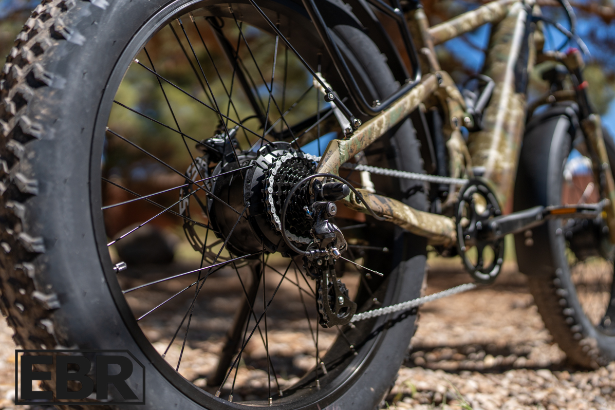

The drivetrain on the GoldenR Pro is a Shimano Altus 8-Speed mated to a 13-32T cassette with a 46T chain ring. PuckiPuppy is also tossed in a zinc-coated chain which tends to fare better over time with less rusting and issues, which was a pleasant surprise.
Up top, the shifters are Shimano Altus 8-speed trigger shifters. I like the under the bar shifters rather than the more entry level over-the-bar index shifters, these are easy to use and with the window on the shifter, you can see your gearing at a quick glance rather than looking behind you at a rear cassette and trying to count on the go.
The wheels are a 26” alloy wheel wrapped in 26”x4.0” All-Terrain tires that lend to the GoldenR Pro’s ‘do-it-all’ attitude and hold an air pressure of 5 to 30PSI. Because most fat tire e-bikes don’t have a full-suspension setup, I tend to air down more to let the tires do a little bit of the suspension work. But, being that the GoldenR Pro has a rear shock, I let the tires run closer to 25-30PSI to improve efficiency.
Bringing those fat tires to a halt is a pair of Logan branded hydraulic disc brakes with 2-piston calipers and 180mm rotors on both front and rear wheels. These brakes do a sufficient job of allowing the bike to slow down and stop safely, it just takes a bit more distance to bring it to a full-stop due to the sheer 94 lbs rolling mass of the GoldenR Pro. Personally, I’d like to see 4-piston calipers as they have a lot more stopping power, and on a bike of this weight, it feels like the right call.

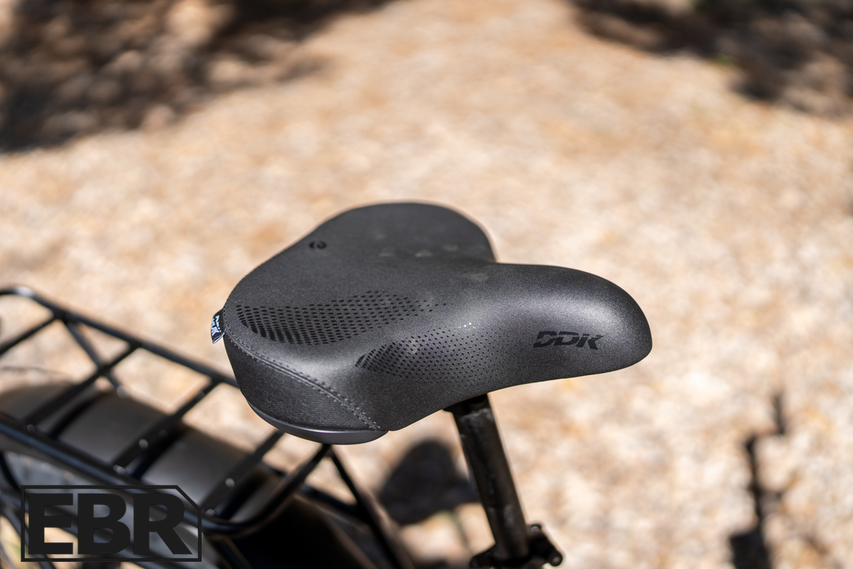

The saddle is DDK branded and has a wide platform with deep cushioning. Pair that saddle up with the GoldenR Pro’s full-suspension and you have a genuinely comfy ride that tackles rough roads without passing that roughness to your lower back as you ride. The handlebar is an aluminum alloy, 28.5”, mostly-flat bar, that does have a slight 15mm rise to it for some extra comfort.

Up front, an adjustable-angle LED headlight does double duty, bright enough to actually see the trail ahead and visible enough to be seen by traffic, which isn’t always a given at this price point. Out back, a rack-mounted tail light functions as a brake indicator and includes integrated turn signals, a nice touch for anyone mixing trail rides with road miles.
The metal fenders are a welcome inclusion and save you from having to source them separately, but the rear fender has one nagging issue worth flagging. There’s no mounting point at the apex of the fender, which means it has nothing anchoring it at its highest point and it slaps around against the rear rack even on mild pavement. A single bolt at that spot would solve it entirely. It’s a minor oversight that creates a disproportionately annoying noise on an otherwise solid ride.

The display on the GoldenR Pro is a 2.8” color display with bright contrasting colors and good visibility. The display faceplate can be removed in a split second for security or storage reasons with a quick push of the retention bracket on the backside.
On the home screen, you have all the basics like speed, battery level, wattage meter, pedal assist level in use, headlight, turn signal and walk mode indicators.
Holding the down button and a single turn signal button for about 2-3 seconds will open the alternate data screen that shows the trip meter as well as trip distance and total mileage.
Holding the left and right turn signals at the same time will open the GoldenR Pro’s ‘Function Settings’ where you can make adjustments to the screen brightness, units of measurement, startup mode (which requires pedaling to start using the motor), reset the trip meter, choose a language and last up, you can conduct a factory reset. Tapping the back button (or left hand turn signal).
