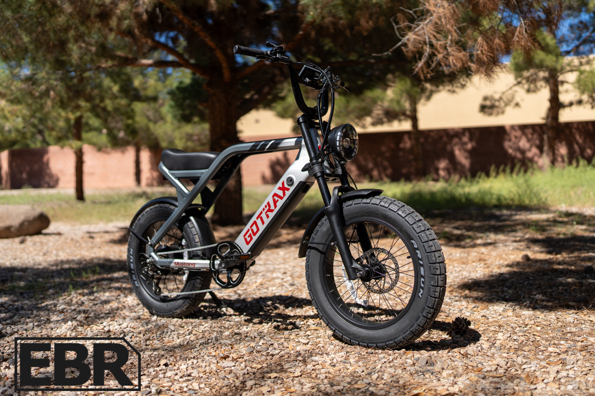

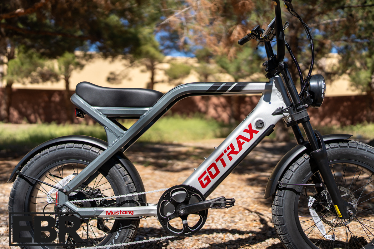

Curb appeal is solid moto styling with a capable look that infers the Mustang is just as ready to rip on city streets as it is on dirt roads. Classic moto look, a fixed position moto-saddle, with a fully integrated battery into the frame’s downtube, and a large empty space in between the frame top tube and bottom bracket where a storage container sits for bring a little bit of gear along for the ride.
The riding position is true to what you would expect from a moto-style e-bike, where you don’t really have a proper pedal extension despite the presence of cranks and pedals, but, with a little bit of sliding backwards on the saddle, you can find a comfy riding position.

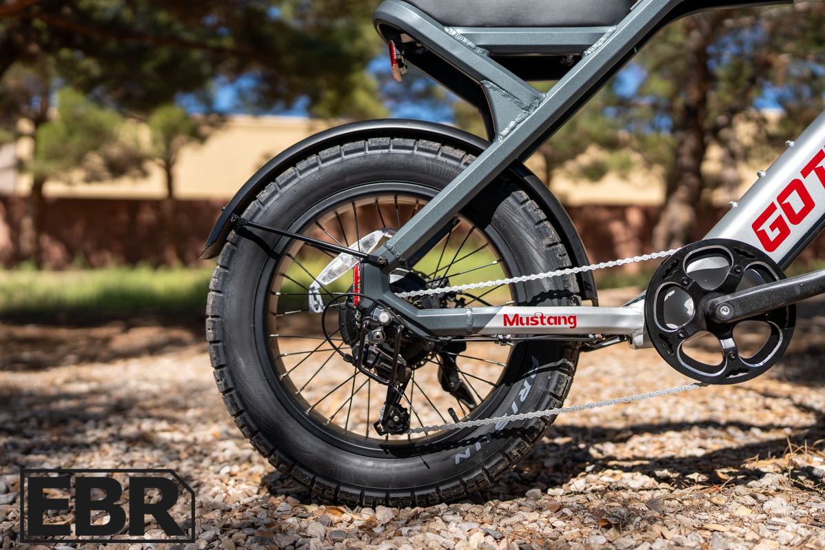

Although, I did have a mystery rattle coming from the rear wheel when I first started testing by default and started blaming the motor, largely because of the sounds coming from that location. But, after further inspection, I found the rear alloy fender had one of its mounting screws just slightly not tight enough giving a small ‘wiggle’ room for the fender and at speed or during hard acceleration would get the right harmonics to produce an annoying rattle.
Finally, after dropping the rear wheel and tightening the mounting screw located at the underside of the highest point in the fender, the noise went away. While it was a straightforward fix, It’s really on me for failing to check every nut and bolt on the bike like the user manual advises, so, lesson learned on my part.

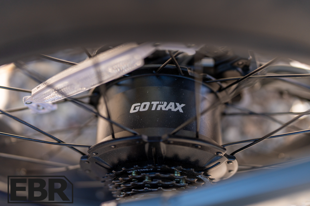

The Mustang is powered by a rear hub drive motor rated at 750W with 90Nm of torque. GoTrax doesn’t disclose the peak wattage, but during rides the display’s power graph showed peaks of up to 990W.
The motor is paired with a torque sensor, giving riders the ability to feather power delivery based on pedaling effort. During testing, soft pedaling at PAS 2 would maintain a cruising speed of around 15 mph while the display showed only 60-150W of consumption. That efficiency is likely the key to the Mustang’s range potential, as a cadence sensor would push watts to the max with every pedal rotation regardless of effort.

The battery is fully frame-integrated, 48V, and comes with a keyed lock for security. It’s removable for off-bike storage or charging and weighs around 9 lbs. The cell specs come in at 15Ah and 720Wh, with LG cells inside.

The frame is a moto-styled aluminum alloy build with a large center storage area, though as noted earlier, it’s unclear whether the storage bin is included or optional.

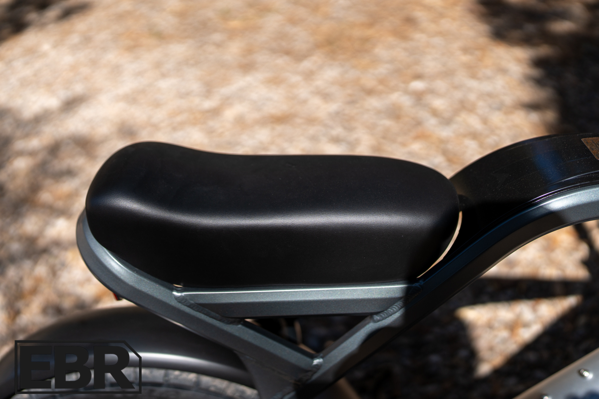

The saddle is a fixed-position moto-style unit with deep padding that makes for a comfortable ride. Alloy platform pedals with traction studs and reflectors round out the contact points.

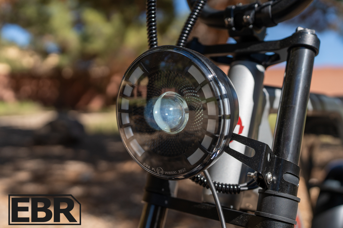

Up front is a large moto-style headlight that adds to the overall aesthetic. GoTrax doesn’t disclose a brightness rating, but it’s genuinely bright and visible even in daylight.

The wheels are 20″ alloy rims wrapped in Arisun 20×4″ fat tires with a mild all-terrain tread pattern suited to most riding conditions. Stopping power comes from Tektro hydraulic disc brakes with 2-piston calipers and 180mm rotors front and rear. The brakes include motor cutoff sensors that kill power the moment a lever is pulled, a useful safety feature in emergency stops.
Finishing it off is the drivetrain, a Shimano 7-speed setup with a 14-28T rear cassette, Shimano Tourney rear derailleur, and a 48T chainring with a dual-sided guard. Cranks are 170mm alloy.

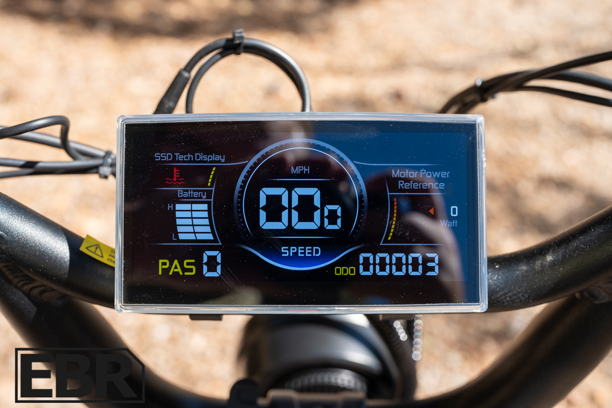

The Mustang features one of the better displays I’ve come across, with a large 5″ screen that’s bright and high contrast in any lighting condition, including direct overhead sunlight.
The home screen covers the usual metrics: speed, PAS level, battery charge, and odometer. It also shows a live power meter displaying real-time wattage consumption and a temperature gauge, both useful for keeping tabs on how hard you’re pushing the system.
Tapping the power button, without holding it, cycles to additional data including trip distance and trip time.
The advanced settings menu has five options: display brightness, units of measurement, trip reset, wheel diameter, and speed limit. All worked as expected with the exception of the speed limit setting, as covered earlier in the review.

The Mustang comes in one size: an 18″ aluminum alloy frame with a large integrated storage area. GoTrax advertises a fit range of 5′ 4″ to 6′ 2″. At just under 6 feet, the fit felt good overall, though I found myself wanting a slightly longer saddle to slide back for better leg extension and arm reach. Riders under 6 feet likely won’t notice that.
There is one color offered, the silver and black colorway you see pictured in this review.
