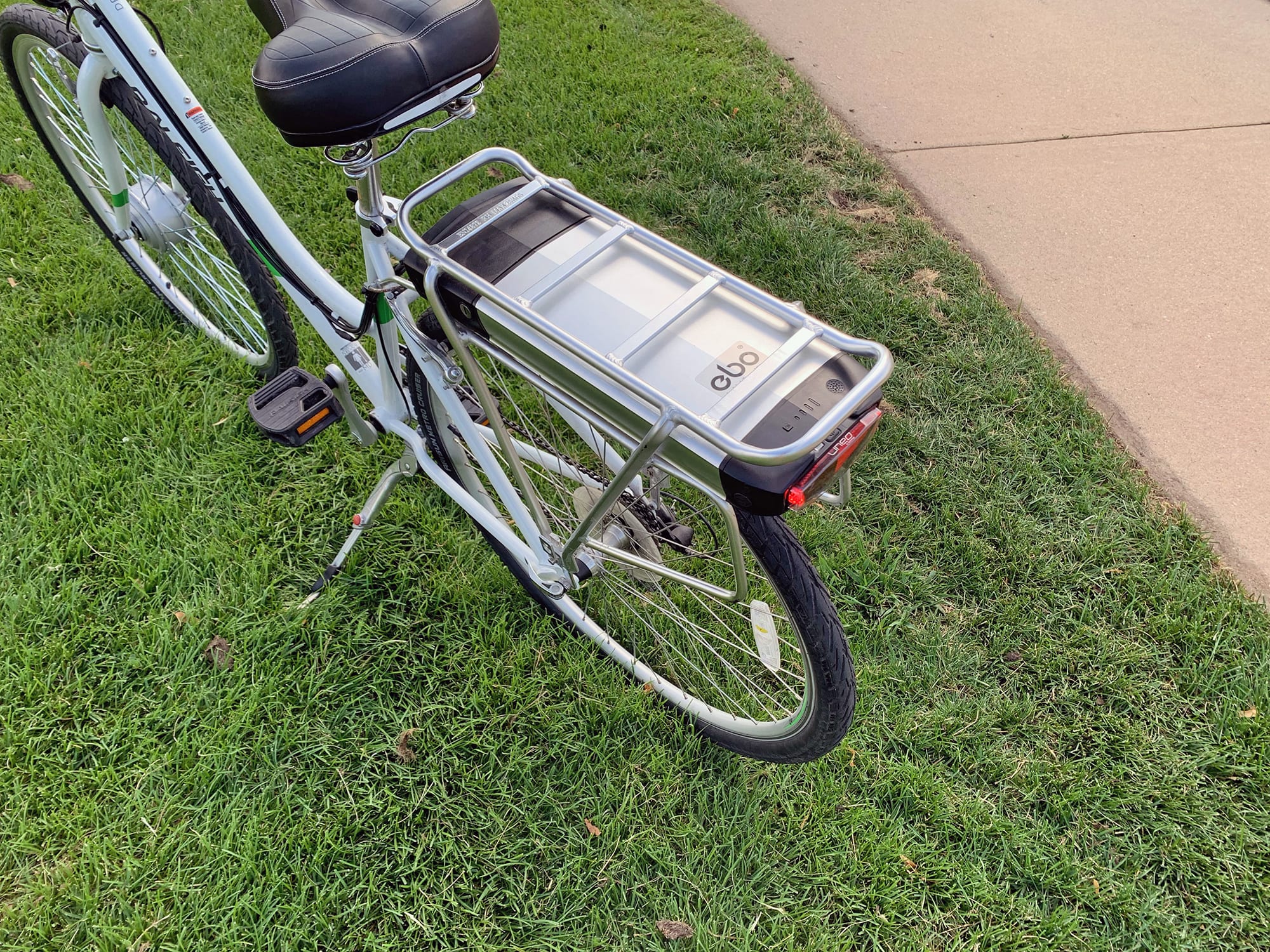

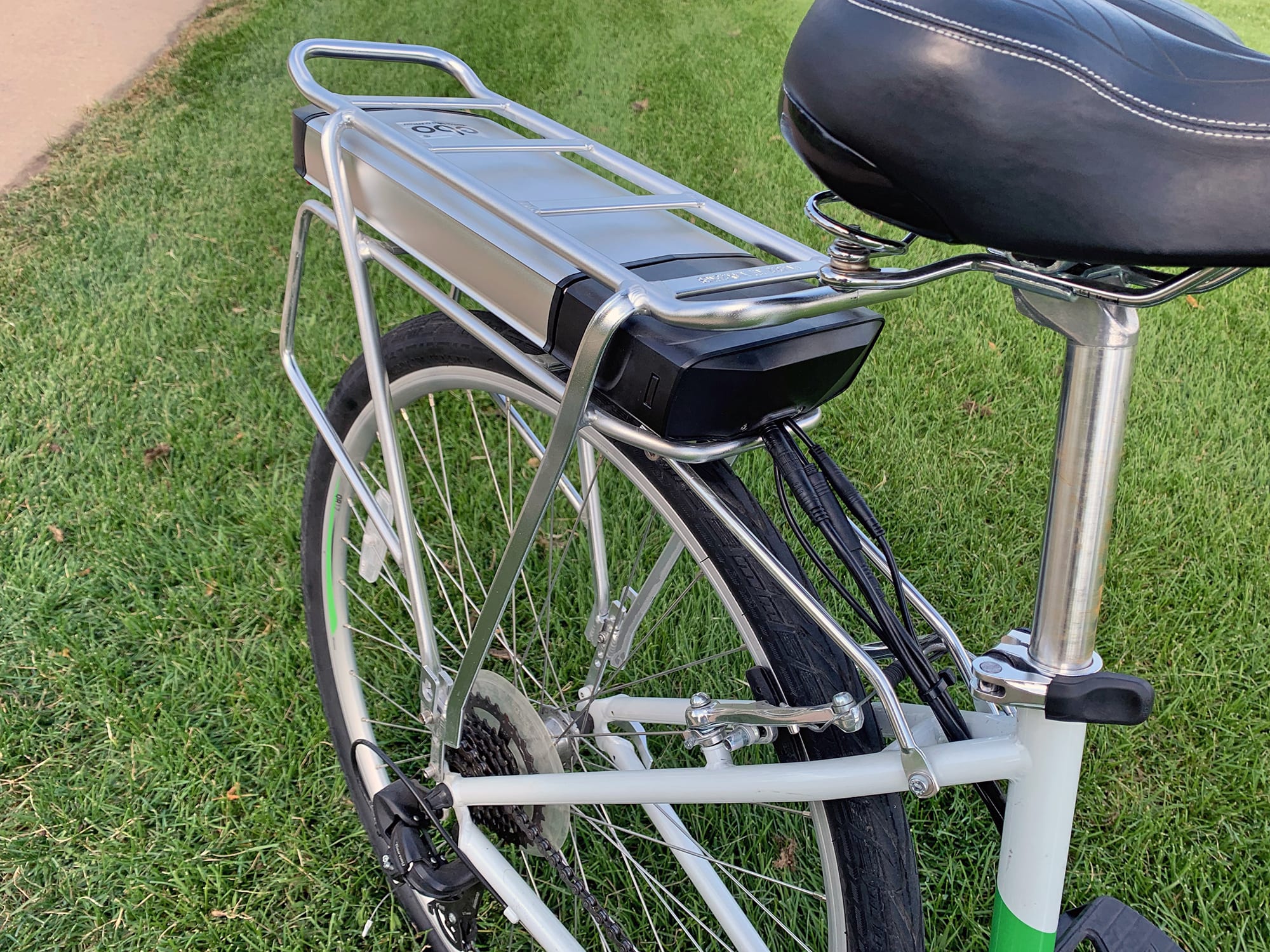

- The rear rack her is rated for 25kg, so about 55lbs, it also has a bungie loops as well as pannier blockers, another cool thing about the cruiser version is that the controller is integrated into the rack, this keeps it protected and you don’t really have to find a clever way to mount it like you would on the Burley version

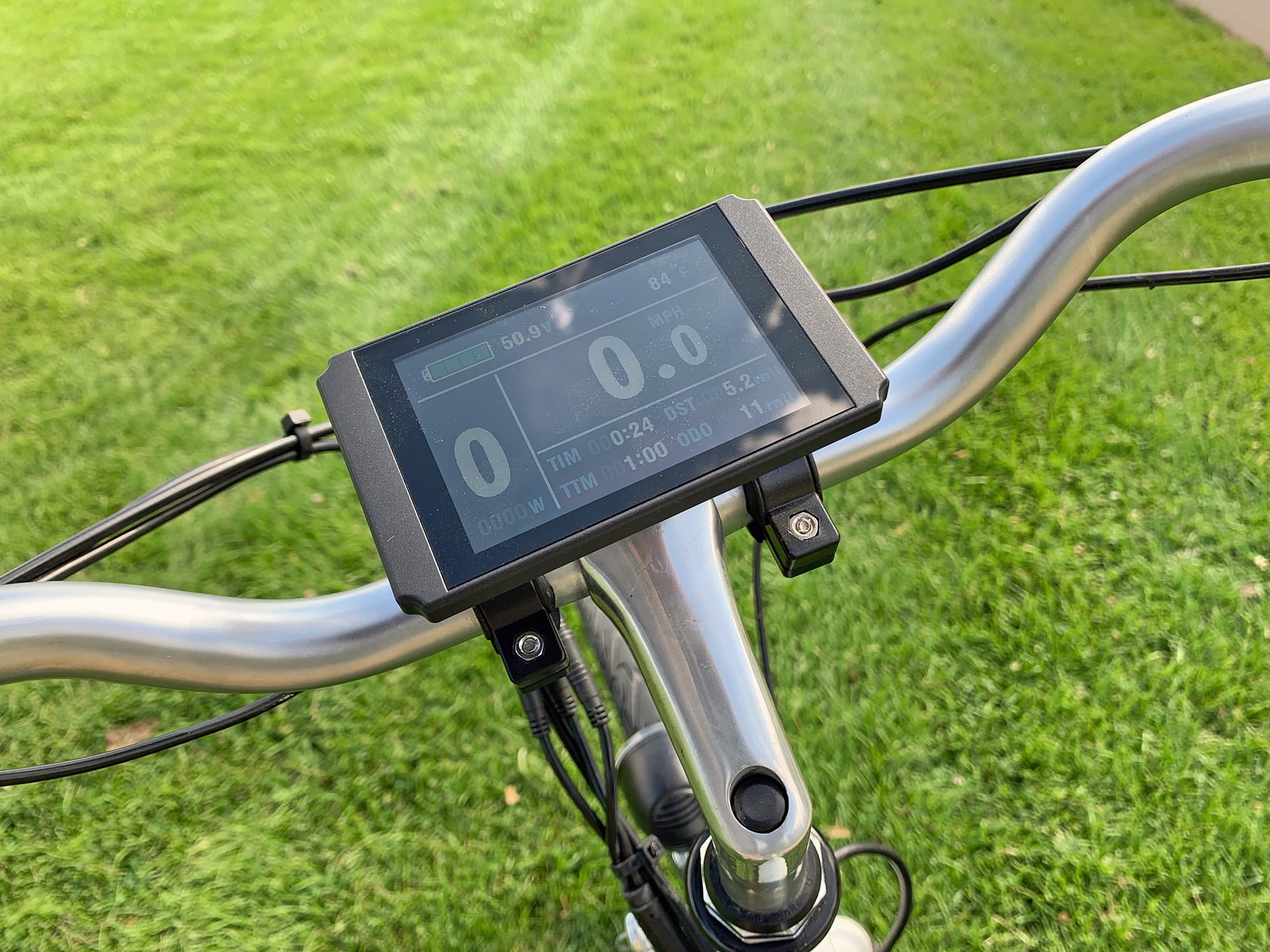

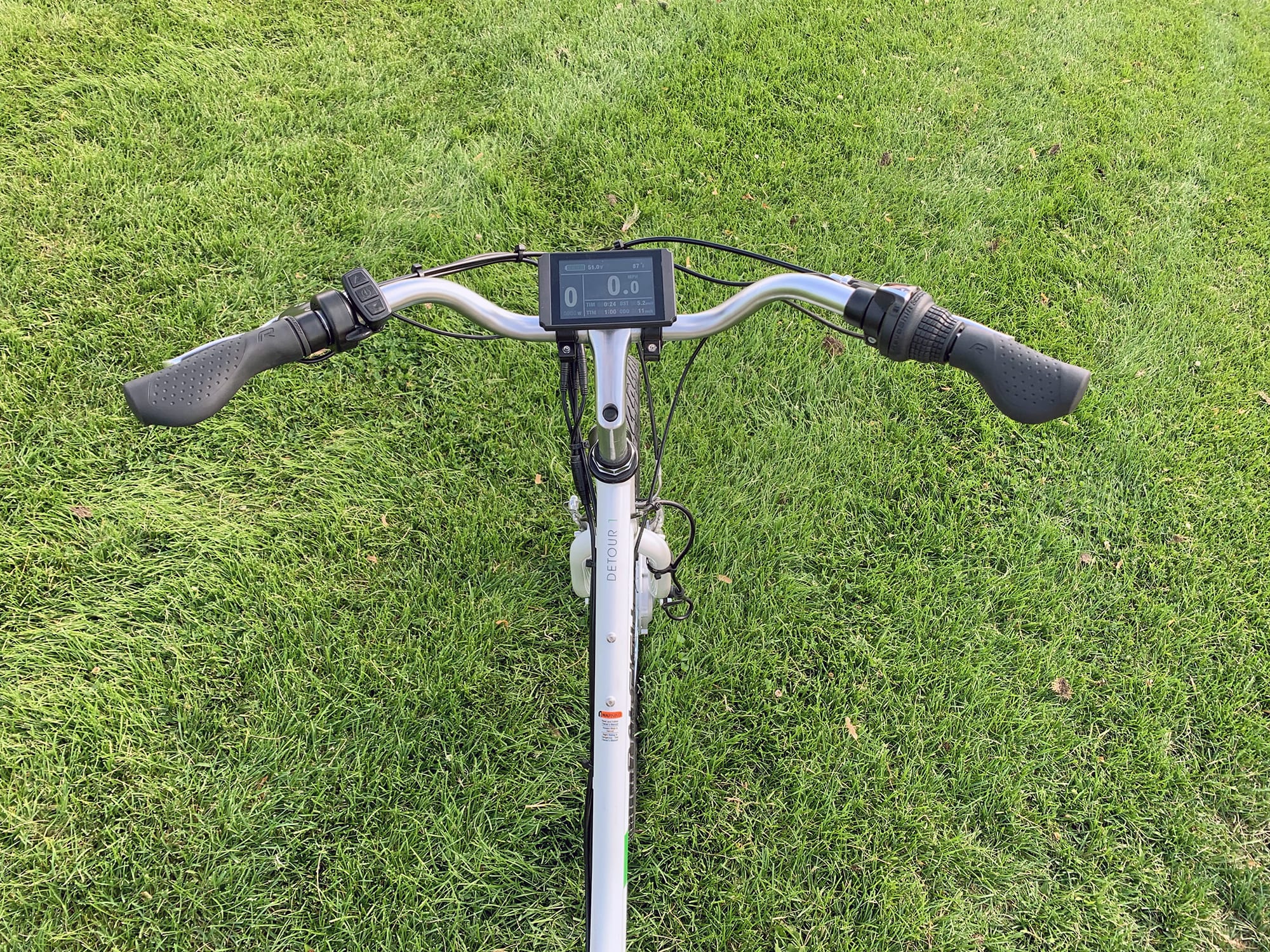

- The display options get an upgrade for 2019/2020, you can now chose between grayscale, or a color display option for both landscape or portrait configurations, it is little details like this that make the kit so versatile and considerate of the many options customers my want or need

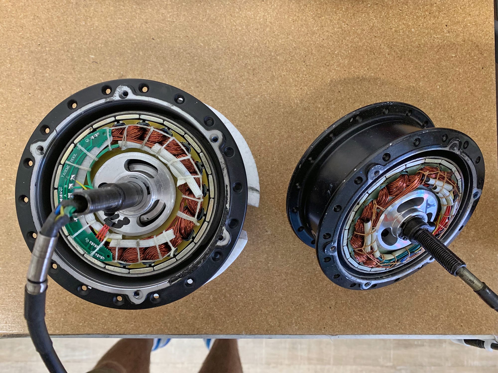

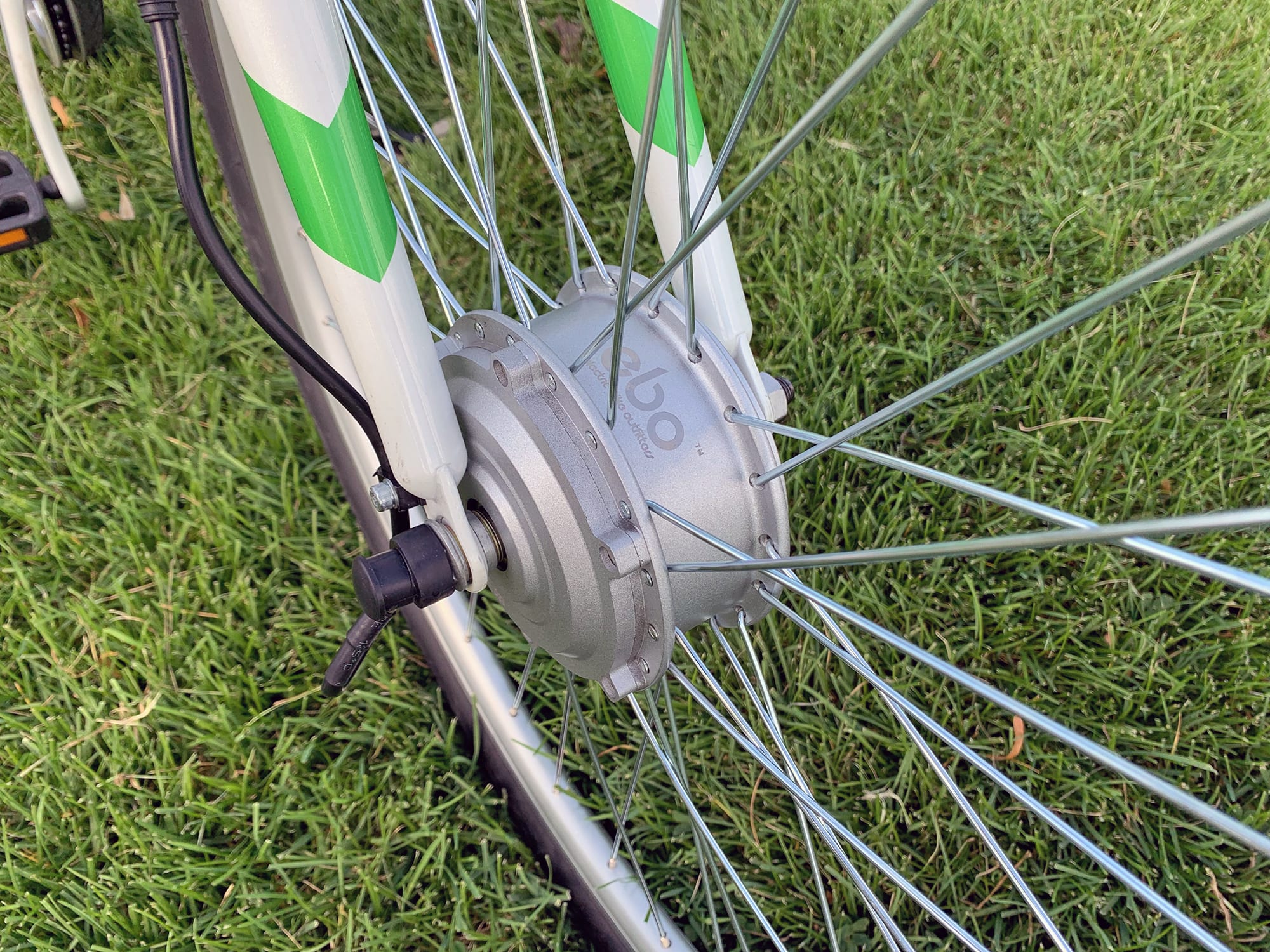

- The motors have been upgraded, one of my past gripes was that the motor seemed to take a moment to catch on, they went from three hall sensors now to four, this means a more consistent speed reading and makes for a much better feeling system
- The battery gets a boost too, it was once a 48v 11.6ah, now it is using a 48v 12.8ah system, so it is over 600 watt hours, this means you get the same powerful system, but now with more range than before, they are also using LG cells, so you know it is a high quality battery
- I love that the battery is surrounded by this metal casing, it is also secured via lock and key, so there is a lot of piece of mind here, the battery slides in and out along this tray and has an on/off switch for safety

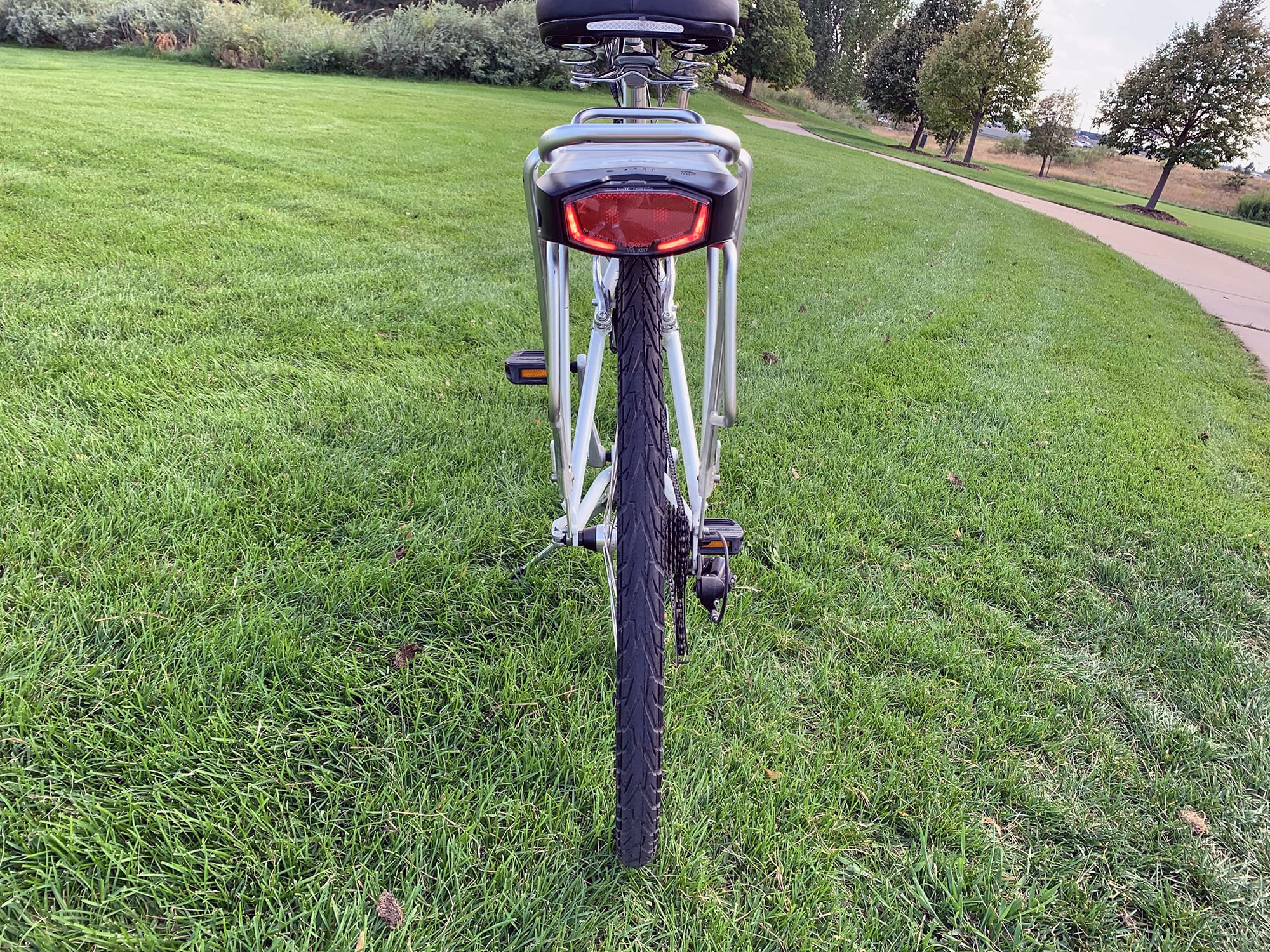

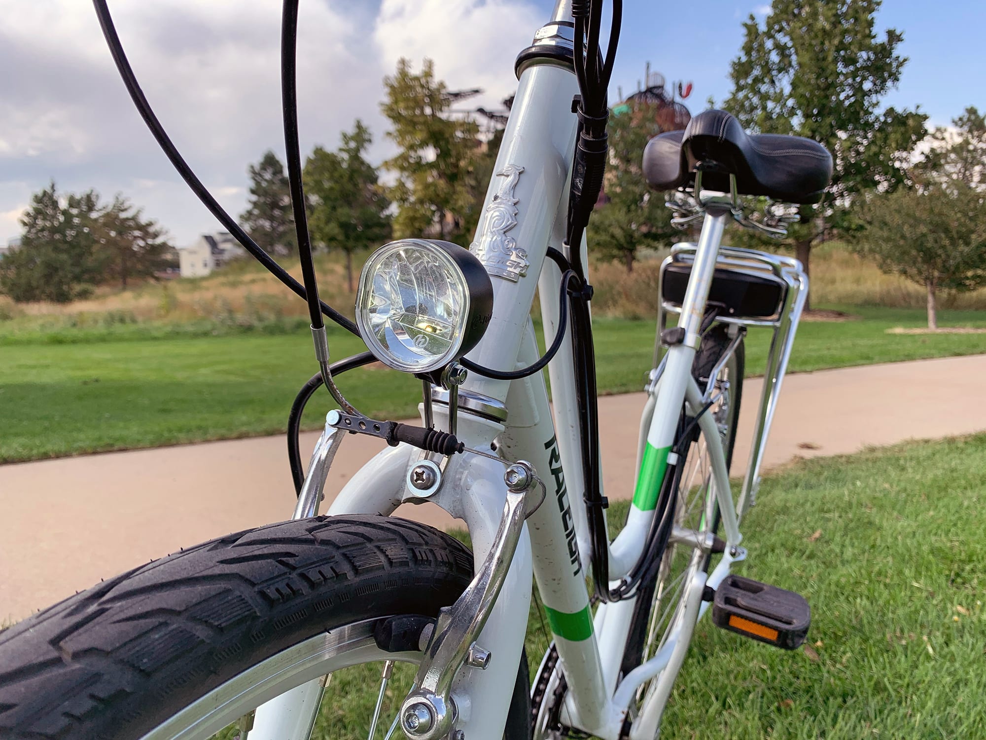

- Electric Bike Outfitters also has battery integrated headlight option, I find the headlight to be really bright here, safety has always been a priority for myself and other cyclists, so it’s nice to see that more and more companies are including these on ebikes

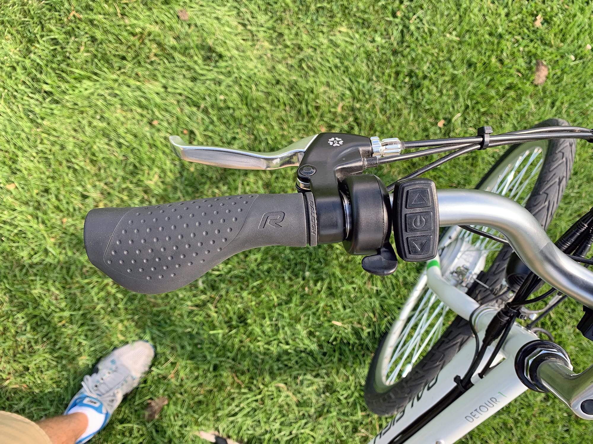

- Safety is a big focus for me, so I appreciate the more sensitive cadence sensor, adjustable top speed settings, different throttle options (trigger, half-twist, and full-twist) as well as the brake lever motor inhibitors
- If your bike uses hydraulic brakes, EBO does have an optional sensor and magnet unit that can be screwed and glued on to enable motor inhibiting, but it’s not as elegant or simple as the included stock mechanical brake levers, but it’s a nice option to have

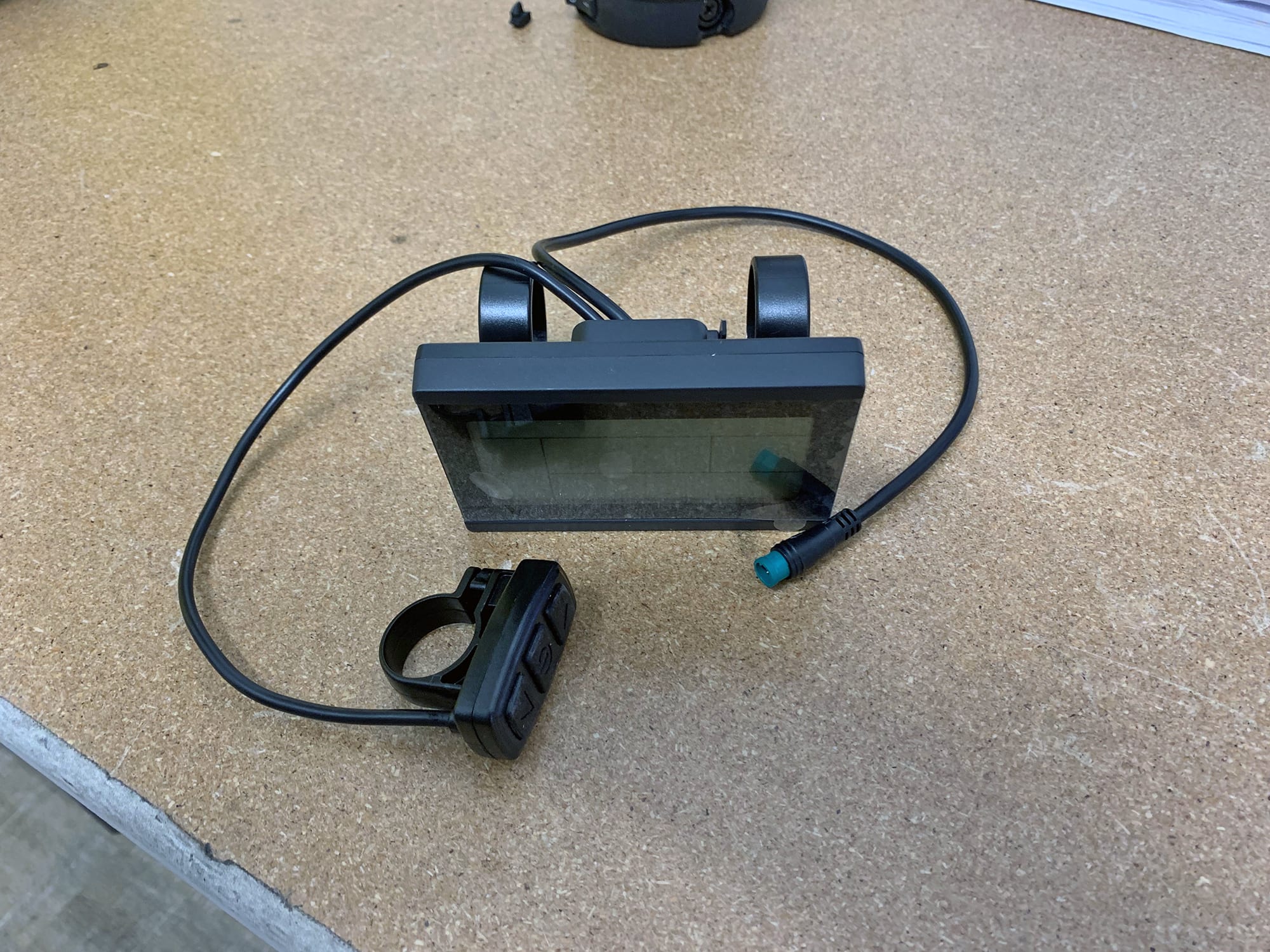

- The original display panel is large, easy to read, full of interesting settings to experiment with (and EBO has a nice manual to help you do so on their website), and it has an integrated USB charging port, though the display cannot be easily removed for protection at bike racks or wet days

- The motor is rated for 350 watts nominal and 816 watts peak, so you can really use it in a wide variety of ways, it feels really zippy when I tested it and I like that you can essentially build a Class 1, Class 2, Class 3, or even something beyond that depending on where you plan to ride it
- The hub motor can be setup in a front or rear wheel configuration, and EBO offers single speed, 6 to 9 speed, and Shimano and Sun Race cassette options

- You can activate walk mode to help move the bike by holding the down arrow if it is standing still, if you enter into the menu settings you can activate cruise control and then when riding over 6 mph, hold the down arrow for a few seconds to set cruise speed, in the settings you can also enable throttle mode at assist level zero if you want… or even remove the throttle and only use pedal assist only as a Class 3 ebike going up to 28 mph, there are just so many options

- The actual motor casing has been custom designed by Jason, the founder of EBO, and he made it fit on a wider number of narrower forks like a Giant road bike for example, it works with linear pull brakes or disc brakes (you can mount dis brake rotors directly to the side of the hub casing)
- Hub motor ebikes can often have more pedal gears to work with than mid-motors (because they can easily support multiple front chainrings), and shifting gears causes less wear because the motor power is separate from the pedaling drivetrain

- The Cruiser version of this kit does weigh a bit more than the Burley, which is the mid battery mounted version, keep in mind where you want the weight on your bike before proceeding as the weight distribution can affect the overall feel of the ride
- The battery charger is a bit basic, only offering a standard 2amp power output, it could take a long time to charge the battery from dead to full, especially given the newer high amp hour rating, and it’s not super compact or lightweight… still, it should fit into your backpack or other bags easily for charging on the go
- Rear-rack mounted batteries position weight high and towards the back of the bike vs. low and center, which changes handling and can make lifting the bike more difficult, consider removing the battery before lifting and transporting the bike, having the setup can also add frame flex, especially if you have a step-through style frame or something similar

- The rear rack battery has an integrated light, but it isn’t controlled by the LCD computer, you have to physically turn it on and off each time you ride, there also is not a USB port on the battery… just the display

- The throttle is hot when the bike is turned on, I do like this for throttle override when you need to get out of the way of something quickly, but do be aware for new riders or people trying out the bike that a bump of the throttle could send it off
- This isn’t a big complaint, but the USB charging port on the battery pack has been disabled (to reduce phantom power draw over long periods of disuse), there’s a second USB port on the lower right side of the LCD display panel, but sometimes it’s nice to use the battery itself as a backup power source off the bike
- Most hub motors have the power cable entering into the axle from one side, and this can be a point of vulnerability if the bike tips or you ride close to obstacles that could snag or scrape it, a few of the new Dapu motors have their power cables tucked very closely (behind the disc brake rotor) but I don’t think that you can order them aftermarket as kits
