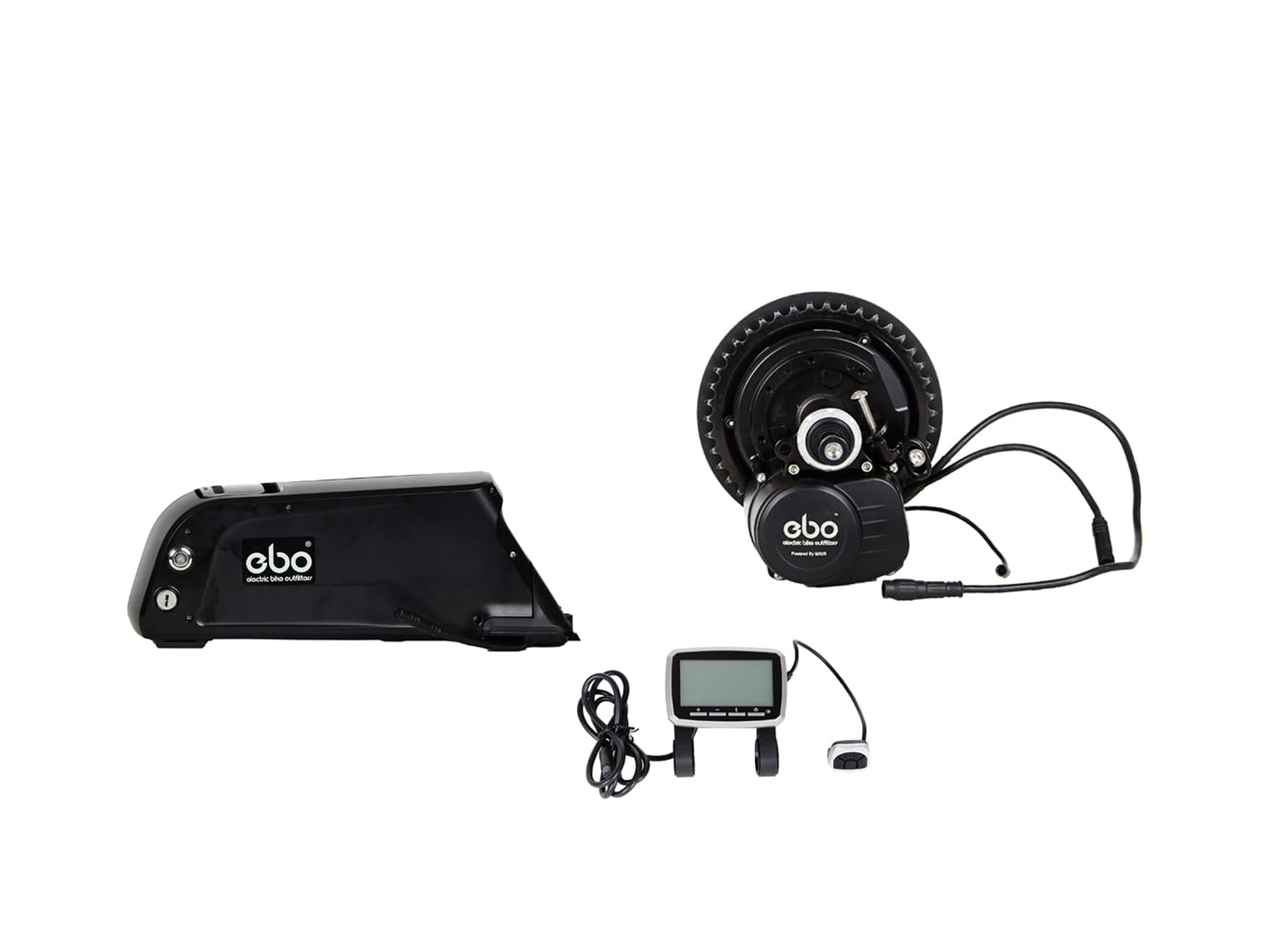

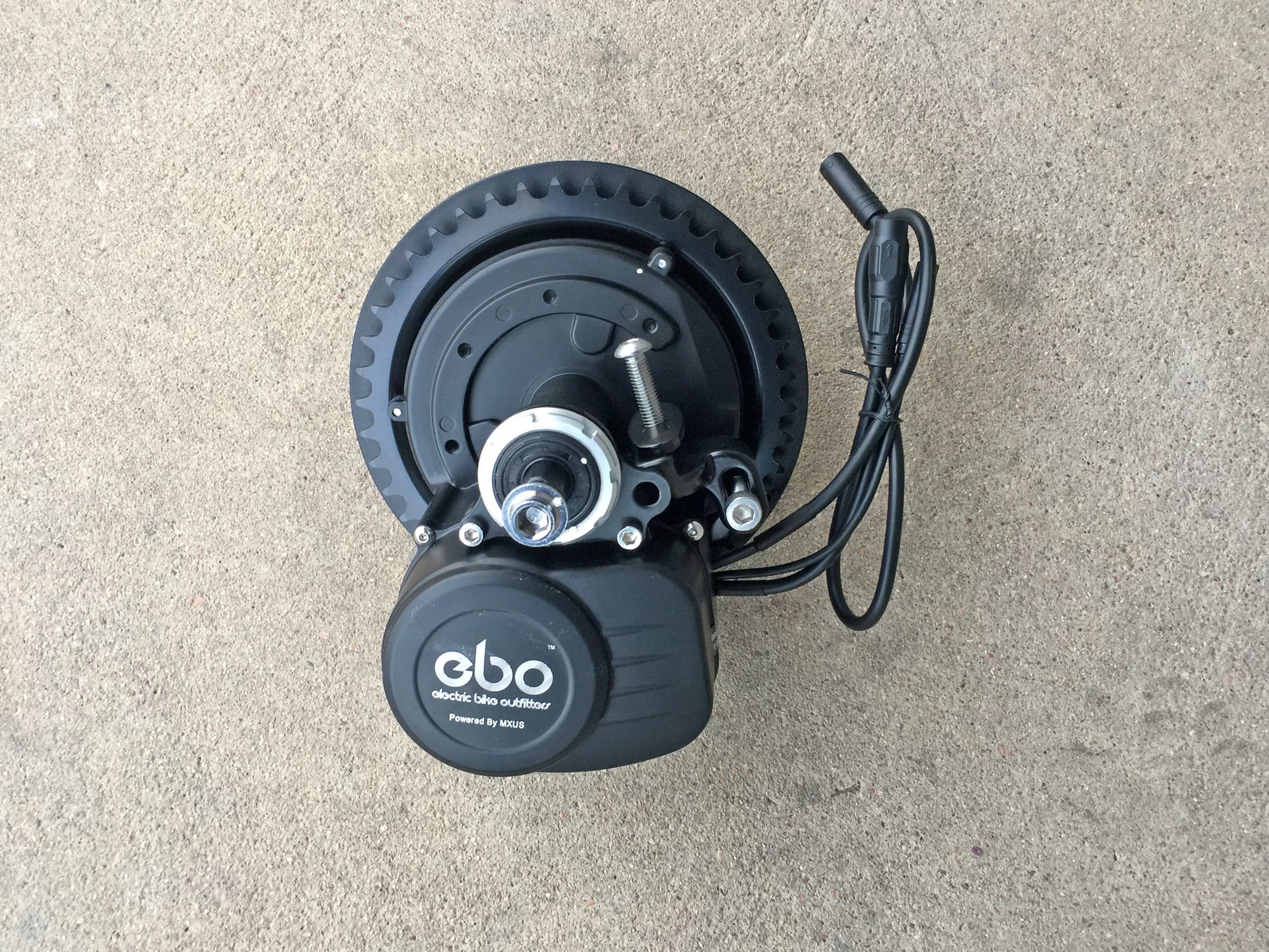

I was a little underwhelmed by the power and torque on offer from the Mountaineer at first, because the stats say 350 to 700 watts and up to 80 Newton meters of torque. That’s significantly higher than most of the mainstream electric bike mid-drives that I have reviewed for Bosch, Brose, Yamaha, Shimano, and Bafang. It performed a lot like the lightweight Shimano E6000 mid-motor, which is commonly found on neighborhood and city bikes. Without the anchoring point of high advertised values, I would have approached and received this kit much differently. In practice, it’s an efficient aftermarket mid-drive that performs best when you’re pedaling along actively and has the unique benefit of throttle operation! It uses a torque sensor vs. a more simple on/off type cadence sensor found on some of the older and less sophisticated Bafang BBS01 and BBS02 kits, and that makes it feel smooth and responsive. But for me, it didn’t feel as dynamic or capable as Bosch or Brose, even in the highest level of assist, you cannot really tap into the torque… and it feels pretty weak when starting in a higher gear, as mentioned earlier. One of the other stats that threw me off here was the high RPM cadence matching that Jason (the founder of Electric Bike Outfitters) told me about. It seems like every mid-motor has a pedal speed where it just sort of fades out. The faster you pedal, the less support you might receive from the motor, usually around 100 or 120 RPM. What this means is, you’ll have to switch to a higher gear and pedal slower if you want the motor to contribute effectively. I was initially told that the MXUSE manufactured EBO Mountaineer could hit 4,000 RPM, but Jason was talking about internal drive speed, not pedal strokes… After I published the video, he clarified that the drive unit is rated at 103 RPM, which fits my experience much better and keeps it in line with the Shimano E6000 mid-drive mentioned earlier. Interestingly, even when I pedaled way over 100 RPM, I could still hear the motor whining and activating, I didn’t feel it slowing me down at all, but I just didn’t feel support at those higher levels. So coming back to use cases here… I’d say this motor would be a great fit for active mountain bikers who want to limit weight and convert an existing bike to be electric, or it would be a great fit for neighborhood riders who prefer a mid-motor to a hub motor. Perhaps you have really beautiful rims or want to preserve quick release? Perhaps you want a mid-motor with a throttle? These are all great uses for this kit.

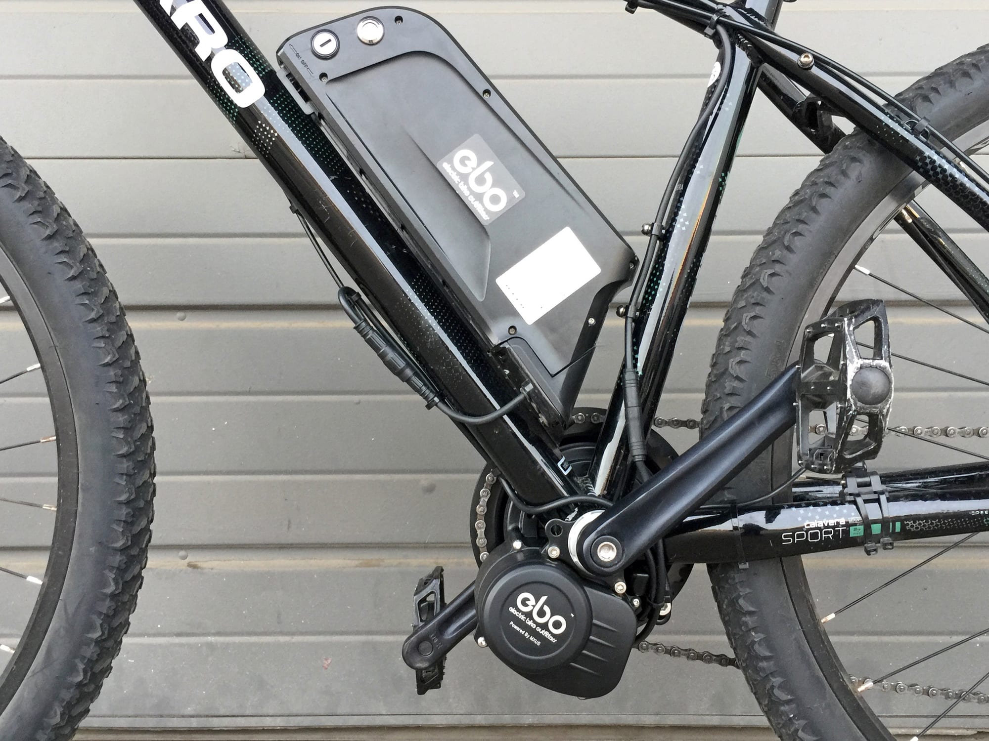

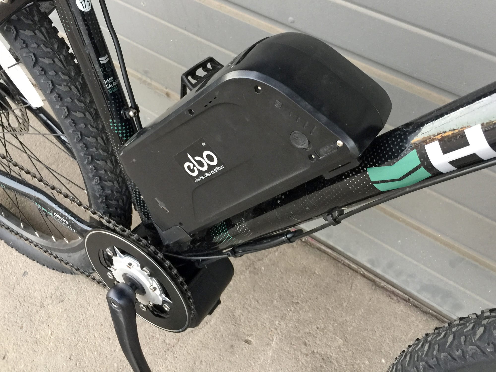

Powering the kit is a 48 volt 11 amp hour battery pack, offering above-average capacity and two mounting configurations. The downtube design is optimal for keeping weight low and centered while reducing frame flex, but it requires a sturdy pair of bottle cage bosses and an open space on your frame that is larger than a standard bottle cage. If you have a step-thru frame, this sort of mounting configuration could expose the battery box to kicks each time you mount and dismount the bike. The ideal configuration would be a diamond high-step frame as shown in the video review. For those with rear rack bosses and space at the rear (meaning that you don’t have oversized fenders or a saddle that is set all the way down and sticking back) the rack battery is a great option. I regularly complain about weight being positioned high up and way towards the back on purpose-built ebikes that use rack mounted batteries, but it’s actually a decent option for doing conversions, because racks attach at four points vs. just two with a mid-battery. The rack battery option frees up your downtube for actual water bottles and gives you the benefit of carrying a trunk bag or panniers in addition to the battery pack! It’s even possible to use this battery design on a hardtail mountain bike, but not advisable. The bolt-on rack looks nice, and comes in two colors (silver or black), but has more potential for shaking around. Regardless of the battery mount you choose, there’s going to be 7+ lbs of weight added to the frame, bolted on using braze-ons (probably) that weren’t designed to hold extreme loads. For this reason, I’d recommend using Loctite Blue super glue and being careful and attentive when riding off-road. Also worth calling out here is the USB charging port built-in to the side of the downtube battery. EBO told me that they de-activated this port purposefully to reduce power draw. It can still be accessed for firmware updates, but the optimal USB charging location is under the display panel… and this location is more accessible too. Whether you charge the battery pack on or off the bike, I suggest storing it in a cool, dry location. Avoid extreme temperatures, try not to drop the pack, and avoid letting the charge drop under 20% because that stresses the Lithium-ion chemistry. Jason recommends recharging every two or three months if you haven’t used the kit, just to avoid hitting those lower fills.
Operating this bike is a two-step process. Both battery packs have hardwired on/off switches built-in (good for keeping them stable during periods of disuse and travel). The downtube pack has a silver circle that you press, and it lights up with blue LED’s, and the rear rack battery has a toggle on/off switch below the light. So, once you’ve charged the battery, clicked the on/off switch, and are ready to ride, you simply press the power button on the display panel itself. This display is large, clear, and highly adjustable. One of my favorite parts about most kits, and certainly the EBO kits, is that they allow you to lower the top speed. This could be useful if you are trying to qualify as Class 1 (pedal assist only, up to 20 mph). The default configuration of the kit is Class 2 (pedal assist and throttle, up to 20 mph), but I think you can actually raise the max speed in the display and go one or two miles per hour beyond 20. There are four levels of assist, Eco, Tour, Speed, and Turbo and I conducted most of the ride testing in Turbo mode to see how zippy the motor would feel, and how much noise it would make. It struggled to climb when I was in higher gears, but did pretty well when I shifted down to the lowest gear. If you’re mounting this kit on a single speed bike, keep in mind that it might start a little slow and struggle with climbing because the torque just isn’t there. Again, looking at this thing side by side with a Bosch, Brose, Yamaha etc. it is physically smaller, but rated at a higher peak torque. My experience was that it’s just not that powerful… but that’s still okay for many situations. Two things I really loved about the display panel were the ability to turn backlighting on and off, and get battery level feedback with six bars vs. just four or five. This makes it more precise and could be the difference between recharging at a half-way point or thinking you have enough juice to get home. Two things I wasn’t so keen on are the fixed nature of the display (you cannot remove it when parking, so it could take more wether exposure or scratches at the rack), and that the battery charger is a bit large and heavy for being a more basic 2 Amp design.

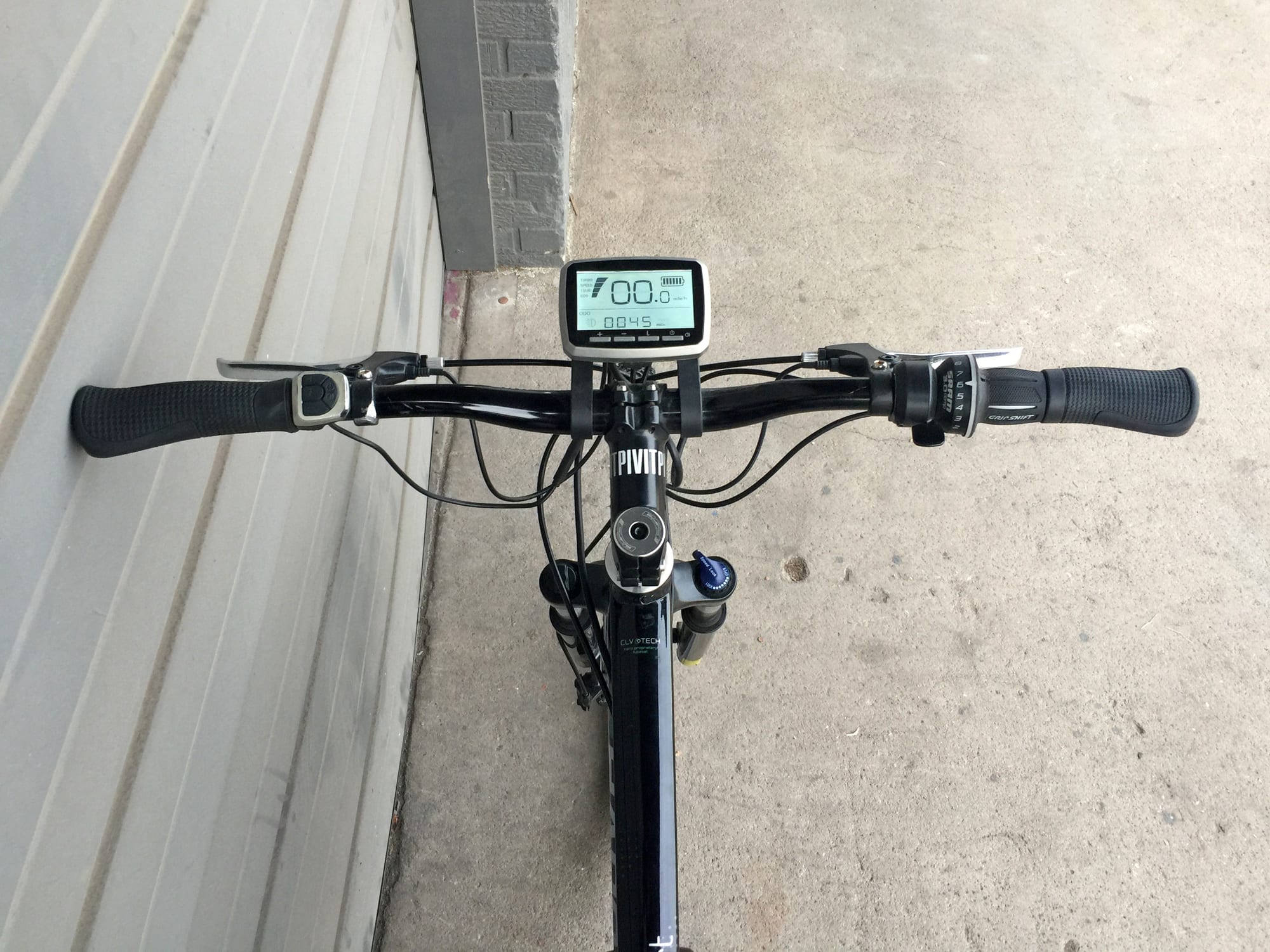

- The display panel is large, bright, has adjustable backlighting (on/off), and gives you access to lots of settings like top speed

- Two battery mounting options make this kit extremely versatile, the downtube pack offers the best handling but the rear rack provides additional cargo options and a built-in light

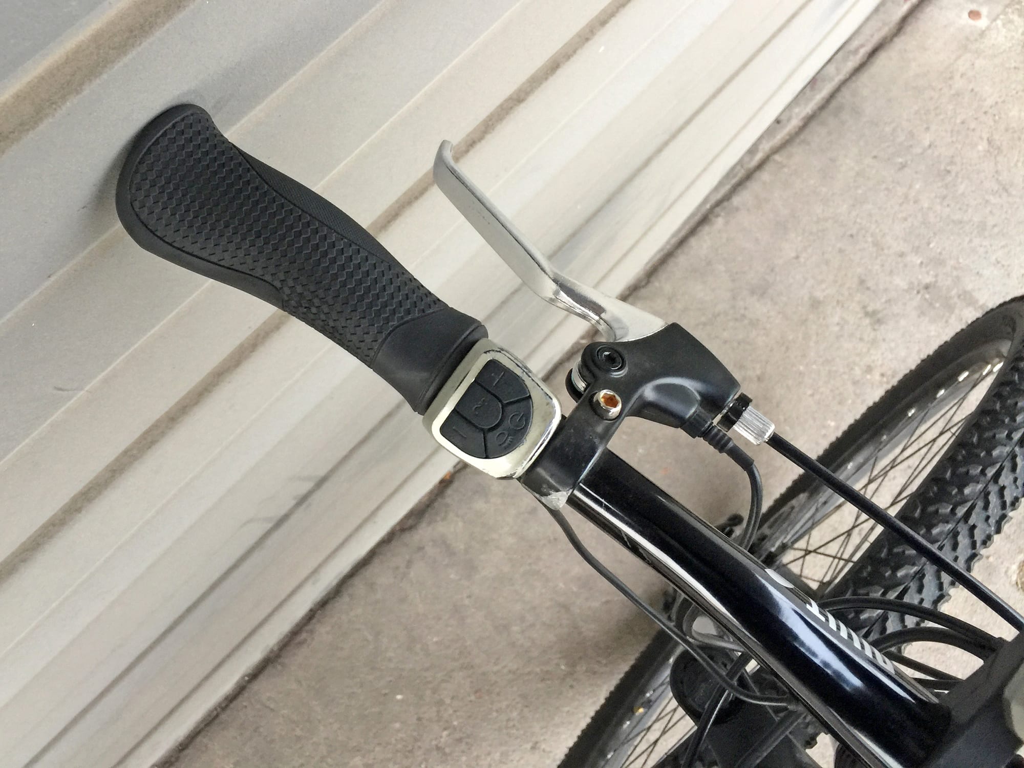

- You get a remote button pad to control assist, lights, and display readouts, and it can be mounted well within reach of your left grip (so you can change settings without repositioning your hands)

- Safety is a big focus for me, so I appreciate the more sensitive torque sensor, adjustable top speed settings, and brake lever motor inhibitors
- If your bike uses hydraulic brakes, EBO does have an optional sensor and magnet unit that can be screwed and glued-on to enable motor inhibiting, but it’s not as elegant or simple as the stock mechanical brake levers
- The display panel is large, easy to read, full of interesting settings to experiment with (and EBO has a nice manual to help you do so on their website), and it has an integrated USB charging port, though the display cannot be easily removed for protection at bike racks or wet days

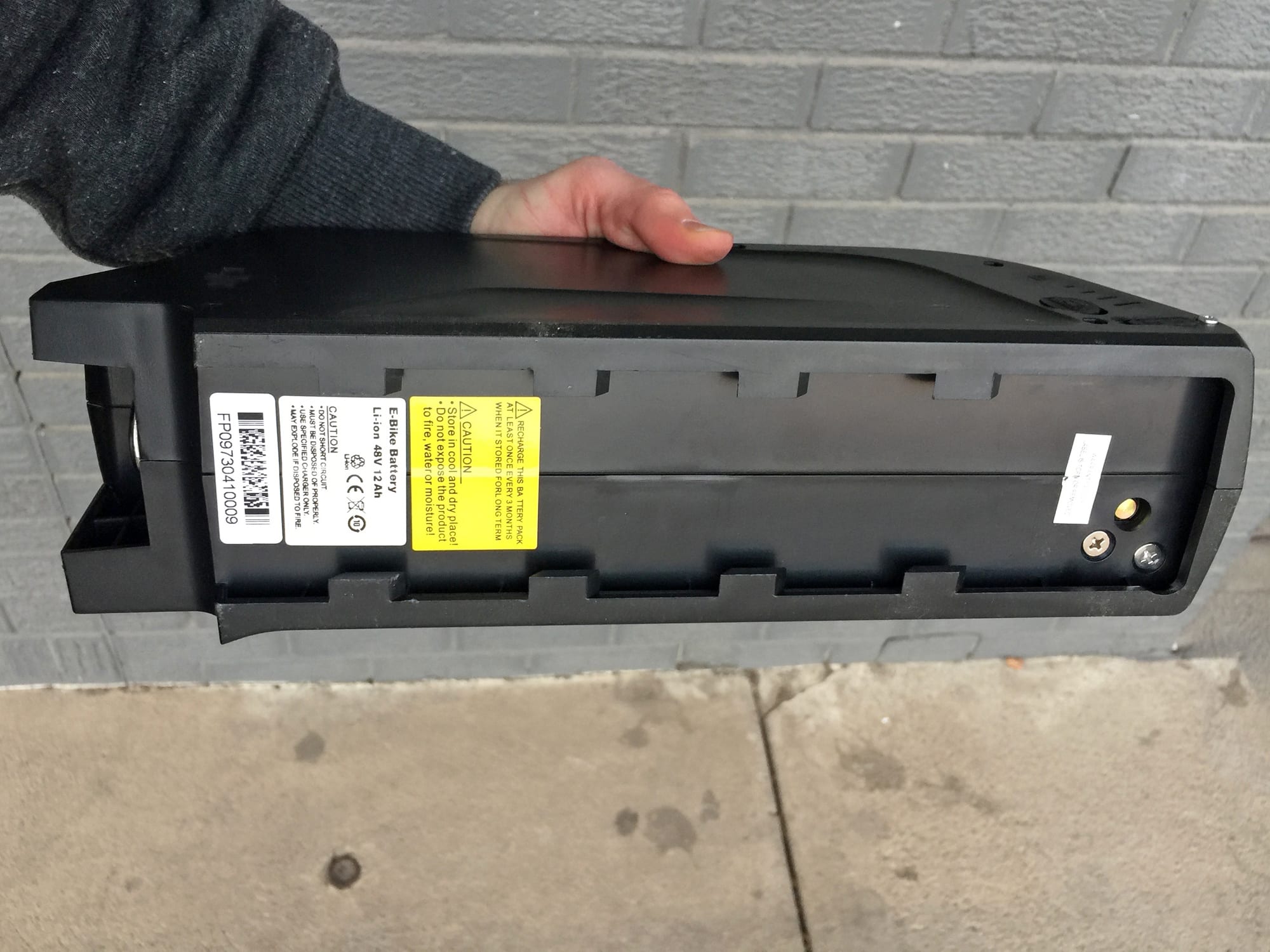

- Given that the battery pack weighs ~7.1 lbs, it’s great that there’s a handle built into the top or back (depending on the downtube or rear rack model), so you can carry it more securely, I suggest storing it in a cool dry location and avoiding extreme heat and cold

- Before shipping each battery, the team at Electric Bike Outfitters actually drains and refills it to test all of the cells, I was told that they experience a 1% failure rate and by testing like this, it saves you time and hassle as the end consumer

- Overall, it isn’t nearly as powerful or capable as the specs would lead you to believe, it compares most closely to the Shimano E6000 motor in my experience, you must shift down your gears to climb effectively and it didn’t offer much support at higher pedal speeds (above 100 RPM)

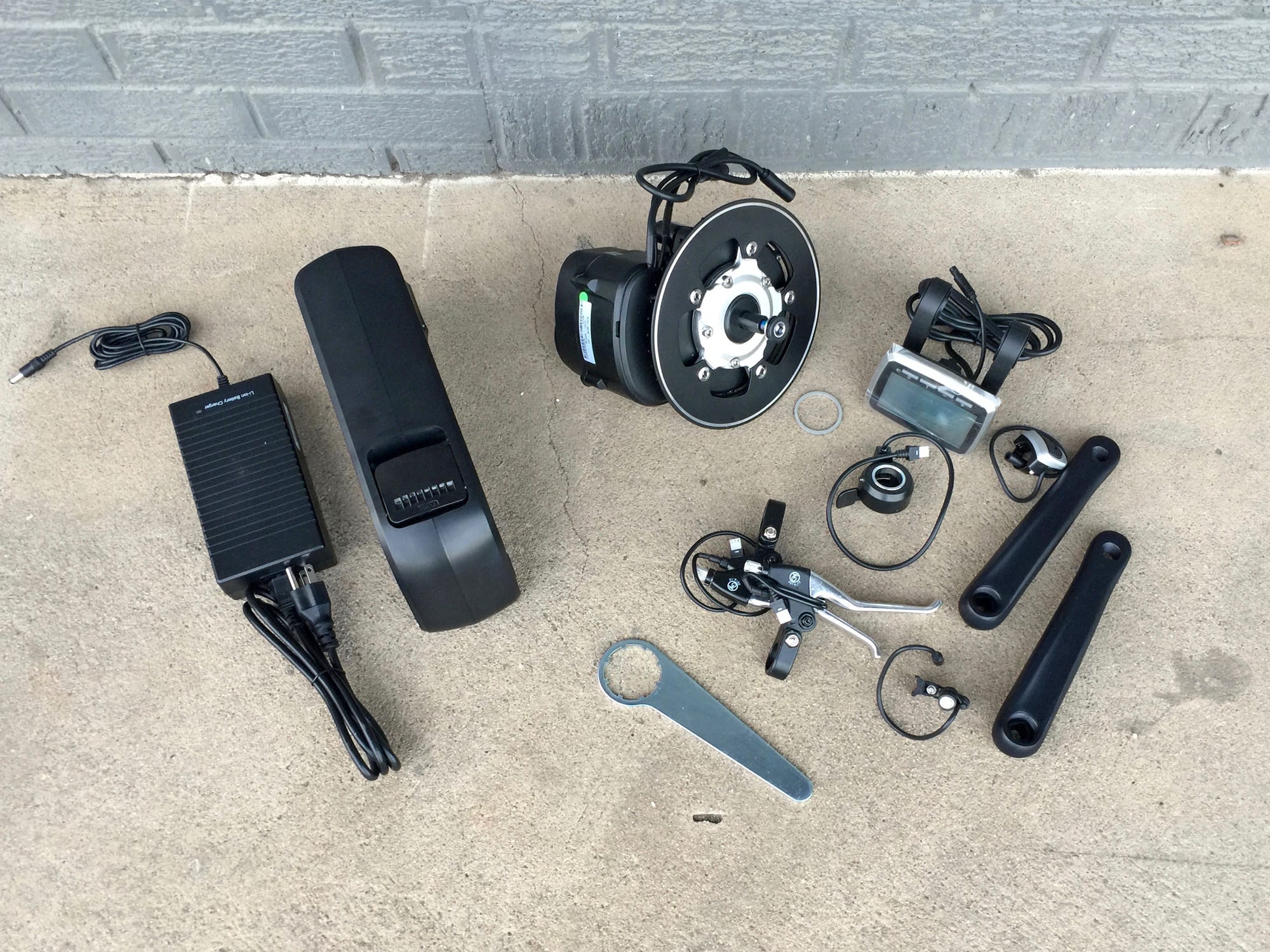

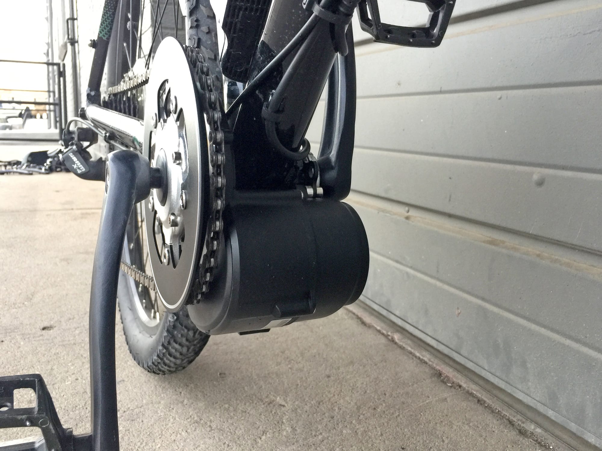

- Mid-motor kits tend to be more difficult and time consuming to install because you must remove the bottom bracket, spindle, and crank arms (requiring special tools like a bottom bracket wrench and crankset puller)

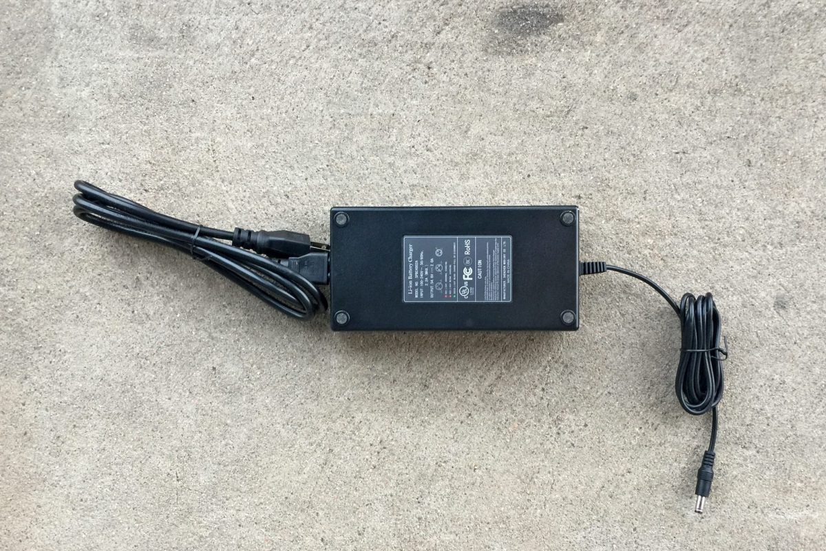

- The battery charger is a bit basic, only offering a standard 2 Amp power output, and it’s not super compact or lightweight at ~1.9 lbs… still, it should fit into your backpack or other bags easily for charging on the go
- Unlike a purpose-built electric bike, kits usually have extra wires that aren’t as hidden or neat looking, the battery mount slide connects to the downtube with two bolts vs. three or some even sturdier custom designs
- The little rubber cap that protects the charging port on the right side of the downtube battery can sometimes be difficult to seat, it’s a minor annoyance but something worth fiddling with each time to protect this sensitive area from dust and water
- The display panel has a bit of lag before showing your current ride speed, it uses a spoke magnet and chain stay sensor but it’s just not as refined as many of the purpose built ebikes I have tested

- It’s nice that the chainring comes with a sturdy alloy bash guard (outer guide), but it would be nicer to also have an inner guard to keep the chain from bouncing off, this would make it a full chain guide

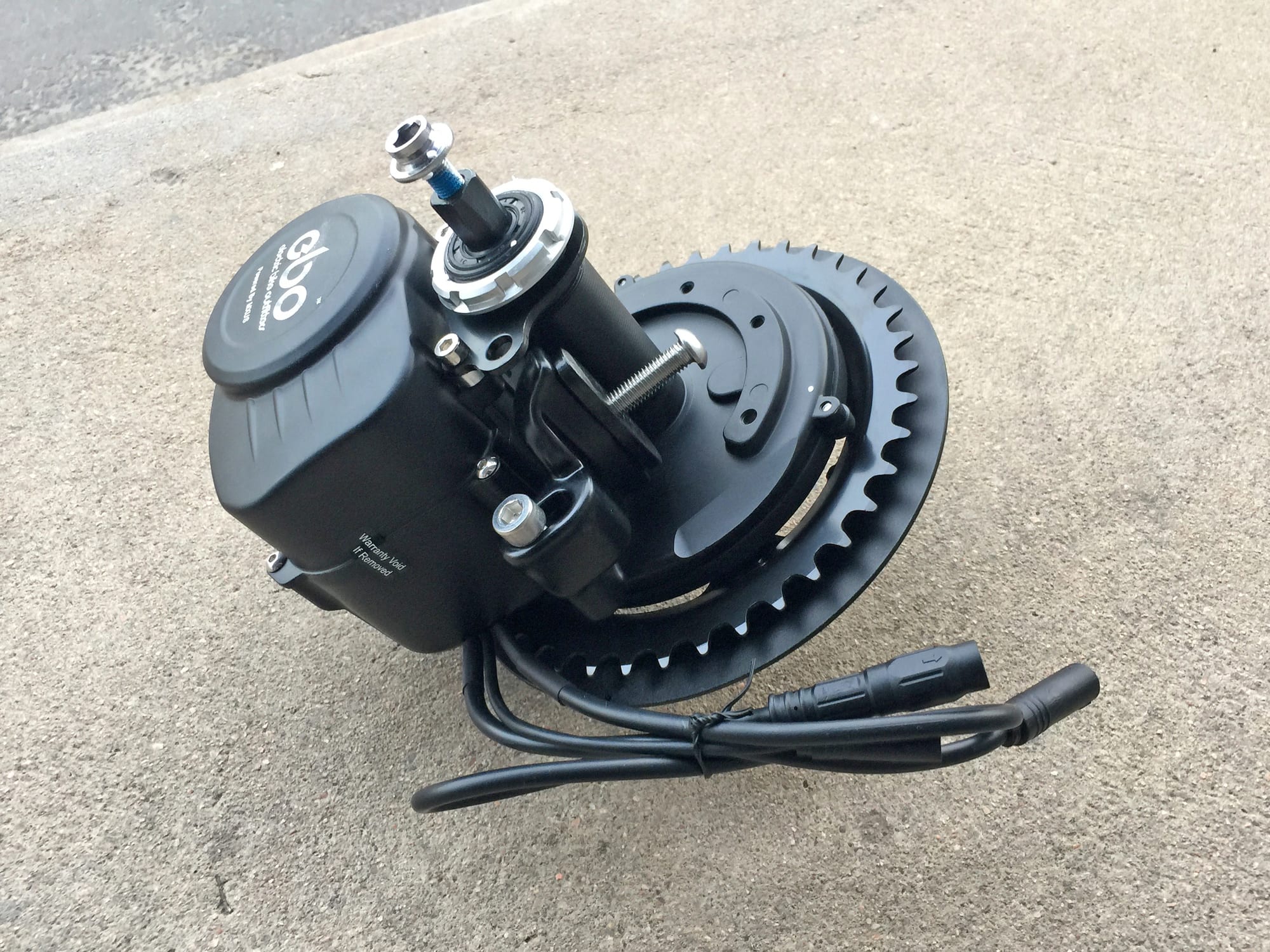

This motor is a rebranded Tongsheng TSDZ-2, there’s a thread running on Endless-Sphere about this motor which is rebranded by several retailers in different countries. In it’s Austrian guise of the Schachner MM15 this motor was selected by Dutch bike builders to create “V8” models of the Workcycles FR8 mid-tail and KR8 box bikes.
