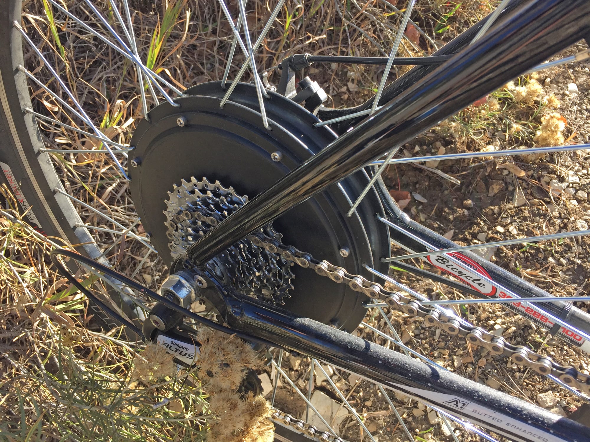

Getting back to the actual kit here, this thing is impressive for the money. While you don’t get regenerative braking or a fancy LCD screen you do get a tough gearless motor that comes laced into one of three wheel sizes (standard 26″, 27.5″ or road sized 700c). You can also choose from a single speed freewheel or a 6, 7, 8 and 9 speed cassette (which I recommend for being able to pedal along at those higher top speeds). The motor itself looked generic to me and weighs more (as with most direct drive options) coming in around 12 pounds. For this reason I’d probably choose a rear-mount design vs. a front wheel replacement which would impact steering. You could probably get two of these kits and make an all-wheel-drive electric bike! But where would you put all of those batteries…

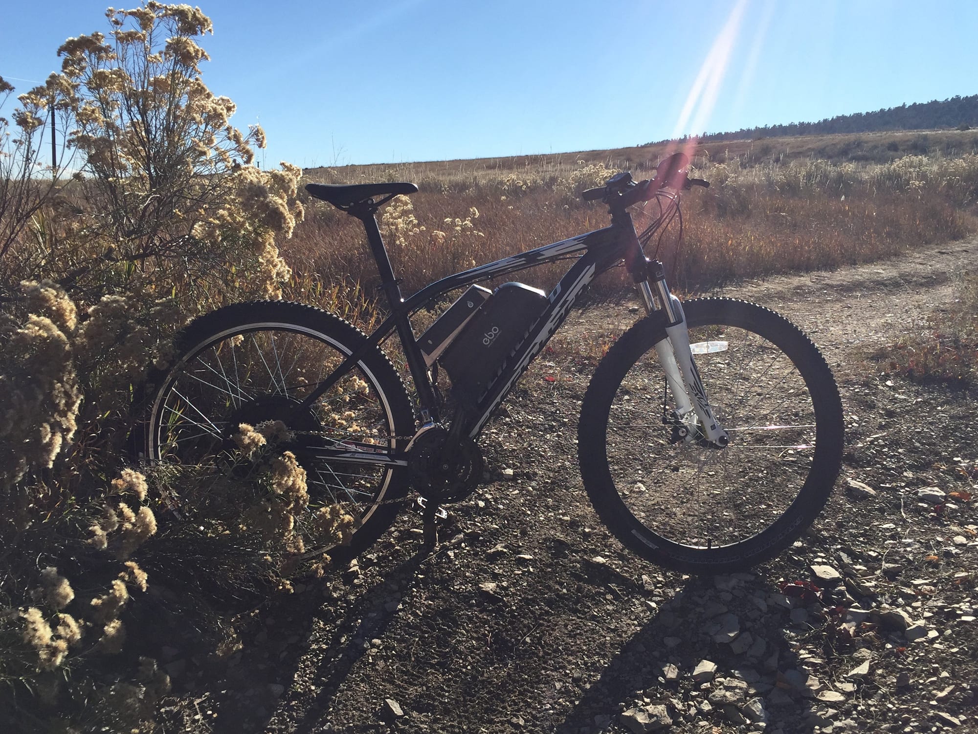

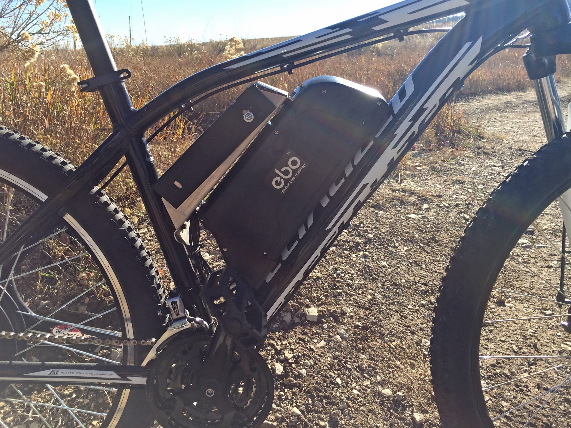

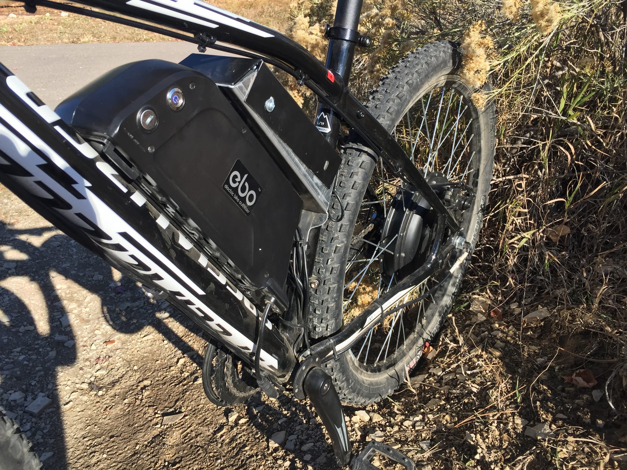

That’s the second double edged feature of this kit. The battery is powerful at 48 volts, allowing you to take full advantage of the motor’s potential, but it requires a larger 25 watt controller to handle the juice and the design is a bit ugly and uncomfortable in my opinion. It’s a metal box that sits just above the battery and attaches to the seat tube bosses (so yeah, all of your bottle cage spots are used up and you must have two sets of bosses on your bike frame to use this kit). I found that the controller box was a bit wider than the battery itself and that the metal corners were abrasive if they came into contact with your knees and legs when pedaling. Not really a huge issue in practice but worth noting… I do appreciate that the box is tough. This is the “Mountaineer” after all and it truly handles rough and steep terrain. In the video above you can see me blasting down hills as well as speeding back up them without issue. I do like that the battery uses Samsung cells, is included with the one year warranty and has a USB charging outlet (even though I probably wouldn’t use that while riding due to risks of snagging extra wires protruding from the side).

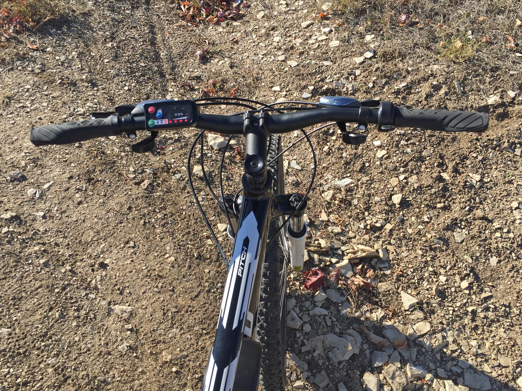

The only reason this kit isn’t getting a harsher rating is that it comes in so many flavors and is so affordable. I would recommend the more-legal EBO Front Range kit but the 500 watt motor seems wasted given the 36 volt battery. Both kits have a mid-level LED display that approximates speed, charge level and assist setting and a standard trigger throttle which is nice for bumpy off-road riding. You can upgrade to a twist throttle but the company was using full-grip throttles when I did this review and I much prefer a half-grip for improved stability. I realize motocross bikes have full grip throttles but they also weigh more and have massive full suspension so the ride is smoother. Depending on your bicycle frame, that’s probably not the case and bumps are more directly transmitted to your hands which could impact your throttle handling. At the end of the day, this kit is powerful, affordable and versatile but also quite heavy and potentially illegal. Ride safe!

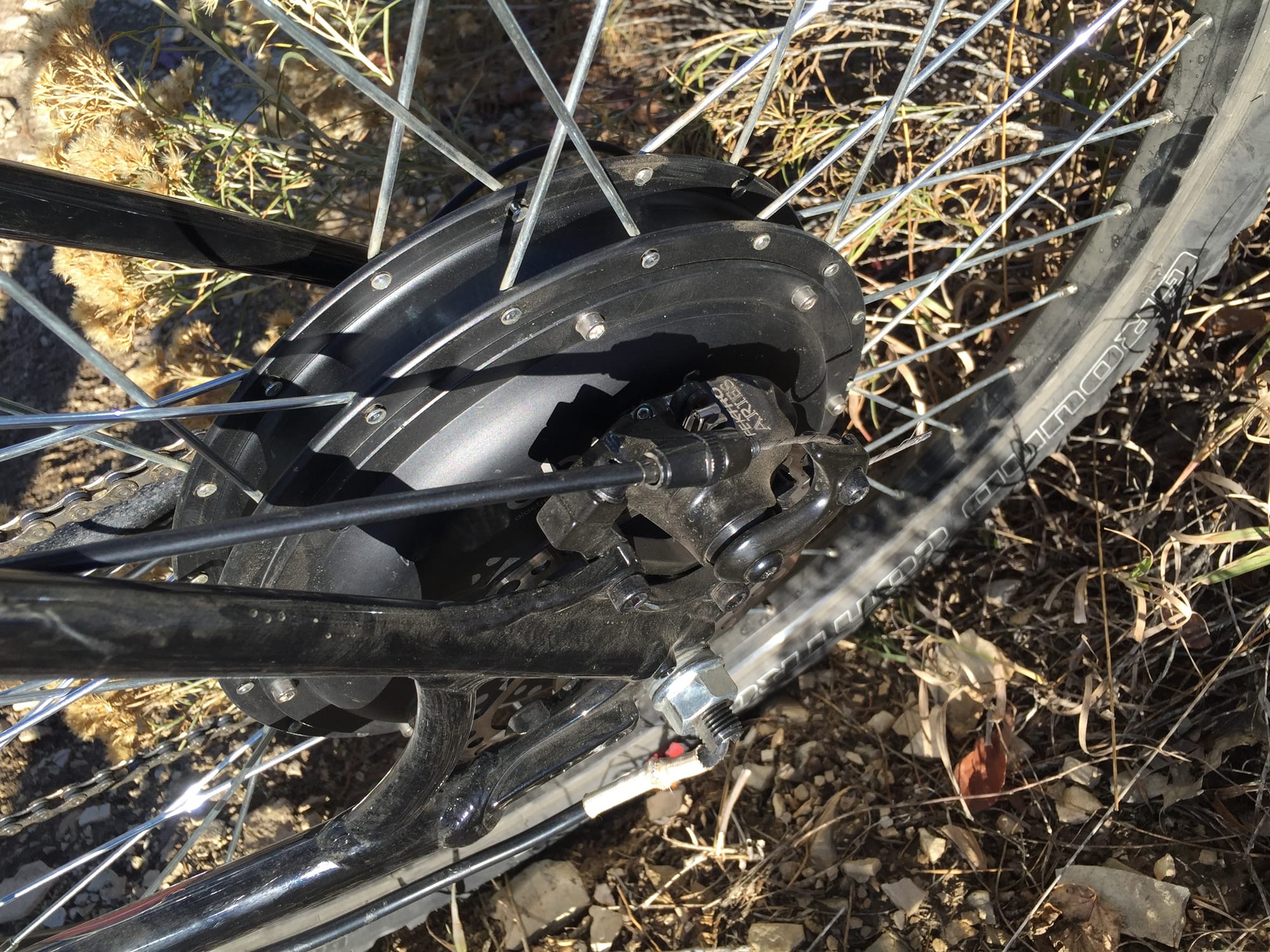

- The hub motor design on this kit is compatible with disc brakes but you can also use standard rim brakes as well, the one thing that requires a changeout is hydraulic brakes because the included levers only work with mechanical systems, you could use hydraulic levers of your own but if they don’t have electronic brake inhibitors built in you won’t be operating as safely (especially given the “all the time” pedal assist design and higher power 750 watt motor)
- The kit comes in several configurations to replace a 26″, 27.5″ or 700c wheel, to fit a 100 mm, 120 mm, or 135 mm dropout, and to work as either a front or rear wheel drive kit (though I’d highly recommend rear given the weight and power of the motor so as not to adversely impact steering)

- Especially for high speed trail and mountain use the default trigger throttle works very well as it does not compromise your grip though it might take more space on your bars than the twist throttle (I just don’t like full-grip twists that they were offering at the time of this review)

- The controller box is custom designed and made with metal to be tough but I think it requires downtube bottle cage bosses to work (at least how I saw it installed) and it’s just not as polished and professional looking, it may also have sharper edges than curved plastic like the one used on the Front Range kit, this controller offers 25 Amps vs. just 22 Amps on the Front Range kit

- The controller unit for this kit is built into a separate black box which adds clutter to the frame and means more wires have to be dealt with, it is also slightly wider than the battery which might make bumping and scraping legs easier
- On the demo bike I filmed and photographed above the battery was mounted to the downtube using the stock water bottle cage bosses and the controller box was fit onto the seat tube bosses so there wasn’t anywhere to add a bottle… Consider an aftermarket saddle rail adapter, a rear carry rack with bottle bag or using a Camelbak

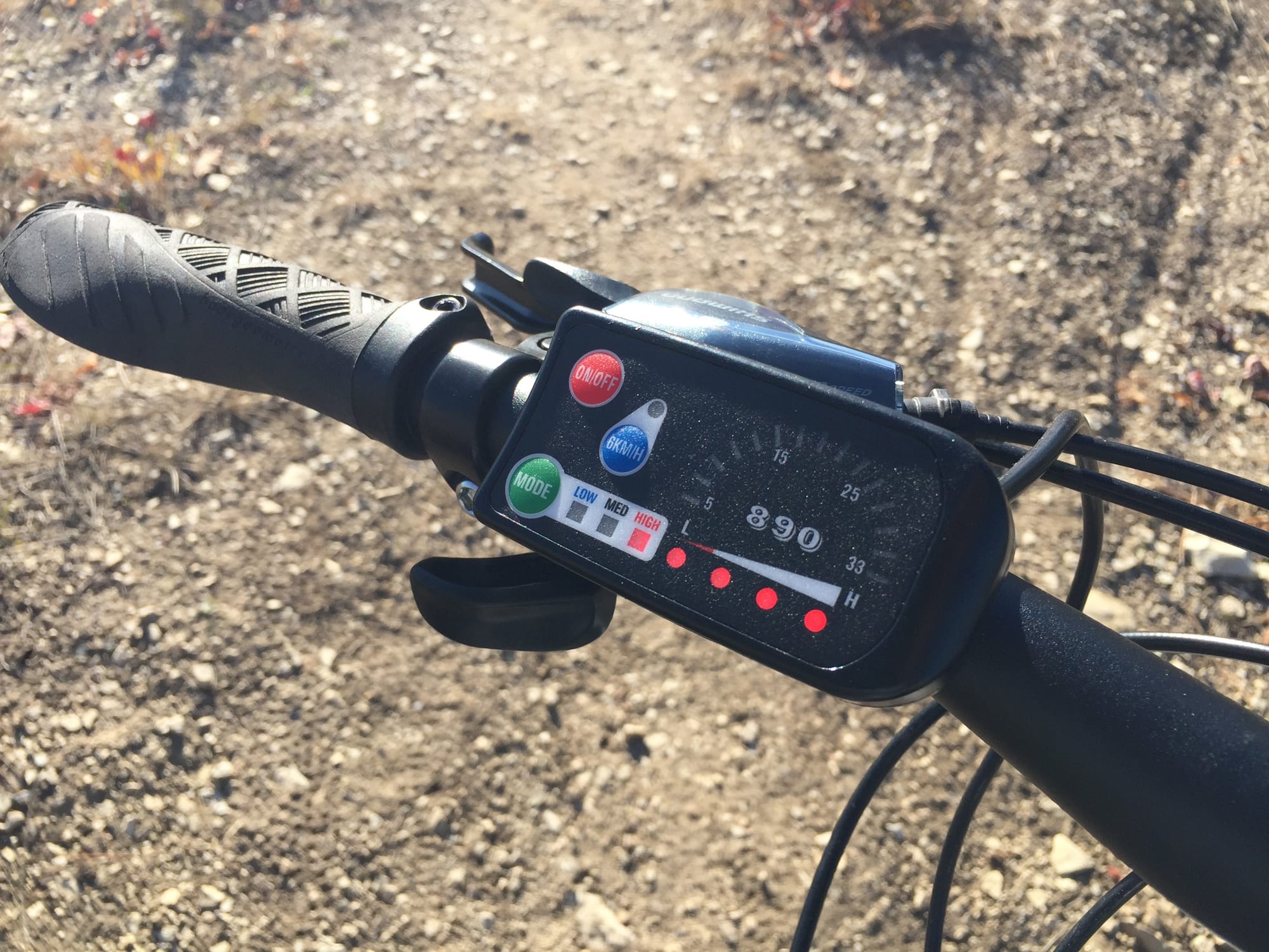

- The LED console offers several readouts (mode, charge level and speed) but is still more basic than an LCD which could show trip distance, time, max speed etc. the unit they chose is fairly small, tough and more affordable so it’s not too bad
- The battery pack has an independent on/off button built into it which has to be activated before the display panel is turned on, this extra step makes the pack easier to leave on accidentally and can be confusing if you forget and try to activate the bike just using the display

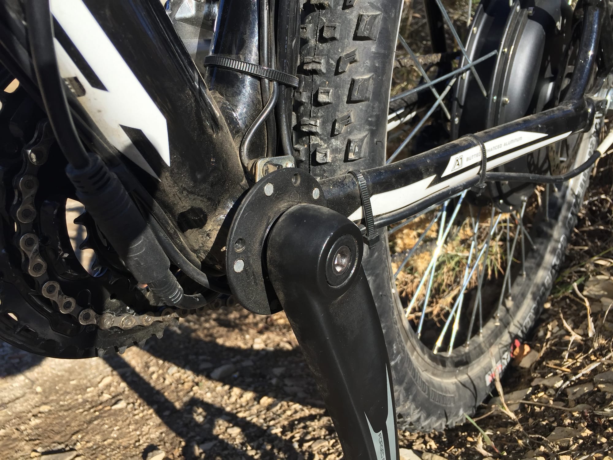

- While the cadence sensing pedal assist worked alright, it only uses a five magnet system vs. 12 on a lot of newer builds and kits I’ve seen which means it is less responsive (especially in higher gears where pedal rotation can be slower at low speeds)
- Gearless motors are very durable and operate without producing much noise but they do weigh more and this one is ~12 lbs, the 48 volt battery is also a bit heavier at ~7 lbs

- The pedal assist sensor is not a clip-on design so you actually have to remove the crank arms in order to mount it, once it’s on however it feels solid and is actually quite responsive
