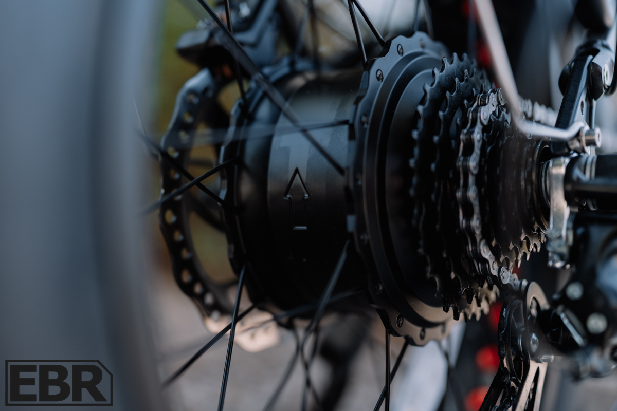

The motor is a 750W rear hub unit with a twist throttle that peaks at 1400W and delivers 95Nm of torque, making this one of the more powerful folding bikes available right now. Motor activation is triggered via a torque sensor, and riders have 5 riding modes to cycle through for pedal assistance.
The motor is seriously quick, and I often found myself grinning ear-to-ear only to realize I was throttling around town over 30 mph. This gives the Mars 3.0 the feel of a folding moped more than a traditional folding e-bike. If you like speed, the Mars 3.0 is just plain fun to ride. On the other hand, if that makes you nervous, the bike has a companion app where riders can not only limit the throttle but tune the motor at each level of pedal assist to keep the bike within parameters you’re comfortable with.
The torque sensor on the Mars 3.0 is a nice touch and a welcome upgrade over the previous version’s cadence sensor. In terms of how natural the pedal assistance feels, it’s close but not quite fully dialed in—I could feel the bike doing small surges in power with each pedal rotation, telling me it’s trying to match my effort but just isn’t quite as refined as some others in this price point.

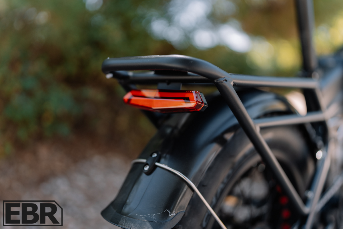

Commuters will love the comprehensive front-to-back lighting that includes not only a headlight, taillight, and brake light but turn signals as well, projecting from the rear taillight corners to let drivers behind you know when you plan to make a turn. Plus, with mounting points for a front rack or basket along with the frame-mounted rear rack, the Mars 3.0 has the build to carry whatever your day has in store.

The Mars 3.0 is powered by a rear hub motor paired with a torque sensor and offers five levels of pedal assist: Eco, Tour, Standard, Sport, and Turbo, plus a twist throttle for those times when you don’t want to pedal at all.
While the bike isn’t particularly snappy off the line, it quickly builds momentum thanks to that impressive torque output, and once it gets moving, it’s genuinely quick. What really impressed me was how this folder crushes hills with relative ease—more capability than I’ve seen from any folding e-bike before. Whether you’re tackling steep urban inclines or rolling countryside, the Mars 3.0 has the muscle to flatten them without breaking a sweat.

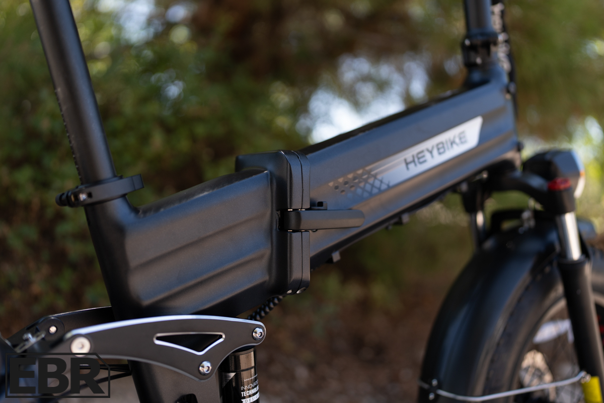

The power comes from a 48V 13Ah 624Wh removable battery that’s fully enclosed within the folding frame. To access it, you’ll find the key slot on the underside of the top tube, but here’s the catch—you need to fold the bike to actually remove the battery from the frame. This setup isn’t ideal for daily battery removers, but it’s a nice option for those who want the security of taking their battery indoors or prefer off-bike charging. The removed battery weighs just under 9 pounds, making it manageable to carry when needed.

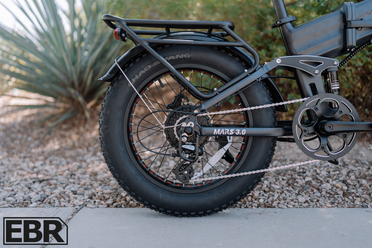

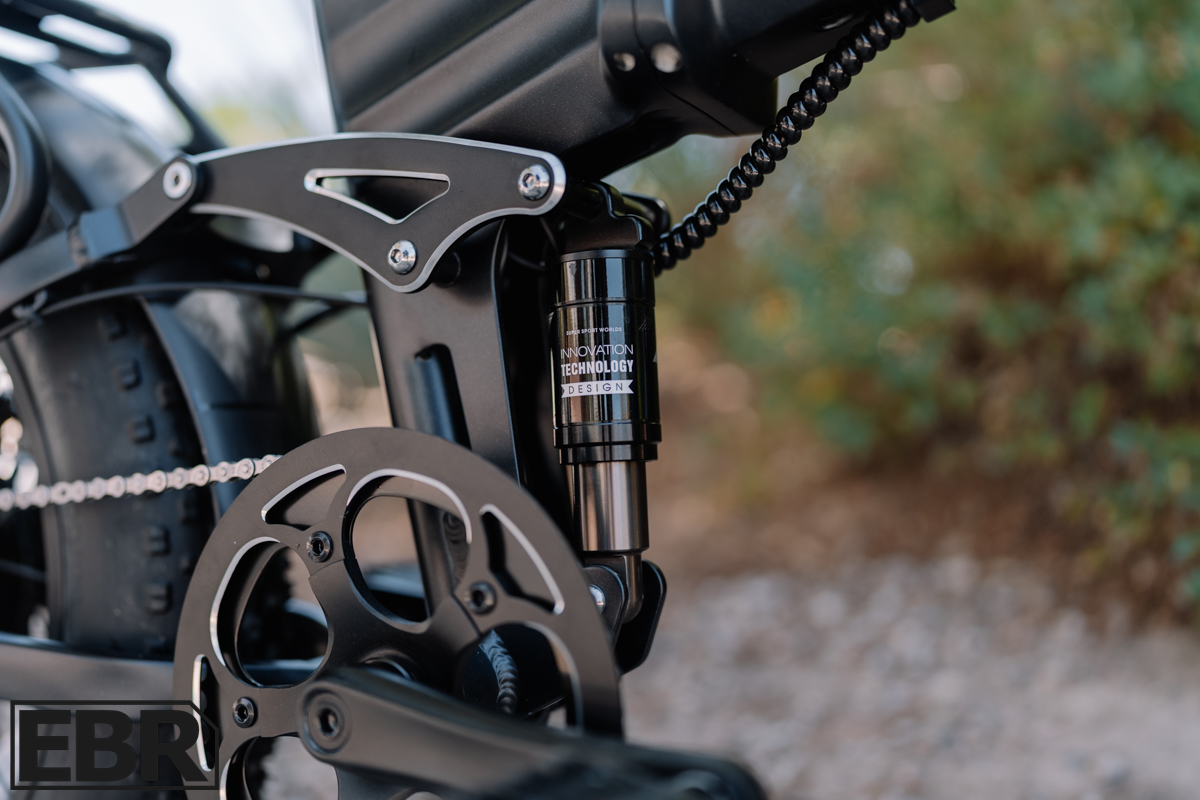

The Mars 3.0 is built around a folding alloy frame with an impressive 440-pound load capacity—more than enough for most riders plus cargo. What sets this folder apart is its full suspension setup: a 50mm travel front fork with coil spring, preload adjustment, and lockout features, paired with a Horst link rear suspension system. This dual-suspension approach is rare in the folding e-bike world and translates to genuine comfort over rough terrain. The lockout feature on the front fork is particularly useful for efficient pedaling on smooth surfaces, while the preload adjustment lets you dial in the suspension for your weight and riding style.
Rolling on 20-inch alloy wheels wrapped in chunky 20″x4.0″ tires, the Mars 3.0 strikes a balance between portability and capability. Those fat tires provide excellent traction and a cushy ride, though as mentioned earlier, they do generate some noise on pavement due to their aggressive tread pattern. The trade-off is worth it for the versatility they offer across different terrain types.

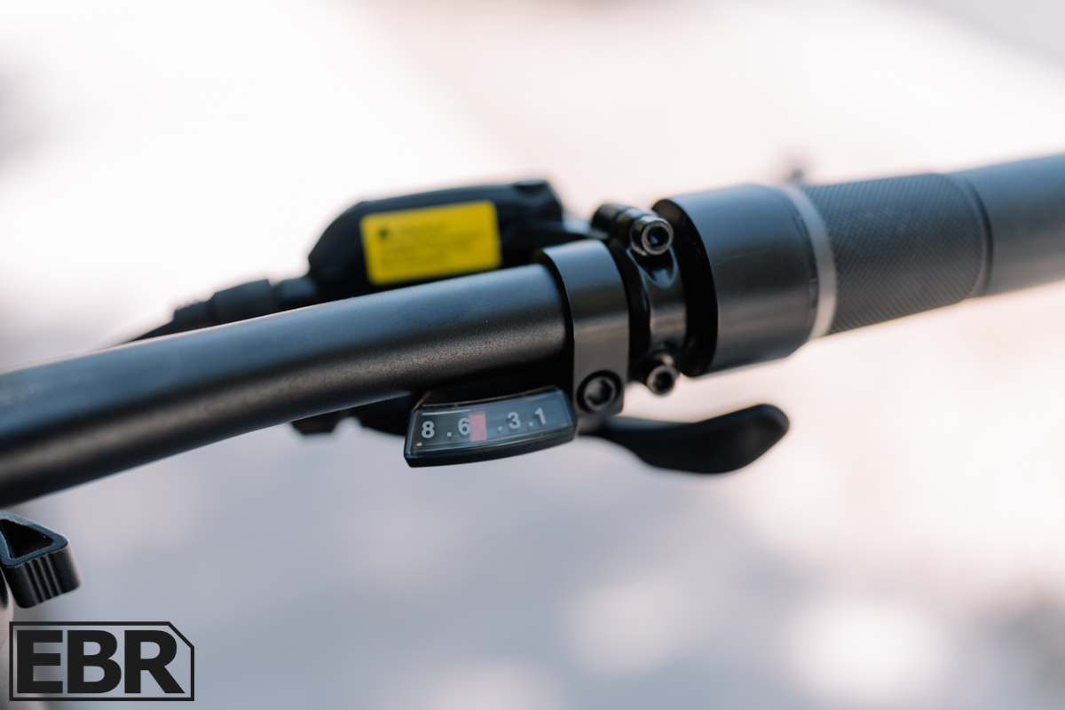

The 8-speed Shimano drivetrain consists of Altus rear derailleur, 8-speed shifters, and a 13-32t cassette paired with a 48t chainring. This setup provides adequate gear range for most riding situations, from steep climbs to flat cruising. The 170mm alloy crankset is standard fare, and the overall drivetrain performs reliably, though it’s clearly positioned as a budget-conscious choice rather than high-performance components.

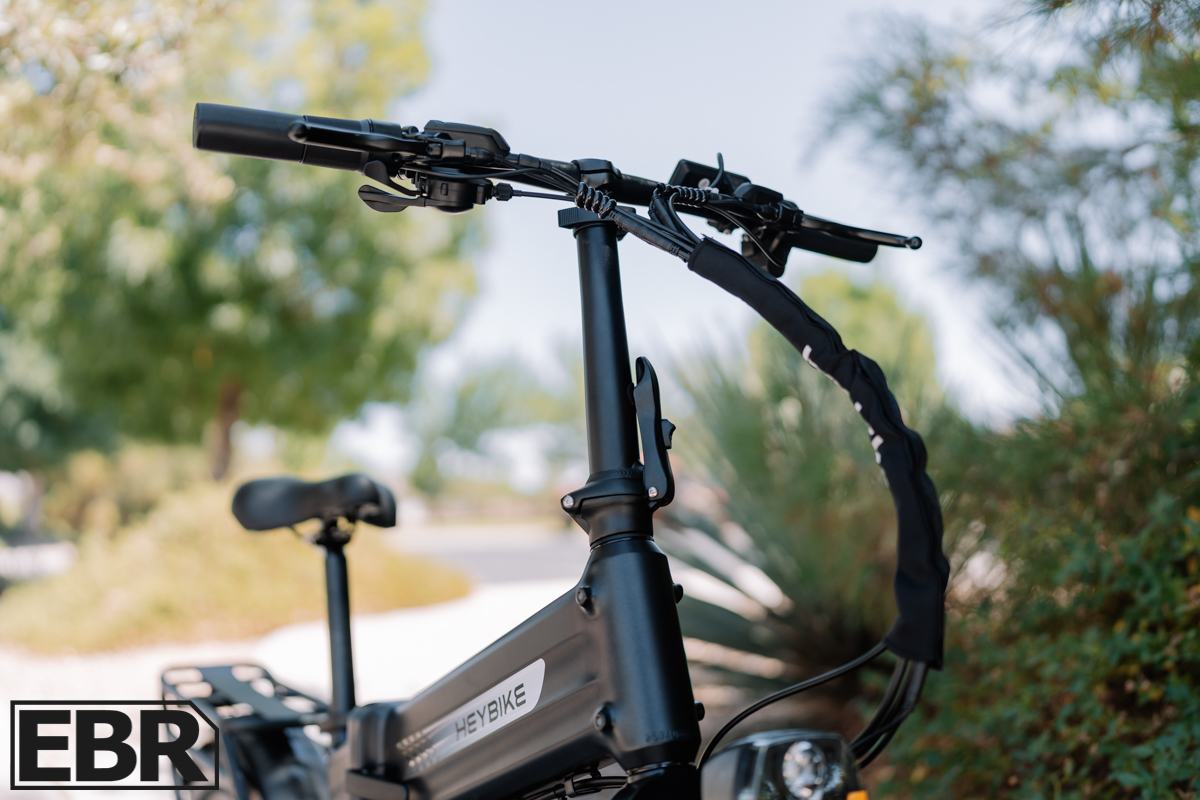

The telescoping/folding stem pairs with a 25-inch flat bar that offers 5 inches of height adjustability via a quick-release lever—great for dialing in your riding position or accommodating different riders. However, the rubber slide-on grips are a weak point; I’d prefer locking grips as these can rotate and slip over time, especially in wet conditions or during aggressive riding.

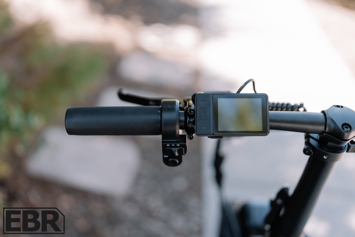

The Mars 3.0 comes with a full-color TFT display that’s both functional and easy to read. With an IP65 rating, it’s well-protected against the elements, so you don’t need to worry about rain or splashing during your rides. One standout feature is the NFC capability for proximity card locking and unlocking—a nice tech touch that adds convenience and security.
The display includes a built-in USB Type-A charging port, which is incredibly handy for keeping your phone or other devices topped up during longer rides. The standard display shows all the essentials: current speed, battery level, remaining charge in volts, odometer, PAS level, and real-time power output. For those who want to dig deeper, holding the ‘+’ and ‘-‘ buttons together for 2 seconds unlocks advanced menus where you can adjust display brightness, units of measurement, wheel size, and other system settings.

Heybike includes a solid accessory package right out of the box. The Mars 3.0 comes with a rear rack mounted directly to the frame, plus mounting points on the head tube for adding a front basket or rack down the line. Plastic fenders front and rear help keep you clean during wet rides, though they’re basic units that get the job done without being particularly robust.
The lighting package is comprehensive and genuinely useful for commuting. You get an adjustable-angle LED headlight up front and a rear rack-mounted taillight that pulls double duty with both brake light functionality and turn signals—a nice touch for urban riding where visibility matters. Being able to signal your intentions to drivers behind you is a safety feature more e-bikes should include.
