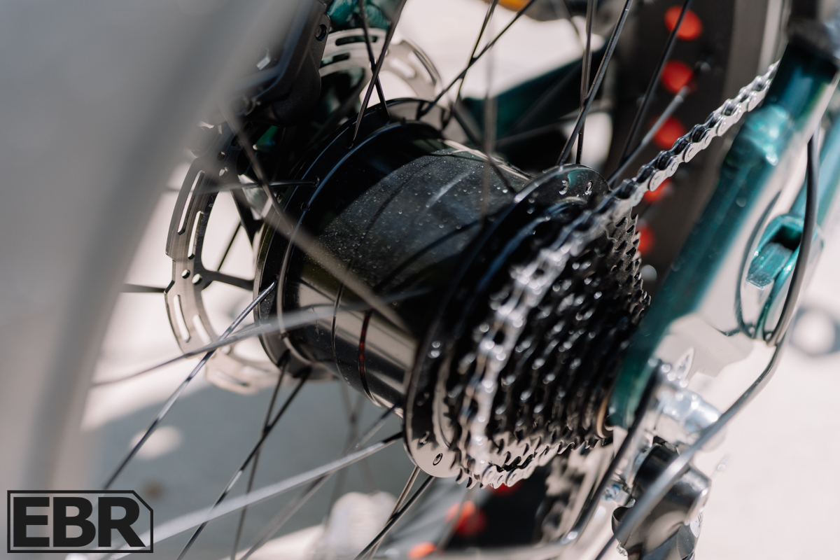

Power comes from a 750W rear hub motor peaking at 1200W with 80Nm torque, activated by a torque sensor across five assist modes and a twist throttle. It’s punchy enough for quick starts and hill climbs, flattening inclines on throttle alone without much drama, though it doesn’t snap as hard as higher-torque options.

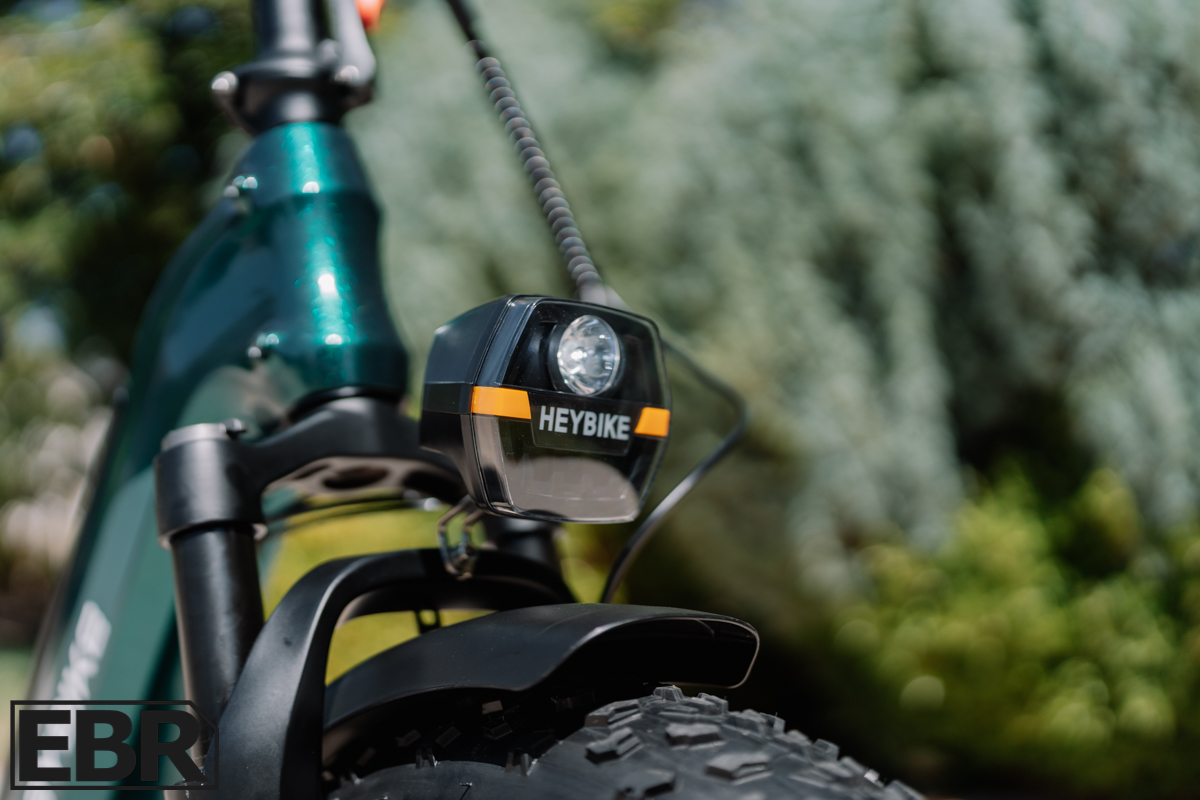

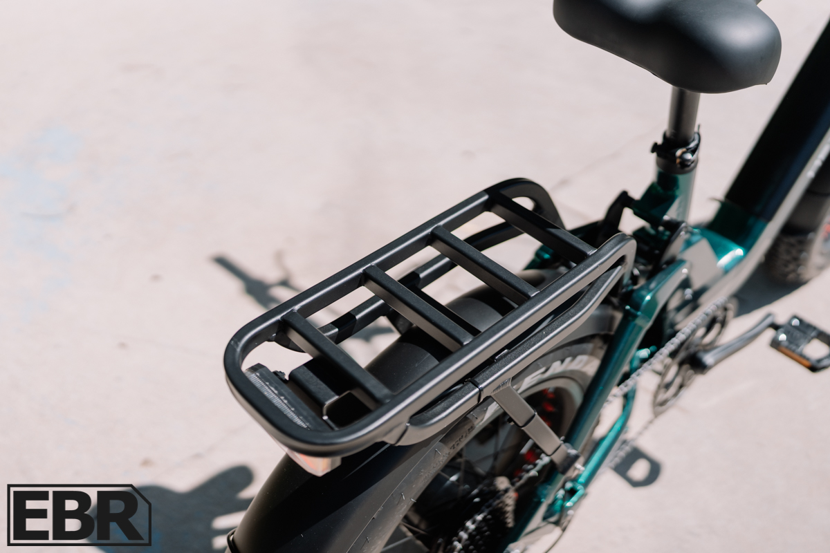

For commuters, the setup is spot-on with a rear rack handling groceries easily, front mounting points for extras, and full lighting including turn signals that make urban traffic safer. Overall, it’s versatile for city streets to leisurely park rides, with enough capability for light adventures. The motor hums subtly under load, but wind noise overtakes it above 15-20 mph, not annoying, just there when pushing hard.

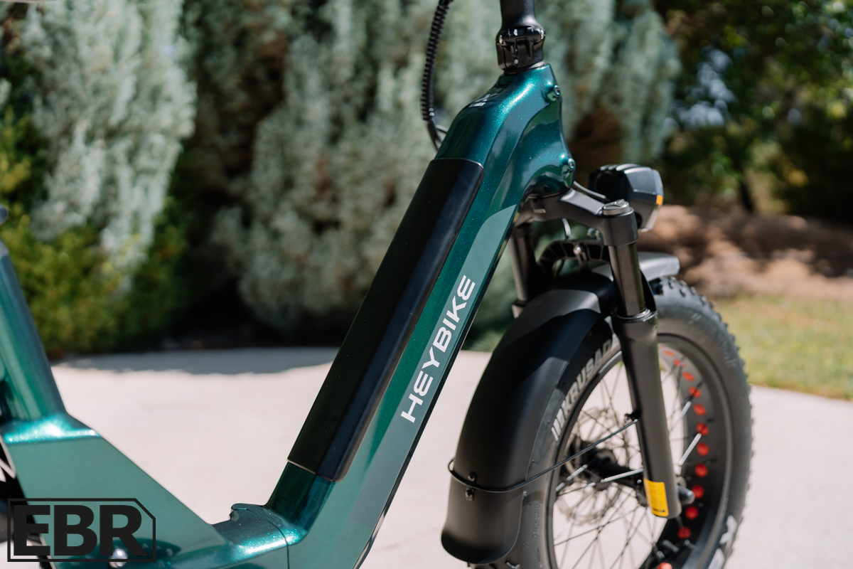

The 48V 15Ah 720Wh battery integrates into the downtube behind a slim cover, secured with a key lock for easy removal when charging indoors or adding security, though folding the bike can make access simpler if you’re dealing with tight spots. Weighing about 10 lbs, the battery’s manageable to carry, and the whole setup keeps things practical without extra daily fuss.

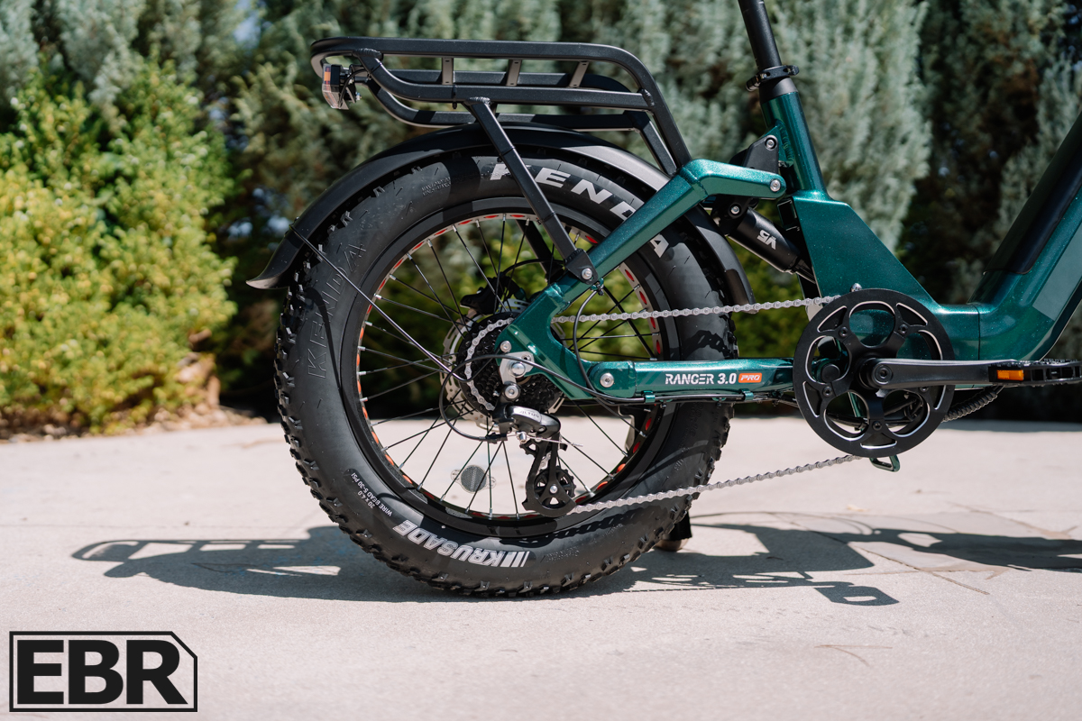

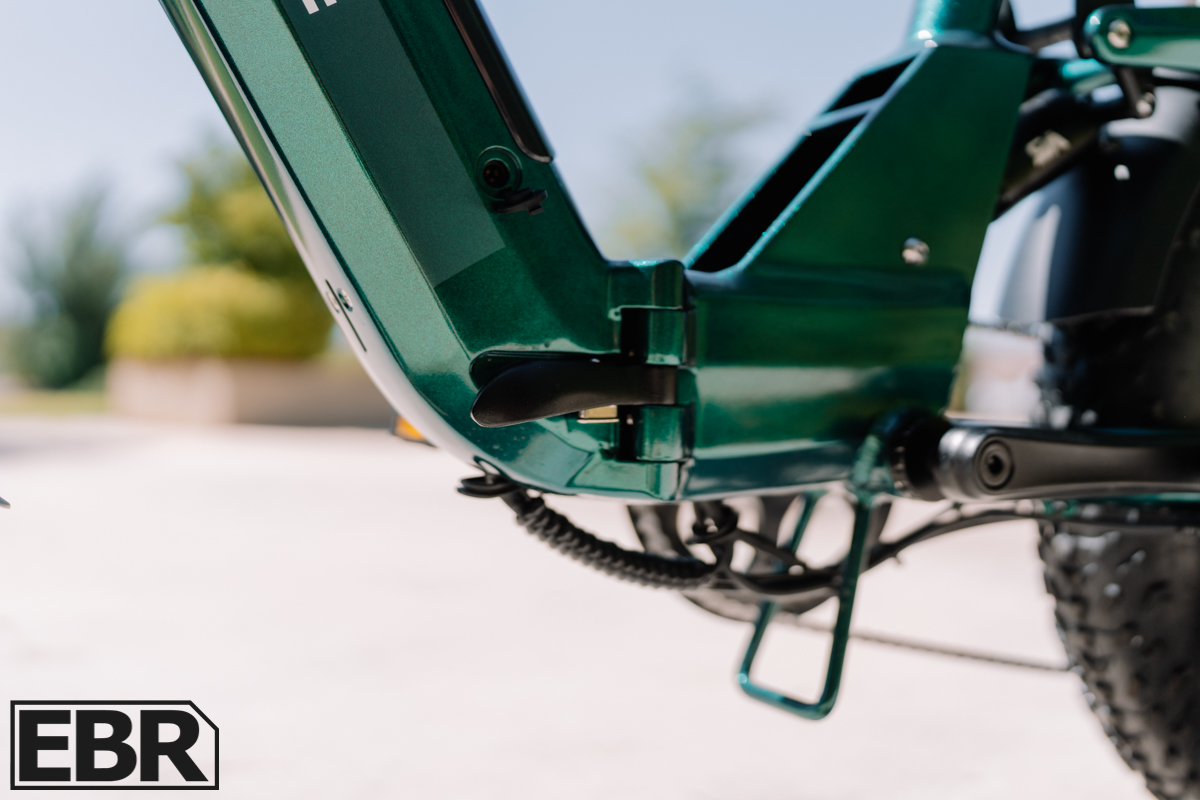

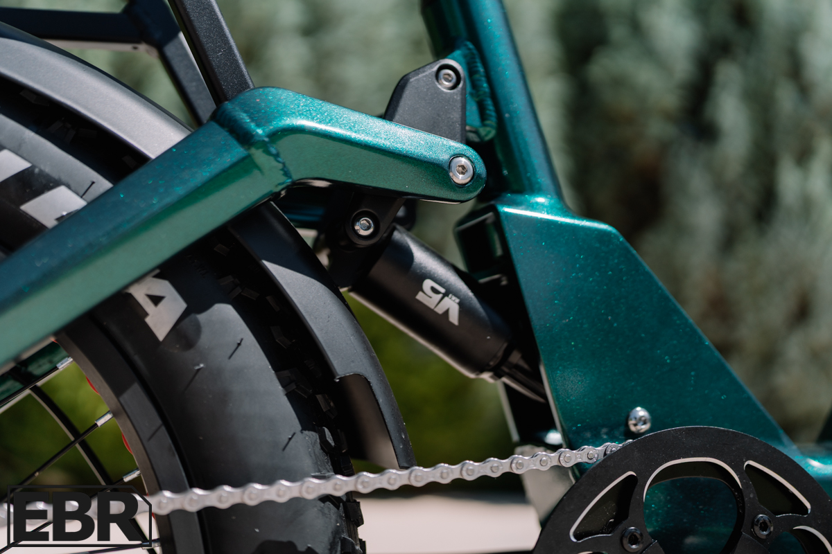

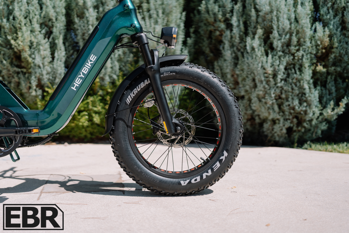

Built on a hydroformed folding alloy frame with 440 lb capacity, the Ranger 3.0 Pro feels stable and capable for loaded rides. The full suspension is a nice touch and not seen often on folding ebikes, but certainly welcome nonetheless. The full suspension includes a 65mm front fork with a coil spring, preload, and lockout features, along with an adjustable air shock in the rear. This setup lets me tweak the air pressure for better bump handling on rough terrain. It’s rare in folding bikes and adds real comfort without sagging on smooth roads.

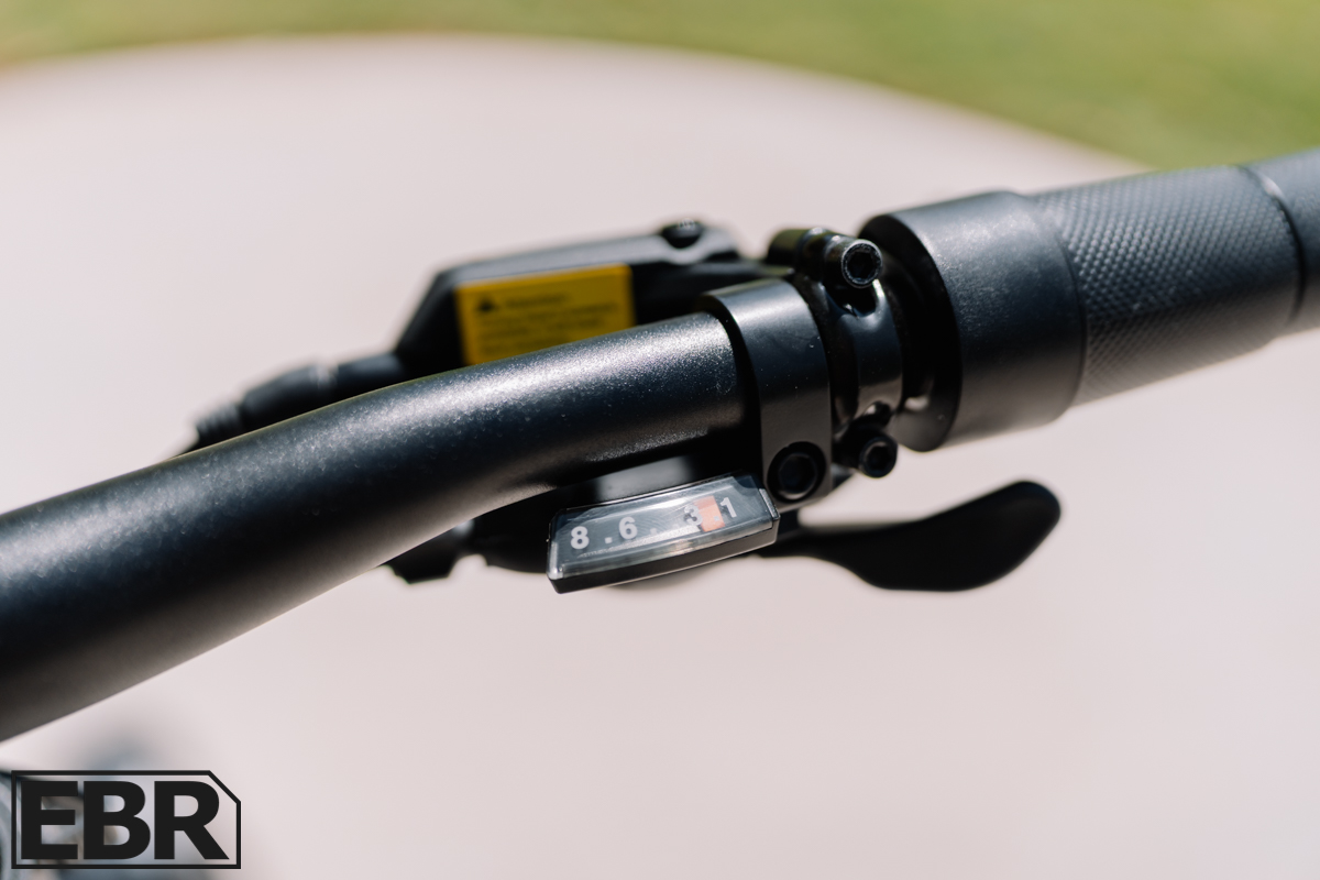

Kenda 20″x4.0″ tires on alloy wheels balance traction and cushion, performing well across pavement to gravel, with the expected light noise on hard surfaces. The Shimano 8-speed drivetrain with Altus derailleur, 13-32t cassette, and 48t chainring shifts smoothly, providing good gear spread that covers flats to hills effectively, no complaints on range or reliability, as it let the motor pick up slack on steeps and I never wished for more during my routes.

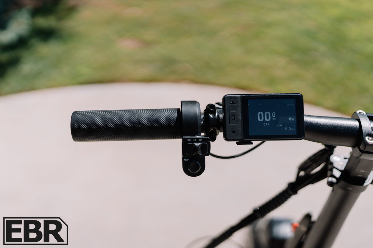

The Ranger 3.0 Pro rocks a TFT color display that’s clear and easy to check while riding. Its IP65 rating means it shrugs off rain or dust, so no worries on wet trails. The NFC proximity card is a slick touch—just tap it to lock or unlock the bike fast, adding security without fuss. You can also set a custom 4-digit PIN (starts at 0000) right on the display for quick, secure startups.
There’s a USB-A port for charging your phone on longer rides, which is super handy. The screen shows all the essentials: speed, battery level, voltage, odometer, assist mode, and power draw. Want more control? Hold ‘+’ and ‘-‘ for two seconds to tweak settings like brightness, units, or wheel size.

Heybike includes a solid set of accessories right out of the box. It comes with a frame-mounted rear rack for carrying gear, front rack mounting points for extra storage, and plastic fenders on both wheels to keep you clean in wet conditions—functional, if not fancy. The lighting kit is built for real-world use, especially for city riders, with an adjustable LED headlight (complete with a horn) and a rear taillight that includes brake lights and turn signals, making it easier to signal cars and stay safe in traffic.
