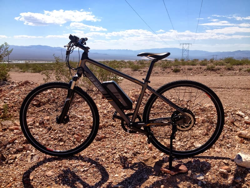

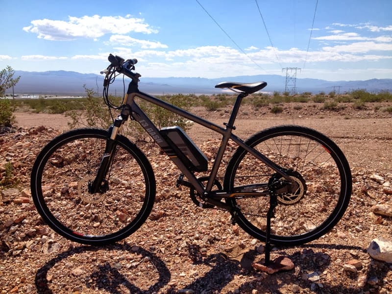

This review is for the first generation IZIP E3 Dash which launched in 2014. The second generation model saw improvements in motor durability, control pad accessibility, saddle comfort and drivetrain components.
The E3 Dash offers speed, quality and affordability that’s top notch. It’s one of my favorite new bikes in the IZIP line for 2014 and worth considering if your ride is mostly on pavement with a touch of trail riding. From the low mounted battery pack and evenly distributed weight to the 28mph top speed in pedal assist mode this bike offers a fun and affordable experience with a great warranty and large network of dealers who can offer support and test rides before you buy.
Now, obviously I like this bike but it’s not for everyone. The frame creates a more forward-leaning position that’s aggressive. While it does come in two frame sizes (medium and large) both are high-step so if you struggle getting onto bikes and prefer a stepthrough experience this may not work (consider the step-through version of the E3 Path Plus). Also, if you’re more into off road and actually want to take this thing on trails and climb with it, I suggest checking out the E3 Peak which has knobby tires, a mid-drive system and hydraulic disc brakes.
Let’s dig into the motor specs on the E3 Dash. This is the first gearless motor I’ve seen on an IZIP bike and it offers 500 watts of power which is very good! It coasts silently (no gears rubbing) and offers smooth torque-sensing assist with four modes of pedal assist to choose from including 1, 2, and 3. The cool thing is, you can activate the throttle at any time while riding in pedal assist or switch into Throttle mode only. While I like the motor setup here the downside vs. a middrive is that changing tires gets a bit more tricky and it’s a bit more rear-heavy. That said, IZIP has designed a quick release system and threaded, waterproof, connection point right near the motor that tries to make changing flats and truing wheels as easy as possible.
Moving on to the battery pack, this bike offers 48 volts of power with 8.7 amp hours of capacity. That’s a lot of force, most ebikes use 36 volt batteries at 10 amp hours. You might be wondering if the range here is diminished but in my experience the efficiency of a stronger motor + battery balances out the lower amp hour rating. The pack uses light weight Lithium-ion cells and is mounted where a water bottle might otherwise sit on the downtube. Yes, this means the traditional mounting point for a bottle is taken and you’ll have to either wear a CamelBak or mount your cage somewhere else. The battery is lockable and can be charged on or off the frame which is nice. Replacement batteries will likely be available for ~$500 which means you could stash one at the office and one at home for extended commutes. All things considered, I love that they kept the weight low to the ground with this design and helped to balance it horizontally by avoiding a rear rack design.
Speaking of racks… This bike fits well in bike racks, bus racks and even on your car rack due to the normal sized tires and straight top-tube. At just under 50 pounds this bike is average weight and moderately easy to lift, depending on your physique, but consider removing the battery pack first if you’re hanging it off the back of your car. IZIP is also working on a city kit for the bike would would come with a rear rack, fenders and lights. You can always add your own in the meantime as there are braze ons on both sides of the seat stays.
The LCD computer used on this bike has a breakout control pad that mounts to the left side of the handlebar. This makes changing modes easy and activating cruise control a cinch. That’s right, this bike has a cruise control that will help save your wrist from getting cramped up, twisting the throttle over long distances. The display panel itself sits right in the middle over the stem and shows speed, battery capacity and pedal mode. It’s simple, effective and also backlit so you can manage things in the dark. The only downside is that it’s not easily removable.
The coolest part about riding the E3 Dash is that it uses three sensors (torque, cadence and speed) to deliver smooth and efficient assistance. It doesn’t feel jerky or abrupt when riding and that makes riding feel more natural and predictable. Other great features include an aluminum chain guide on the front ring to keep it from falling off or snagging your pants, a lock out on the front shock to make climbing hills and riding on pavement more efficient, an adjustable kickstand, integrated wires and solid metal pedals with great traction. It offers a nine speed cassette which is just enough gears to have fun and keep shifting simple (just one set of triggers on the right handlebar) and disc brakes for excellent stopping power.
In my opinion the IZIP E3 Dash is one of the best electric bikes in its class and price range. I think they achieved something special with the gearless motor and pedal assist + twist throttle. It would be an awesome first ebike or upgrade if you’ve got an older model and are looking for something that’s smooth, strong and affordable.
Pros:
- Offers twist throttle mode and pedal assist up to 28 miles per hour!
- 500 watt gearless rear hub motor is strong, smooth and quiet
- Chain guide keeps the chain on track and protects pants
- Sturdy and grippy metal pedals are higher quality, lots of traction
- Uses torque sensor, cadence sensor and speed sensor to deliver a super smooth ride in pedal assist mode
- 9 speed cassette with easy to use trigger shifters on right handlebar
- Lockout on front shock reduced bob when climbing or on flat city streets
- Cruise control is simple to use and reduces strain on wrist over long distances
- Battery pack is mounted low to the ground and forward to balance out the rear hub
- Great price point for a bike that offers quality components and sophisticated drive modes
- Solid 12 month warranty on battery and frame, two year warranty on motor
- Easy to find a dealer with this bike to test it out, IZIP is a large brand that has been around for a long time
Cons:
- No lights or fenders but there is a city kit in the works and a few mounting points to add your own aftermarket accessories
- No regenerative braking or regen modes despite having a gearless hub motor (I was told it would significantly increase price and that it didn’t offer that much energy savings in testing)
- No water bottle mount, this spot is taken by the battery pack
- LCD screen is easily not removable
