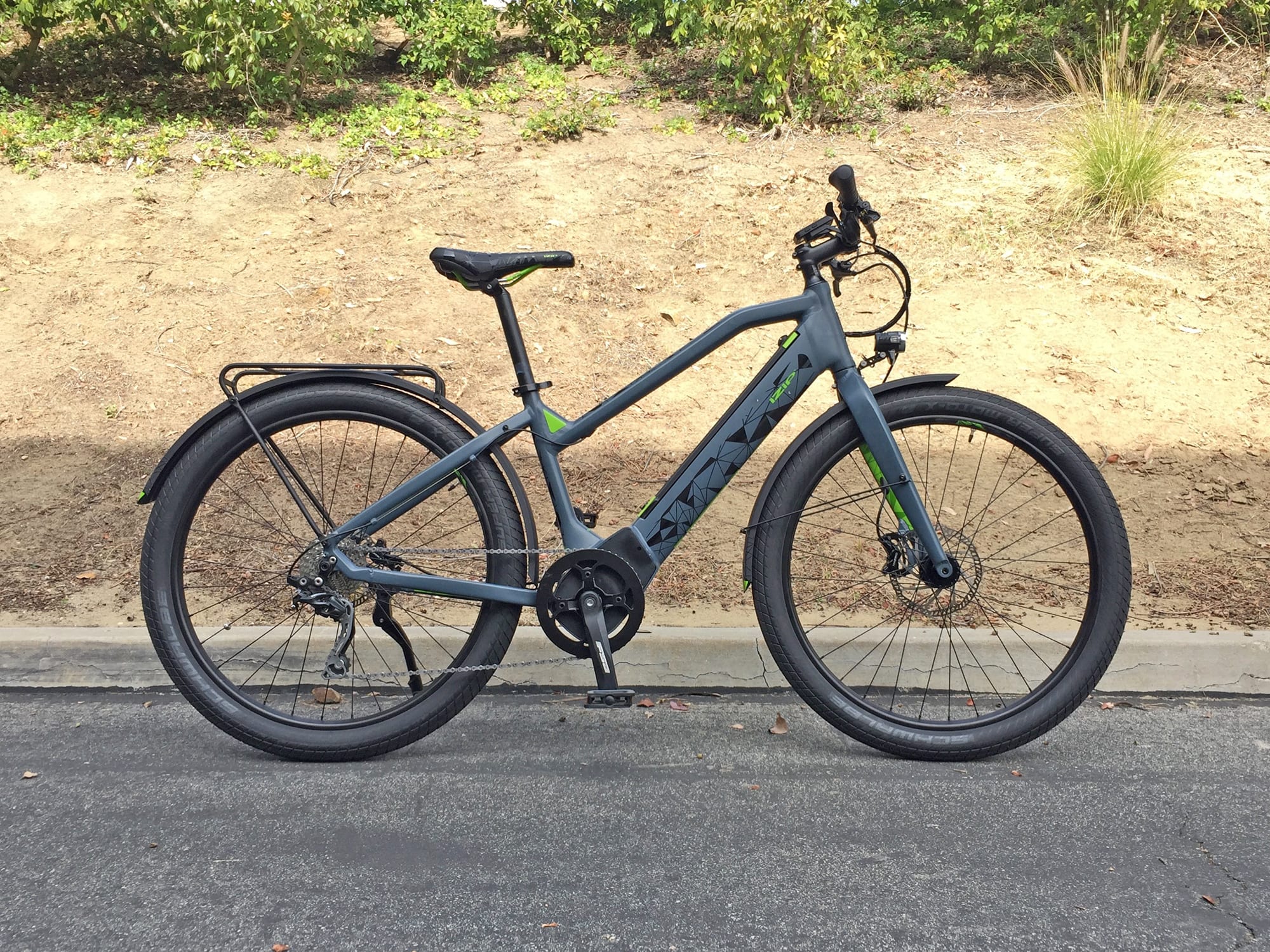

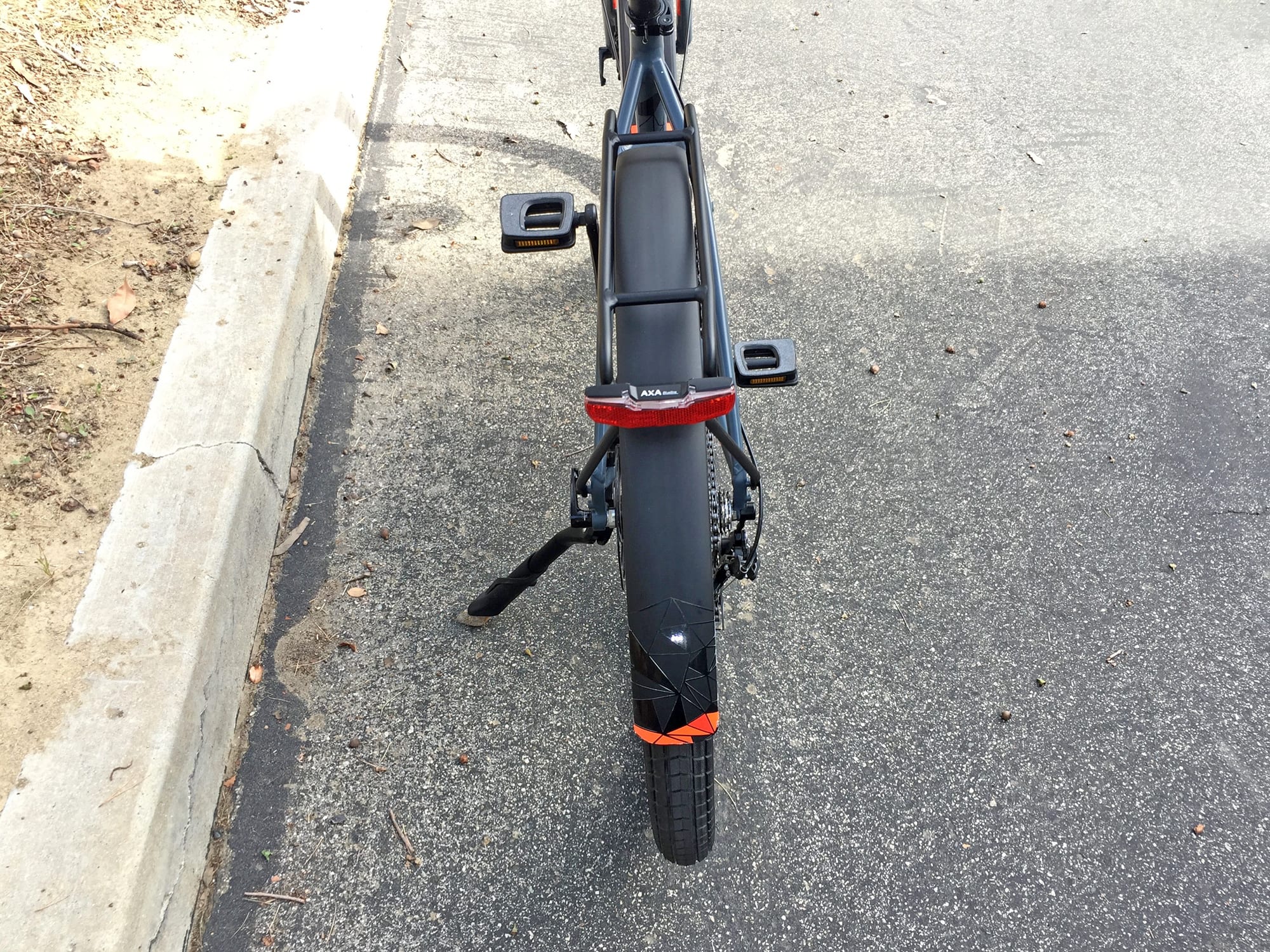

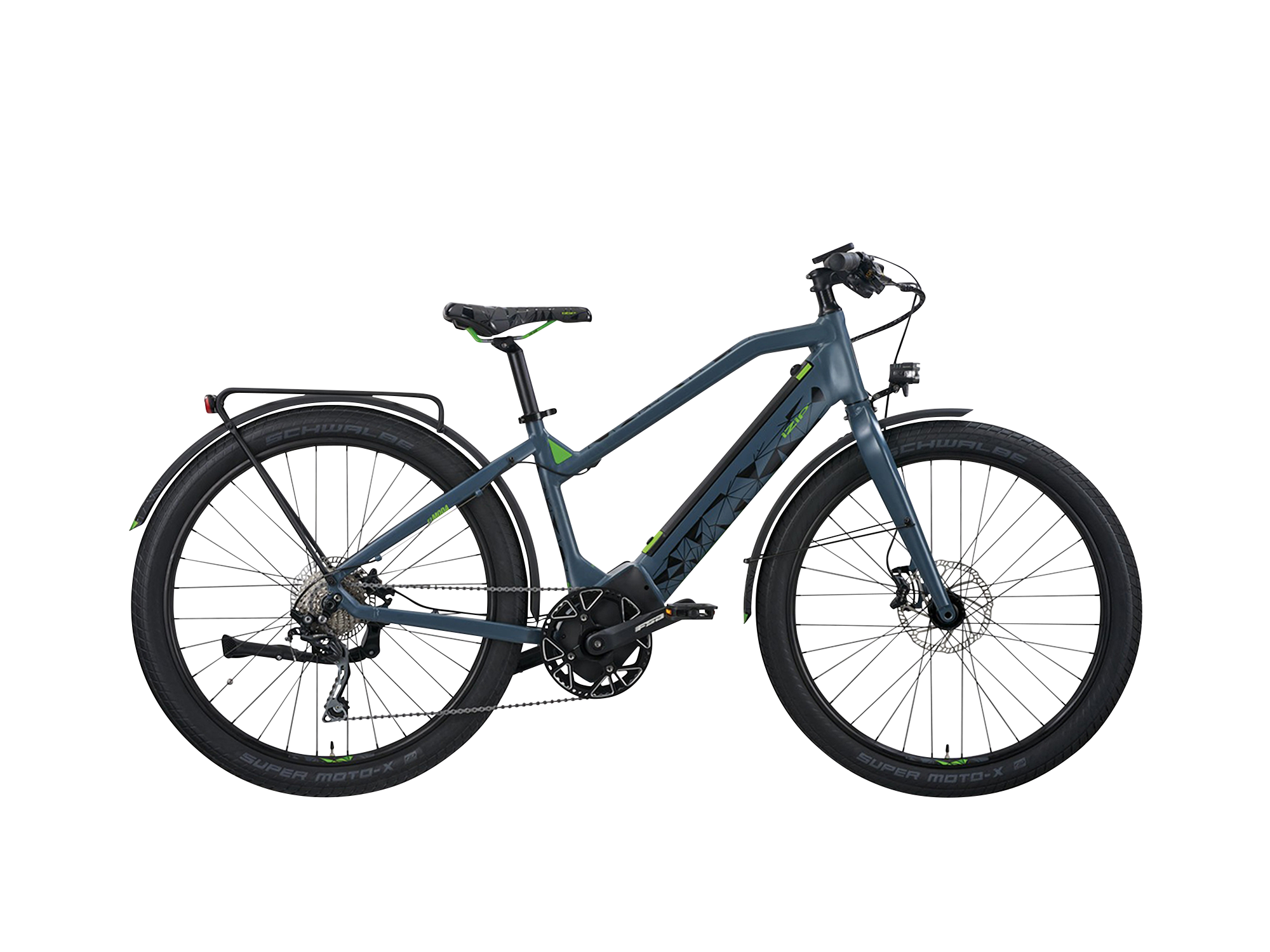

The IZIP E3 Moda is a commuter-ready urban electric bike that comes complete with wide 60 mm alloy fenders to keep you dry, a sleek rear rack for clip-on panniers, and integrated LED lights to help you see and be seen. It’s feature complete, meaning that you really don’t have to add anything to deal with rain or night riding, and it’s a Class 3 ebike, meaning that it can reach top speeds of ~28mph vs. just 20mph for most other ebikes. Priced at roughly three-thousand dollars, the bike is backed by IZIP’s leading two-year comprehensive warranty and growing network of dealers in North America. This product is strikingly similar to the Raleigh Redux iE, because both brands are owned by the Accell Group. Amazingly, the E3 Moda is priced lower than the 2017 Redux iE that I reviewed… and that product didn’t include the fenders, rear rack, or lights. IZIP is a less well-known brand compared to Raleigh, and their products tend to offer additional value and are sold through independent electric bike dealers as well as online through the official website. This electric bicycle uses the trusted Brose TF motor, a high capacity integrated battery pack, and fancy removable LCD display with integrated USB charging port. I love that the step-over model comes with bottle cage bosses on the seat tube, and understand why they wouldn’t quite fit on the step-thru (which is really more of a mid-step frame in my opinion). It’s wonderful to have multiple frame sizes and styles to choose from, and I love how the tubing is reinforced with angular gussets on both the top tube and down tube for strength and stiffness. This is a stealthy electric bike because the battery is hardly visible from the side and the the dark color scheme blends nicely with the compact black motor casing. Furthermore, the Brose mid-drive is tilted up in such a way that it hides behind the 48 tooth chainring. I love that this chainring has an alloy guide to keep the chain on track, and want to emphasize just how quiet and smooth the motor is. It’s one of my favorites.

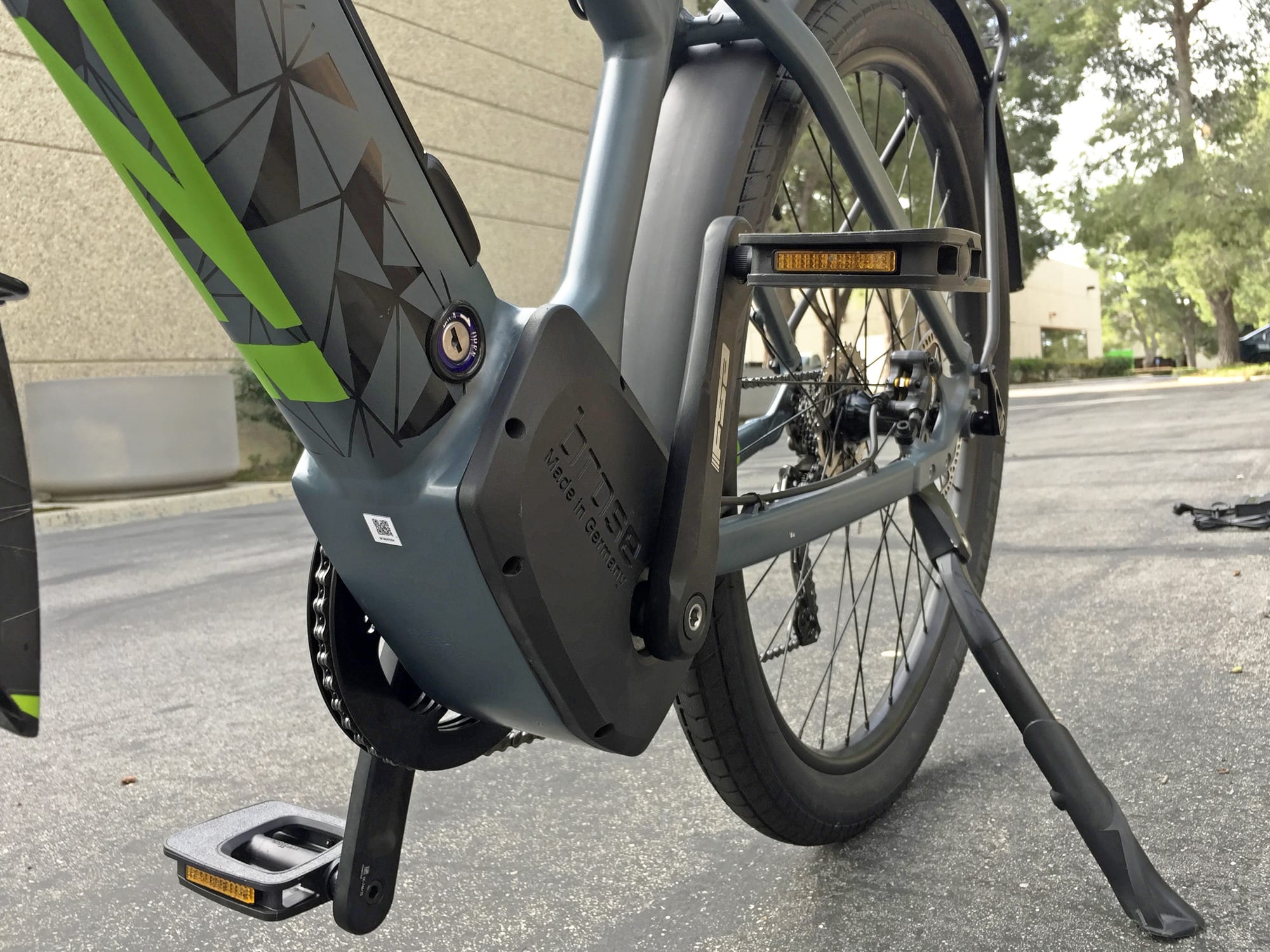

Driving the IZIP Moda is a 350 to 530 watt mid-motor from Brose. It offers an impressive torque output of up to 90 newton meters and can support up to 120 pedal strokes per minute. These specs are very competitive, and my own experience riding on this and other ebikes that use it have been very good. I love how quite and smooth it operates, in large part due to an internal Gates belt drive that transfers power between the gearing system. It feels more natural than the nylon gears of other systems. While the motor does not offer shift detection, like Bosch, it does respond quickly when you ease back on pedal force. The motor controller measures rear wheel speed, pedal cadence, and pedal torque. I have found the pedal torque signal to be the most noticeable, meaning that if you only pedal lightly, the motor will only activate a little bit. The Brose TF stands for Trekking Fast and designates the higher speed output potential. At ~7.4 lbs, it’s average in terms of weight, and that weight is positioned well at the low-center point of the frame. Both the front and rear wheels feature quick release, which is one of the big benefits of utilizing a mid-drive vs. a hub motor system. It’s very efficient because it leverages the gears that you shift through as a rider… just ease off a bit when shifting so you don’t mash the sprockets and derailleur as demonstrated in the video review above. The bike comes stock with a mid-level Shimano Deore 10-speed drivetrain, but the spread is only 11-32 tooth vs. 11-36 or 42 tooth. When combined with the larger 48 tooth chainring, it’s really designed for medium and high speed riding, and you don’t really have the low gears for steep climbs. That shouldn’t be an issue given the higher torque potential of the motor and smooth efficient tires, but I wanted to call it out. There’s also no one-way clutch system to tighten the chain and reduce bouncing, and I didn’t see a slap guard on the right chain stay of the demo bikes. The trigger shifter mechanism worked very well, with two-way action on the high shifter and three-shift action on the low shifter. All in all, the drivetrain is good enough, but probably one of the areas where they compromised a bit to keep the price point low.

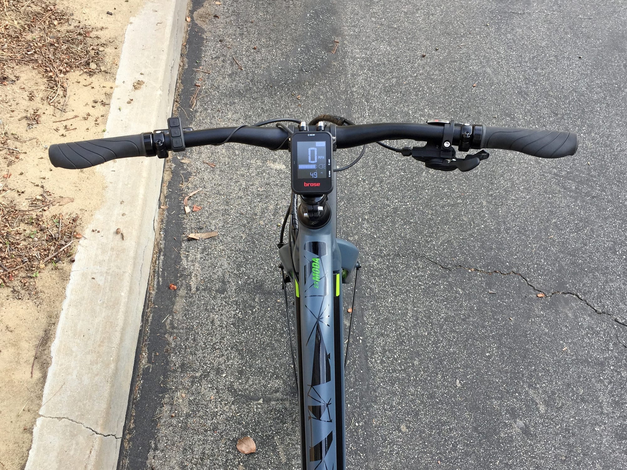

Operating this bike is fairly intuitive in terms of button and display arrangement. The display is large, clear, and mounted high in the center of the handlebar, making it easy to read. I have done an in-depth guide and video on the display in the EBR Forums here, but will also go into some detail below. Once the battery is activated, the display automatically powers up as well. It’s a grayscale LCD that has a dim mode and a bright mode that activates automatically whenever you press the navigation buttons. It’s handy, and saves power this way while also reducing distraction at night. There’s a power button at the top right edge of the display that basically puts it to sleep but does not de-activate the battery, you can accomplish that by holding the button for several seconds. On the right edge of the display, there’s a light button that power on the headlight and taillight. If you hold the light button in, it will cycle to automatic mode, which uses a built-in sensor to switch the lights on and off as you ride. Just below the light button is a menu button that cycles through readouts, and this button is duplicated on the remote pad which is mounted within reach of the left grip. On this button pad, the center circle button is what changes menus. Above the circle is an up arrow and below the circle is a down arrow. These arrows let you navigate through three levels of assist (Cruise, Tour, and Sport), or you can go all the way down to Off and then hold the down arrow to activate walk mode. I love that the bike has a functional walk-mode because some big companies have disabled it on their US products. The walk assist only goes up to ~4mph (~6km/h) but is useful for pushing the bike if you get a flat tire or have to climb up a steep section of trail that isn’t rideable. For an electric bike like the E3 Moda, that weighs 52lbs without cargo, it could be especially useful when the bike is also loaded with gear. All in all, this display is elegant, simple to use, and offers more precise battery charge level feedback than a lot of competing devices. You get a 10-bar infographic with each bar representing a 10% step. The Brose Classic Original display is removable, easier to find and replace than some custom proprietary solution, and provides most of the menus I like, but didn’t seem to have a dynamic range estimate like Bosch, Shimano, and some others.

- The IZIP E3 Moda is a great platform for sporty urban commuting, it has bottle cage bosses (on the step-over frame), a sleek rear rack, alloy fenders, and integrated LED Lights that run off of the main battery! I especially like how the headlight is aimable and has windows on the sides for increased visual footprint

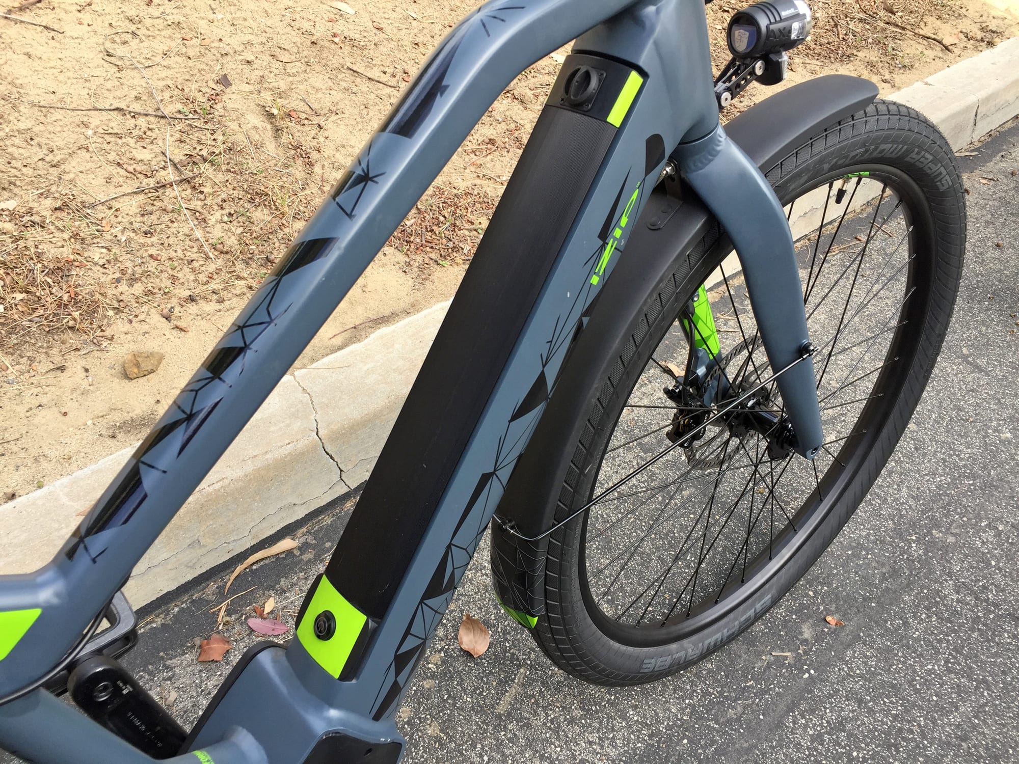

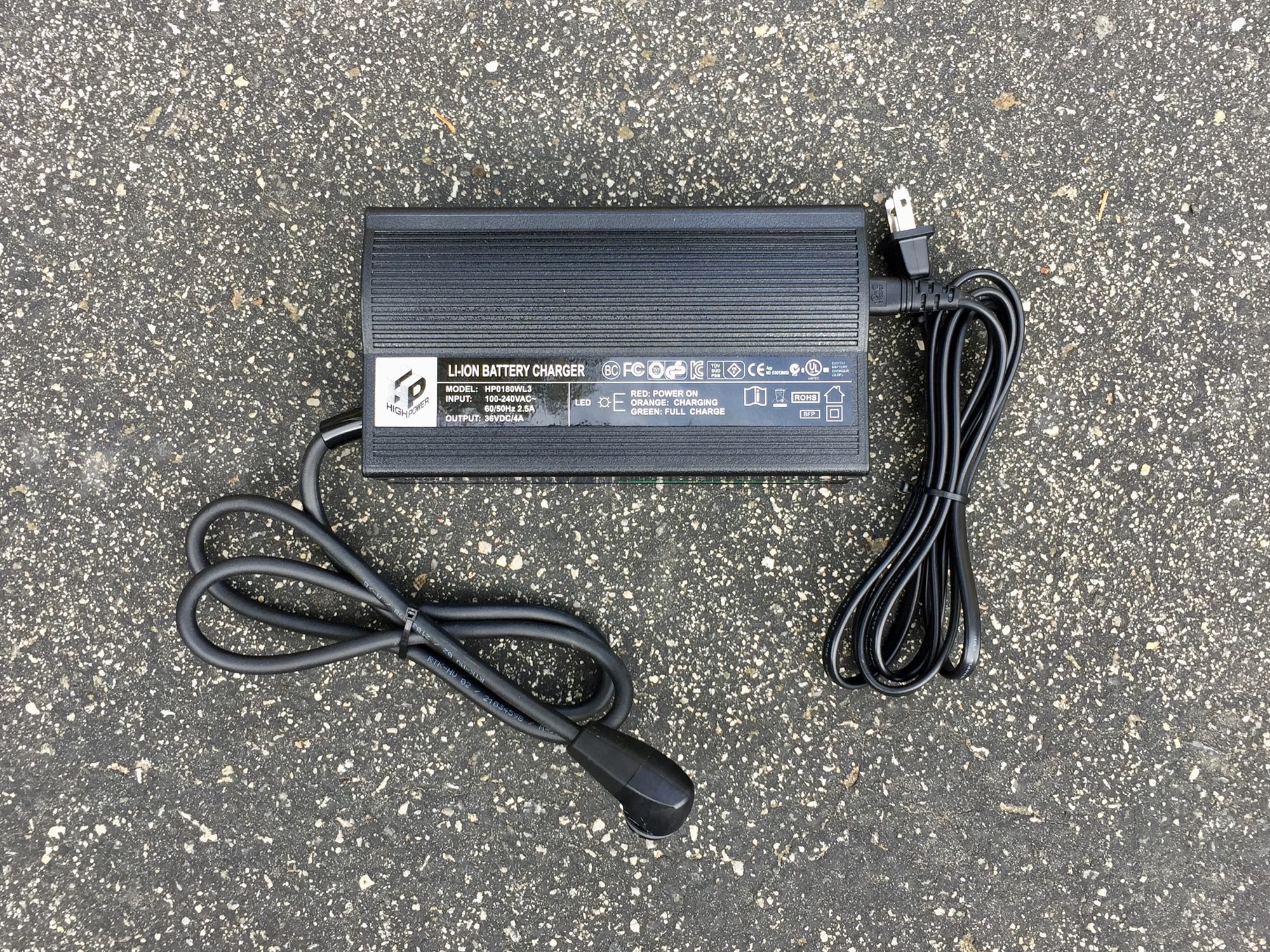

- Comes with a high capacity 500 watt hour battery pack that fits beautifully into the downtube for protection and excellent weight distribution, the 4-amp charger will top you off quickly on longer commutes

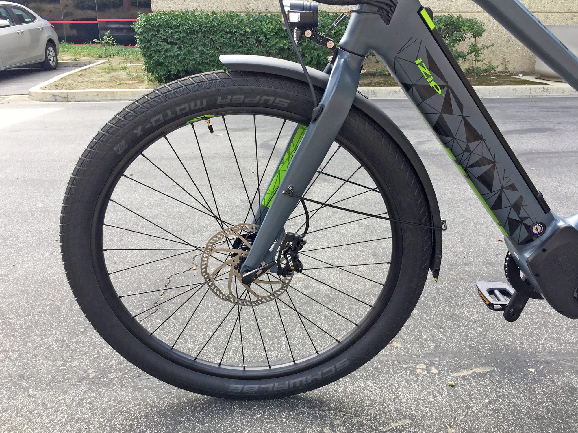

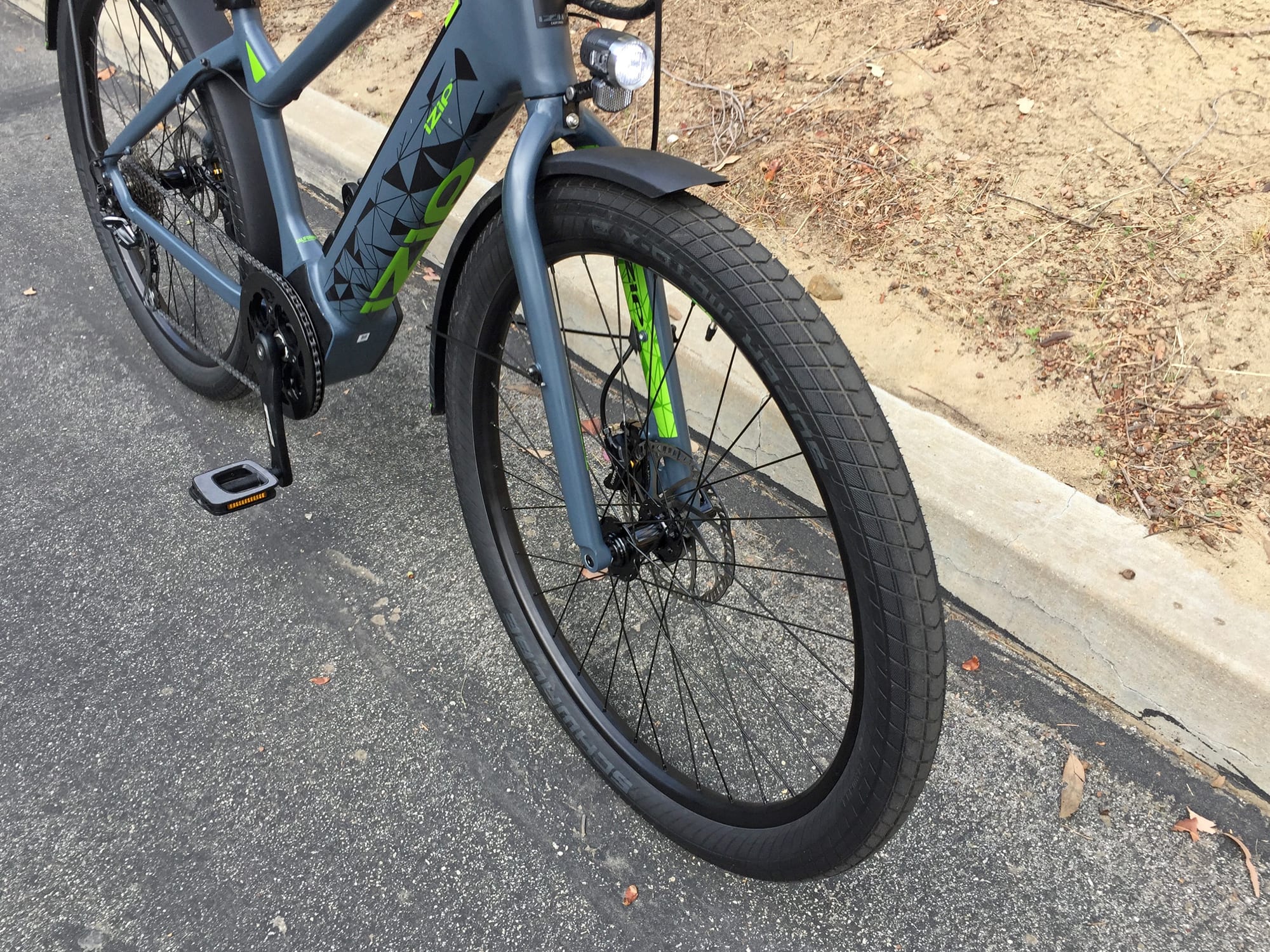

- Thru-axles keep the wheels stiff and support larger tires, this allows you and the motor to transfer energy more efficiently into the bike, it handles well and feels stable with the larger 2.4″ wide Schwalbe Super Moto-X tires

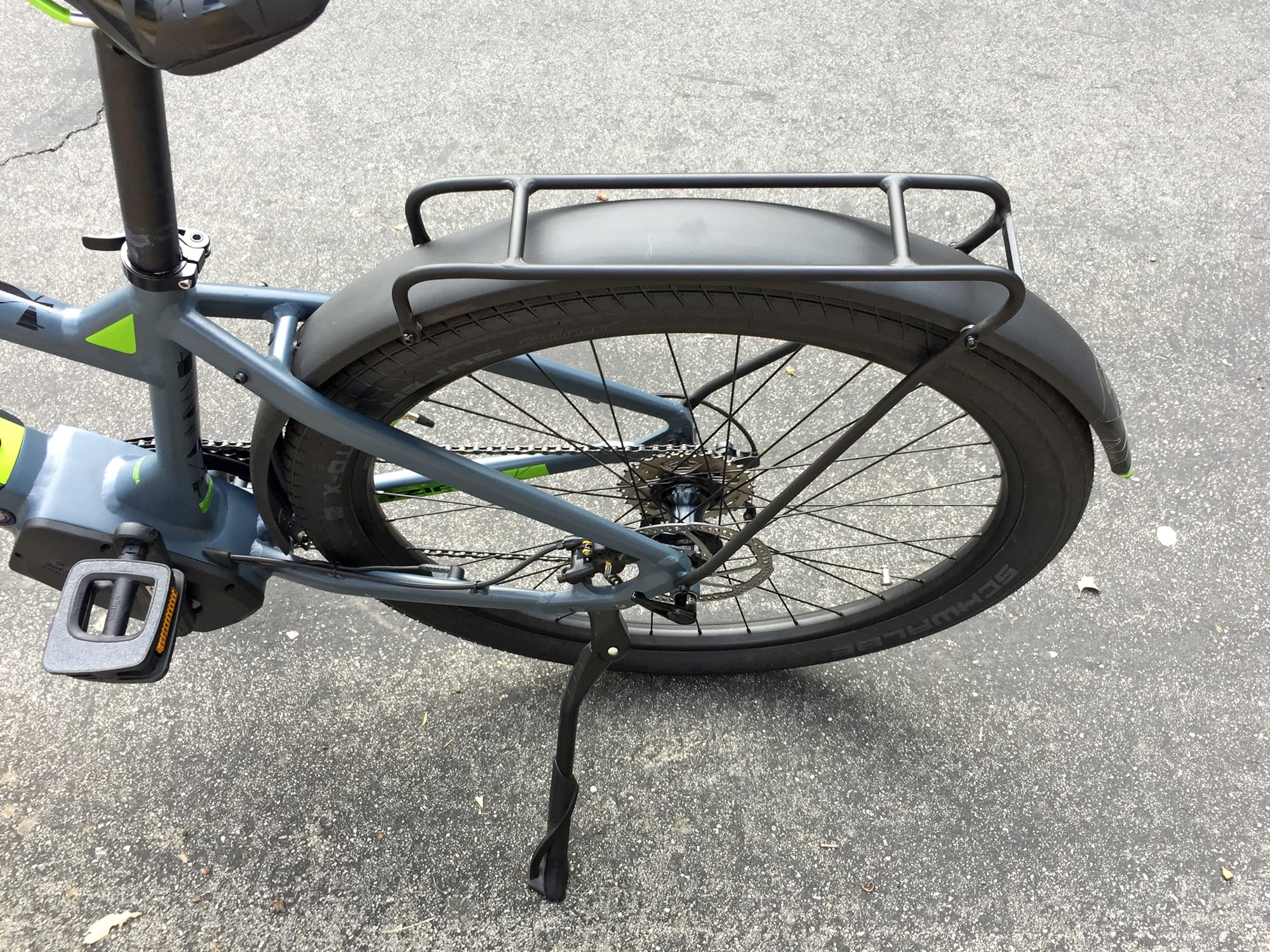

- Minor detail, but I like the kickstand they chose because it stays out of the way and looks nice, it’s slightly fatter than other stands and holds the bike up well, this is great if you’ve loaded the rear rack with bags and gear

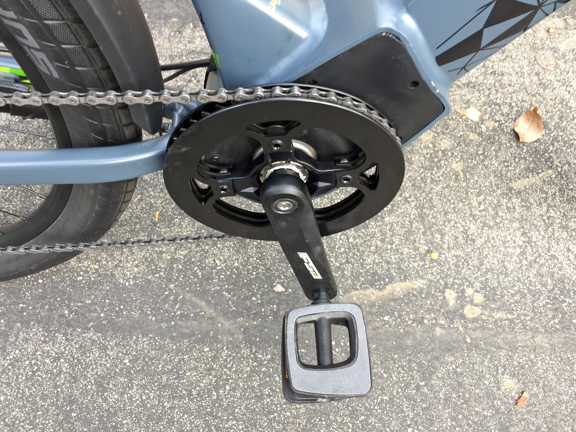

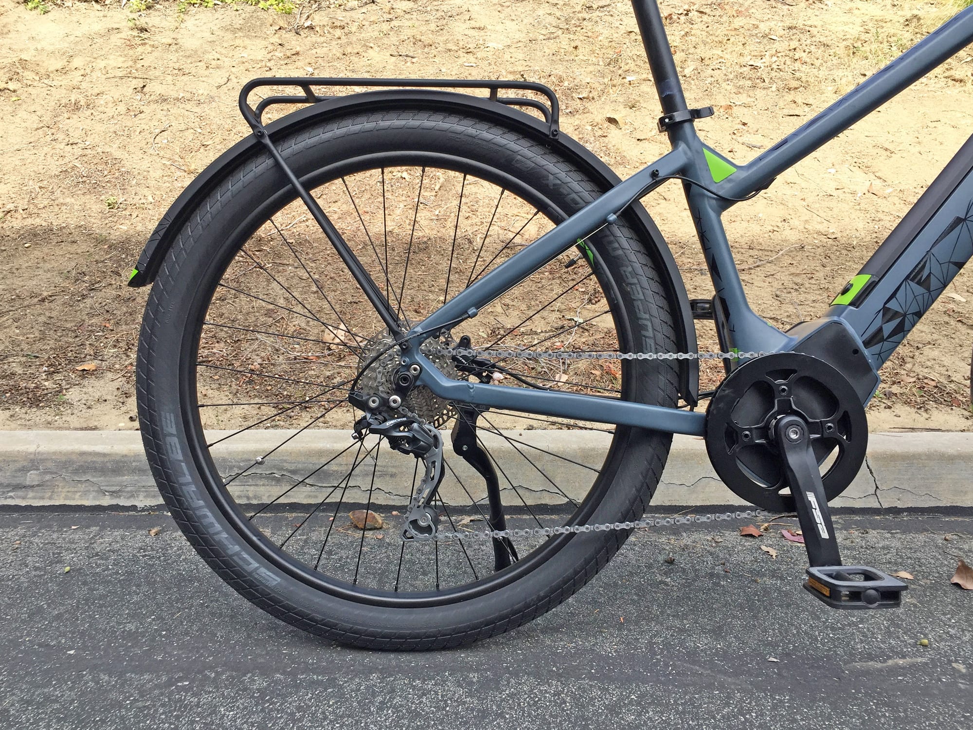

- Some electric bicycles are notorious for dropping the chain while riding on rough terrain (my Uncle owns the Stromer ST1 Limited and it falls off all the time for him) but IZIP has used a chain guide (two plates sandwiching the chainring to keep the chain on track) so this won’t happen… and the guide doubles as a chain protector to keep pants clean

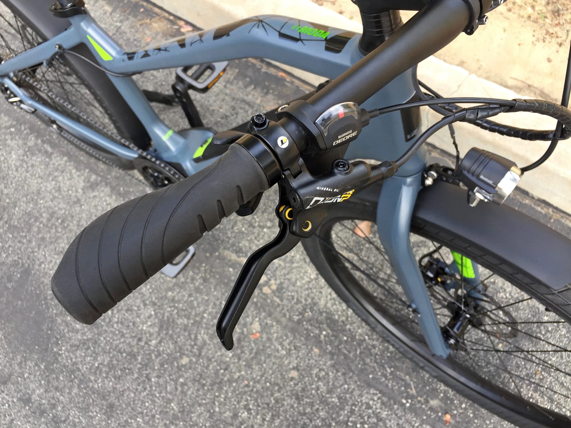

- Hydraulic disc brakes offer good stopping power and the adjustable reach levers are good for large and small riders with different length fingers (or if you wear gloves), love the larger 180mm front rotor with quad-piston calipers for applying force and dissipating heat faster
- The Brose motor is relatively quiet and smooth thanks to a Gates carbon transfer belt inside, it’s not just plastic and metal gears interfacing with each other

- I really appreciate how the battery pack seats in from the top vs. the bottom of the downtube because it’s less likely to drop and generally easier to work with here, I also like side-mounting batteries for this reason
- The display panel is large, easy to read and comfortable to use because of the remote button pad located near the left grip, you can adjust assist without looking down as you get some practice
- Both wheels offer quick release for easier maintenance and transport, though the fenders would still stick out a bit so you can’t lay the bike on its side with the bar turned quite as easily as other products

- IZIP left walk mode enabled, just arrow down to no assist and you’ll see this little arrow on the right side of the speed readout, all you have to do is hold the down arrow and the bike motor will run a few miles per hour to help you push the bike (which is great, since it weighs ~52 lbs)

- I did not see a range estimator menu like some of the other ebikes are offering but do appreciate the 10-bar battery infographic, it’s more precise than the 4 or 5-bar menus that are common

- I tend to prefer metal pedals with pins for maximum power transfer and grip, the plastic pedals with sandpaper texture were okay, but not what I was expecting for a higher speed Class 3 ebike, I’d probably replace them with some lightweight magnesium Wellgo platform pedals like these
