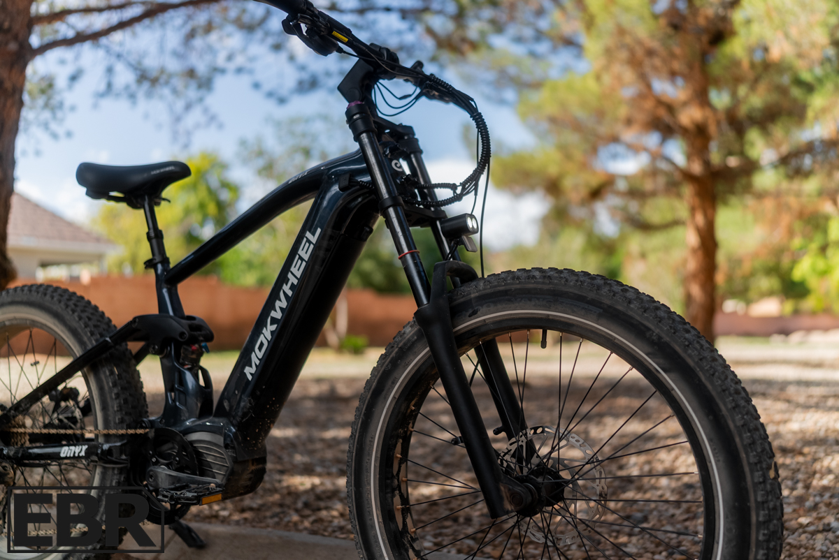

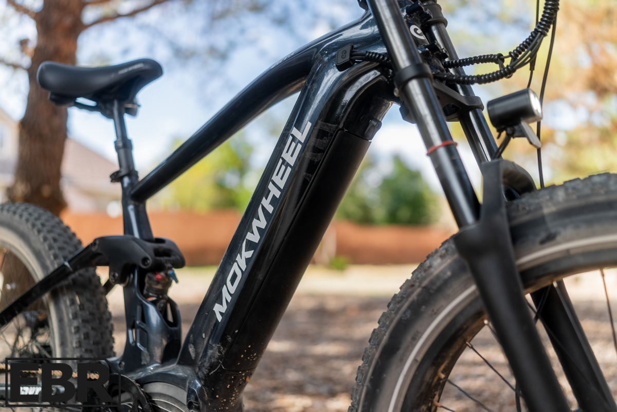

The Onyx arrived at our office in that signature Mokwheel blue-black, and it looks right in line with the rest of their power station lineup, same aesthetic language, just scaled up appropriately. The larger frame tubes are there to handle the bigger battery, but it’s not like they redesigned the look from scratch. The new stem display is clean and nestled nicely into an adjustable mount so you can dial in your viewing angle. Add those chunky 26×4″ fat tires and yeah, this thing looks ready for action straight out of the box.

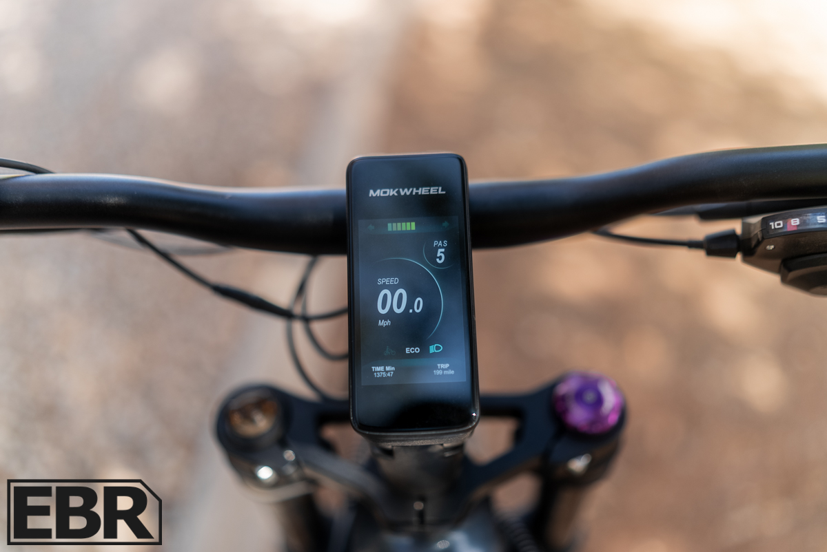

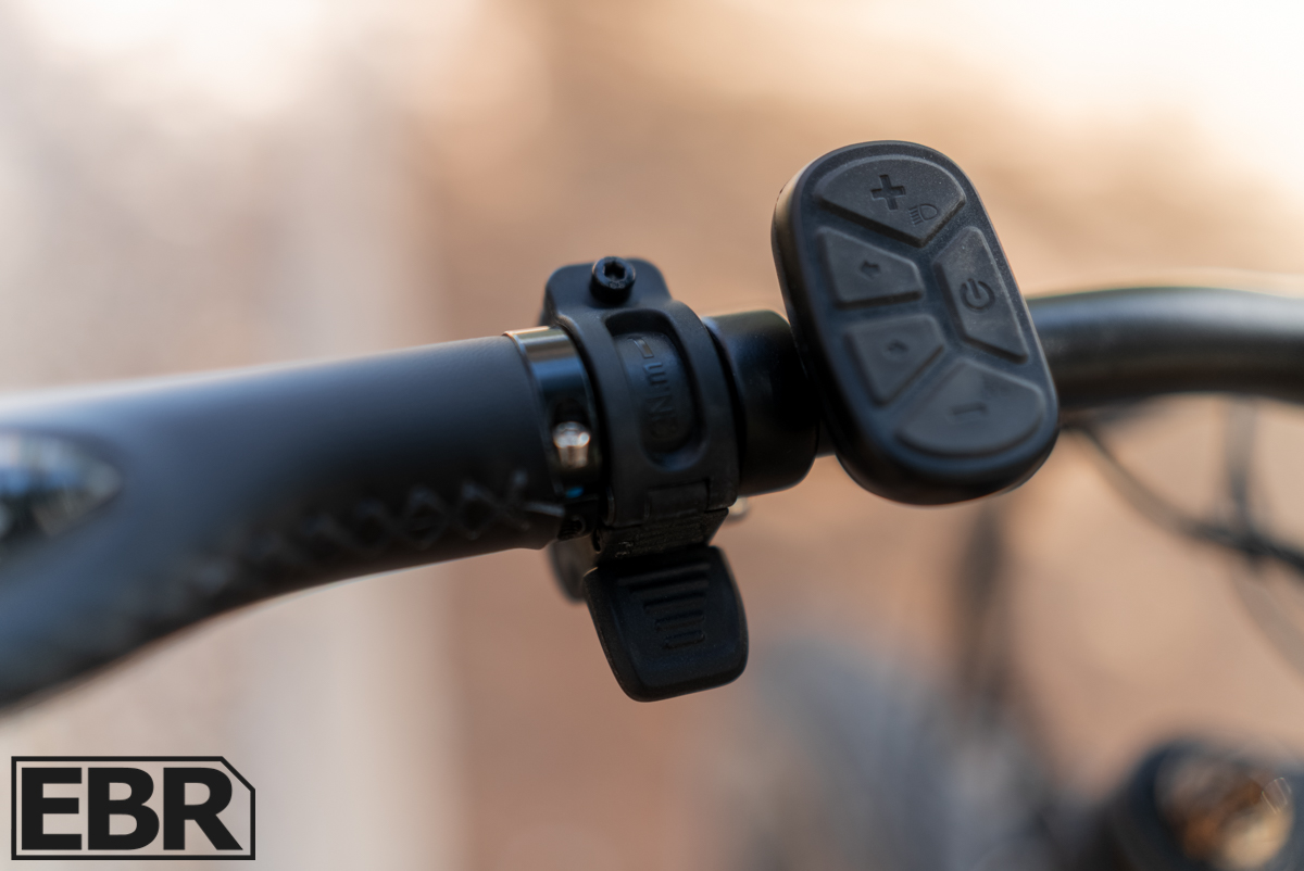

In terms of how the motor performs, Mokwheel tucked into the settings the “intensity levels 1-5”, separate from your standard PAS 1-5. You access them by holding the left and right arrows on the control pad for a few seconds, and they adjust overall motor response and aggression. The bike ships at intensity level 3, right down the middle. Drop to lower levels and it’s perfect for new riders or anyone not chasing speed. Crank it to 5 and you get the full motor personality. But even at level 5, there’s still that reserved off-the-line acceleration, they’ve protected the drivetrain against sudden motor dump right from a standstill, which sounds smart in theory and plays out even better in practice. Most riders don’t think about how sensitive mid-drive components are to aggressive power delivery, and this approach prevents you from cooking your chain or cassette in a few months of spirited riding.

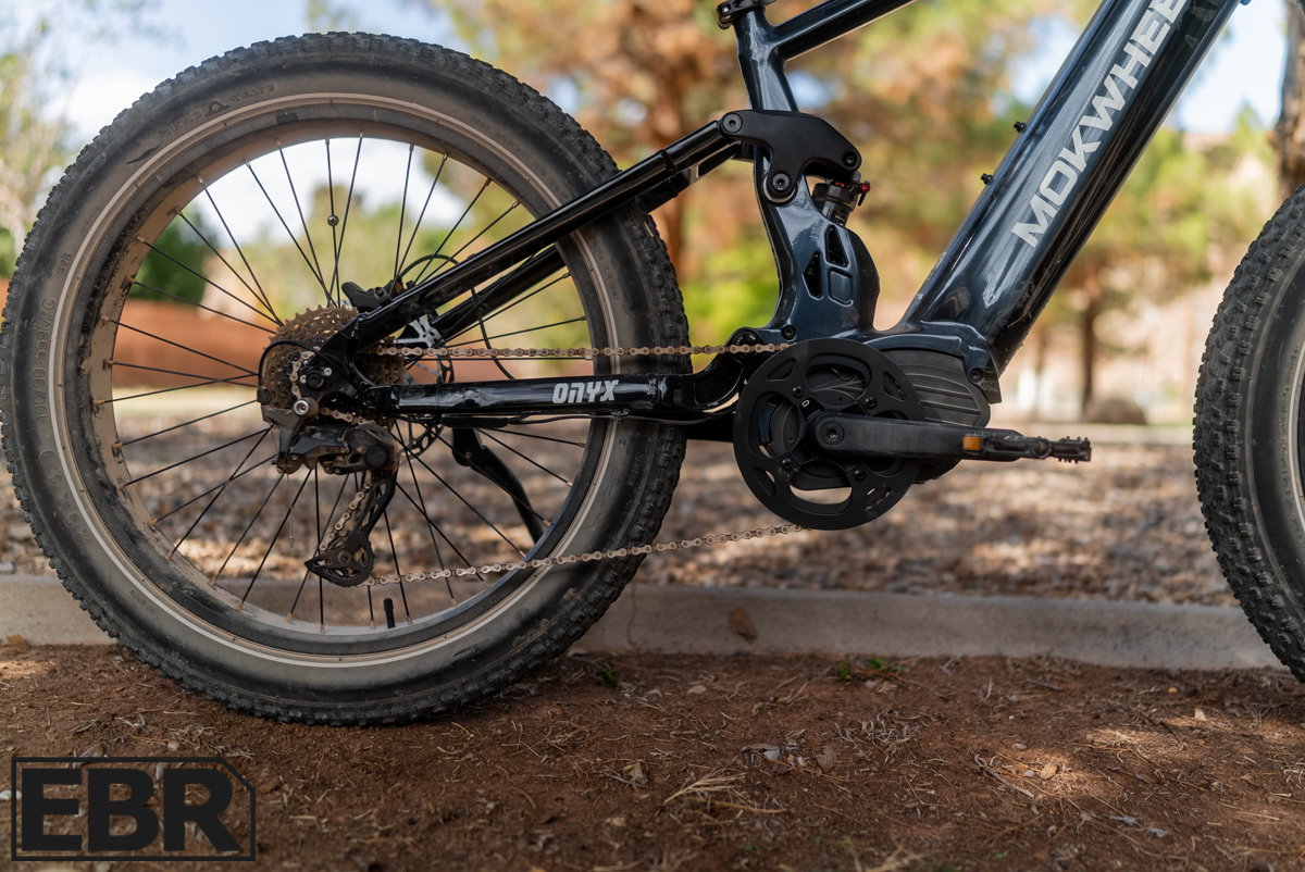

The Onyx is powered by a TruckRun mid-drive motor that’s rated at 750W nominal with a 1300W peak output and 210Nm of torque. That’s a healthy amount of power, and it shows when you’re climbing or dealing with real terrain. The motor uses both a torque and cadence sensor, which gives it a more natural, responsive feel compared to pure cadence-only systems. You can run it in PAS 1 through 5, and Mokwheel lets you dial that down to 3 levels if you prefer fewer options. It’s a nice bit of flexibility depending on your riding style.
What’s interesting is how Mokwheel programmed the power delivery. The motor is legitimately powerful, but it’s tuned to hold back a bit off the launch in lower PAS levels. That’s actually smart because it keeps the torque spike controlled and protects the drivetrain from unnecessary stress. You won’t feel like the bike is babying you, but you also won’t get that jarring surge that can wear components faster. It’s a solid balance between capability and longevity.
The battery is a 941Wh pack (48V, 19.6Ah) built to UL 2271 standards and weighs 10.9 lbs. It’s housed internally in the frame, which keeps the look clean and protects it from the elements. The included charger is advertised as a 3A fast charger, but here’s the thing. If you actually check the back of the charger, it’s a 2.6A unit. It’s not a huge deal in the real world, but it’s worth knowing if you’re planning on frequent charges between rides. Either way, combined with that mid-drive efficiency we saw in our range testing, this battery setup gives the Onyx some genuinely impressive longevity on a single charge.

The drivetrain is where you start to see the Onyx separate itself from Mokwheel’s other fat tire offerings. It runs a 1×10 setup with Shimano’s newer CUES derailleur, which is a meaningful step up from the cheaper Tourney or Altus derailleurs we usually see on budget e-bikes. The CUES has significantly better chain retention thanks to its more robust design compared to the flimsy springs found on lower-tier shifters. The cassette runs 11-39t paired with a 44t chainring, protected by a single-sided chain guard that keeps things tidy without overdoing it.
What makes the CUES especially smart on an e-bike this powerful is the integrated shift sensing system. You’ll see the sensor mounted along the chainstays, and it works by detecting cable pull. When you shift, the sensor tells the motor to cut power for about a second, just long enough for you to make the shift safely without fighting the motor’s brutal 210Nm of torque. That’s the kind of thought that keeps drivetrains from getting shredded. That said, I did notice the sensor would occasionally cut the motor during rough offroad riding when I wasn’t actually shifting, likely from cable movement caused by impacts and bumps. It only happened occasionally, but it’s worth noting.

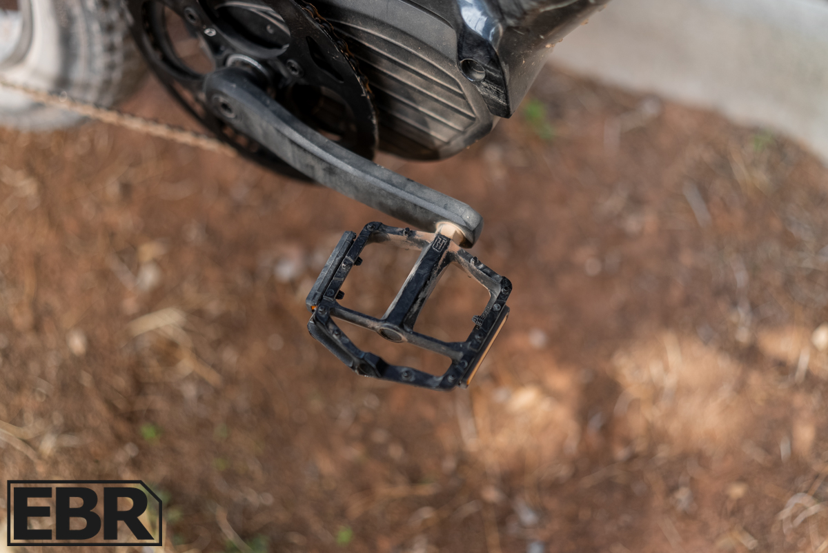

The cranks are 170mm aluminum and the pedals are alloy flats with traction studs and reflectors built in for visibility. Simple, functional, and they get the job done.

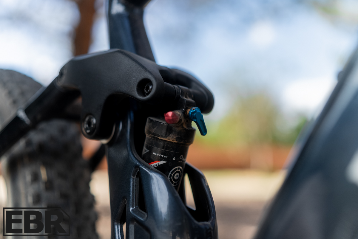

The rear shock is where things get interesting. It’s an air shock with lockout and adjustable air pressure via a Schrader valve that maxes out at 275PSI. At my body weight of 180 pounds, I found 180PSI gave a really nice ride feel. The rear shock is a genuinely useful addition that punches well above its obscure brand name. Combined with the frame’s linkage setup, it delivers performance that exceeds expectations.

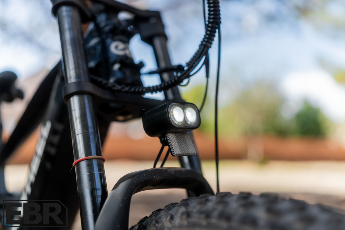

The front LED light is mounted and hardwired to the bike with an adjustable angle bracket, which is the right way to do it. The rear light is less impressive. It’s a battery-powered unit with a rubber strap that secures it to the seat post. It has multiple modes from flashing to solid, but I found the strap tension never quite held the light in place on rides. I eventually took it off when riding offroad because it would shift around too much to be reliable.

The Onyx rocks a new stem-integrated display for Mokwheel, which is a smart design choice. The display and stem are a single unit, which keeps things clean and minimalist while also giving you 40 degrees of adjustability for fit and ride comfort. The downside is that if you ever want to swap stems down the line, you’re out of luck since the display comes along for the ride. It’s a trade-off between aesthetics and modularity, but for most riders it won’t be an issue.
What I really appreciate is that Mokwheel kept the same operating system design from their other power station e-bikes. There’s no steep learning curve here. The full-color display is really clear and intuitive to navigate. The home screen shows all the essentials: speed, PAS level, battery percentage, trip meter, and odometer. Everything you need at a glance.
If you want to dig deeper, there’s a technical settings menu you can access by holding the PAS up and down buttons for 3 seconds. From there you can adjust screen brightness or set it to auto mode, change your units of measurement, and select from 6 different languages if you need them. It’s straightforward and well organized.
For everyday adjustments like speed limits and intensity settings, you access the function menu by holding the left and right arrow buttons on the control pad for 3 seconds. That menu also gets you into more advanced features like error and fault code checks, serial and firmware numbers, hardware info, and the ability to reset the display if needed. It’s more in-depth than you’d expect from an e-bike at this price point, and it shows Mokwheel put real thought into the software.
