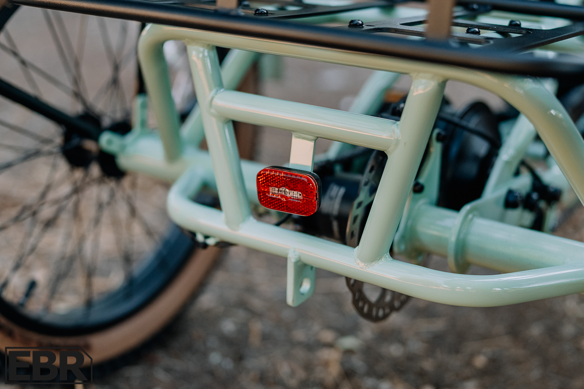

The Star Union hydraulic disc brakes handle braking on the Boca Rev. On the front end, there’s a 180mm rotor and a 2-piston caliper mounted along the fork. In the rear, center-mounted along the axle, an additional 180mm rotor and 2-piston caliper slows both rear wheels simultaneously. What’s all that translates to? Solid braking performance in all three wheels, and the trike always stopped confidently whenever I asked.
Unique to trikes, the Boca Rev also has a built-in parking brake feature that flips a switch up on the brake lever. This is especially handy on a trike design as it never ‘leans’ against a wall or bike stand like its two-wheeled cousins, meaning the trike can quickly roll away on uneven surfaces. So, parking brakes on the Boca Rev was a solid move that will save you some panicked moments….that is, unless you forget to set them before walking away. Panic moments aside, it’s nice knowing we still have it on this trike.

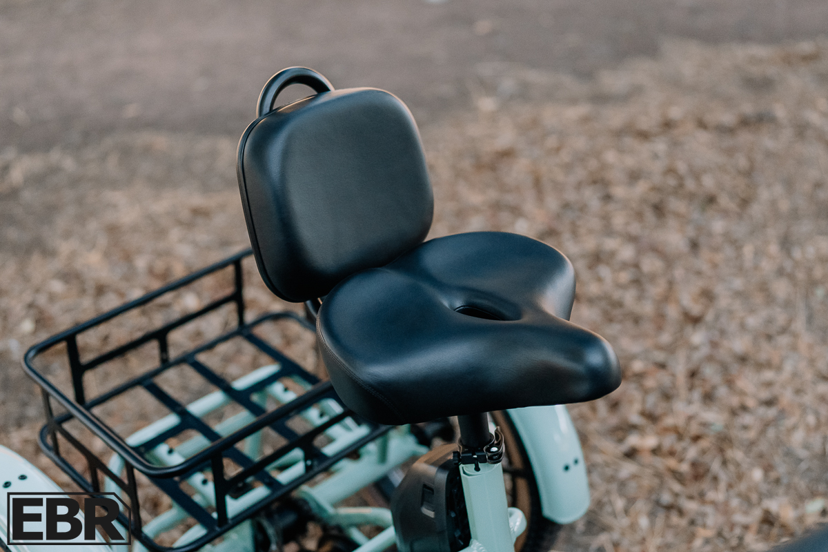

The saddle is a strong point for the Boca Rev, and it’s not uncommon for an e-trike to have a saddle with integrated back support. What is new is just how cozy this seat is. It’s a strong point for anyone who prioritizes comfort, and even better, it doesn’t interfere with pedaling like so many trike seats can do.

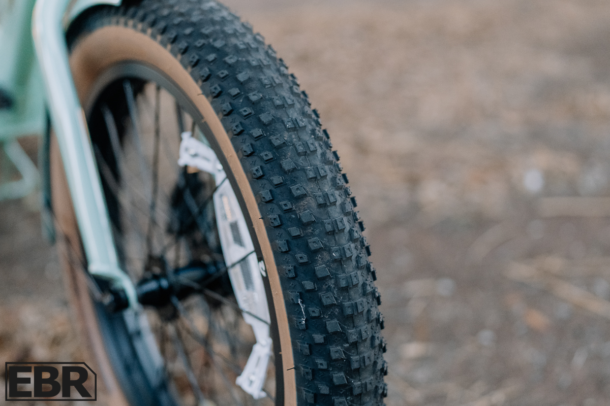

The Boca Rev wheels are 20 inches in diameter and wrapped in a 27.5 x 3″ tire. I gotta say, with tires, I’m always a sucker for gum walls (or tan sidewalls for non-bike nerds) with a mild knobby tread pattern like these Chaoyangs have. Its subtle design choices don’t add cost to the build but still go a long way in the overall aesthetic. This smaller tire size lends to a lower center of gravity that helps maintain stability when riding, even more noticeable in cornering. All three wheels are secured to the frame via bolted axles, so there is no quick-release or thru-axle. Just a heads up.
Oh, and as a bonus, the Chaoyang tires seem a bit more plush than I expected, as the ride on the Boca Rev is genuinely comfy.

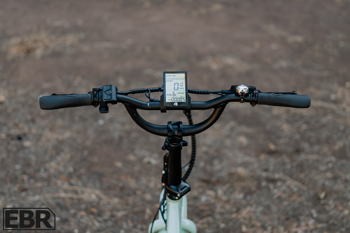

The center-mounted display of the Boca Rev follows its cues from the rest of the bike by giving you everything you need and nothing you don’t.
The display has a duo-tone black and white LCD screen with a font that mimics a calculator. It’s crisp, clear, and easy to read from nearly any angle, even in direct sunlight where some newer, full-color displays struggle, so that’s a win in my book.
The display has all the basic ride data you need at a glance, such as speed, battery level, PAS level, headlight indicator, odometer, and trip meter.
Retrospec does not mention (or clarify) if the display has any IP Water Resistance rating, so I can’t confirm this here, but I have yet to see one that can’t withstand a bit of rain. Just don’t mistake that for full submerging or pressure washers.
All in all, the display on the Boca Rev is an easy-to-use setup that doesn’t take a second manual to navigate. With that said, if you need to tweak any advanced settings (not standard), you will need the manual, as the advanced settings use a code system you can’t guess your way through; trust me, I’ve tried.

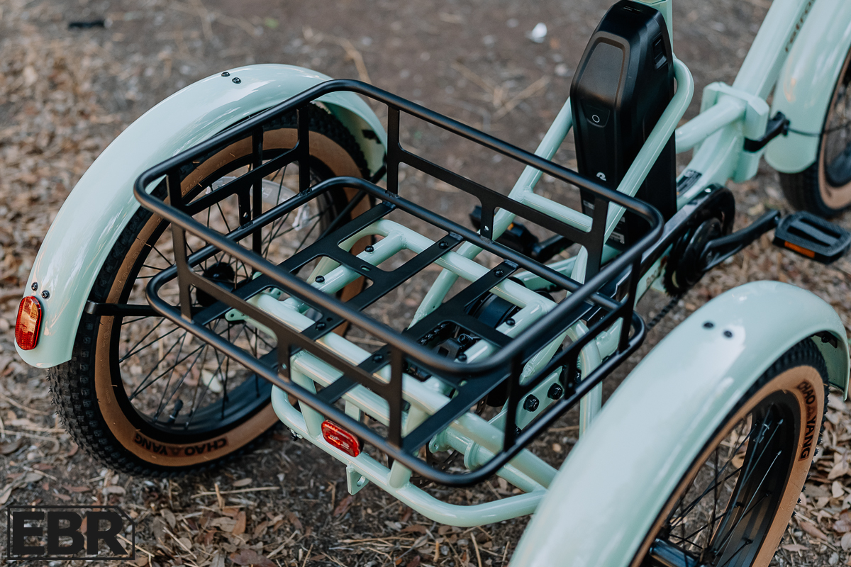

Accessories included at no extra charge are the Boca Rev ‘EverythingBin’, a large alloy basket for the rear cargo area to carry whatever you can think of to fill that 500 lb total max payload capacity. Optional accessories are typical for most bike offerings, a front basket, helmets, lights, bike locks, etc.
