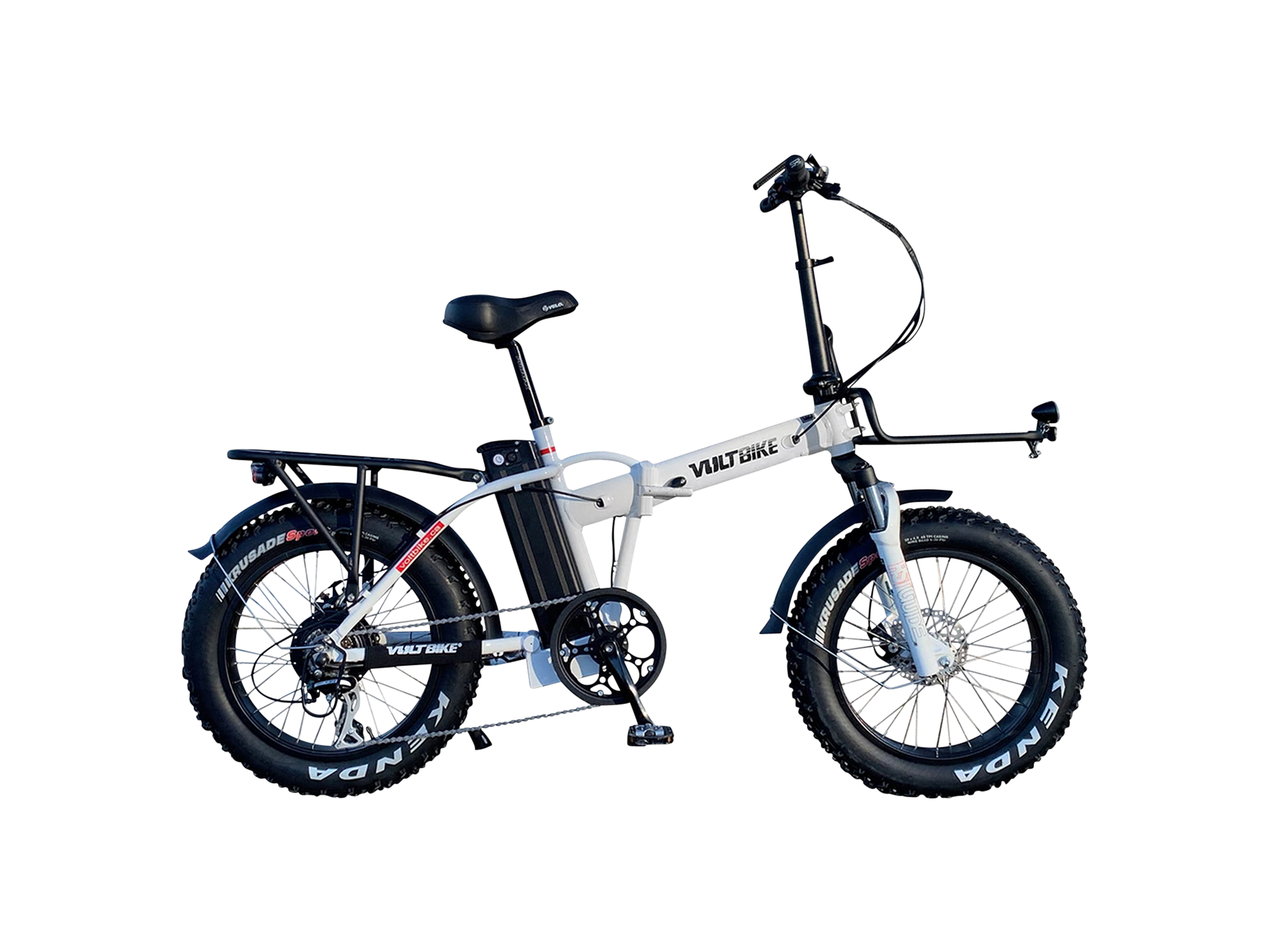

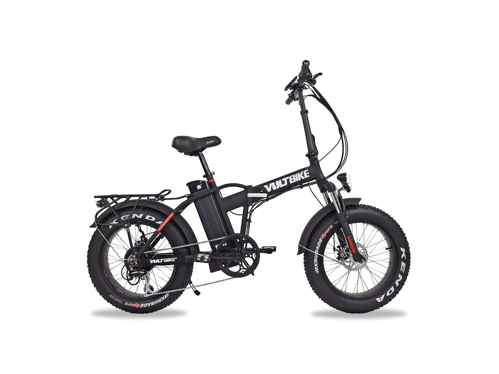

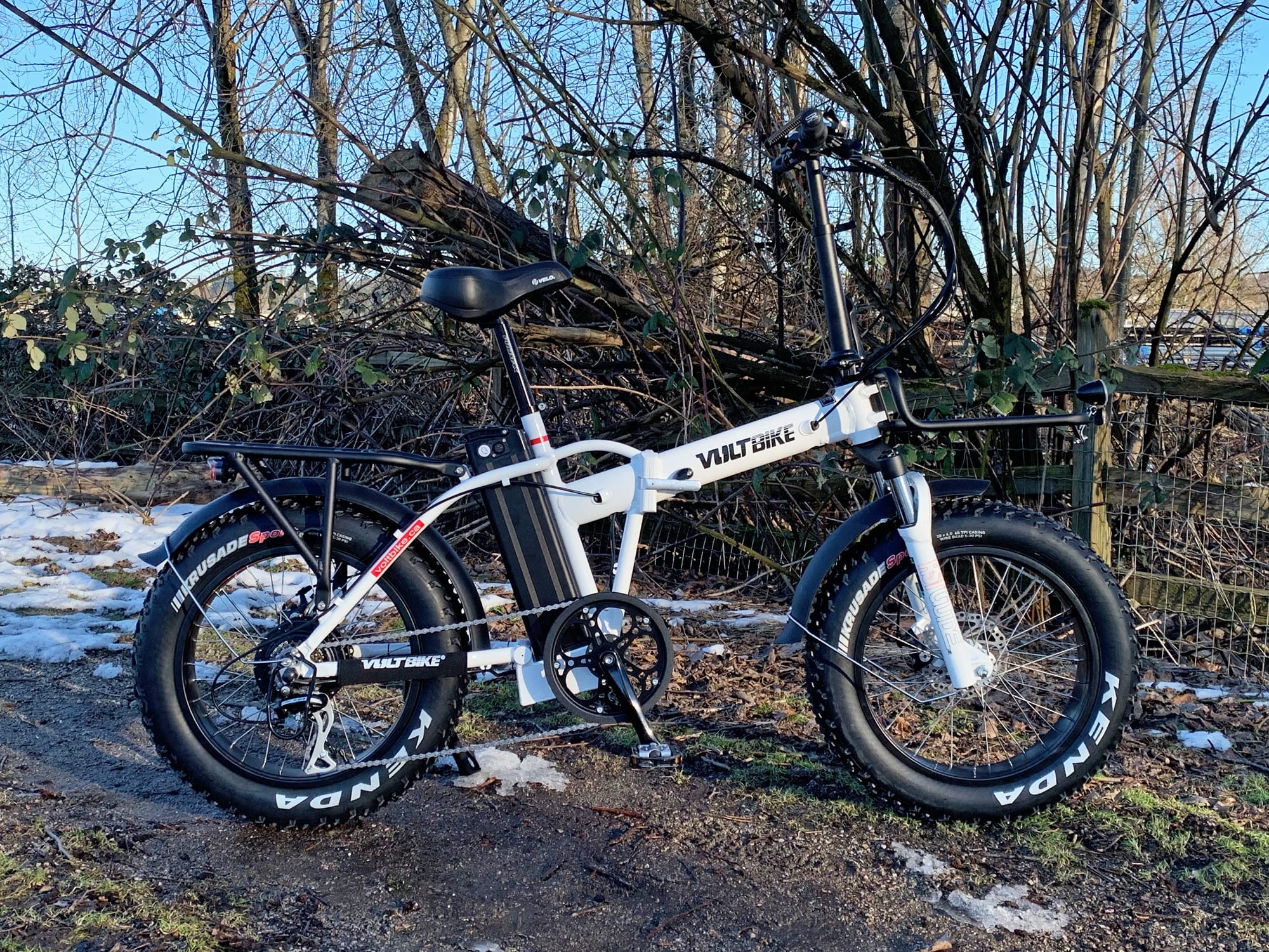

VoltBike has released their new Mariner bike, a hub-drive fat-tire folding bike made to take on just about anything you can throw at it. I was happy to have the chance to review it on a snowy day in Vancouver, B.C., which let me really put it through its paces and see what it was all about. The Mariner is a value priced ebike at $1,599 ($1,699 in Canada) and comes in 2 colors (matte black or gloss white) and 1 frame size. The mid-step frame is very approachable, and these smaller 20” wheels give it a good stand over height. Although there is only 1 frame size, you do get some adjustability with the telescoping stem. Usually when I see these on folding bikes, they can be stretched and strained so that that wires and tight and don’t allow you to make a sharp turn. However, VoltBike supplied the Mariner with plenty of wiring slack in the front to alleviate this problem and I really appreciate it. The Mariner can handle quite a bit, and that is thanks to the Kenda Krusade Sport fat tires with 60 threads per inch casing. As mentioned before, the tires are 20” x 4” and rated for a 5psi-30psi… the lower levels, such as 5psi, really work well on various terrain such as sand or snow, I highly recommend dropping that tire pressure if you want to take it out on adventures because it makes a world of difference. But these tires here keep everything comfortable since each of those little knobs somewhat act as mini absorbers for the bumps on the road. Unfortunately, there is no puncture protection or reflective sidewall here. Assisting the tires with comfort is the front fat-tire specific suspension fork. It looks like it has about 60mm-70mm of travel with some fairly large stanchions. It is kind of a basic fork so there is no lockout, but it does have preload adjust so that helps. I also love these extra thick spokes and 135mm hub spacing, really just making the experience sturdy overall. Looking around the bike I notice that it has this awesome included rear rack. The rack has some really thick tubing, a bungie strap clip point, and even windows for a Yepp! child seat. I do love the internally routed cables, stitched grips, adjustable angle stem, 165mm crank arms, and Wellgo aluminum alloy folding pedals. They also have some optional accessories like a front rack or these waterproof panniers. The front rack is mounted on a mounting point on the steering tube, so it keeps the load straight when you turn the handlebars. However, this does move the headlight forward onto the rack itself so then the headlight will no longer point where you steer. I guess that kind of goes into the next feature, the integrated lights. I love that more and more bikes are becoming standard with these and it really is a nice feature to have it run off the battery power. The Mariner has both an integrated headlight and an integrated rear light as well… the rear light is only 1 LED however, so it kind of can feel like big reflector at times. Other features include an adjustable kickstand mounted in the rear to eliminate pedal lock, integrated bell, neoprene slap guard, and these included steel fenders to keep you dry.

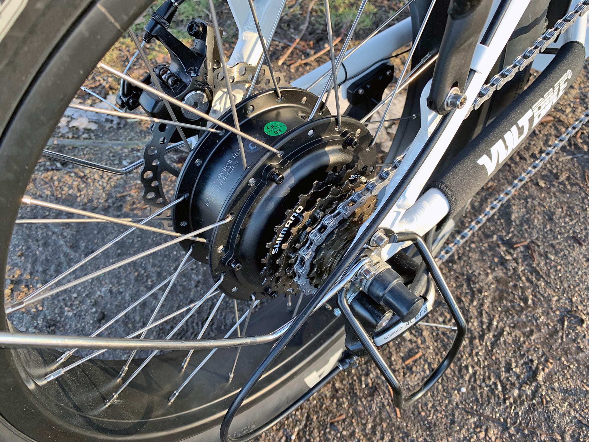

Diving the Mariner is this 500 watt planetary geared Bafang geared hub-drive motor with 9 modes of pedal assist and a twist throttle with throttle lock out via an on/off switch. It has a 12 magnet high resolution cadence sensor, which used to be kind of a premium setup, but nowadays it is considered somewhat older technology. Compared to todays top of the line systems, it tends to feel sluggish because it has this very pronounced on or off feeling, so I recommend using the throttle to ramp up your speed if you want that smoother feel. It kicks up to 20mph with no problem and stopping is nice since they also equipped it with motor inhibitors. On the mechanical side, they have a 6 speed Shimano Acera derailleur which is a step up from the typical entry level derailleurs I usually see on value priced ebikes. I love that it has a derailleur guard too, that really helps protect these systems in the shipping process of if the bike gets knocked over. It has a 14-28 tooth on the cassette… not the best for climbing but is fine for cruising around the city. In the front you have a 52 tooth chain ring which kind of compensates for that low range cassette. A thumb shifter is here, and I have never been a big fan of these, but I understand if you have a twist throttle attached, sometimes the thumb style shifter is the only option for the engineers to mount a shifting system. Stopping the Mariner are these 160mm rotor mechanical disc brakes with motor inhibitors. 160mm may not sound like the largest setup, but it works well given the smaller 20” diameter wheel size since you don’t need that much stopping power.

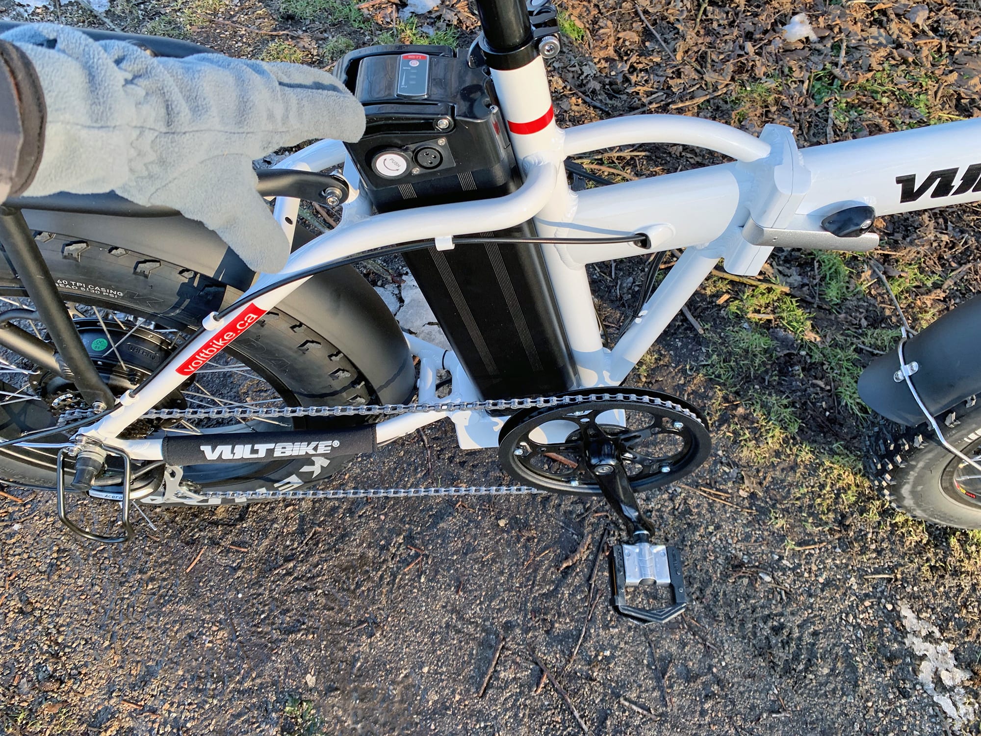

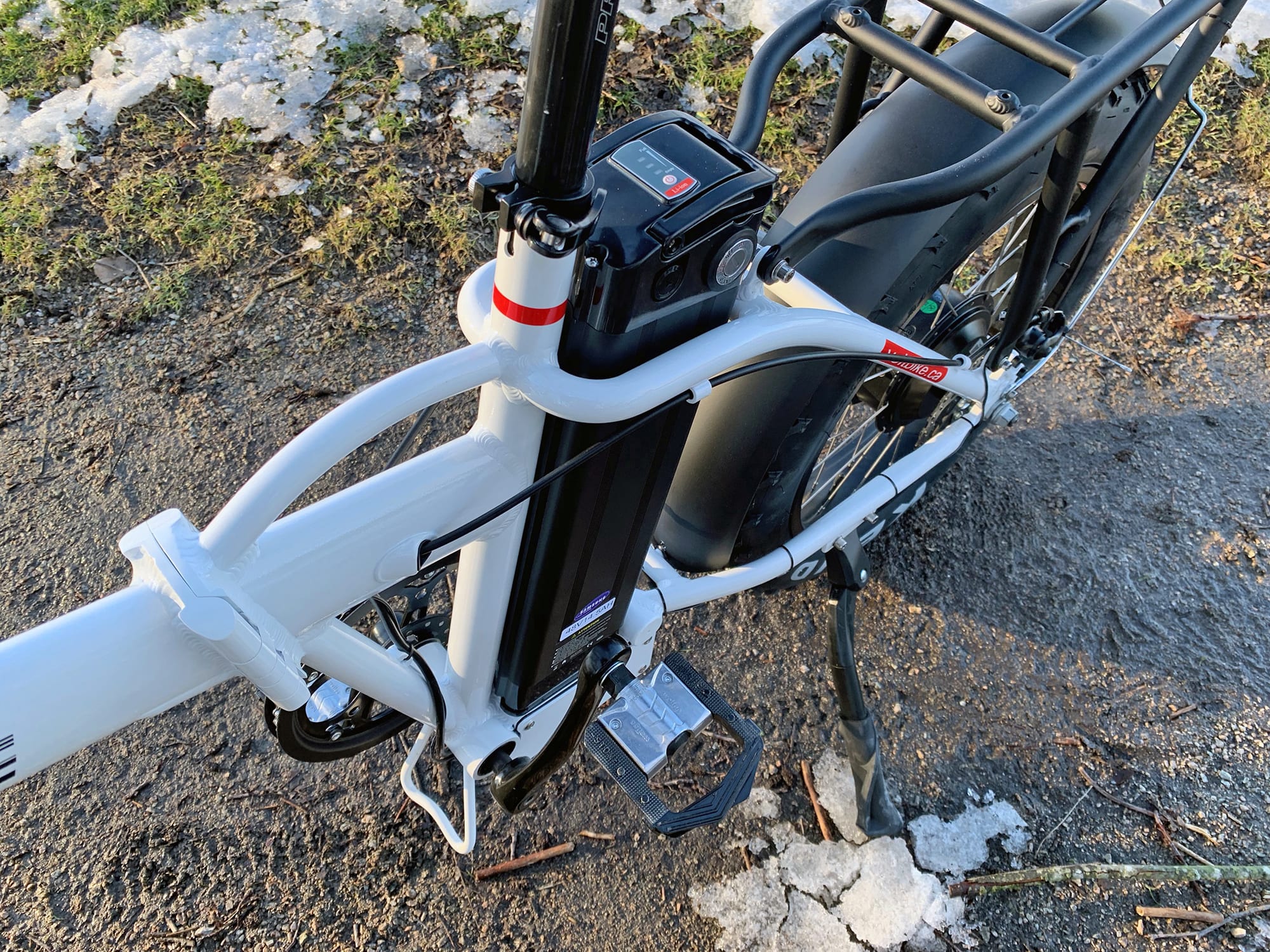

Powering the VoltBike Mariner is a 48v 14.5ah lithium ion battery pack. I would consider this a high capacity battery with that 14.5ah rating. The amp hour designation refers to how long the battery can perform at its peak, while the volts act as the peak itself. With a rating such as this, it would be able to go the extra mile and then some. The battery has an LED charging indicator, weighs 9.2lbs, and mounts behind the seat post. The bike is setup very well, but most of my gripes have to do specifically with this battery. Mostly, you must have the keys in at all times to operate it, so it can be annoying to have them jingle and bounce around. In addition to that, you have to take the seat all the way off if you want to remove the battery and charge it off the bike. Charging is done with this 1.5lb 2amp charger. To really care for this and other lithium-ion packs, I have heard that storing in a cool dry location vs. extreme heat or cold will extend the life and try to keep it about 50% full when not using for long periods so you won’t stress the cells. Try not to let it run down to zero, because that’s really hard on the cell chemistry.

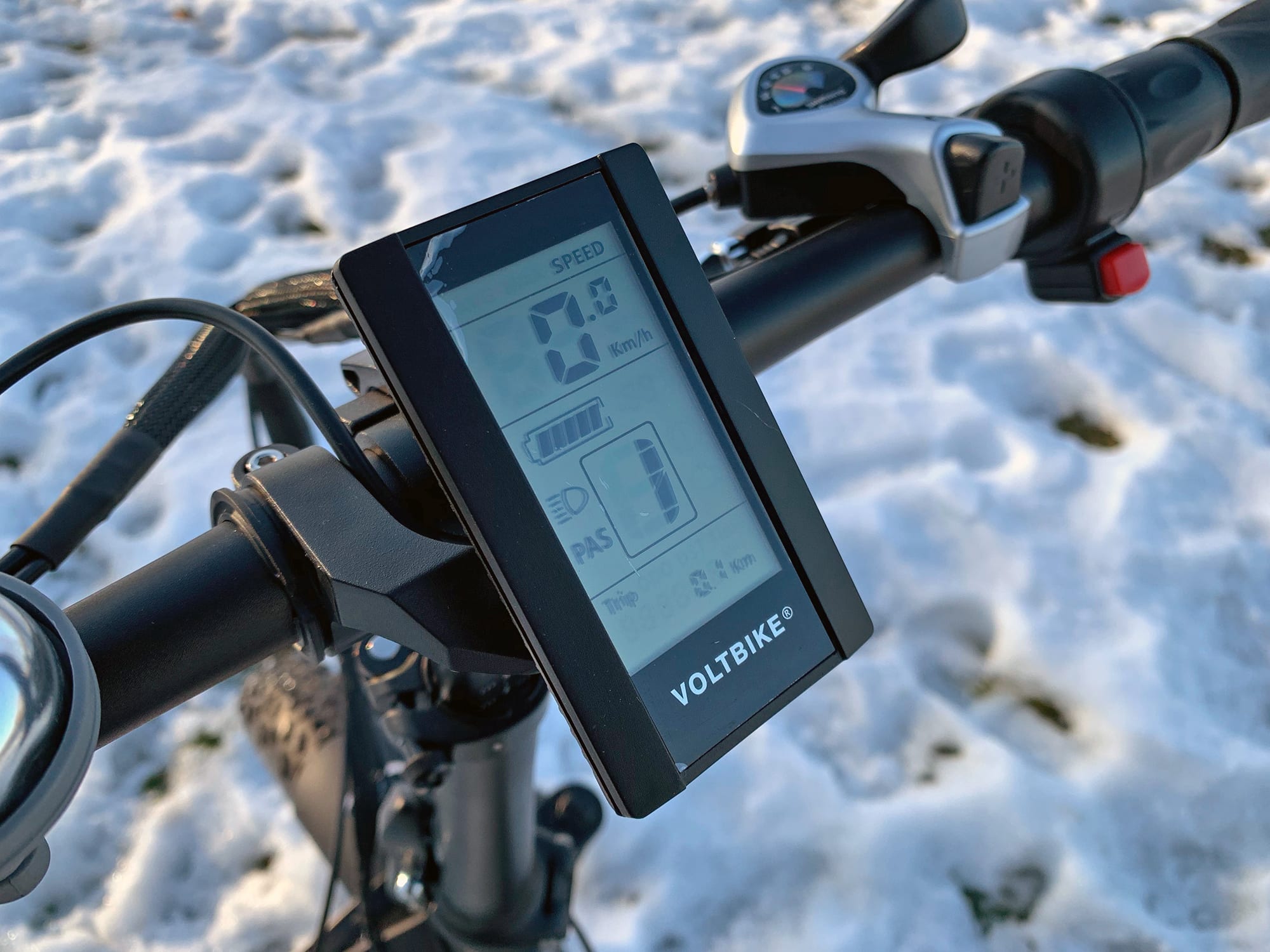

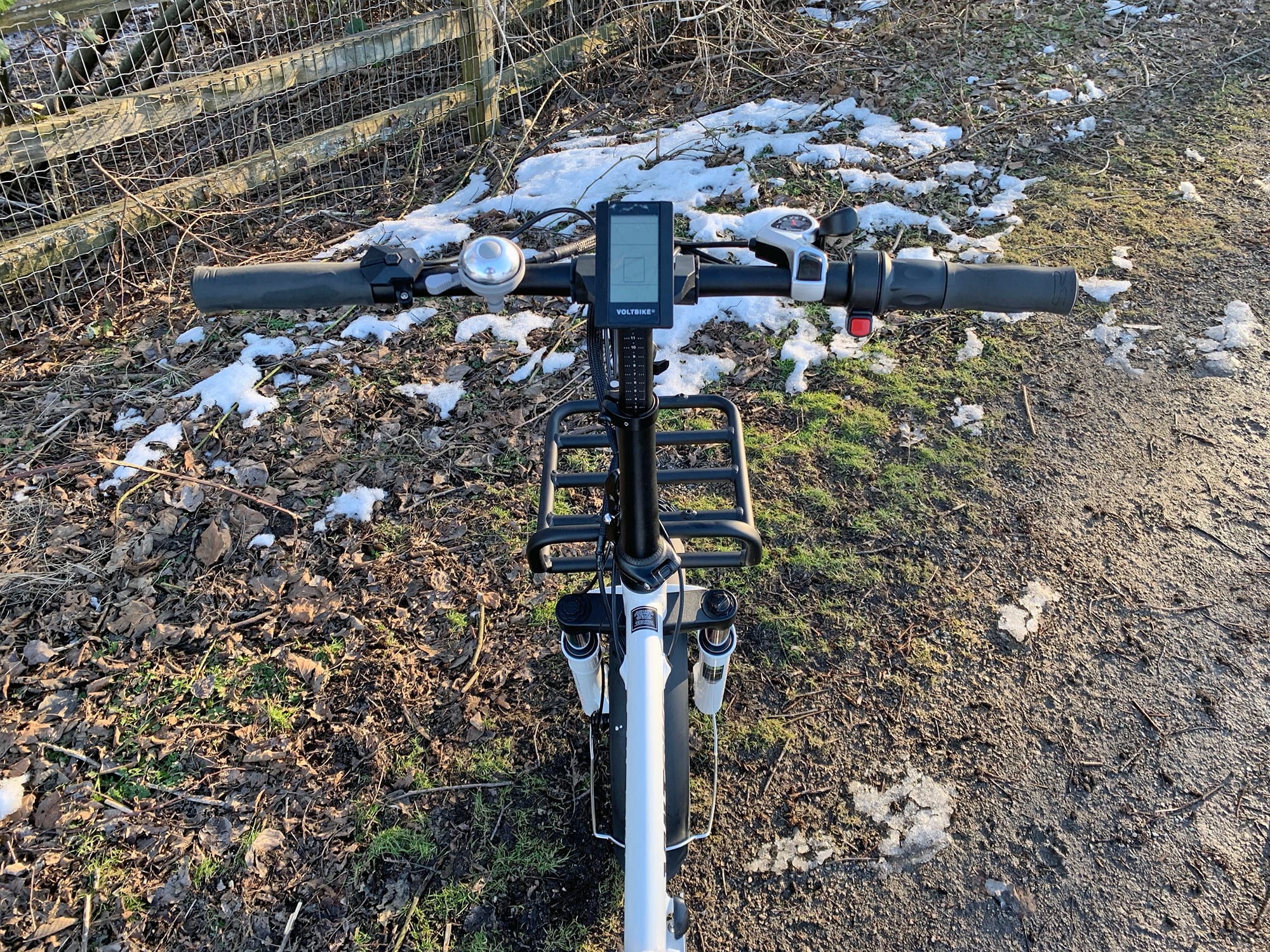

Operating the VoltBike Mariner is straightforward, in fact, it’s using the exact same display system and button pad as before. The LCD is large, backlit (if you hold the up arrow), and adjustable angle to reduce glare. It is not removable, but there does appear to be a disconnect spot for easy replacement if you experience damage at some point down the line. All of the standard readouts about current speed, battery capacity, and assist level are shown, and if you tap the power button (the little rubber button on the remote pad) it will cycle through advanced readouts like average speed and max speed. Holding down on the button pad activates walk mode, and double tapping the power button opens a menu where you can adjust the maximum speed of the bike, though you’ll need a password from VoltBike to do so. This cold be handy for people who want to ride slower for safety reasons… but you can always just arrow down on assist for less power. The real consideration is how fast the throttle will get you going, because it’s always offering up full power when pushed all the way down. I was able to reach just over 20 miles per hour in the highest assist level during my tests. I would have been happy with a 5 level assist vs. 9 because I don’t love clicking through so many levels when trying to focus on riding. At least the display is within reach and easy to learn (there are only three buttons). After a bit of practice, it’s easy to click up or down without even looking at the display for feedback. The one thing I have noticed about this particular button pad is that if you snag the buttons with fabric or somehow bump them when parking, the plastic cover can get bent up and become vulnerable to breaking off. I have only seen this once, but I have never seen the rubberized buttons get broken, so I consider it a point of consideration and extra care.
All in all, the Mariner is a great bike if it falls under your consideration, but there are some tradeoffs I should mention. For example, I noticed that when folding and unfolding, you have a set of wires that run through the main tube that could become pinched if not careful. Also, when folded, the bike cannot be walked quite as easy as some of the other competing folding bikes currently out there and there are no straps or magnetic claps to keep it folded. Probably the biggest tradeoff however would be with the battery. You have to keep the keys in at all times to operate it leaving them to bounce around and make noise. And finally, the seat itself must be removed if you wish to take the battery off the bike to charge it. All these may seem like nitpicking, and for a bike priced at $1,599, it is hard to fault. VoltBike offers not only top notch support, but also a free helmet with each bike purchase! Truly a capable bike that is well supported by a caring company as you can see by my factory tour. I would like to thank VoltBike for inviting me out to check out their lineup.

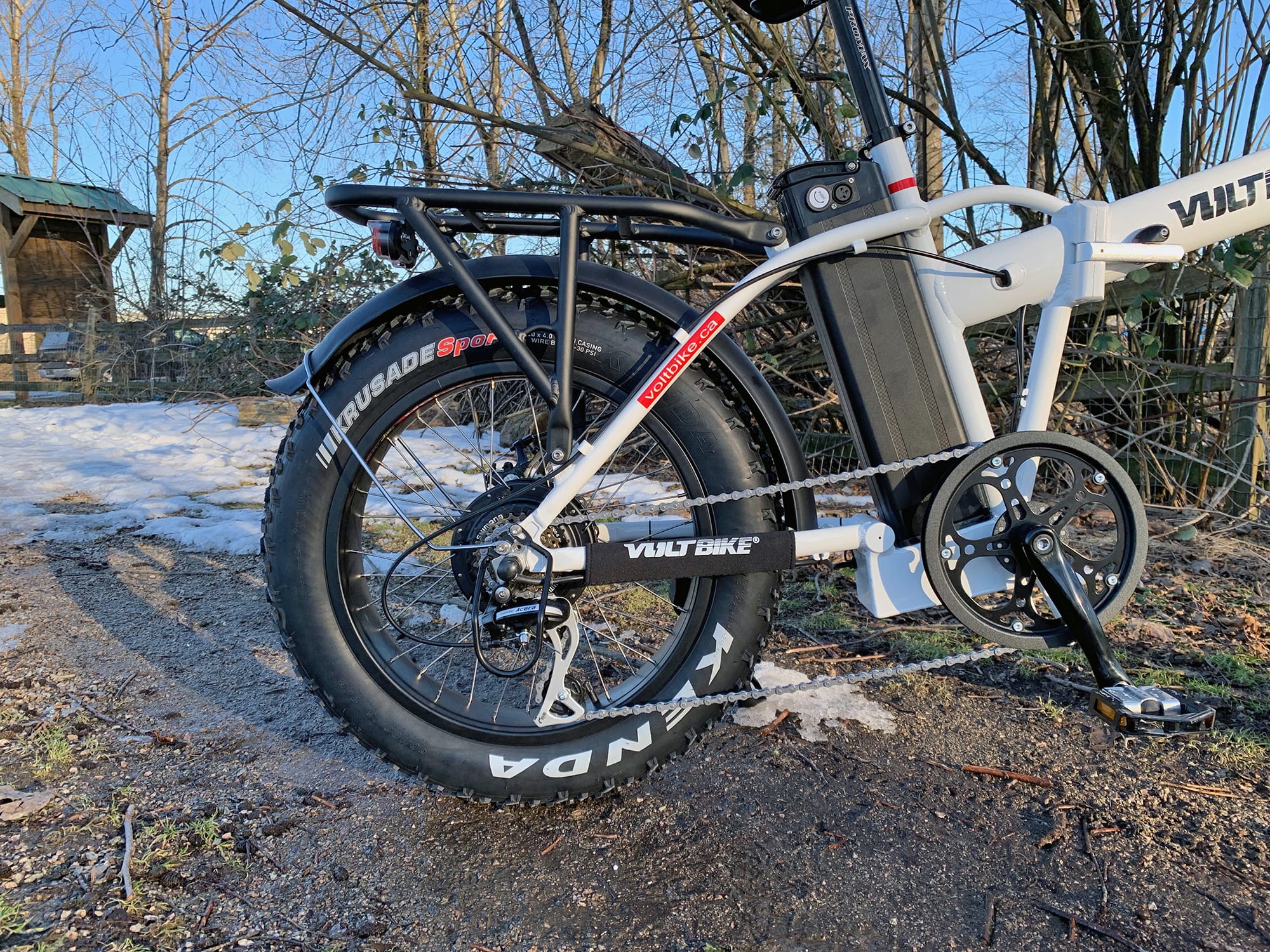

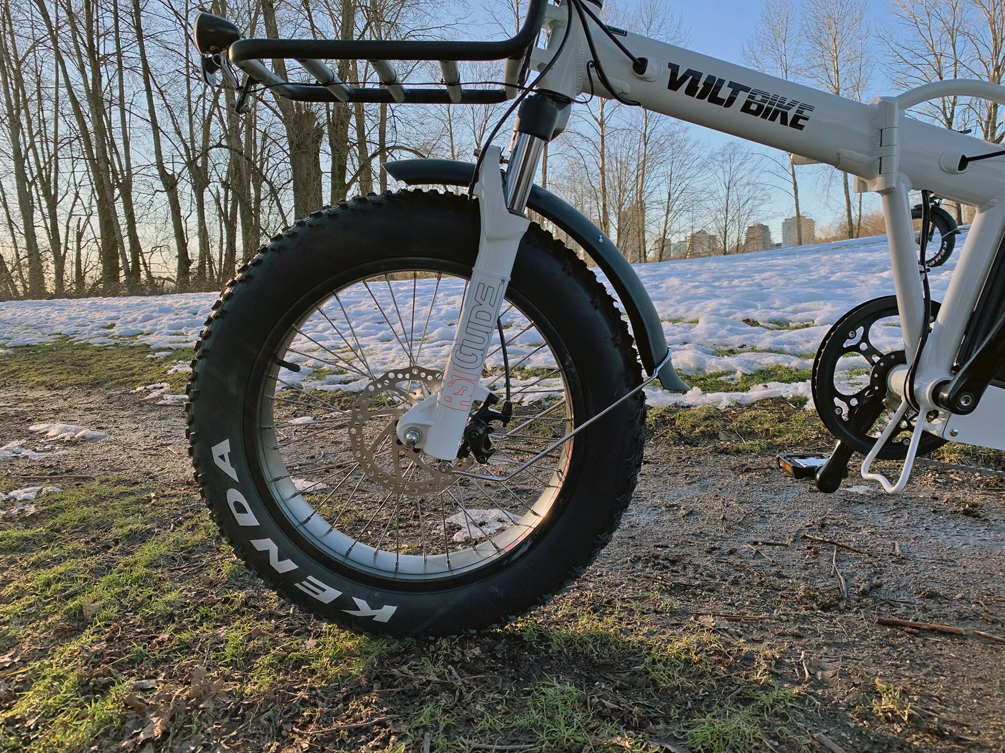

- Kenda Krusade Sport 20” x 4” fat tires with 60 threads per inch casing, rated for a 5psi-30psi, and has some bump absorption with its nobby tread
- A front suspension fork with 60-70mm of travel and some fairly large stanchions, preload adjust, and is fat-tire specific

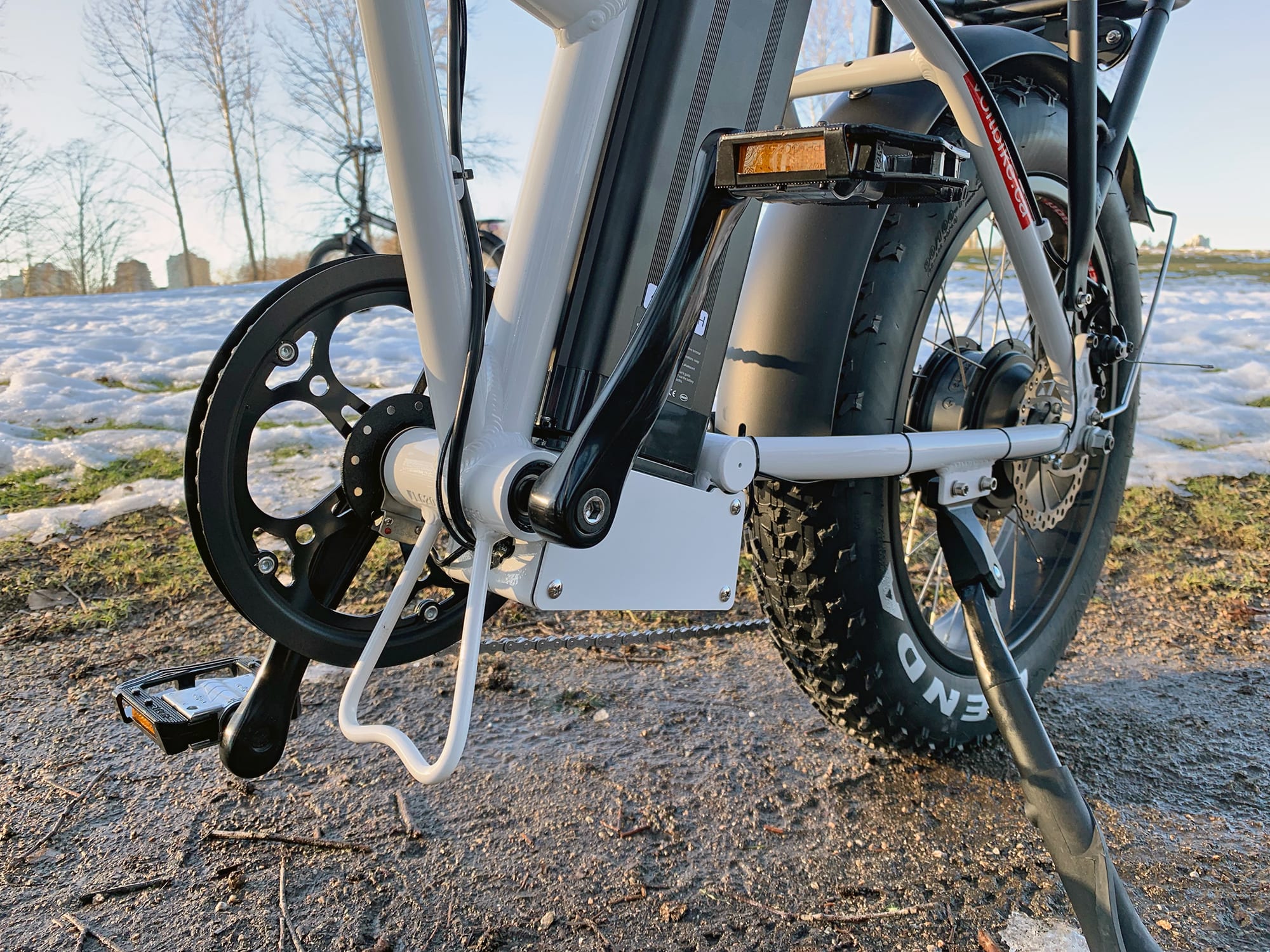

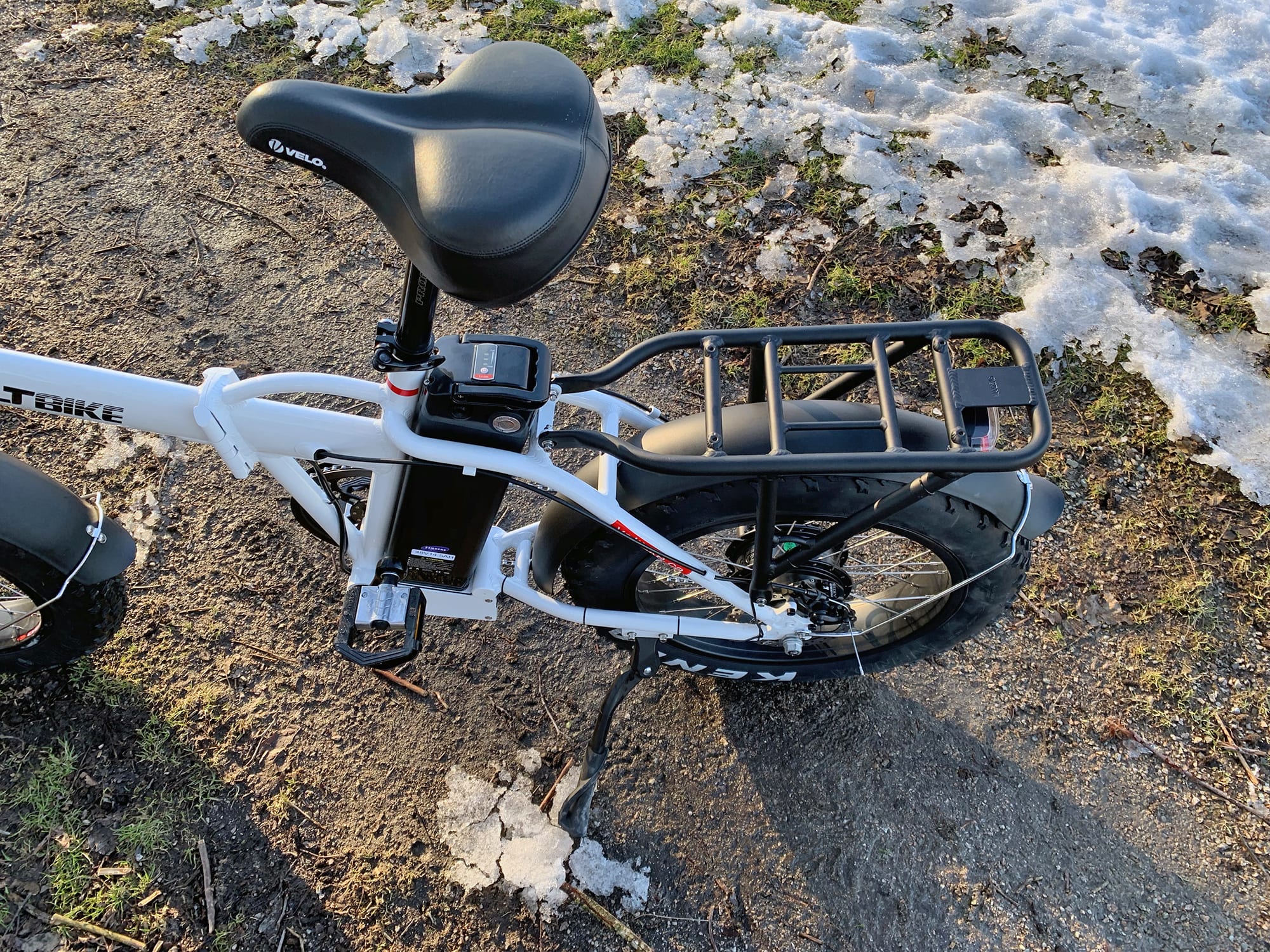

- The adjustable kickstand included is mounted away from the pedals in the rear, so that eliminates pedal lock, an annoying occurrence when reversing a bike with the kickstand down that this bike doesn’t have to worry about

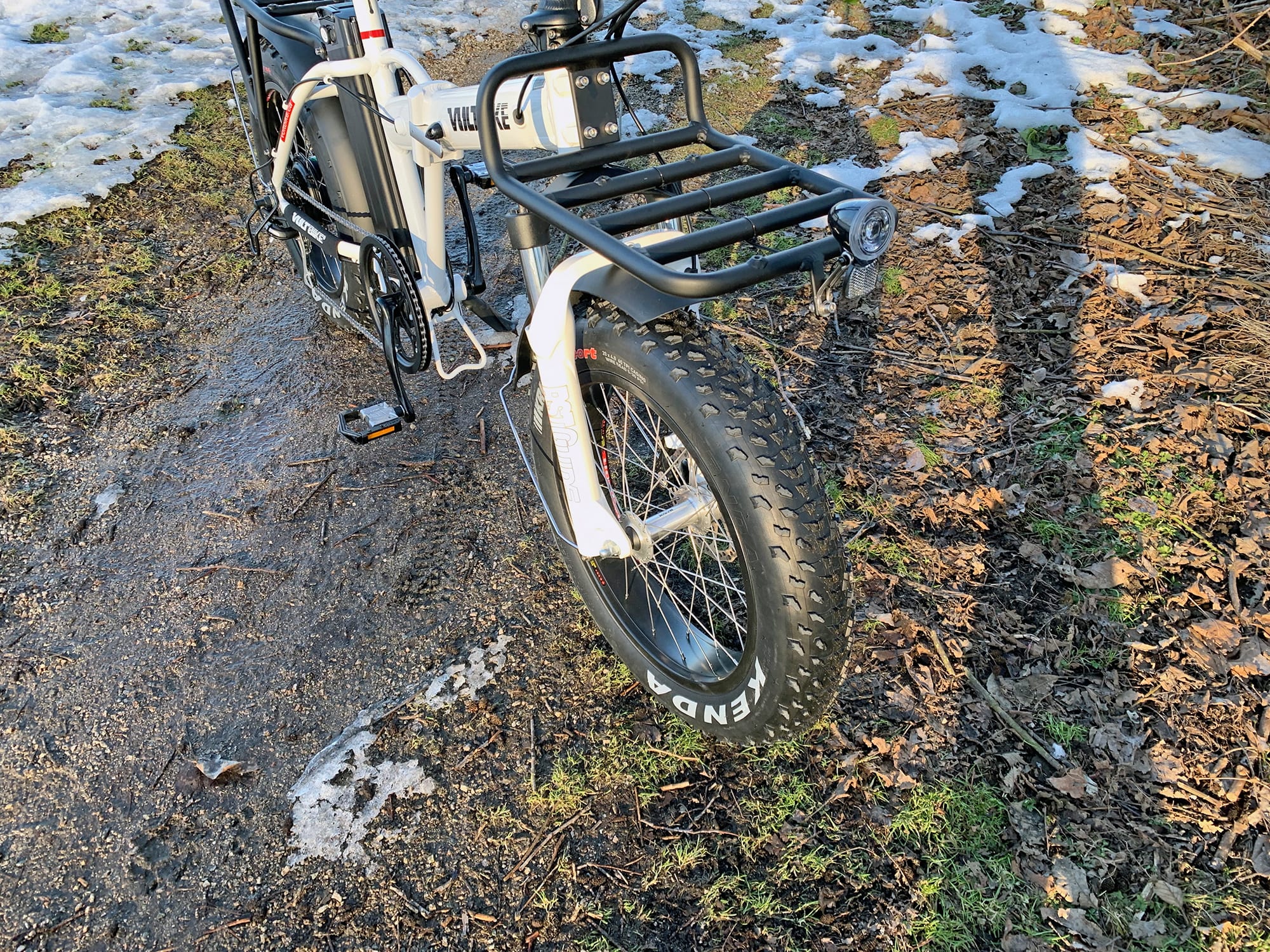

- If you do opt for the front rack, it is mounted so it doesn’t turn when you steer so it keeps the load nice and straight while maintaining stability

- A lot of cool little touches like a neoprene slap guard, derailleur guard, Wellgo aluminum alloy folding pedals, included steel fenders

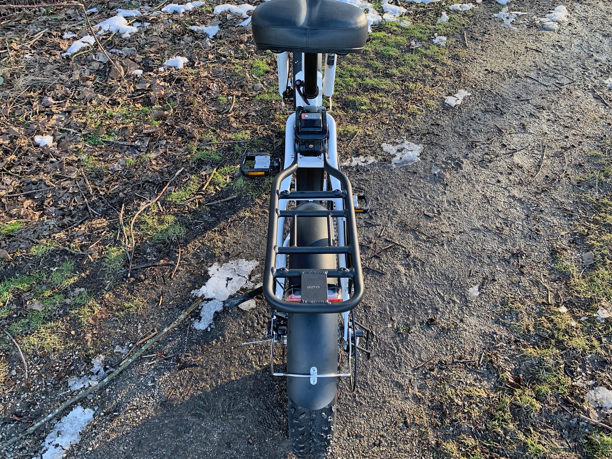

- It is great that there are both an integrated headlight and rear light, however, the rear light is 1 LED and can feel a bit like just a really large reflector rather than a rear light

- To operate the bike, you have to keep the keys in at all times on the side of the battery to operate it, this leaves them hanging around to bounce while riding as well as make noise

- The controls for the display have a groove in them that can catch cloth and other material, so if you are wearing gloves for example, be aware of that
- Using this battery setup means the seat itself must be removed if you wish to take the battery off the bike to charge it, kind of an annoyance
