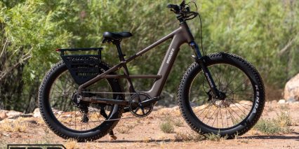

The Mariner is one of just a handful of mini sized electric fat bikes I’ve seen that are designed to be both easier to mount and ride for short people as well as transportable for people who maybe have a boat, RV or trunk space. It’s a bike that’s fairly adaptable with telescoping stem (to raise the handle bars) and a seat post that can also raise and has a built in suspension element for comfort. The frame on the bike is sturdy but rigid and it comes with a bolt-on rear rack so you can add a trunk bag or panniers. Also, it has a headlight and tail light for improved safety and perhaps a bit of off-road nighttime adventure! Ultimately, it’s a surprisingly affordable little bike with a big personality that younger people, women and even large guys can enjoy on nearly any type of terrain.
For this review, I was able to get the company that makes them, VoltBike, to send a unit to Cabo San Lucas Mexico for testing at a resort called Cabo Adventures. This company specializes in scuba, zip line and biking adventures and has been considering adding electric bikes but was unsure how they would fare in the soft sand (and with different types of riders). Ultimately, the bike worked VERY well in the sand… even soft sand, which surprised and delighted me. To be fair, all of our fat tire ebikes handled the sand and the larger-wheeled models performed best, but even the 20″ x 4″ tires on this folding model made it through once the tire pressure was lowered sufficiently. Note, lowering the tire pressure makes a HUGE difference on soft terrain like sand or snow. The 500 watt internally geared Bafang hub motor zipped along in pedal assist and throttle mode without a hitch. Being able to add power on demand with the throttle (overriding assist on demand) made a big difference for me and my girlfriend and the fact that VoltBike uses a trigger throttle helped to keep the grips feeling solid vs. the half-twist design that some other bikes employ. It’s personal preference though and I noticed that the throttle on this bike is always active which means it could get bumped if you forget to turn the bike off after riding (if you lift it or decide to fold and pack it up).
