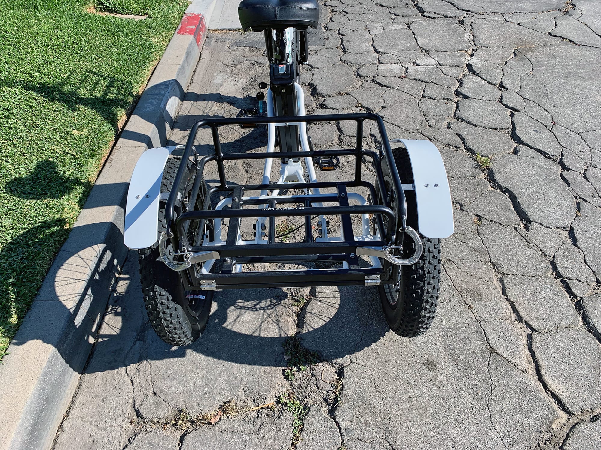

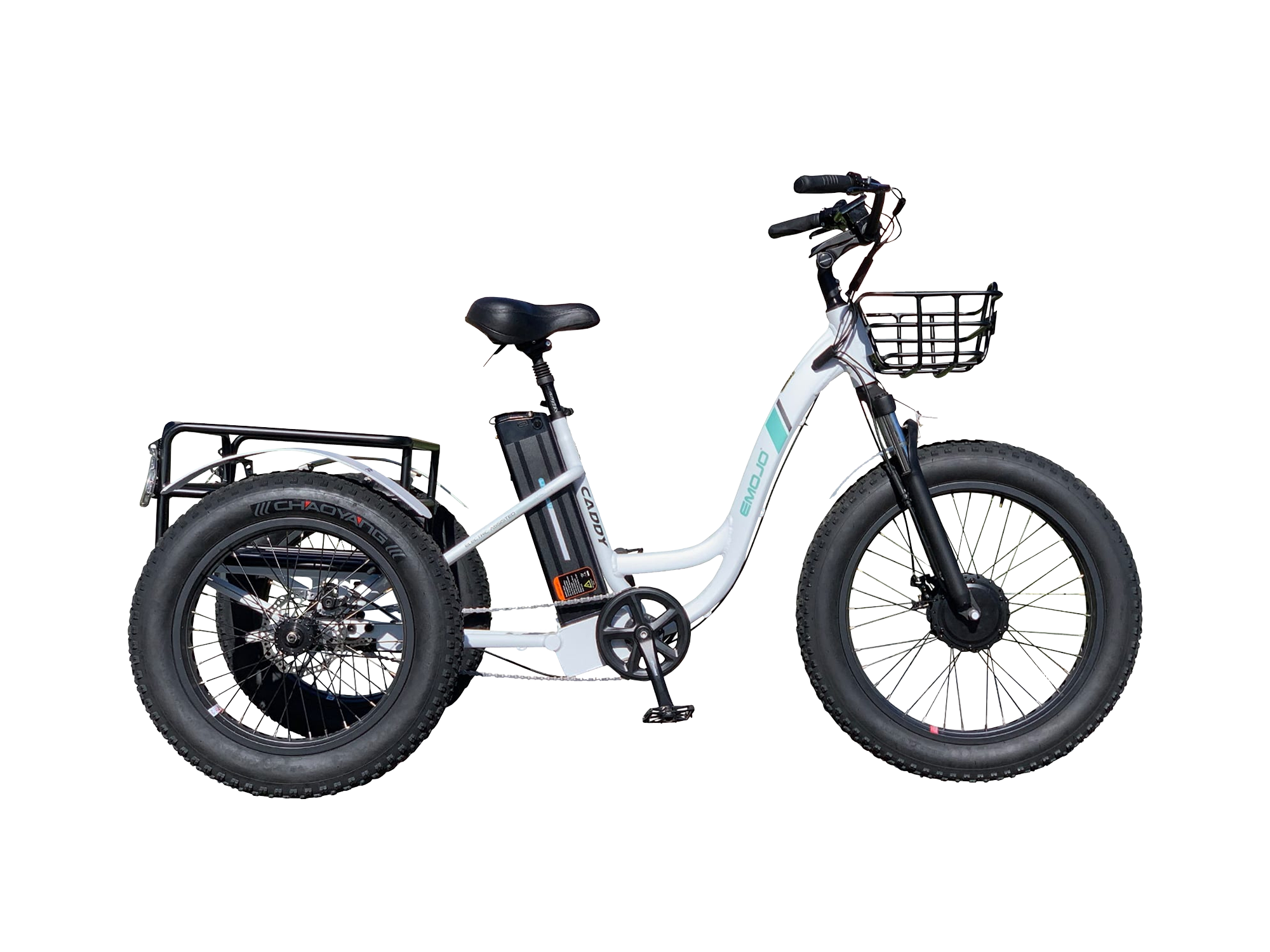

It used to be that only one or two electric trikes were available on the market, but it seems each year more and more are entering the arena which means consumers have a lot of choices to pick from. This inspires companies need to stand out more and fulfill different needs, and such is the case with the EMOJO Caddy Trike. The Caddy Trike was actually designed to do just that, they have a sort of adapter that allows it to carry around golf clubs. So far, that accessory has yet to be released, but the trike still stands as a welcome offering. The aluminum alloy frame is very stable and features high utility. Overall, it weighs about 90.1lbs with the extra tubing and solid frame. The weight capacity is here too, the front basket is rated for 19lbs, the back rated for 55lbs, and the entire trike is rated for an impressive 330lb capacity altogether. I love that the rear basket actually has these chain clips that allow the back slate to function as a tail gate just like a pickup truck… Very cool! There is quite a bit of comfort as well.. You get these 4” wide knobby fat tires in the front and rear. I should note that the front is a 24” tire, while the rear tires are 20”. This will give you a mechanical advantage for stopping as well as keep the rear low for easy loading and unloading. All 3 of the tires are complimented by these mini fenders that are aluminum alloy. These may not wrap around all the way on the tire, but they should help keep you a little dry. The comfort continues with a Promax suspension seat post with 40mm of travel, this pairs nicely with the rubber bumper comfort saddle from Velo and the front suspension fork The front fork is a little basic however, this is a Mozo spring suspension with preload adjust, but it does lack lockout, compression, and rebound adjustments. As you sit down, you will notice the swept back bars and adjustable angle stem which are very cozy. I will note however, the rubber grips are non locking which isn’t a big deal, but may be annoying for some. I really like that there is a battery integrated headlight that points where you steer, but there is no rear light which is a bit of a missed opportunity given the size of the area back there. I also want to mention the plastic chain guide so your clothes don’t get snagged, I love little touches like this.

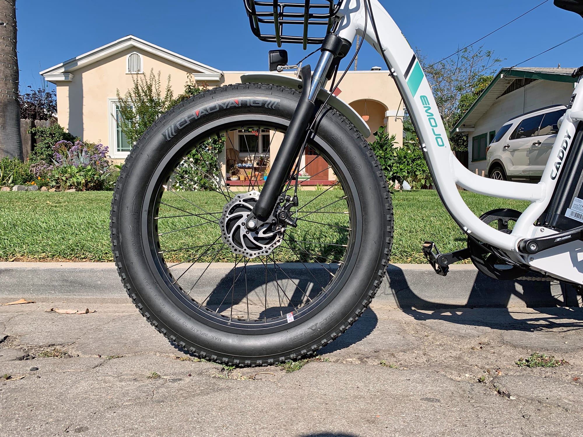

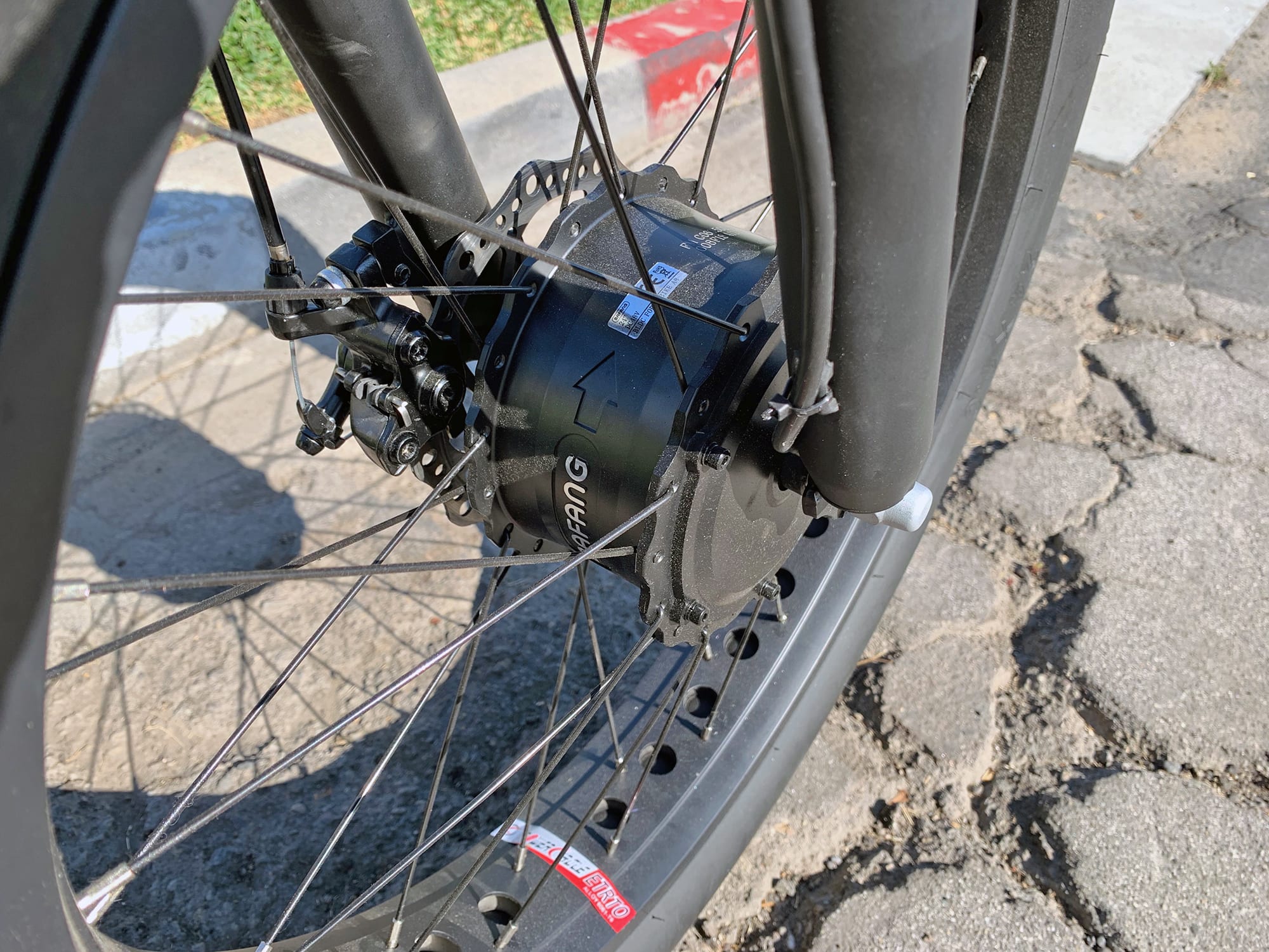

Driving the trike is a 500 watt fat-tire specific front hub motor from Bafang. I noticed that the electric motor engages the front while pedaling engages specifically the right rear wheel. The pedal assist has 9 different modes (which I think is too many) and is measured by a more basic 6 magnet cadence sensor. There is a throttle here too, mounted on the left, but Sam tells me you can easily switch it to the other side if desired. Overall, the system is rated for a top speed of 20mph. This is a massive limit for a trike as speed is actually sort of your enemy. High speeds can be dangerous, especially when turning as trikes can tip easily. Luckily, the throttle here is governed by what mode of pedal assist you are in, so I would keep it nice and low until you feel comfortable enough to get it up to speed. Mechanically, the trike has a quiet and reliable single speed drive train. It features an 18 tooth sprocket and a 42 tooth chainring in the front. I also noticed the smaller crank arm in the front. This will be a little bit lighter on the knees and keeps the pedaling motion up and off the ground nicely. Stopping the Caddy is a set of 3, (1 for each wheel) mechanical disc brake rotors. The rotors here are 160mm and could be somewhat of a complaint for stopping such a fast and large beast… however, the smaller wheels offer a mechanical advantage and both brake levers employ motor inhibitors which cut power to the motor when breaking. When working together, they all combine a decent stopping effort I would say.

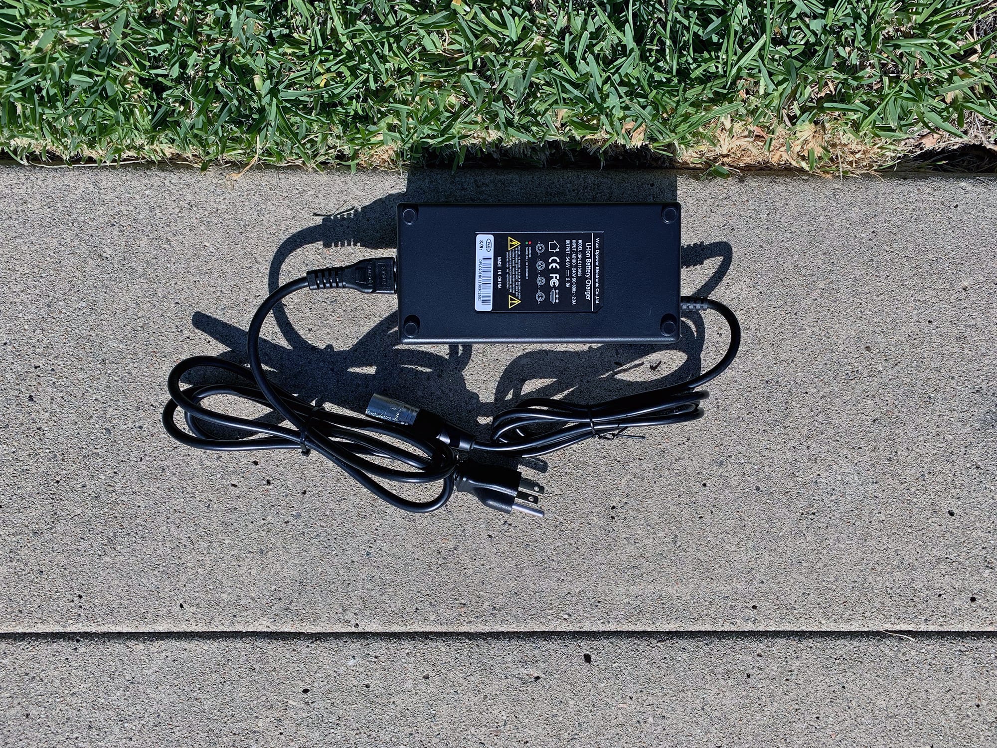

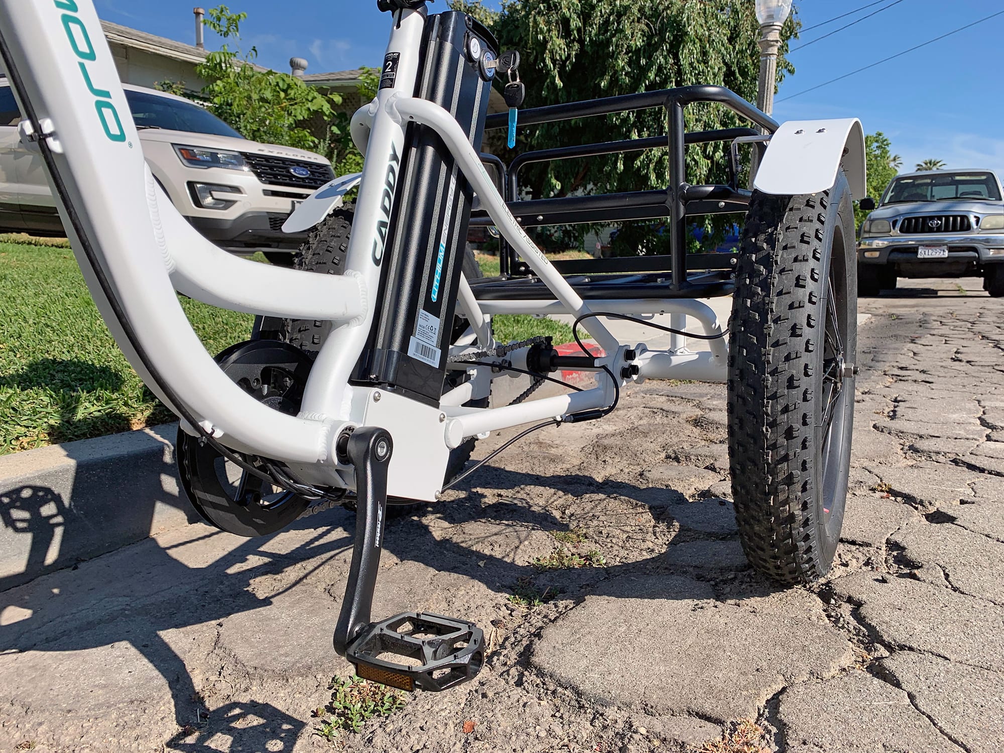

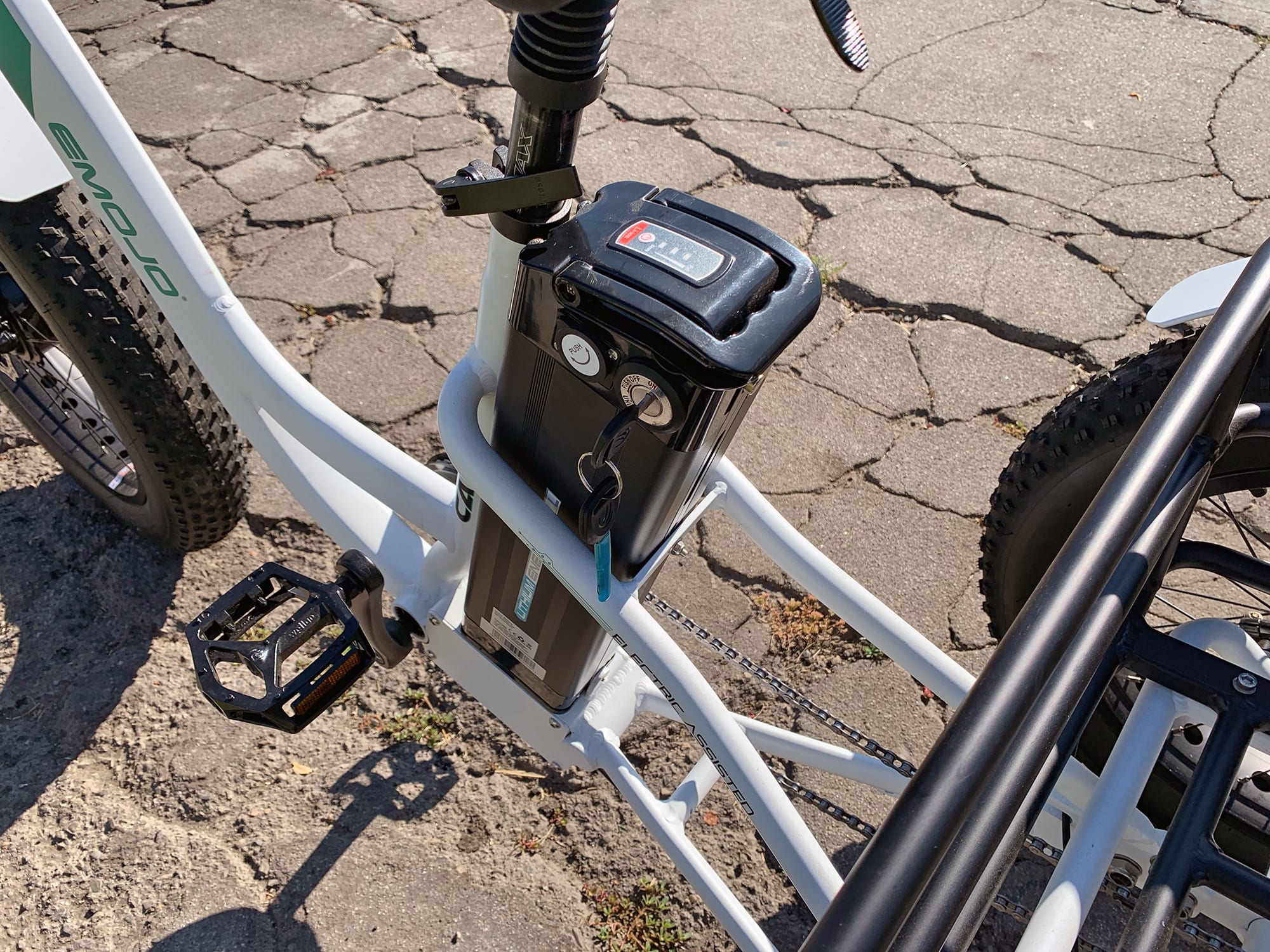

Powering the trike is a very high capacity lithium ion battery. It is rated at 48v 15ah, so you really get a great 720 watt hours. On a trike like this, that means you should be getting very good range on each charge. The battery here is heavier, about 10.2lbs, and latches behind the seat post. To remove it, you must tip up the seat via a little handle underneath. Once tilted, you can slid the battery in and out with its handle. The battery also has a USB Type A charging port on it so you can charge devices or use it as a mobile power bank. A bit of a downside is the slower 2amp charger. 2amp chargers are not so bad for smaller batteries, but for a large battery capacity such as this, it could take a very long time to charge it up from dead to full. To really care for this and other lithium-ion packs, I have heard that storing in a cool dry location vs. extreme heat or cold will extend the life and try to keep it about 50% full when not using for long periods so you won’t stress the cells. Try not to let it run down to zero, because that’s really hard on the cell chemistry.

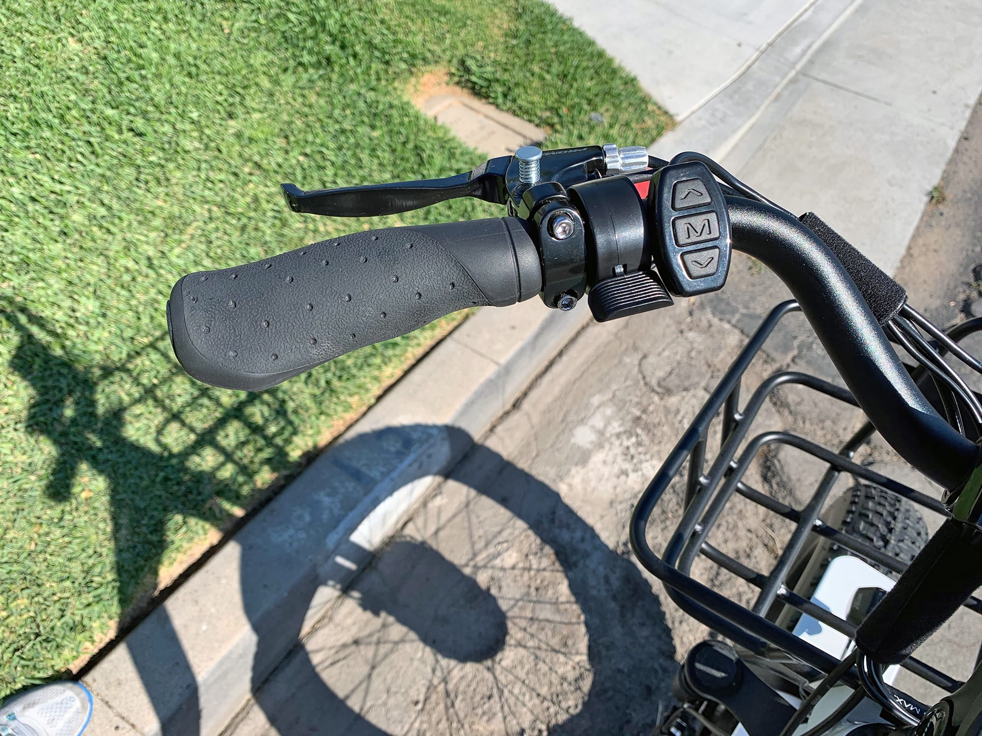

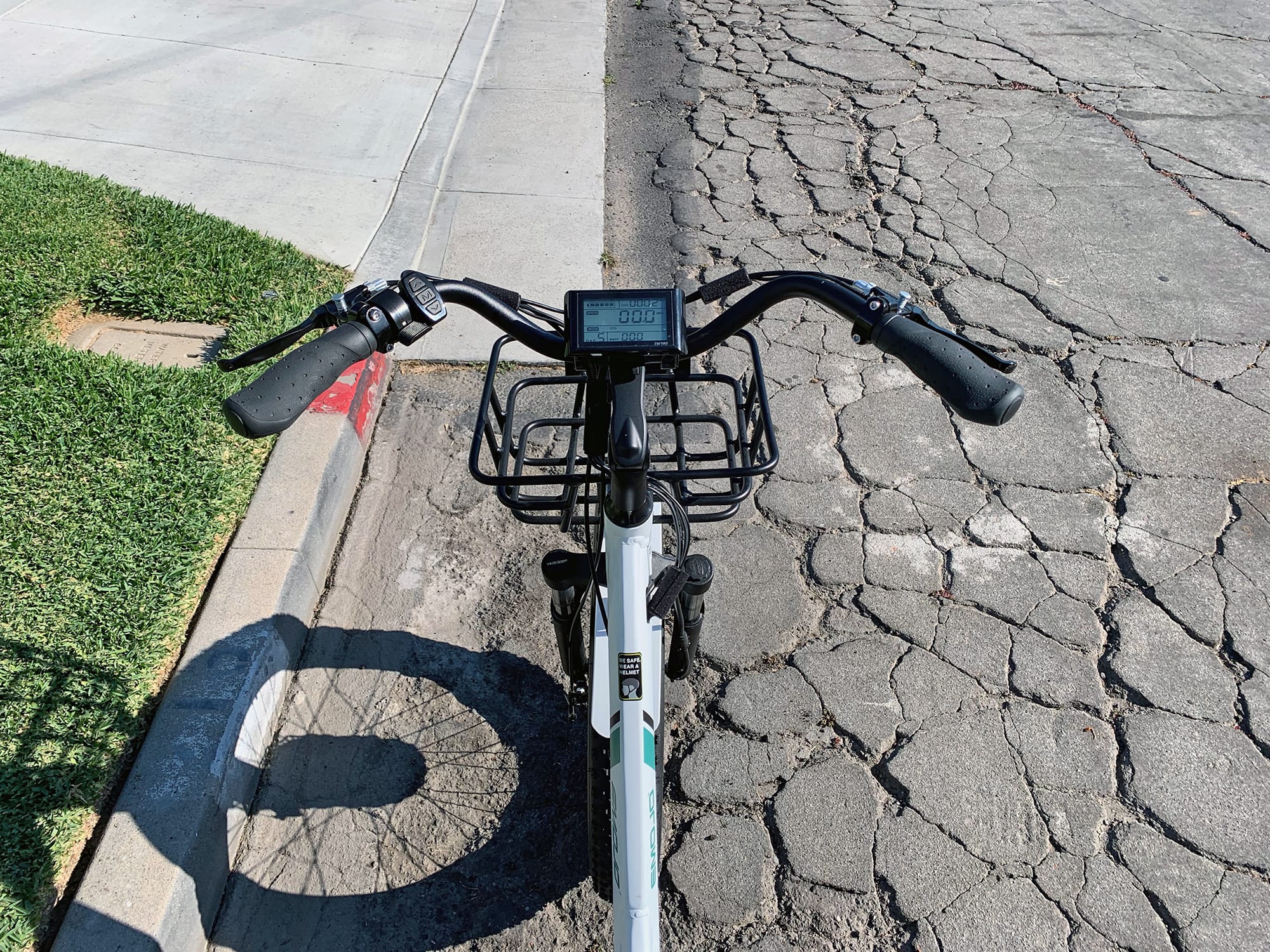

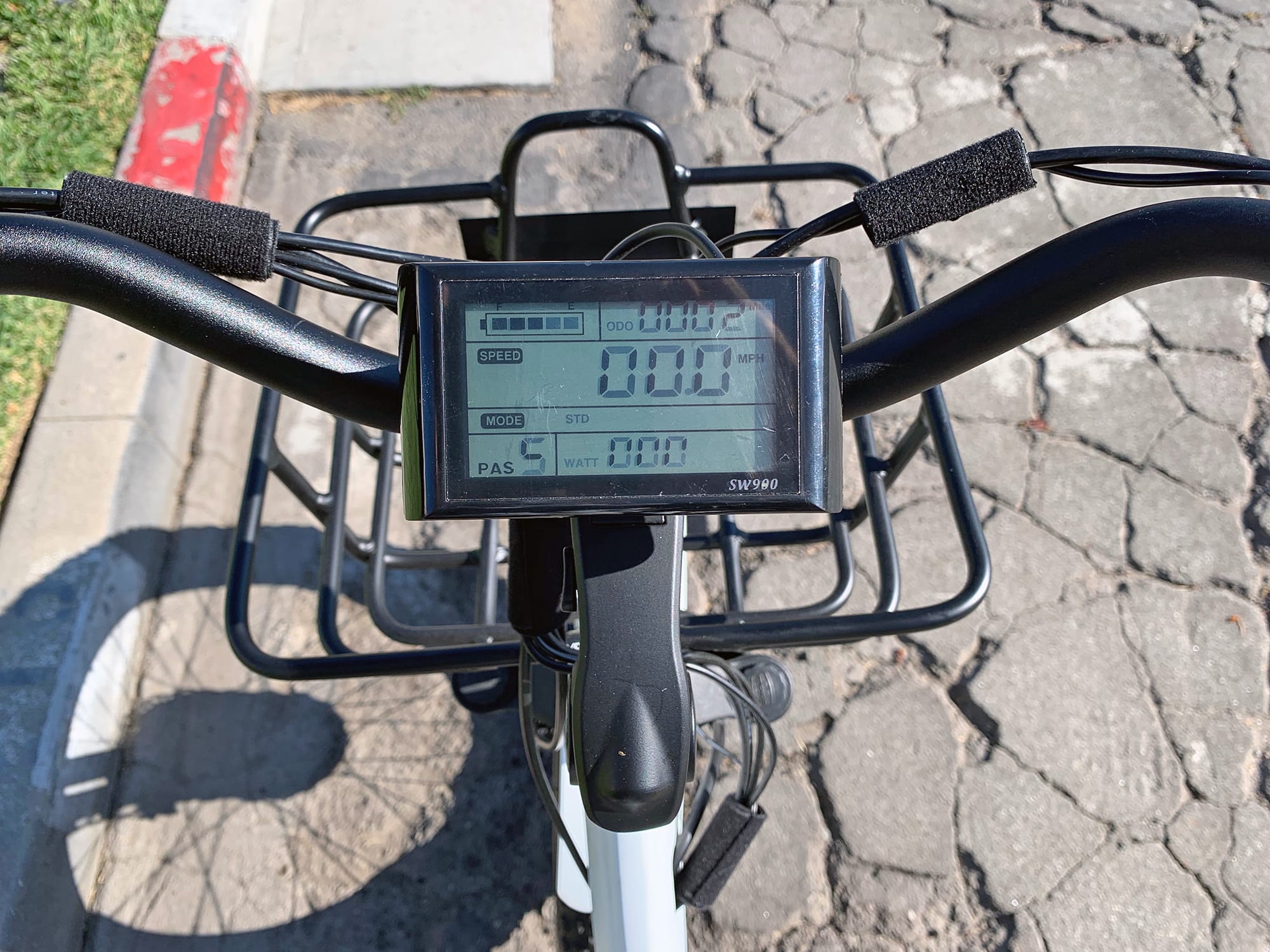

Using the Caddy Trike electronically is simple. To activate the display, just hold the Mode button in the middle of the rubberized control pad (near the left grip) and it blinks to life. This display is not removable, but it does swivel forward and back just enough to reduce glare. It’s large, which makes it easy to read from a distance, and it shows your battery level, trip stats, speed, and assist level 0-9. If you press the mode button, it cycles from trip distance to total distance (odometer), and if you hold the up arrow it will cycle from current speed to average speed and max speed. For those who want to mess around with settings, hold the up and down arrow keys simultaneously, and for those dark riding moments (or to be extra safe during the daytime) just hold up and mode simultaneously to activate the headlight. Normally, this display setup has a walk mode, but in the review video I couldn’t get it to work. The company may have disabled it for safety since this is a trike rather than a bike.

- A stable and heavy duty electric trike that features a front suspension fork, suspension seat post, fat tires, and a front and rear basket
- The aluminum alloy frame is very stable and features high utility, it weighs about 90.1lbs with the extra tubing and solid frame, the entire trike is rated for an impressive 330lb capacity altogether

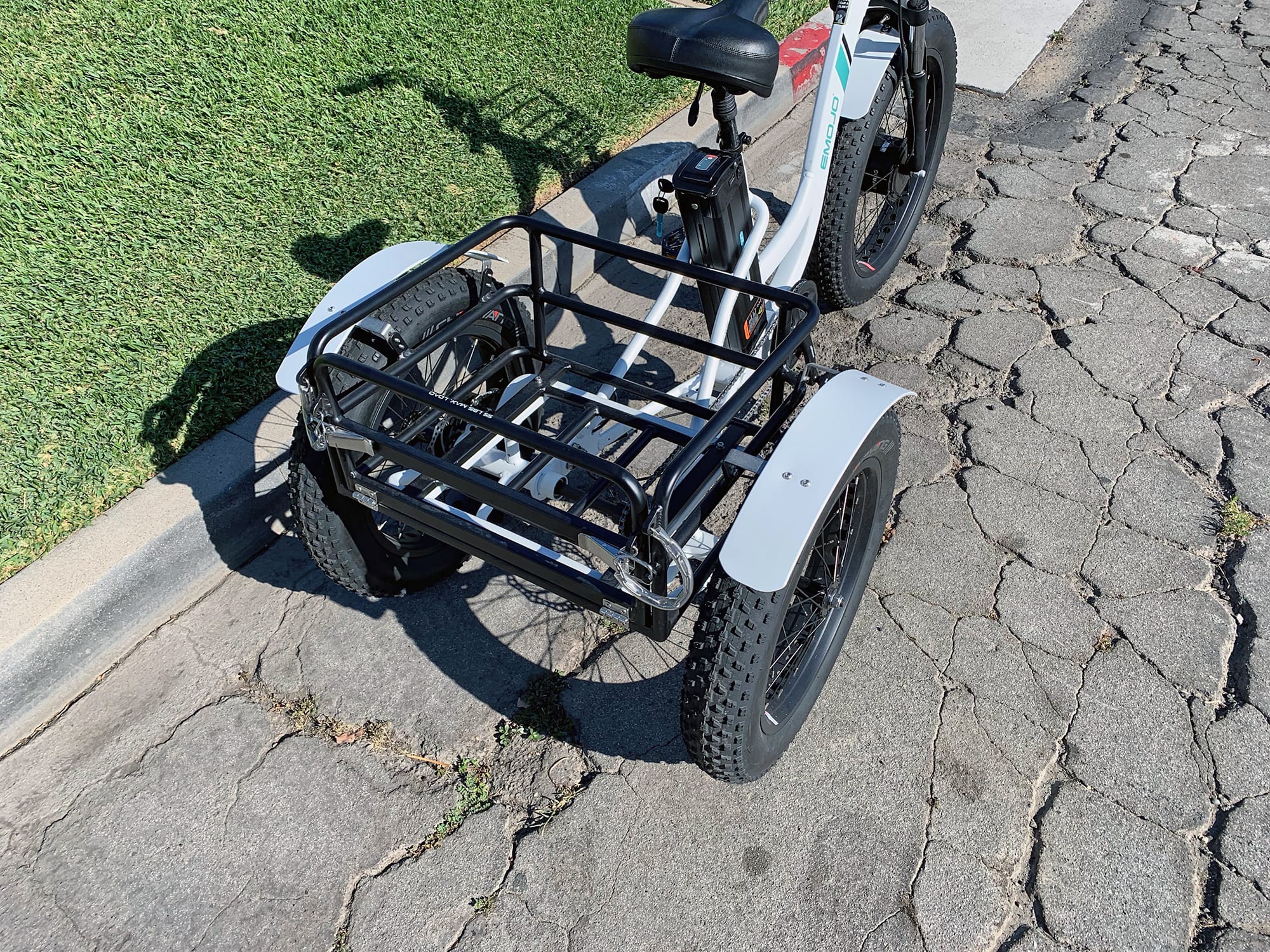

- The front basket is rated for 19lbs, the back rated for 55lbs, I love that the rear basket actually has these chain clips that allow the back slate to function as a tail gate just like a pickup truck, super cool!

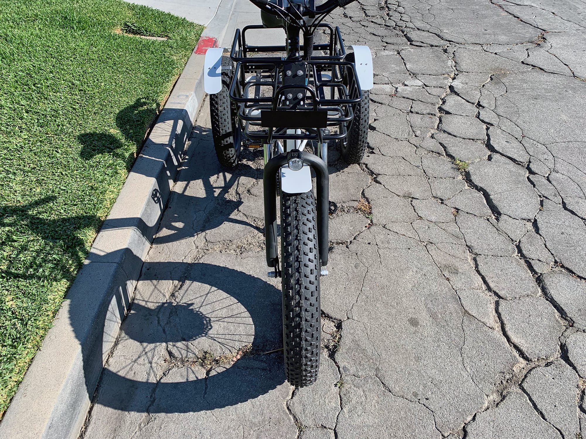

- 4” wide knobby fat tires in the front and rear, the front is a 24” tire, while the rear tires are 20”, this will give you a mechanical advantage for stopping as well as keep the rear low for easy loading and unloading

- There is a front suspension fork as well, this is a Mozo spring suspension with preload adjust and is extra wide for the fat-tires

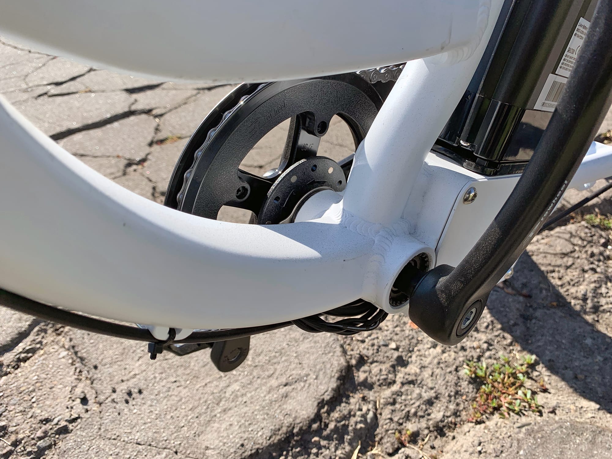

- Powered by a Bafang fat-tire specific 500 watt front hub motor, very powerful and capable, also has a reliable single speed drivetrain
- 3 mechanical disc brakes, 1 for each wheel, 160mm rotors, also features motor inhibitors and a parking brake on each lever

- The keys must be in the battery to operate the bike, they can jingle around or snag clothing, both of which can be annoying
- There are some basic components here, like the 2amp charger, 6 magnet cadence sensor, and generic non locking grips
- It is definitely on the heavy and unwieldy side, parking and maneuvering in and out of a garage could be tough if you don’t have the space (also, there is no reverse here), and during the ride, we were worried the back wheels and their lugs could scrape a car or curb, so do be aware of that
