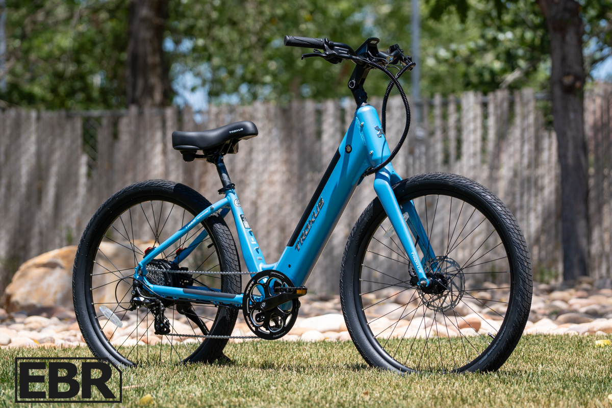

That cycling and manufacturing background shows up in the Trax Whim iQ, which is the brand’s upright, laid-back, Dutch-style cruiser.
At $1,599 this is a good buy, and a few things about it caught us off guard in a good way. It is not a hill machine and it does not pretend to be. What it does is roll well, feel light and nimble, go further on a charge than Troxus claims, and comes with a nice Troxus App that lets you adjust the power output to your specific liking.

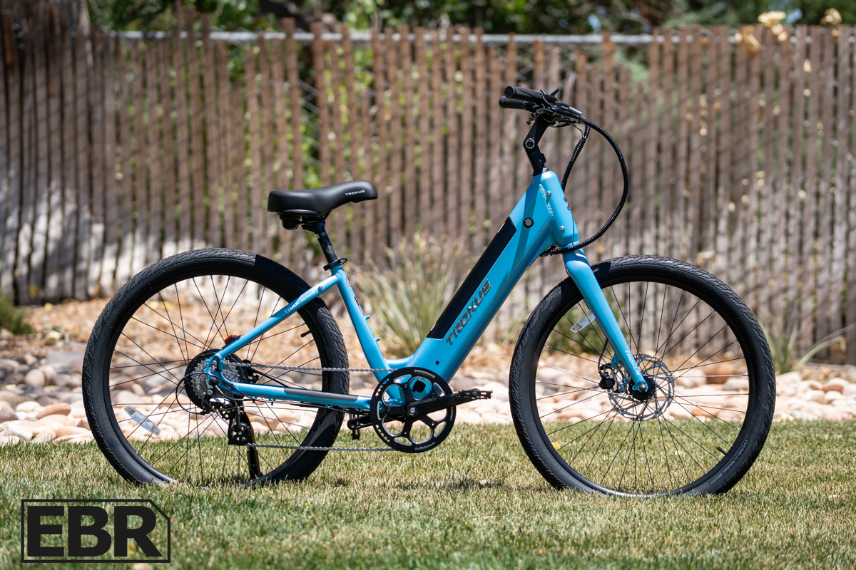

First impressions on the Glacier Blue paint: pictures don’t do it justice. There’s a fleck in the finish that catches the sun – making the bike look more expensive than the price tag.
While the bike was a tad small for me, I didn’t mind the combination of a shorter reach to the handlebars with the pedal-forward layout. That geometry left me riding upright, but not fully upright at a 90 degree angle. Instead, I was in a nice middle ground of leaning ever so slightly forward but still in a relaxed position.
At 5’11” and 185 lbs I’m at the top end of what this Medium fits. I’m losing maybe a quarter inch of leg extension at full seatpost extension, which is small, but riders above 6′ / 6’1″ are going to notice it. It’s interesting to me that Troxus went with two sizes, a Small and a Medium, instead of a Medium and a Large – I’d recommend that they change up the sizing a little bit and have a S/M and a M/L.
The 68° head tube angle, 510mm chainstays, and 1,138mm wheelbase on the Medium give this bike a nice, sporty feel. It’s a laid-back comfort cruiser that wants to still go fast and have fun. Part of that is the 58 lb weight, part of it is how stiff the frame is even with a step-thru design, and part of it is the 2.4″ Arisun Beetle tires, which have enough volume to take the edge off but roll like a road tire. At PAS 0 in fifth gear on flat ground I was cruising 9 to 10 mph without working, which tells you plenty about rolling resistance.

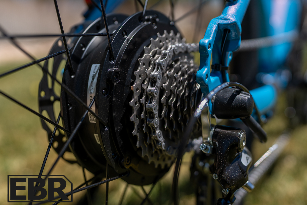

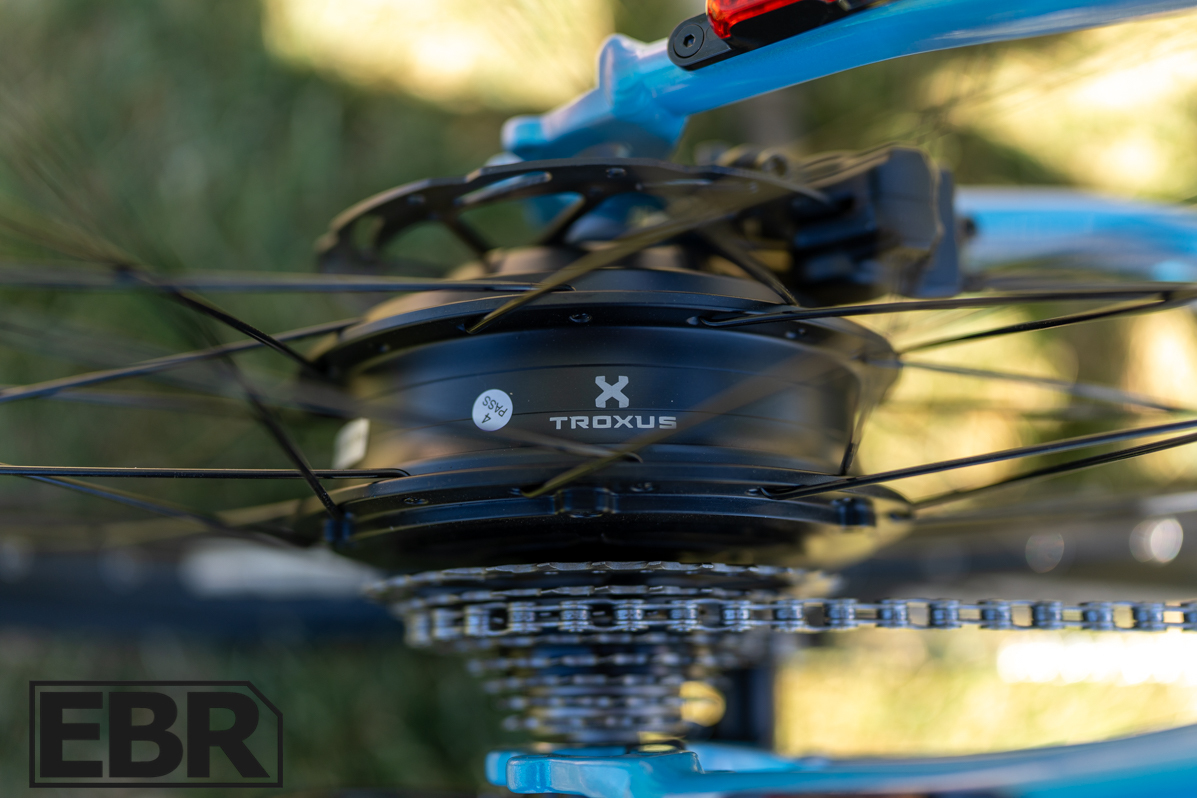

The ShengYi rear hub motor is rated at 500W nominal with 50Nm of torque. Troxus doesn’t publish a peak figure, but it’s likely around 900-950 given that is the max wattage the display showed during our hill testing.
On flat ground it’s peppy. From a stop on throttle I hit 20 mph in about 12 seconds. Even with the throttle acceleration set to 100% (which you can adjust in the app), the bike was controlled rather than suddenly lurching off the line.
Pedaling in torque mode took 9 seconds to reach 20 mph, and 17 seconds to reach 28 mph. That 17 seconds is a bit slower than some; however, the bike got up to 25-26 mph easily without much effort at all, and then needed some extra push from me to get to the full 28. Overall, the Whim IQ is very quick and fast on flat to slight uphill roads and trails.

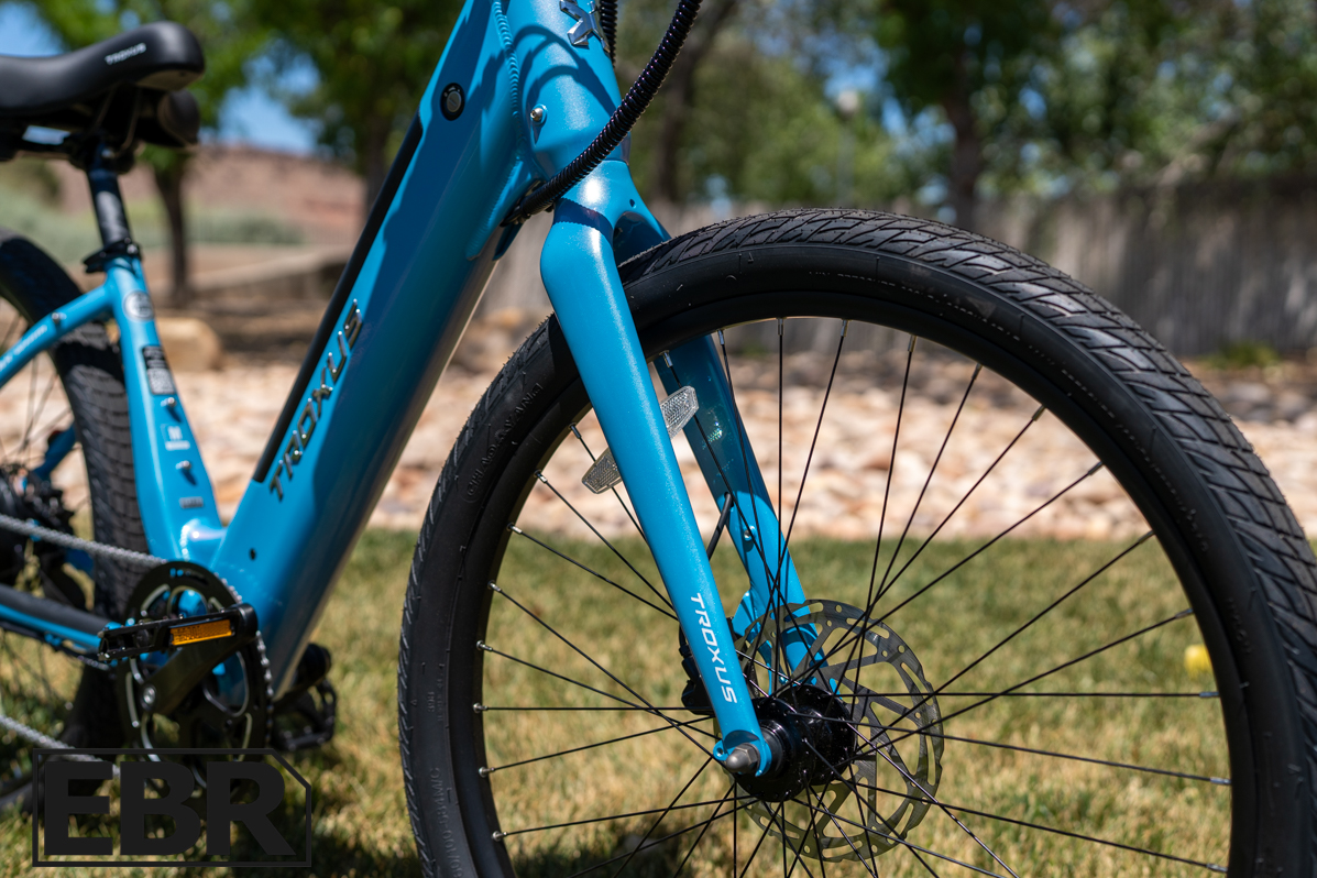

- Frame: 6061-T6 hydroformed aluminum in a step-thru, pedal-forward layout. It feels stiffer than most step-thru frames, and the finish quality is above the price point.
- Drivetrain: Shimano Altus 8-speed with a 12–32T cassette, a 52T chainring, and rapid-fire shifters. Altus is my floor for a value e-bike and I’m glad to see it here instead of Tourney. However, even with a large 52T chainring, I was still on the edge of ghost pedaling at 27-29 mph. A ninth gear would make the bike pedal better, and while I would like to see that, I don’t think it’s worth an extra hundred dollars – so I’m happy with the current drivetrain.

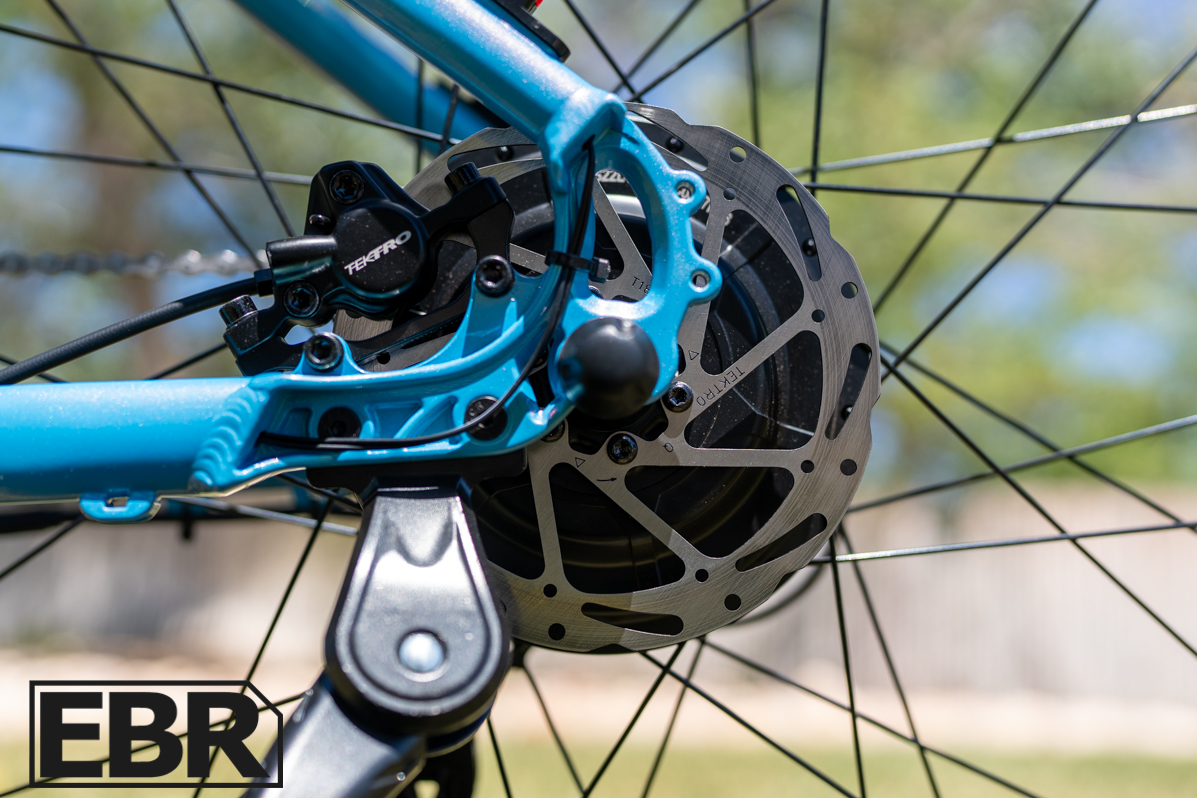

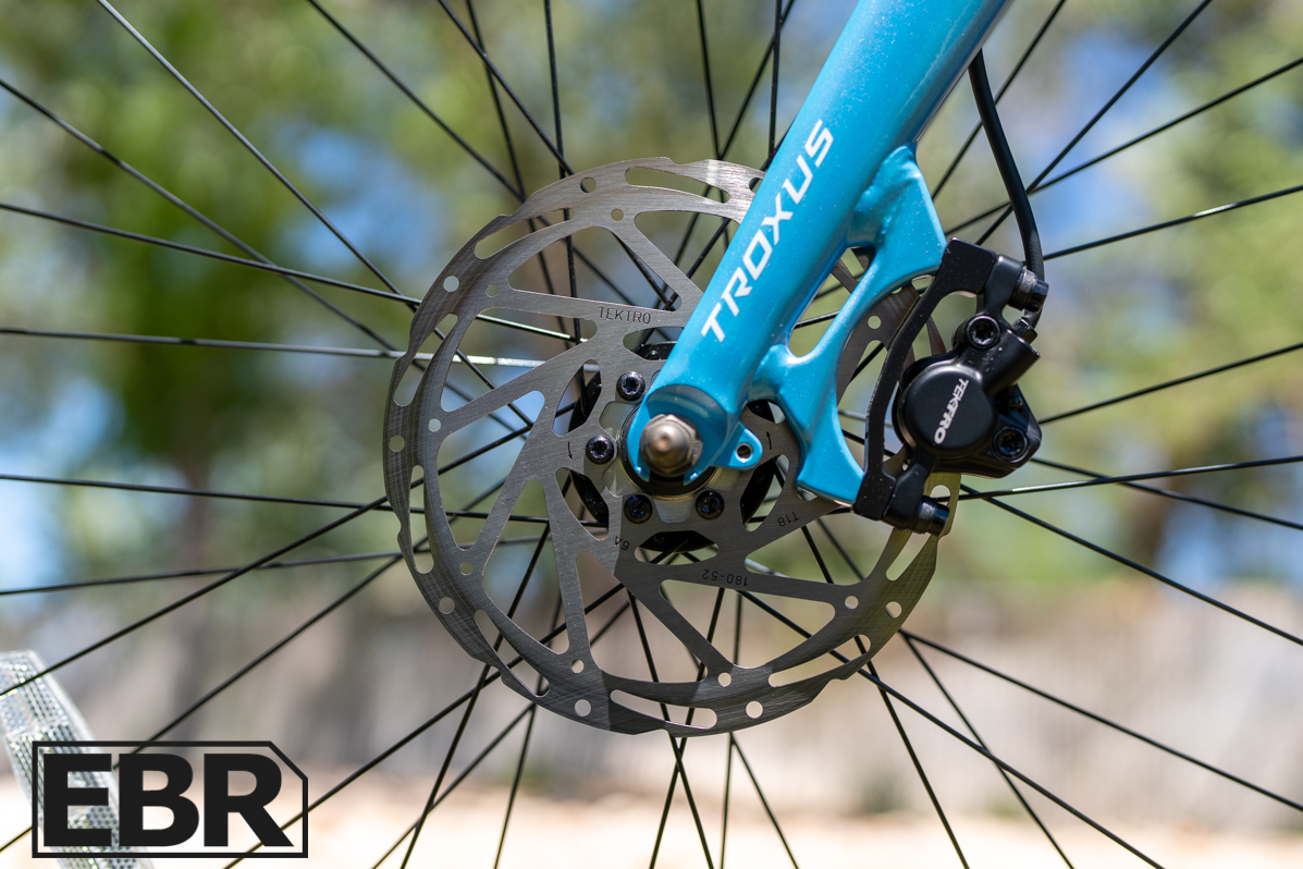

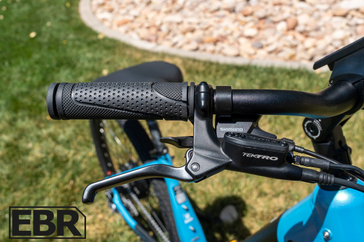

- Brakes: Tektro hydraulic discs with brake sensors, 180mm front and 160mm rear rotors at 1.85mm thick. Seven hard stops from over 20 mph on a steep grade plus a sustained 30-second drag produced no fade and no sponginess. Three fingers on the lever gives a good bite, and we’re 165 miles in with no adjustment since assembly and no squeal.

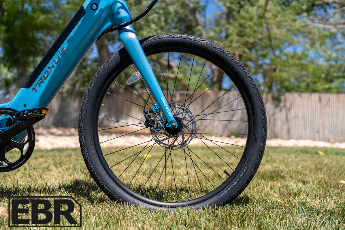

- Tires and wheels: Arisun Beetle 27.5″ x 2.4″ that roll fast and quiet.

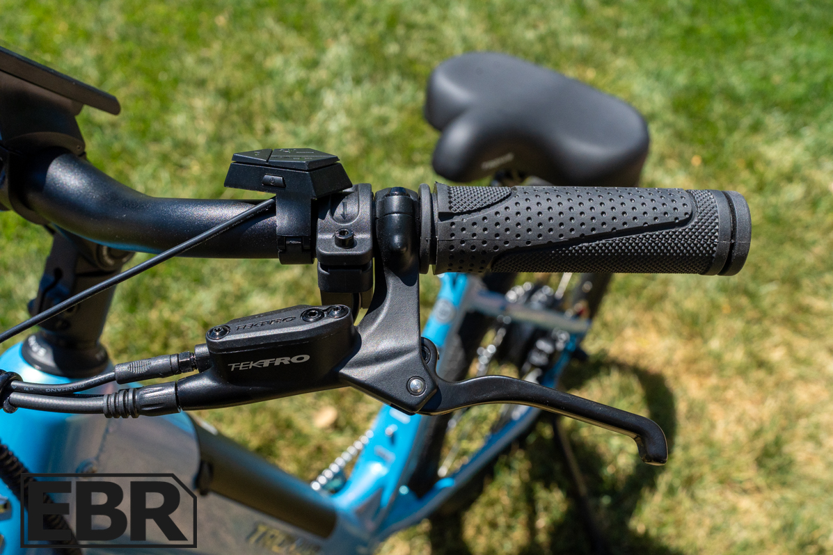

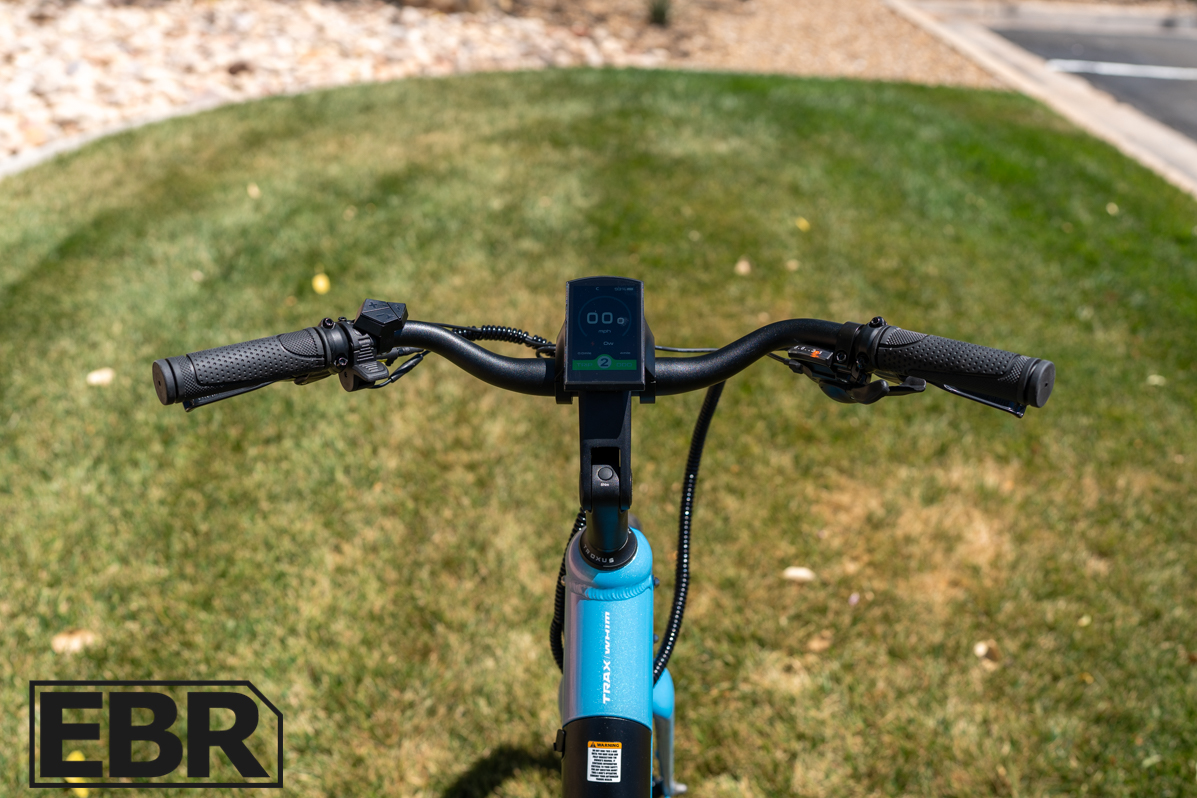

- Cockpit: Adjustable 90mm alloy stem with internal routing, 680mm bars with 37° backsweep, thumb throttle on the left, rapid-fire shifter on the right. This is pretty basic, but I like how clean the set up is and my only gripe is that the grips aren’t locking and did twist a bit in those 100+ degree temps.

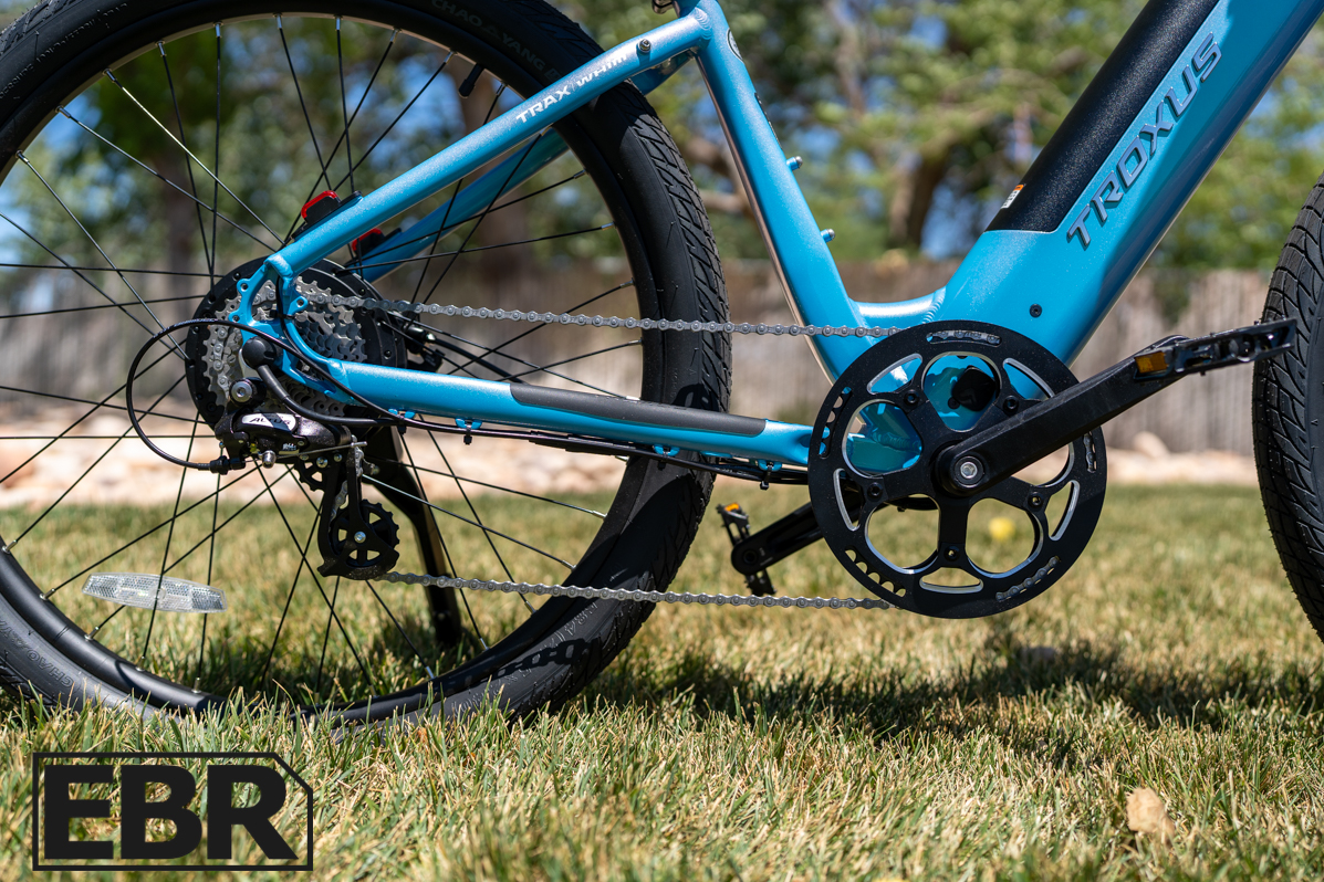

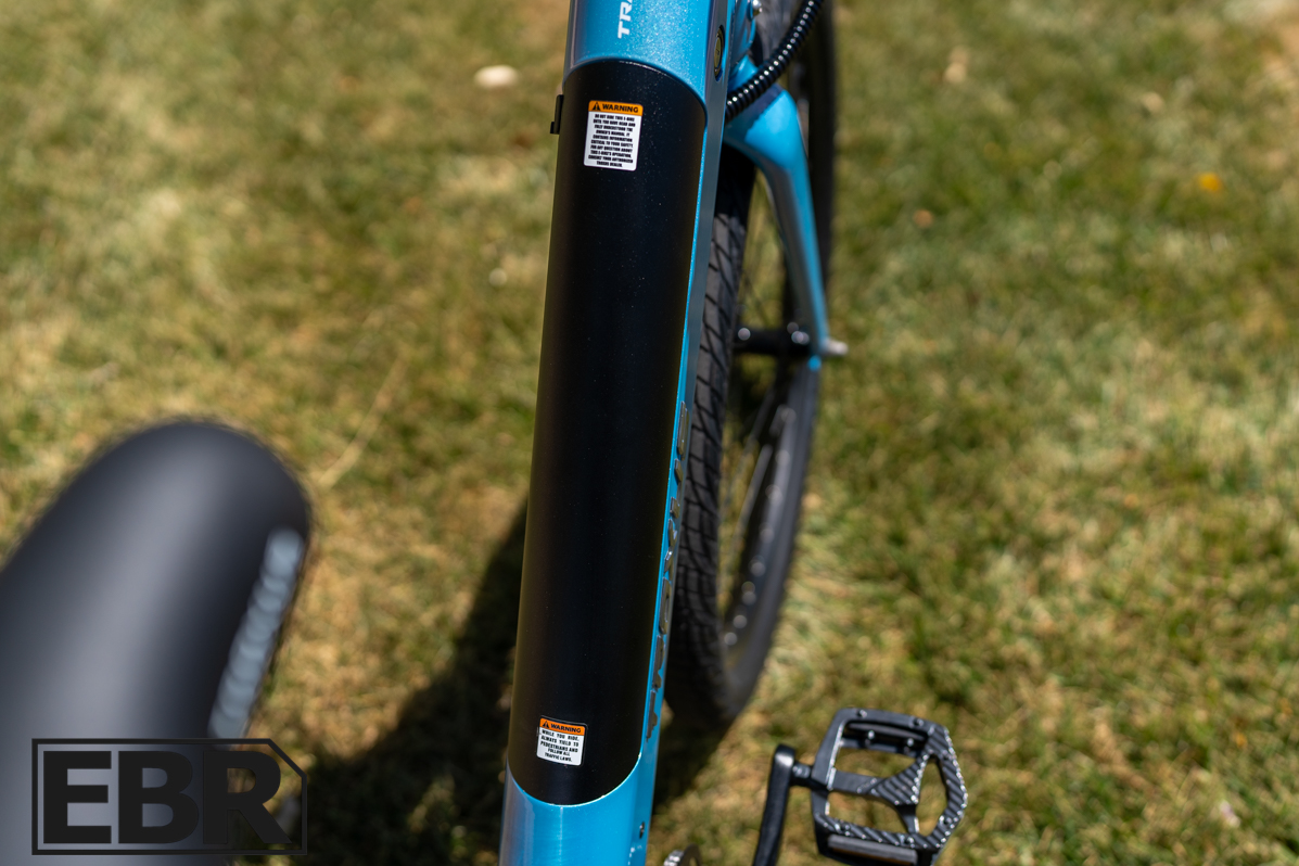

- Mechanic’s details worth calling out: cable routing enters the down tube rather than the headset, which makes battery, controller, and cable work far easier than if cables were run through the headset. There’s also a chain slap guard on the rear chainstay to keep the paint intact.

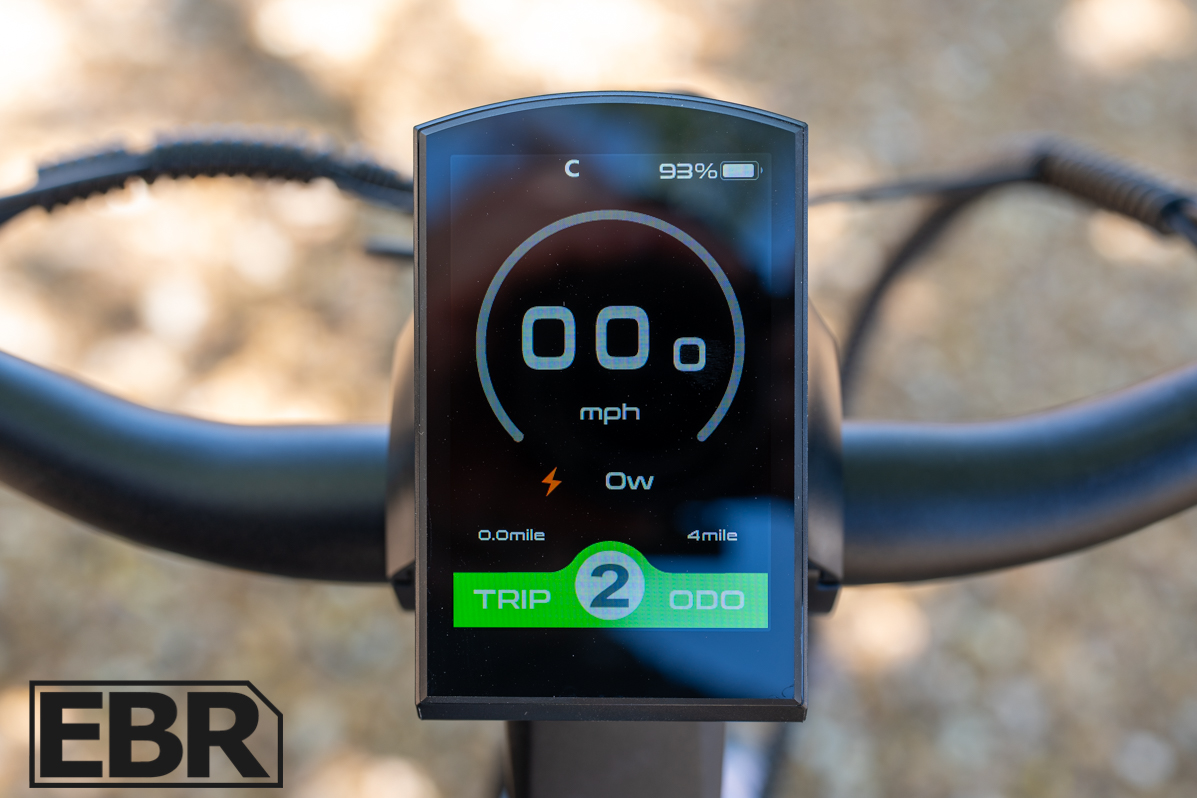

The display is a roughly 3-inch full-color unit mounted on the center bar, and it’s easy to read. Brightness ships at 50%, and I’d set it to 100% on day one. Battery percentage lives in the top right corner, and because the bike uses a sine wave controller that reports in real time, you get an accurate percentage rather than the 10% increments that drive me nuts on other bikes.
A “T” tells you you’re in torque sensor mode, and a small blue link icon confirms the Ride IQ app is connected. You also get speed, live wattage, trip distance, odometer, max speed, average speed, and ride time.
The one readout I’d tell you to ignore is the range estimate. In assist level 1 it showed 26 miles remaining, then 37 miles in level 2, 31 in level 3, 27 in level 4, and 26 in turbo. Level 1 is reporting as though the bike is in turbo. That’s a software fix, not a hardware problem, and the bike supports OTA updates, so Troxus should be able to solve this little quirk.
You can do almost everything from the screen itself, which is something I appreciate even though there is a companion app. Holding plus and minus opens advanced settings where you switch between Class 1, Class 2, and Class 3, toggle torque or cadence, change units, set brightness and auto-off, and add a password.
