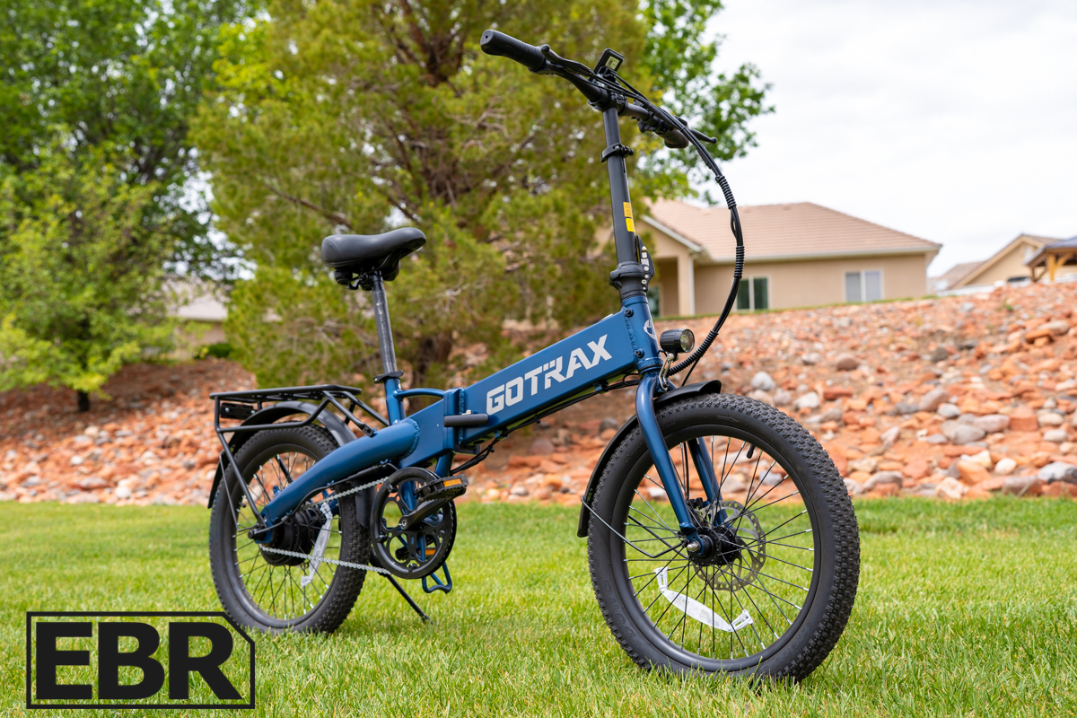

Can a $500 e-bike actually be a good bike? That’s the question I brought with me to the GoTrax E-Fold. I have to be honest: I came in skeptical. Adding a motor, battery, controller, and display to a folding frame at this price point usually means something suffers. The question is whether what suffers matters enough to count it out.
Short answer: no, it doesn’t. The E-Fold surprised me. It’s a decent bike when you put it in context of a sub $600 price (currently the pricing is around $500). The frame is stiff, the motor is peppier than the wattage suggests, and the overall package gives you everything you need to ride around town.
There are some tradeoffs, of course. These include a single gear vs a 7-speed, mechanical brakes instead of disc brakes, and a motor that’s going to struggle on serious hills if you’re over 220 lbs (it climbed just fine for me).
If your budget is around $500-$600 and you’re looking for a folding e-bike for commuting, errands, or casual riding, the E-Fold is a good option.

On the road, the E-Fold is more zippy than expected. The lighter weight bike (52 lbs with the battery) has a nimble, responsive feel. Overall, the E-fold doesn’t feel like a cheap bike. There’s not too much flex or wobble, and there wasn’t any of the normal creaking I tend to find on cheap bikes.

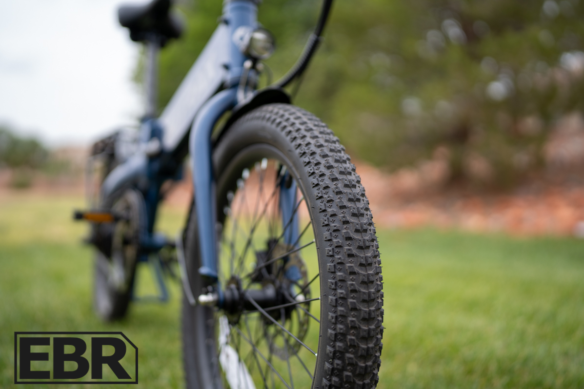

The bike doesn’t have a suspension fork, which is fine given it has slightly wider 2.6″ tires. I felt the bumps and big cracks on the pavement, but not any more than expected. If you want the tires to absorb a little more of the bumps, you can always run the tire pressure a bit lower. A suspension seat post is a reasonable upgrade as well.

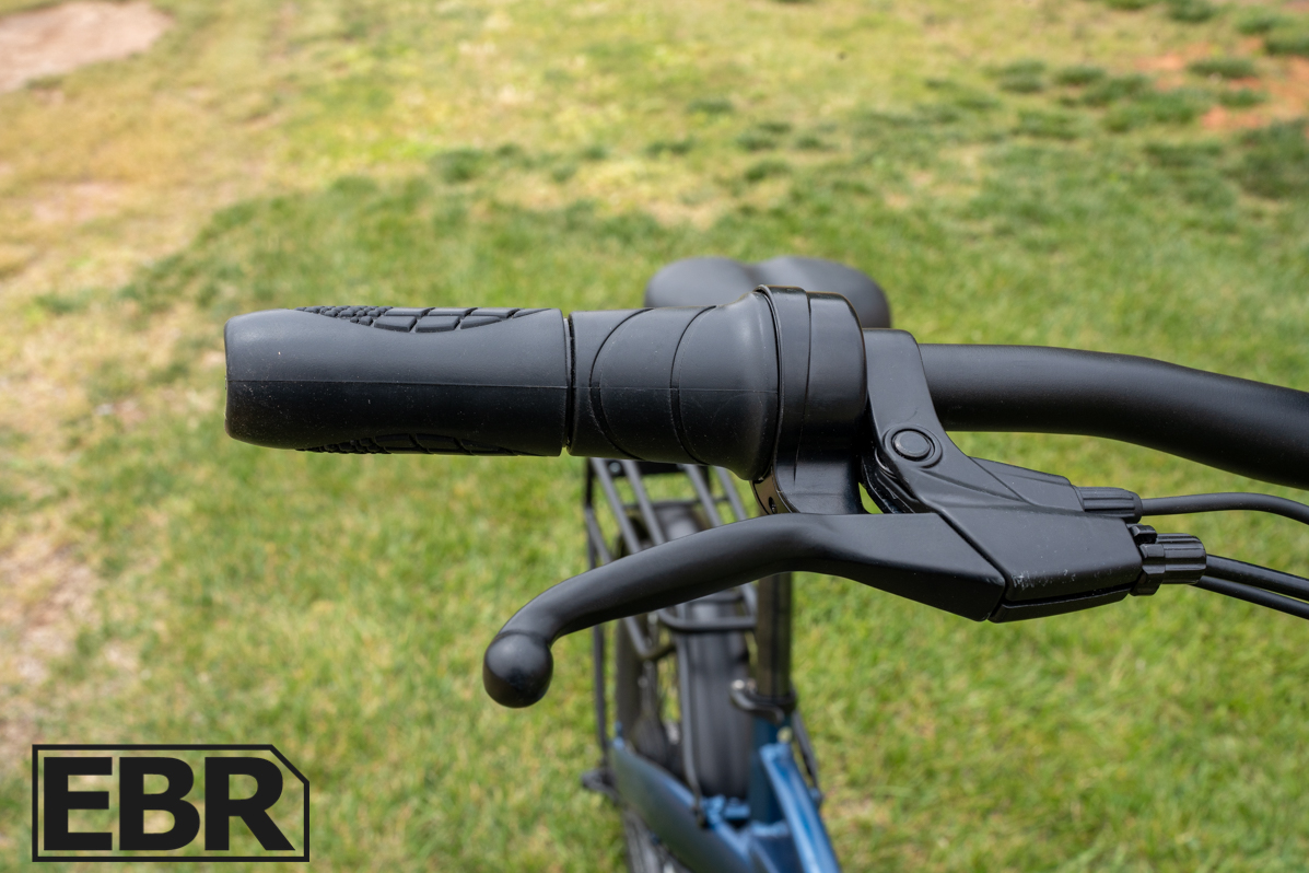

One thing worth pointing out is the throttle engagement: there’s a slight delay before it engages, and once it does kick in, there isn’t a lot of modulation. It’s more of an on/off switch than other twist throttles are.
I actually don’t mind that as a safety feature on a lighter bike like this, since it reduces the risk of accidentally whiskey-throttling. Pedaling wise, you have to almost fully pedal one time around before the motor kicks in, and there is about a quarter to half a second of motor overrun after you stop pedaling. While this is standard for a cadence sensor e-bike at this price point, I’d love to see that programming improved by GoTrax.

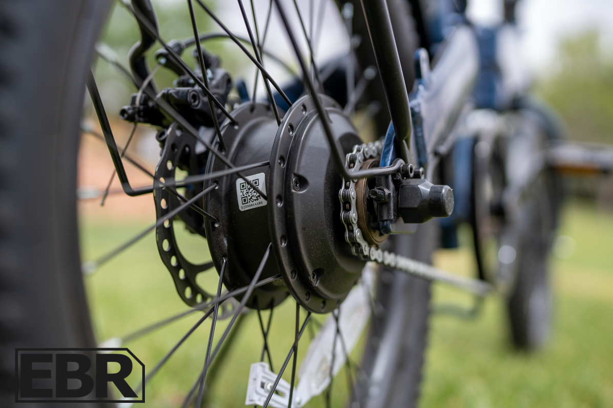

The E-Fold has a 350W rear hub motor. While I don’t know how much it peaks above 350, I will say that the way GoTrax programmed the controller makes the motor feel almost like a 500W motor. It felt more peppy and powerful than I expected from those 350 watts.

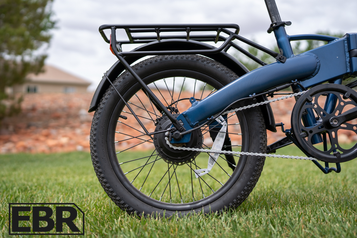

The single-speed drivetrain is the right call for this bike. A 52T chainring up front and a 16T cog in the rear gives you a gear range that balances hill climbing and flat-ground riding as well as a single gear bike paired with a 350W motor can. You’ll ghost pedal a bit above 15-16 mph, but you will also be able to pedal up steep hills.
You will also have less maintenance issues because you won’t have a derailleur. Keep the chain clean and this drivetrain will just work.

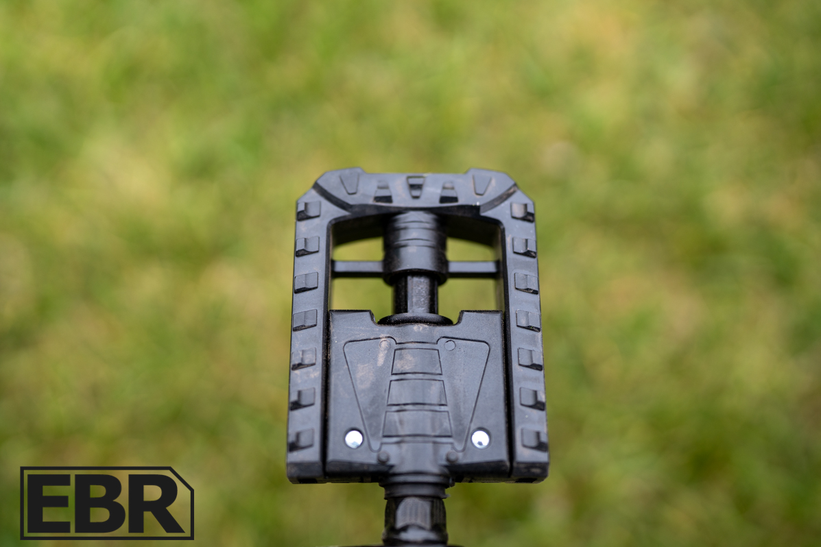

The folding pedals are nice. They fold flat, which makes the bike more compact and keeps the pedal from catching on things when you’re carrying it.

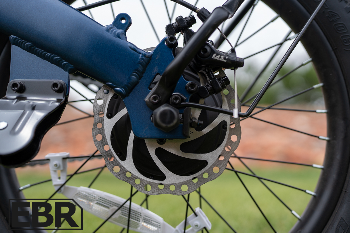

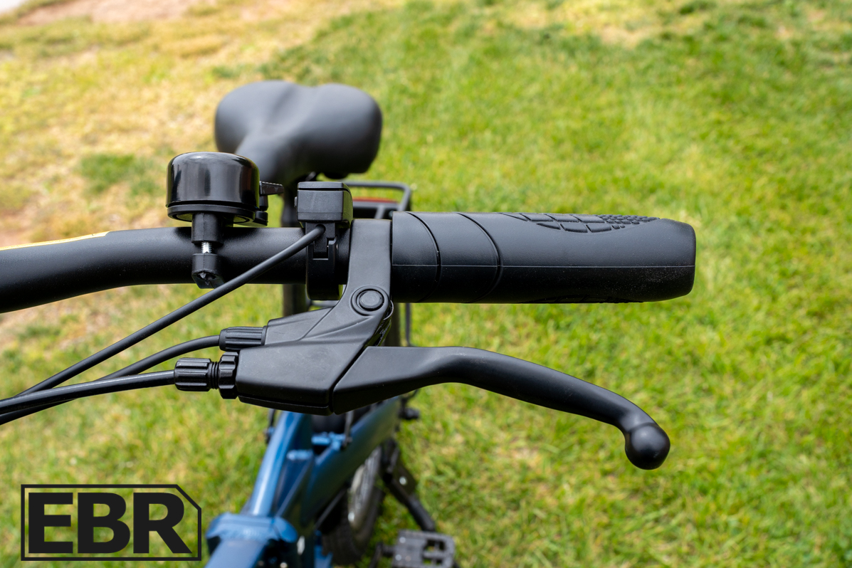

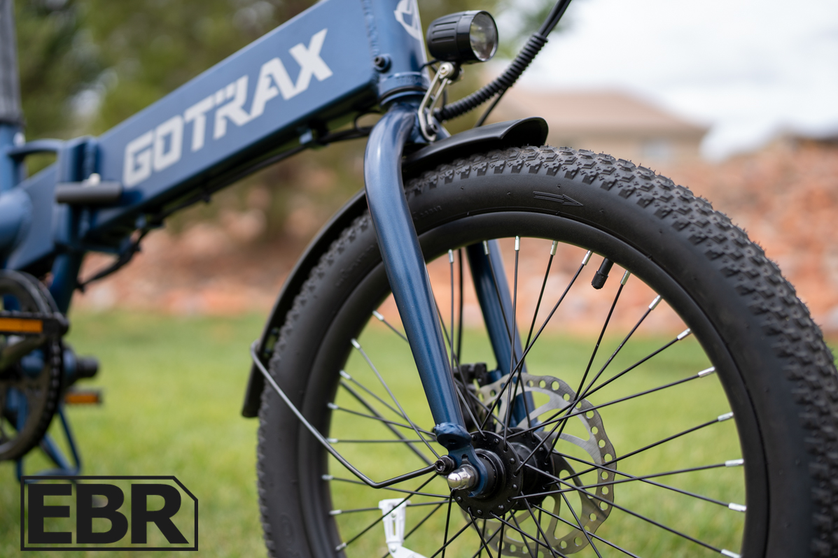

The brakes are mechanical disc with 160mm rotors front and rear, at 1.8mm thickness. While they don’t have the same stopping power as hydraulic brakes, the system is tried and true: it’s a system that’s been used on bikes for decades, and a backyard mechanic can adjust with basic tools since the brakes don’t require a brake bleed. On the road, stopping power was adequate and I felt comfortable. They did make a little noise when I grabbed them hard at speed, but nothing that felt unsafe. If you want more bite, GoTrax offers the F2 and a few other models with hydraulic disc brakes, but you will have to pay $100+ more for that.

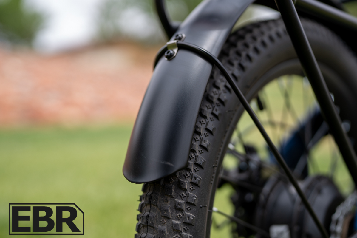

The 20″ x 2.6″ tires sit between a standard commuter tire and a true fat tire. They have enough volume to absorb bumps in the road and light gravel, but they’re not going to be as plush as a suspension fork would be – although I don’t think you need that on this style of bike in general (personal opinion). The knobby tread pattern gives you some confidence on light dirt or wet pavement.

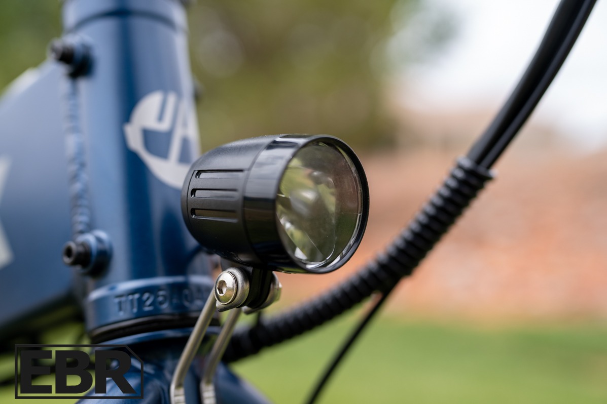

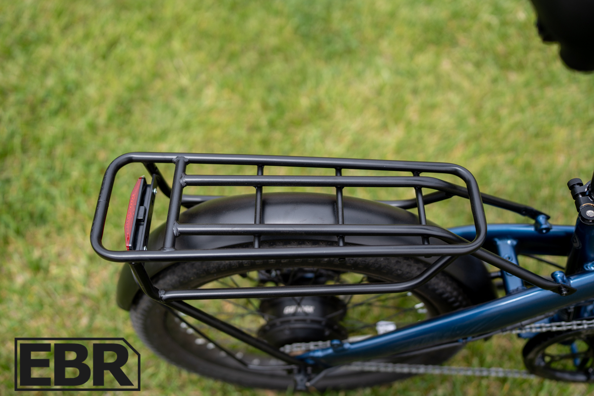

The rest of the package is better than expected for what this bike costs. You get front and rear metal fenders (I’d prefer a hard plastic over metal, but at least you don’t have to pay more for them), a rear cargo rack, a front LED headlight, a rear LED taillight, a kickstand, and a bell. Basically, you can throw a bag of groceries on the rack and ride home from the store without any add-ons.

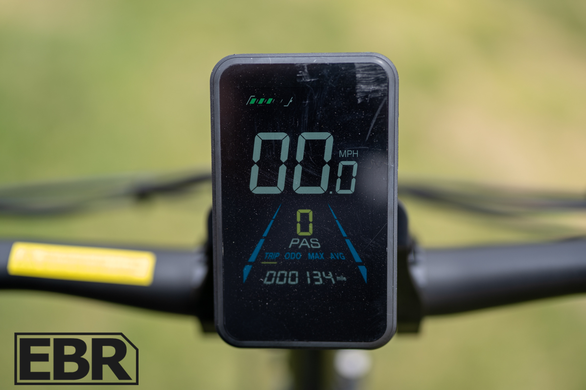

I have to give GoTrax some credit here: I like the color display on the E-Fold. It’s center-mounted on the handlebar, easy to read from the saddle, and is easy to see even in bright daylight. The display shows your speed, assist level, trip odometer, and a battery bar indicator. You can cycle through max speed and average speed with the top right button on the control pod.
The display does what you need it to do at this price. It’s not a TFT with Bluetooth or real-time wattage readout, and there’s no companion app, but those are expectations you bring from a $1,000-$1,500 bike. That being said, I’d still like to see GoTrax (and all budget-level brands) find a way to spec their bikes with accurate percentage battery readouts instead of the 5-bar readout.
While the readout was reasonably accurate through most of the range test, it dropped off faster than expected near the end, which made it harder to gauge exactly how much battery was left.
Navigating the settings is straightforward. You hold the plus and minus buttons to enter the advanced menu, which lets you change the display language, the number of assist levels (I’d recommend keeping it at 0-5 rather than 0-3), and the wheel size. One odd note: there is a setting that appears to let you change the top speed from 20 to 25 mph, but it doesn’t actually do anything. The motor still cuts out at 20 mph. It’s a Class 2 bike, so that’s not a problem – just interesting.

GoTrax keeps the E-Fold lineup simple with one size, one color (blue), and only one frame style. What you see is what you get. For a brand trying to keep costs down and deliver a complete bike at $500, that model simplification makes sense.
The rider height range is also pretty good for a single-size bike. Between the seat post adjustability (very low to quite high) and the adjustable stem, GoTrax has made the fit work for a broad range of riders. Based on my testing and with our taller colleagues in the office, I’d say roughly 5’3″ to 6’3″ can find a comfortable fit. Those on the edges of course won’t have a perfect leg extension and reach, but it’s still better than many other single-size bike options.
