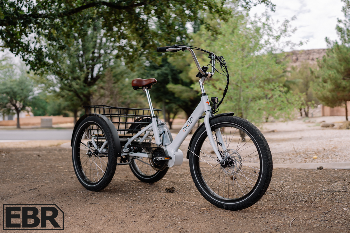

I was sent the gloss white version of the Compass—hopefully you like white because that’s your only option with this one-color, one-size-fits-most setup. The ride position is upright and relaxed, with a surprisingly comfortable tan leather saddle that really helps keep things pleasant on longer rides. That low 15″ standover height makes mounting and dismounting way easier than a traditional bike, and those parking brake features keep everything rock-steady while you’re getting on and off.
EVELO claims this fits riders from 4’10” to 6’2″, which is pretty ambitious, but at 5’11” I never felt like it was the wrong size—not too cramped, not too stretched out. The fit worked well for me throughout the size range.
Even without any suspension, the ride is surprisingly smooth thanks to those chunky 24″ x 2.4″ tires and that comfy saddle. Now, here’s something I always test with trikes—the dreaded tipping point. Every delta trike (one front wheel, two rear) has that moment where physics takes over if you get too aggressive in corners. What made me curious about the Compass was those 24″ wheels instead of the more common 20″ size, which raises the center of gravity by about 4 inches.
So, does that higher center-of-gravity make it more tippy?
Turns out, no.
I did my usual series of increasingly aggressive corner tests, starting slow and ramping up speed until I felt that the inside rear wheel start to lift. The Compass held its composure until around 13-14 mph before things got sketchy—that’s actually a solid result. Most folks aren’t going to attempt tight corners anywhere near that speed on a trike anyway, so for normal riding, the Compass handles its size and higher center of gravity just fine. I felt confident hitting turns throughout my test rides.

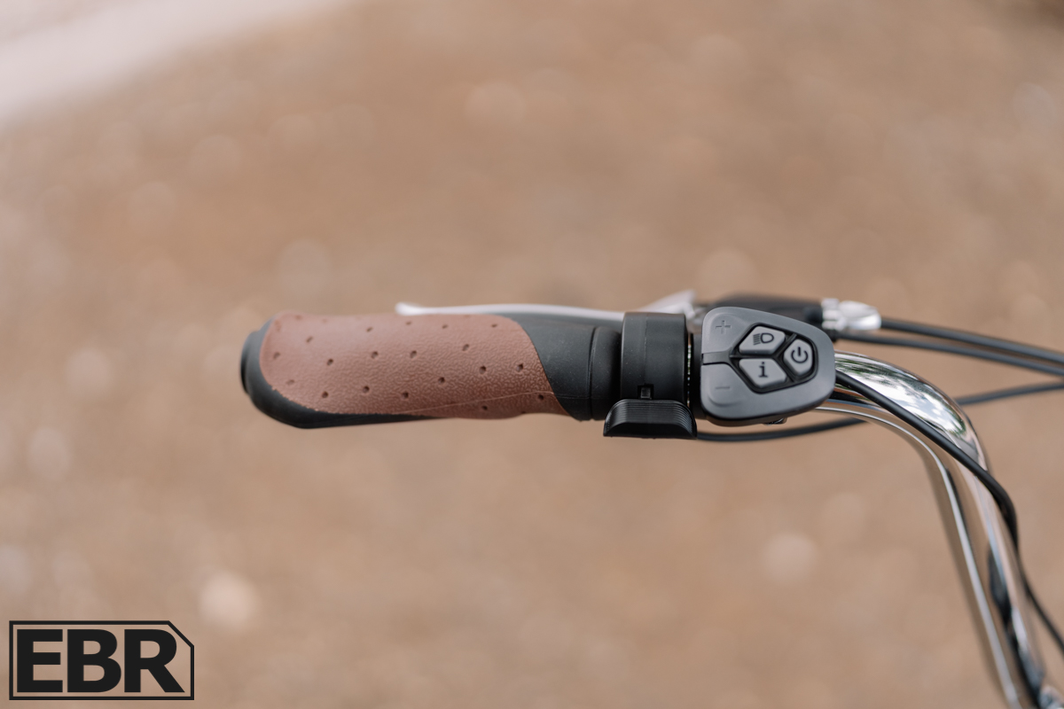

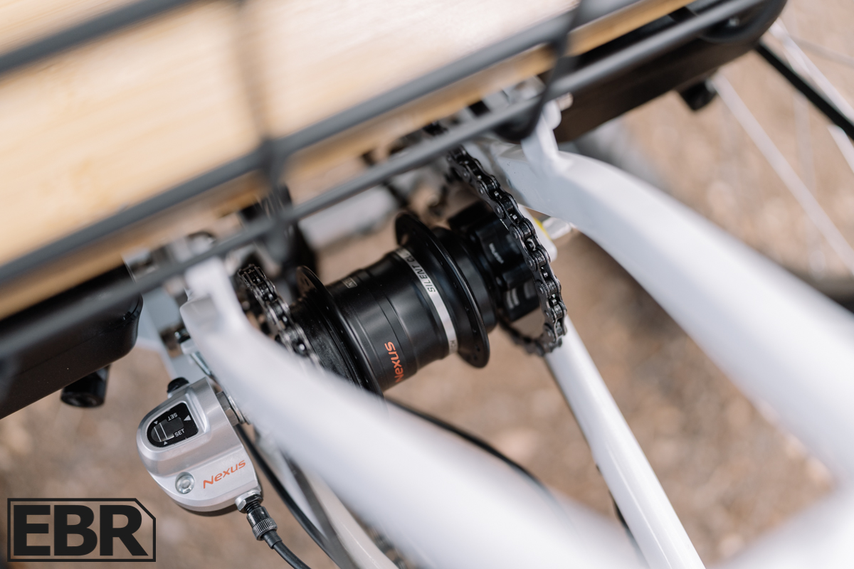

One of the coolest features (beyond that mid-drive motor) is the Shimano Nexus 3-speed internal hub. No finicky rear derailleur to deal with—just a simple twist shifter that controls three speeds tucked away inside a sealed hub unit. Less maintenance, less mess, less tinkering than traditional setups. It’s perfect for the target audience.

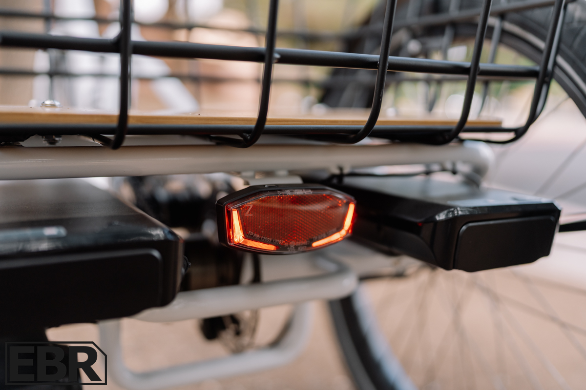

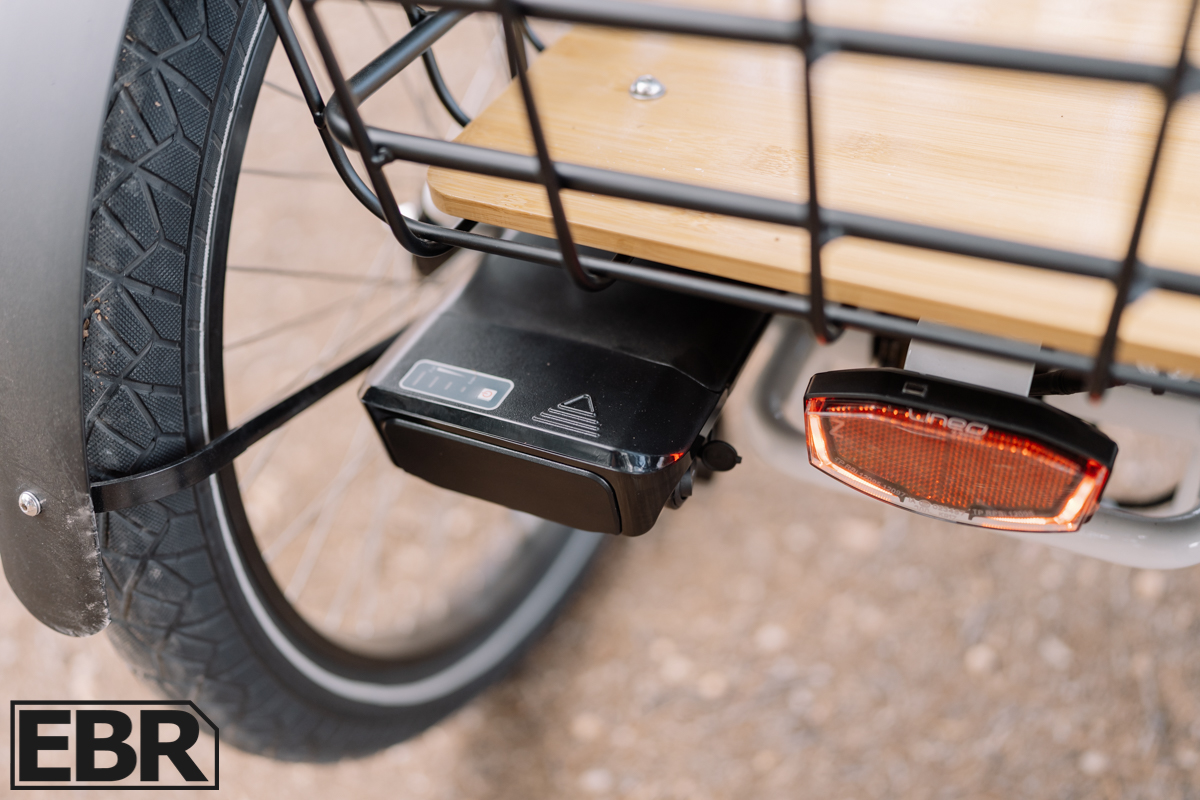

While my test bike came with just one battery, there’s actually space for two under that rear rack to double your range if needed. Pretty slick setup.

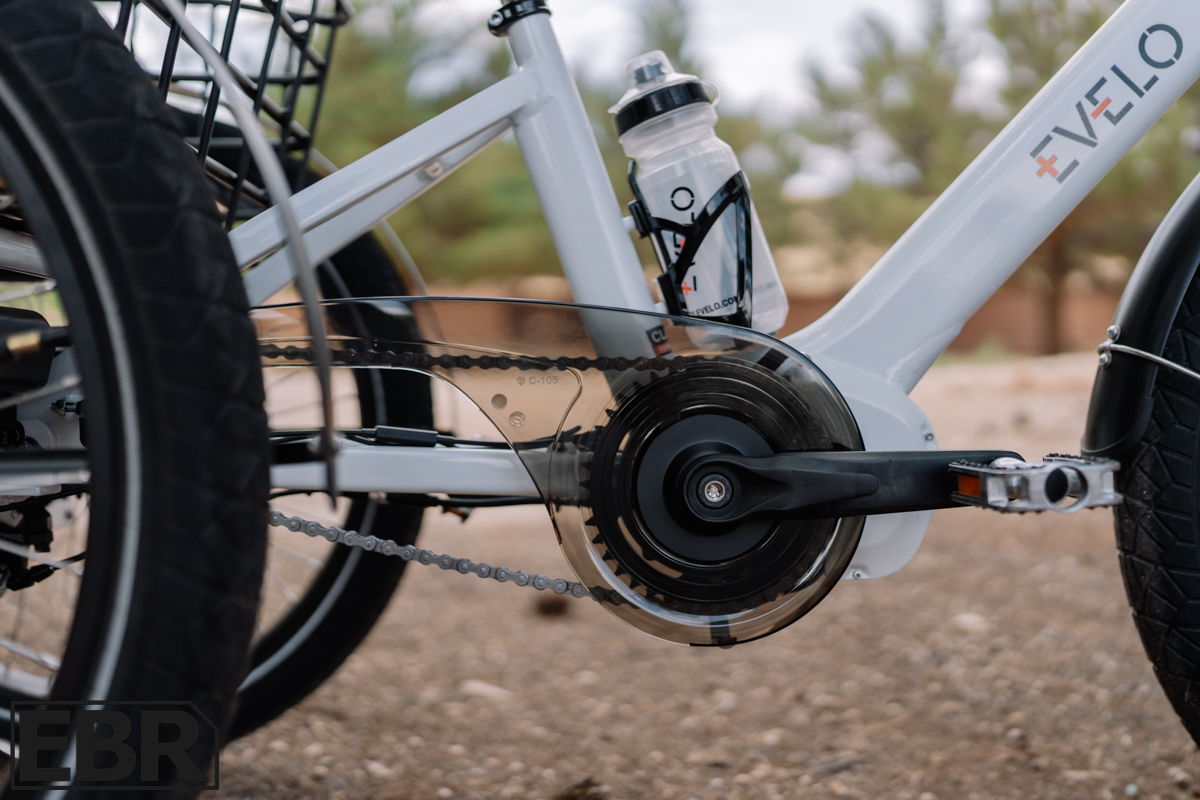

The heart of the Compass is a Bafang BBS02 mid-drive motor—a 500W unit that peaks at 960W with a hefty 105 Nm of torque. What surprised me was discovering this is a cadence sensor-based mid-drive, which isn’t something you see super often these days. But honestly, I think it works better for this application. Most trike riders aren’t chasing that refined, natural pedal feel you’d want on a high-end road bike—they want something easy, stable, and reliable to get around town, and this delivers exactly that.
The low-end grunt is impressive. Hills that would make you sweat on a regular bike become no big deal, and you get a confident, smooth start from stops without feeling too aggressive. Just keep it reasonable—fire this thing up in PAS 5 from a dead stop and it gets a bit jumpy, so stick to the lower assist levels when you’re starting out. The cadence sensor needs about half a crank rotation to kick in the power, which feels natural enough, and the motor cuts out immediately when you hit the brakes for safety.
As for top speed, EVELO advertises 20 mph, but I consistently maxed out at 19 mph—close enough for government work. The five PAS levels give you plenty of flexibility to dial in exactly how much help you want.
Powering all this is a 48V 10.5Ah battery pack (504Wh total), mounted below the rear rack with room for a second battery if you want to double your range. Nice touch: there’s an external LED display on the battery that shows charge level without having to plug it in or slide it into the bike—way more convenient than fumbling around trying to check battery status. The battery isn’t UL certified, but EVELO says it’s built to UL certification standards, which is something at least.

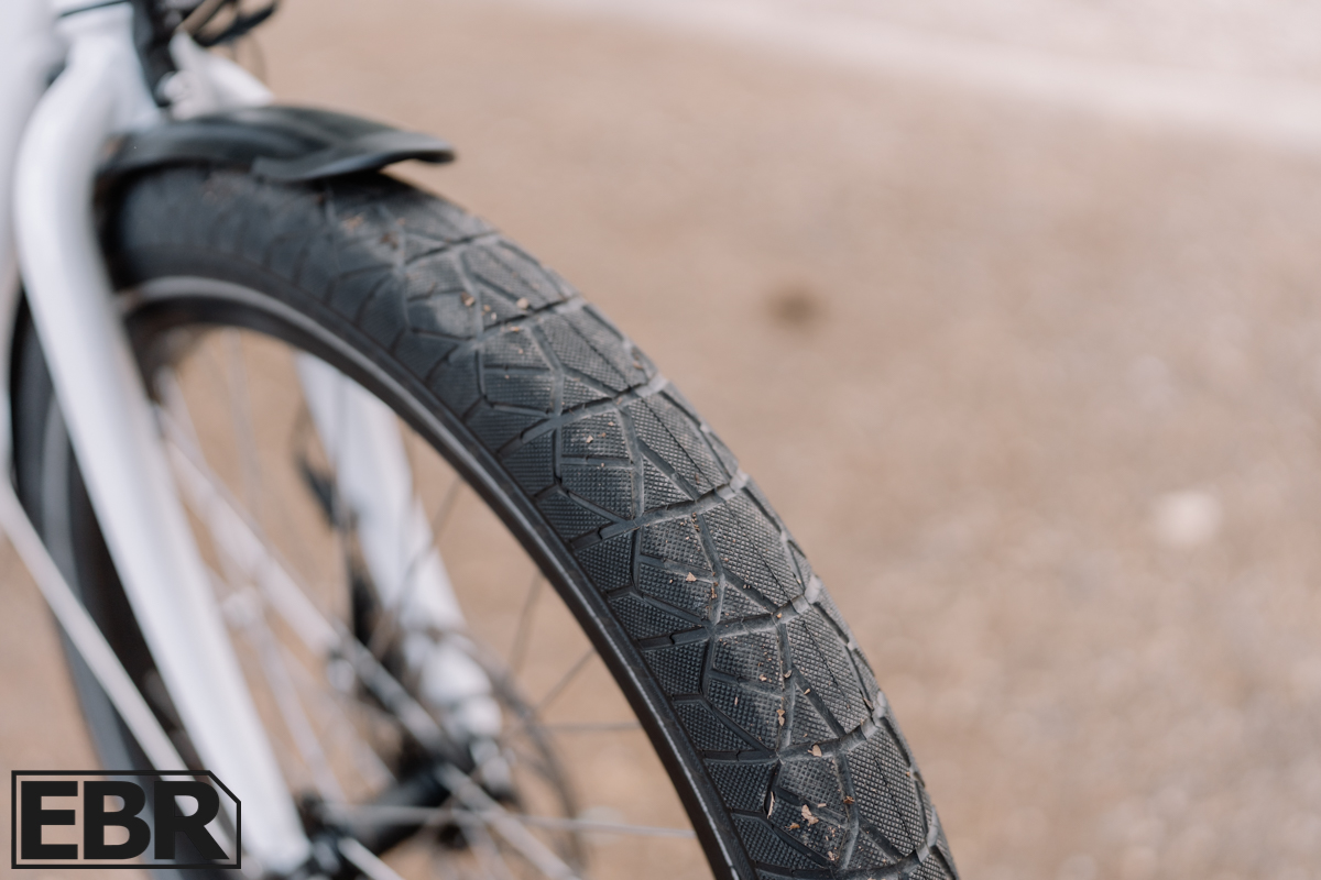

The CST Cyclops tires (24″ x 2.4″) with aramid flat protection strike a nice balance between comfort and puncture resistance. They’re wide enough to provide cushioning without suspension while giving you confidence that road debris won’t strand you miles from home. The composite fenders aren’t fancy, but they’ll keep you dry and clean without adding much weight.

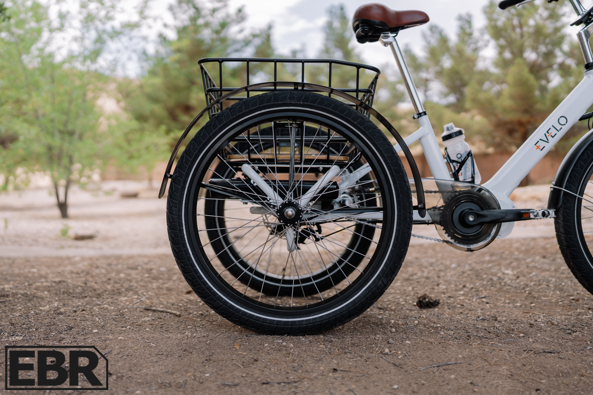

Now for the tech that really sets this trike apart—that rear differential system. Most delta trikes just send power to one rear wheel, which can cause issues with traction and handling, especially on loose surfaces or when turning. The Compass actually drives both rear wheels simultaneously through what appears to be a mechanical differential system.
Think of it like a car’s differential—when you’re going straight, both wheels get equal power. When you turn, the outer wheel needs to spin faster than the inner wheel to maintain traction without scrubbing. A traditional single-wheel-drive trike can struggle here because the powered wheel might lose traction while the unpowered wheel just drags along. With power going to both rear wheels through a proper differential, you get better traction, more predictable handling, and less tire wear.
It’s honestly pretty clever engineering that addresses one of the fundamental weaknesses of most electric trikes. Whether you’ll notice the difference day-to-day depends on your riding style and terrain, but it’s the kind of thoughtful feature that justifies calling this a premium trike.

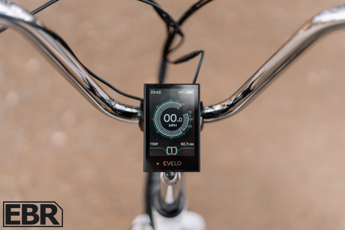

The Compass comes equipped with a 3.2″ IPS display (DPC-18) that keeps things refreshingly simple. It’s bright and easy to read while you’re riding, which is really all you need from a display. No squinting at tiny numbers or struggling to see what’s going on when you’re moving.
All the basics are covered: current speed, elapsed time, real-time power output in watts, odometer, PAS level (numbered 1-5, not fancy names like “eco” or “turbo”), and remaining battery charge. It’s a straightforward setup that gives you the info you actually need without getting cluttered with features you’ll never use.
There’s no mobile app integration here—this is old-school, button-controlled simplicity. Some folks might miss having smartphone connectivity or the ability to track rides through an app, but honestly, it’s kind of refreshing to just get on and ride without worrying about Bluetooth connections or app updates.
The display is mounted in portrait orientation with physical button controls that are easy to operate even with gloves on. There’s also a USB charging port built in, which is handy for keeping your phone topped off during longer rides.
If you’re looking for high-tech features like GPS tracking, smartphone integration, or advanced ride analytics, you’ll need to look elsewhere. But if you just want a clear, reliable display that shows you what you need to know, the Compass delivers exactly that.
