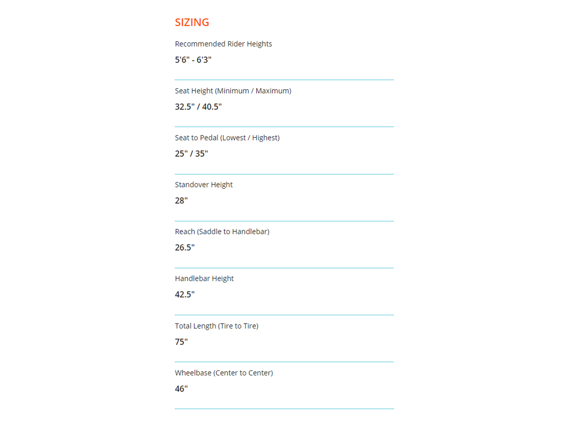

17.5" Seat Tube, 23.8 Reach, 29" Stand Over Height, 33" Minimum Saddle Height, 42" Maximum Saddle Height, 26.5" Width, 75" Length, 46.25" Wheelbase

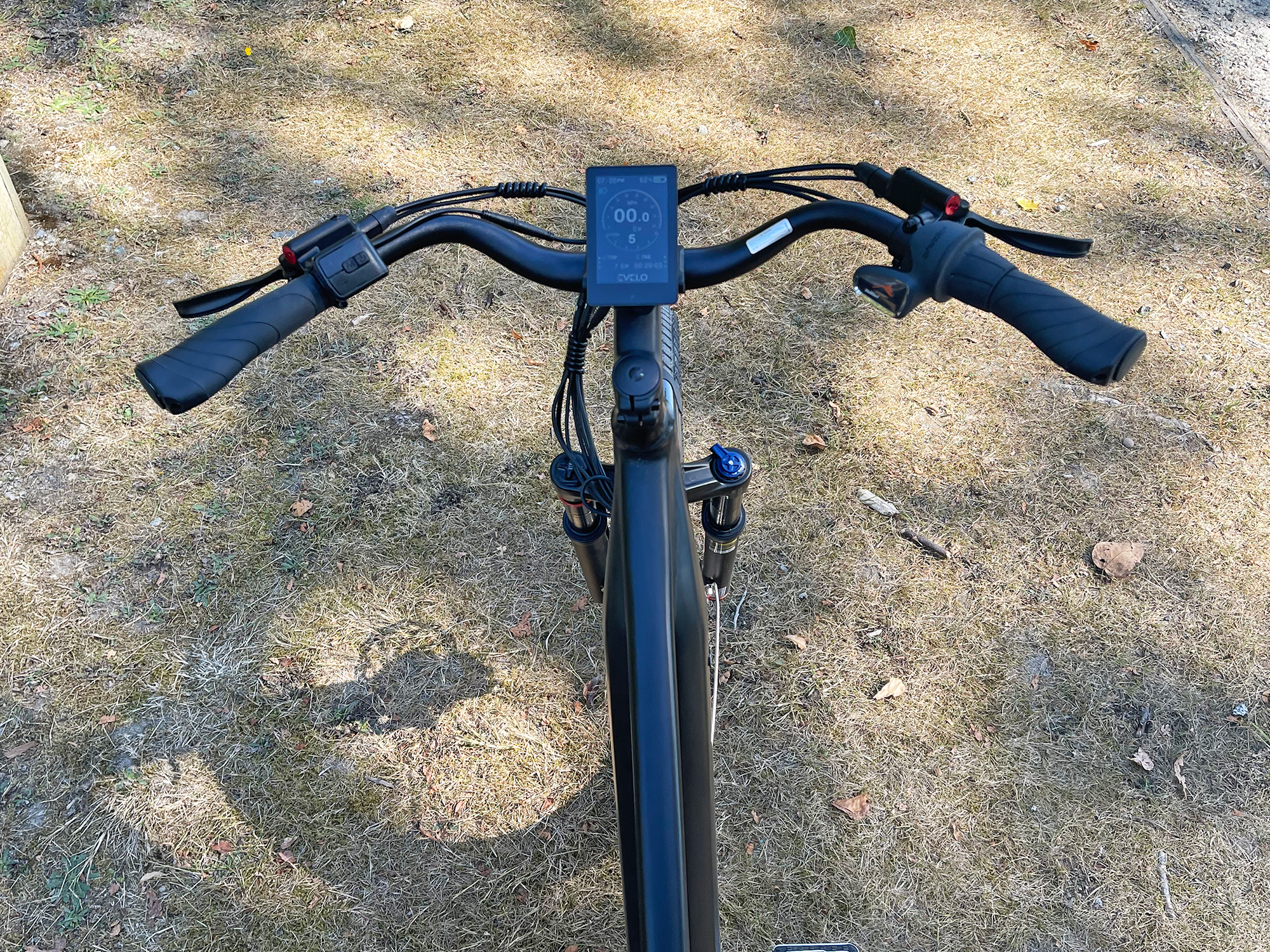

Independent Button Pad on Left, Buttons: +, -, Set, Power, Lights: Hold + Button, Settings Menu: Double Tap M Button, USB Type A Port on Battery Pack (5 Volt 1 Amp Output)
Current Speed (MPH/KMH), Odometer, Trip Distance, Battery Charge Level (Percentage), Assist Level (0-5), Range Estimate

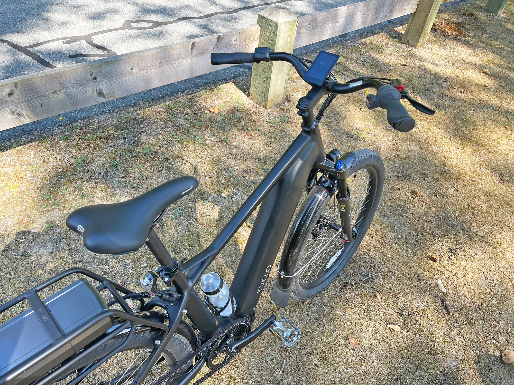

  • The Atlas is configured for urban use with smooth tires, fenders, and integrated lights… but it could easily double as a cross country mountain bike if you swapped the tires for knobby tread. The frame is fairly rigid, and the 110mm air suspension fork with 15mm thru-axle is definitely off road capable.
  • This model only comes in one frame size and color, to achieve economies of scale and keep the price lower. I noticed the sloped top tube with lower stand over height and swept-back handlebar which help improve fit for different sized riders.

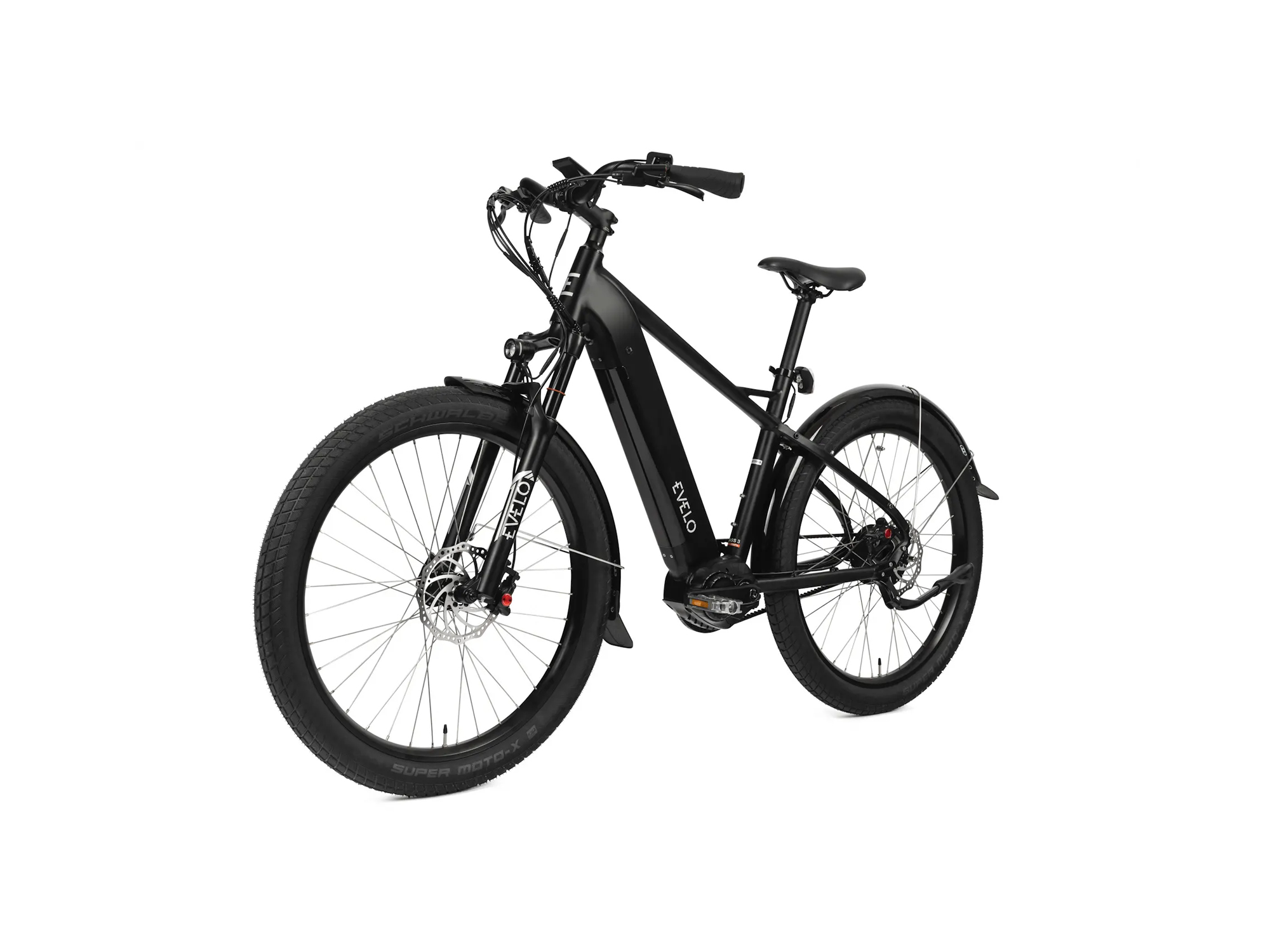

  • Sturdy high-step frame is capable of handling heavier riders and loads, up to 350lbs total. The suspension fork and 15mm thru-axle are very capable, so this could be used for light trail or cross country riding if you swap the tires and remove the fenders.

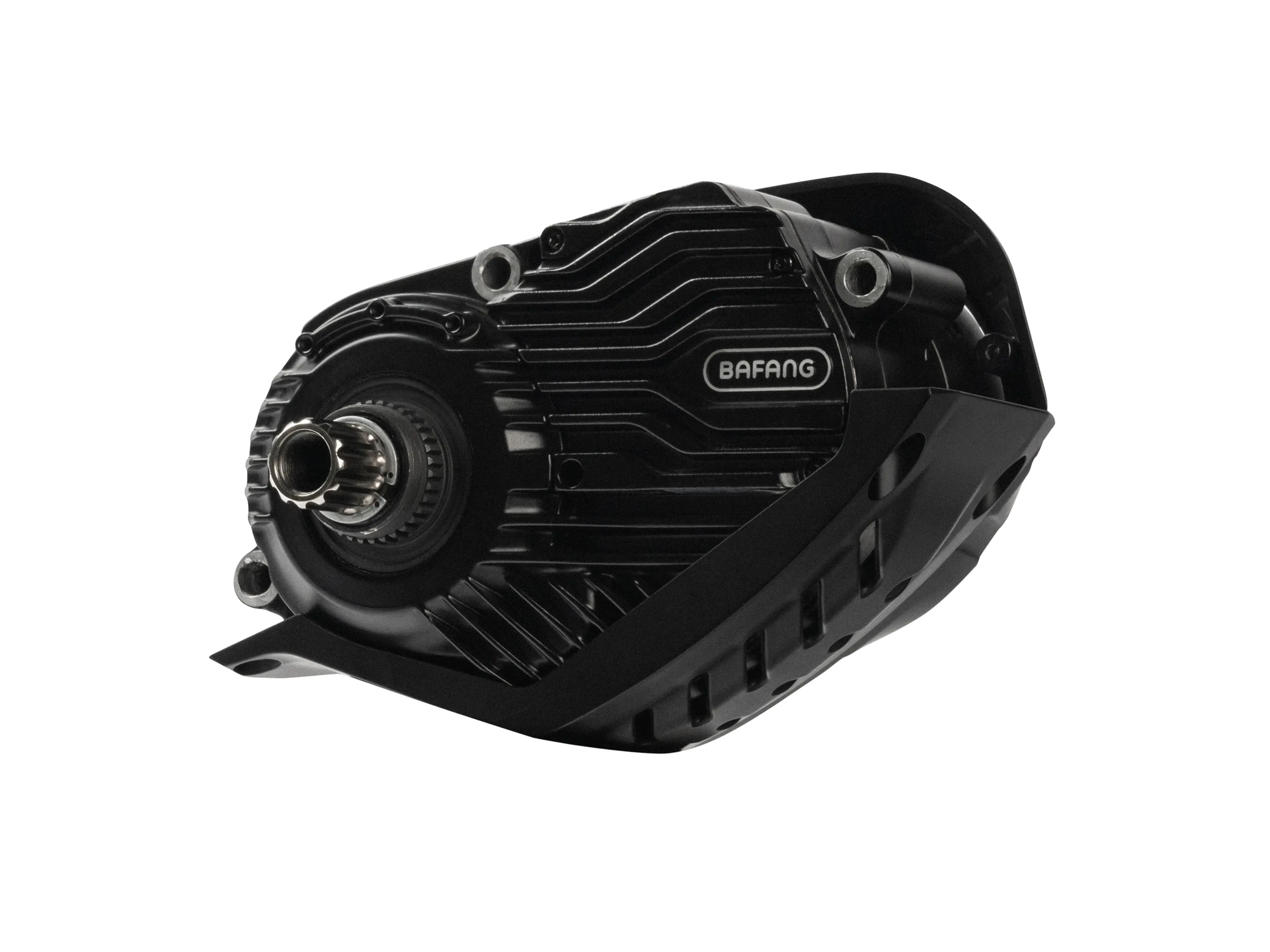

  • The bike uses a high powered mid-drive motor that’s setup as Class 3 for high speed. It’s also pre-wired for an optional trigger throttle, making it extremely versatile. It ships as Class 3 but could be used for off-road with the throttle. If you decide to purchase the rear rack, it would be great as a commuting platform.

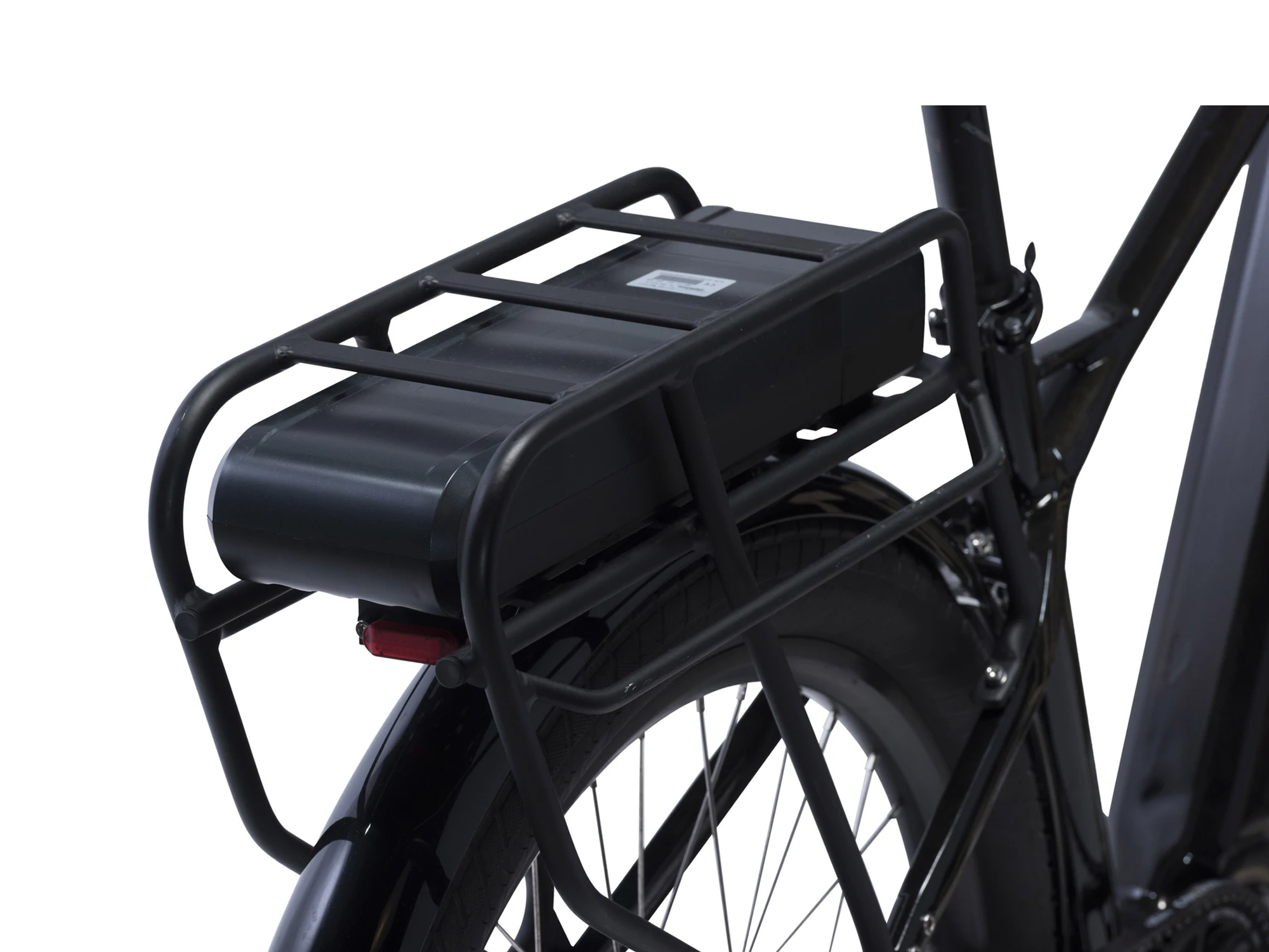

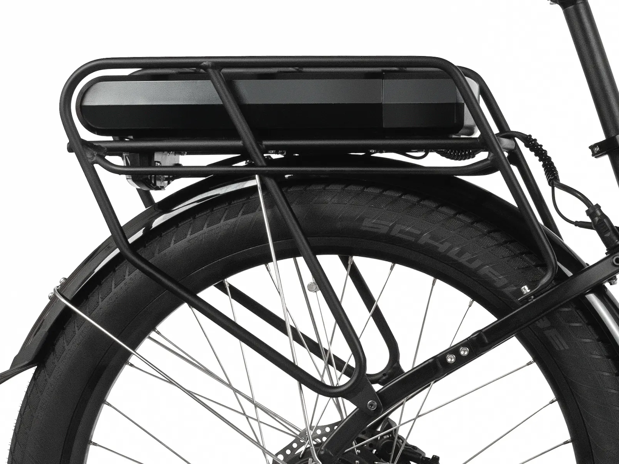

  • For those who wish to ride farther, or rely on the higher assist and throttle modes, EVELO sells an optional second battery pack that mounts using a special rear rack (shown in the video and photos above). This effectively doubles range, and is a unique feature in the world of ebikes. I was impressed that it only costs $800.
  • I appreciate that the optional trigger throttle is setup to override assist, so you can use it to start from standstill and reach top speed, or override lower levels of assist to climb or catch up with a friend all without pressing additional buttons and looking at the display.
  • The bike comes pre-wired for the second battery, and I’m told it will balance and charge in tandem with the primary downtube battery using one charger. The charger itself is rated at 3 amps, which is faster than the 2 amp chargers I usually see.

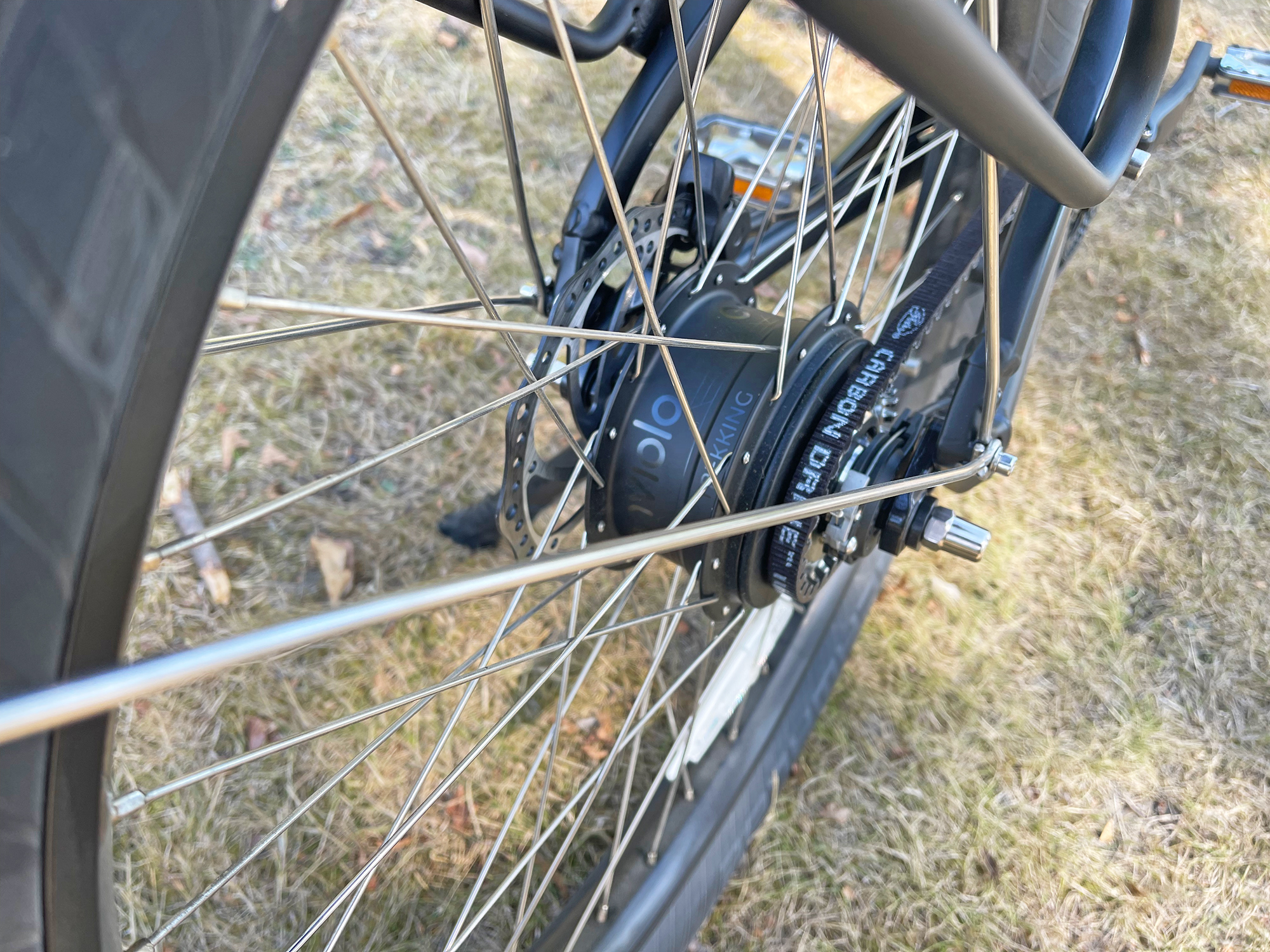

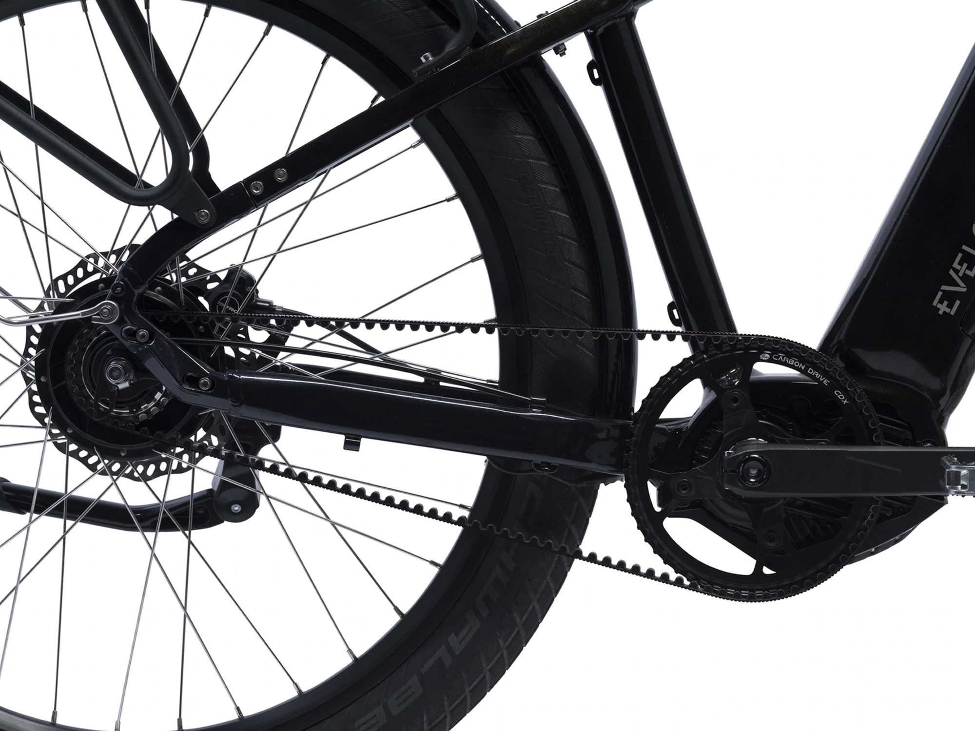

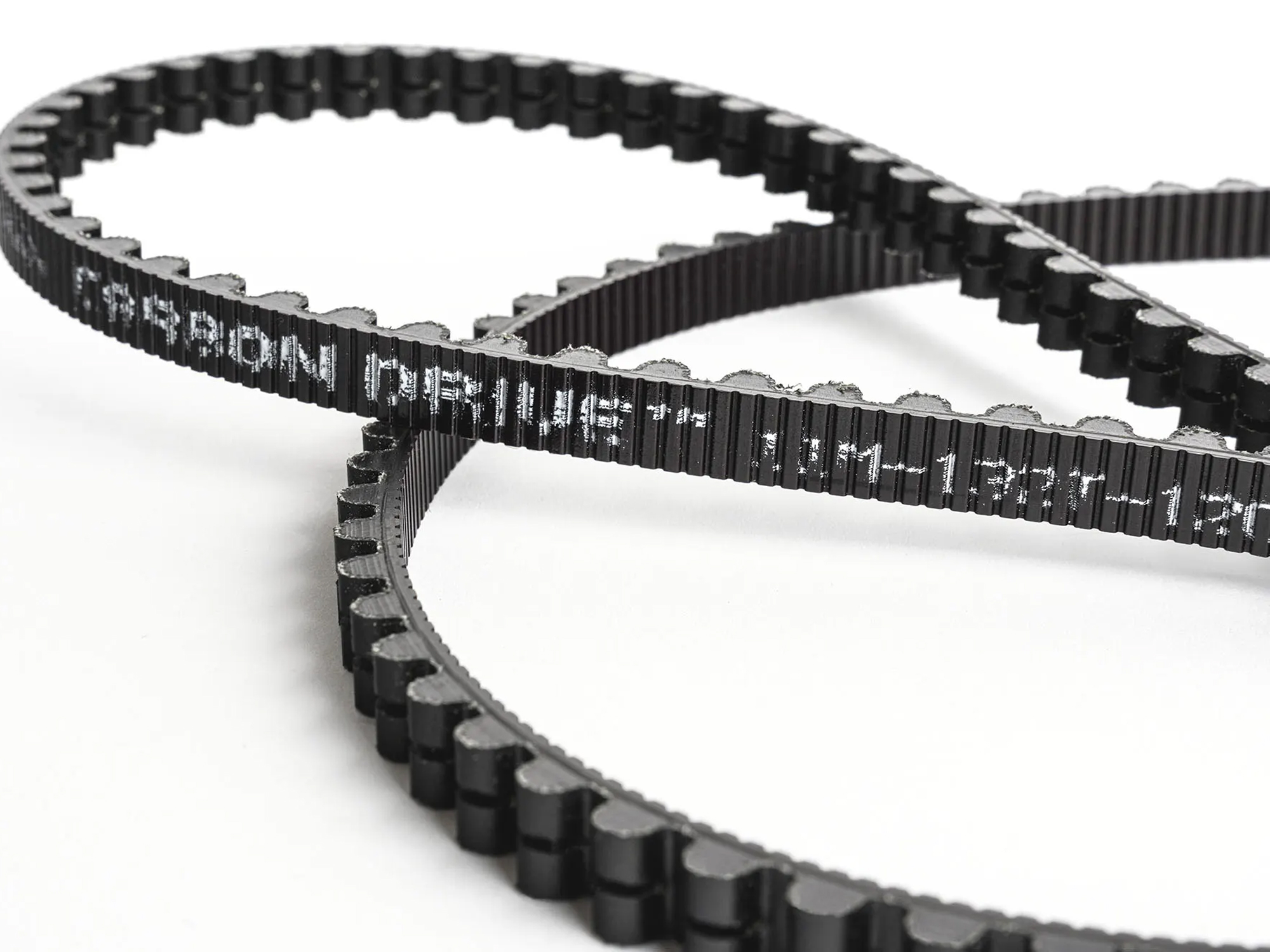

  • Gates Carbon belt drive is more durable than a chain, and super quiet and clean. The frame had to be specially engineered with a break on the right seat stay in order to use a belt drive like this.
  • The Enviolo continuously variable planetary transmission hubs are recognized for being smooth, able to shift at standstill, and very durable. They are also clean and quiet, especially when paired with a belt drive like this. The half-grip twist shifter is easy to understand and use, even for new cyclists.

  • With a torque rating of 120 newton meters, this is one of the most powerful ebikes around. I was impressed by how well it climbed the dirt hill during my demo, and feel that it would inspire confidence for people who live in hilly areas or who weigh more, or plan to carry heavy loads with that optional rear rack. I was told that the controller has been optimized to start smoothly, despite the high torque, so it feels comfortable and is easier on the drivetrain.

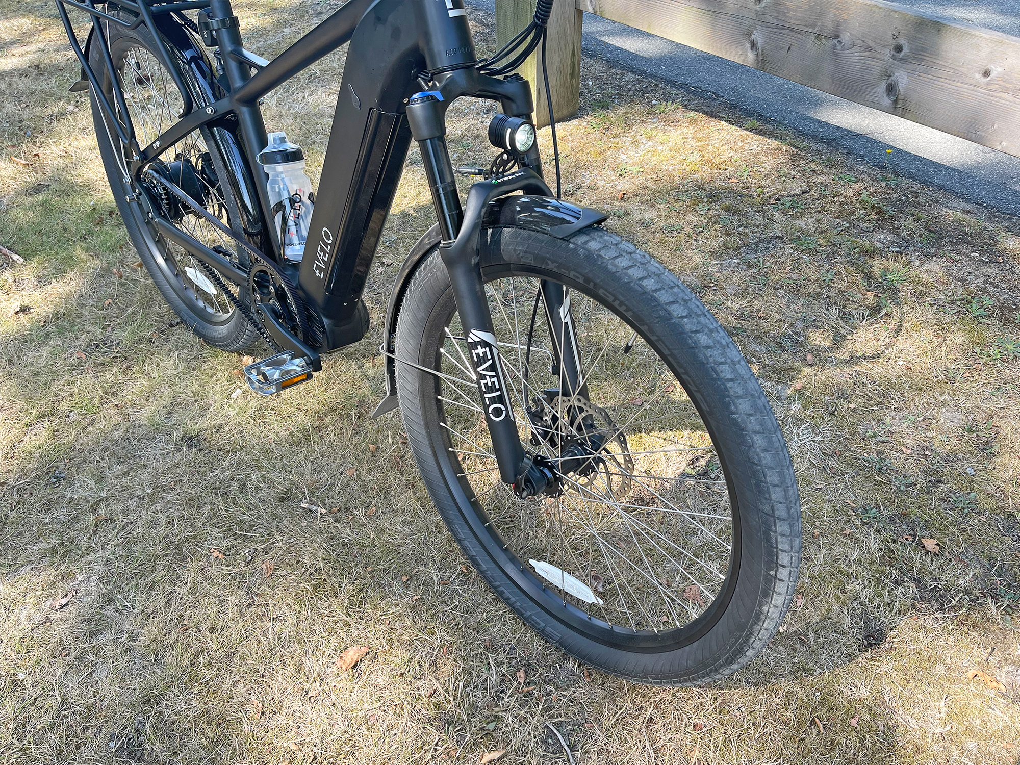

  • The plus sized Schwalbe Super Moto-X tires provide excellent comfort and stability because they’re wider at 2.8″ and that means increased air volume and surface area… this allows you to ride over grass, packed Earth, small rocks, and even some gravel and light cross country trails without losing traction, you can reduce weight and make them more durable by converting to tubeless (as I am told that they come tubeless ready).
  • The frame is purpose built, meaning that it was designed to handle the additional forces of a motor and internal battery. Most wires are internally routed to reduce the possibility of snags, and to make it more aesthetically pleasing.

  • Both optional rear racks are rated to carry up to 25kg and are designed well. For the battery rack combo, that means you can support 25kg in addition to the battery pack which weighs ~7.4lbs already. Note the pannier hanger on both racks that will work with most pannier bags.

  • From what I could tell, the rear light is blocked by the rear fender. This is resolved if you purchase the optional rear rack with battery, because it has a second light built in that’s actually brighter with two LED’s.

  • The Enviolo CVT hubs tend to weigh more and be less efficient than a traditional cassette and derailleur. There’s traction fluid and metal orbs inside. I also noticed that shifting under load can be difficult, so I usually ease off a bit when shifting… though it’s very easy to do at standstill.

  • Because this ebike has motor inhibiting brake levers, a display, a control pad, and an optional throttle, there are more wires up front and that creates some clutter. That said, the internal routing helps to keep the rest of the frame clean of clutter.
