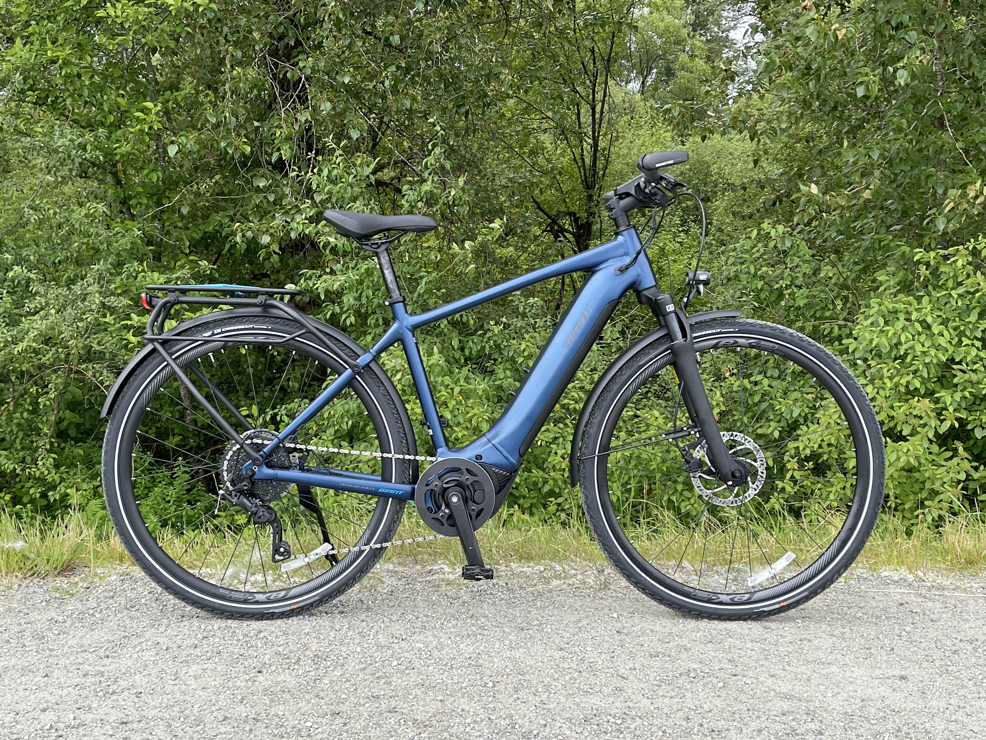

- This is the fancier more powerful version of Giant’s hybrid model which is capable of being a commuting ebike or light cross country mountain bike. It comes in both High-Step GTS with four frame sizes and Mid-Step STA with three frame sizes. The only color option for the 2022 model year is satin metallic navy blue with black accents.

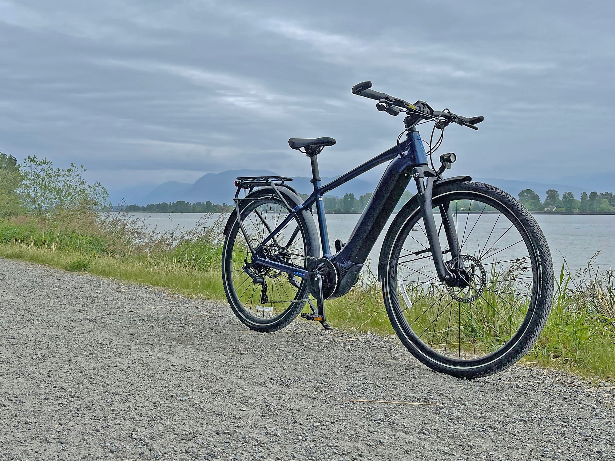

- The Explore E+ 2 is a “do anything” platform that is capable off-road on light mountain trails or gravel roads, as well as city streets. It excels with safety because of the integrated lights, reflective tires, and smart responsive motor systems. The drivetrain, motor, and battery are all high quality and I’d expect them to last.

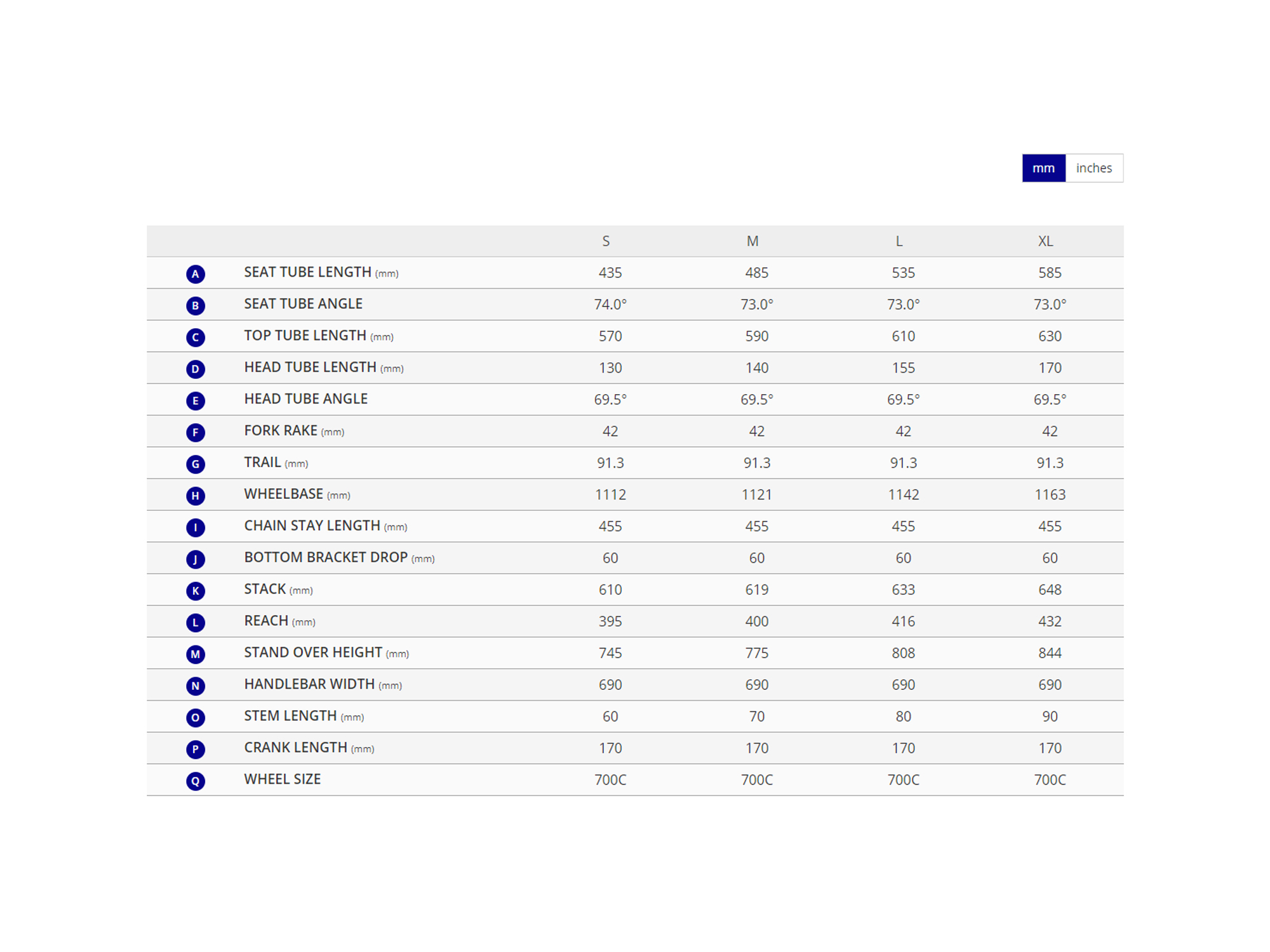

- I think it’s great that they offer two frame styles. The mid-step is more approachable for people with hip and knee sensitivity. I test rode the medium high-step frame and felt very comfortable on it. Benefits of the high-step include reduced frame flex, easier to lift and mount on some car racks, and it has a bottle cage mount on the seat tube. It does not appear that the mid-step version has a bottle mount.

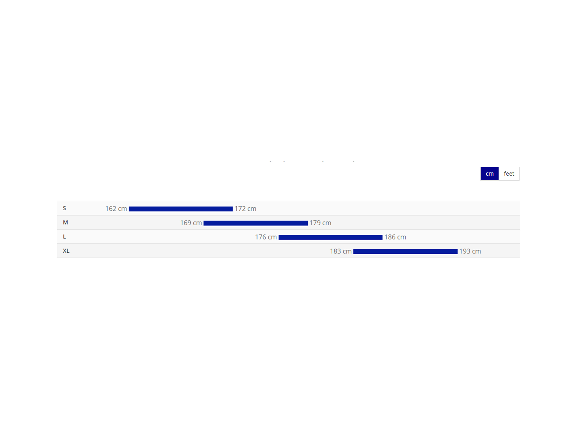

- In addition to the two frame styles, each version comes in several sizes. The high-step comes in four sizes and the mid-step comes in three frame sizes… or if you get the similar Liv Amiti E+ 2 step-thru it comes in four sizes! The adjustable seat post, low-rise handlebar (that can be swiveled forward or back to adjust reach), and adjustable brake levers all offer refined fit.

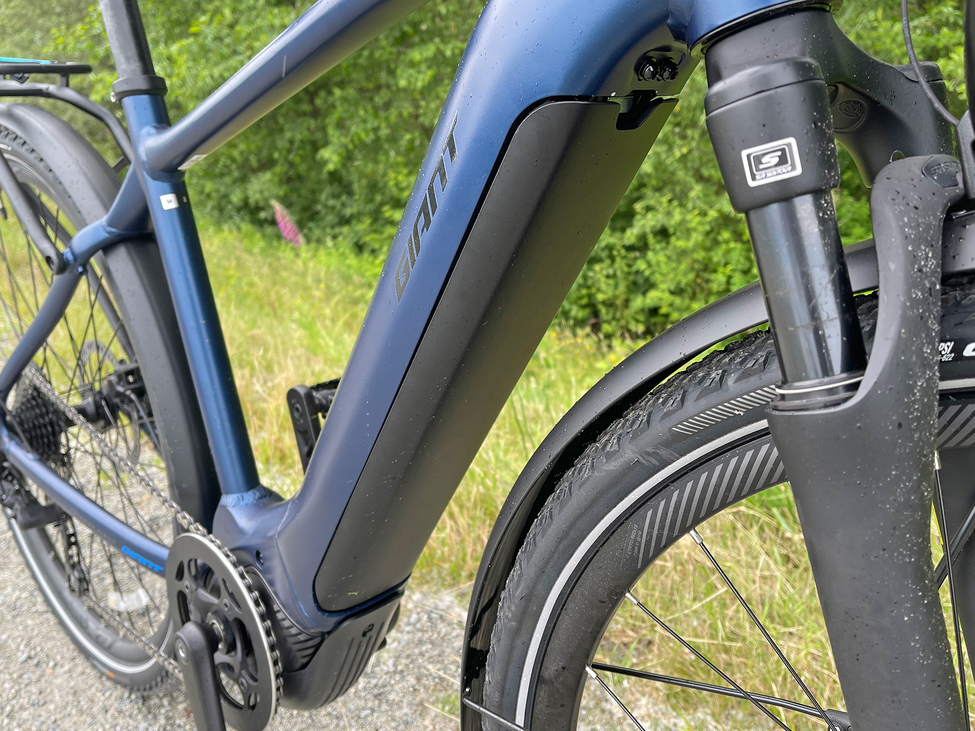

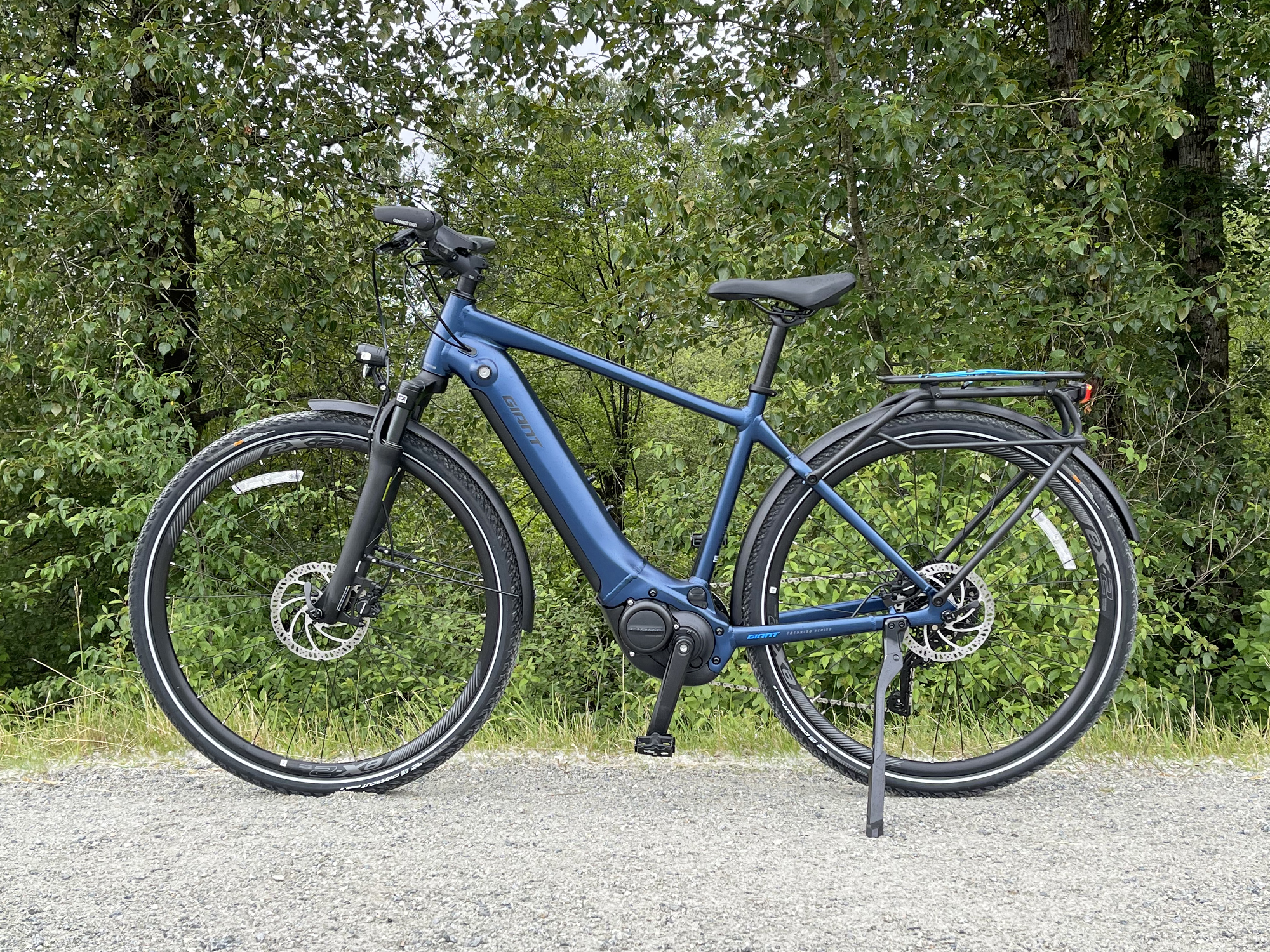

- This ebike looks very professional and almost like a regular bicycle because of the integrated downtube battery pack. You can tell they scrutinized all of the details and were tasteful with labels and branding. Note the matching black suspension fork, hubs, spokes, and other hardware. Most of the wires are internally routed, so they don’t look busy and won’t get snagged as easily.

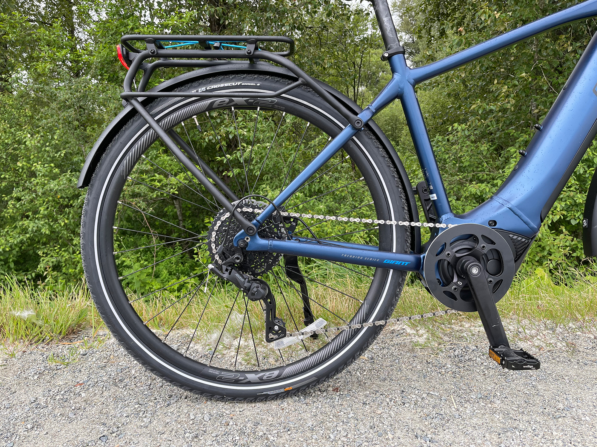

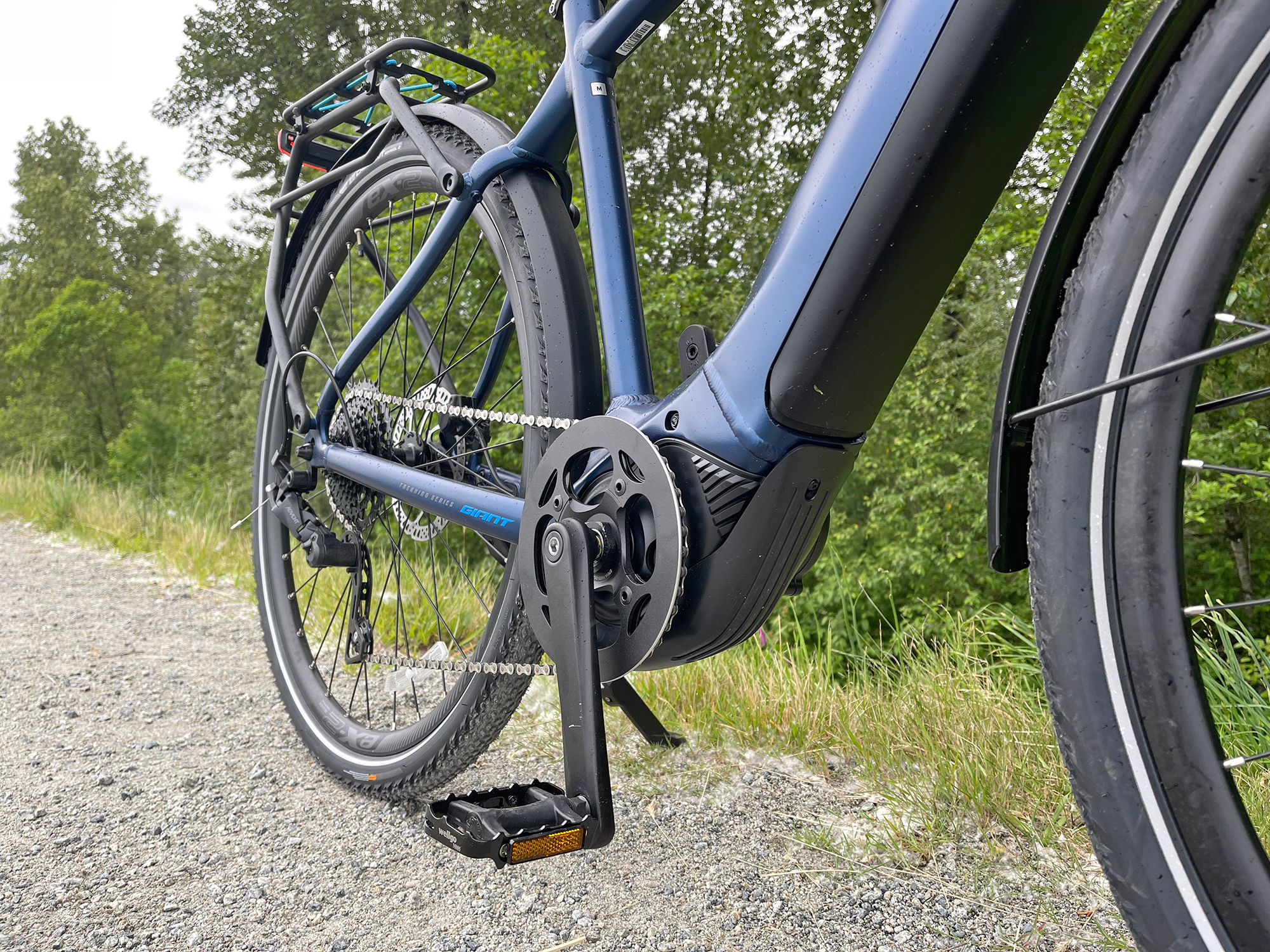

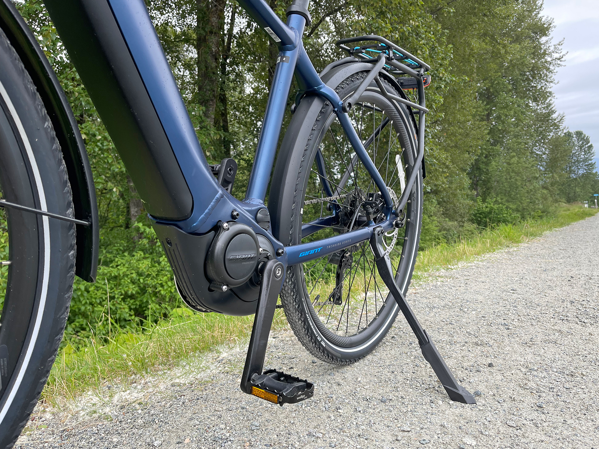

- The chainring has an aluminum alloy guard that will protect pant legs and dress ends from touching the greasy chain or getting snagged as you pedal. this guard also helps to reduce chain drops and can protect the motor and bottom bracket area from obstacle strikes like logs and curbs.
- Excellent weight distribution with both the 9.5lb battery pack and 7.4lb motor low and center on the frame. Since this is a mid-drive design, the wheels, hubs, and axles are all standard parts and have quick release! This makes tune-ups, wheel trueing, and flat fixes much easier.

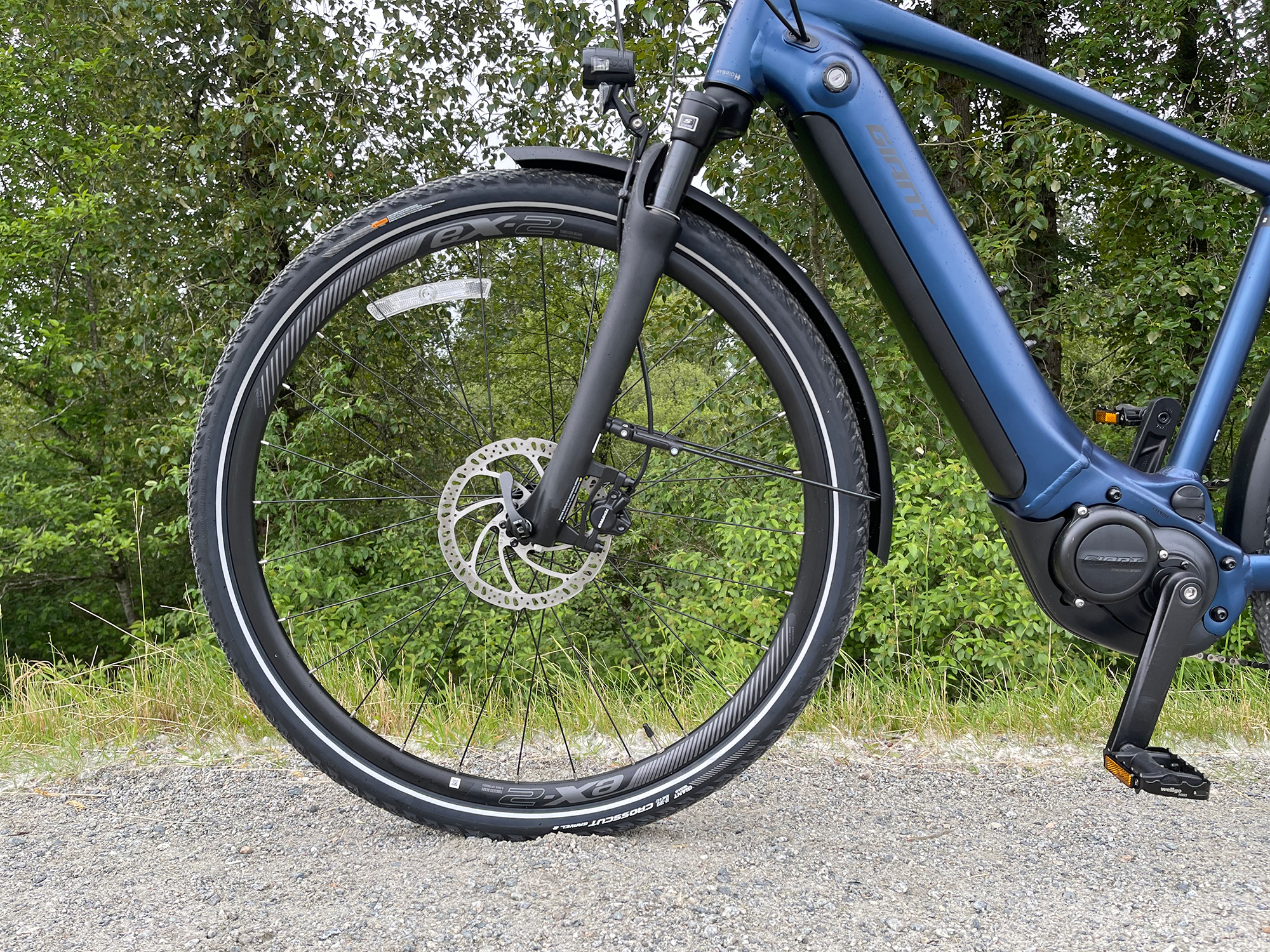

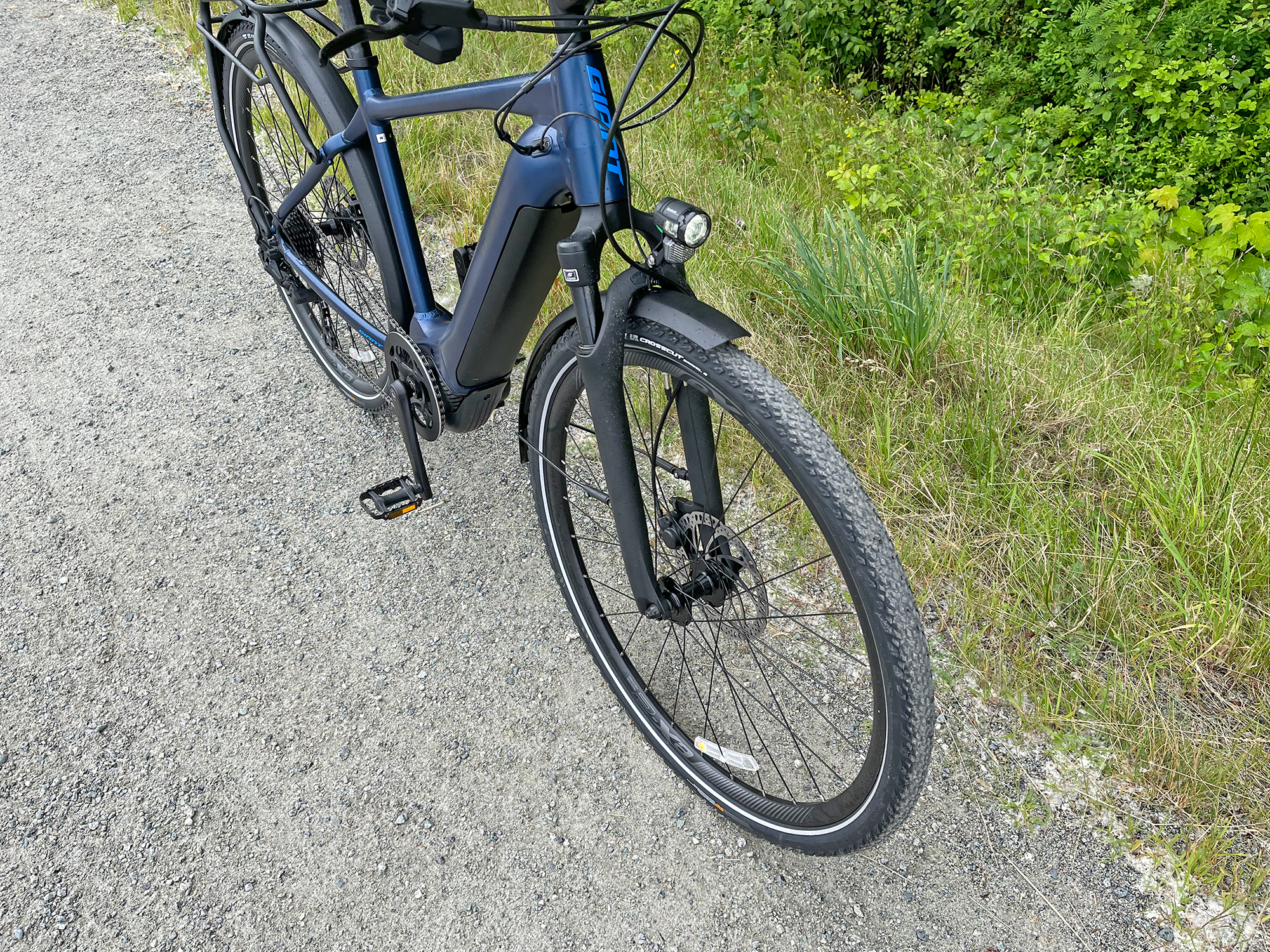

- The tires offer a hybrid pattern that can be efficient on paved surfaces but wide and grippy enough to handle gravel trains and some light cross-country riding. I appreciate the wide pressure rating 50 to 70 PSI! Low pressure improves comfort and traction while high pressure is quieter and more efficient for extended range.
- The tires and rims can be run tubeless to save weight and support low PSI without the higher risk of pinch flats. This is only possible on higher quality parts… notice the reinforcement eyelets on both rims to improve strength as well!

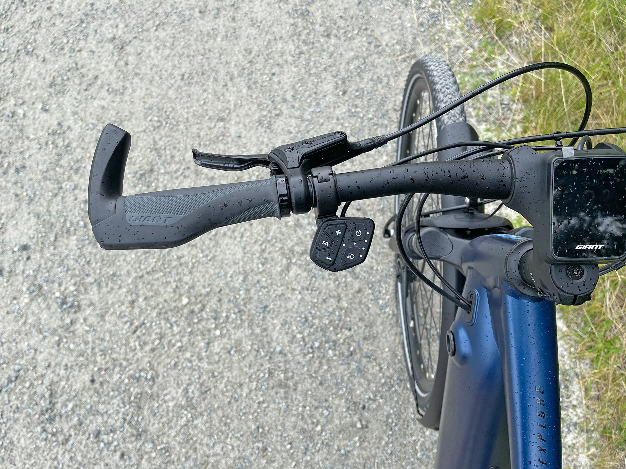

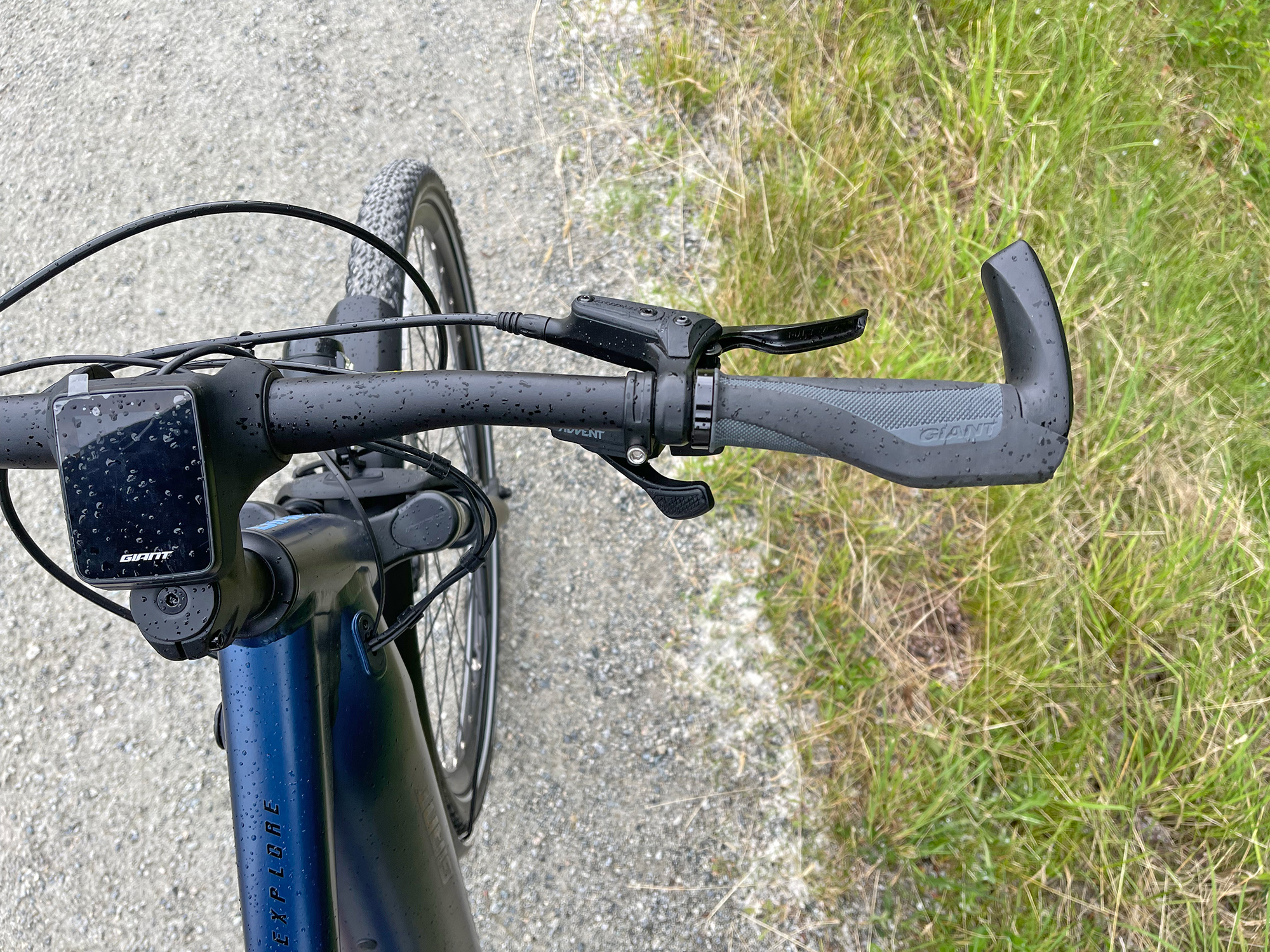

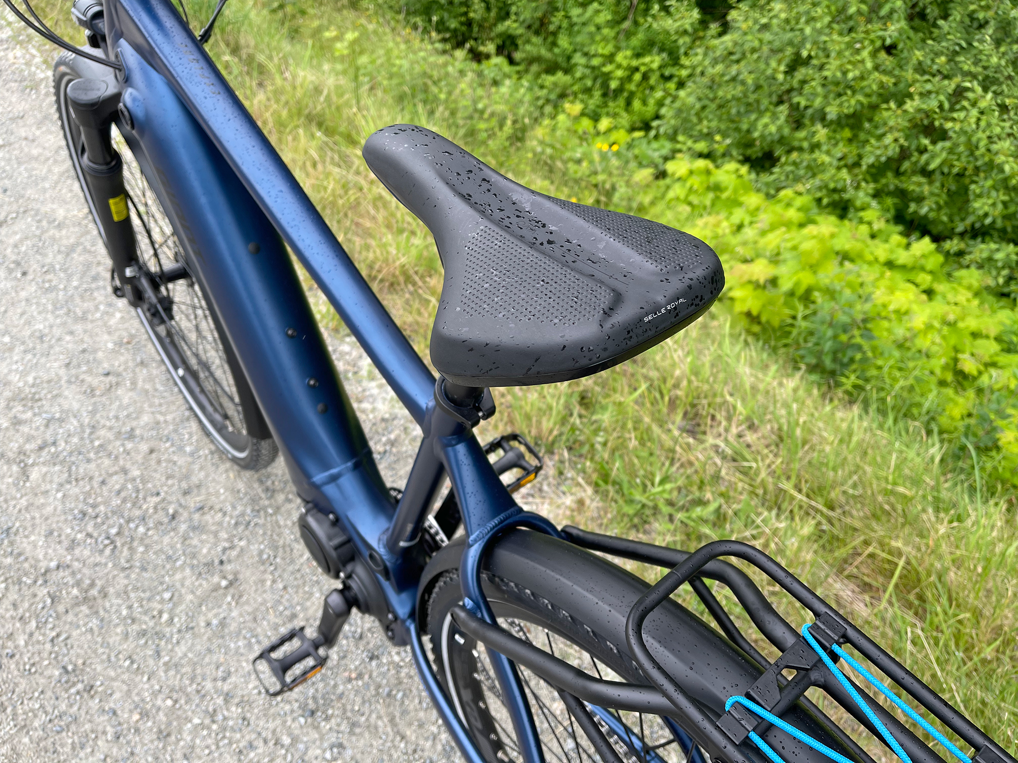

- The saddle felt very comfortable, I love the locking ergonomic grips (that won’t twist or spin out of position over time), the metal bar ends that offer different hand positions for longer rides, and the minimalist suspension fork. You can adjust preload on the suspension fork by pulling off the plastic caps and twisting the dials in combination. Pre-loading the spring will improve performance for heavier riders and loads.

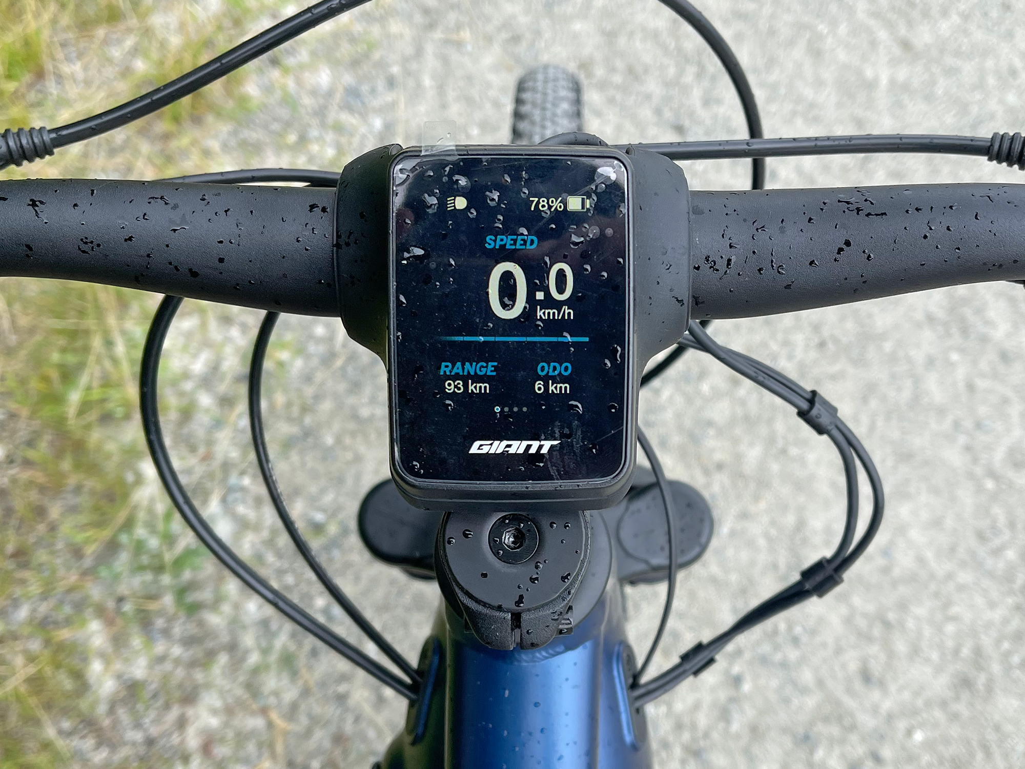

- The display panel is color, and fairly large. It’s easy to read and navigate with lots of good feedback about range (based on assist level and battery charge level), pedal cadence, current speed, and you can even sync a heart rate monitor to it!

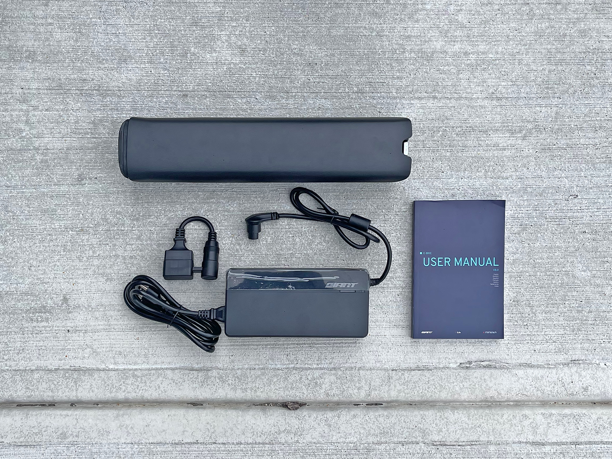

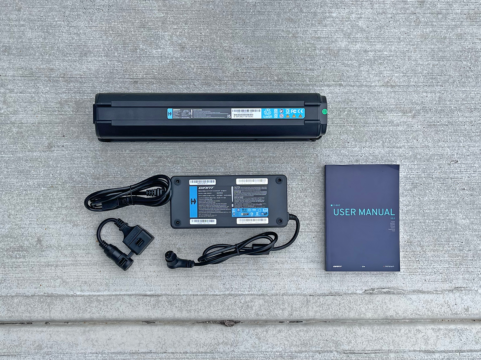

- The battery pack is removable for easy charging at a place of work or half-way destination. I’ve heard that it’s best to avoid extreme cold and hot to extend battery lifespan and keep it at 50%+ when not in use.
- Pretty good battery charger here, it weighs a couple of pounds, is fairly compact, and is faster than average at 4 amps vs. 2 amps like most others. The charger does require a dongle if you want to connect directly with the pack off the bike vs. the bike itself.

- The rear wheel speed sensor and magnet are mounted near the droput and the hub vs. using a spoke magnet. I feel that this is more secure and won’t get bumped out of position or cause as many issues. It’s a nice little upgrade.
- I appreciate the dedicated Smart Assist button on the control pad, as well as the dedicated headlight button. If you hold the light button it turns the light on and off, but tapping it quickly adjusts the backlight brightness on the display! This is so handy for people who feel that the display is too bright and distracting… very nice minor touch and done well.
- I love how the display shows battery percentage and is very precise vs. just having five or ten bars. I also like how the range estimate is dynamic and updates automatically as you adjust assist settings on the fly

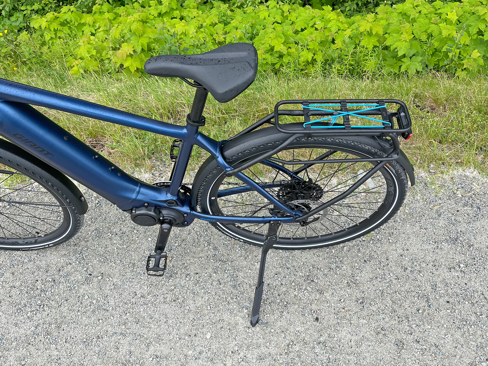

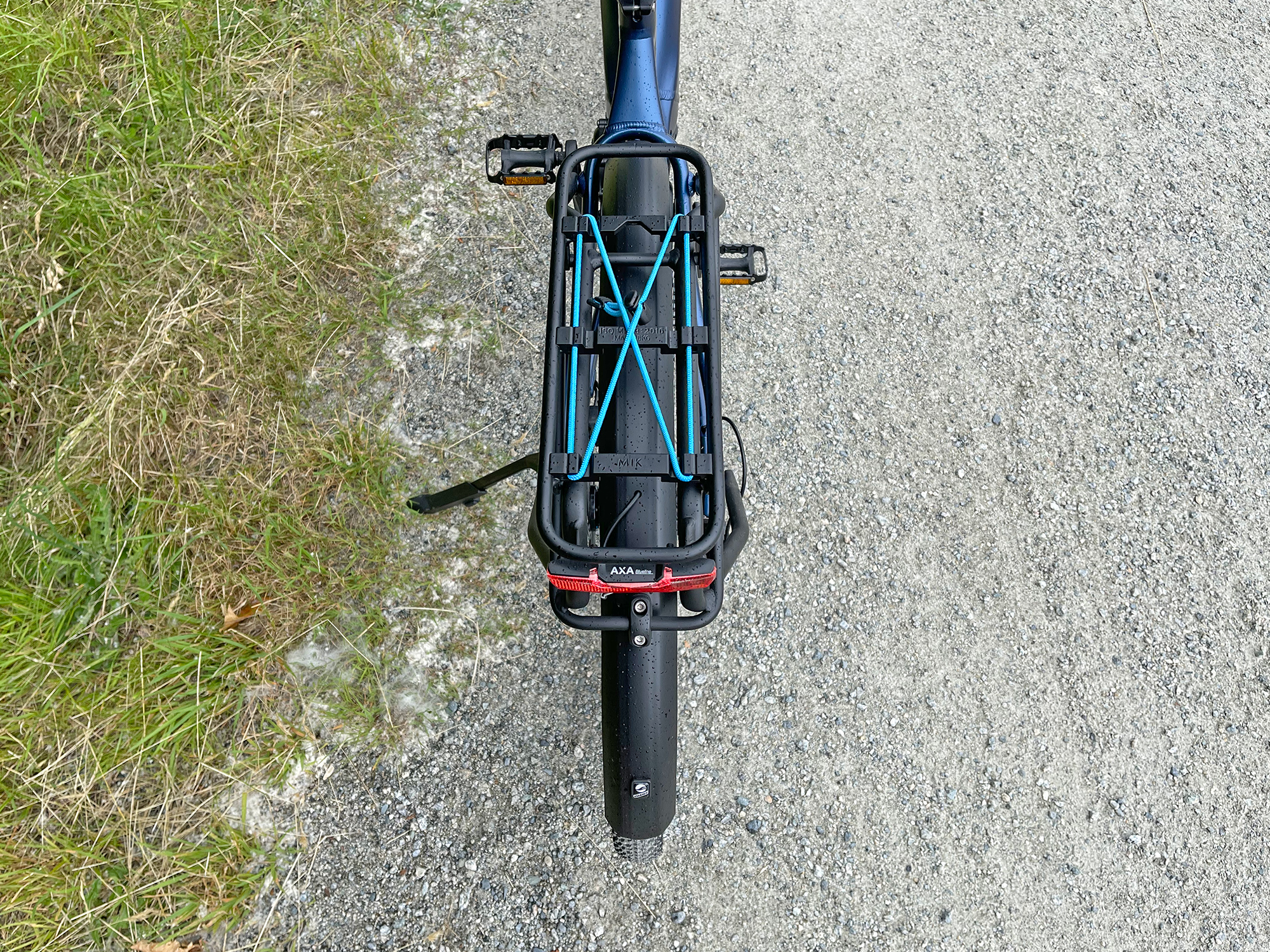

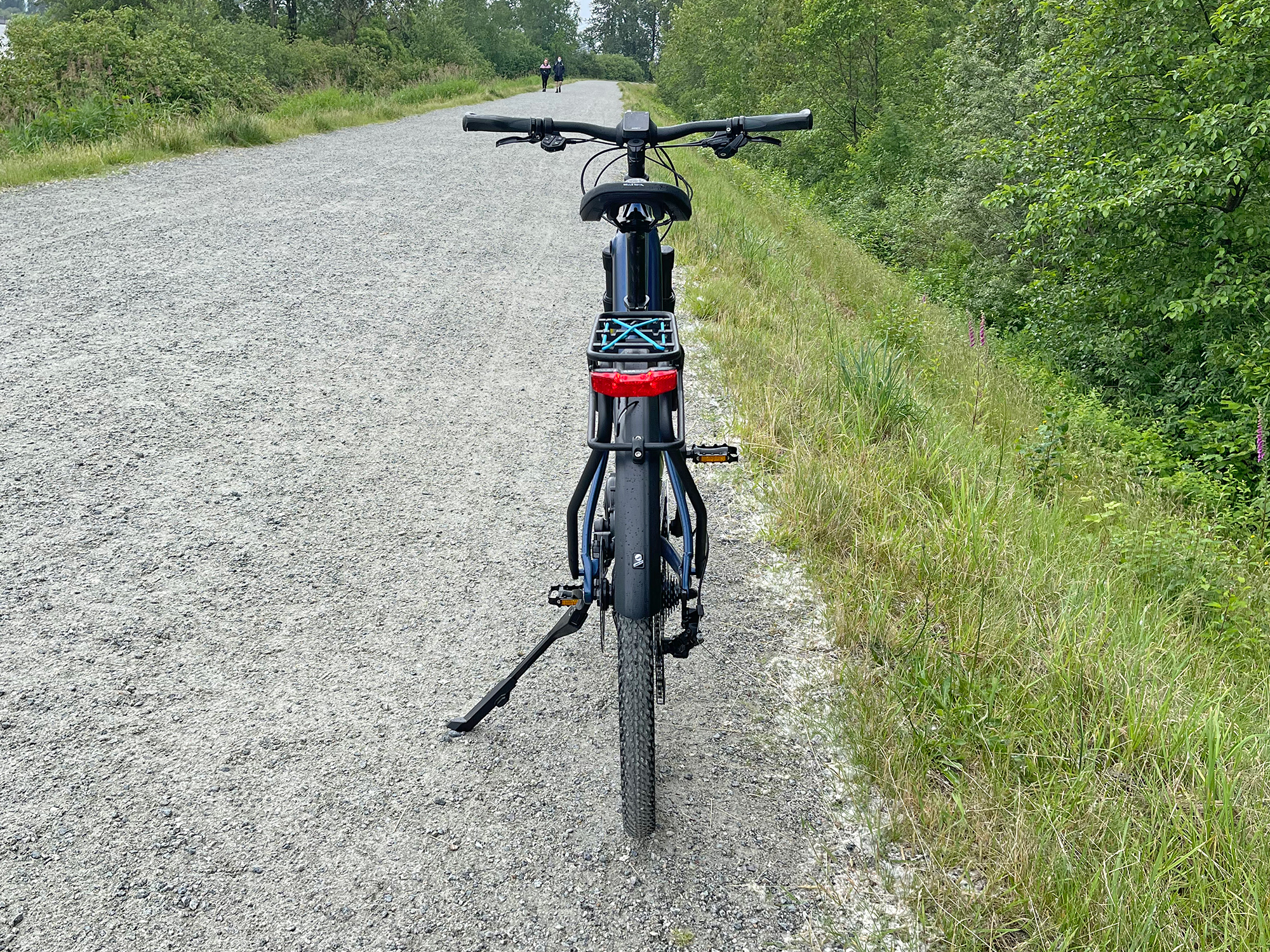

- The included rear rack is pretty nice. It has an MIK platform on top for use with some accessories (bags and baskets) that clip on. It also comes with a bungee cord, and has two dedicated pannier hangers that are below the top platform so it keeps weight lower and also makes panniers easier to clip on or remove.

- The charge port is positioned on the left side of the frame, down by the crank arms and pedals. It requires you to bend down to reach and seems a bit more crowded and vulnerable to snags there. I do appreciate the included kickstand, which is tool-free adjustable to get the bike in the perfect position for charging or battery removal.
- Removing the battery pack is a bit more time consuming and difficult because there’s not a lot of room between the downtube and front fender. I also dislike that the interface for the pack is different than the port on the frame. Perhaps they could have put the port on the pack itself and then used one plug from the battery to avoid the extra cord attachment?

- The SyncDrive Sport mid-drive is powerful (up to 70nm of torque and 350% feedback) and very responsive (supporting up to 120 RPM pedaling). It’s not quite as quiet or energy efficient as the SyncDrive Core used on the Giant Roam E+, but I much prefer the ride experience. I was surprised that both models use the same capacity battery pack even though this one will use power faster and costs much more? Neither motor offers shift detection, so ease off as you change gears so you and the motor don’t harm the chain or sprockets.

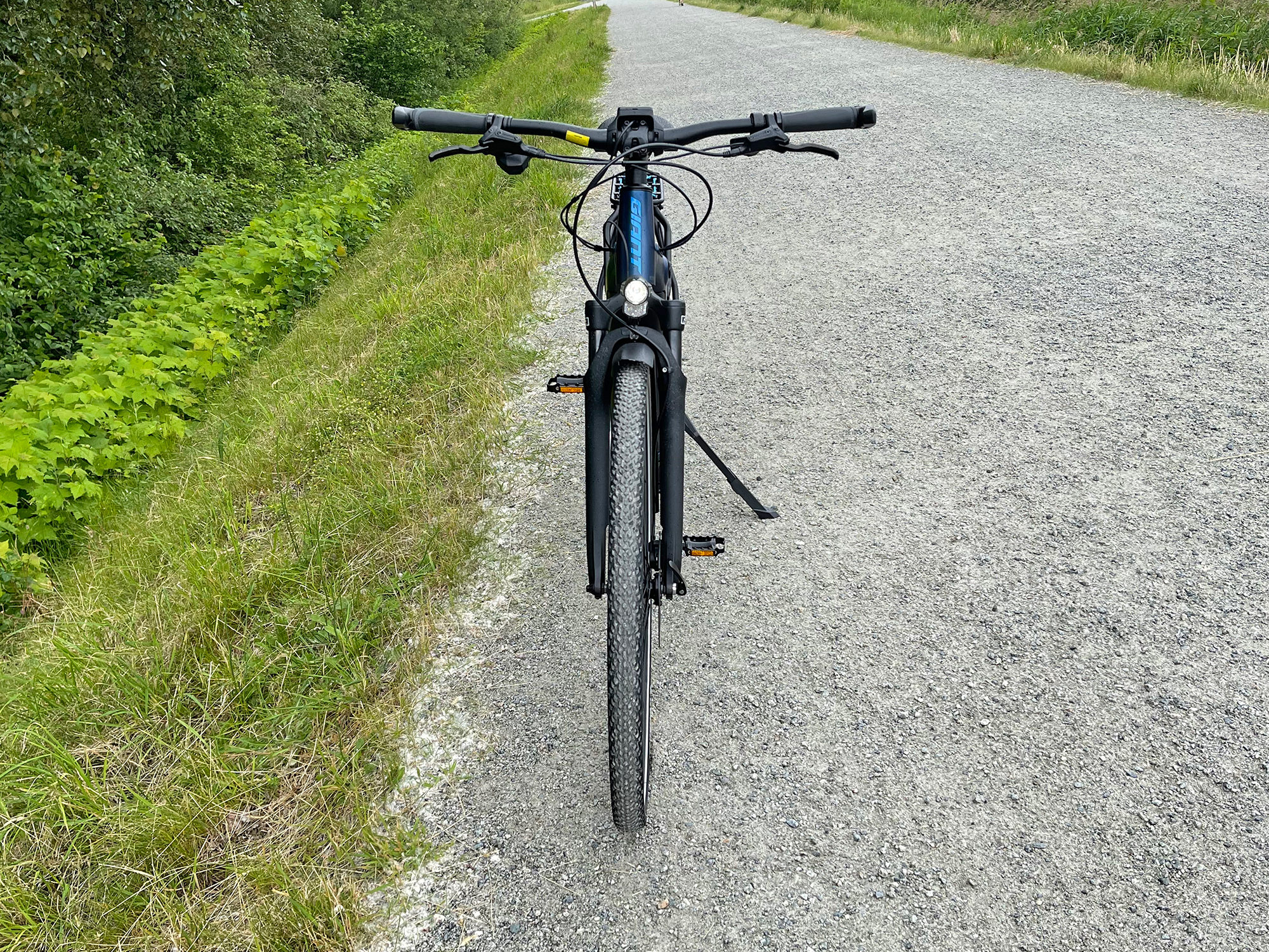

- The headlight is mounted to the arch of the suspension, so it’s unsprung and can bounce a lot more than if it was mounted to the stem or handlebar. I love that it’s aimable and has the side windows, just a minor point about where it’s mounted. I also want to mention that I feel walk mode comes on very strong with many of the Giant ebikes I’ve tried, maybe the gear you’re in also plays a role… but they usually seem pretty abrupt.
