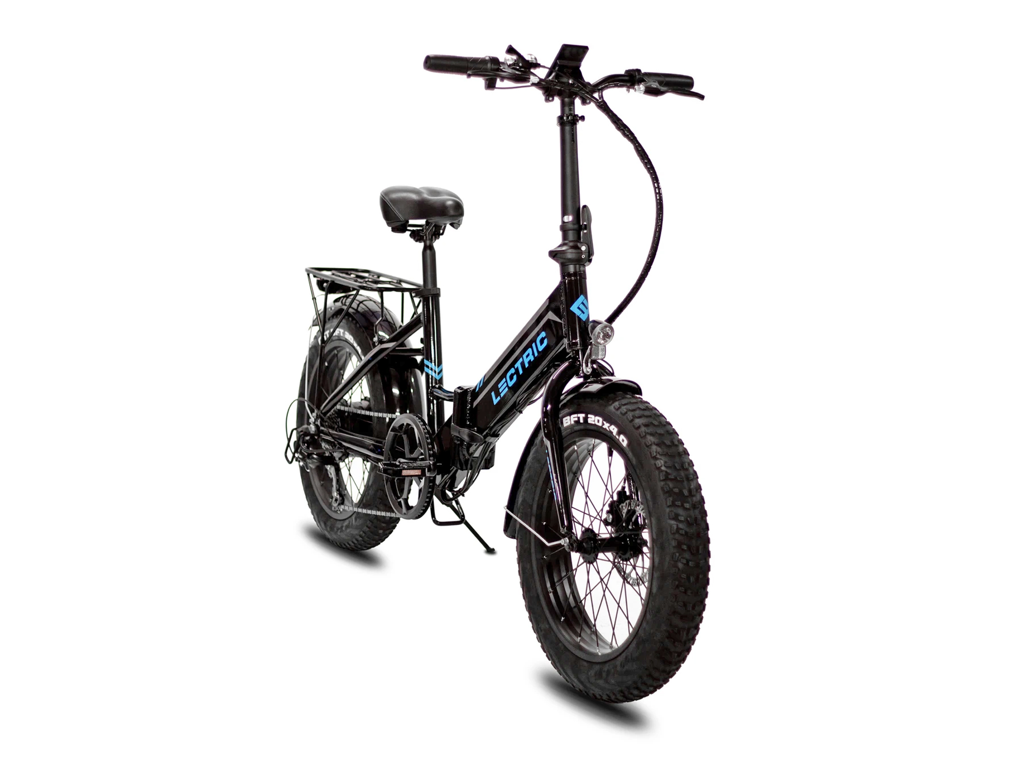

- While the original Lectric XP was approachable (as most folding ebikes with 20″ tires are), the super low step-thru frame on this new model is even easier to step over and manage at stops. Based on their official specs, this model is only 0.5 to 1lb heavier, and I observe that the frame should not suffer from frame flex too much because of the additional reinforcement tube connecting the downtube to the seat tube.

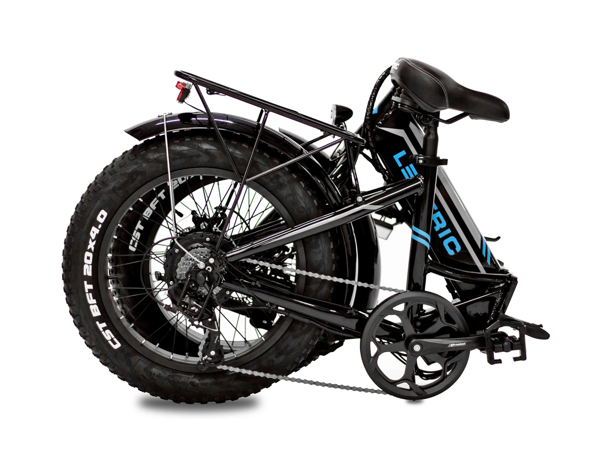

- Compared to the original mid-step frame, I love how the folding joint and buckle are much lower here because they are less likely to protrude into your knees. I have occasionally bumped my knees and thighs when pedaling on folding bikes (and so has my girlfriend!) which isn’t super fun or comfortable. It’s a big design win that is oft overlooked when considering a low step folding ebike :D
- The battery pack and controller are hidden on this frame, which gives it a nice aesthetic and probably protects the parts from physical impact and the elements… though it requires a bit more effort to remove the battery. The wires and electrical cabling is all external, but on a folding frame, that can mean they won’t get pinched as easily. The wires tend to blend in more on the black frame, but white may be safer for commuting purposes due to higher reflectivity.
- I love that the bike comes in two colors, and am a fan of their design and accent color choices, this lets you and a friend personalize a bit if you’re getting the same bike. As mentioned above, the white is my favorite because it’s more visible at night. I appreciate how Lectric eBikes paint matched the fork and fenders on both models!

- The display is large and easy to read, it angles slightly to help you reduce glare, has a higher resolution 10-bar battery charge level indicator, and offers lots of customization in the settings… including the ability to set the top speed at ~28 MPH for speed pedelec performance, or lower it for improved range and possibly safety or peace of mind for some riders.

- The rear rack is wide, has a spring latch, and uses standard gauge tubing so it will work with most aftermarket clip-on pannier bags or the ones that hang over. Please note that it’s 55lb (25kg) max weight rating subtracts from the total load of the bike (so a 55lb loaded rack plus a 275lb rider combine to 330lbs).

- As with any step-thru or mid-step frame, the overall strength is reduced when there’s only one main tube and it’s made to curve down lower vs. being straight. This can introduce some frame flex and reduce overall weight capacity, but it’s not something I could observe directly here, and it has not influenced their official advertised max weight rating.
- The handlebar is a bit narrow, which can make the steering feel a bit twitchy… especially since it has smaller 20″ wheels to begin with. Fortunately, this is easy and cheap to fix with a different aftermarket handlebar but it’s something Lectric eBikes could also upgrade in the future. Consider a bar that’s got a bit more rise and backsweep like we see on the e-Joe Epik SE. Two downsides are that this type of bar could take up more space when folding, and might require more width for entryways into houses or RV’s.

- The bike is fairly heavy at ~63 pounds (28.57kg), especially for a folding ebike. Yes, you can remove the 6.6lb battery pack and even take the rack and fenders off… but that takes time and manny people will just want to load it up and go. Please consider getting help from a friend and lift with your legs, not your back. You may also find success in loading the bike into a plastic tub before placing into your storage space. There are some posts in the forums that show this here, here, and here ;)

- There is no folding retention mechanism (like magnets or a rubber strap), so consider buying so plastic bungee cords and putting a towel between the two portions of frame to keep the bike from rattling around and scratching itself up.
