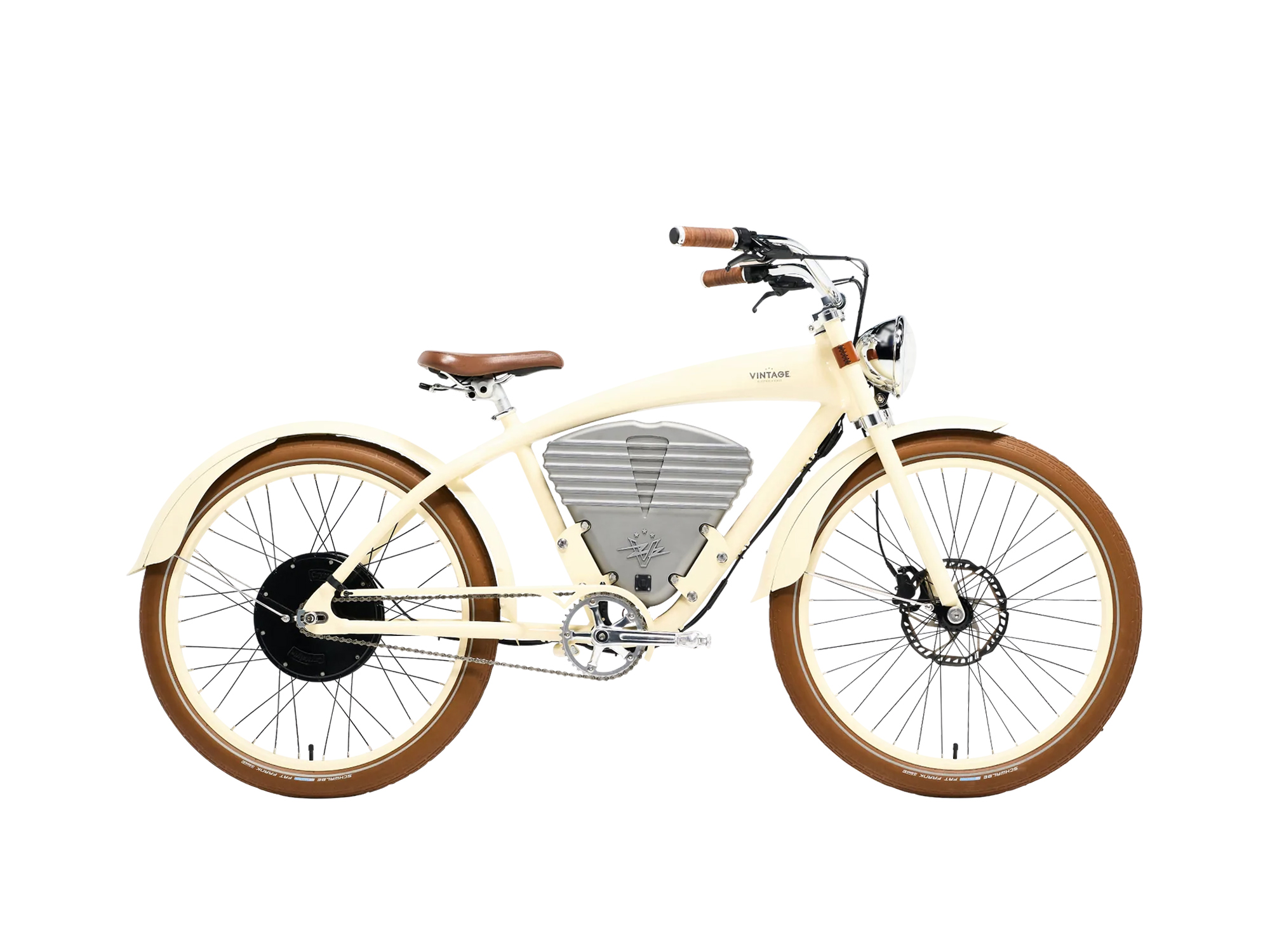

  • The Tracker Classic comes in two colors, includes paint-matched metal fenders, and uses a long swept-back handlebar, making it more of a cruiser than the 72 volt models. It’s still very powerful, but has a lower torque rating (160nm vs. 180nm) and lower unlocked top speed rating (26mph vs. 40mph) than the Roadster, Shelby, and Scrambler. It’s a bit less expensive, and does not include an inverted suspension fork.
  • I was told that the Tracker Classic can be upgraded to match the power and speed stats of the high performance 72 volt series models for customers who are willing to pay a bit extra (the same $7k price) or you can just do the battery and controller or just the inverted suspension fork for $1,000 individually. I believe Vintage Electric will even do custom colors for their bikes if a customer wants something truly unique and are willing to pay extra.
  • The bike has lots of low-end torque to help accelerate and climb hills, it also has a high weight capacity of 300lbs vs. 250lbs on many other products I’ve tested and reviewed.

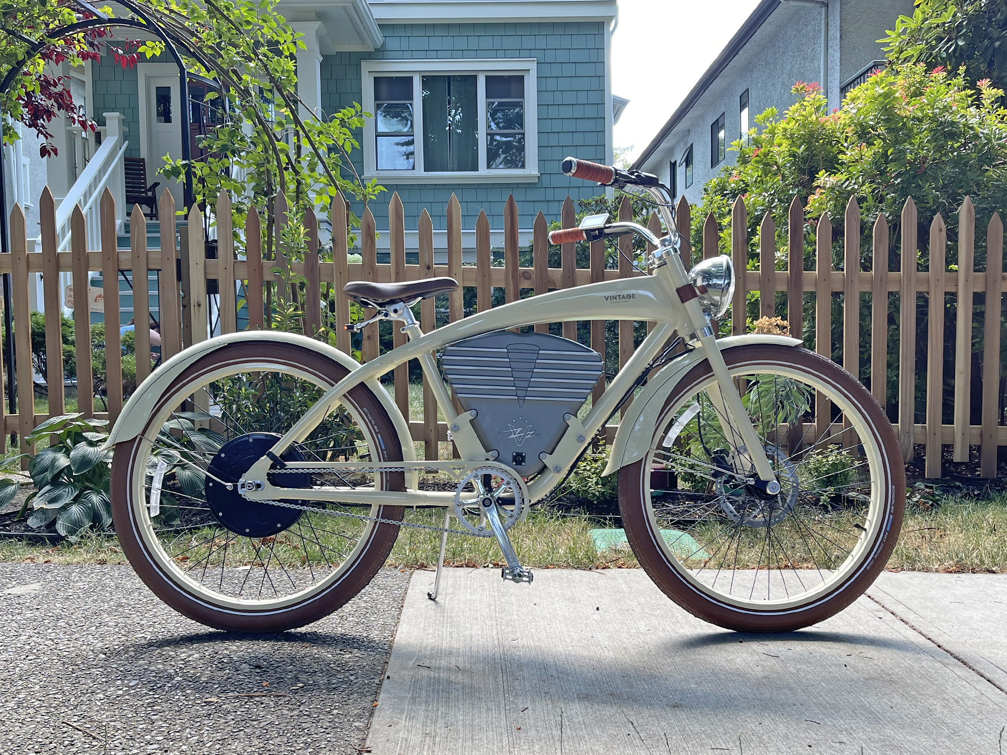

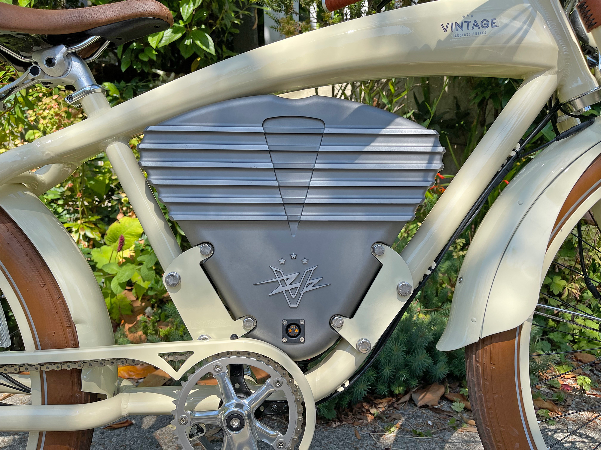

  • Incredible aesthetic, these are some of the coolest looking electric bikes I’ve had the opportunity to ride. The hydroformed frame tubing, custom paint and designs, custom battery box, and motorcycle inspired headlight match perfectly and really set Vintage apart from others.
  • The bike feels solid, and none of the parts rattled during my ride tests. There’s no vibration or jarring feeling on this bike like many others I’ve tested. I think the increased weight is part of what makes it comfortable. Note that you can lower the tire pressure and upgrade the rigid seat post to a suspension post to further improve comfort.

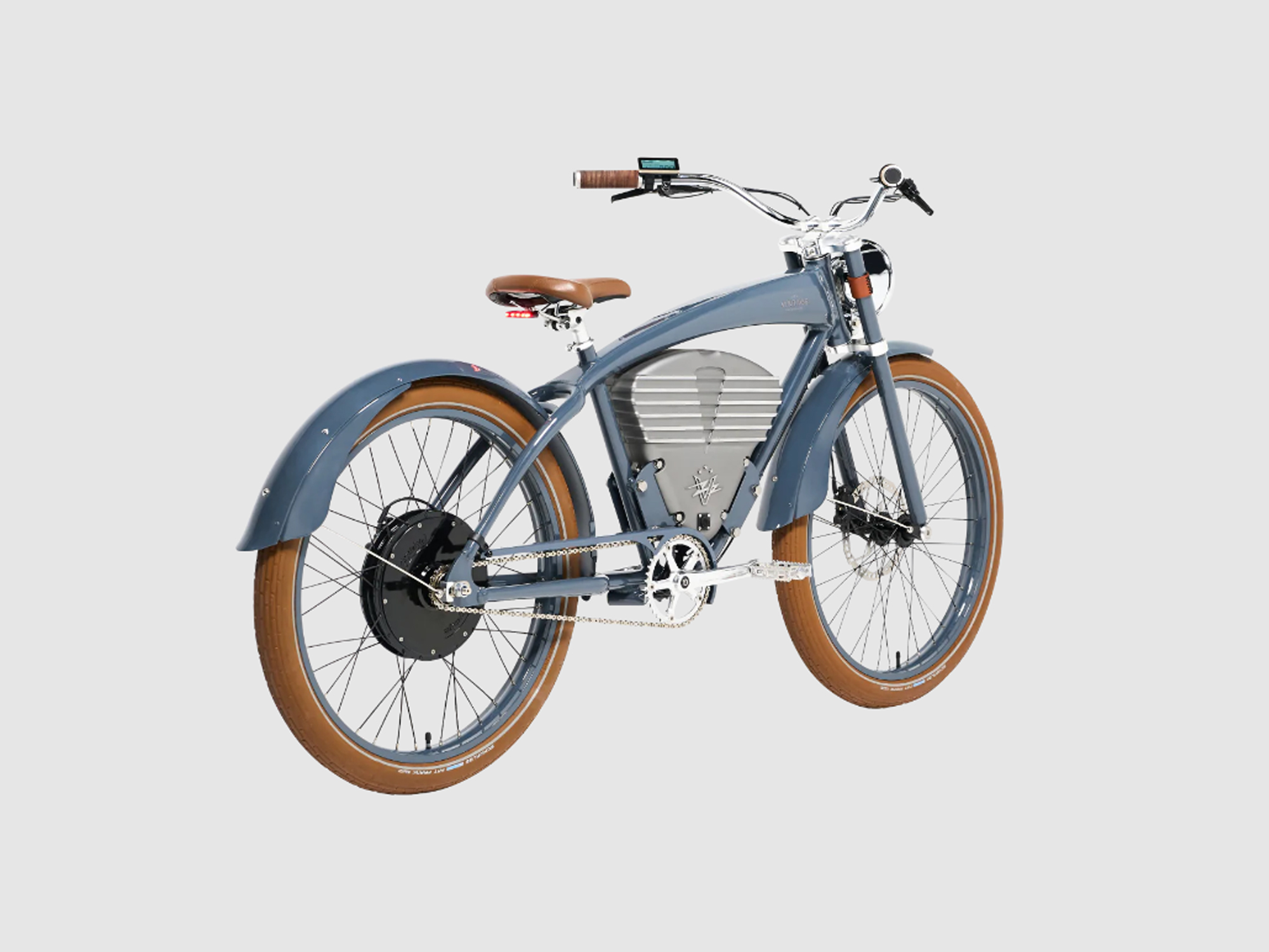

  • It’s extremely quiet, because the gearless direct drive motor does not have any gears rubbing inside. It’s larger and heavier than a planetary geared motor, but I believe these are more reliable, and you get regenerative braking as well. Note that only the right brake lever activates regen.

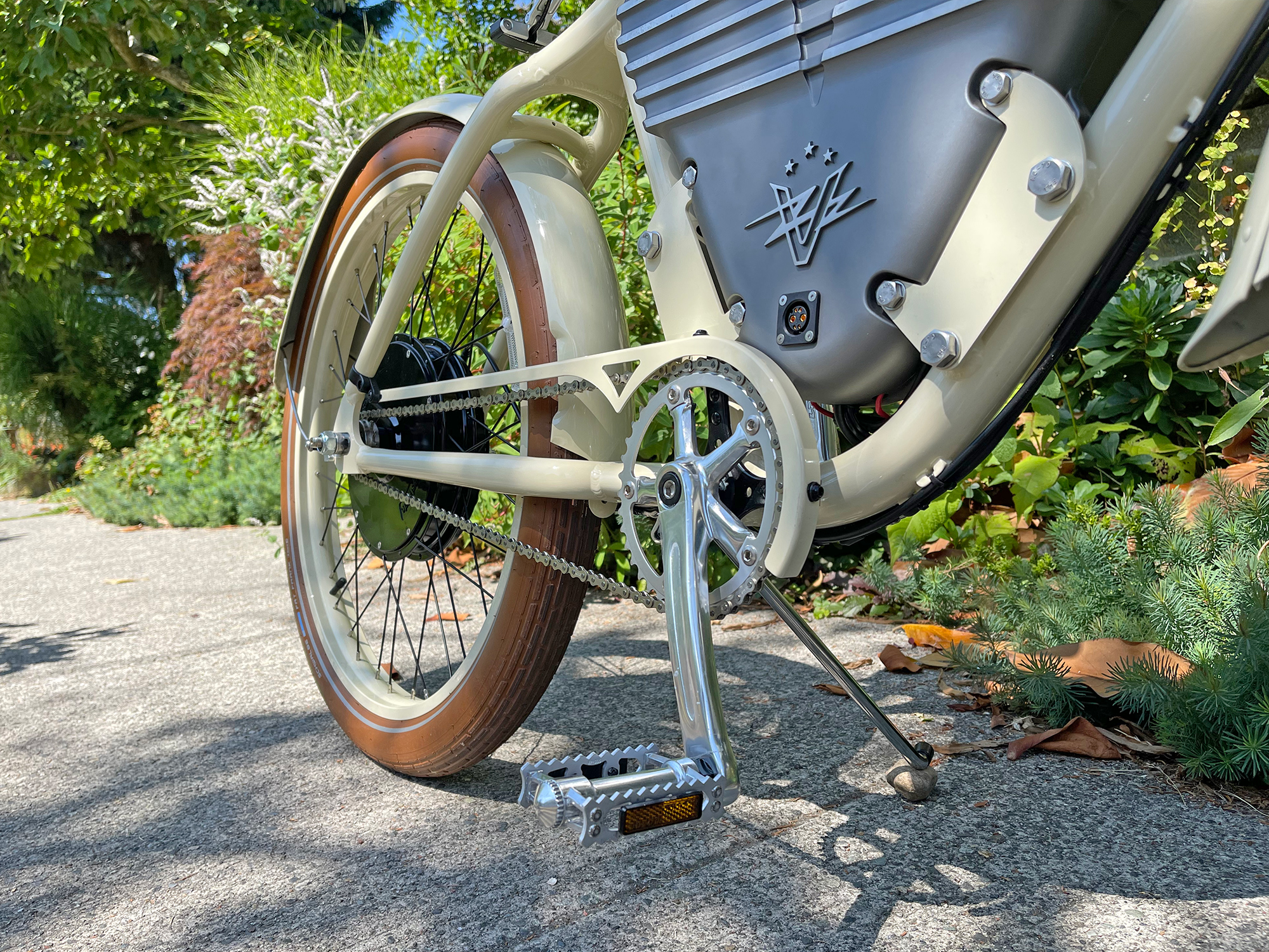

  • The hub motor still looks like it did on previous models, it’s still made with Crystalyte, but has upgraded aluminum alloy staters and torque-optimized copper winding design. For context, most other hub motor powered electric bikes I try are in the 50nm to 70nm range and this one is 160nm! It’s still silent, offers regenerative braking, and should be very durable and long lasting.

  • Premium Promax Lucid hydraulic disc brakes offer the stopping power needed for high-speed riding and a heavier bike build. The 203 mm front rotor will do more than half of the work as weight shifts forward, and it will cool faster because of the increased surface area. The rear brake rotor is 160mm, which is smaller than expected, but keeps the rear from getting too crowded.
  • When activating the right brake lever, the controller system activates regenerative braking to recoup some energy. This helps to reduce speed and wear on the brake pads. The controller is designed to never overfill or damage the battery however, so you might notice regen fading out if you’re at 100% full and descending a long hill.
  • The metal fenders felt sturdy, did not rattle when riding on rough terrain, and definitely add some style to the bike because they are paint matched and skirted on the sides. They should keep you clean, but you might notice little pebbles clicking through occasionally. Note that the fenders may be aluminum alloy or steel depending on the run. The demo bike I tried had steel fenders.
  • Decent weight distribution, the bike may be heavy but at least the battery box is mounted low and center on the frame, this improves handling and keeps the frame stiff compared to e-bikes with rear-rack batteries.

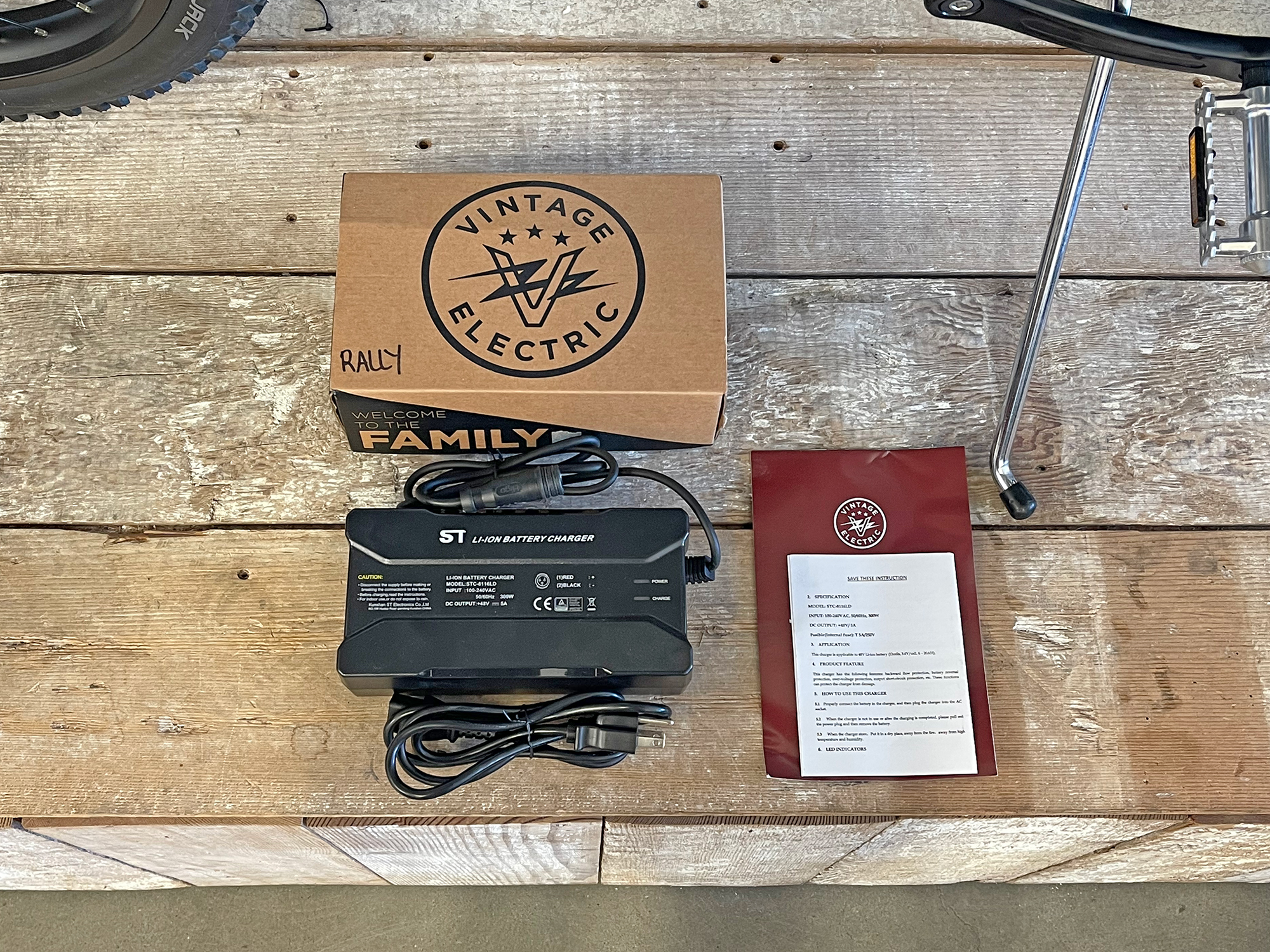

  • The battery charger is fairly heavy at 2.8lbs and quite large. This makes it less portable, in my opinion. It’s also not as adjustable as the charger you get with the 72 Volt Series, which allows for 80% or 100% fill and even the speed from 1 amp to 5 amp. This charger just goes at 5 amp and I assume it fills to 100% each time.

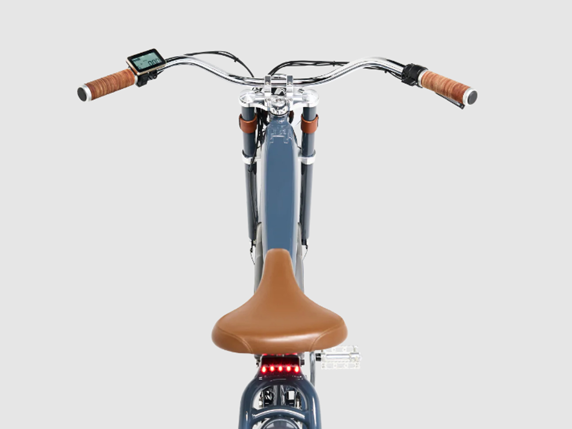

  • The bike only comes in one frame size and the stem isn’t super adjustable (you can only swivel the handlebar). I appreciate the adjustable height saddle, because it allows for better leg extension and comfort, but otherwise this is a single size single frame style high-step.

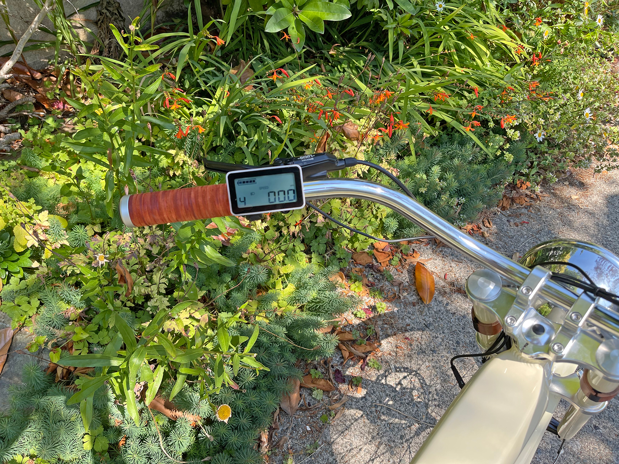

  • The grayscale display is easy to read and its buttons are reachable, but there’s no USB charging, the battery charge level indicator isn’t as precise (just 5 bars, each representing 20%), and it’s not removable. In some ways it’s kind of basic, but it’s intuitive enough and does offer settings menu if you hold up and down. Press M to cycle main display readouts, hold up to activate lights, and hold down to activate walk mode.
  • The rear light is positioned just under and behind the saddle. It’s nice to have it high up, to clear the fender and optional rack, but if you have a jacket or backpack on, it could easily hang down and block it. Keep this in mind, and note that the Scrambler uses knobby tires that do not have reflective stripes like the Roadster and Shelby. Since the bike is all black, it might not be as visible to cars and other cyclists in low light conditions.
  • The gearless hub motor has a big of magnetic drag. This is the case for all of the direct drive motors I’ve covered, and it is somewhat balanced by the regeneration that you get. Note that pedaling without assist, or beyond the supported assist and throttle will be more difficult than with a geared hub motor or regular bicycle. You could hypothetically charge the battery up by pedaling, but it would be lots of work and very inefficient :)
  • It would be nice if the display had a range estimator or battery percentage instead of just five squares (which each represent 20% steps and just aren’t as precise).
