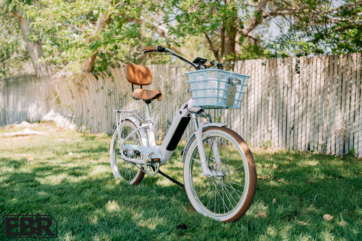

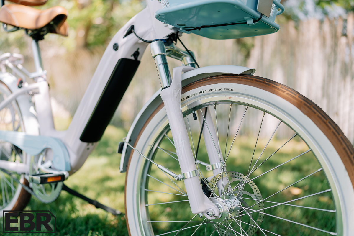

During my rides, the Model R’s ride quality was just as impressive as its build and aesthetics. The 26 “x3″ inch tires, combined with the 80mm of travel in the front suspension fork, team up to give the bike more versatility and an overall smoother ride.
The step-through frame design allows for easy mounting and dismounting for riders of various heights and mobility levels. This is especially nice, considering the bike’s overall weight.
Despite the size of the Model R, the bike still handles really well. The cockpit layout is simple yet functional, providing all necessary controls within easy reach.
True to its cruiser design, the riding position is comfortably upright, giving a nice wide field of view of the path ahead. The back-supported version saddle on our test model had a non-adjustable backrest that I thought felt a bit far from the seat, creating a slight dilemma between proper riding position for pedaling and back support. However, this may not be an issue for all riders, and EBC offers various seat options at purchase, allowing you to choose one that works best for you.
Riding this bike at 5’11”, I found the frame and bike’s overall fit to be excellent, with plenty of room for adjustment in either direction. This supports the claimed rider height range of 5′ to 6’10”, though the upper limit may require some in-person verification as even on my most confident days, I cant pass for 6′ 10″.
Despite the minor seat issue, the Model R felt like a well-balanced, smooth-rolling bike that would give many comfortable rides over the years. Its overall comfort and stability make it a pleasure to ride, living up to its cruiser persona.

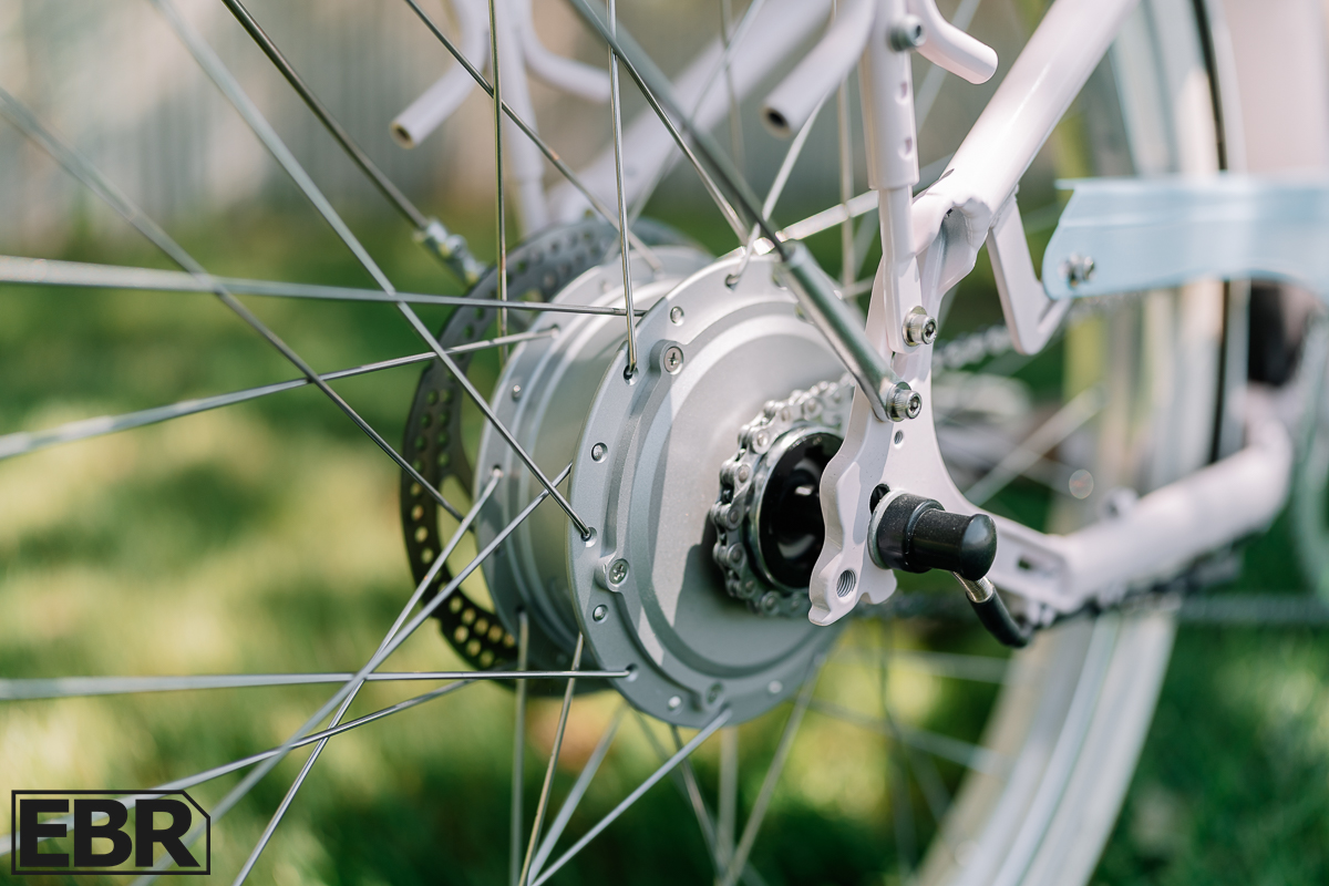

The Electric Bike Company Model R ships with a 500W rear hub motor that I found to give confident acceleration and, surprisingly (in a cruiser), speeds up to 28 mph. The power delivery feels nice and linear across all five levels of pedal assist as you progress through each level.
A quick couple laps up and down a steep hill near the office here helped shed some light on how the Model R performs when it has a climb to deal with. The first run, I only used throttle (no pedaling) and the bike held at 13.5 mph during the climb.
Then, I did another run up the hill using PAS 5, and on this run, it maintained 15.5 mph when my legs were mixed in with the pedal assist activated. I did notice on steep hills, I couldn’t feel much assistance with PAS 1 and 2, but when I upped the PAS to levels 3, 4, and 5, it had no issues getting me up the hill. I do like how the Model R manages to balance power delivery. It has all the power I need, such as on hills, but doesn’t overwhelm the rider while cruising on flats.
Overall, the Model R’s motor is really nice, it’s able to walk the line between being a laid-back cruiser while still being able to tackle longer jaunts or steep hills whenever I needed it.

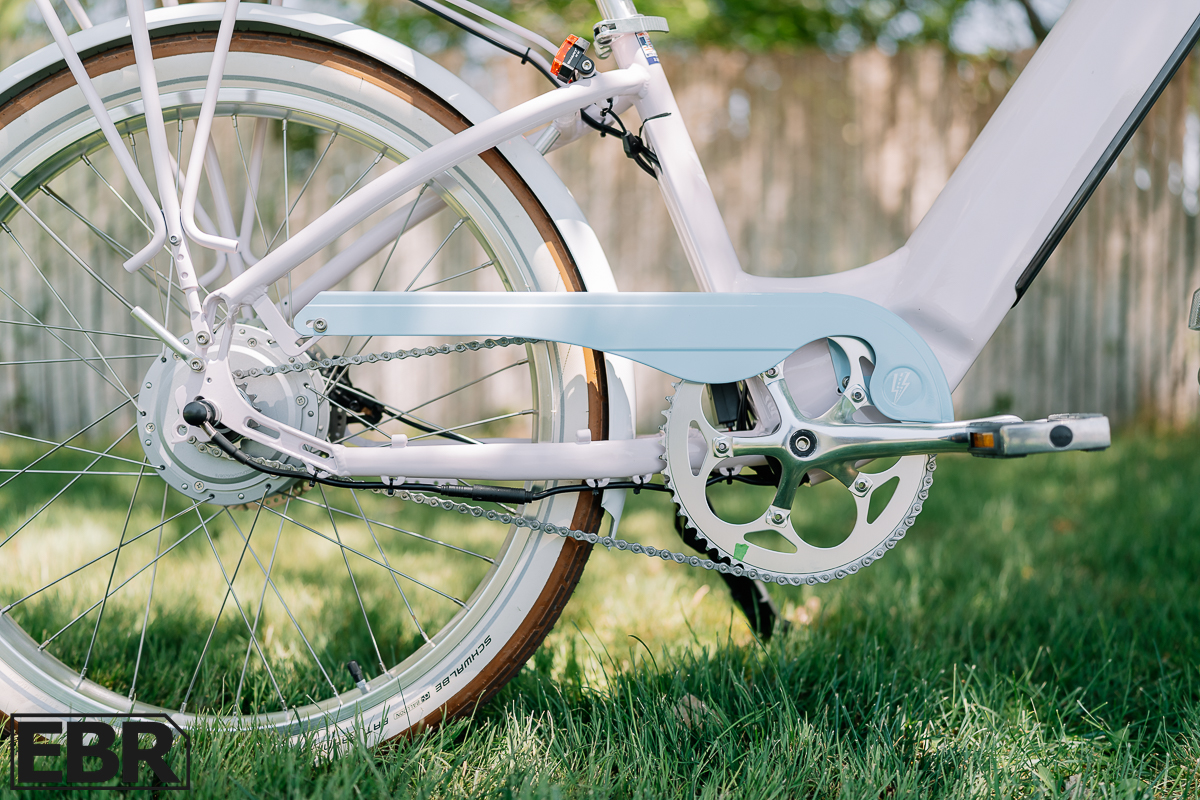

The Electric Bike Company Model R that we tested has a straightforward and low-maintenance drivetrain. As a fixed-gear bike, it consists of a 58T chainring, a stainless steel chain, and a 16T freewheel. Personally, I prefer this on a cruiser as its not a performance-minded bike, it shines in relaxing, comfy cruising, not racing, hill climbs or sprints where you need a certain range of gearing.
The absence of a derailleur and shifter also means fewer components to maintain or potentially fail, resulting in a simple, reliable system that aligns well with the bike’s purpose. But, of course, should you want the flexibility of some gears, you can opt for the 7-speed drivetrain option.
Braking is handled by the 4-piston hydraulic disc brakes with 180mm rotors. While not branded, these brakes felt great on my rides, with reliable, confident braking in all situations I encountered.

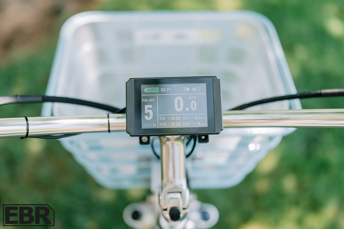

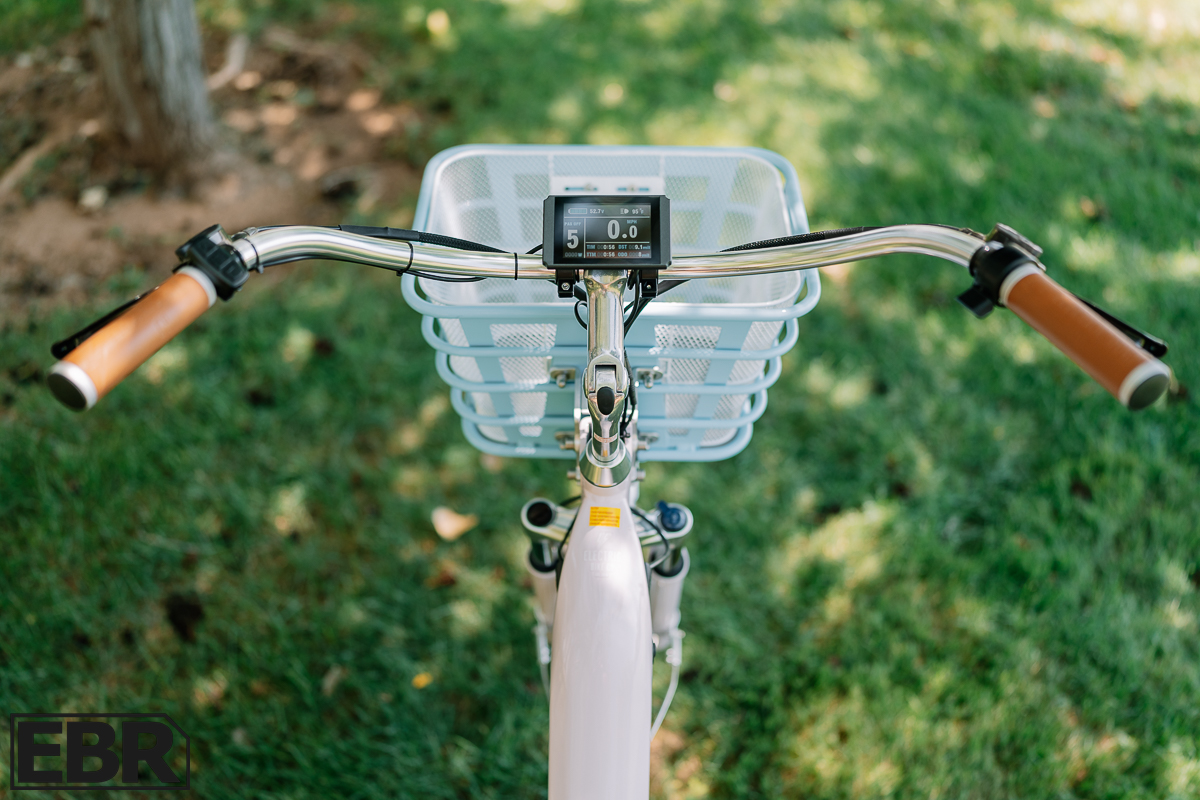

The Electric Bike Company Model R features a centrally mounted, full-color display that provides riders with essential information at a glance. The screen layout is straightforward but still has key ride data like:
- Current speed
- Ride time
- Pedal Assist System (PAS) level
- Battery level
- Ambient temperature
- Odometer reading
While the display covers all the necessary bases for most riders, the interface does have a slight learning curve. For instance, turning on the headlights was not as simple as I expected as there were no buttons or menu options in the display, but, once I did a little search online, I found it requires a long press of the PAS up arrow button.
At the time of this review, the Electric Bike Company does not offer a phone app for the Model R or any of the EBC lineup. Fortunately, everything I needed for a typical ride, like battery life, speed, and PAS levels, are all right there on display.

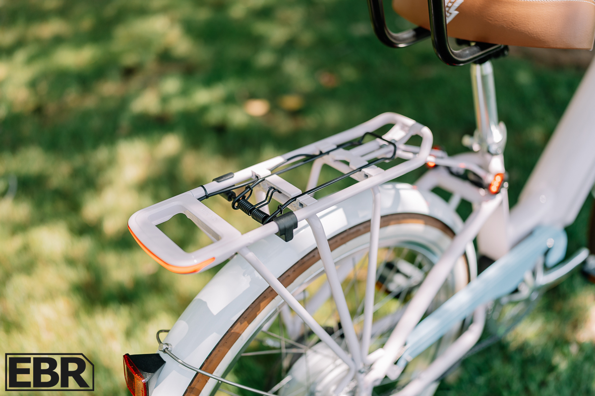

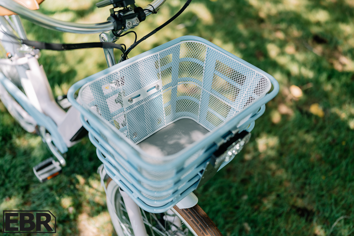

Storage solutions range from various front baskets to rear racks compatible with the MIK system for easy accessory attachments. For those heading to the beach, there’s even a specialized surfboard rack.
