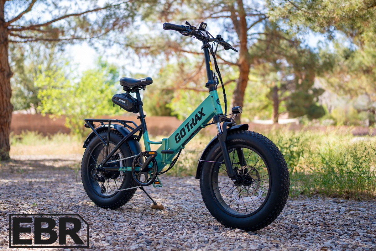

The GoTrax F3 is not trying to reinvent the folding e-bike, and I mean that as a compliment. Fat tires, front suspension, hydraulic disc brakes, and a big battery, at a price that leaves money in your wallet. The question I had going in was whether GoTrax cut corners on build quality, ride comfort, or motor tuning to keep the bike priced under $1,000.
My Experience Riding the GoTrax F3
Ride Quality Score: 6 / 10

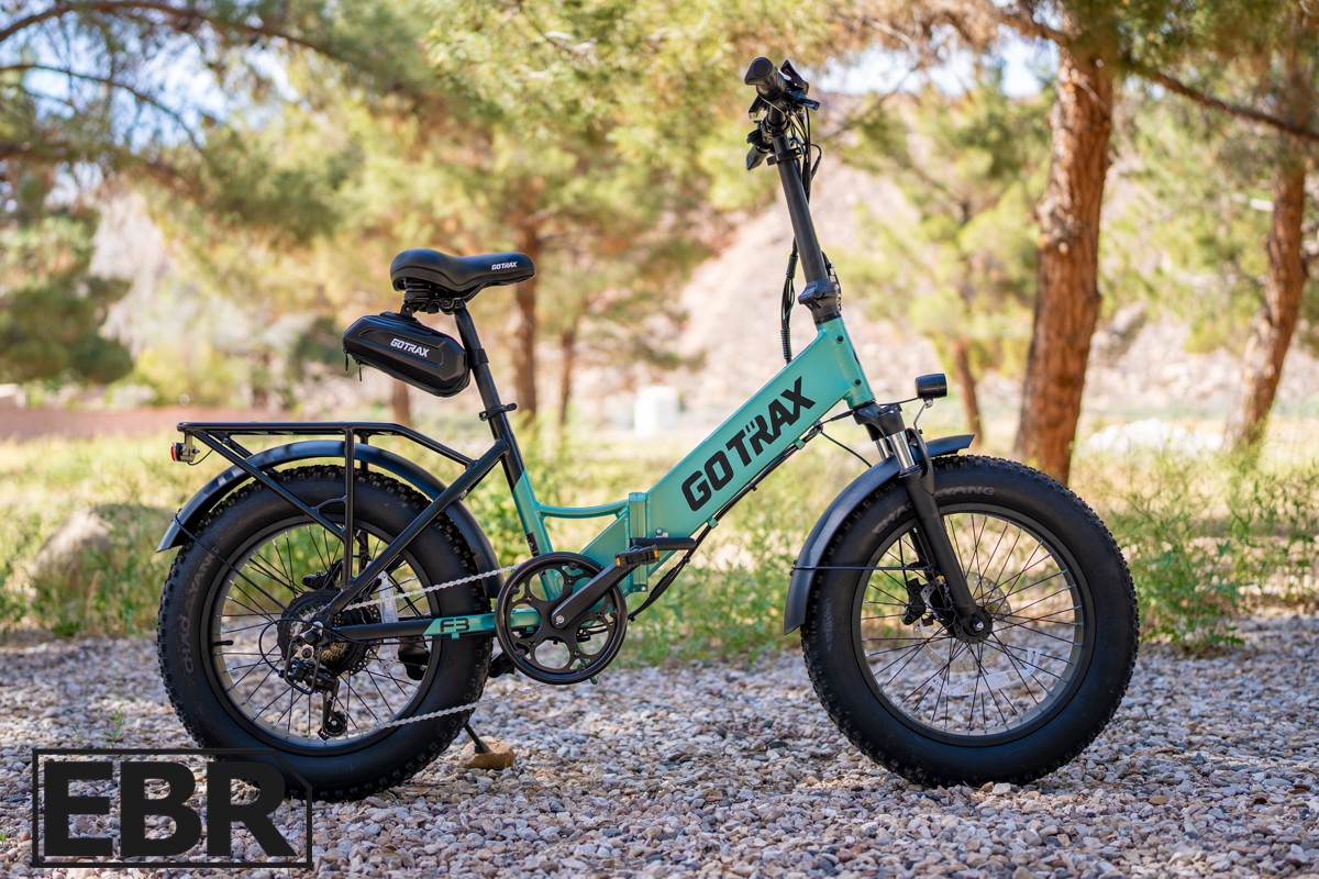

Fitwise, I came away impressed with the GoTrax F3. The reach is a little shorter than average, so I sit a bit more upright than I do on most folders. I like that, and if you want a relaxed position, this bike gives it to you.
The quill stem has about four inches of height adjustment and the seat post gives you around ten inches, which is a lot of room to work with. At 5’11” I had full leg extension without going anywhere near the minimum insertion line. Our range tester is 6’3″ with a fairly long torso, and he even got full leg extension and raised the bars enough that he was not crouched over and uncomfortable.
GoTrax does not publish a fit range, but based on our testers I would put it at roughly 5’2″ to 6’3″. The one change I would make is the stem angle. Draw a line up from the fork and the stem still cants forward slightly. Straightening that out would help the handling.
Comfort surprised me too. The butterfly grips let me rest my palms flat and I never got any numbing in my hands. My problem with them is that they rotate. They are not locked down, and about every mile I would feel them sink and have to twist them back into position. Not a dealbreaker, but I would like to see lock-on collars on the next version. The saddle is more padded than average and more comfortable than I expected, and paired with the coil fork and 4″ fat tires, the F3 is comfortable on pavement and paved paths.
It is a folding bike, but it does not feel loose or floppy while pedaling. It does not handle like a dedicated commuter, but it feels solid, which is what I care about most in a folder.
On the flats it is peppier than I expected. From a dead stop it took 10 seconds to reach 20 mph on throttle, 7 seconds to reach 20 mph pedaling in PAS 5, and 14.5 seconds to reach 28 mph. Stepping up through the assist levels one at a time, the speed increase between each level is even, which tells me the controller is tuned well and the power will feel predictable out on the path. I found myself settling into PAS 2 or 3, partly because that puts me between 15 and 20 mph where I like to cruise, and partly because the drivetrain runs out of gear around 19 to 21 mph and I start ghost pedaling.
(Way-too-in-the-weeds note: On a 20-inch wheel with a 52T front chainring, a 14T cog requires an uncomfortable ~115 RPM cadence to sustain 28 mph speeds.)
Off road it does better than I expected as well. Rolling over bumps on a dirt two-track, the front tire stayed planted and the fork took the edge off. I bounced around less than I normally do on a bike with no seat post suspension. The tires are balanced nicely, with enough grip to get through loose sandy sections without washing out and not so much tread that you are giving up miles on pavement.
If you want a bike to ride around town, do a little grocery shopping, get to and from the office, and then go exploring on a dirt road on the weekend, the F3 handles all of that.

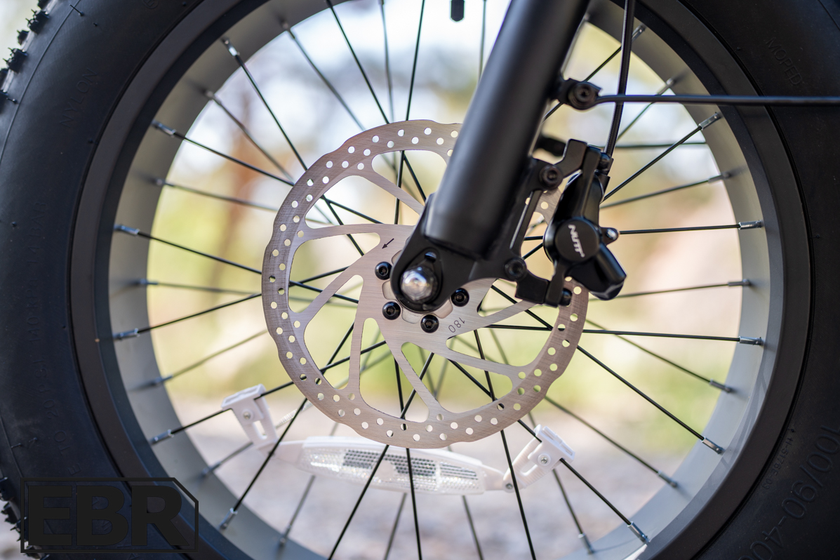

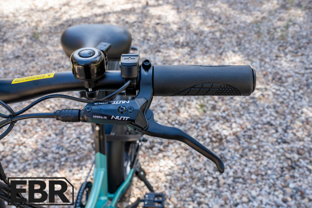

The NUTT hydraulic disc brakes performed better than I expected. You get 180mm rotors front and rear at 1.8mm thickness, and we put them through six-plus hard consecutive stops coming down a very steep descent that was wet with red dirt washed onto the trail, plus a long 30-second drag at around 10 mph. There was a little squeal at the beginning that went away, and no fade at all. NUTT is not a household name like Shimano or SRAM, but we have had good luck with them so far.

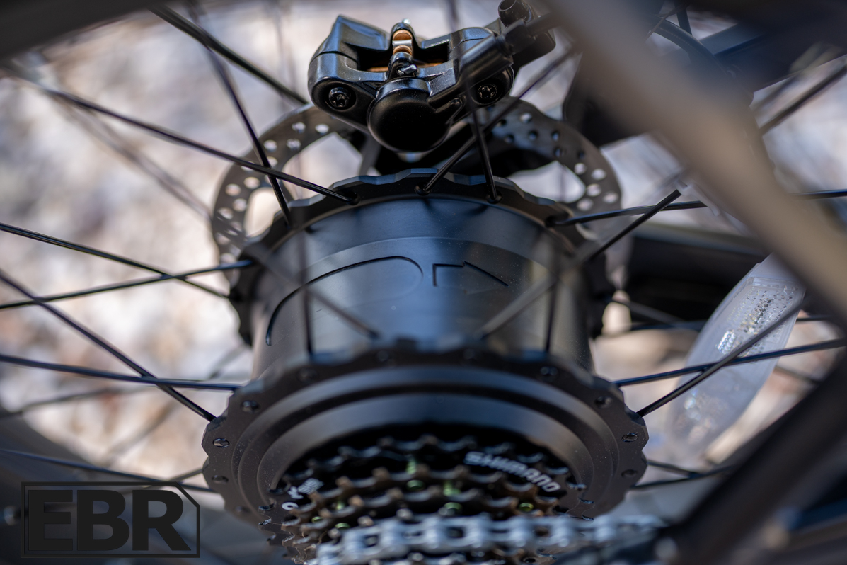

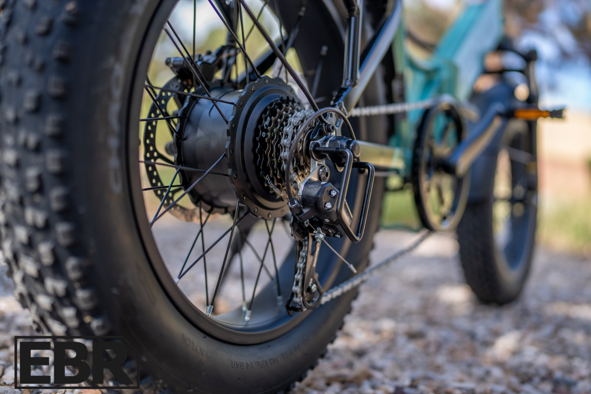

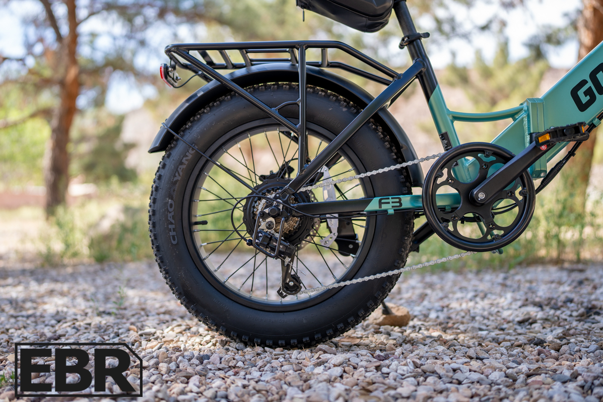

The Shimano Tourney 7-speed drivetrain is where I would recommend GoTrax improve a little. You get a 52T chainring up front and a 14-28T cassette in the rear, and on a bike that can hit 28 mph, that is not enough range at the top end. Past about 19 mph you are spinning faster than you want to. Adding a gear or two, or moving to an 8-speed, would take care of it and make this a more capable Class 3 bike.

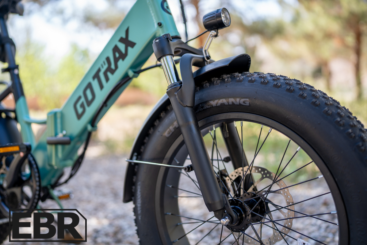

Suspension is a coil fork with lockout on 28mm stanchions, using a dropout rather than a thru-axle. GoTrax has not published a travel figure, so I am going off our own measurement, which puts it somewhere in the 30 to 40mm range. A thru-axle would stiffen up the front end, and that is something I bring up constantly on bikes at this price. The dropout is fine, it is just an area they could improve.

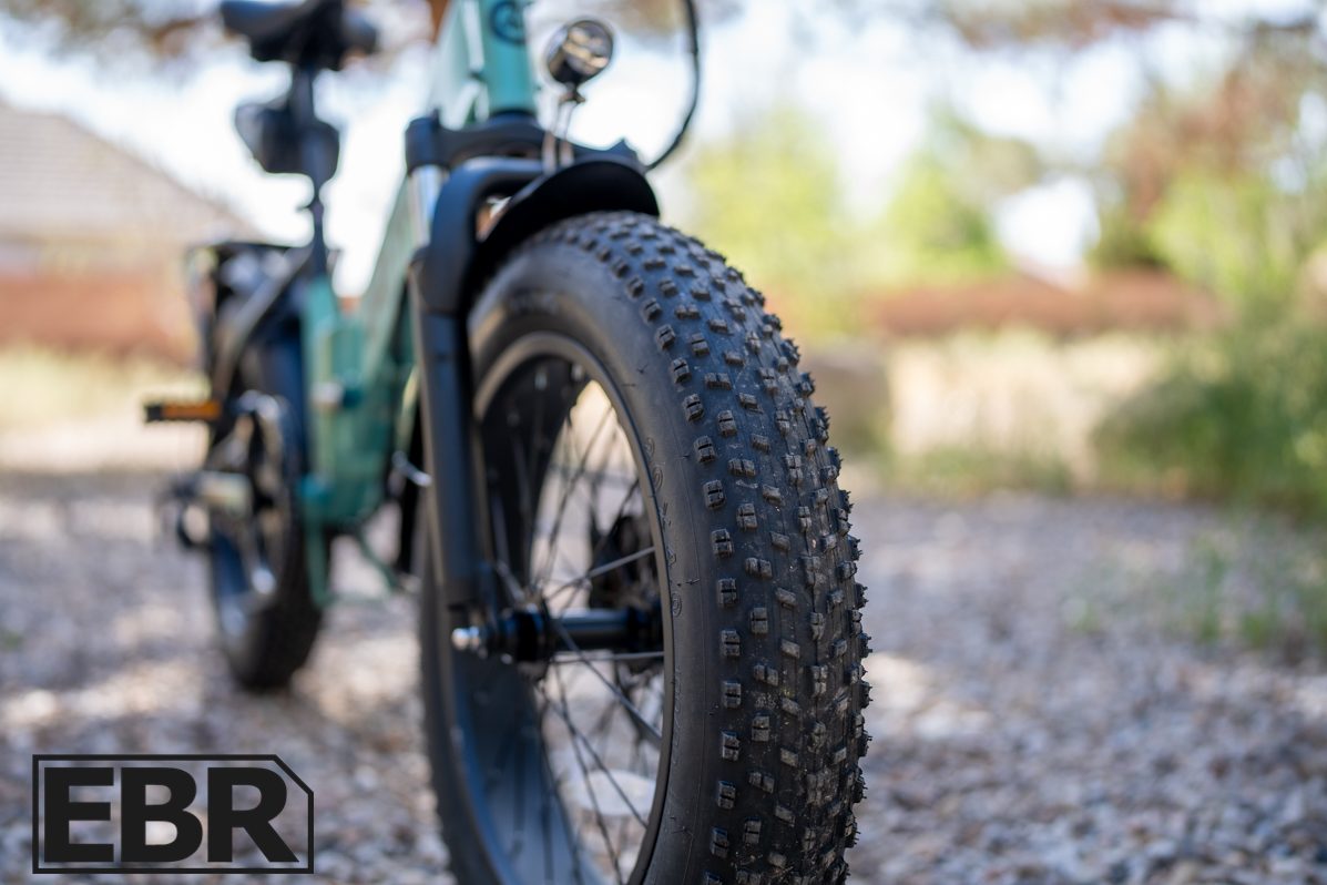

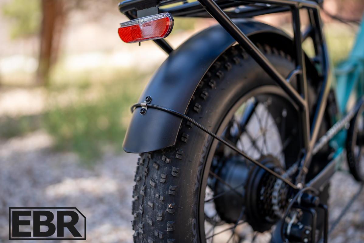

The 20″ x 4″ knobby tires split the difference between off-road grip and pavement rolling better than I expected. You also get metal fenders front and rear, which do their job but make the bike noisier when something hits them, a frame-welded rear rack rated at 25kg or about 55 lbs, and front and rear integrated lights. No turn signals.

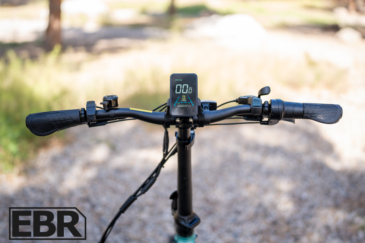

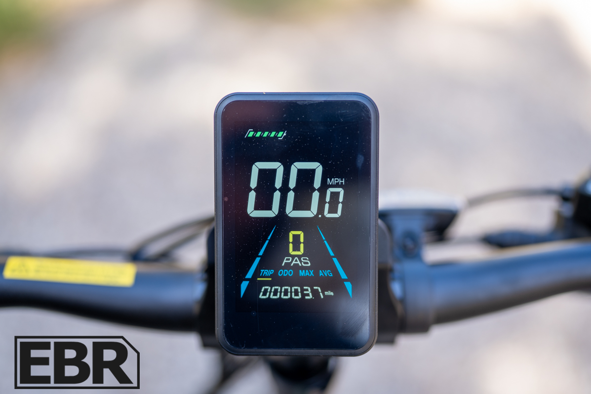

The F3 has a full-color display of about 3 inches, and it is a good size and easy to read. You get speed, your assist level, and a set of readouts along the bottom for trip, odometer, max speed, and average speed that you scroll through with the inner button on the control pod. Our test bike had 175 miles on the odometer by the time we finished, so we spent a fair amount of time with it.
The battery readout is where the display could be improved. It is a five bar readout, not a percentage. Five bars means each one covers 20 percent of the pack, and once you are down to the last bar you are guessing. On a bike with a 672Wh battery and a 74 mile ceiling, that is a lot of range to guess at. I would rather have a true percentage, even though that means GoTrax would need to spend a little more to upgrade from a square-wave to a sinewave controller.
The other thing I would change is the light button. Turning the lights on dims the screen. I like running lights during the day for visibility, and I do not want to trade screen brightness for that.
Advanced settings live behind holding the plus and minus buttons on the control pod. Most of what is in there should be left alone: units, system voltage, the number of assist levels, and wheel diameter. The one you will use is setting number five, the speed limit. It is set to 20 mph out of the box and goes up to 28. That is your Class 3 unlock, and it takes about five seconds. There is no app, so everything happens on the screen. At $899 to $999 I am fine with no app, but I would trade a lot of app features for a percentage battery readout.
