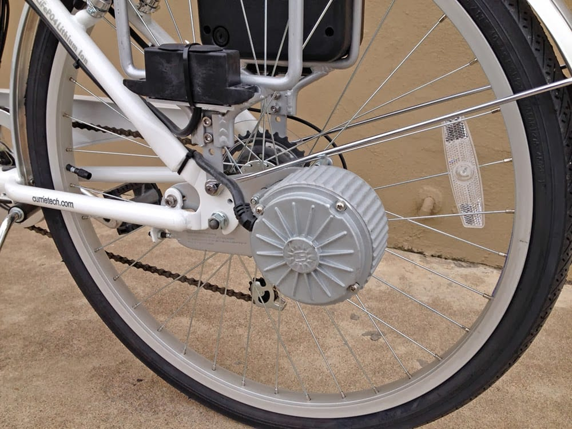

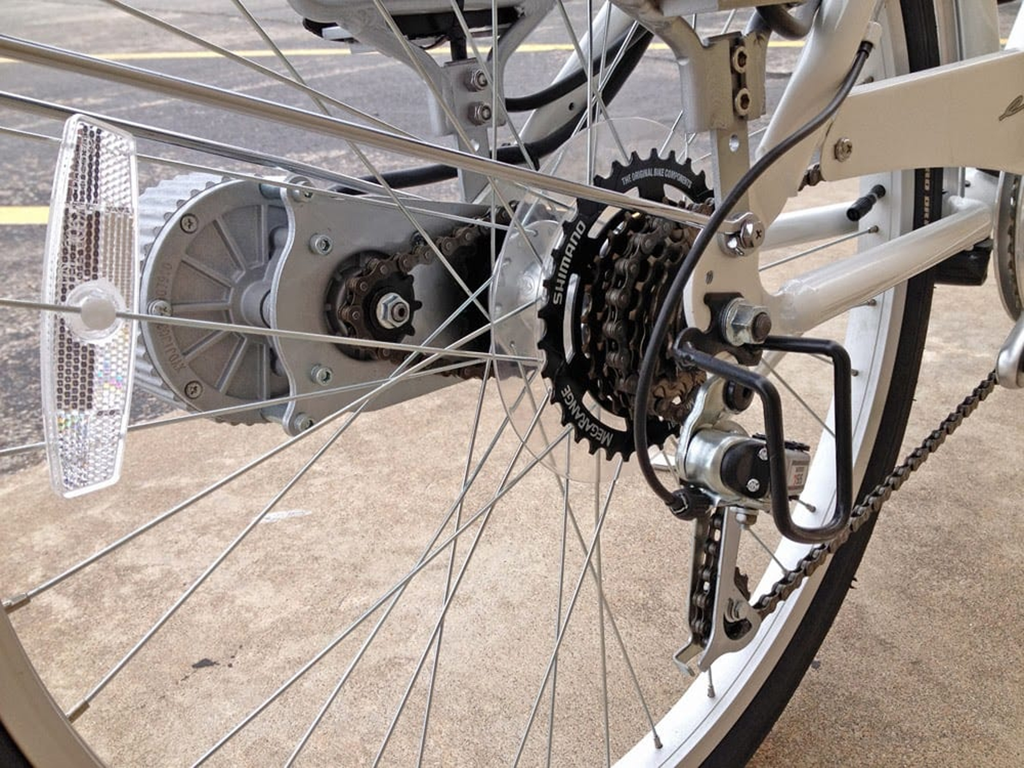

The 450 watt motor driving this ebike is very unique because it isn’t mounted as the hub of the front or rear wheel nor is it a mid-drive design. It sits just behind the rear hub on the port side (left side) of the frame and is mounted to a giant torque plate for stability. The motor drives a short chain that is directly connected to the rear hub. It’s a brushed design that’s not as smooth or long lasting as gearless might be and it has a more limited range of drive speeds (which I imagine is partially why the bike can only reach 15 mph). Given that the motor requires a second chain of its own, in addition to the regular chain connected to the front ring that the rider activates when pedaling, the rear wheel can be tricky to remove if you get a flat.

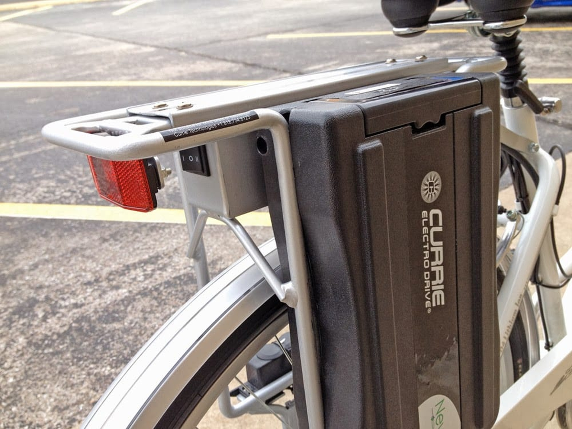

The battery pack driving this bike offers 25.6 volts of power with 9.6 amp hours of capacity. That’s not a whole lot compared to others available in the US that tend to offer 36 volts of power and 10+ amp hours capacity but it’s kind of the norm in Europe. It’s contained in a plastic box that slides onto the left or right side of the rear rack. The pack only weighs 5 pounds (vs. 15 pounds for the pack on the standard Trailz) and has a handle at the top making it easy to remove for charging or just to make the bike lighter for transport. The rear rack uses standard gauge tubing that works well with bags and panniers but can get loose more easily over time and tends to rattle. Still, it’s a clever system that makes mounting a second battery very easy and actually keeps weight lower than other rear-mounted battery designs like the Prodeco Stride but not quite as low or centered as the e-JOE Anggun.

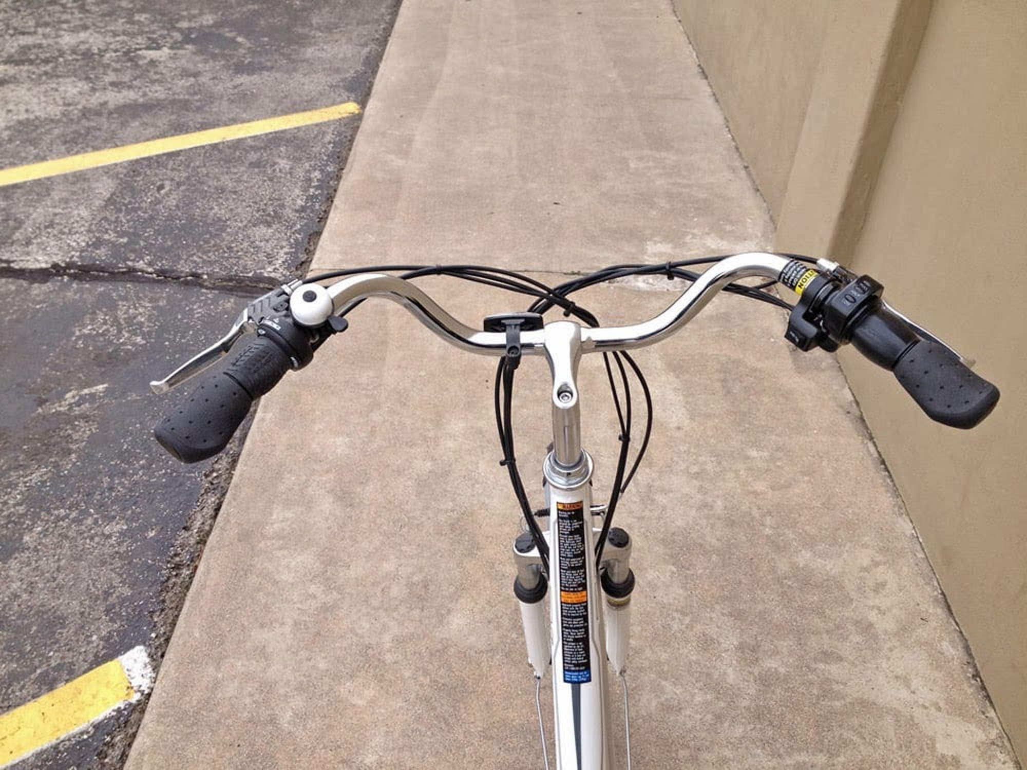

The control interface on the eZip Trailz Commuter (and regular eZip Trailz) is very simple. Once you’ve selected a battery using the switch on the rear rack you use a toggle switch on the right handle bar to select from twist and go (TAG) or pedal assist mode (PAS). Contained in the switch box are three LED lights that show battery capacity by illuminating green yellow and red. It’s not as precise as some other bikes but it’s simple, durable and inexpensive. The twist throttle on the right balances out the twist shifter on the left bar and is satisfying and responsive to use. Also note, if you twist the throttle while pedaling in pedal assist mode, it actually increases the power from 50% assist to 100% assist which helps when climbing hills. It’s a neat feature that works well but isn’t obvious at first.

In pedal assist mode the bike can go quite far (25 miles) and the rear rack design makes it very easy to add a second battery for increased range

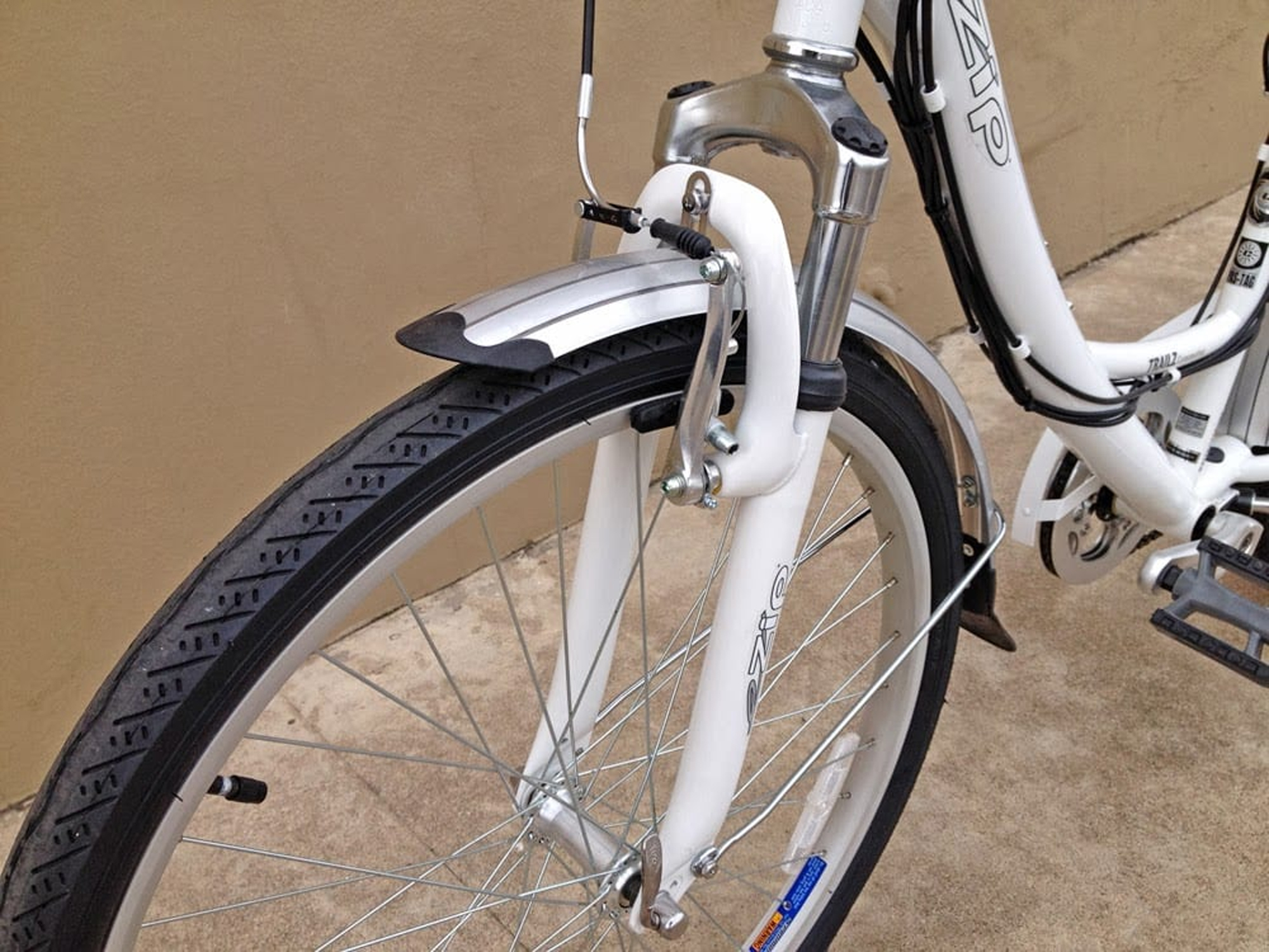

Great options for comfort and utility when commuting including a seat post shock, suspension fork, front and rear fenders and a chain guard

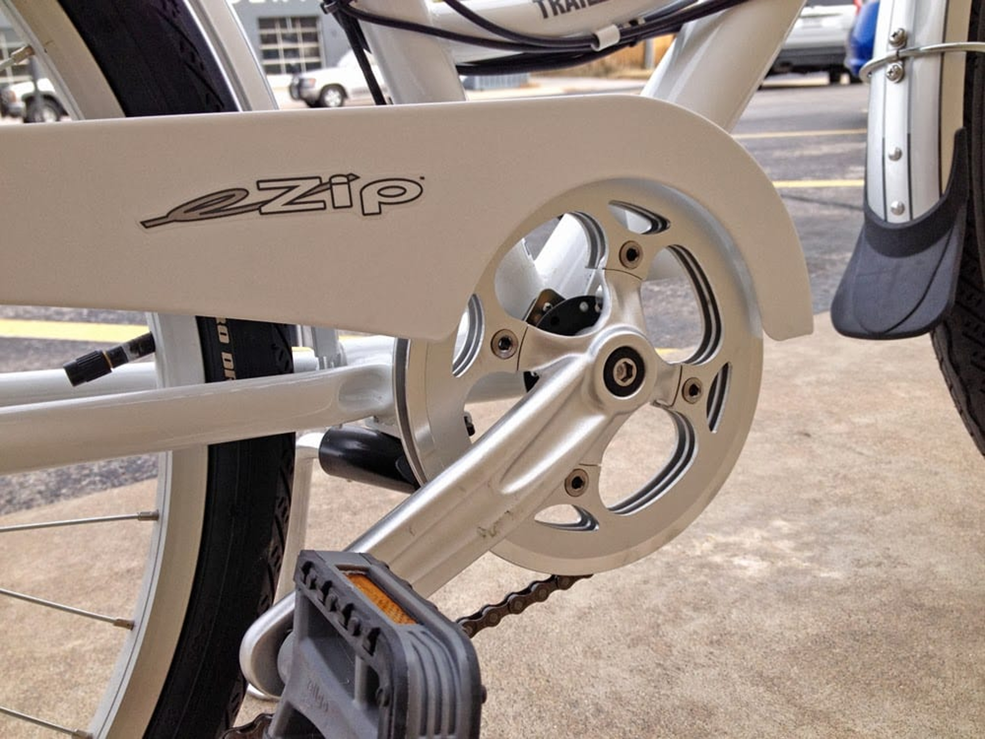

Seven gears on a Shimano rear cassette with an oversized ring for climbing, the front chain ring has an aluminum bash guard that doubles as a chain guide to keep the chain from falling off

Rear rack is bolt on which can start to rattle and get loose over time supporting the weight of batteries and add-on bags or panniers, it’s also easy to bump your knee on this when mounting the bike

Motor design requires an extra chain and is off-center making it trickier to take off the rear wheel

No lockout on front suspension, basic fork with very limited adjustment options

#3 Chaingaurd – helps keep your pant leg clean.

#1 Replace 9T motor sprocket with 11T for 20mph capable = $18 – http://www.gngebike.com/parts
