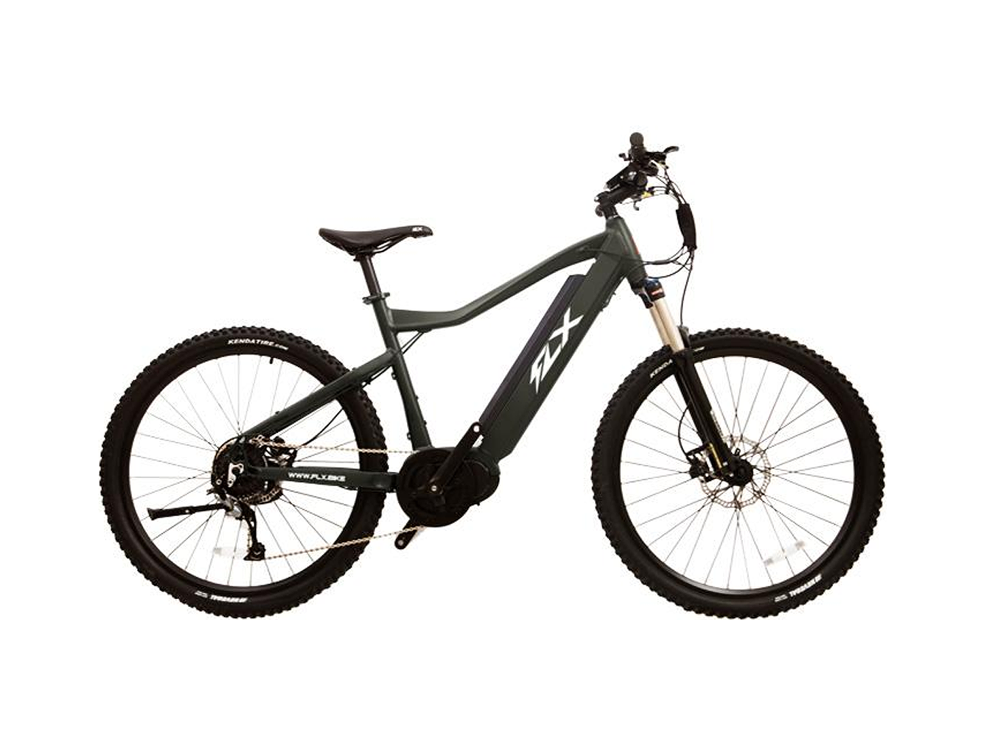

The Trail is the second bike in FLX’s lineup I’ve reviewed so far, and like the Blade, the Trail is a fun, purpose-built electric mountain bike designed with dirt trails in mind. It only comes in one frame size, 19”, but offers three different colors: Electric White, Carbon Black and Gun Metal Gray. It also comes in a few different configurations. The base model of the Trail runs for $1,899, the Touring Package runs for $2,169 and includes a rear rack, integrated front and rear lights and fenders, and there’s also the option of upgrading the 13ah battery to a 17.5ah battery for an additional $299. The Trail has a higher-than-normal top speed, upwards of 40 mph, placing it squarely outside the typical classes of electric bikes. The high top speed is cool for tearing through the trails, but it also means it’s likely illegal to ride in most places, making the Trail more of an off-highway vehicle (OHV) or private property experience as opposed to general cross country and trail riding. Riding this bike on the road could pose some legal issues, especially in the case of an accident, so please be careful. Because the Trail can be considered an unregistered vehicle (due to its top speed), there may be some serious legal ramifications if you were to hit another biker, pedestrian, vehicle or even damage public or private property. That being said, given the Trail only has a 350 watt mid-drive motor, I don’t think it’s likely I could hit the top advertised speed of 40 mph unless I was on level pavement in some sort of super aero position. However, I was able to get it close to 30 mph relatively easily and have ranked it as a 35 mph bike in the stats here. FLX started as FLUX back in 2016. They launched an Indiegogo campaign, asking for $50,000 and raked in an incredible $1.7 million from the campaign, plus an additional $400,000 from their website. Needless to say, they crushed it. FLX has dropped the “U” and now they have some second-generation models being added to the lineup. So let’s dive into the Trail and see what this bike is all about.

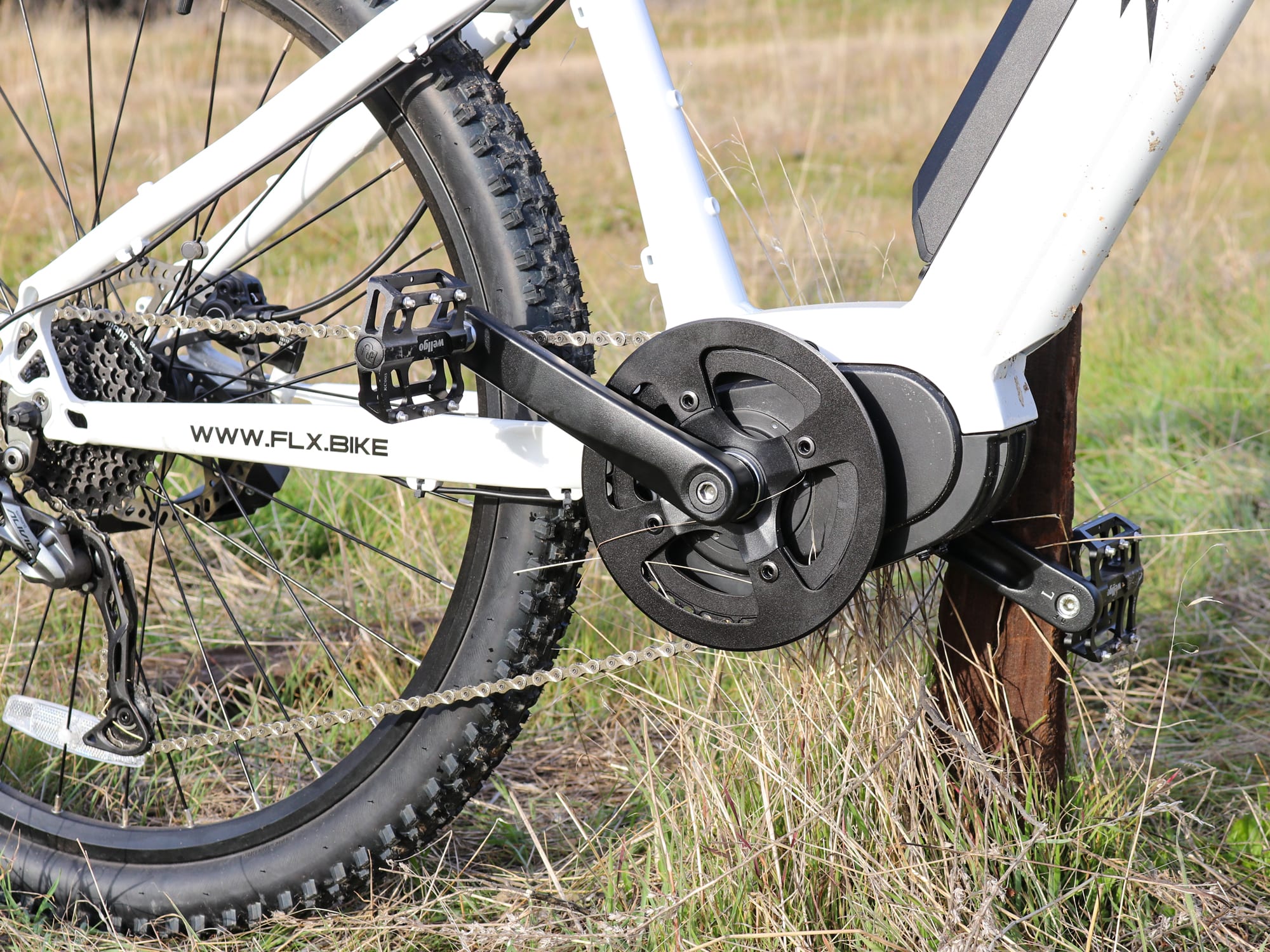

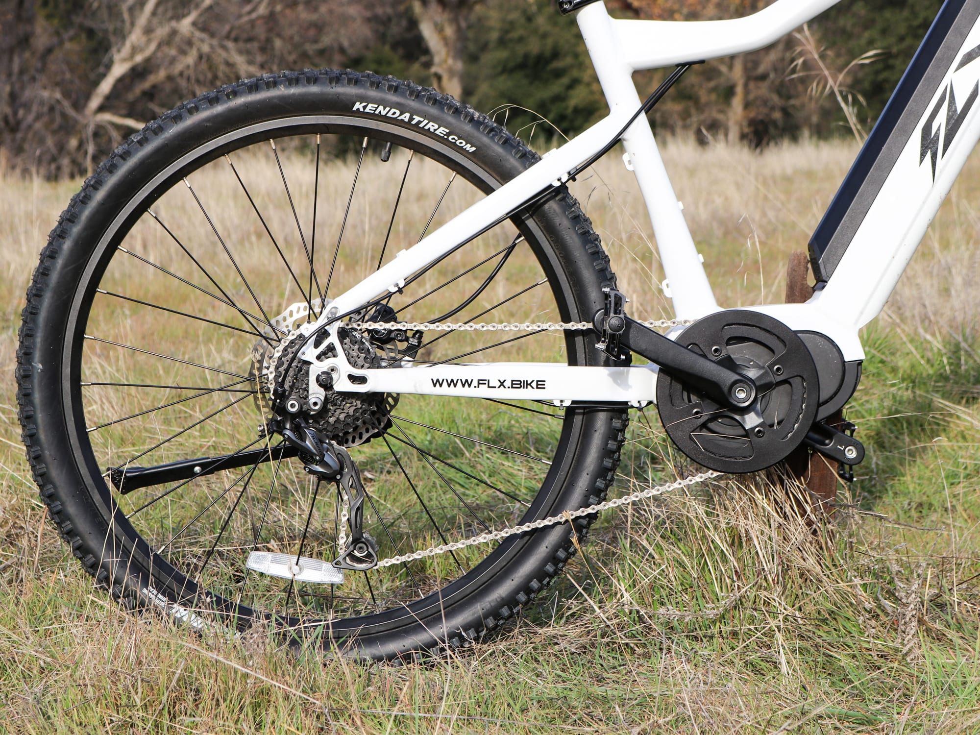

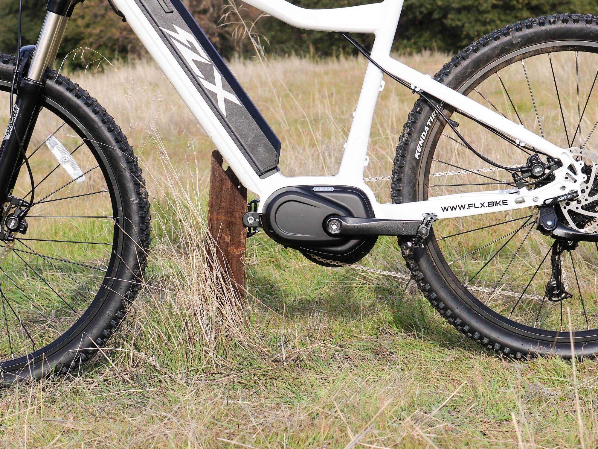

Driving the trail is a 350-watt mid-drive motor, called the Max Drive from Bafang. This is the second time I’ve tested a bike with this specific motor and I like it even more this time around. While it’s nowhere near as powerful as the 1,000-watt motor on the Blade, it is far quieter. It’s so quiet, in fact, that I have to strain to hear it running. The motor has a modest 80 newton meters of torque, but thats more than enough to help get me (as a 200 lb rider) climb some steeper hills. Riding the Trail with this motor is an entirely different experience than the Blade (obviously :). With the Blade, it felt almost like the bike could get away from me because of the immense power, but with the Trail, it feels more like it’s assisting me – like I’m in control vs. the bike being in control. I also appreciate the 350-watt motor as it still allows me to get my heart rate up, even when I’m on the highest pedal-assist mode. The torque sensor on the Trail works well with the motor, giving power almost immediately after I apply pressure to the cranks and stopping just as quickly when I let off the gas. Like I mentioned in the FLX Blade review, I deeply appreciate the torque sensor versus a cadence sensor as it allows for a finer degree of control when traveling at low speeds. This is especially important to me when I’m trying to navigate trickier terrain. I like that when I stop pedaling, the motor stops giving power. I’ve run into issues before with cadence sensors where I’m trying to creep along a ridge crest or something and the motor just doesn’t want to shut off. Thankfully, that’s not an issue at all with the Trail. With this particular setup, the motor will technically continue giving pedal assist up to 40 mph, but the top speed with the throttle is limited to 25 mph.

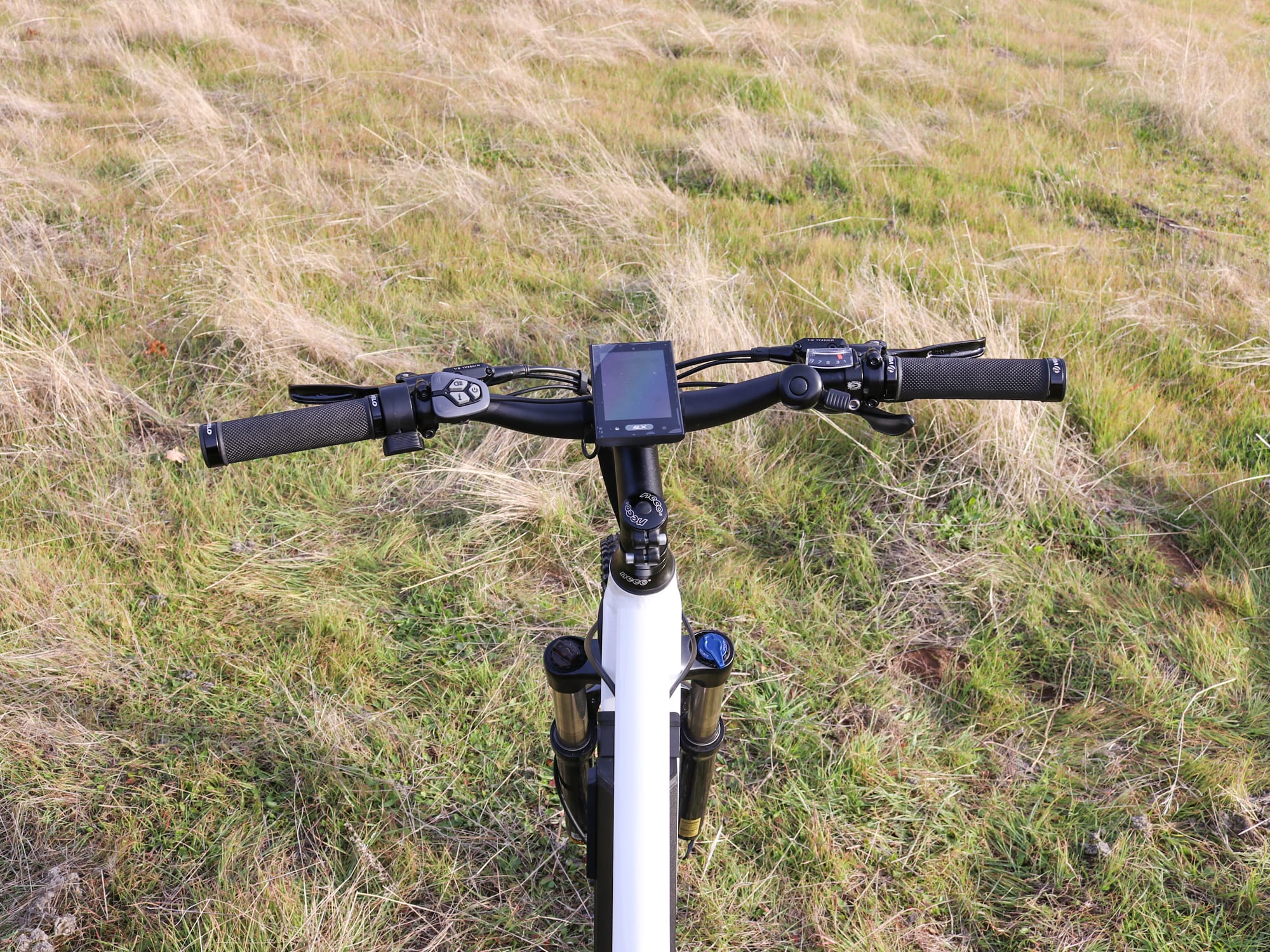

I like the trigger throttle design that FLX went with for this bike because it will stay out of the way compared to a twist throttle and allow you to focus on steering and grip if the terrain gets rough. You cannot activate the throttle at standstill, which can be annoying when you go to start, but this does make it a bit safer to mount and dismount the bike when it’s turned on. I usually try to remember to turn off electric bikes with throttles before doing anything besides riding them, especially messing with the gears, fixing flats, or mounting them to my car rack. The way this throttle works is that you have to be moving upwards of five miles per hour before it goes active… I have tested other ebikes where you only have to go one or two miles per hour, and I preferred those. You may notice that at one point during the ride test in the video review, I was struggling to go fast enough (while climbing) to get the throttle active. It was a bit annoying and perhaps this is a setting that FLX can adjust in the future. Thankfully, the throttle can override all of the assist levels with 100% power once you are going fast enough. It’s a convenient way to zip up to speed or climb a hill without adjusting the assist level using the button pad.

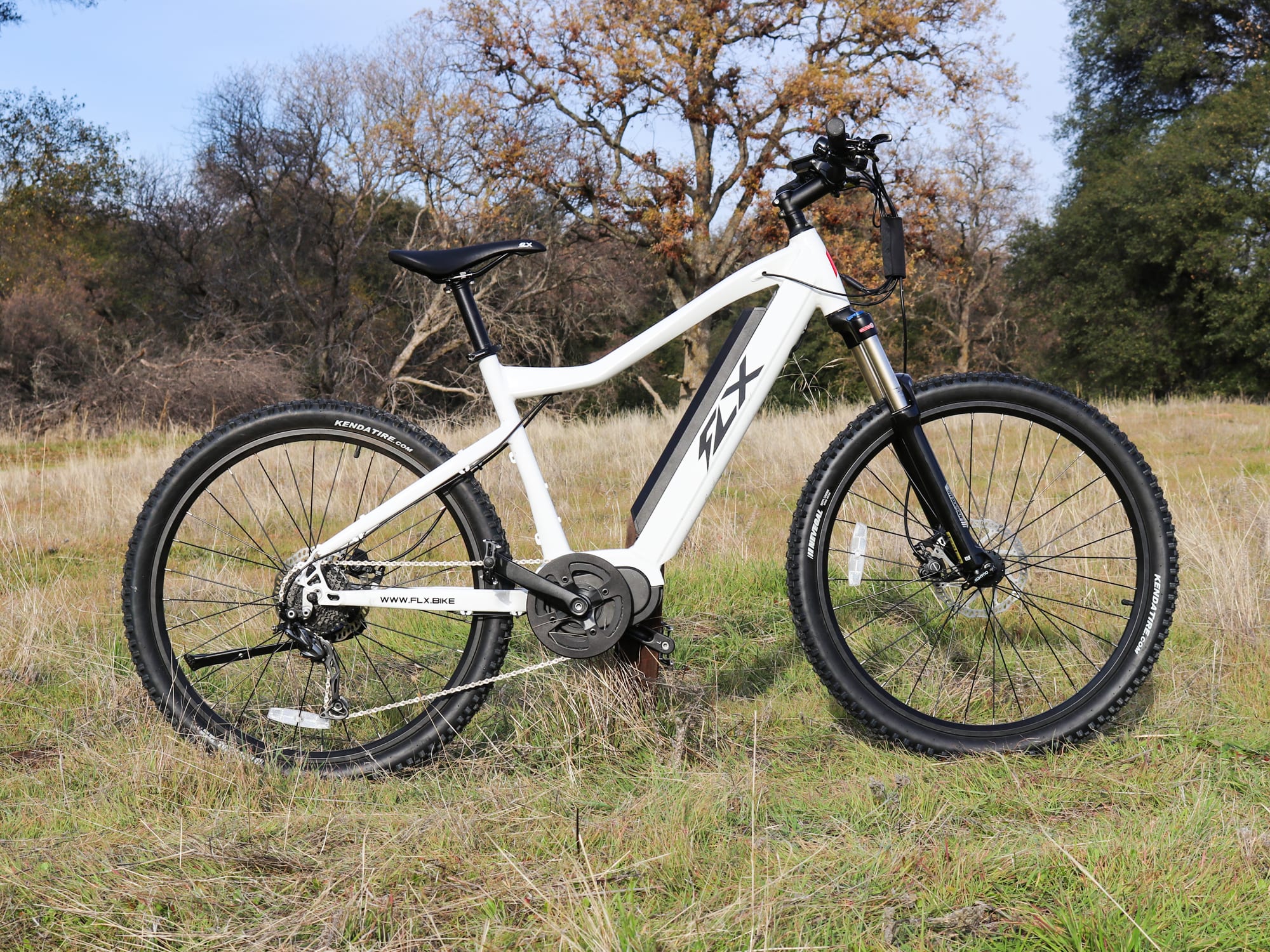

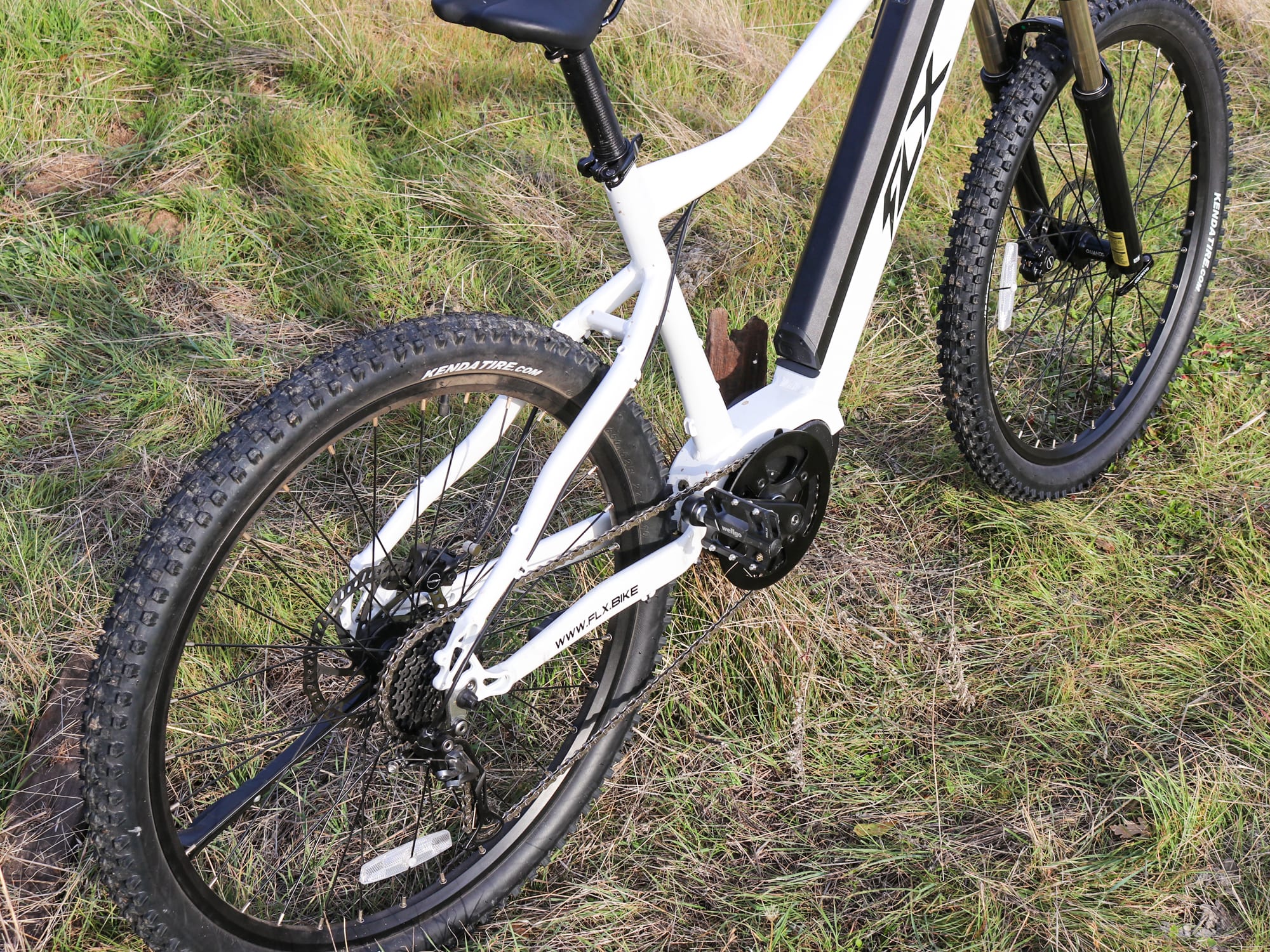

The frame itself is made from aluminum alloy, offering an average curb weight of 50 pounds. And, since the motor is located low on the middle of the frame, and since the battery is on the down tube, it’s pretty well balanced. There’s probably two main reasons this bike is so much lighter than the Blade: It has a much smaller motor and battery. The roughly 10-pound difference between the Trail and Blade is definitely noticeable when riding and I was able to flick the Trail around pretty easily during the ride test. The frame also looks pretty cool (to my eyes) and was custom designed by FLX to take a beating. The Trail I tested was the Electric White color, which stands out nicely against pretty much all backgrounds and would be more visible in dark conditions. While the Electric White color does stand out, I might lean more towards the Carbon Black myself since everything is all one color. With that setup, the battery and cables really disappear into the frame and it has a stealthier look. One of my biggest complaints about the frame though is the lack of rear suspension. While I could add a seat post suspension, it’s not the same as an integrated rear suspension. Additionally, the tires are only 2.1 inches wide, and since this bike doesn’t have boost, I can’t add plus size tires, which would increase the overall air volume and make for a cushier ride. FLX does offer a seat post suspension of their own, but most aftermarket seat post suspensions with a 31.8 mm diameter should also work (or you could use a shim to hit this size, I was a little surprised at my own measurements of 31.8 mm because it seems like 31.6 mm is much more common, feel free to correct me in the comments below). The frame also has fender bosses, water bottle bosses and rear rack bosses, which are great for those who want to pedal through the city on the Trail (but just remember the potential legal issues of doing so). The locking, integrated battery fits snugly to the frame and doesn’t bulge out past the sides. It’s a 36 volt, 13 amp hour battery, but there’s also that option of the larger 17.5 amp hour battery for those who want to ride further (and I love that that pack does not bulge out past the sides).

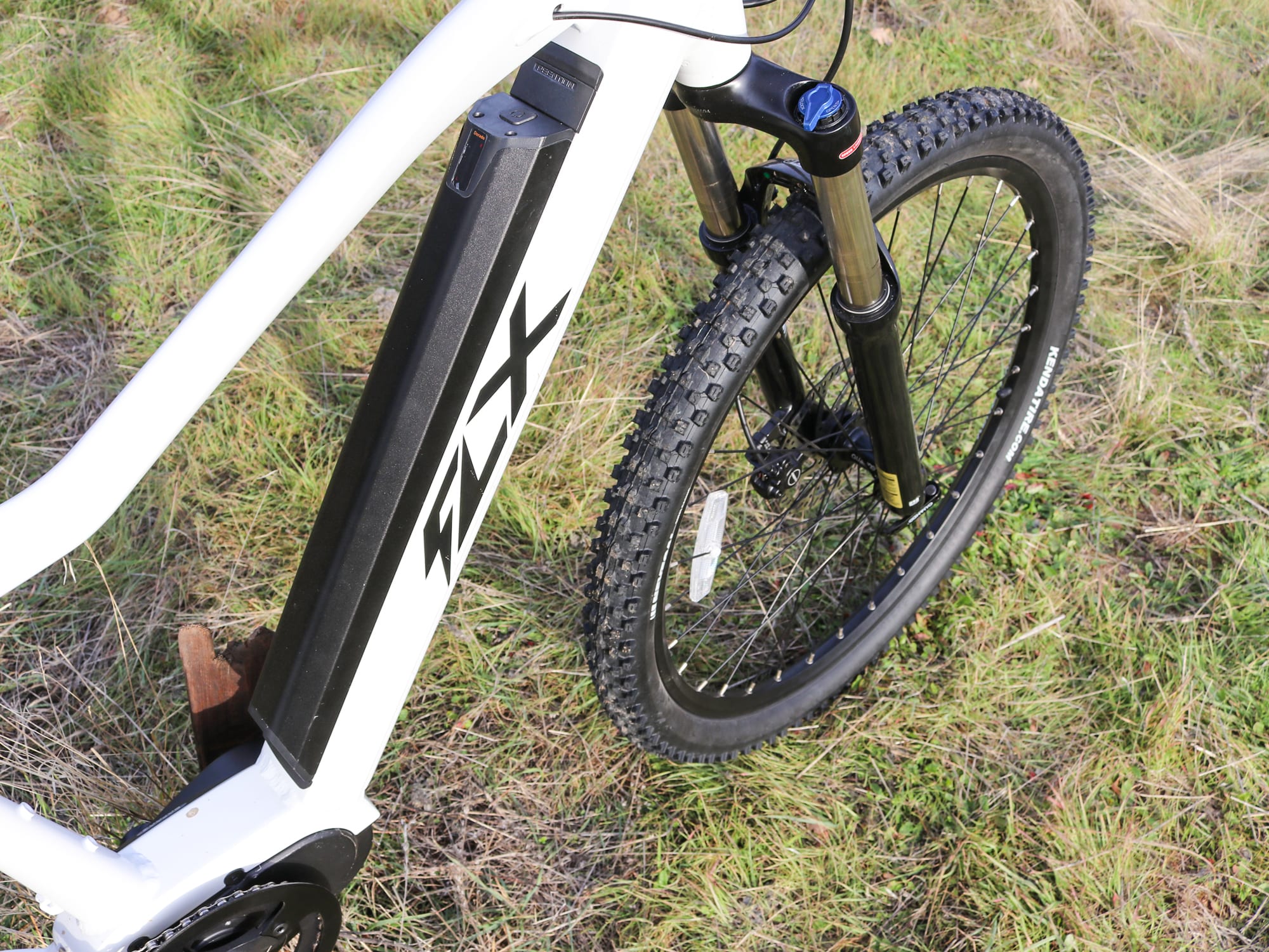

FLX estimates the range at around 60 miles in the lowest pedal assist setting with the 13ah battery, but I think realistically I would get around 20 miles with the way I ride. I really appreciate that the battery and display console up at the handlebars have USB ports for charging accessories on the go! You could use this to maintain the charge of your smartphone while using GPS and then take the battery pack off and use it to power other portable electronics while camping etc. Mounted in the middle of the handlebar is the FLX-branded Bafang control center, which offers tons of information. This control center displays current speed, top speed, average speed, range, battery level, pedal assist mode, wattage output and quite a bit more. More importantly, I can see it in direct sunlight! The only downside to this display is that it’s not easily removable, so leaving it unattended in a public place could subject it to tampering. Another cool thing about this control center is the extensive configuration options. I can set up a passcode to keep children or anyone else from accessing the electronics. I can also change the top speed to whatever I like. So if I want to tone this bike down, that’s an option.

- The LCD control center offers tons of information and is easily visible even in direct sunlight, you can angle it a bit to reduce glare, navigating through the different display features is intuitive and I was able to reach the button pad without taking my left hand off the grip

- Bafang’s Max Drive motor is incredibly quiet and smooth but still very responsive, the motor controller relies on a multi-sensor to gauge rear wheel speed, pedal cadence, and pedal torque
- Locking integrated battery pack fits snugly into the frame and doesn’t bulge out past the sides, it also has a full sized USB Type A port at the bottom to charge accessories (just be careful not to bump this when pedaling, you might want to use it as an energy bank off the bike)

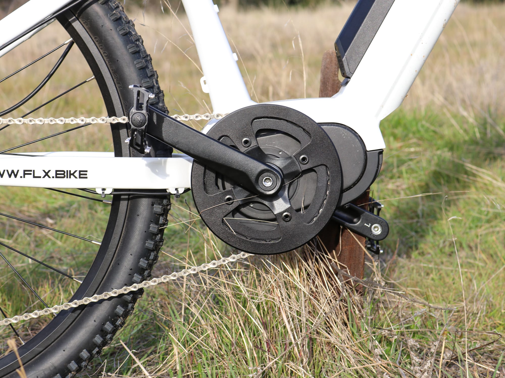

- Aluminum bash guard on the chainring should help protect the sprocket ring teeth from damage during log and rock strikes if you take the FLX Trail into the woods
- The chain ring has a narrow-wide tooth pattern to help keep the chain securely locked on, this is really nice for riding at high speed on bumpy terrain, especially since there isn’t a chain guide

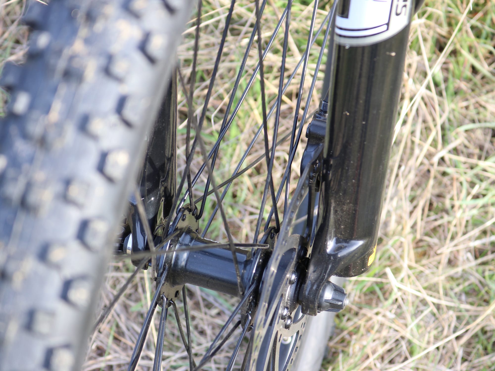

- Suntour XCR suspension works well enough to absorb moderate bumps and jumps, but isn’t as lightweight or adjustable as an air fork, it offers adjustable rebound and lockout however and both wheels have quick release skewers for easy trail maintenance

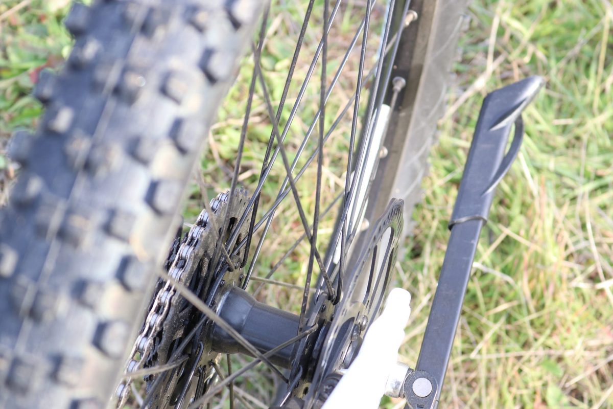

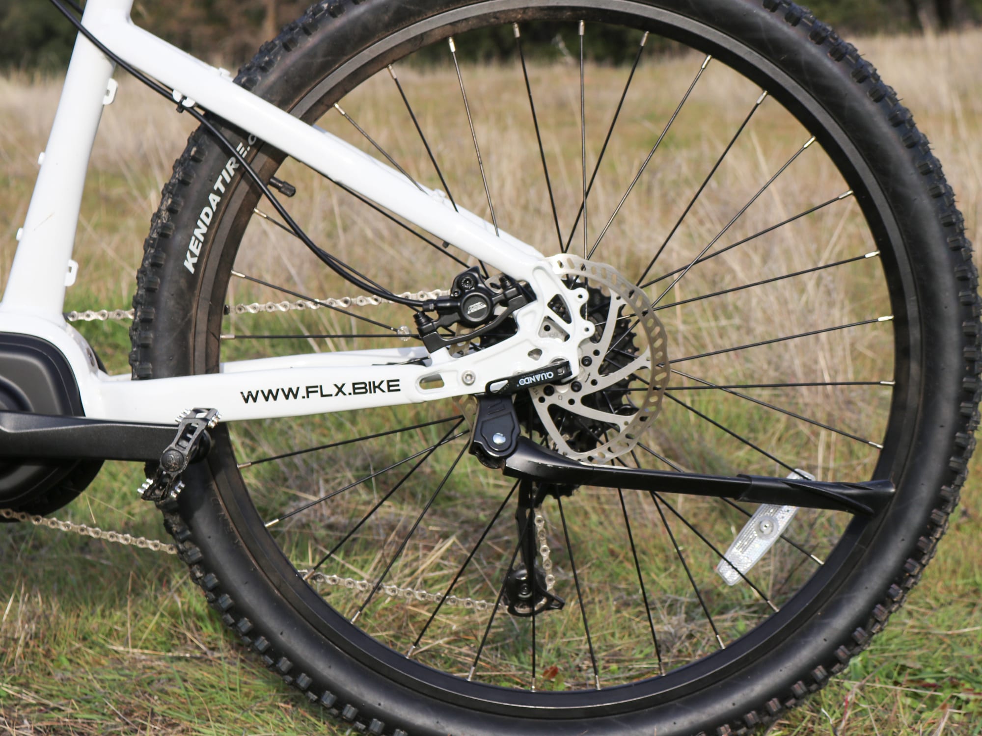

- Shimano Alivio derailleur is nice enough, but it’s not e-bike specific and without shift sensing it may struggle to handle the power of the motor over time, so shift gears thoughtfully by easing off as you pedal

- Skewers are used instead of thru axles, and this coupled with the standard hub spacing seems like it may not be enough structural integrity to handle the highest top speed of 35+ mph
